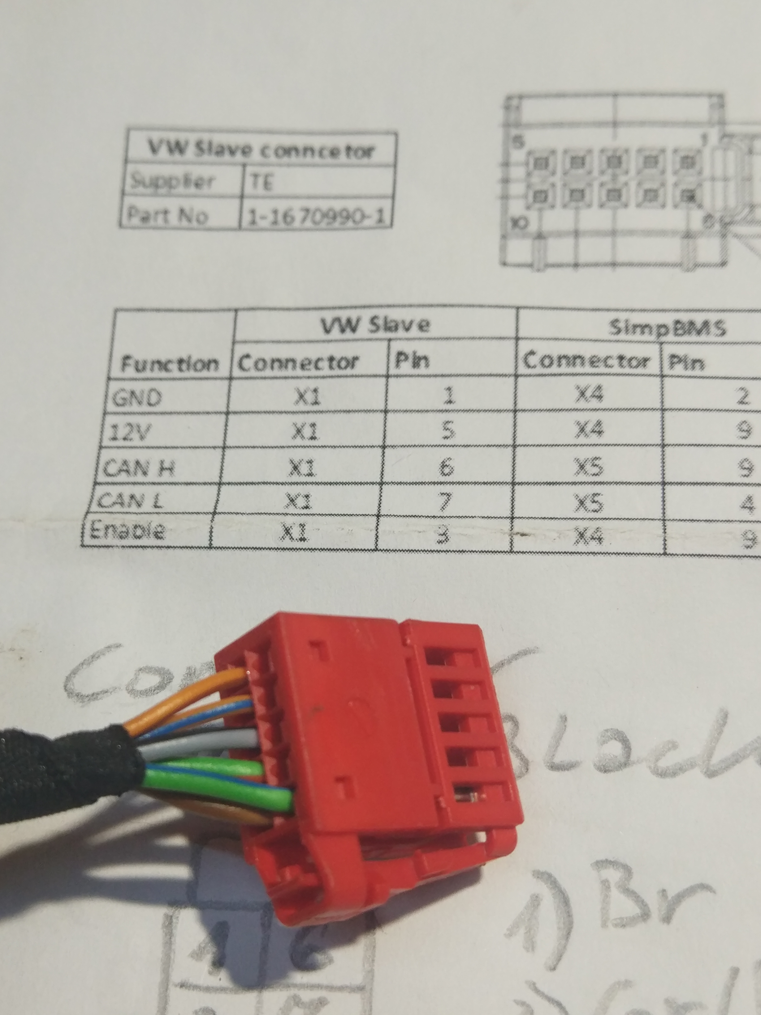

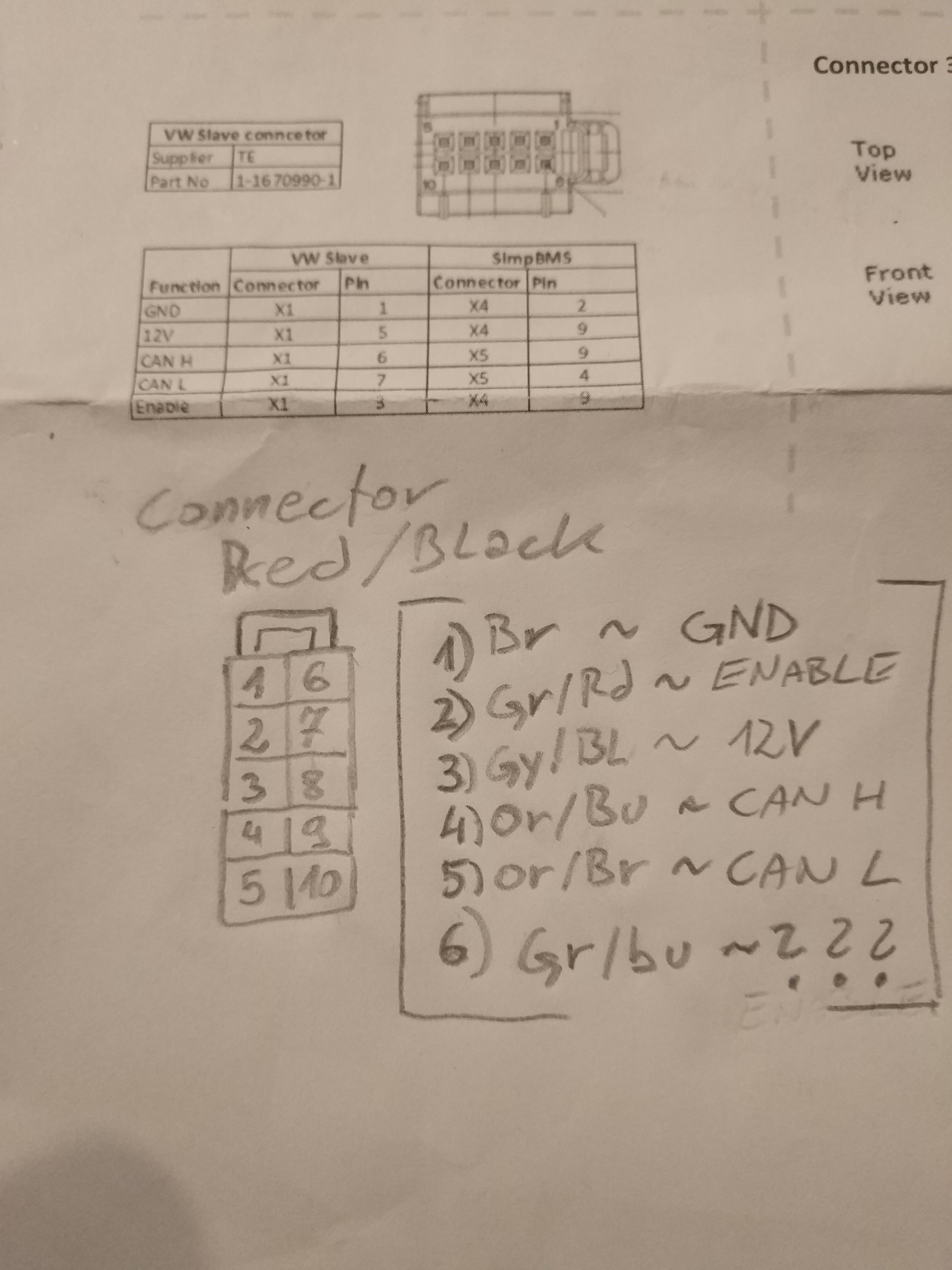

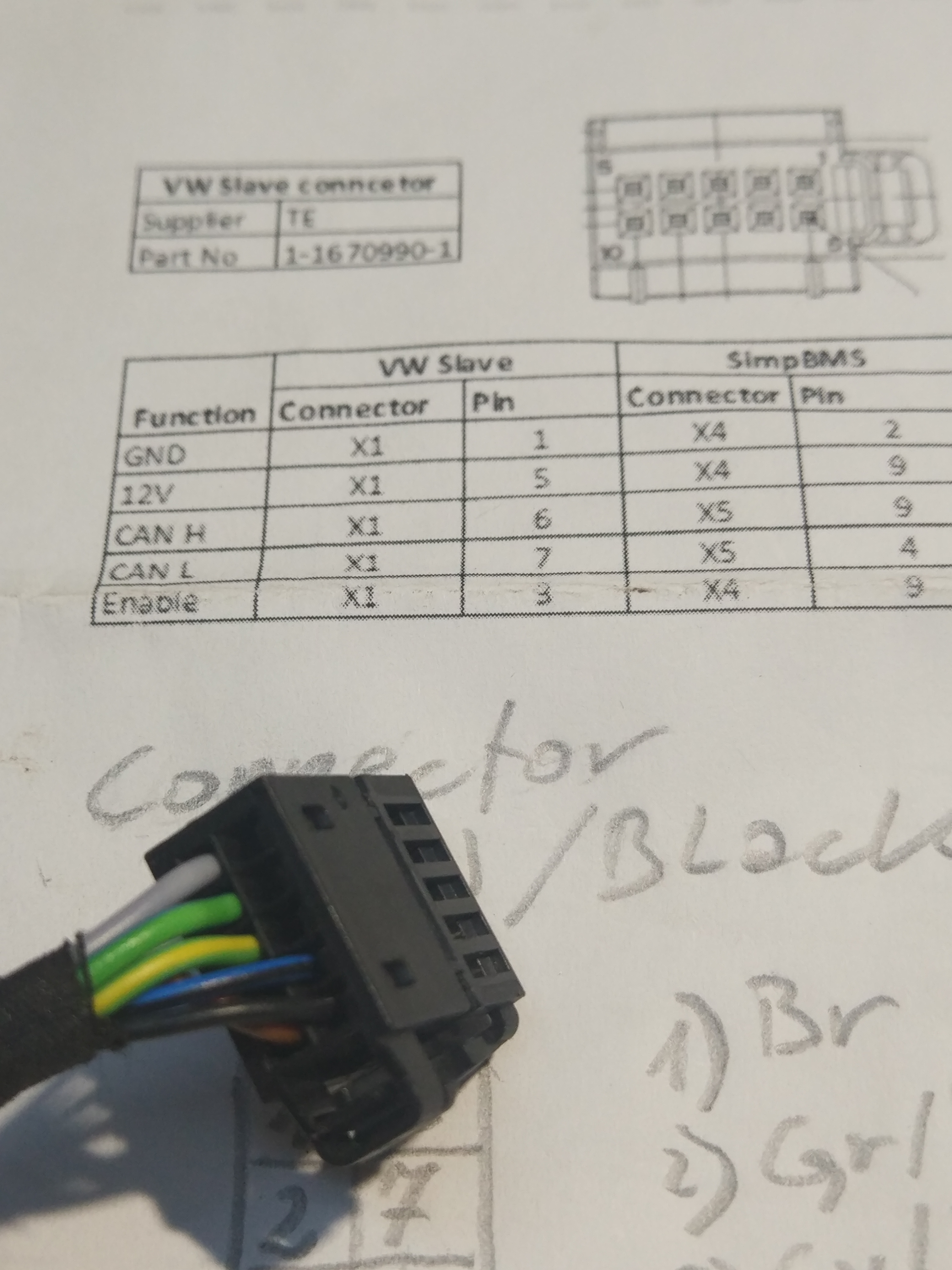

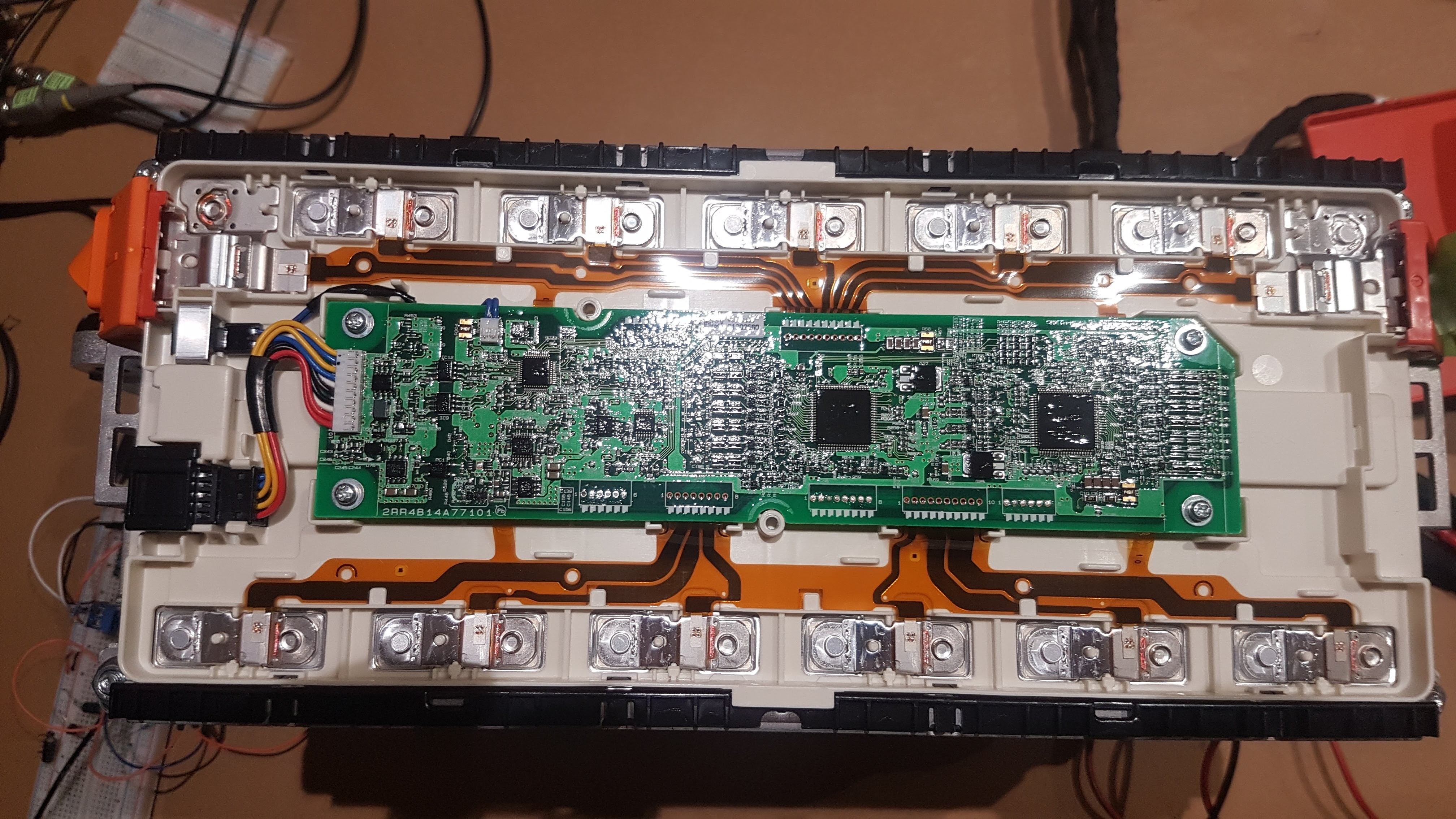

tom91 wrote: Sat Feb 13, 2021 6:02 pm VW code has been update to now include Audi Q7 Phev 13S batteries.
Hi Tom

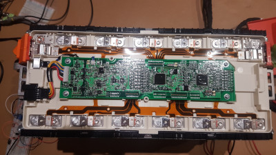

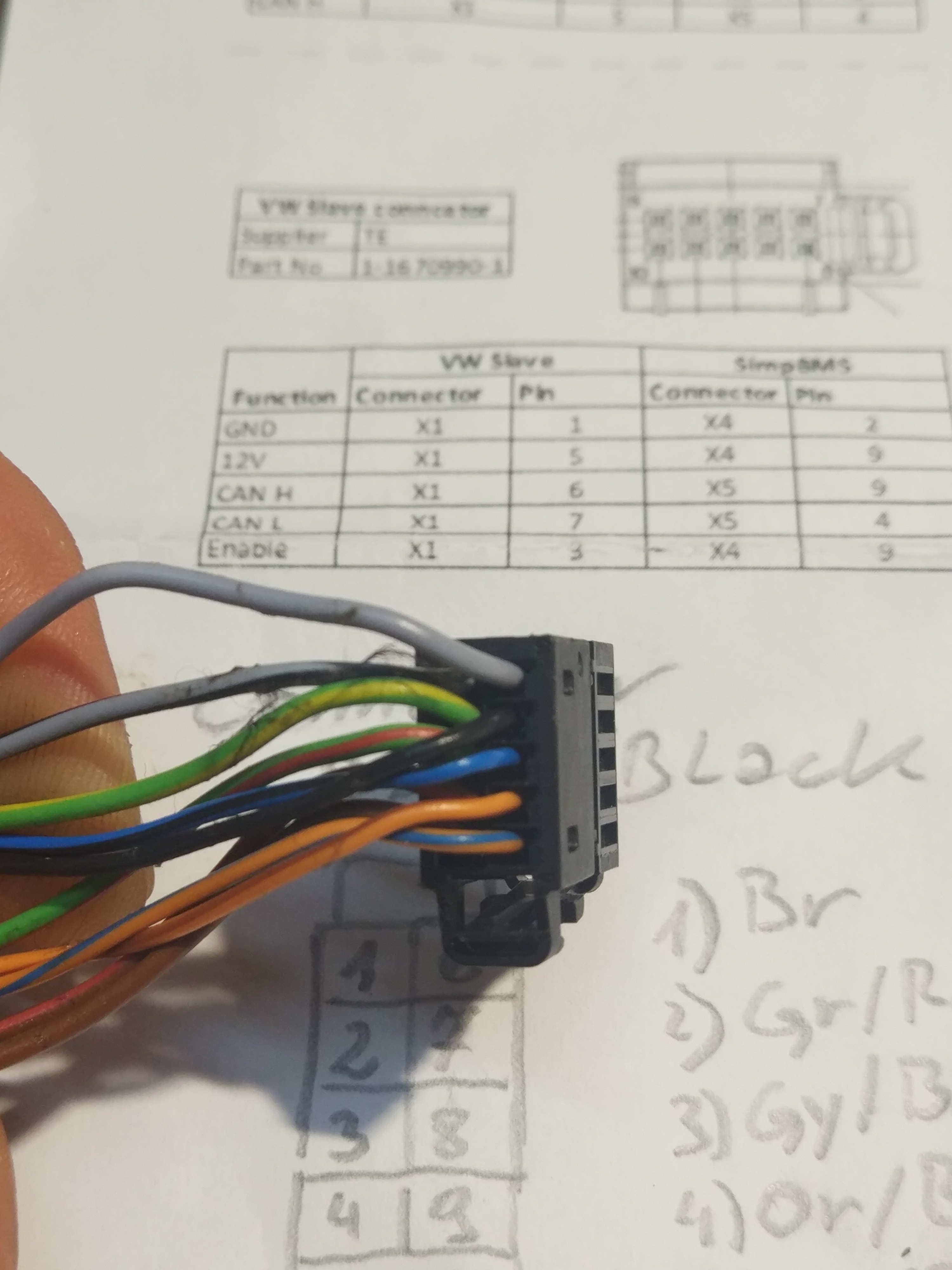

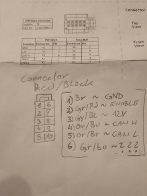

I have started to play with VW Passat modules at last. I see there are 7 standard wires/pins to connect SimpBMS to slave modules. But only the first connector on the harness has 7 pins. All the rest have more (9). Can you or someone explain how are the rest of the wires related? I can trace some of the pins as 12V, GND and Enable signals, but there are two additional CAN bus wires.
1. Are those wires just pass through for the slave CAN or is this a separate line?
2. I would like to use halfh pack wires into Red and black connectors that join to common pins on the master. Not all pins are alligned... Of course i will replace master with SimpBMS. Has anyone done that allready?
EDIT: I went along the wires and i can speculate further that neighbouring pins are in fact passtrough for the 12V, GND and Enable with addition of CAN H and CAN L. Everything leads to one RED and BLACK connector that are joined together on the same pins. I will test my theory in the next days.
tnx
Posts: 1884
Has thanked: 91 times
Been thanked: 517 times
Re: Simp BMS
The the Golf GTE, it's a similar setup, the wires are doubled up. Assuming for redundancy.

Re: Simp BMS
Bigpie wrote: Mon Jun 07, 2021 8:13 am The the Golf GTE, it's a similar setup, the wires are doubled up. Assuming for redundancy.
Thanks for the confirmation! I think pins are bridged inside BMS so that wiring could be made easier.
I will work more on making integrated contactor schematic.

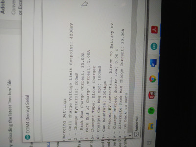

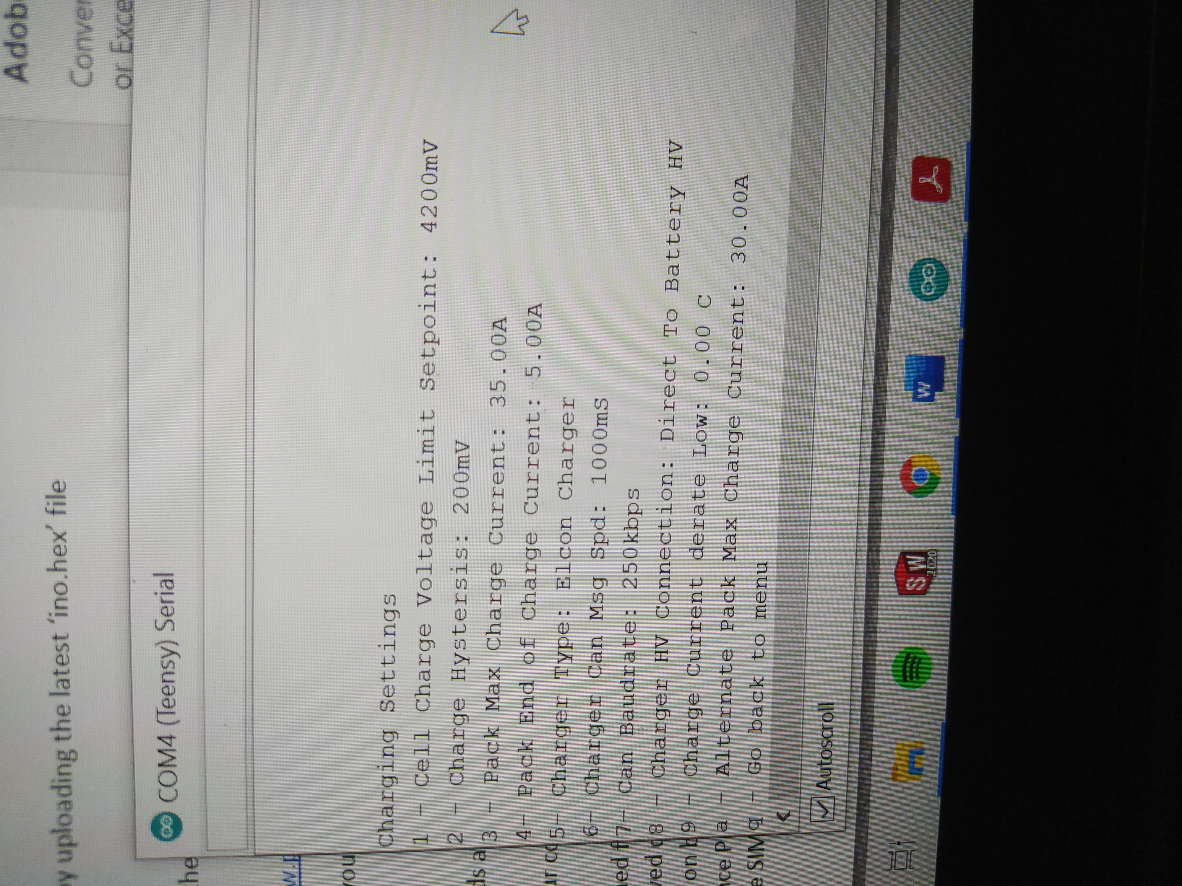

Post by Jackk »
Hi all. Having got my TCC charger communicating with my simp and all working for some reason it now fails to turn charger on... Nothing to my knowledge has changed from when it charged perfectly last time. Tesla cells are sitting at about 4v
For some reason if I put the simp in ESS mode the charger seems to boot up...any ideas really stuck!?
joromy
Posts: 371
Re: Simp BMS
Post by joromy »
I see your Charge Hysteresis is set to 200mV, and charge setpoint to 4200mV.
Then charging should not start, if cells are > 4000mV.
Could that be it?
Try setting Charge Hysteresis to 100mV
Jackk
Posts: 57
Joined: Thu Dec 17, 2020 6:29 pm
Re: Simp BMS
Post by Jackk »
Joromy you ledgend that sorted it. Panic over thanks very much!!!!

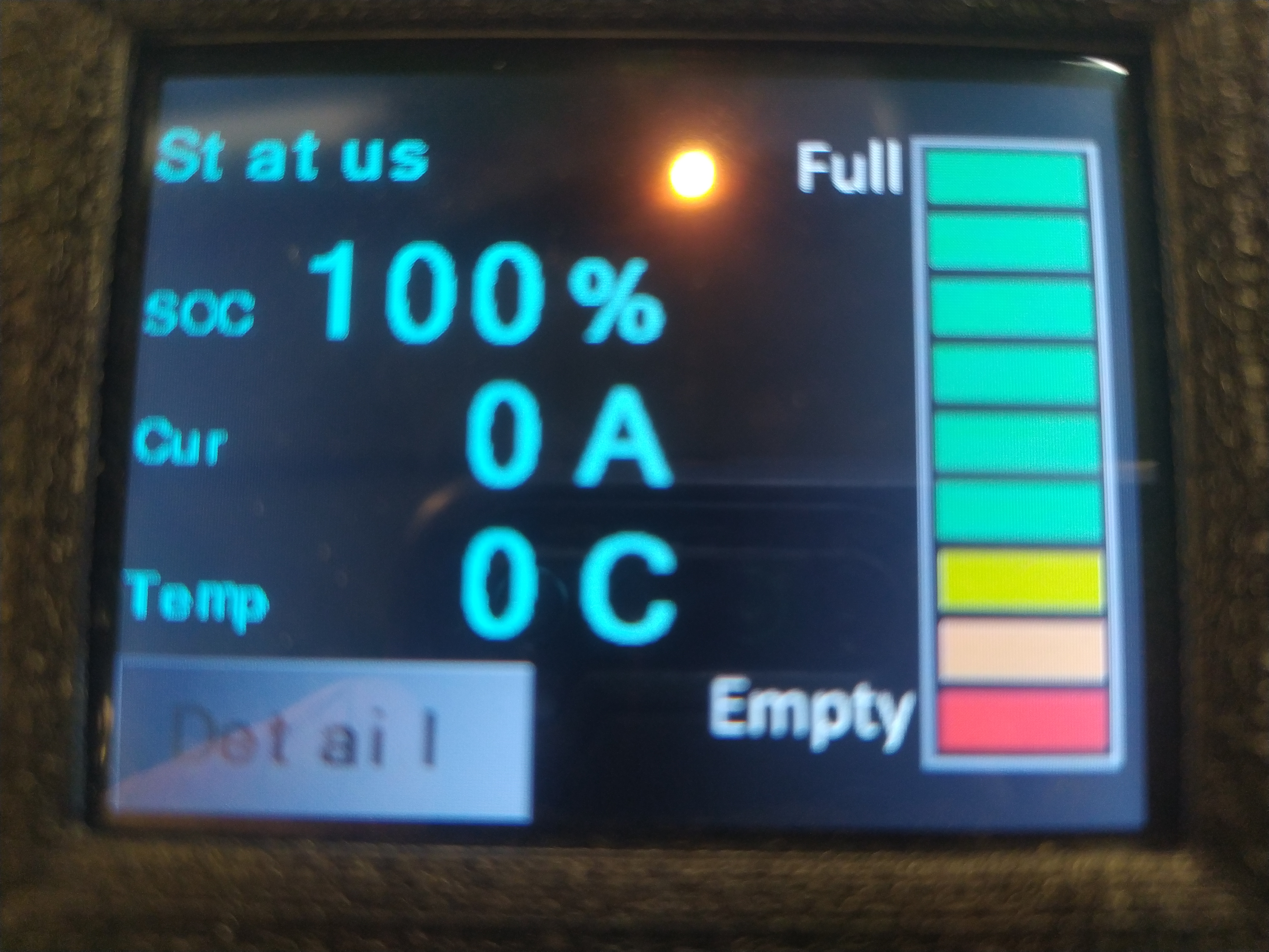

Now onto the next....

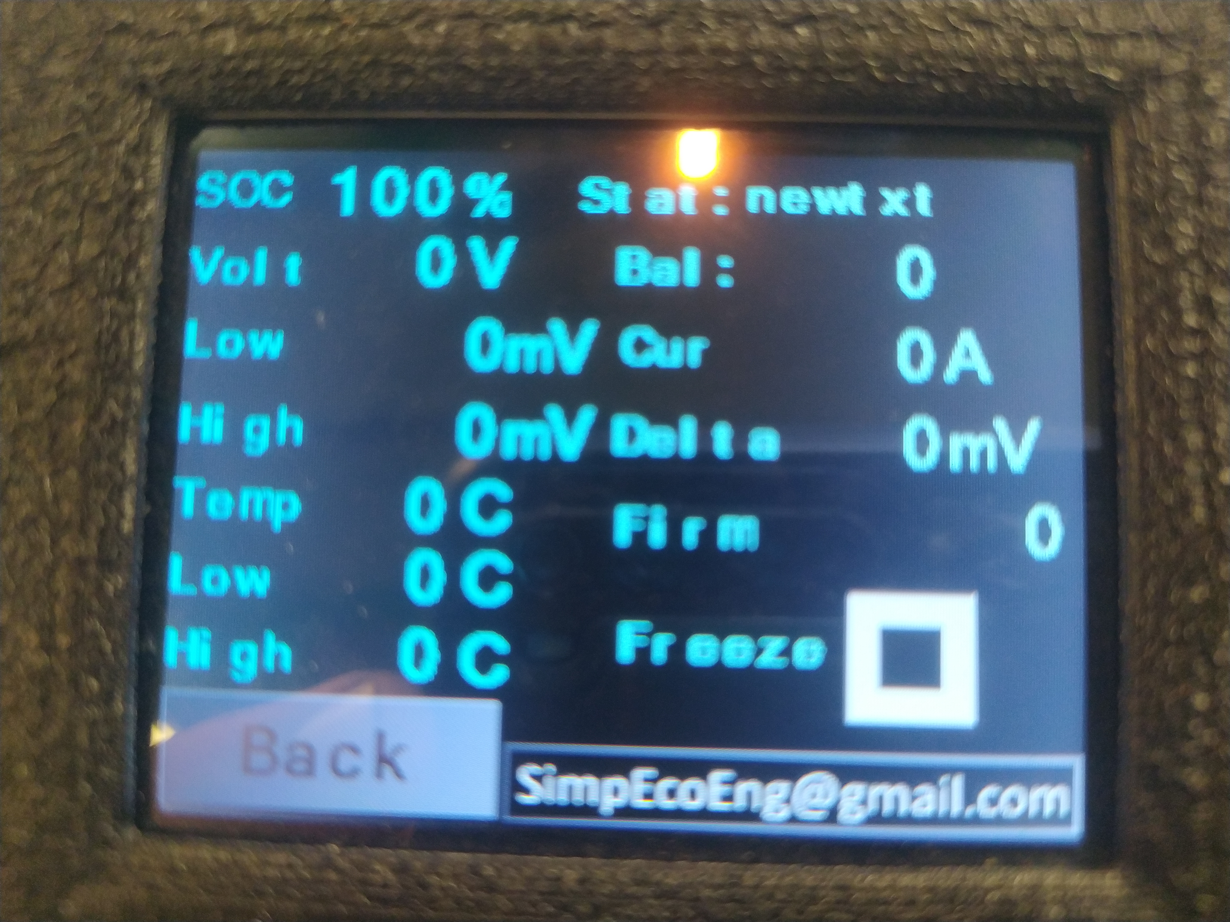

My nextion display is not recieving data from the simp...what steps should I take?
FJ3422
Posts: 122
Location: Netherlands
Has thanked: 13 times
Re: Simp BMS
Post by FJ3422 »
Have you already tried to swap the RX and TX wires to the display ?
Jackk
Posts: 57
Re: Simp BMS
Post by Jackk »
Thanks FJ342 !!! that worked a treat!

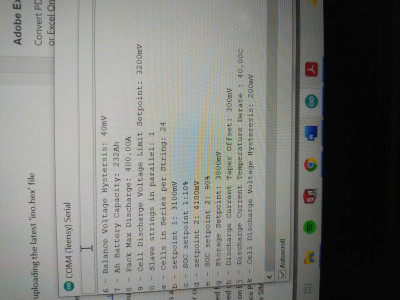

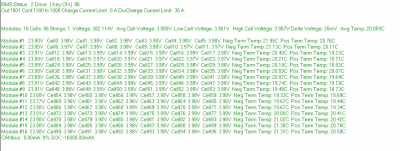

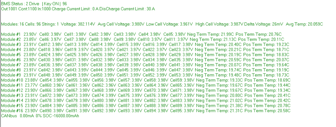

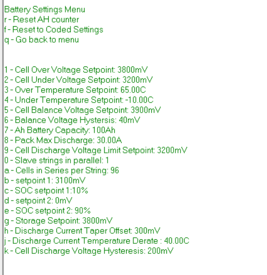

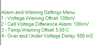

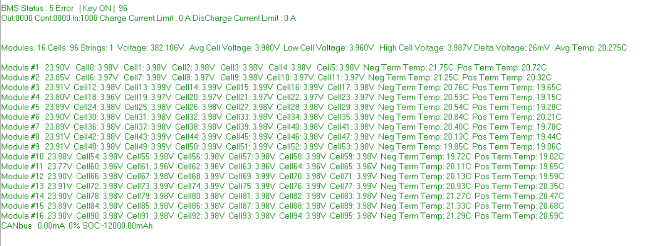

Hello everyone,
currently I try to set up SimpBMS with a Tesla battery. Everything works fine but I have troubles with the alarm settings…
Example:
Over voltage setpoint: 4100mV
Under voltage setpoint: 3200mV
When the minimal cell voltage goes under 3200mV the BMS goes into error state, but when the maximal cell voltage goes over 4100mV nothing happens. But when I do a restart in this situation, it tells an error until I change the over voltage setpoint. So it somehow does not recognize the over voltage alarm in running mode.
What can be wrong here?
Thanks and regards
Posts: 2962
Has thanked: 330 times
Been thanked: 847 times
Re: Simp BMS
mfuchs wrote: Thu Aug 05, 2021 3:50 pm What can be wrong here?
It should be working fine let me try and replicate.
Please share snap shots of your settings and debug.
I cannot replicate the issue at the moment.
mfuchs
Posts: 3
Joined: Thu Aug 05, 2021 2:30 pm
Re: Simp BMS
Post by mfuchs »
thanks for the reply.
Here is what I configured:
SimpBMS keeps running:
After I do a reeboot it goes into error state (which it should):

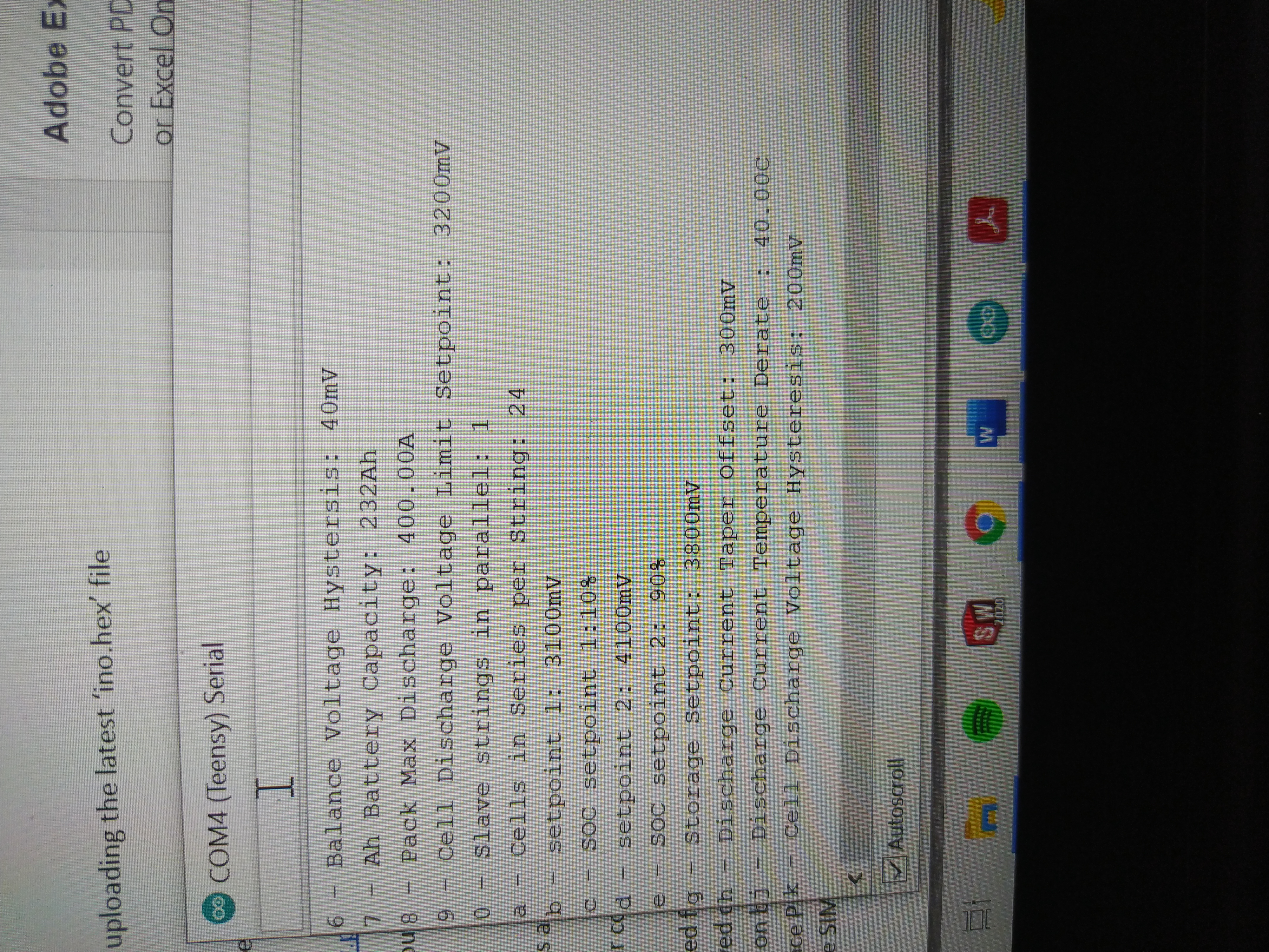

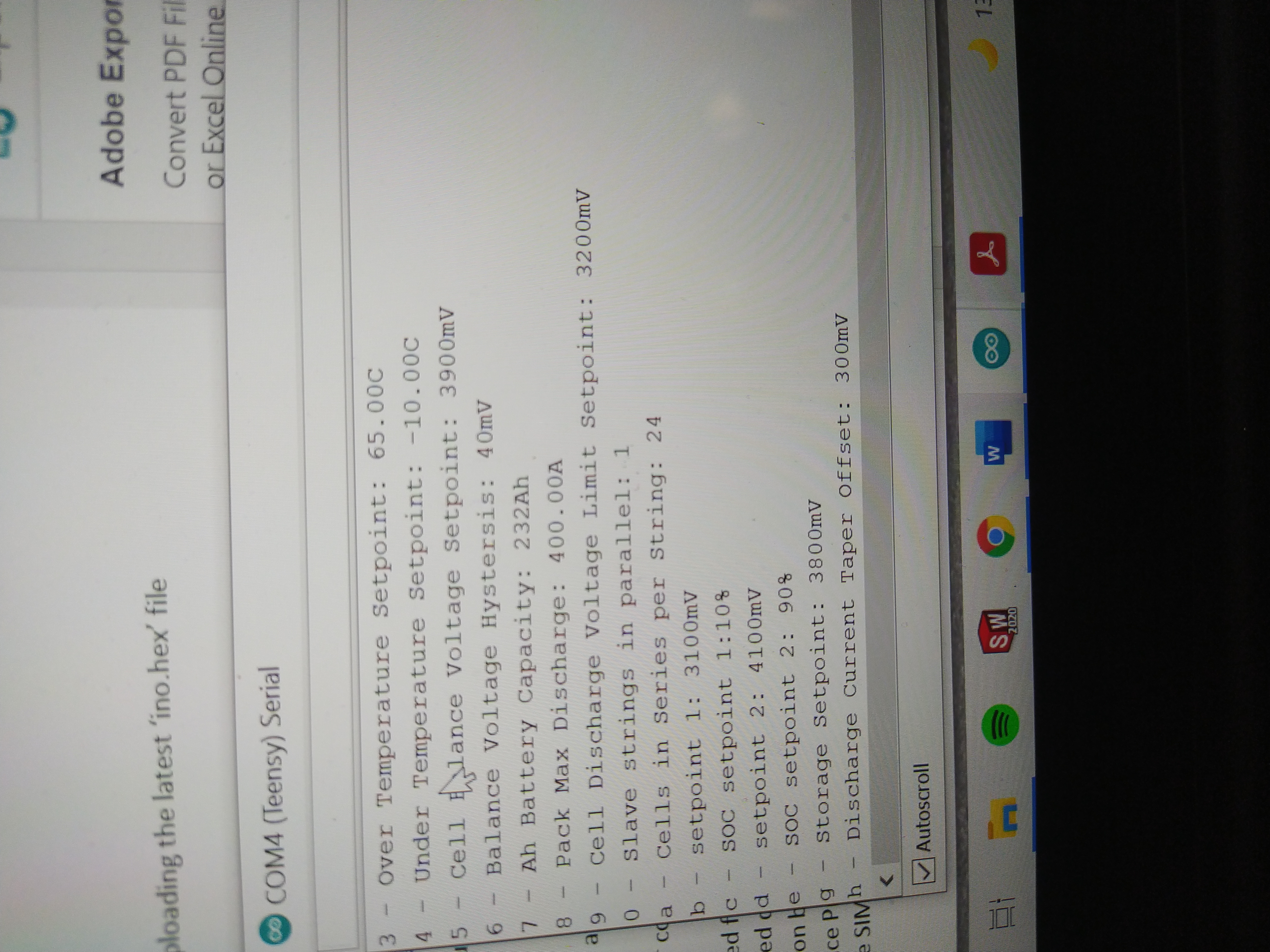

Re: Simp BMS
What is the firmware version? Mind updating it to the latest
mfuchs
Posts: 3
Re: Simp BMS
Post by mfuchs »
This is the installed version:
Firmware Version : 261020
