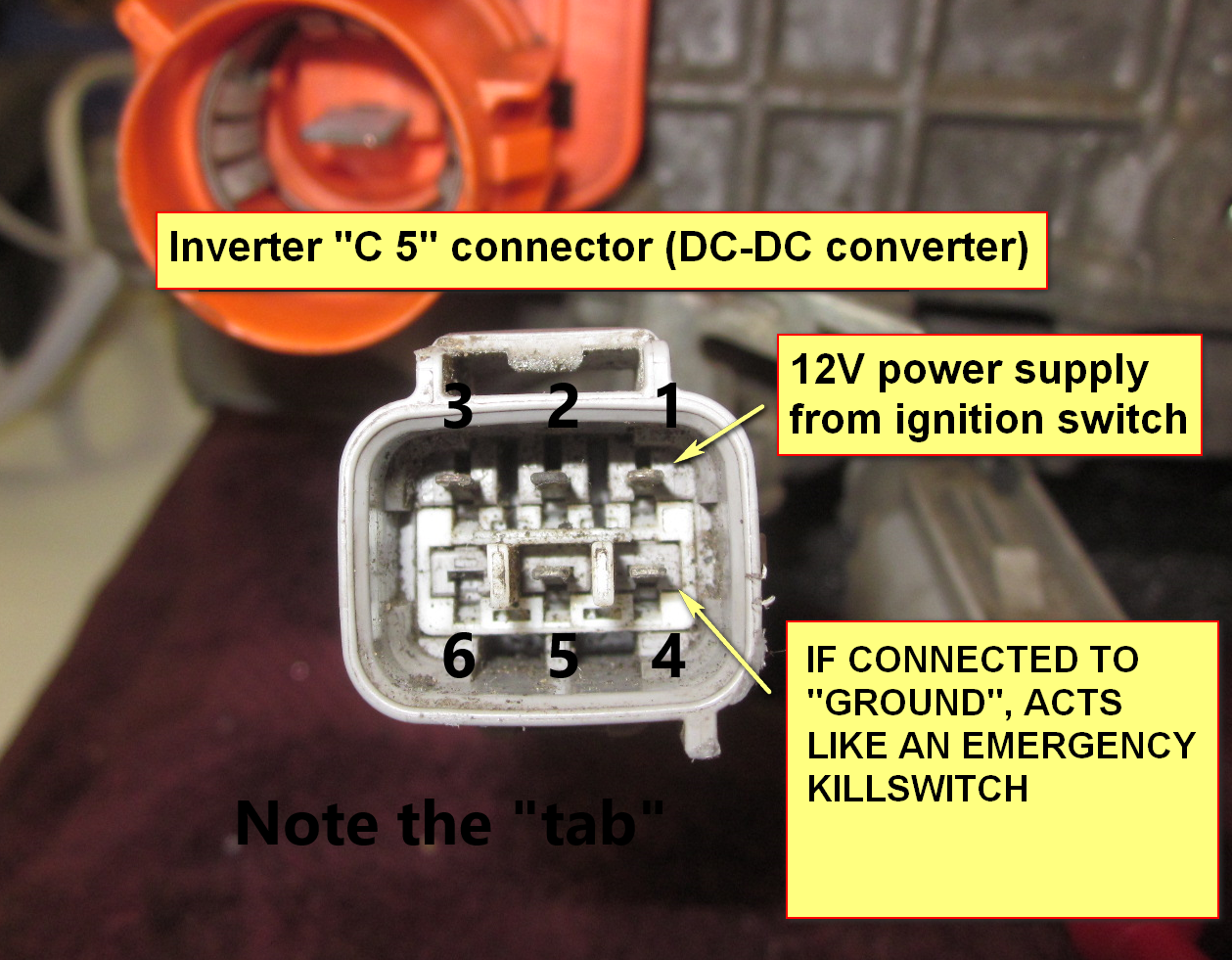

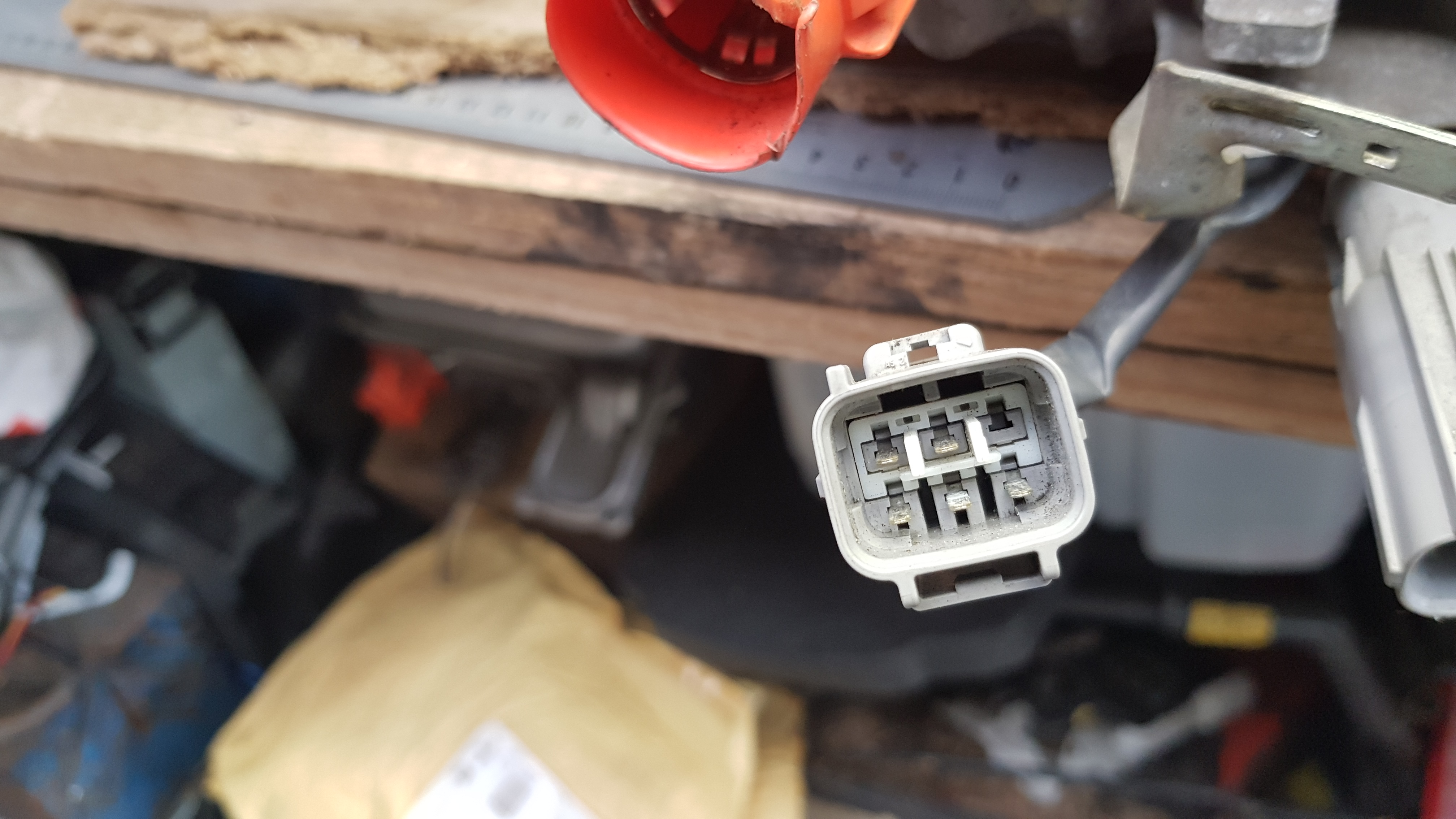

A quick revert back to Zookeeper's findings on the terminals on the C5 connector. I examined mine this afternoon and Pin 1 seems the best pin to start the DCDC converter. Unfortunately neither of my gen 2 inverters have a pin 1. By design they are missing. ??
Anyone else have this problem. The inverters I have would have been for the European market.
Stephen
Stephen

Stephen Darbey wrote: ↑Sun May 17, 2020 4:41 pm A quick revert back to Zookeeper's findings on the terminals on the C5 connector. I examined mine this afternoon and Pin 1 seems the best pin to start the DCDC converter. Unfortunately neither of my gen 2 inverters have a pin 1. By design they are missing. ??
Stephen

Re: Toyota Prius Gen 2 Inverter Controller
Hope that is all it is but will check and revert. I did not notice the blank on the wiki photo. I just pulled it all apart this afternoon.
Regards
Stephen
Regards
Stephen

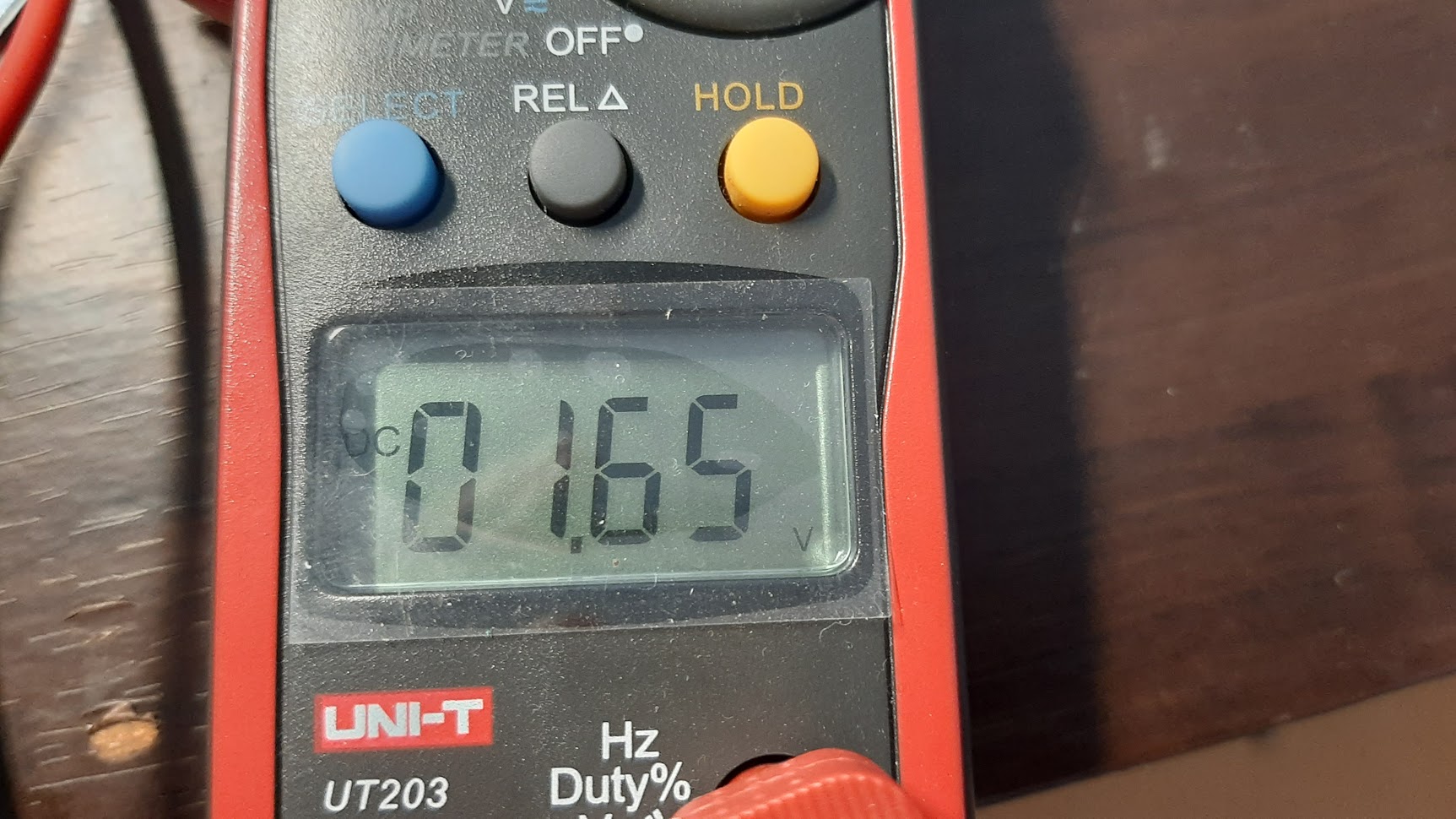

Hey Konstantin8818.
Top marks. I must remember to bring my laptop down to my Mums garage where I do all this ( top secret hideout/Man shed), then I can check all without having to publicise a blunder.
I went back this evening after work and performed some of the tests I did yesterday but still did not have the results of Zookeeper. I get a highly fluctuating voltage on the DC/DC output and High voltage. I suspect my voltage may not be high enough or even strong enough.
Regards
stephen
Regards
stephen

As Zookeeper tested, you have to provide atleast 100 volts DC to BUS line for dc-dc to operate correctly. I haven't performed any tests on my inverter yet. Still need some basic circuits to make before testing.Stephen Darbey wrote: ↑Mon May 18, 2020 7:00 pm I suspect my voltage may not be high enough or even strong enough.

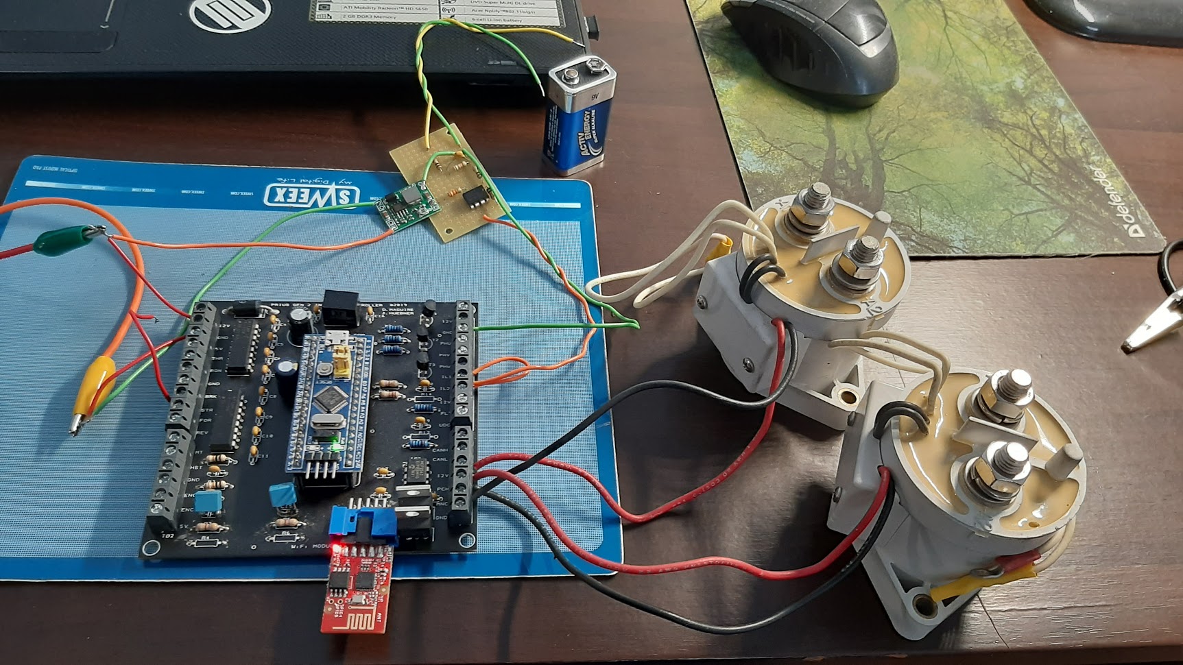

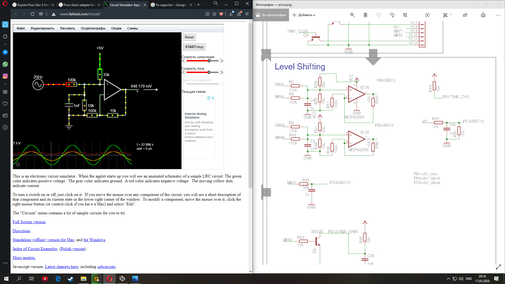

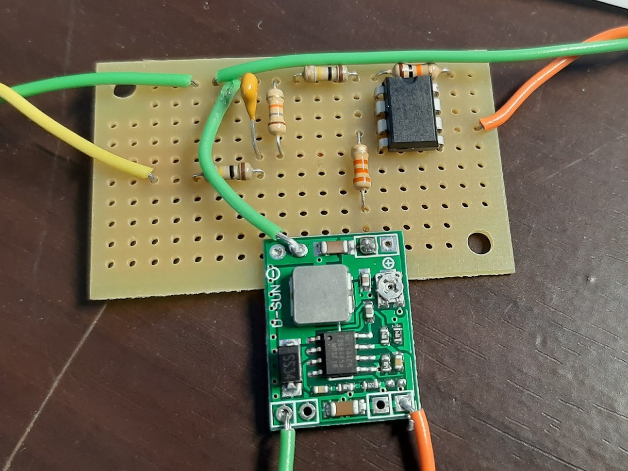

To make logic board happy about phases currents instead of using OP amp schemes people suggested, I've stole circuit from johu's gen 2 board, because it is simplier
I've tested it on circuit emulator After an hour of soldering misery this thing was born: And if nothing is attached to its inverting input, and little dc-dc stepdown board provides 5.5V, this is what we see at output: And the board is happy. Now after I've set all the parameters, but the board is not connected to anything yet, it is not happy about precharge. Are errors marked as [WARN] don't stop the inverter from operating?

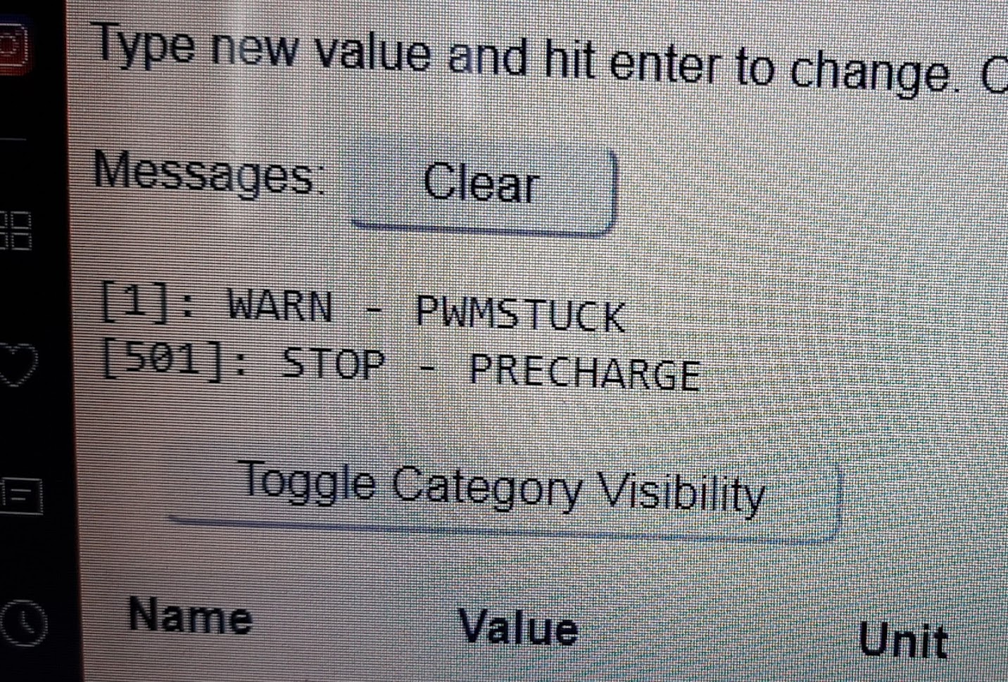

Correct.konstantin8818 wrote: ↑Sun May 24, 2020 2:22 pm Are errors marked as [WARN] don't stop the inverter from operating?
Adjust your udcsw parameter to get rid of the precharge error - see what udc is reading at and then set udcsw below that. I'm doing the same right now since I messed up my voltage sensor and I can't wait to run my motor

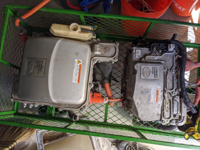

Lastly, is there a "feature" list of what the Gen 2 and Gen 3 inverters have as a comparison between the two? The wiki has plenty of Gen 3 info, but not much on Gen 2.
I would certainly like to go Gen 3, but a Gen 2 might be sitting down the street for me to get. Thanks again!
Looking at webshop, I see my confusion, the difference between "Blue Pill" and "Blue Pill-based". The board is pretty cheap (30 euro!), but does have some SMD soldering work. I need to price the components to compare costs.
(let me know if I should be starting a thread on this)

That's a brilliant summary of the current situation.MattsAwesomeStuff wrote: ↑Fri Jun 12, 2020 5:32 pmDamien has skipped around to follow what hardware he has around and what things people are helping him with.TheSilverBuick wrote: ↑Fri Jun 12, 2020 12:47 amI do not see these boards available on the evbmw webstore, are they still available for purchase? My local junkyard has a Gen 2 Prius in it and prices the inverters at $50... so contemplating seeing if the inverter is still in the car and getting it.
I think he first had a Gen 3 and made those first boards. Those were challenging because there's lots of SMT stuff and the boards were pretty expensive to order with components placed. So you could pay a lot of money and get the boards pre-placed with SMT, or you could pay less but then have to do them all yourself.
Then Damien designed the Gen 2 to be entirely through-hole parts to be friendlier (and cheaper) to beginners, which involved searching for an STM32 that was already mounted to a board that could be through-hole. That turned out to be the "Blue Pill". So, his boards for that are what came out of that project. The current sensing connections on it are not good to go as-is, they need a few extra components. Also, lots of Blue Pills apparently use counterfeit STM32s, in a way that does actually matter for this project. So, some people have found that it simply won't work.
Then another community member was putting effort into the Gen 3, so the next round of boards Damien worked on was the Gen 3 again. This time from a new PCB source that has far more affordable component pricing if you use their inventory. So Damien redesigned the whole board to use their components instead. Also combined with new knowledge about the Gen 3 so other stuff is enabled.
Scrapping the through-hole requirement (because the new PCB source is so cost effective for placed components), Damien was going to redesign the Gen 2 board too, it's on his eventual to-do list. But that hasn't happened yet.
Alternatively, Johannes has in the meantime designed a bespoke Open Inverter board kit for use on the Gen 2, it has its own thread. This is a costlier option, but on a proven platform and will have everything you need kit-wise. I believe he's received the boards and one has arrived for Damien to test with when his manifesto of EV scrolls far enough for him to find time for it.
So there's certainly options.
Today: Blue Pill-based through-hole, probably will work for you.
Soon: Open Inverter's kit.
Eventually: Damien's redesigned Gen 2 boards pre-placed.

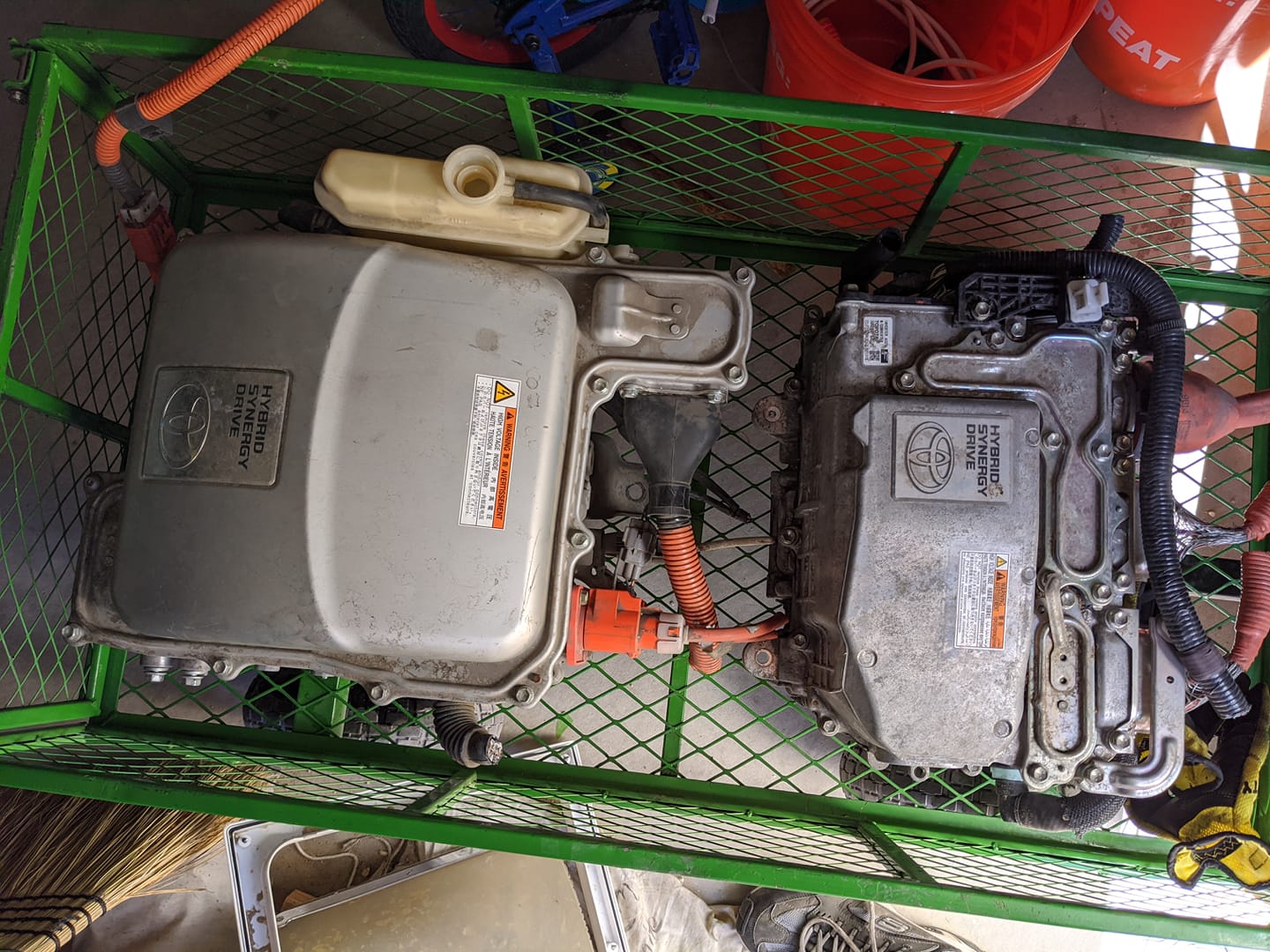

I bet you're confused between Gen 2 and Gen 3. I see only this one for Gen 2: https://evbmw.com/index.php/evbmw-websh ... ogic-boardTheSilverBuick wrote: ↑Fri Jun 12, 2020 6:03 pmLooking at webshop, I see my confusion, the difference between "Blue Pill" and "Blue Pill-based".
It has no SMD work. That's the point of it. You're probably looking at the wrong board.The board is pretty cheap (30 euro!), but does have some SMD soldering work.
Does this help?: http://www.digikey.ca/short/zpfj75 (it has an "error" because of a component update, just click "submit")I need to price the components to compare costs.
I ordered extra of some things in there, you could trim it a bit. It cost me $70 CAD at the time ($50 US or so, I think, or maybe it was $70US, can't remember).
You'll also need to purchase a Blue Pill from a reputable source. And an "ST-Link" (eBay, everywhere). And a wifi module (from Damien, Open Inverter, or buy a "Wemos D1 Mini" like some of us have done). The wifi module from Damien or Open Inverter is less capable and more expensive, but plugs right into the board. The D1 you'll have to wire up yourself (just 4 wires, not a big deal).
That's because it was mostly me doing the wiki on the Gen 2, and I've had it sit on a shelf for 4 months :pLastly, is there a "feature" list of what the Gen 2 and Gen 3 inverters have as a comparison between the two? The wiki has plenty of Gen 3 info, but not much on Gen 2.
Power-wise the Gen3 is capable of more (680hp between MG1 and MG2), but, I dunno if that'll actually be a limit for you.
Damien's latest Gen 3 board has working current sensors and I think is ready to go for using the boost converter as a charger. I don't know if the Blue Pill can do that, but I don't understand the difference in hardware much.
I think the Gen 3 can also dual-drive the inverters? I'm fuzzy on the details, you probably shouldn't use me as a source.
Gen 3's have a more common flaw where they die. So do check yours soon enough to get your money back if it's fried. Gen 2s are generally cheaper but, the deals some people here are getting... hardly makes a difference. I paid $150 for my Gen 2 I think. Gen 3s were thought to be around double that at the time. But people are picking them up for under a hundred if they ask a local scrapper.I would certainly like to go Gen 3, but a Gen 2 might be sitting down the street for me to get. Thanks again!

Hot Dang! Sure enough! Thanks again. With the hall sensors I need to purchase it'll kick the total up enough to get free shipping.MattsAwesomeStuff wrote: ↑Tue Jun 16, 2020 4:05 amNo, I mentioned that. There's an error with those and that's why it comes up with that.TheSilverBuick wrote: ↑Mon Jun 15, 2020 8:39 pmYour digikey link just gets me 20 resistors after the website processes.
Just click the "submit" button to clear the error, and then it takes you to the full shopping list.
Noted!Jack Bauer wrote: ↑Tue Jun 16, 2020 7:21 am My advice to people on this thread is use this :
https://openinverter.org/shop/index.php ... duct_id=63
Just picked these up today for $55 each. Just looking to run a ~55kw MGR down around 15-20kw.
