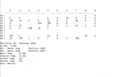

dc_bus_voltage not reporting
I've been trying to track down an issue with my setup and I'm getting nowhere. I'm having trouble with my inverter whereby the bus voltage is not being reported.
This issue started yesterday after rearranging my setup which involved plugging everything out and back in again.
Software: Version 7, very lightly modified. Previously working fine, so not a software issue.
Symptoms:
When I apply power (~ 25 v), through my precharge circuit (previously working), the main contactor will not open, and the dc_bus_voltage remains negative in the serial monitor output.
The voltage across the inverter inputs is around 1.3V
The voltage used to be reported (yesterday morning), but is no longer reported, so something has happened. I just don't know what!
When I 'force' close the main contactor by setting the precharge limit to -10 (yes, bad idea but i'm using low voltage), the inverter now works (The motor runs when pressing the accelerator) but the dc_bus_voltage remains negative. The voltage across the terminals is now ~ 25V
My guess is that there's some sort of loose or missing connection causing the voltage to not be reported, but I'm stumped as to which one it could be.
Attached is a screenshot of the mth_data, which is mostly reporting sensible data, and ad mentioned the motors spin fine once the main contactor is closed.
Does anyone have any idea as to which connector / connection I should be looking at, or have any other explanation of why this could be happening?
Thanks in advance,
Steve

Interesting problem. I do not why it happening but I have somewhat similar problem. When I power up my inverter it reports correct "DC Bus" voltage initially, until I spin motors up to around 3000 RPM then reported DC Bus voltage drops to around +100V (my battery pack is 360V) also "Another Temp 2" reports incorrect value at the same time. Otherwise I see no other side effects. It is annoying though. When I power cycle system I get correct values again until I reach "critical" RPM LOL.

You can always connect a 12V car battery or similar directly to the inverter inputs and see if it's reported correctly. The motors will spin at 12V as well (though not very fast).
Don't worry so much about the -2V, IIRC I added an offset to my code for my particular inverter, it may be different for different models. It might in your case be better to put a known voltage in and have a play until it lines up.
Also, if you set your mth_mask to all 1's, you can see the full data packet. The mask which I applied as shown in your screenshot was used to hide the "known" data to help me narrow down the purpose of the unidentified bytes.
Those two "another temp" were ones which I didn't find the source for. As far as I know, the unit has the following sensors:

Thanks for the replies guys.
By way of an update, I have resolved some of my issues:
1: The lack of voltage looks to have originally been caused by an intermittent short in my HV setup. I haven't identified the exact location of that short though which is somewhat concerning, and something I'll continue to look into. The behaviour came and went as I plugged and un-plugged the 3-phase cables. Curious.
For now at least here is a circuit being completed, which is allowing precharge to work.
2: The inverter is still reporting the HV bus voltage is still reporting as -2. Using a second inverter, I tested my setup and it reports the voltage correctly. So It's definitely an issue with this inverter, and not my setup. Taking @artuk's idea, I'm now using the ISA shunt to read the voltage. Precharge now works, and I can see accurate voltage being reported by the shunt.
So my setup is working as before (except now I have reverse courtesy of the zeroev gear selector!), but with a few nagging issues, namely the cause of the HV short, and the lack of HV being reported by the inverter. My guess is that the short killed whatever it is that reads the HV.
Let's call this case closed, but I guess it's something to be aware of that at least 2 of us now have the issue of the inverter not reporting the HV bus voltage, and having to rely on the shunt for this.
Thanks again!

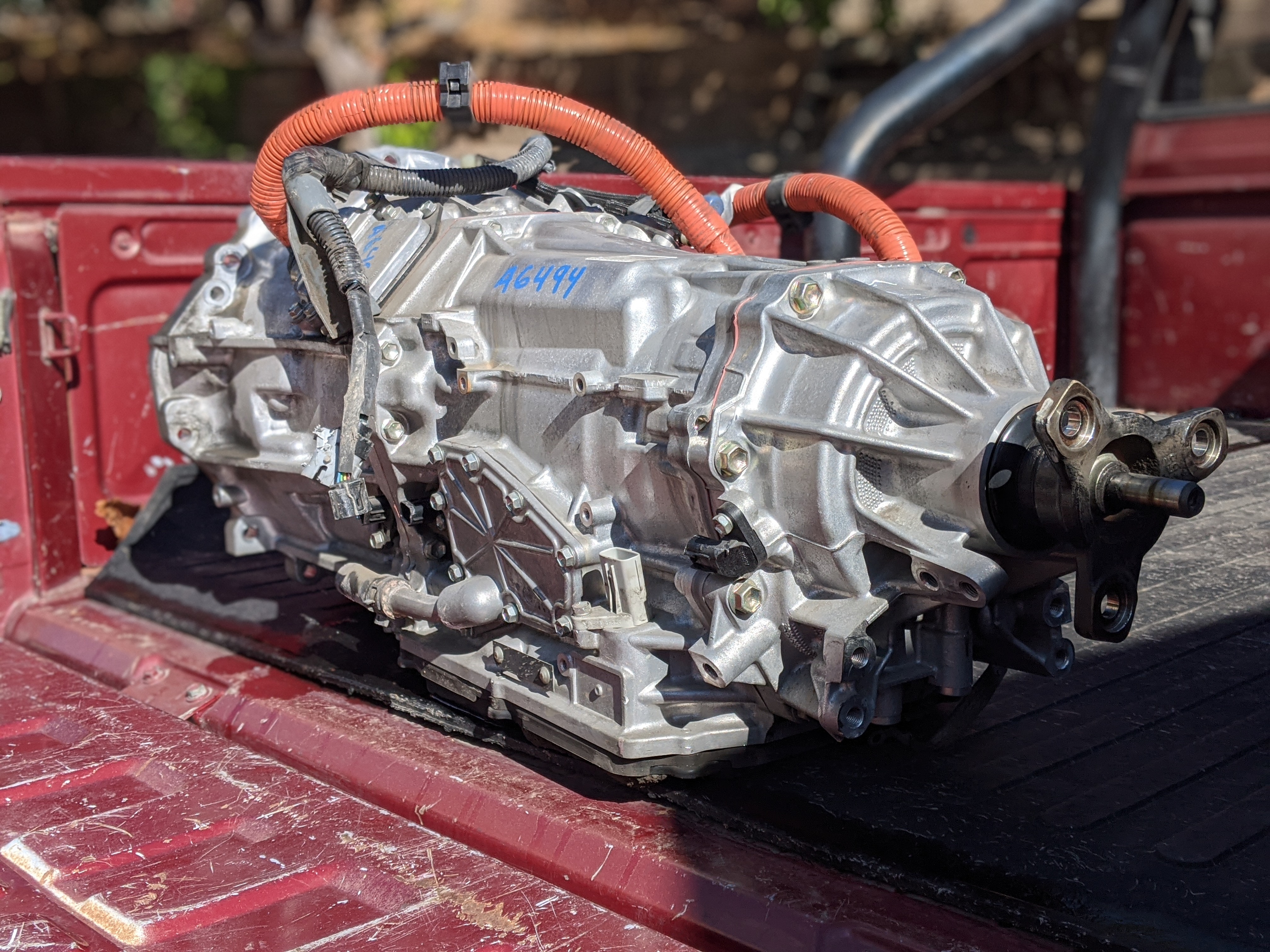

Also, I just bought my 450h transmission today
. I am really excited to embark on this journey, and hopefully it comes out well.

bobbyj_408 wrote: ↑Sun Nov 08, 2020 4:08 am Also, I just bought my 450h transmission today. I am really excited to embark on this journey, and hopefully it comes out well.
Bobby, I have a feeling it is going to be very exciting one
Please consider starting build thread and good luck!

The transmission is from a 2007, and I got it for $500. I think I got a good dealGigas wrote: ↑Mon Nov 09, 2020 6:31 pmLooks nice - what year and how much if you don't mind me askingbobbyj_408 wrote: ↑Sun Nov 08, 2020 4:08 am Oh wow! Sorry, I didn't put 2 and 2 together. I have seen your videos and am really excited about your Jaguar build! Please keep those videos coming.
