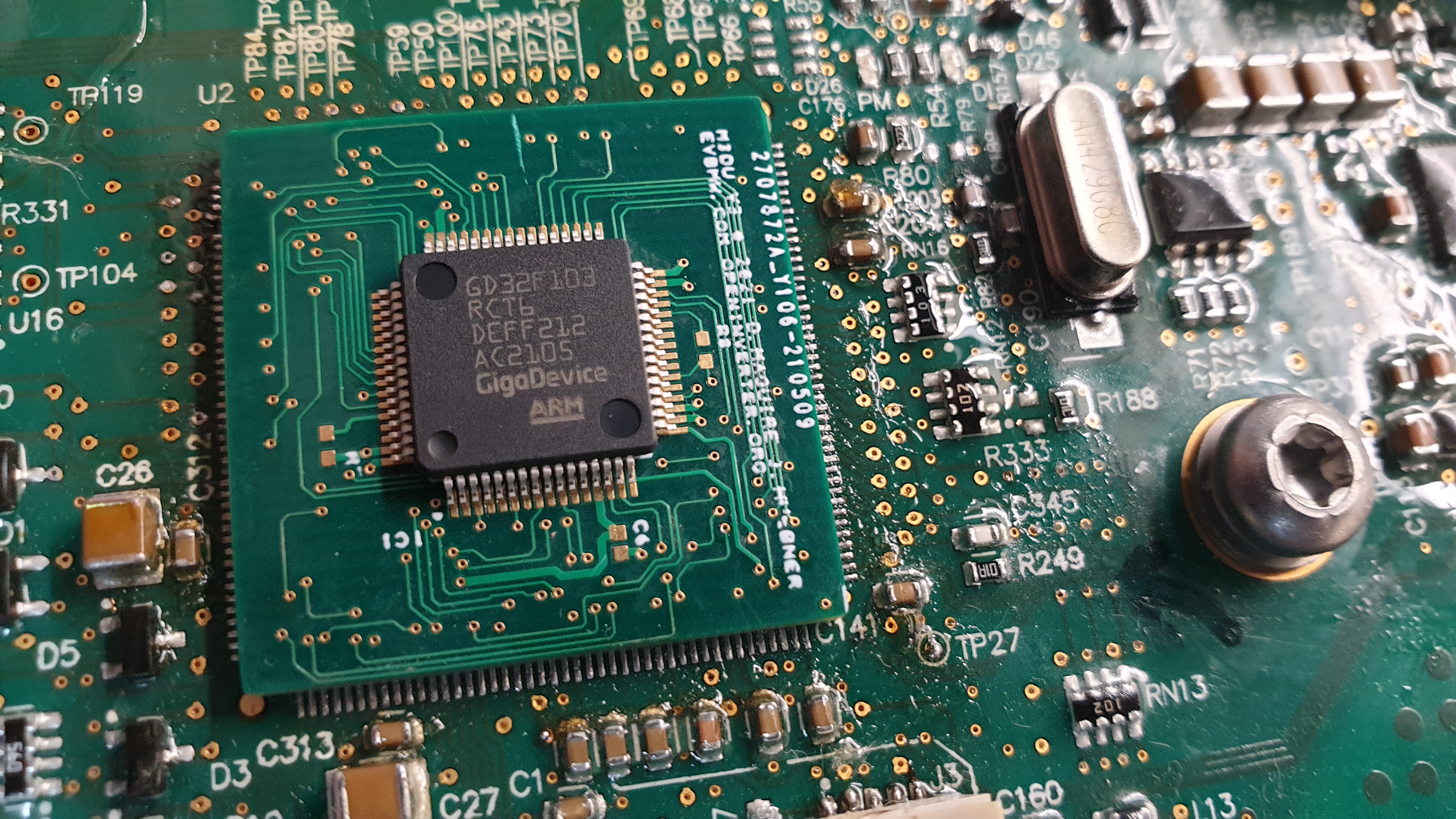

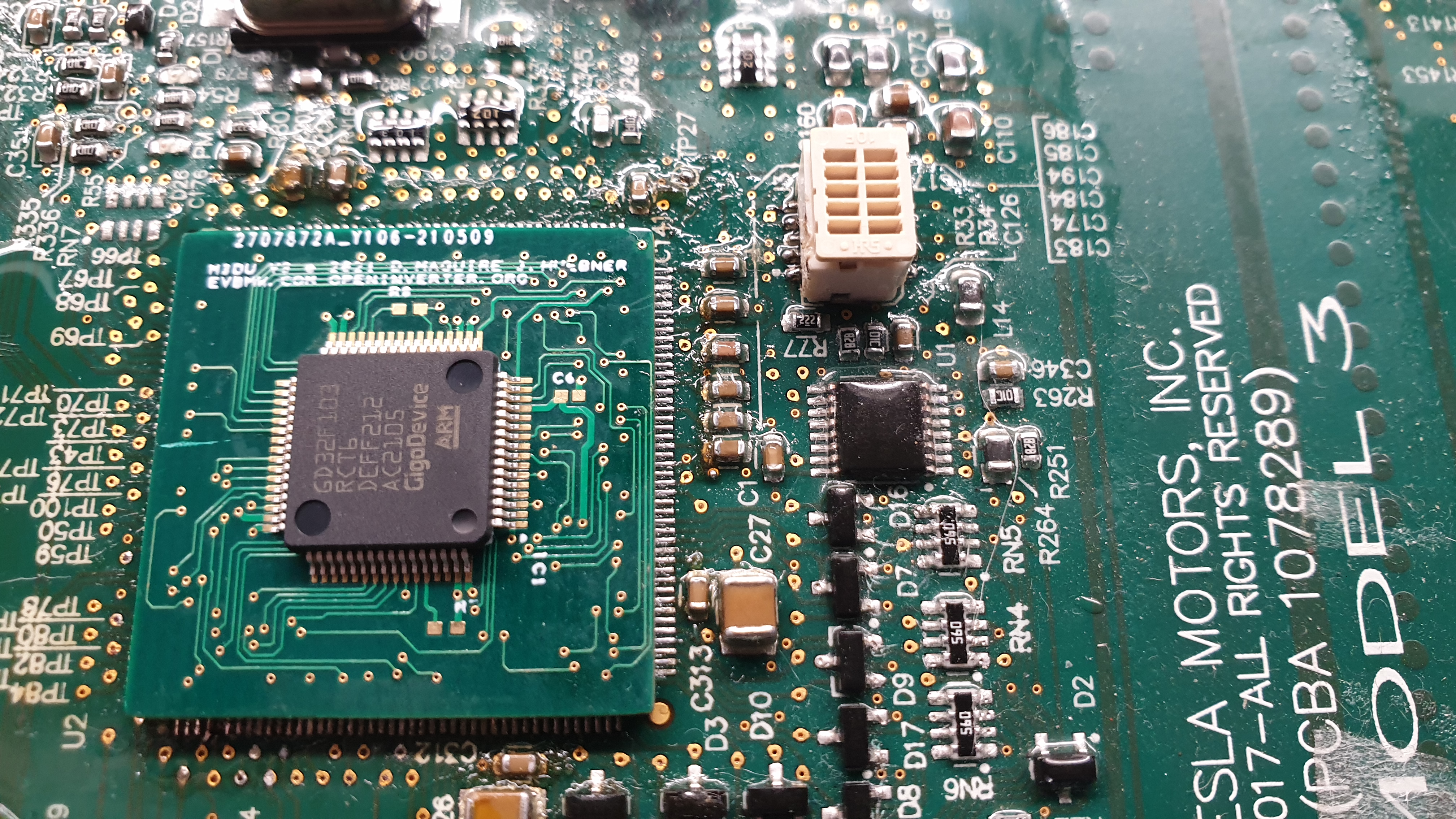

In other news the ...uh...High density devices have arrived. Just don't tell the Muskians that its actually a Gigadevice part.
- Posts: 6746
- Has thanked: 380 times
- Been thanked: 1570 times
108 MHz, wow
So you could just connect it to the 10 MHz crystal and it will happily run at 90 MHz. Just the LED will blink a bit too fast

Exciting, next the black box in the middle?
That really reminds me of some old Athlon/duron processors.

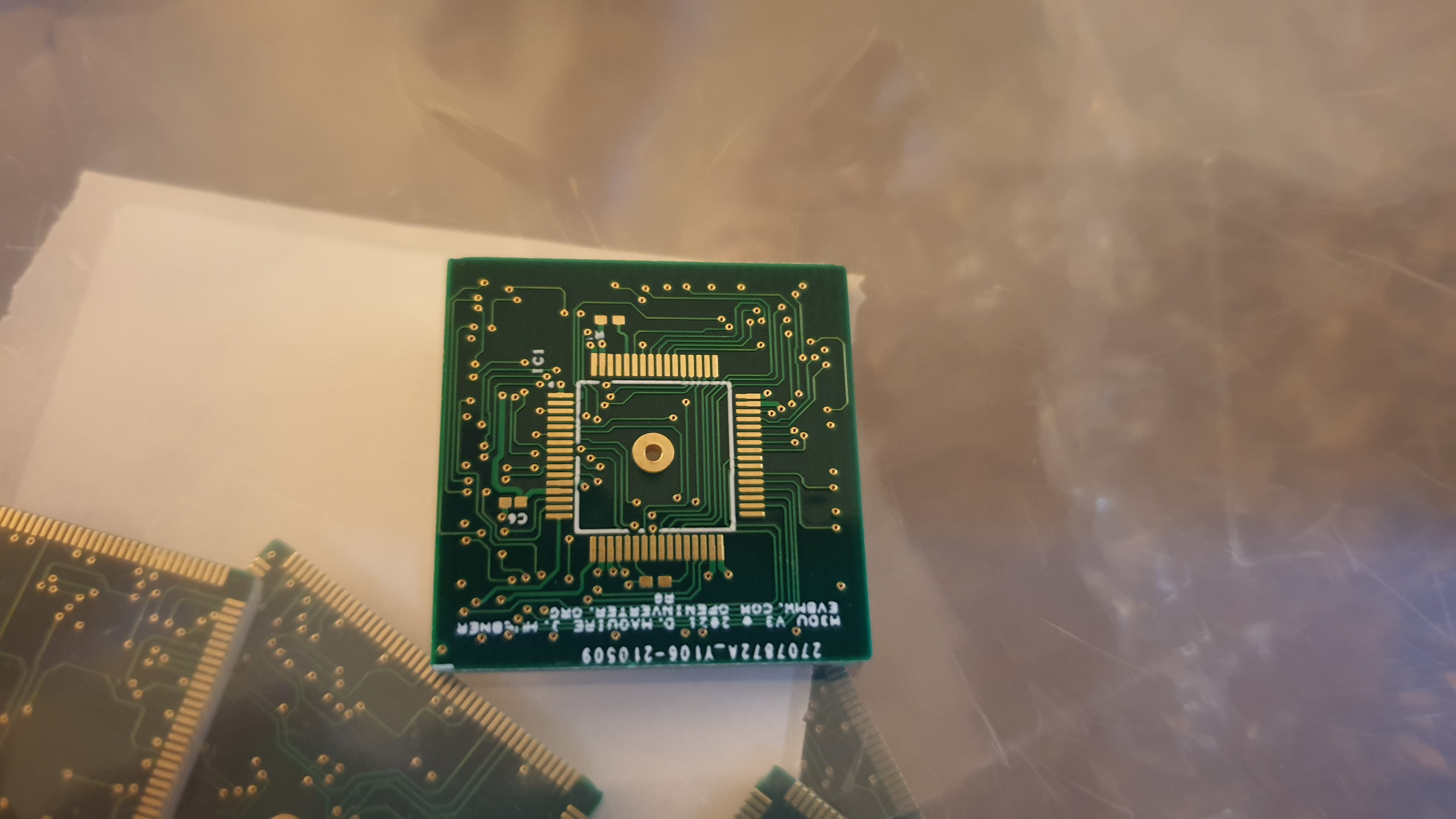

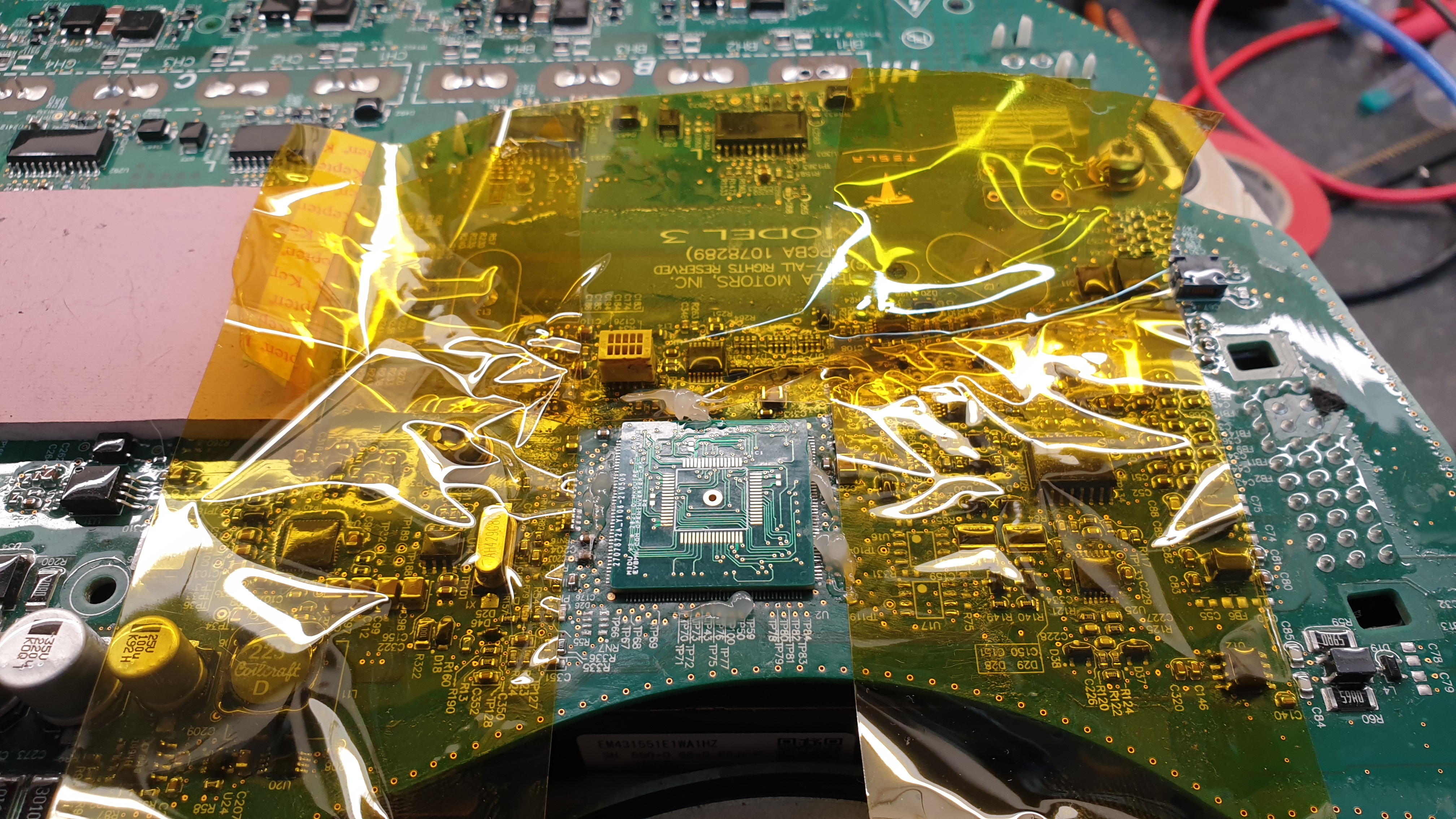

And its in. Quite anticlimactic in the end. Power rails, xtal and a few random tests show no shorts or non connections so far. Now to fit the BEAST of an mcu that this drive unit deserves:)
- Posts: 294
- Has thanked: 78 times
- Been thanked: 96 times
Exciting times. Hope it all goes smoothly. Looks like you've gone for a regular FR4 based PCB this time rather than the flat flex. Is this because you don't need the castellated edges? Do you need to do anything on the underside to stop vias shorting against the ground pad for the TI chip?

Just experimenting with the fr4 really. its a lot cheaper than the polymide so at least will let me find the mistakes:)
