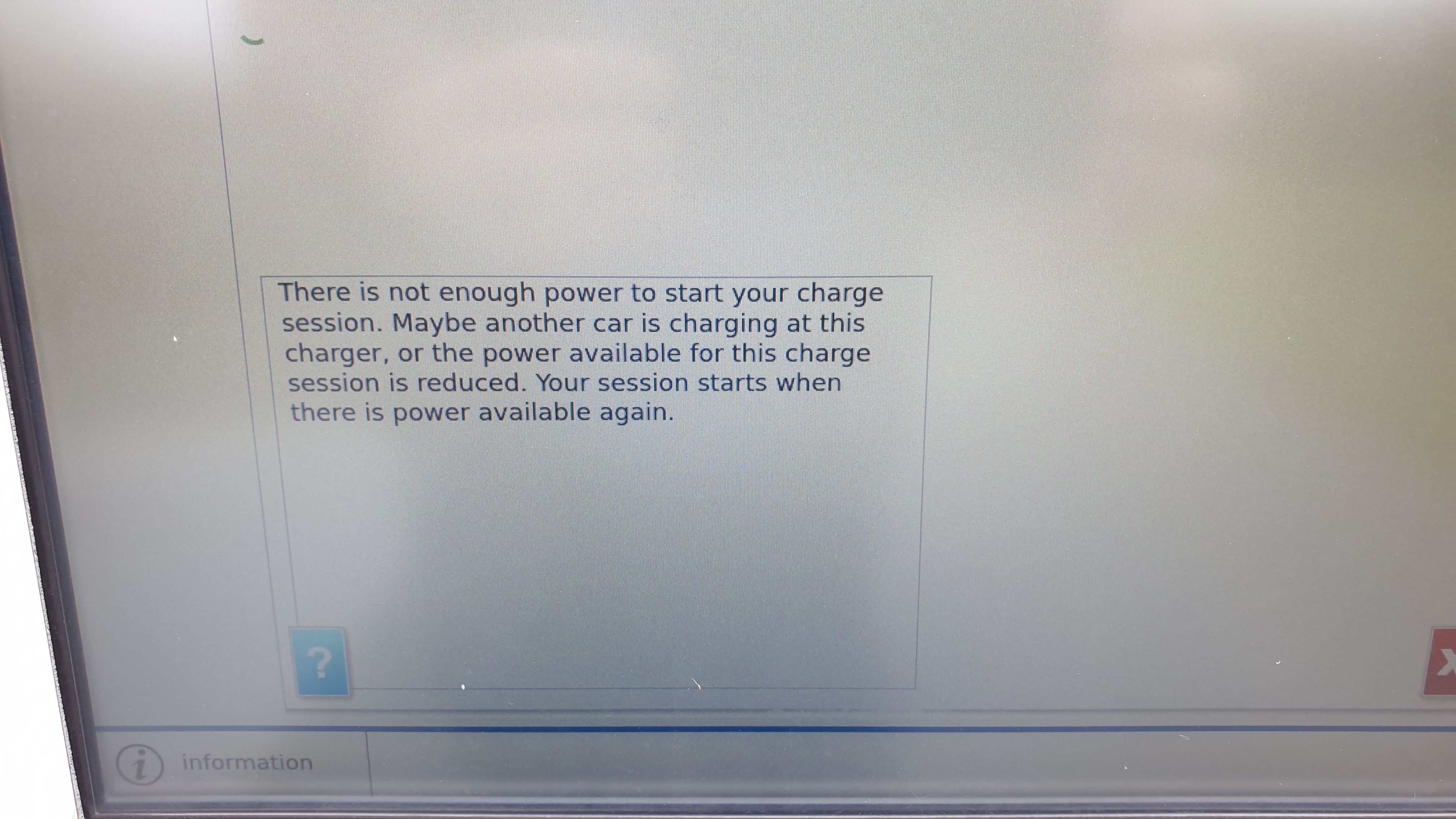

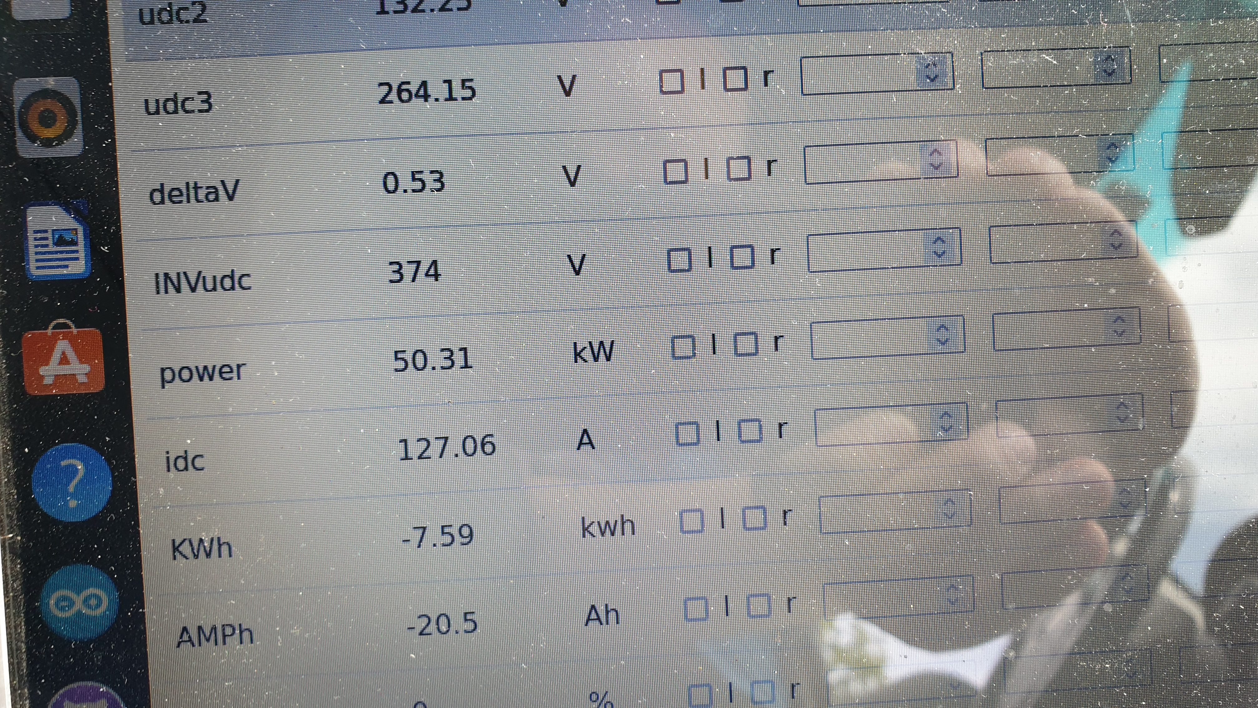

Funny thing is these Circontrol stations state a min current of 0 and a min voltage of 0. Abb/Ionity say min 50v and 10a. They just ignore anything under 10amps. Likewise the Efcaec say min 50v and min 5a and ignore anything under 5amps. I don't for a minute believe those min volts figures but the currents should be accurate....famous last words I suppose.
Found a way to get 50kw out of the Efcaec QC45 though. Seems real cars ignore the value based limits and bounce of the Ilim and Plim flags!
Ionity don't like me anymore. For some reason I can't get past this "charging will commence when power is available" crap so its probably not liking something I'm transmitting that the others ignore. This is where some CAN LOGS would come in real handy folks but I'm done asking at this point. Big thanks to all the folks who have helped out. No way would it be nearly as advanced without you.

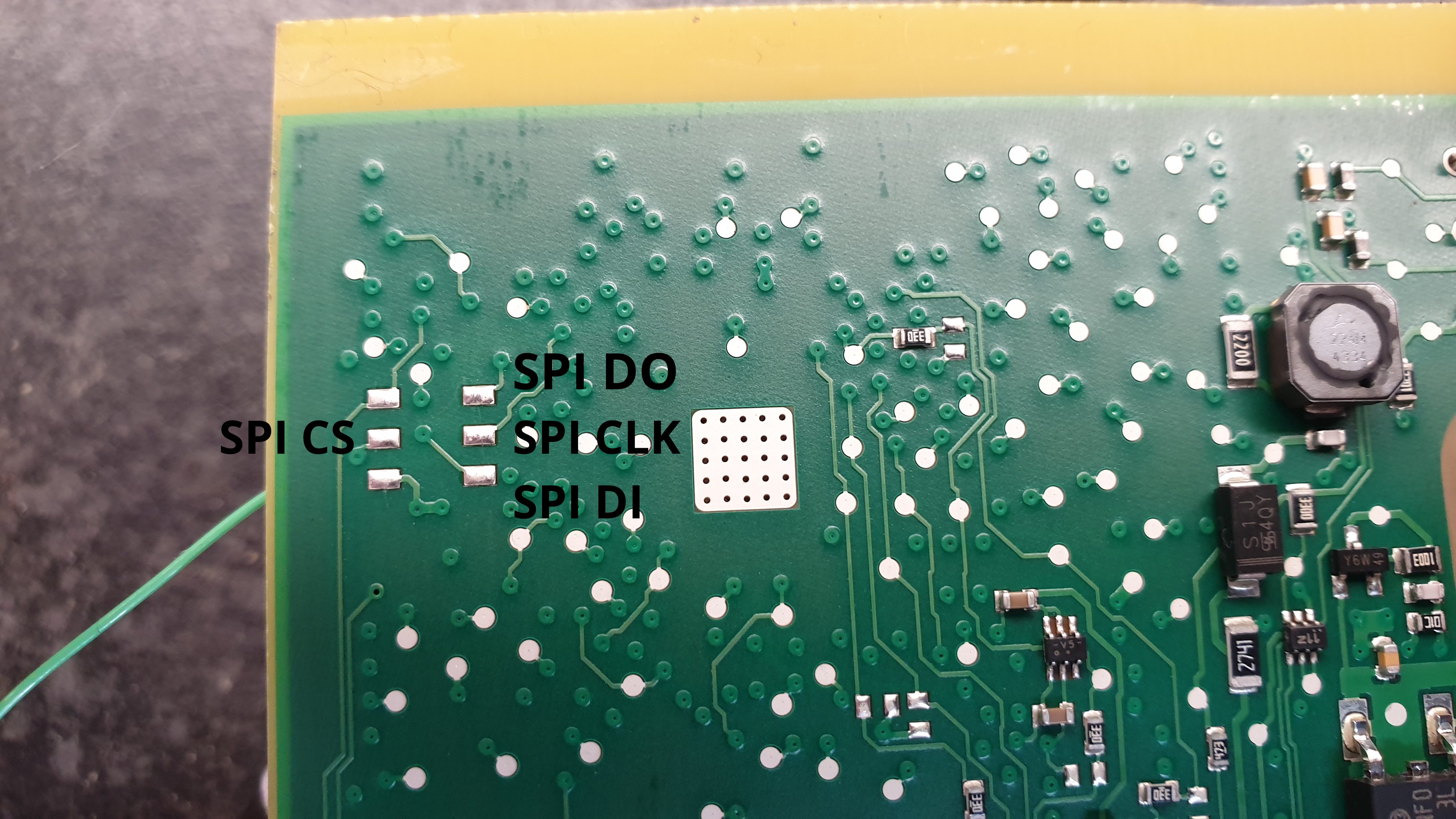

To get wireshark captures, from which I can decode the protocol and see what you are saying, I see two relatively inexpensive options:
1) Sniff the SPI of the Qualcomm chip off of one of the LIMs, and take up davefiddes' offer to convert it to pcap. I believe the Qualcomm chip converts ethernet frames send via SPI to homeplug green phy. I can decode the pcap and see what's going on.
2) Follow this article and purchase one of these dLAN Green PHY evaluation boards (https://www.codico.com/en/dlan-green-ph ... oard-eu-ii) and tap the pilot wire on your side. You'll need an ethernet adapter that supports promiscuous mode, and run wireshark on that interface to get pcaps. The team who wrote the paper do offer a decoder but I haven't used it and I wouldn't need it for me to analyze.

The spi seems like the best option for me. I'll do some investigation on my spare lim and see if I can find the bus. The ideal thing of course would be to get an i3 for a few hours and drive to all these points and can log how the car deals with them. No one seems to want to do that and I've exhausted all avenues available to me.

That QCA7000 HomePlug paperweight/module you got from AliExpress the other week should make it a bit easier to find the SPI pins I would have thought. Assuming it's the same package as the LIM anyway...
Getting a long enough SPI capture will require some thought. The Saleae Logic software is only good for 24 second captures which seems tricky when juggling the CCS charger start process. Sigrok and the PulseView GUI offer huge multi-gigasample captures provided your laptop disk is up to it with the Saleae Logic probe. Details: https://sigrok.org/wiki/Main_Page or install from your Linux distro.
Offer still stands of building an SPI to PCAP converter. Don't know how long it will take. A few days at least. The QCA7000 doesn't seem too obtuse a chip to decode based on the Linux driver.

I guess the ball is in my court then:) Good news is the LIM is full of test pads probably for a flying probe ate so finding the signals and a place to tap in might not be too bad. I'll have a look later today.

Done! Mike's datasheet made it easy.

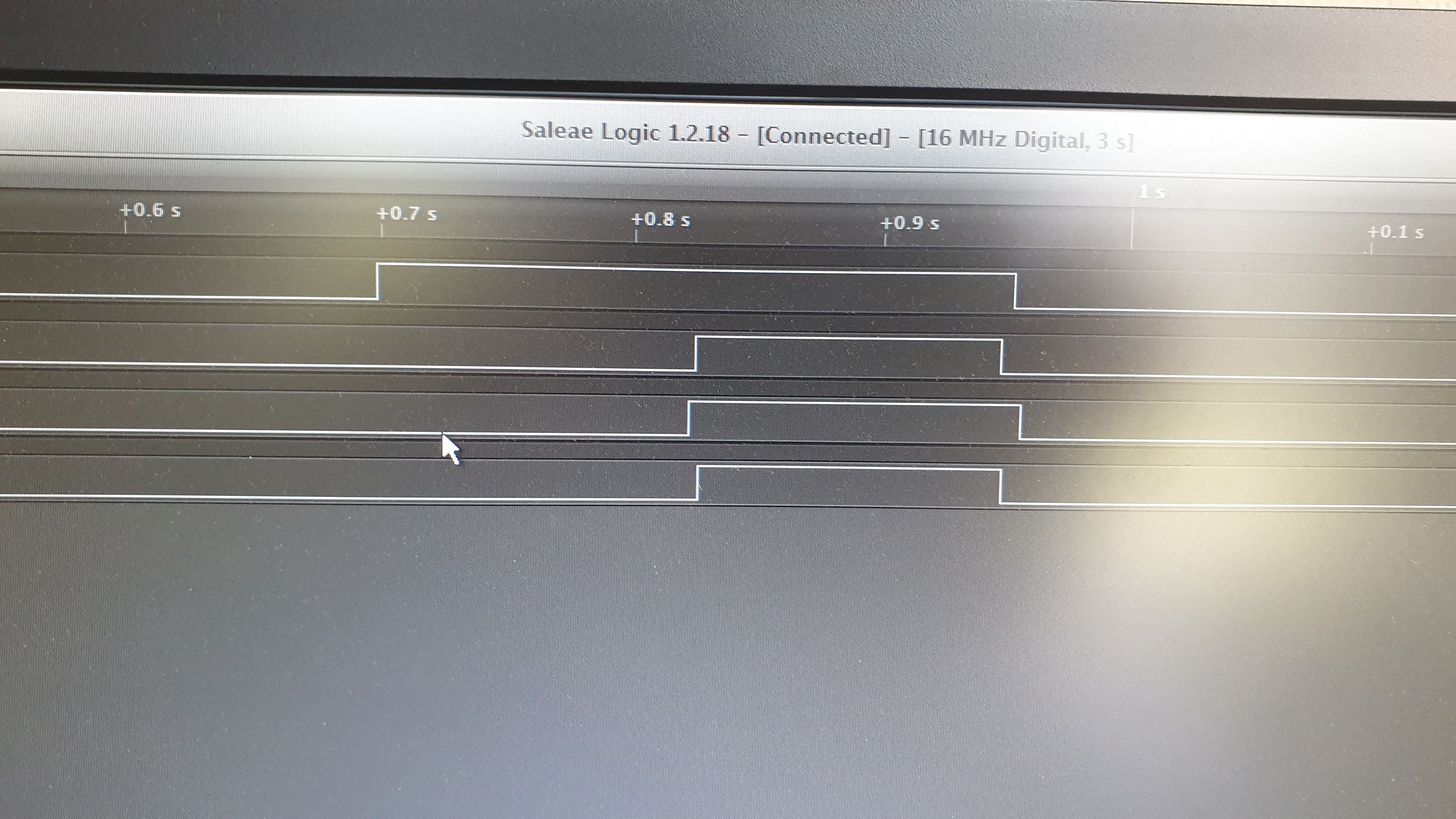

Nothing very exciting here on the bench. Next stop ccs stations.

That's surprising - I'd have expected to have seen at least some initialisation at power-up

Seems reasonable enough. They're probably bringing up the TCP/IP stack and PowerPlug interface when they initialise for a CCS session. If they start from scratch every time it'll stand a better chance of clearing out any unexpected state and general weirdness from one session to another. Good for power consumption too not having the device running when not being used.
