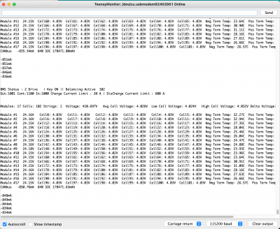

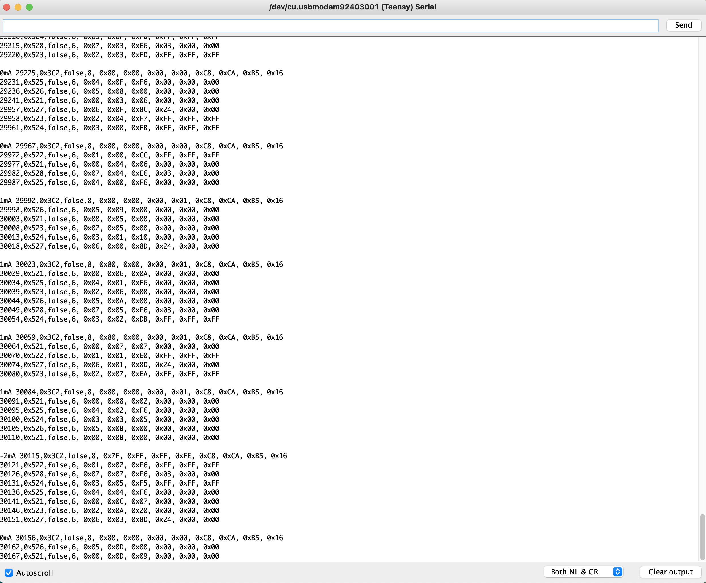

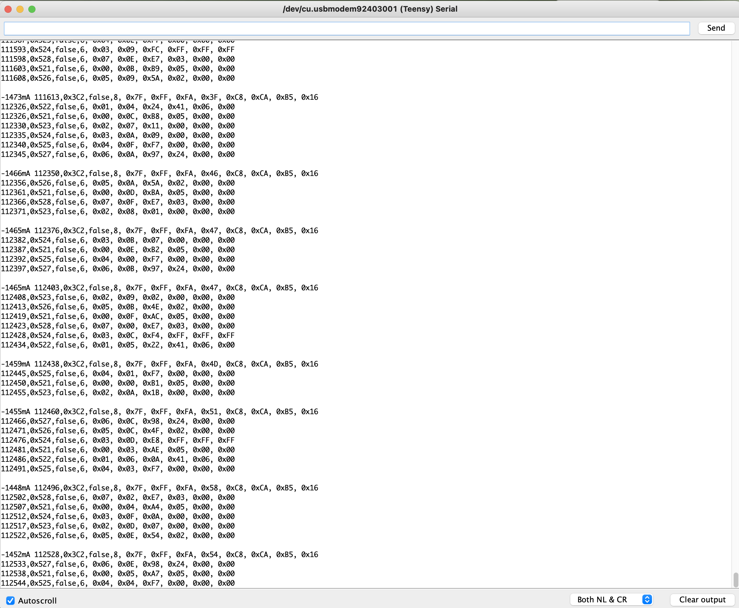

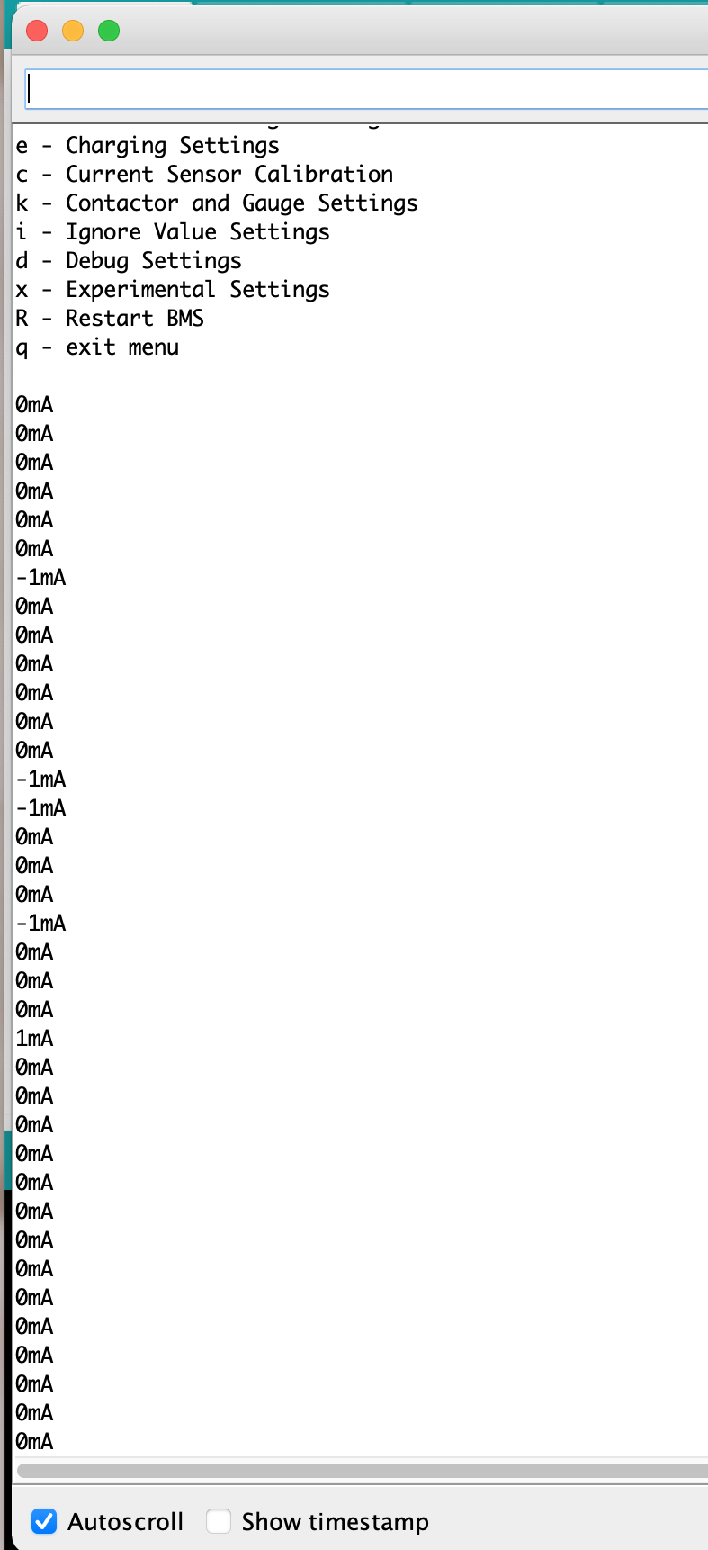

Hey Tom, still no luck getting any current readings with the ISA shunt on my end. The shunt is also sending data to other devices in the same CAN network successfully so I’ve ruled the shunt out, and it’s using the default config. I merged the changes you recently committed into my code as I have a separate issue when I run the latest out of the box code.
The issue when running the latest is that the contactors cycle through precharge, to on, to error/ open, then repeat cycling when I turn the key on. It happens seemingly indefinitely and cycles every couple seconds. I’m running 17 Tesla modules in my car and the early 2020 code has been working just fine for me for a while now, the car is my daily driver and there are no issues to report with the older software (other than ISA not working).
Any leads I should look into on either?
Also, nice work on the Simp charge. Now I have more wiring to do! :)

Bryson wrote: Sat Sep 04, 2021 3:08 pm Hey Tom, still no luck getting any current readings with the ISA shunt on my end. The shunt is also sending data to other devices in the same CAN network successfully so I’ve ruled the shunt out, and it’s using the default config.
Do you see the messages appear when you got the can debug on the simpbms turned on? if so can you share a screenshot.

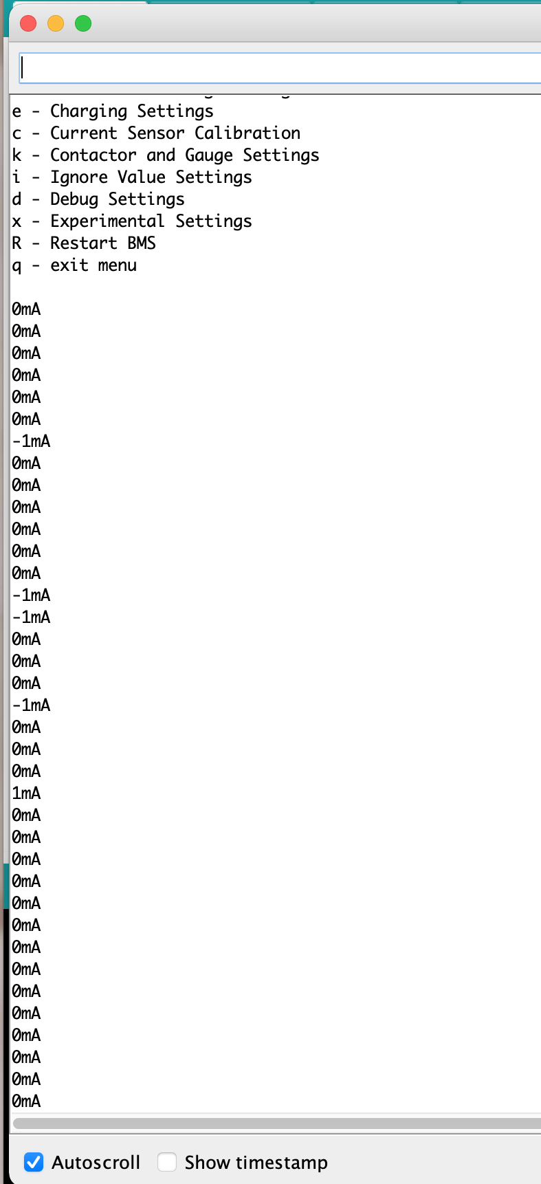

tom91 wrote: Sat Sep 04, 2021 3:15 pm
CAB sensor reads out like this during CAN debug (contactors open, did not cycle ign):
ISA sensor reads like this (nothing) during CAN debug (contactors both open and closed, cycled ign during this screen grab):
exiting the menu didn't have any effect, no data showed

Re: Simp BMS
you need to only turn on candebug and then fully exit the settings menu. It will the show the scrolling debug and between that all the canbus traffic.

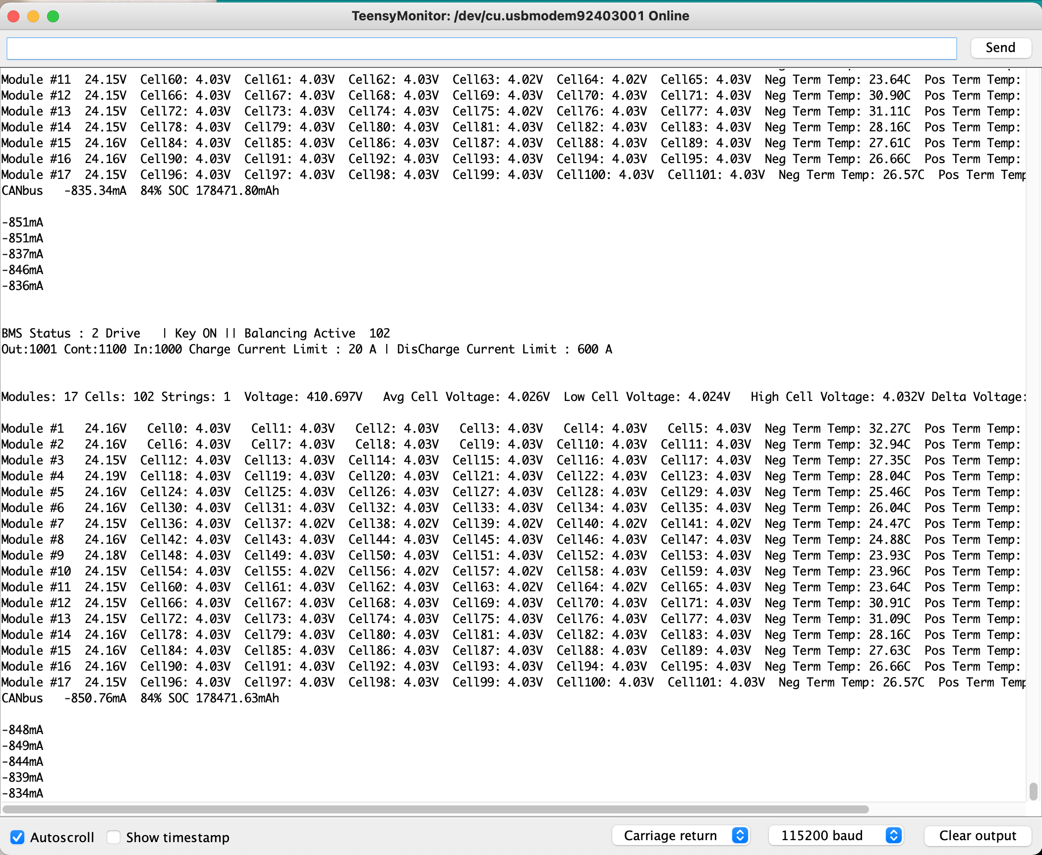

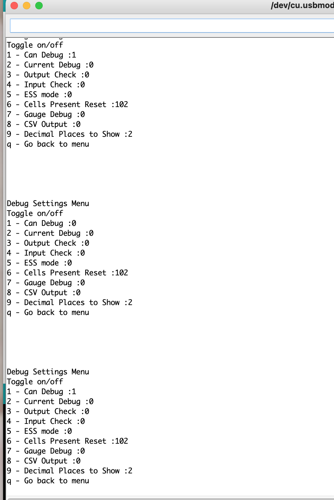

Post by Bryson »
tom91 wrote: Sat Sep 04, 2021 8:47 pm you need to only turn on candebug and then fully exit the settings menu. It will the show the scrolling debug and between that all the canbus traffic.
Sadly this isn't showing anything when ISA shunt is selected, just the regular serial interface with no additional data. Here's a shot with the CAB300 in debug mode, I don't see any raw CAN traffic:
thanks Tom

Bryson wrote: Sat Sep 04, 2021 11:23 pm
So this is what I get when enabling can debug. Since you have modded some of the code something might be getting broken.

Post by Bryson »
Hey Tom, found the [Serial.print] line of code that was missing and got an output from the ISA shunt showing in the debug menu. Looks like I'm getting CAN but still nothing making it to the BMS itself. Maybe we're parsing the message incorrectly?:
Contactors open:
Contactors closed and current flowing:
Bryson
Posts: 179
Location: California
Re: Simp BMS
Post by Bryson »
Got it. The variable CANmilliamps was trying to pull from the rx buffer and not the can message buffer. Set CANmilliamps as below and we're good to go! ISA shunt compatibility B)
CANmilliamps = ((inMsg.buf[5] << 24) | (inMsg.buf[4] << 16) | (inMsg.buf[3] << 8) | (inMsg.buf[2]));
