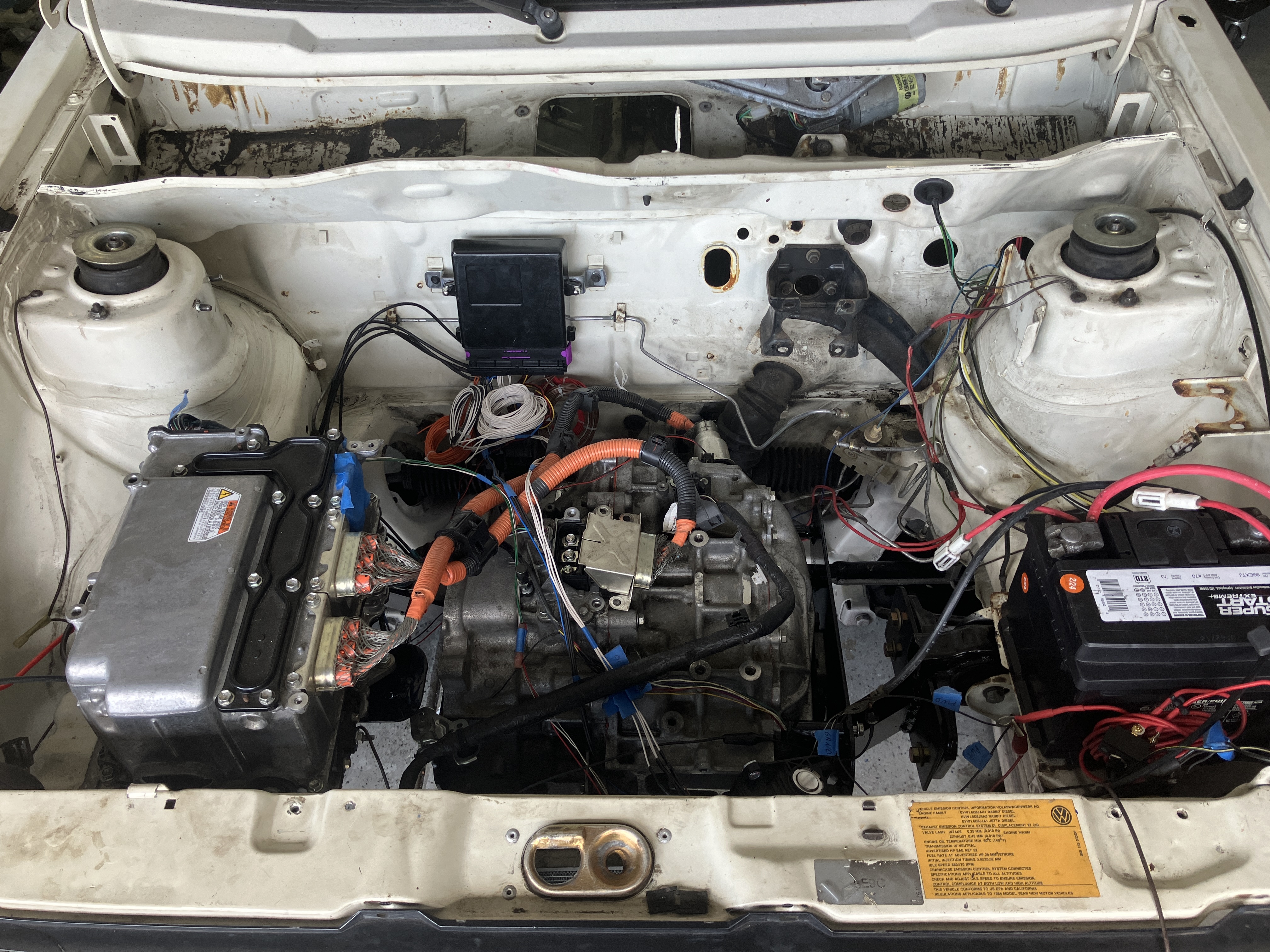

evbuilder wrote: Fri Apr 05, 2024 10:43 pm I've found something odd in the code I think you are using: (this? https://github.com/damienmaguire/Stm32- ... GS450H.cpp )
Thanks for noting this, the Prius 3 is still not fully worked out. Luckily we resolved some issues so it should be ready for a driving vehicle and more testing.
Quite some copy pasting going on between the GS450h and Prius Gen3 and IS300h. Surprised things are just working :)

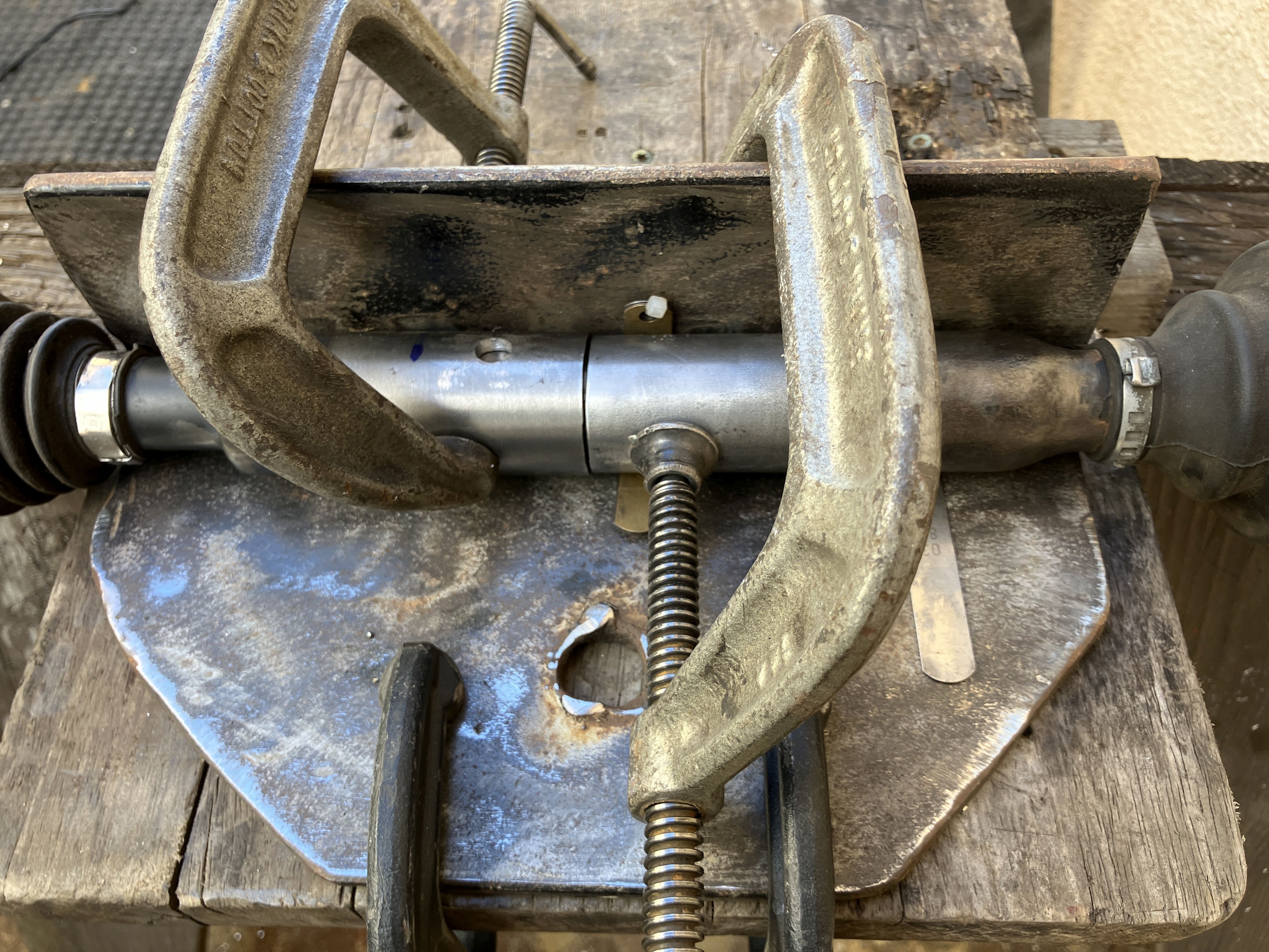

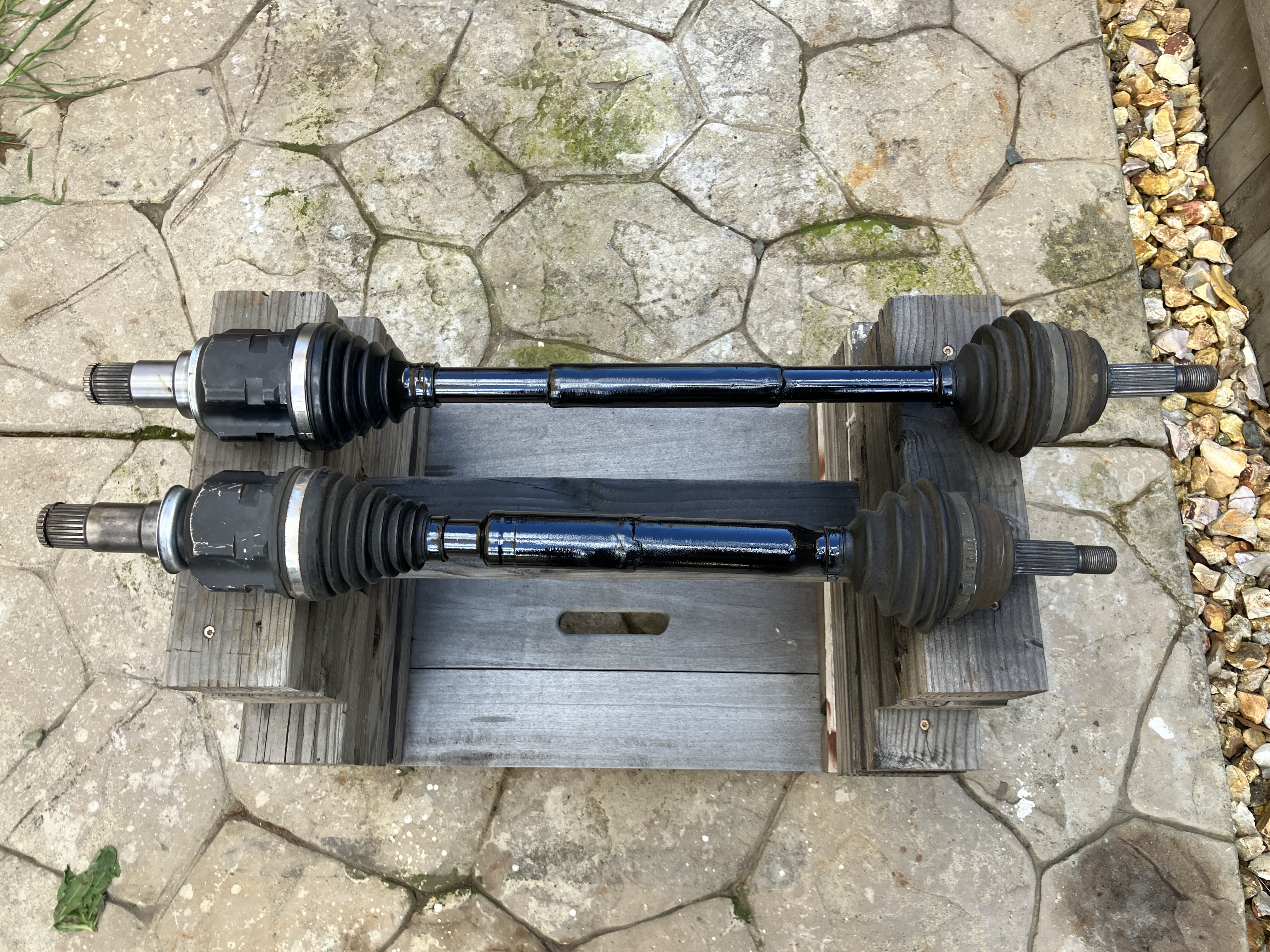

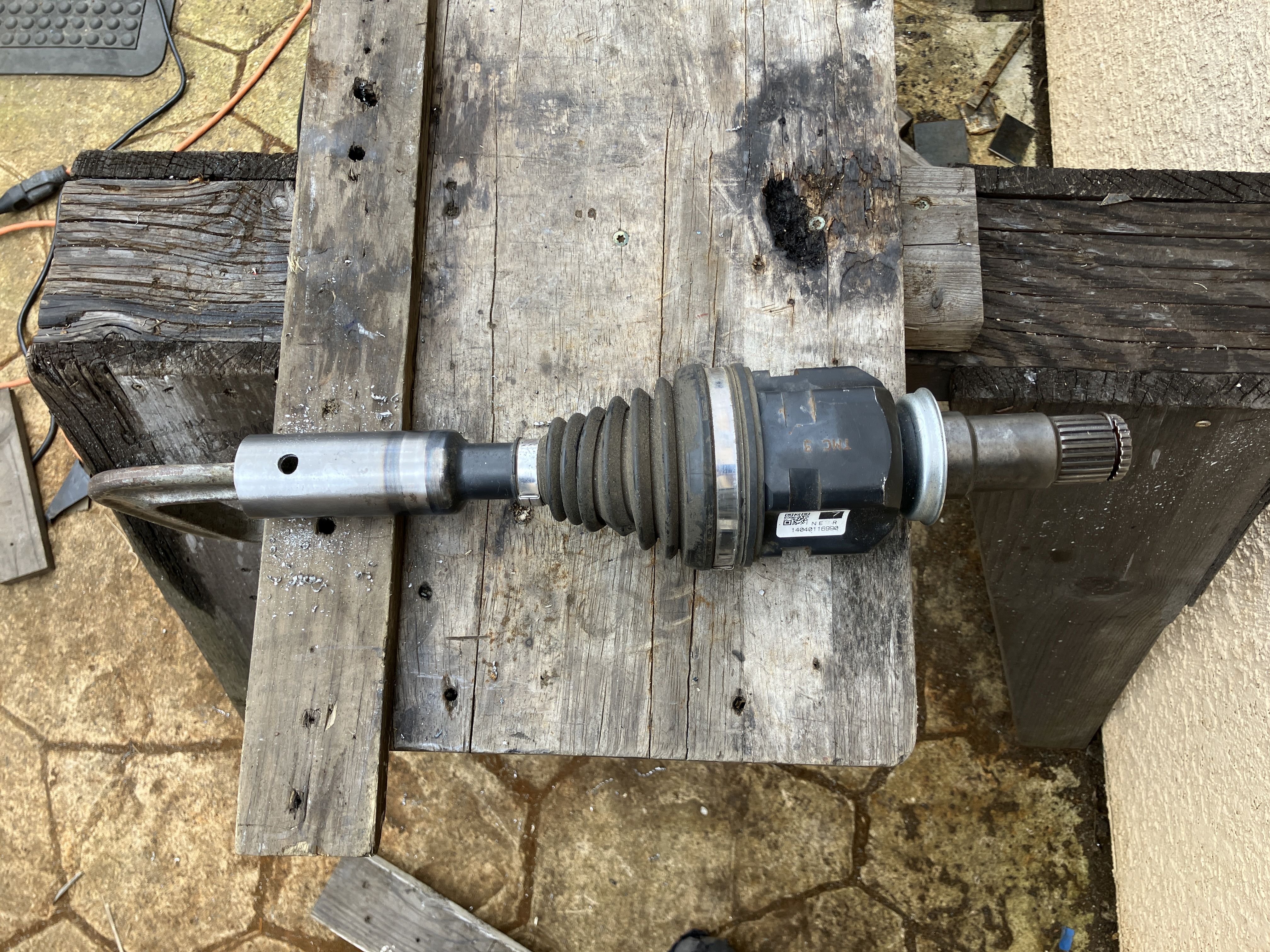

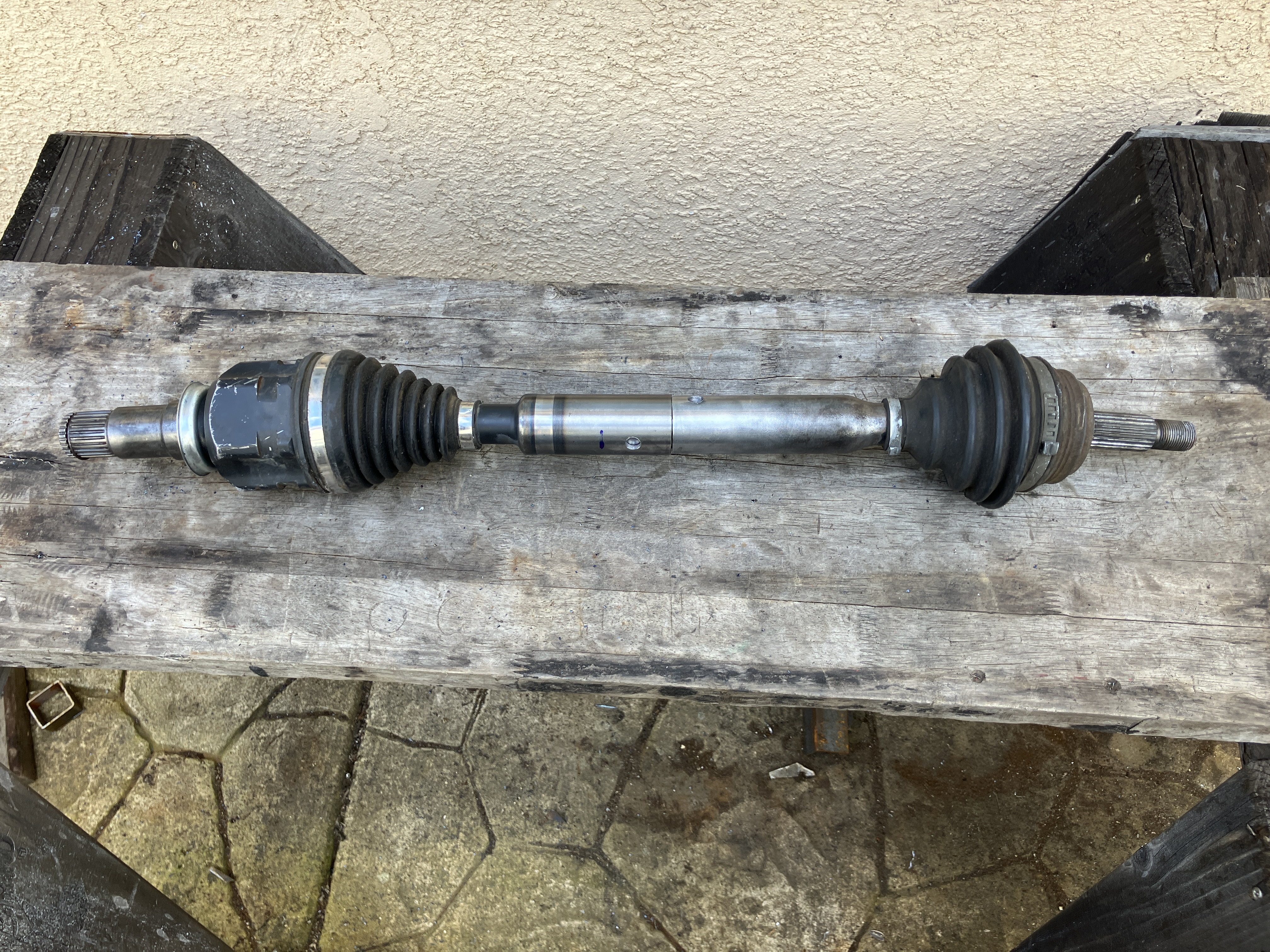

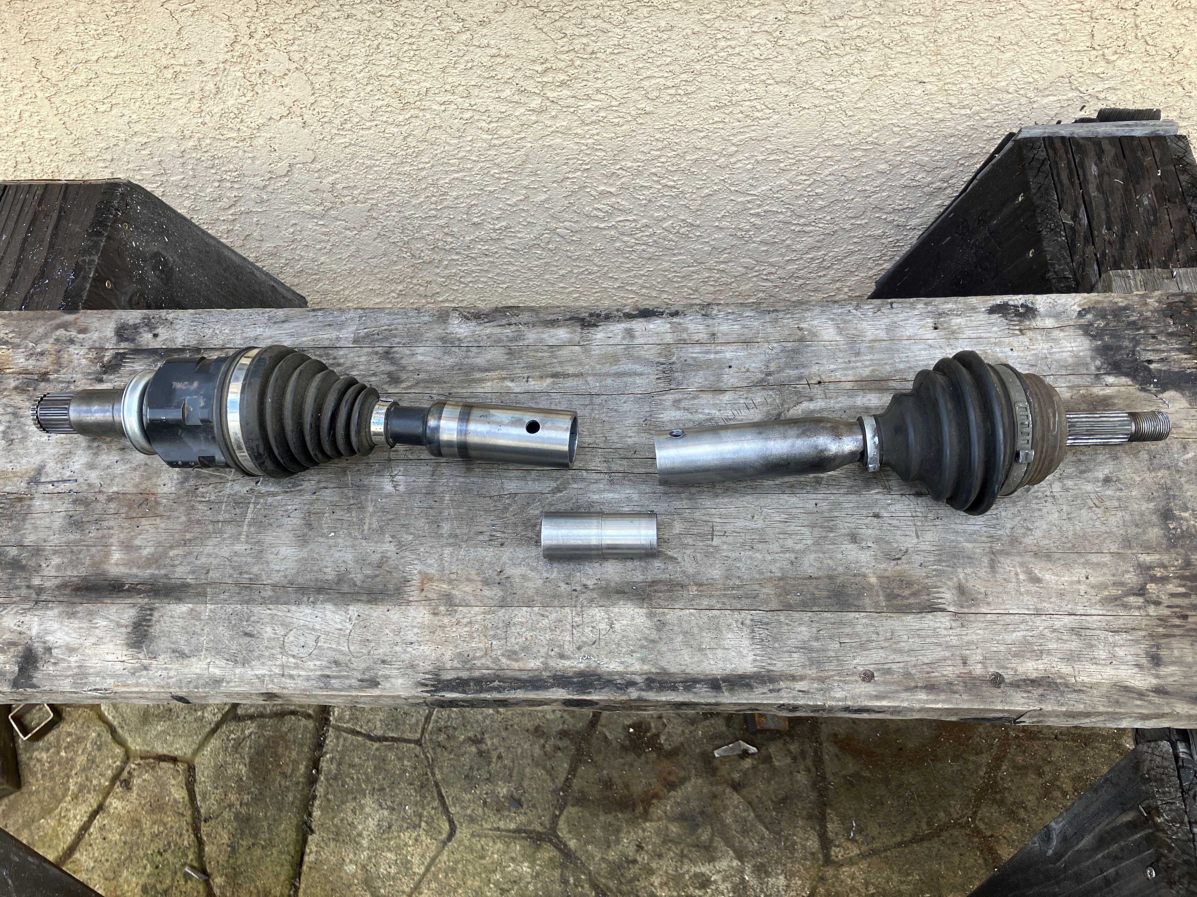

Passenger side CV Axle joiningship

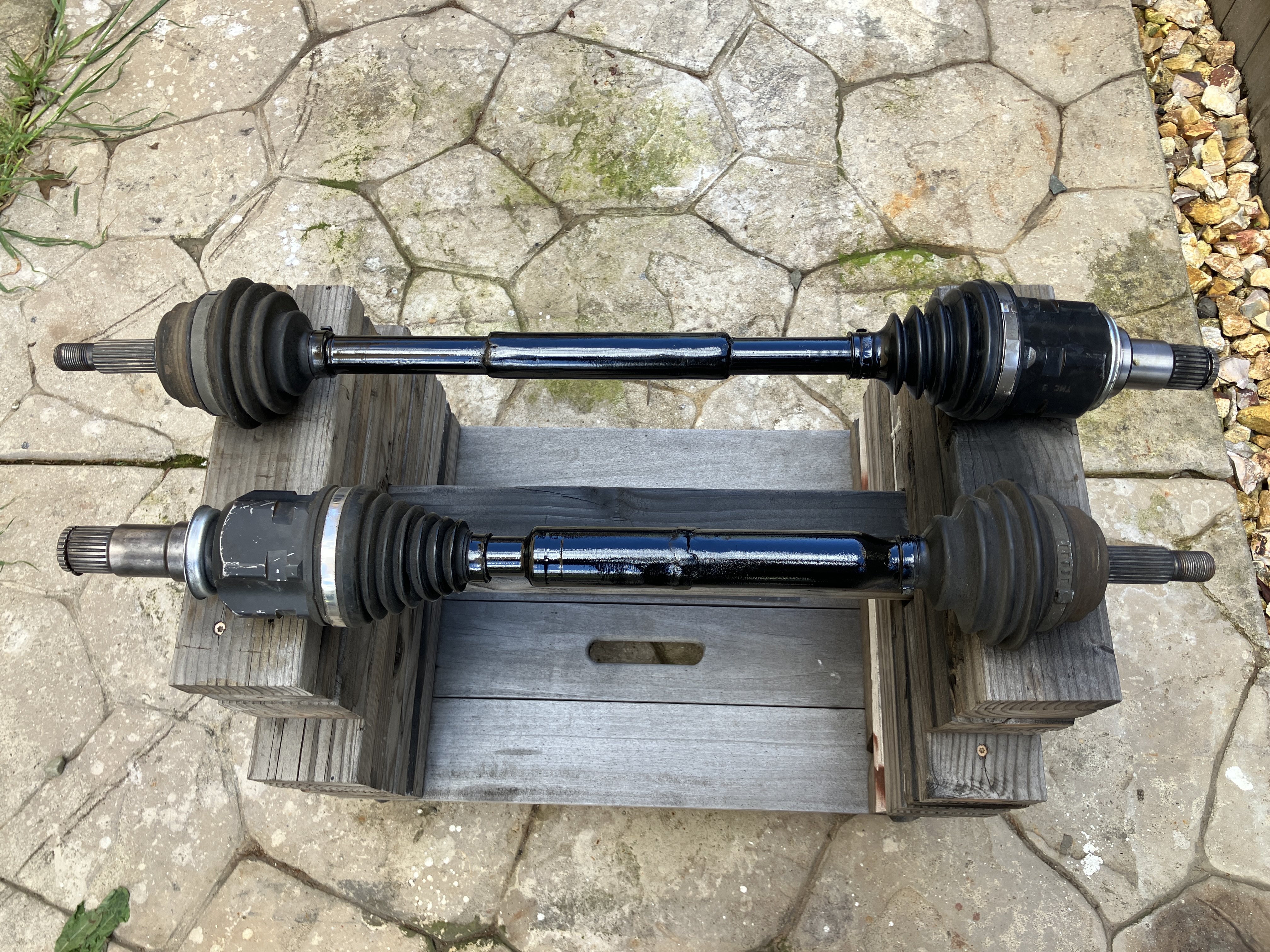

Post by Gregski »
Paint It Black And Put It Back !

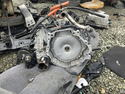

Post by Gregski »

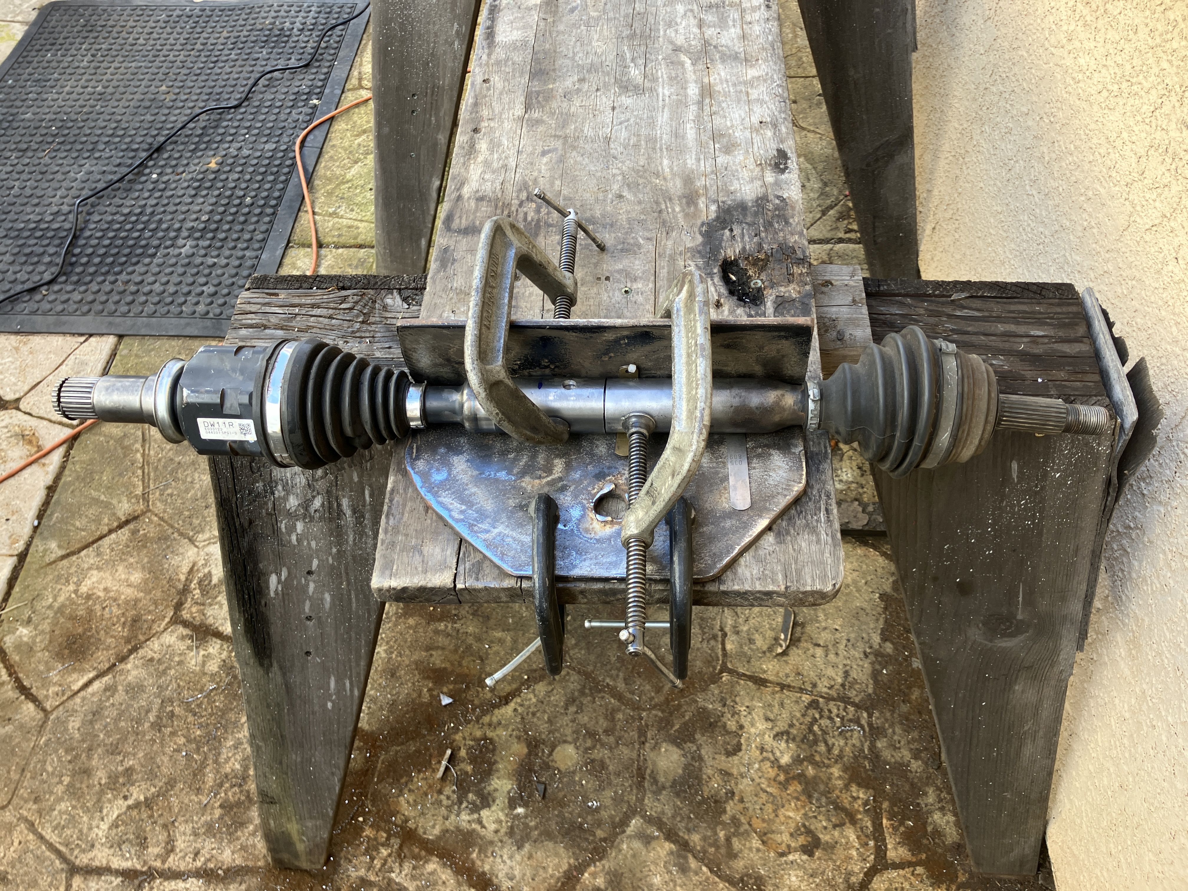

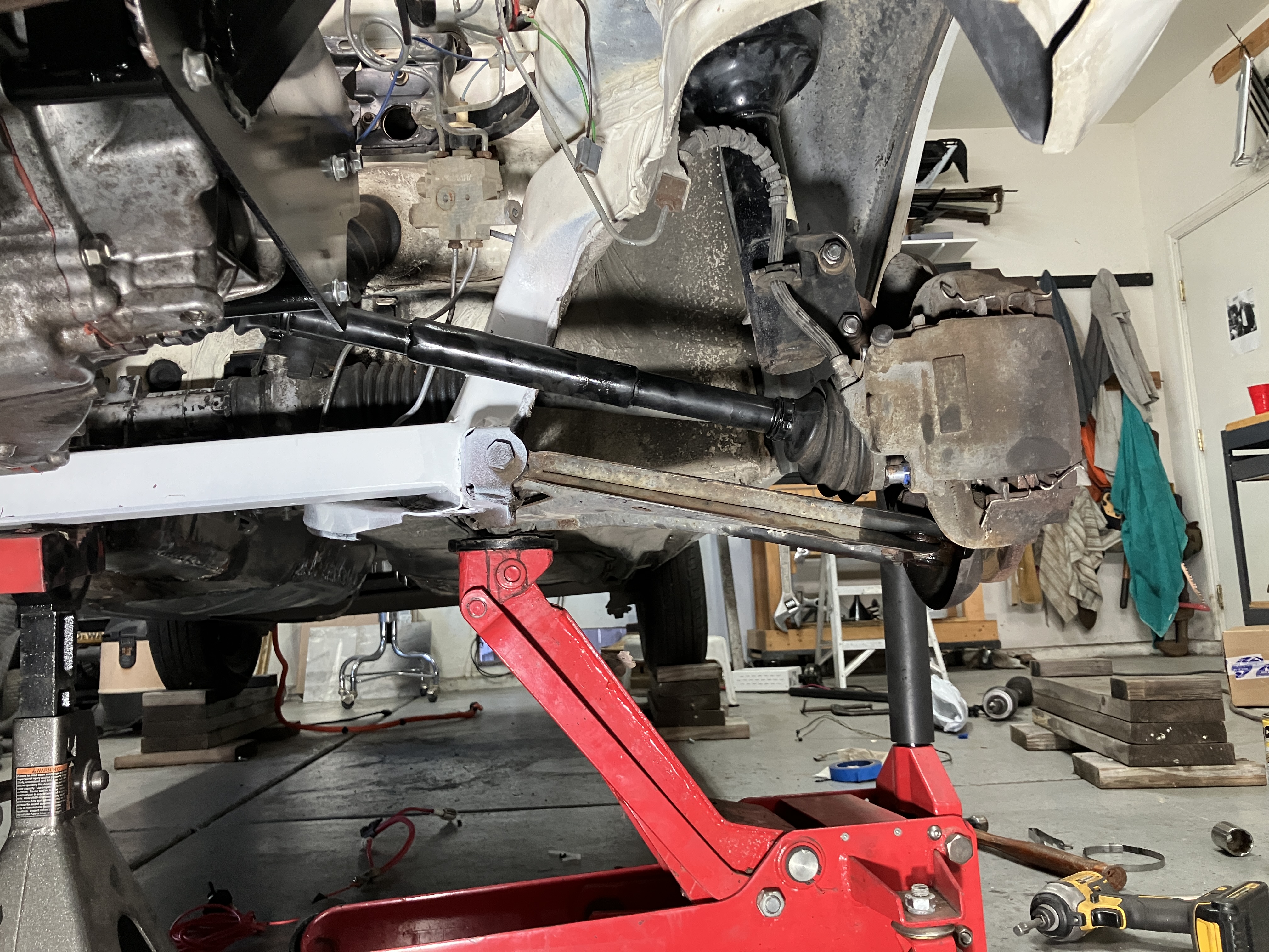

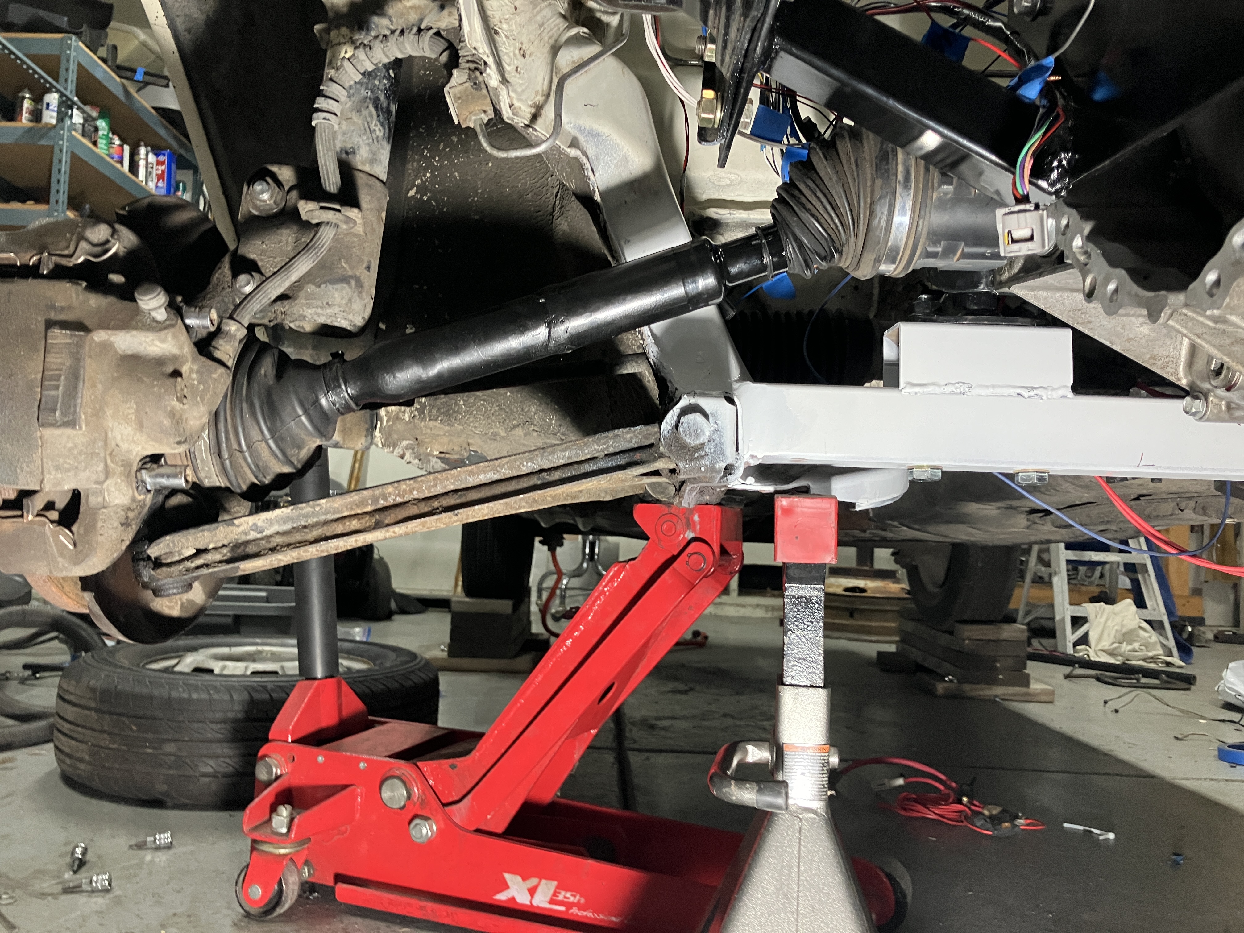

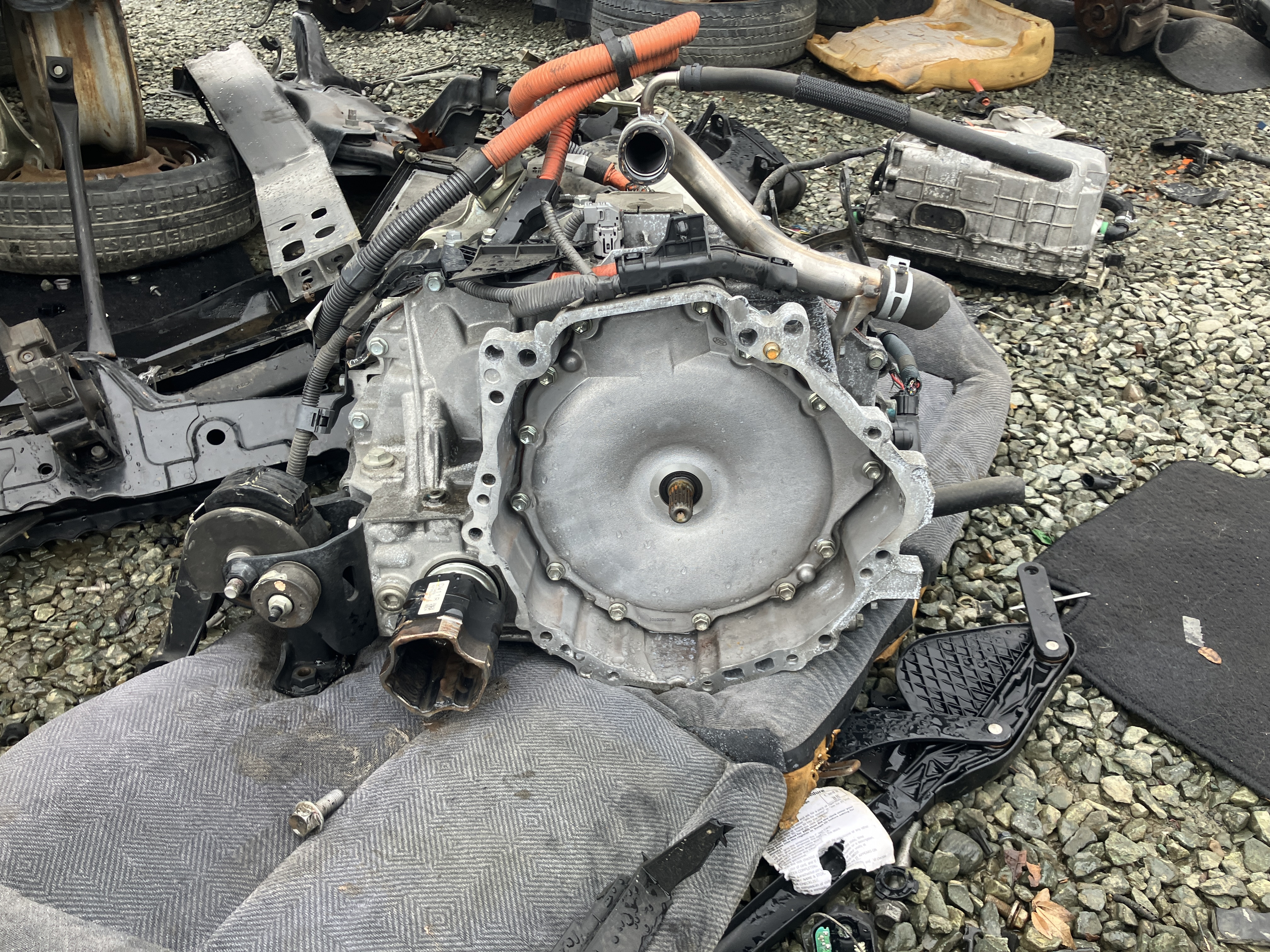

well this really urks the Greg, apparently the Prius transaxle butt ie it's differential is offset to the passenger side, so by putting the transaxle in the middle of the motor bay, now the driver side drive axle (pictured on top) is longer than the passenger side
Can the Greg ignore this or will he abandon the entire build and buy a Tesla?
Gregski
Posts: 3161
Has thanked: 631 times
Been thanked: 1608 times
Post by Gregski »
don't tell nobody but this ol' Rabbit is a fun little car to work on
I hope the angles will de-extreme themselves once the axles are no longer drooping and are under load

Post by MattsAwesomeStuff »

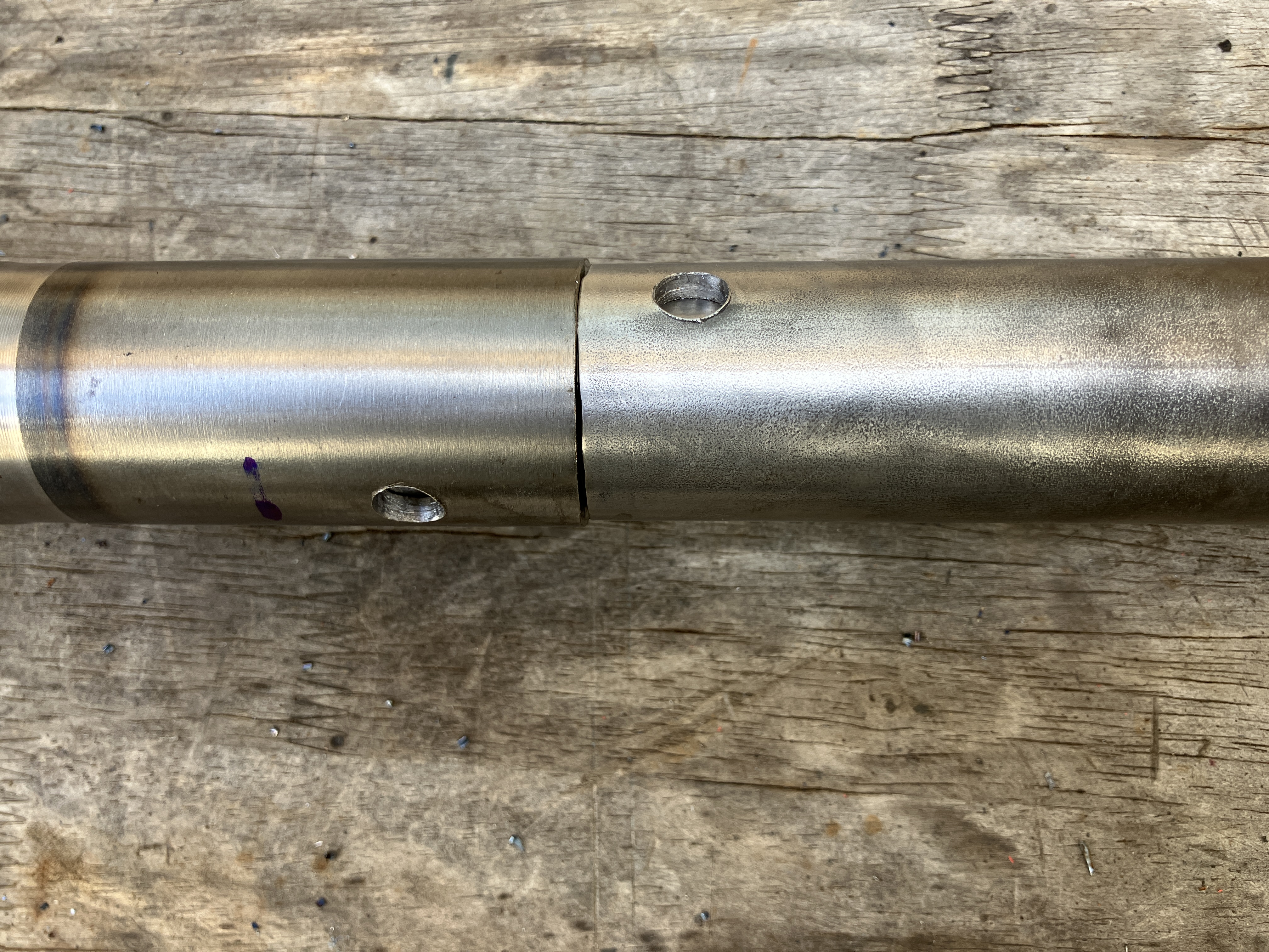

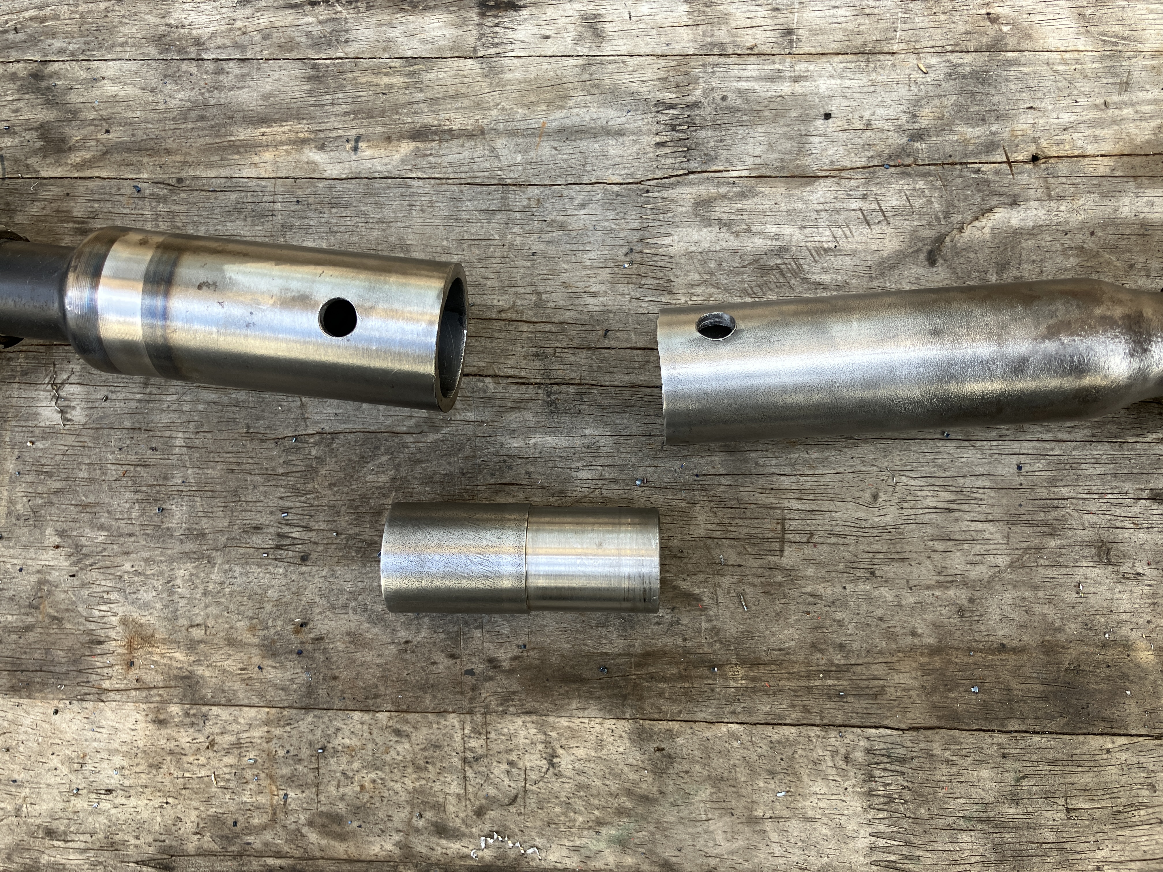

I've heard that when joining axles the wrong way, to never cut them square. You cut them at 45 degree angles. That way if the weld seam shatters, they're still forced to spin each other, where a square cut would not.
Gregski
Posts: 3161
Post by Gregski »
MattsAwesomeStuff wrote: Sat Apr 06, 2024 10:35 am I've heard that when joining axles the wrong way, to never cut them square. You cut them at 45 degree angles. That way if the weld seam shatters, they're still forced to spin each other, where a square cut would not.
I know of two ways to join CV axles... and both of them are wrong!

Post by Alibro »
Gregski wrote: Sat Apr 06, 2024 4:33 am well this really urks the Greg, apparently the Prius transaxle butt ie it's differential is offset to the passenger side, so by putting the transaxle in the middle of the motor bay, now the driver side drive axle (pictured on top) is longer than the passenger side
I think it is pretty common for the two drive shafts to be different lengths in FWD cars.

Post by lsh3rd »
Alibro wrote: Sat Apr 06, 2024 3:49 pm I think it is pretty common for the two drive shafts to be different lengths in FWD cars.
Correct... the car the transaxle came out of is this way... except it's much longer on the passenger side.

Post by Gregski »
lsh3rd wrote: Sat Apr 06, 2024 4:24 pm Correct... the car the transaxle came out of is this way... except it's much longer on the passenger side.
thank you gentlemen, it appears the Greg has over corrected

Gregski wrote: Sat Apr 06, 2024 4:30 am Paint It Black And Put It Back !
That looks really good!
Hm... did you accoount for the movement of the loaded axle? It should have like 0.5cm movement in its loaded position. Just saying because i didnt think of that the first time and i had to shave the CV side down on the lathe!!!

Post by Gregski »
arber333 wrote: Sat Apr 06, 2024 7:17 pm That looks really good!

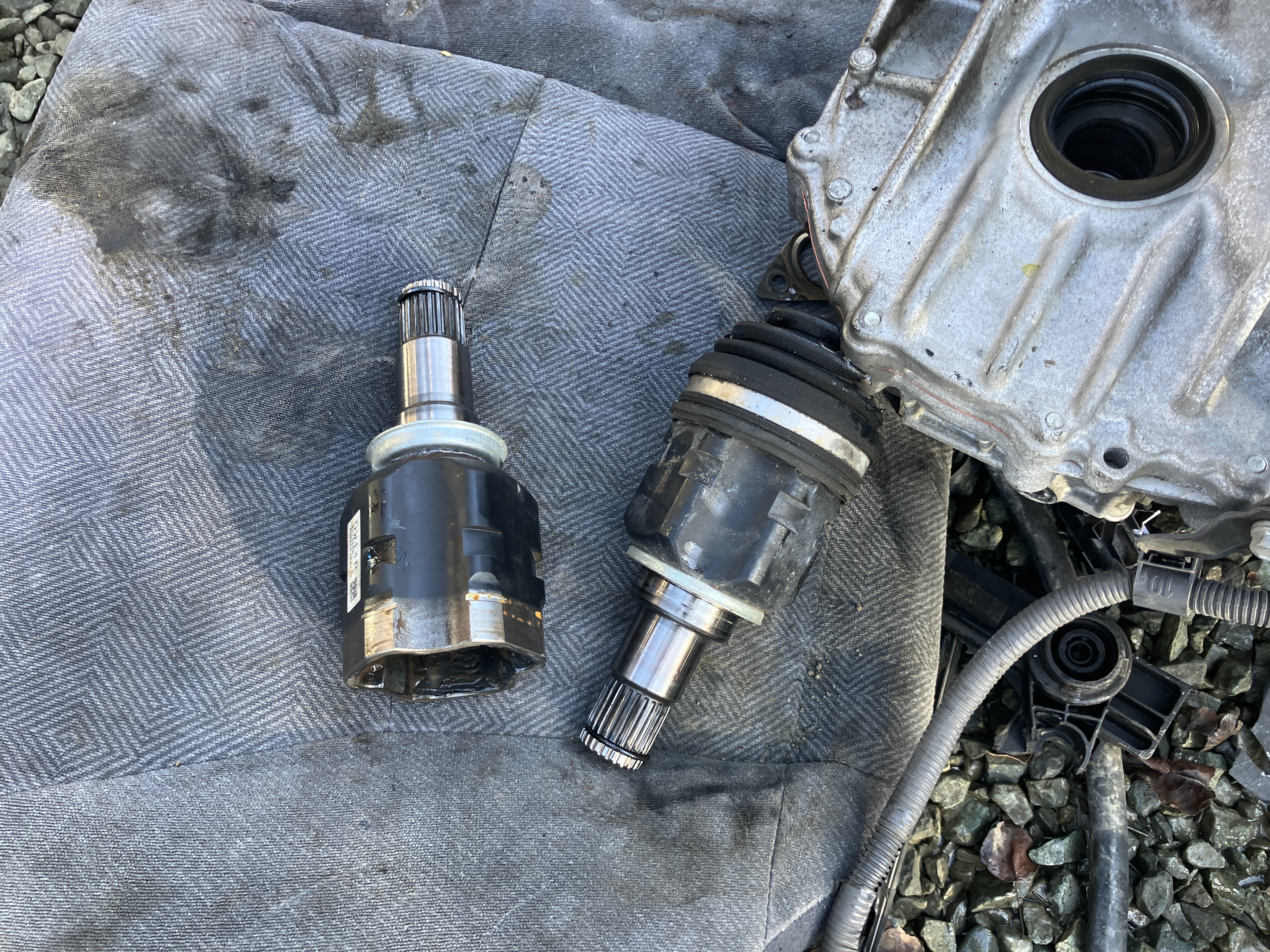

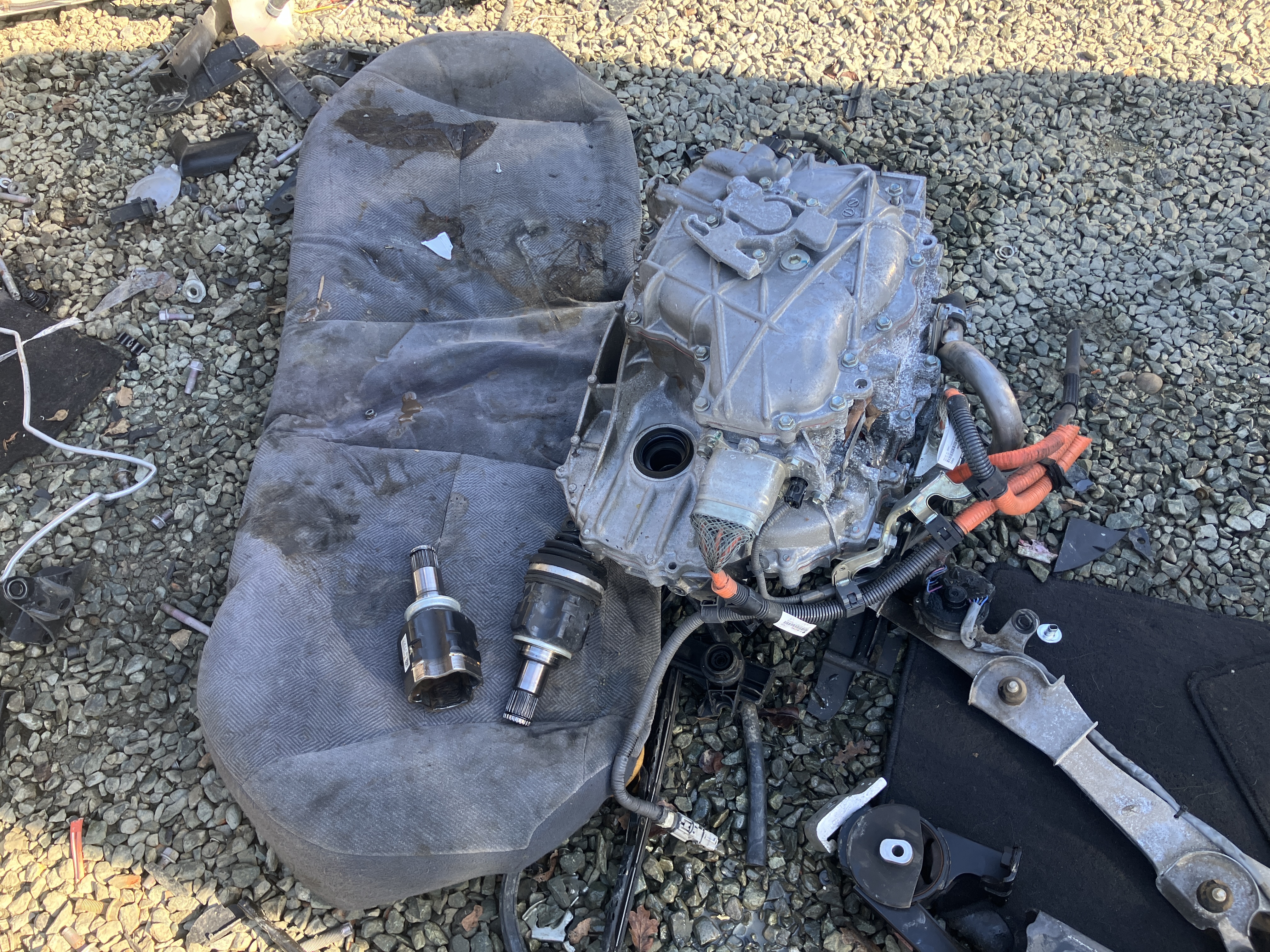

yes sir, I installed them while the Prius inner CV joints were in the cups in what I call neutral position meaning they could go in at least one inch and travel out one inch as well
I just checked the angles the and driver side is at 9° which I can live with but the passenger is at 11.5° and I recall reading somewhere that 12° is the most they can tolerate
the reason I pushed the envelope on those angles is because I moched up the transaxle location without the "cups" in it because mine did not come with them, well once the cups are installed they protrude an additional 5" or so either way aka left and right
these are the cups I keep referring to, I scored these later from another junkyard

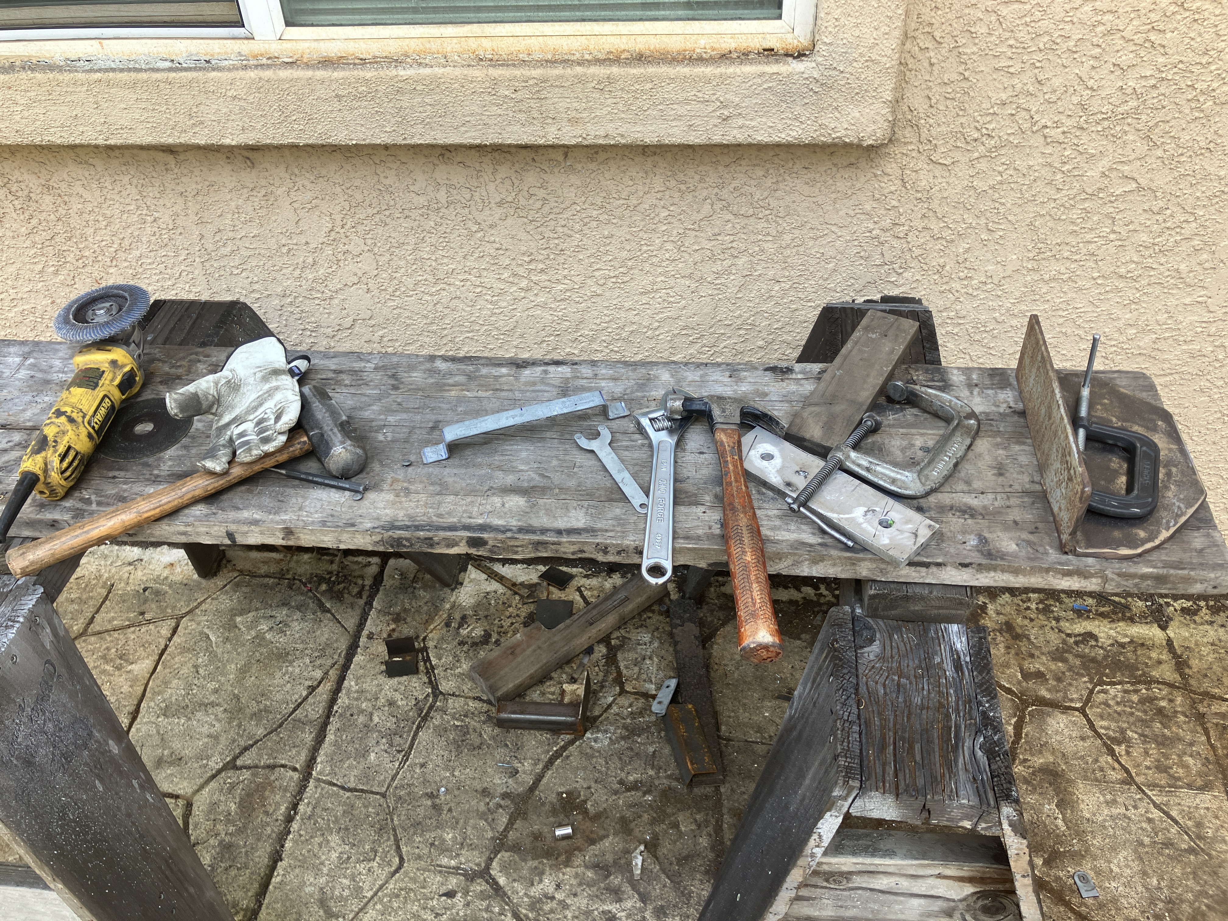

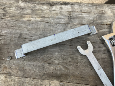

Post by Gregski »

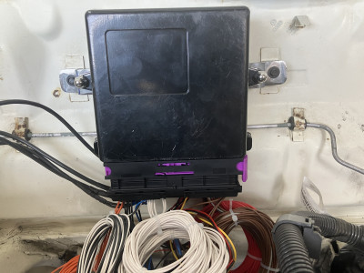

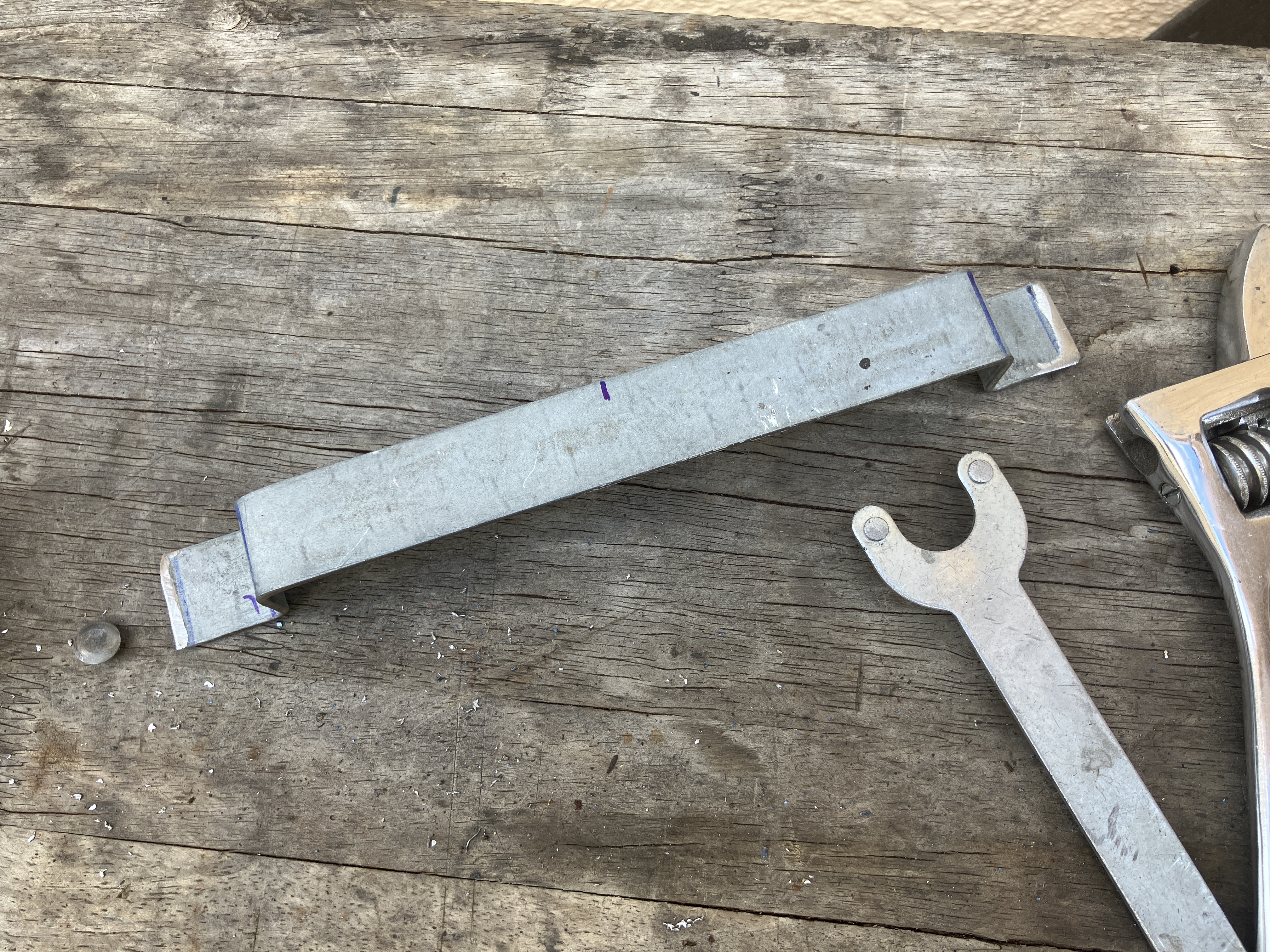

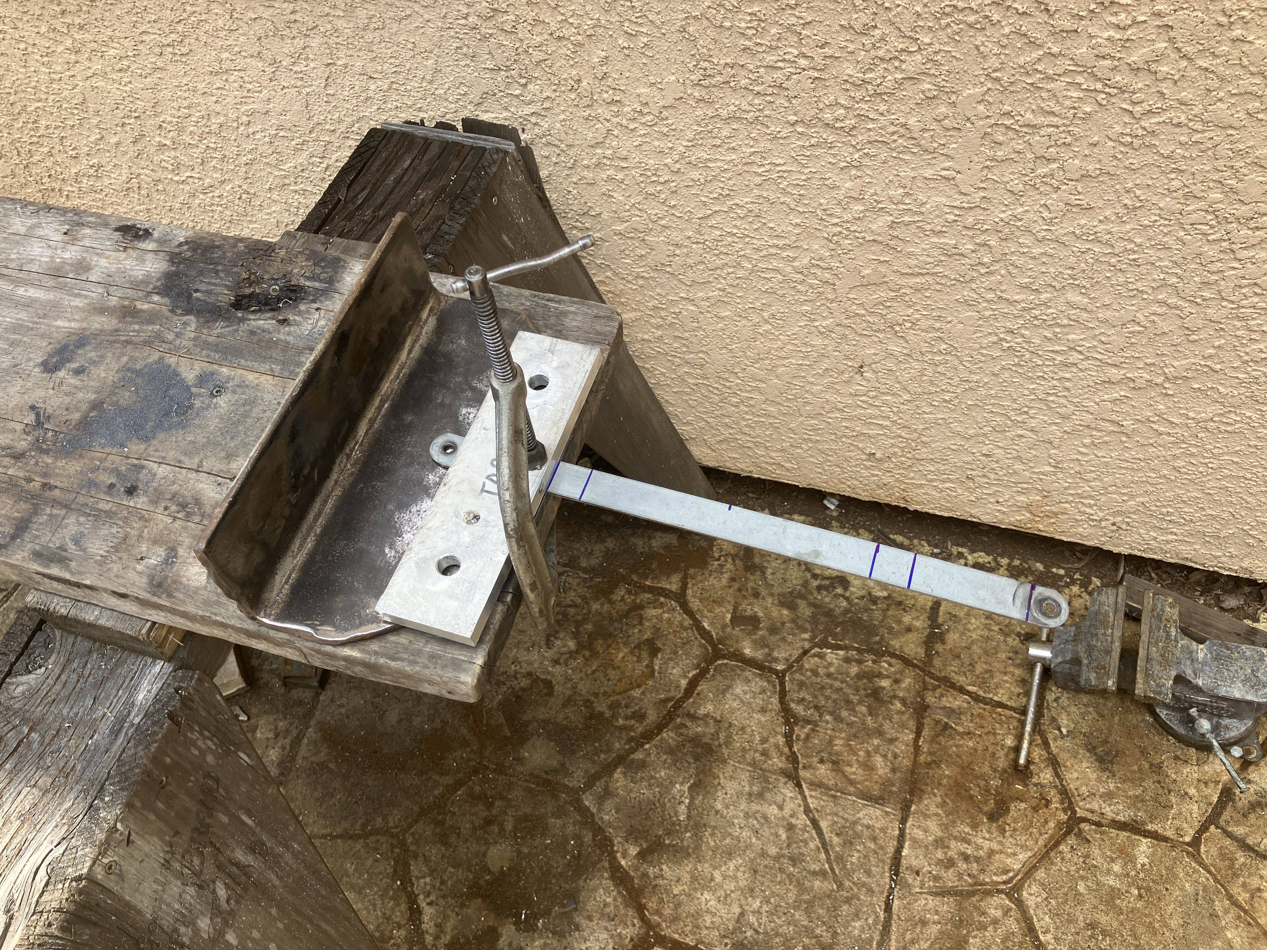

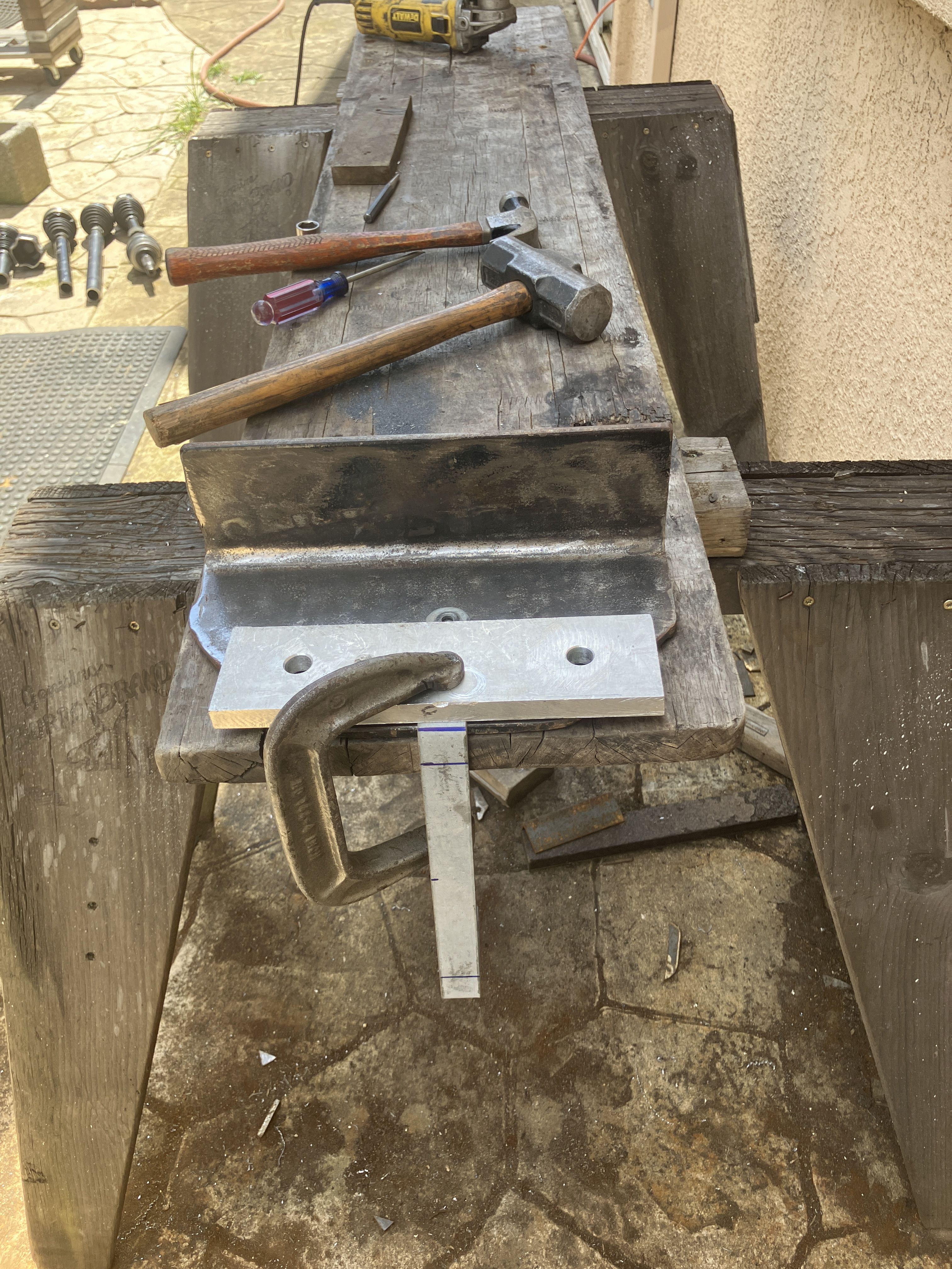

Electric VW Rabbit VCU Bracket
this is my hammer, and this is my backup hammer
I am very pretty proud of myself how this turned out... [eventually]
Gregski
Posts: 3161

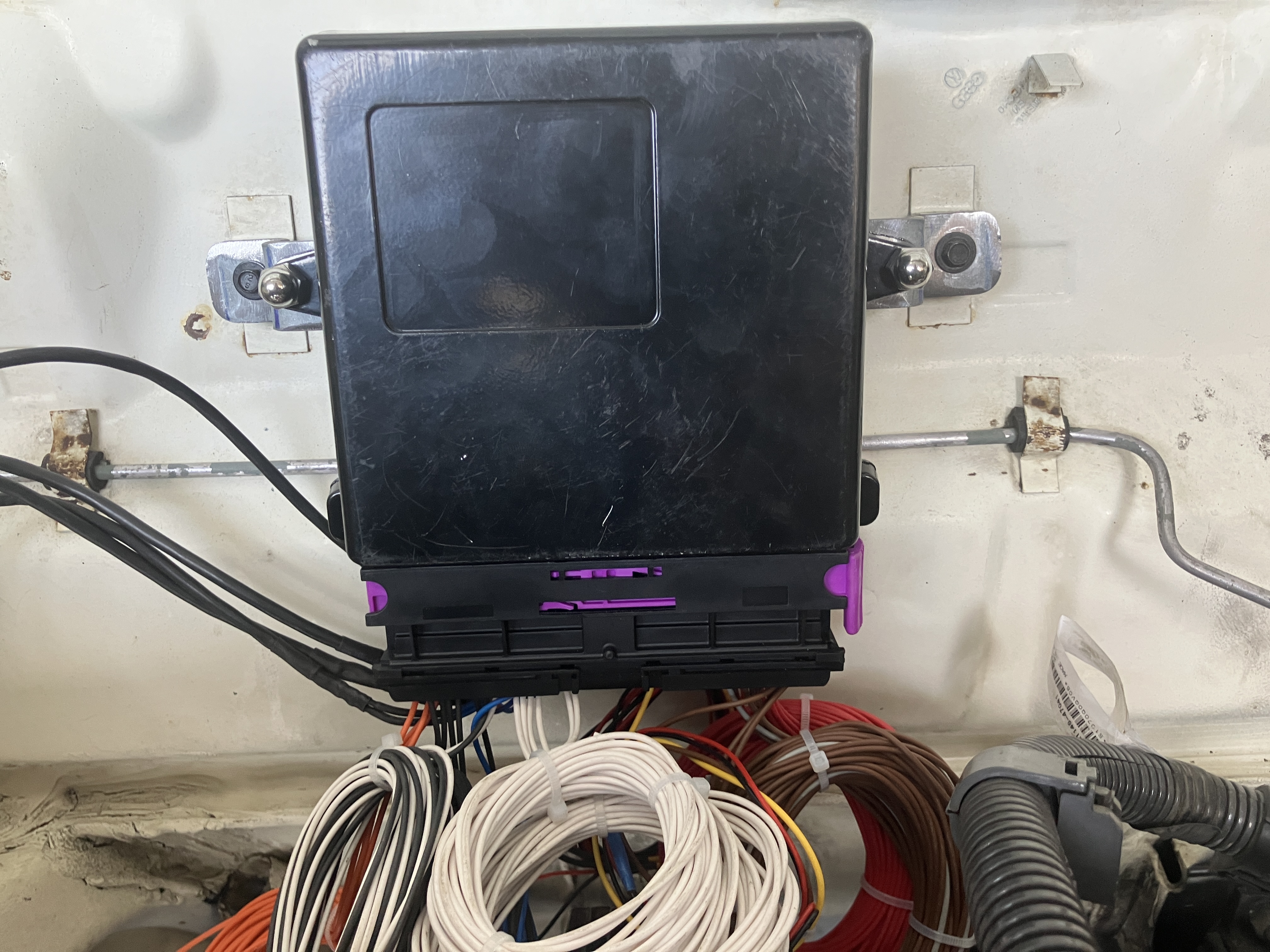

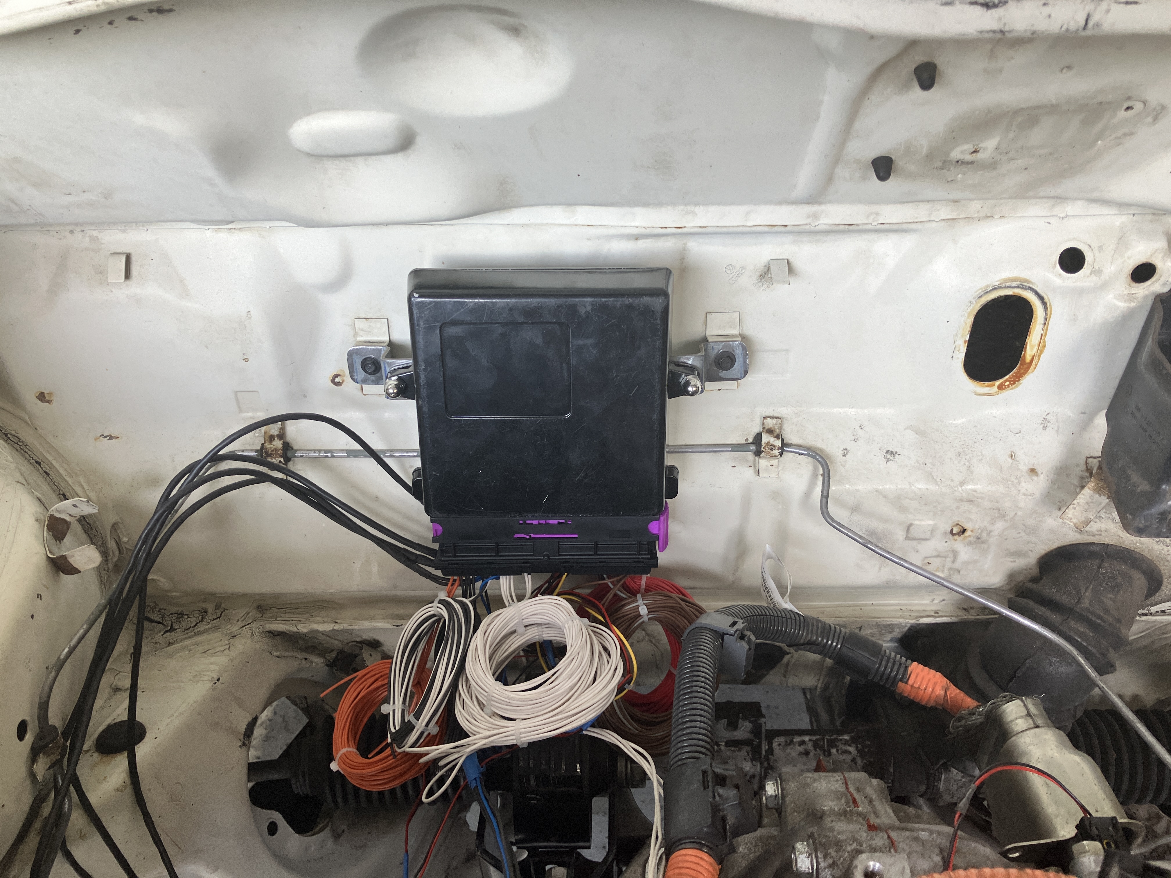

Post by Gregski »
and she's in
"laces out" ie header / connector pointed down so that agua don't get inside of it
I am sooooo tempted to snip all these "extra" [pronounced: I have no idea what they do] wires

Posts: 2962
Has thanked: 330 times
Been thanked: 847 times
Gregski wrote: Sun Apr 07, 2024 1:43 pm I am sooooo tempted to snip all these "extra" [pronounced: I have no idea what they do] wires
This connector is easy to de pin, just get the TPA cover off, short sides small screw driver or de pinning tool and should come up easily. Then two bars on each of side of the pins, small pressure on the wire when doing it ensures it stays released so you can do one side at a time.
https://de.aliexpress.com/item/32822692950.html
Gregski
Posts: 3161
Post by Gregski »
tom91 wrote: Sun Apr 07, 2024 1:51 pm This connector is easy to de pin, just get the TPA cover off, short sides small screw driver or de pinning tool and should come up easily. Then two bars on each of side of the pins, small pressure on the wire when doing it ensures it stays released so you can do one side at a time.
you are a friggen life safer... [ sets the Sawzall back down ]

Post by robertwa »
Agree, harvest those extra leads and you may have enough extra to only need to buy the cheaper bare connector for your next conversion :)

Post by Gregski »
robertwa wrote: Sun Apr 07, 2024 2:50 pm Agree, harvest those extra leads and you may have enough extra to only need to buy the cheaper bare connector for your next conversion :)
stop reading my mind, I just bought that extra plain connector Tom recommended, my OCD could not handle having a black permanent 12 volt power lead, we must shuffle the colors around or else we loose the shop
