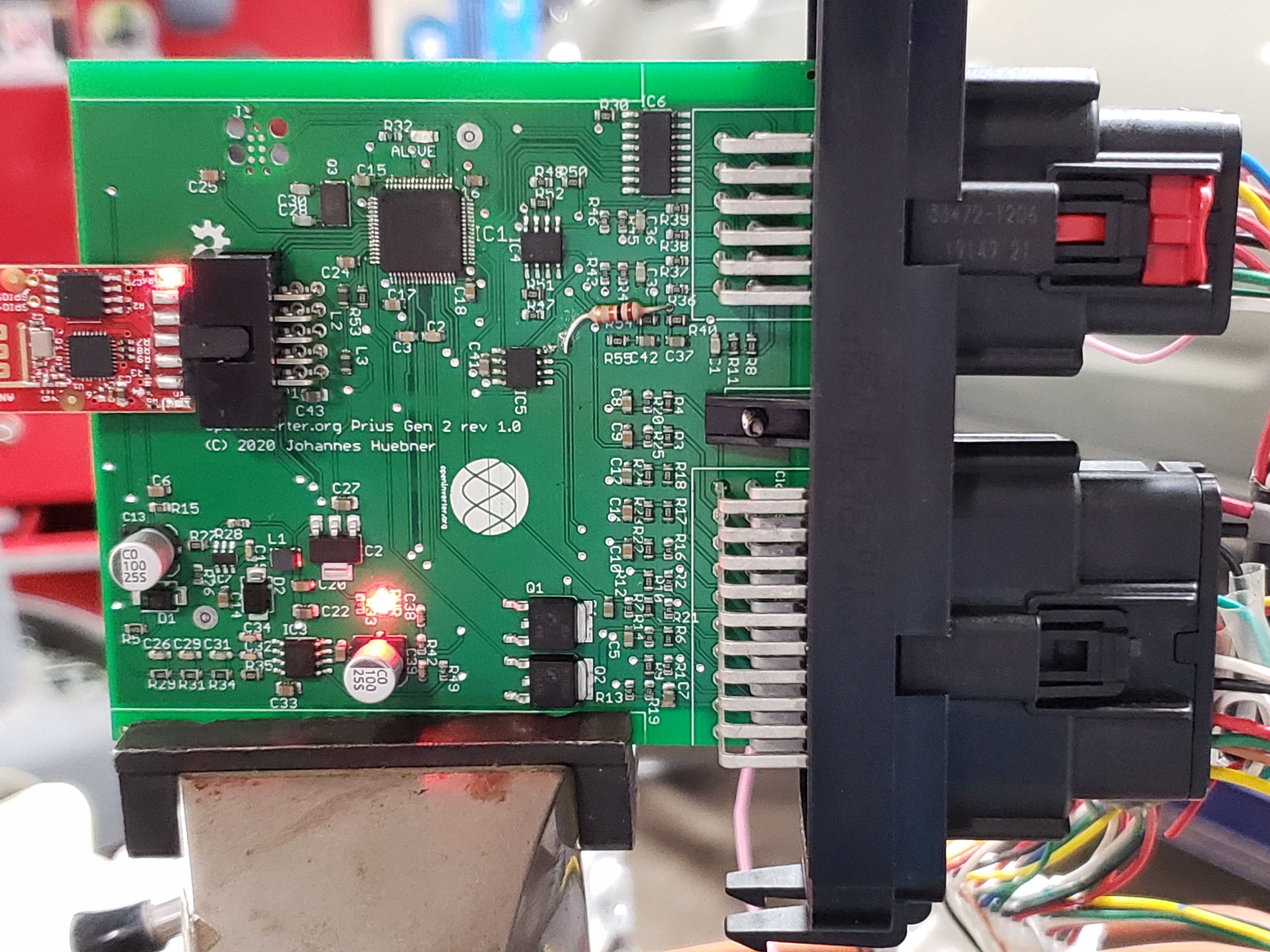

I might have cooked the STM then... Wifi lights up.
Even without wifi adapter connected, the LED next to R32 should flash no?
Any chance of checking voltage on ALIVE through hole points?

Retro, I had a similar condition with my BluePill go at this and based on my web searching, the STM programmed just fine. For reasons I never figured out, the WiFi module (ESP8266-DEV in my case) & STM32 just absolutely would not communicate and it is beyond my technical knowledge to figure out, much less explain why.
My point, it might not be a fried STM, hoping not.

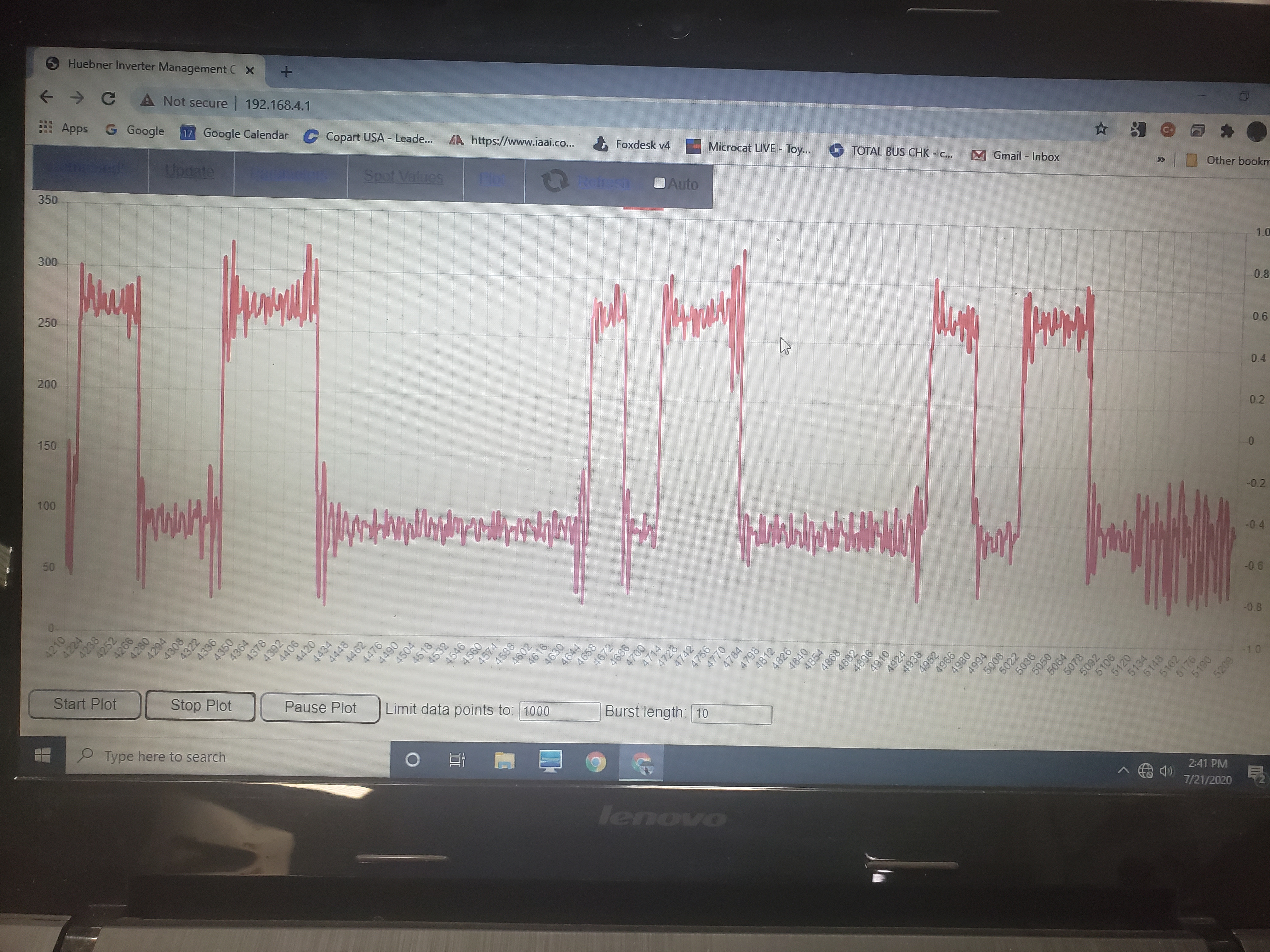

I am noticing that my angle readout is changing even when the resolver is not moving. and I have connected another " test" resolver outside the motor just to see if there is any interference.
back to the pinswap feature.. what if I ( like damien in his youtube video) , need to pinswap pwm 2 and 3 but I also need to swap sin/cos
I cant do both with software, and when I swap the wires physically there is no effect.
I cant get over the fact that there is no way the (inverter control board v3) can control the motor in FOC mode if it does not read the resolver angle correctly.
maybe I need a low pass filter to get rid of that hysteresis (See previous photo)or maybe change the resolver frequency? by the way is there a published suggestion for the parameters descriptions like say for example resolver freq?

imwoody36: What signal is ploted in the picture? Is it one of ENC A or ENC B?
I would expect this signal to slowly rise and fall similar to a sine-wave. The signal ploted looks like a digita signal jumping from low to high?

that is the webinterface with " angle" selected. I dont see an option to show me ENC A or ENC B
you are right I would expect a sine, and no it is more like a square but when I turn slowly by hand the leading and trailing edges begin to look like a sine due to what I thought was noise. then I see the post below by JAP and Im thinking wait, what?

status update:
improvement with damiens parameters installed (thank you !)!, will begin to hum and jerk when throttle is applied.
( and conversely will stop when throttle is released
not using any manual current, and im still not convinced the resolver is giving good angle data.
did try reversing sin in hardware, and then cos,
not getting a pretty sine wave on the angle plot like this page shows

The angle data should go from 0 to 359 degrees and then back to 0.
Guess what shape that graph would look like.

Thanks for the advice, will try to keep it short.MattsAwesomeStuff wrote: ↑Wed Jul 22, 2020 4:58 pm I think you should give us a procedure of what you did. When troubleshooting, you can't just say what's broken, it's often helpful to tell us how you progressed. You won't know if you did something wrong (or you wouldn't have done it). Try to make it as easy for people to help you as possible.
BEFORE 'the problem' : I had 12V and GRND, LED PWR lit up and stayed ON and LED ALIVE flashed Red.
Communication via wifi - OK and web interface with values OK
Connected 2nd 12V supply for HV
Carried out Delta test with 3 X 21W light bulbs - one burnt brighter than the others but 1Hz flashing, solder joints maybe?
After playing with flslipspin and ampnom as per everyone helping here on the forum, I managed a spin up MG1 in Manual Mode from MG2 inverter output- Champagne!!
Connected standard 12V 20A relays for Precharge and Main contactors. Used a 3rd Relay ( IN and OUT switching circuit) to simulate precharge resitor - 40 Ohms. Precharge and Main contacter functioned correctly....
Connected 3 way position switch for Forward & Reverse - signal confirmed in values
Connected push button for STRT signal - OK
Connected MG2 inverter 12V signal to Forward and Reverse - thought MG2 ON signal is only required when direction is selected.
Connected Prius Gen 2 pedal - potnom would only activate from 90% to 100%, BUT communication via wifi still possible.
Wired up Resolver cabling (got it all wrong from what I see imwoody had done) along with Johu and what the rest of you posted, BUT, communication OK.
THEN : I had to leave my project a few days.....so when I returned, I decided to first clean up all my wiring.
I even anticipated higher HV, so connected 2nd series of more powerful relays, to be switched by the first set on original 12V Low voltage system.
Unable to get Precharge and Main contacters to function - No faults in web interface and Communication OK
4hrs later, went back to original relay set up. Unable to get Precharge and Main contacter to function correctly - Precharge remained ON permamnently. Put it down to bad connections and too many fuses all over the place.
Soldered up wiring and connected 12V supply and corresponding adapter board signals as before. Still only precharge relay staying ON.
All this time, LED Alive flashed and communication with board was OK.
THEN, I cut the precharge signal wire and denuded it for testing....I had 12V supply to the board connected.
When I moved the board for better testing position, the precharge signal wire (P16) 'fell' on the 12V supply I had close by....
Poof, and lights out was what happened next. LED PWR remains ON along with wifi adapter LED
Communication to wifi OK, web Interface communication is possible, but no values.
With a multimeter, I have confirmed at each through hole point that there is iether -3.3V, 5.5V or 0V.
Tested LED ALIVE with multimeter in diode Mode, doesn't beep, but I get the same with PWR LED. I do however get a resistance and then short circuit when testing in one of the directions. Confirmed PWR and ALIVE LED's values identicle...500 Ohm R32 resistor - OK
When GRND of multimeter on 0V 'reference' Q1 OUT_PRE and Q2 OUT_DCSW have 0v and 3.3V on each pins respectively.
How would I test the STM is not fried, or is there something else I should test before that?
I tried to reload parameters and reset web interface - no luck....

This is what your sine and cosine feedback signals should look like on a scope:imwoody36 wrote: ↑Wed Jul 22, 2020 6:56 pm status update:
https://openinverter.org/wiki/Web_Interface#Update
two of the three motor wires are warm, not melting but the third clearly is cold.
im going to drag a scope out to the work area and see if I can visualize anything. should I assume there is not a sin and cos readout in the webinterface?
here is a tube video of what I got
Clearly your signals are not sinusoidal. I suggest that you disconnect the sine and cosine connections from the control board and just scope the resolver driving signal with the resolver drive coil connected to the control board. It should be perfectly sinusoidal. If that looks ok next scope the sine and cosine feedback signals with them disconnected from the control board. Again the signals should be sinusoidal. Post your results. I would be inclined to double check your wiring, the sine and cosine coils have the same impedance and the driving coil will be significantly different and have a smaller value.
