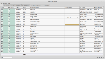

I am trying to find out why we statically need 60k of RAM. I have started an optimization branch that omits the various TCP, UDP etc. buffers in favour of pointers that point directly into the ethbuffer. Also makes some memcpy redundant. It's still hierarchical, so ip buffer points into eth buffer and tcp buffer into ip buffer and finally payload buffer into tcp buffer.
https://github.com/jsphuebner/ccs32clar ... ptmization
Ok, mem usage is still 57k so the bulk must be somewhere else

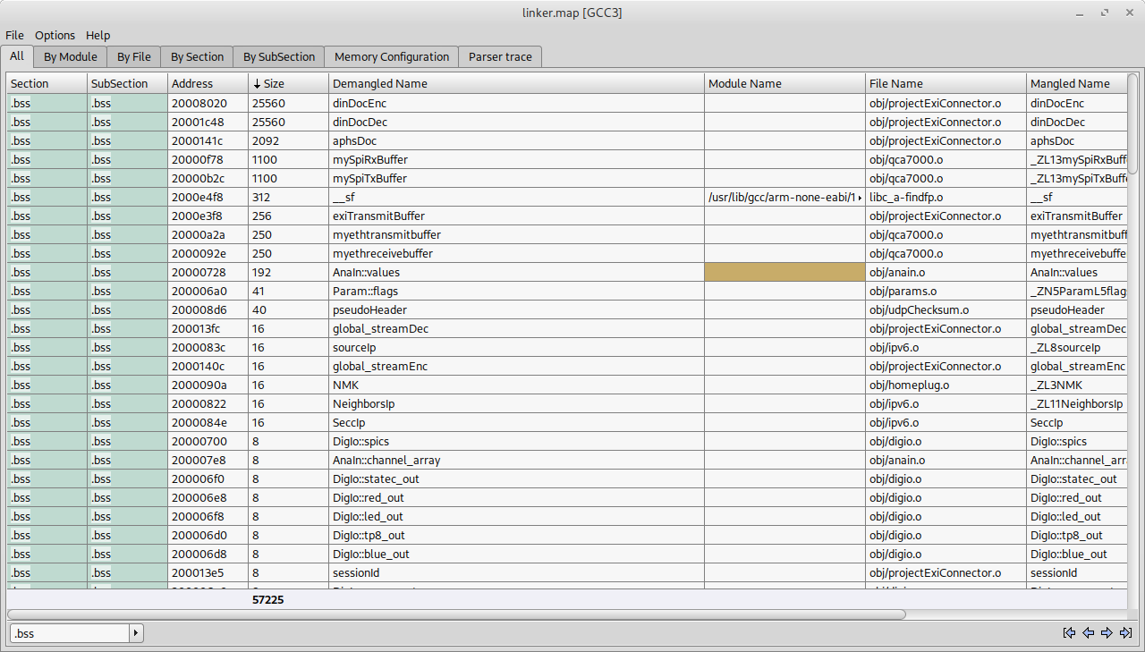

Happy new year. The memory consumption should be visible in the map file, I guess the structures of the exi codec need a lot.
- Posts: 6969
- Has thanked: 455 times
- Been thanked: 1771 times
Re: Develop a QCA7000 board?
Yes you're right, the dinDocs take up 25k each
https://www.sikorskiy.net/info/prj/amap/index.html
I guess that's nothing you want to mess with. "EXI is targeted at embedded systems with a small memory footprint"

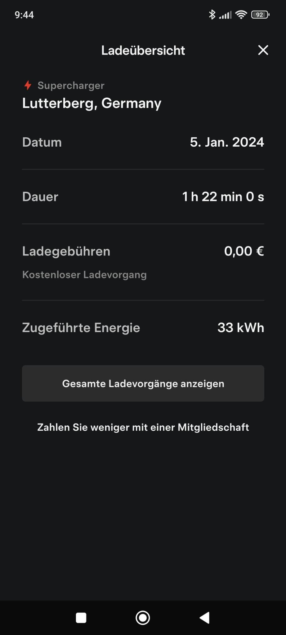

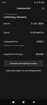

Thanks to our little project here I was able to snatch Elons free energy yesterday
Was in the process of doing a captest of the Nissan battery so that was very convenient
"Zahlen Sie weniger mit eine Mitgliedschaft"!?
do you get money back then?
- uhi22
- Posts: 1143
- Has thanked: 231 times
- Been thanked: 638 times
No, you need to sign the membership before the charging, normally. But we have "Special days" until today: First charge of a new user is free.

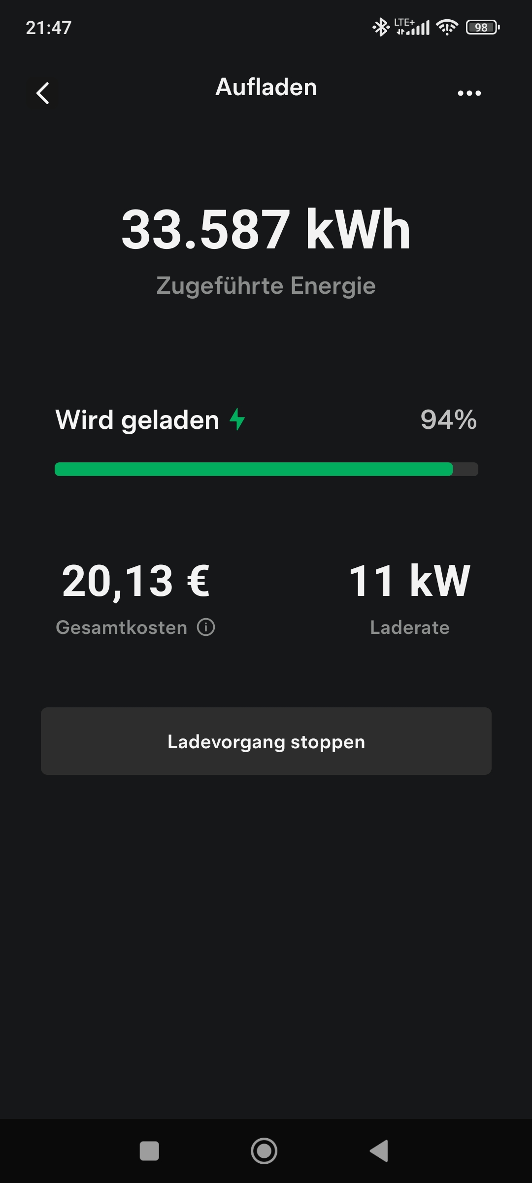

Do not do this at home.

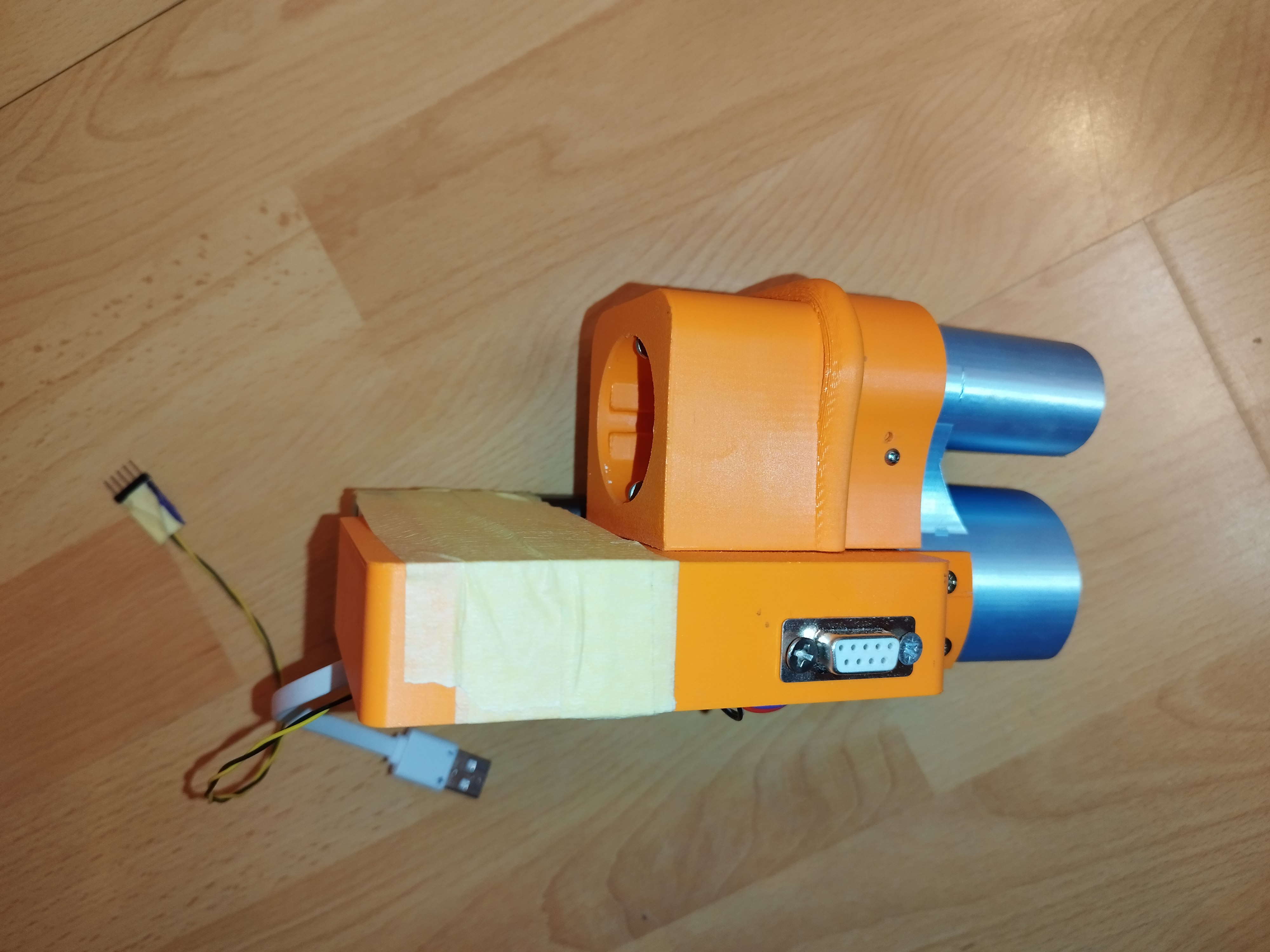

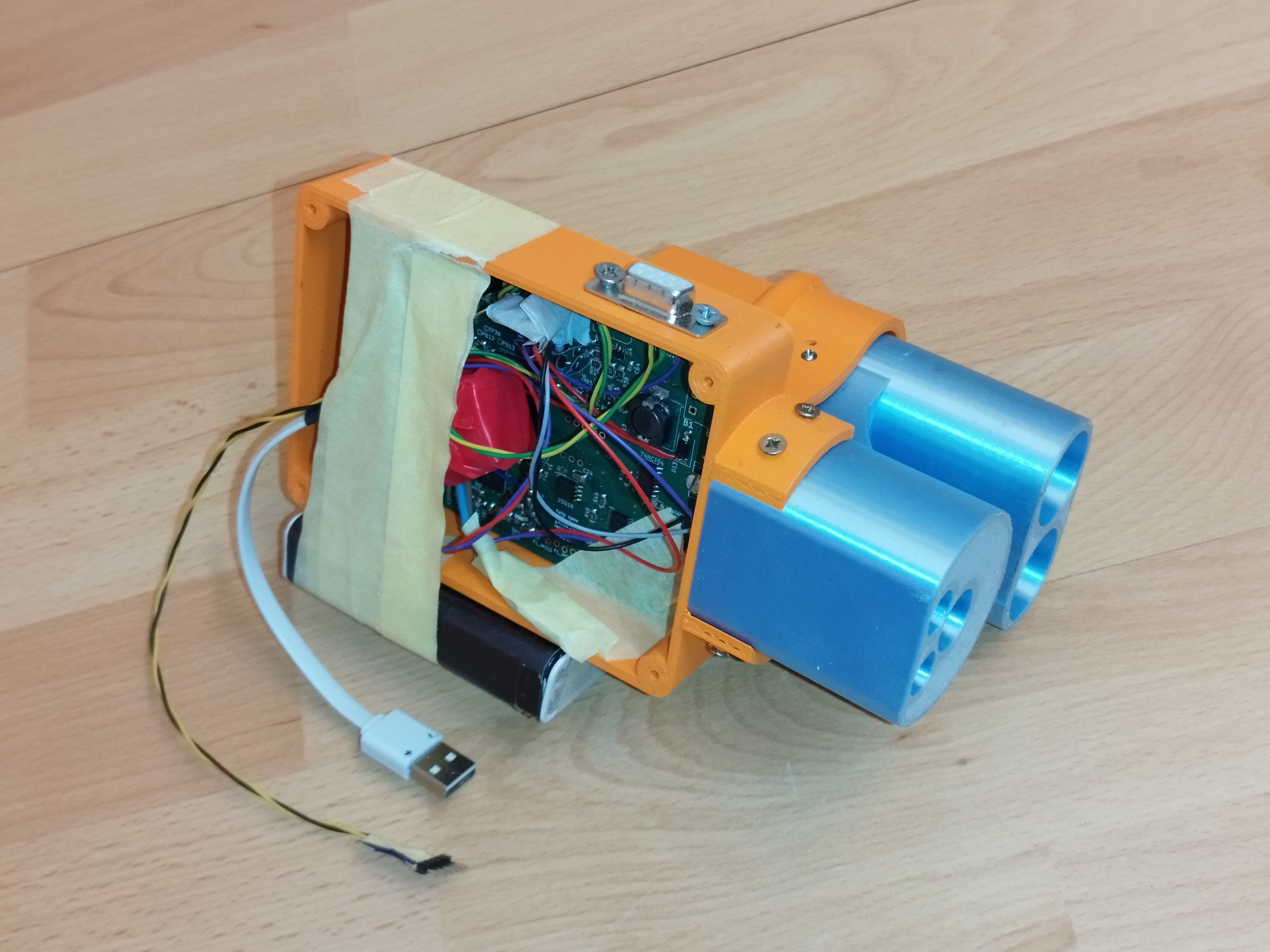

Foccci and Clara live in a box together with CCS2 socket, German "SchuKo" and a power bank. RGB LEDs directly soldered on the board.
Test on Alpitronic worked, but not on Supercharger. Next time will take the laptop for logging.
