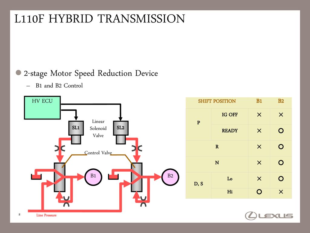

Folks has anyone implemented shifting the high / low gear in the Gs450H gearbox? Would like to implement this in the new vcu project.

I think I've got a working solution but have not tested it in real life yet.
The project code gets a bit more complicated since the system as a whole needs to know what gear you're in. The whole shift sequence has to go something like:
RPM gets to the threshold value (with hysteresis for up/down).
Ensure line pressure is high enough for the shift (from either PB1, 2, or 3)
Set torque request (in HTM data) to zero
Wait a predetermined time (a few ms) to allow the data packet to propagate.
Maybe verify torque response from the MTH data.
Close (or open, depending on shift) both SL1 and SL2
Look for response from PB1, 2, 3 (I forget which two)
Reapply torque gradually over time (a few 10ms)
Record appropriate gear (for speed readout adjustment). I posted the ratio a while ago in here, it's 1.9 vs 3.9.
All the while, SP should be modulating line pressure, with one of the PBs as feedback.
Whether you use MG1 or MG2 for this is up to you. IIRC MG1 reaches its max RPM first, 11000 I think, so maybe set a shift up point at 9000-10000 and a shift down point a thousand or two below the equivalent high gear ratio for shift down.
The transmission defaults to the highest gear (SL1 and 2 not energised).

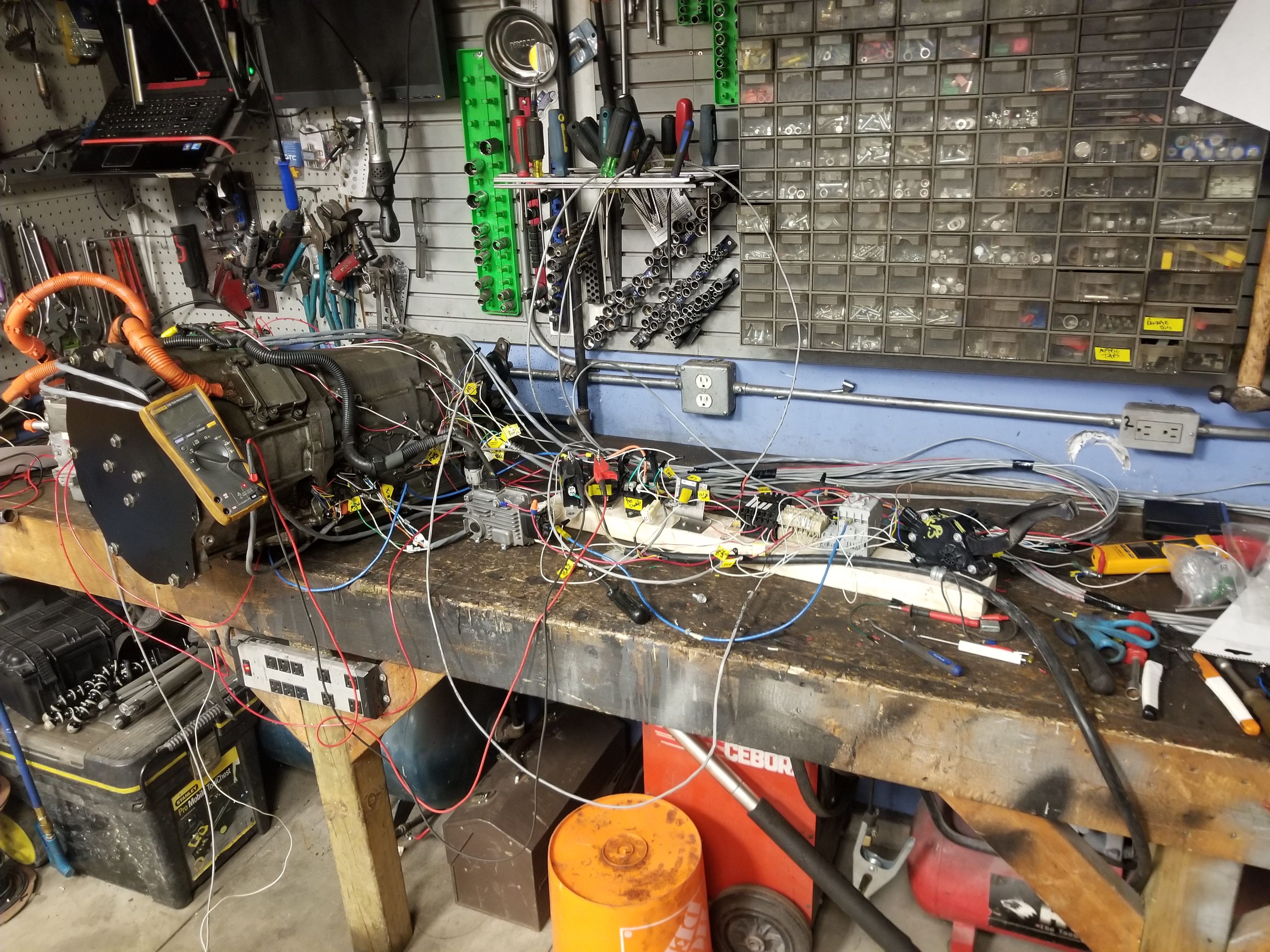

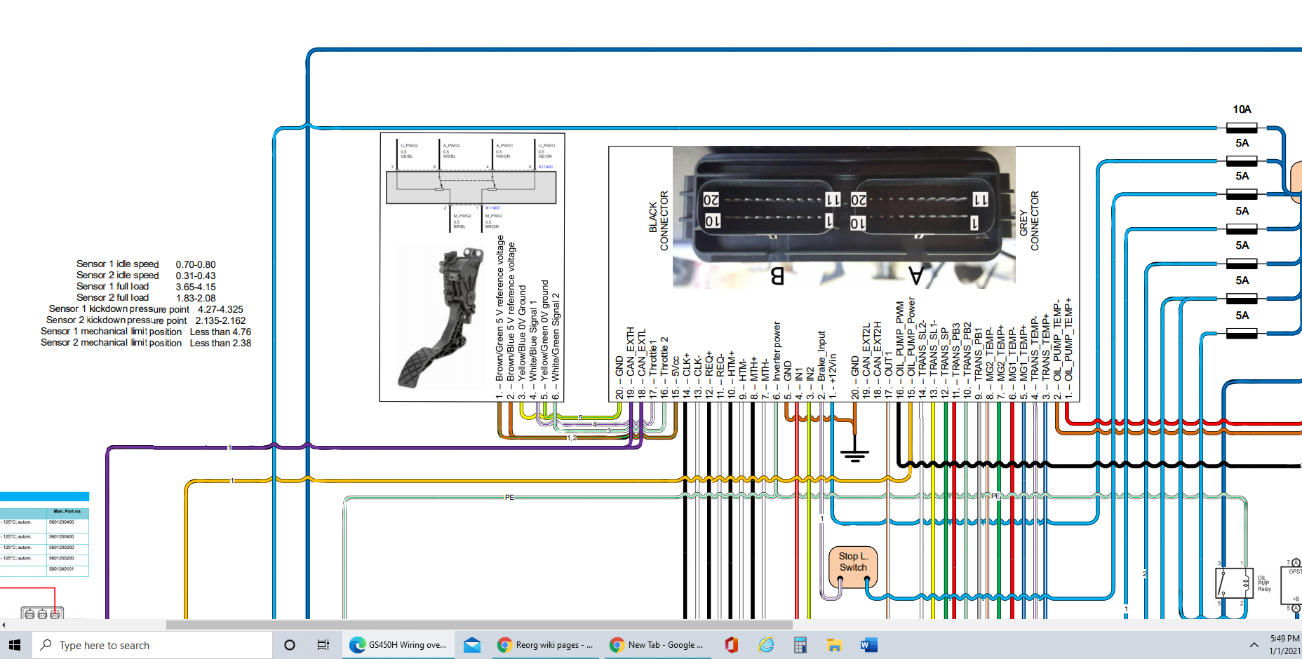

Hi everyone,
started bench test wiring for the 450H transaxle.
I have a question:
from the gas pedal, wire #3 and #5 go to GND pin #20 on the VCU,
Is pin #20 the same as pin #5 GND?

I’ll not had any issues bench testing when supplying the throttle pedal ground via VCU versus another ground. I’ll assume there is a specific reason for the VCU supplying ground versus it being feed elsewhere

You want to avoid there being any unwanted current flowing in the pedal ground or 5V wires, as those currents would fluctuate the pedal output voltage. Thus either use a separate ground and 5V pins or split those wires right where they exit the VCU.

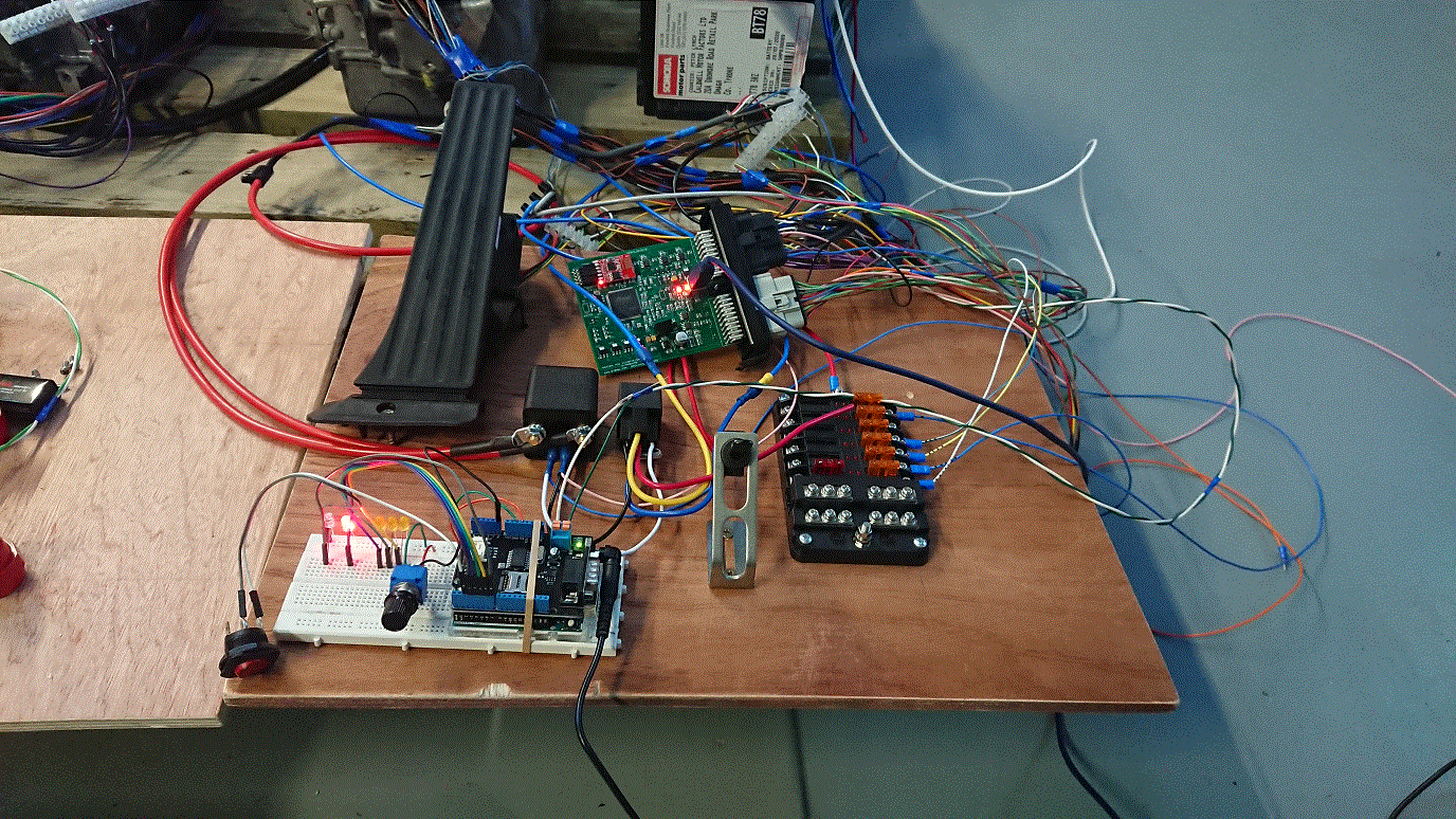

JackK and TonyV, just checking, if using V7 of the GS450 code, are you doing anything to accommodate the CAN messages that code is expecting to receive for the BMW E65 it was intended to work with?
Just recently got my GS450H setups running on the bench. Started with V3 and some light mods to get the motors turning and prove the inverter/transmission was ok before worrying about the oil pump or HVJB.
Moved onto the V7 code but it needs to see some CAN from a BMW E65 to fire up and get gears selected etc. Maybe you've addressed that. I Just put together a basic arduino sketch for an UNO with a Seeed Studio CAN shield to mimic these, ignition on, gears.

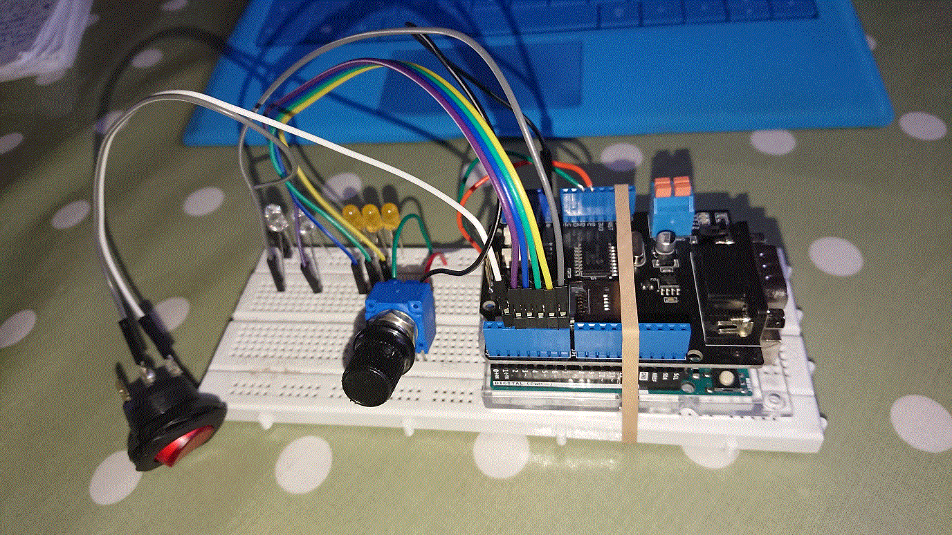

Put up a quick video, might help. Switch for T15 or 'on', pot for rotary gear select - P-R-N-D.

here is my disaster
