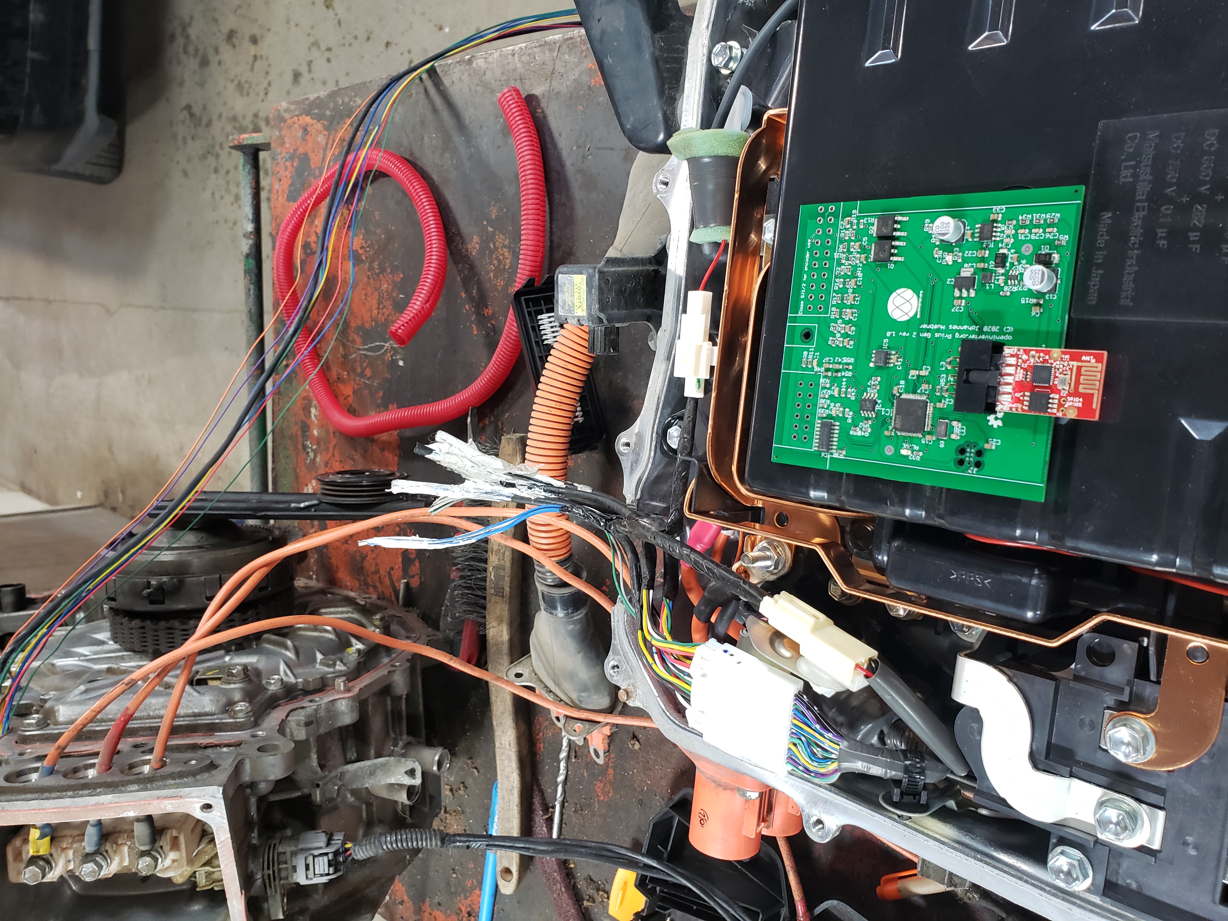

my board is new as of june 2020 and says "openinverter.org prius gen2 rev1.0" (c) 2020 johannes huebner on the silkscreen
im just dizzy from looking at wikis and forums.
surely there is a page showing the pin locations and names of signals for this board?
![Image]()
I purchased from Johannes and the more expensive option whatever that is.

Check the Gen2 Adapter Board link. The pinout sheet is normally with the board too. Mine was stuck to the bottom of the packaging box.
