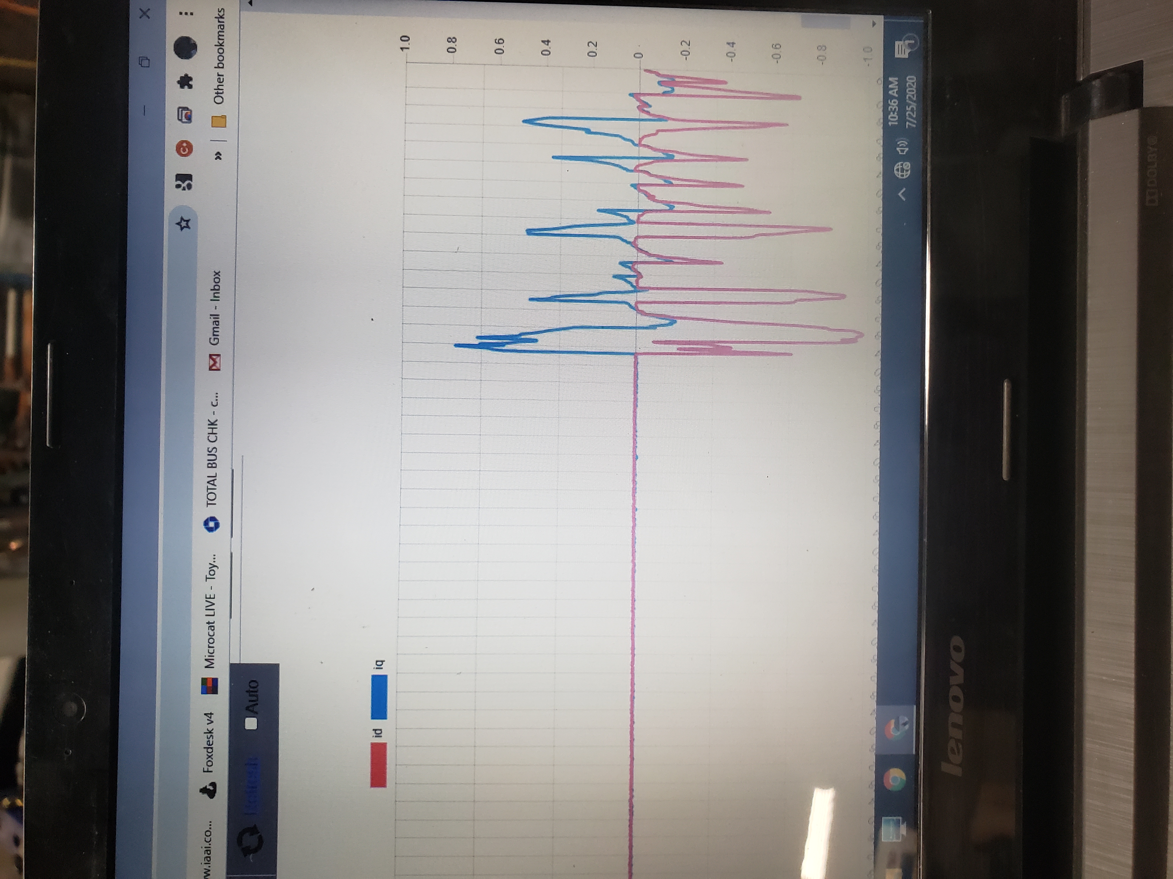

Ive never been so happy to see smoke, apparently its just residual oil burning off , because with continued testing it stopped by itself.
swapped in hardware red and yellow ( sin and cos) then also current swapped 1 and 2.
this is the first time ive got motor movement, and also turning throttle down does not stop it.
moving forward switch off does eventually stop the motor
the priustoric boatcar guy
this is id and iq when this was going on
for what it is worth

Do the wires with smoke coming off of them feel hot (measure with volts off, and caps discharged)?
- Posts: 4003
- Been thanked: 1125 times
Have you done the foc tuning procedure? If not you are probably causing id and iq to fight hence the heating.
- ZooKeeper
- Posts: 526
- Location: USA
- Has thanked: 8 times
- Been thanked: 5 times
May I ask what id and iq stand for? "I" is current, "U" is voltage, but d & q have me and a moderately deep 'net search turned up nothing.
Time for ICE Melt
- SciroccoEV
- Posts: 370
- Location: Luton UK
- Been thanked: 16 times
They stand for the magnetising and torque producing currents, but then you'd know that having watched Johannes' video on field oriented control, wouldn't you?

I am struggling with the FOC tuning... actually melted what might have been an already damaged field winding.
another motor and im back to playing with throttle without manual inverter" on "mode.
should the current be in phase, out of phase, or 120 degrees apart for Il1 and il2

I don't have a Gen2 inverter, but when testing the pinswap function in FOC software I had a similar result if the polarity of the current measurement was wrong.
I think there is a contribution that in the first Gen2 boards there is an error with the polarity of the current measurement reversed and Johannes therefore introduced the parameter pinswap.
With the wrong polarity, the engine turned after starting even at maximum speed and could not be regulated, the lines also got hot.
In manual mode it should be possible to regulate the current, if the polarity is wrong you could not regulate the current, because the limit will not reach.
- Posts: 4003
imwoody36, did you calibrate the current sensors?
um..no..how does one go about doing that?
this is the first time I have heard of that
