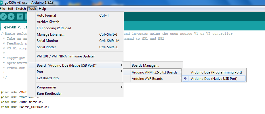

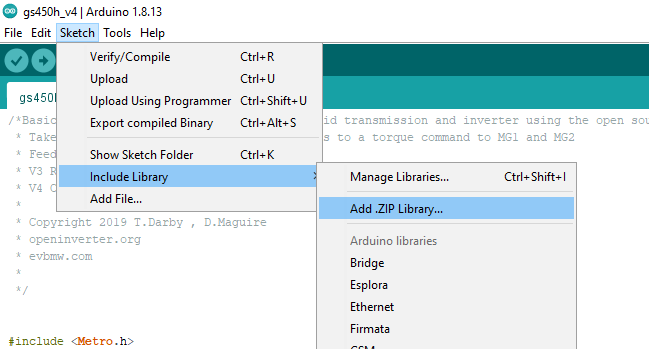

Hello all, I am struggling to get the new V3.01 SW to compile due to missing libraries.
First metro - I found a link to that in the support thread, sorted.
But now I have error due to missing Varient.H and I can't find anywhere I can download that. I assume I will then have the same problem for:
#include <due_wire.h>
#include <Wire_EEPROM.h>
Shown in the code.
I found a post in the thread giving links to these libraries (Copied below). But I can't find the user Collin80 on GIThub anymore.
Any advice on where to find them?
Dan

Can you double-check that you're trying to compile using the correct board type. I've had that error when trying to compile to an uno by accident.
In Tools -> Boards -> Board Manager, search for 'due'. You should get an option called 'Arduino SAM Boards'.
If that's not installed, install it, then choose the arduino due from "Tools -> Boards -> Arduino ARM (Programming Port)" and try again.

I too had "Variant.h" issues.
The problem was I had the wrong Port selected.
Make sure it looks like this.

Click on the links, download the Zip file, Install using Arduino, close Arduino(important step), repeat for each file that comes up as "missing"I found a post in the thread giving links to these libraries (Copied below). But I can't find the user Collin80 on GIThub anymore.
Dan
#include <due_can.h> //https://github.com/collin80/due_can
#include <due_wire.h> //https://github.com/collin80/due_wire
#include <DueTimer.h> //https://github.com/collin80/DueTimer
#include <Wire_EEPROM.h> //https://github.com/collin80/Wire_EEPROM
Install using Arduino's "Include Library" function.
Thanks everyone, I will check everything suggested and somehow the links to the libraries seem to work now, I swear they didn't last night!
Hi, I followed all the instructions and found I had all of your problems, set to Uno board, wrong port and missing libraries!
All done now and successfully uploaded.
Thanks everyone!

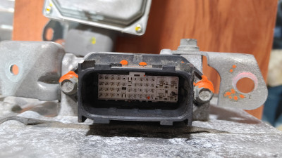

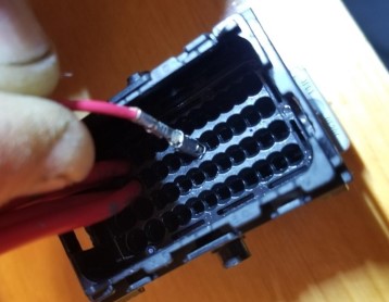

On the wiki page it says, to replace the impossible to find inverter connector you’ll need:
32x 064323-1029 Terminals
and
1x 064320-1311 connector receptacle, but they aren’t compatible as far as I can tell.
The terminals are too large for the receptacle even after removing a layer of plastic and the waterproof seal from the connector.
Could anyone point me on the direction of the right terminals (unless I’m doing something wrong which I probably am)
and

Yup,
I Email Molex about this,
This is their reply.
"The part numbers 0643231029 are indeed compatible with 0643201311, however, there are two different sized openings for the terminals to be inserted into in 0643231029 is only able to be inserted into L1-L4 and M1-M4."
Here is the PDF
Scroll down to the bottom and it lists the crimps that can be used.https://www.molex.com/pdm_docs/sd/643201311_sd.pdf
Here is the PDF
- Will Not Fit. These crimps are for L1-L4 and M1-M4 only.
- Molex connector.jpg (24.18 KiB) Viewed 9246 times

Ok I must be missing something but I ordered two different connectors for this connection on the inverter and both connections off the wiki page don't fit - Also is there not a pinout for this?
What was I doing?
- Posts: 4000
- Been thanked: 1117 times
From the wiki :
Connector Part No. Location
Inverter interface connector (A62) 90980–12630 Black connector on the side of the inverter. This connector is not sold anywhere to our knowledge.
A good alternative to this, otherwise difficult to obtain, connector is to replace the receptacle/header with the following parts from Molex:
Also from the wiki :
https://openinverter.org/wiki/images/c/ ... nector.png
