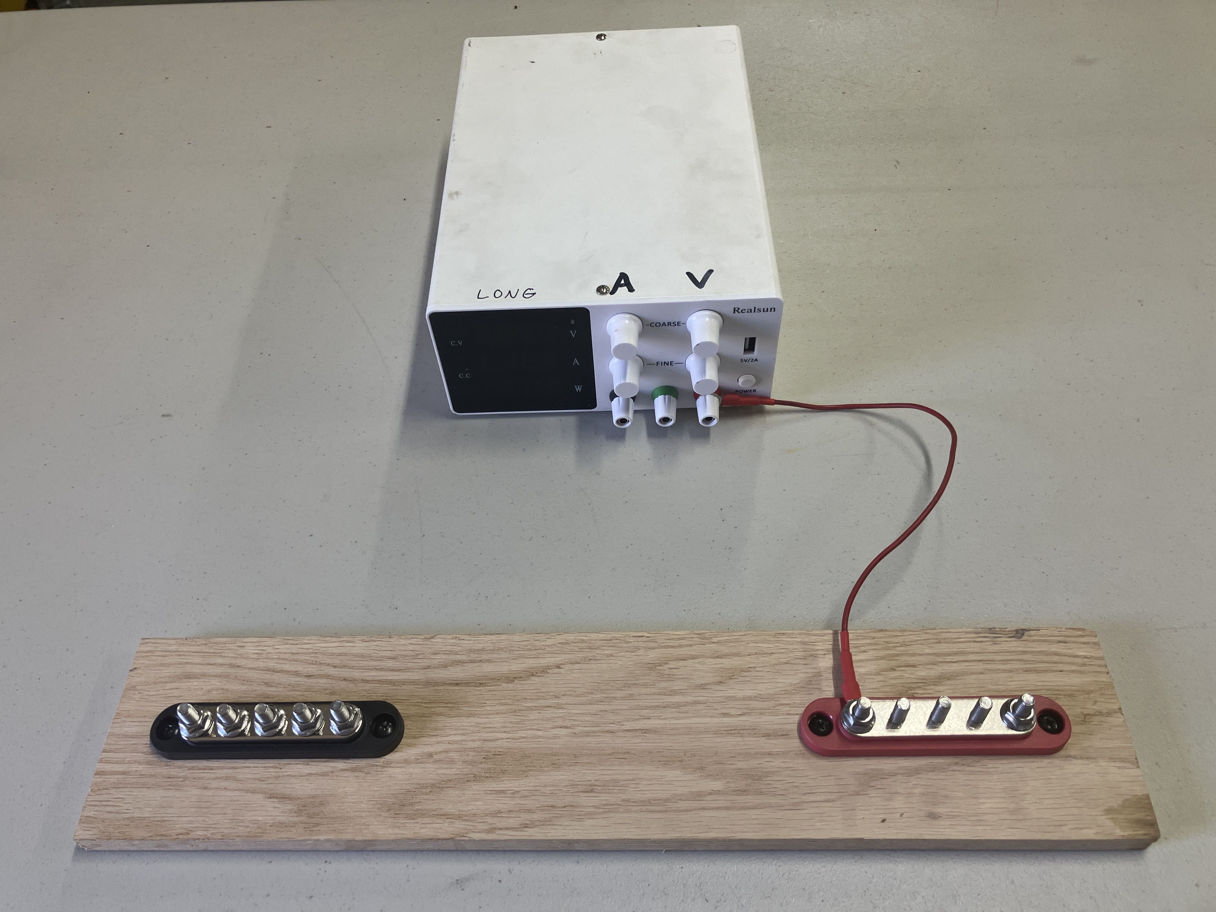

Posted: Tue May 07, 2024 1:27 pm
by Gregski

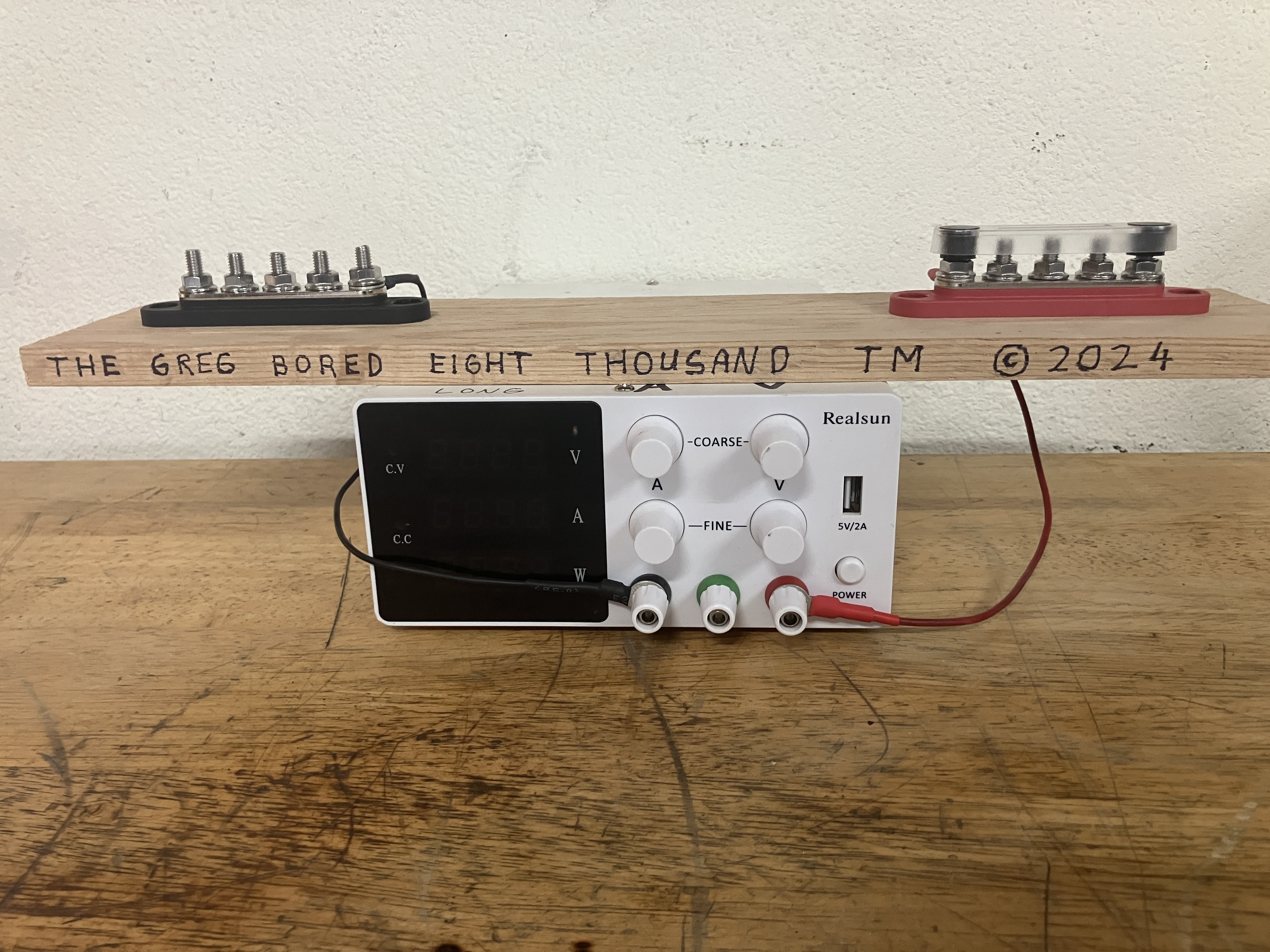

84 VW MK1 Rabbit DIY Wire Harness Fuse Block & BMW Safety Box 2
below the bench power supply on the right is simulating the High Voltage battery pack
Posted: Tue May 07, 2024 5:57 pm
by MattsAwesomeStuff
Gregski wrote: Tue May 07, 2024 1:27 pm84 VW MK1 Rabbit DIY Wire Harness Fuse Block & BMW Safety Box 2 What's going on here, isn't the light bulb the same as a capacitor?
Just taking a swing...
A capacitor is a load, yes. But when it charges up it stays charged.
A light bulb is also a load, but it is continuous. So it's constantly draining the power.
Since you don't actually have a capacitor hooked up, there's no energy reserve. Maybe when your relay toggles, that moment between, the voltage drops and throws the error?
Posted: Tue May 07, 2024 6:21 pm
by Gregski
MattsAwesomeStuff wrote: Tue May 07, 2024 5:57 pm Just taking a swing...
Thanks Matt, per a commentors suggestion I tried lowering the udcsw to 35 volts and that worked, someday I will understand all this but today is not that day

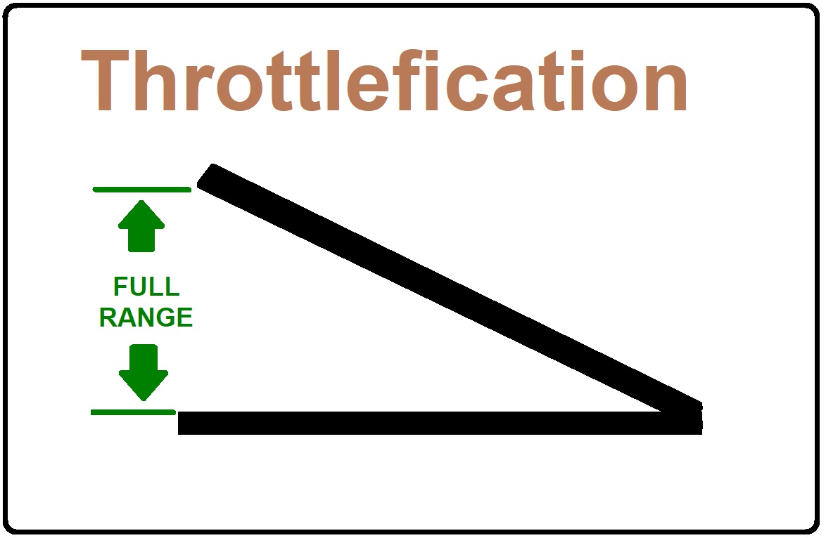

ZombieVerter VCU Throttle Calibration

"Digits" I think is, maybe a poor translation, based on Johannes' feedback to me a few years ago.
In English, digits means how many orders of magnitude. Like, 5927 is 4 digits. 218 is 3 digits. How many columns the number takes up.
"Units" might be a closer meaning.
For example, there are some variables that vary between 0 and 4095. If a variable is currently at 500... that's 500 of what? It doesn't have a unit, (amps, volts, ohms, etc), so its unit... is units.
You can think of it like a percentage, if the percentage went from 0-4095 instead of 0-100. It's a unitless number.
I've never heard anyone describe that in English as "digits", though, I'm only an engineering dropout, so, maybe I'm missing something.

by arber333
Gregski wrote: Fri May 10, 2024 3:18 pm man just when I thought I knew nothing, you remind me that I know even less !
Well nice job with the video...
It is all about sensor resolution. 0 to 4095 means your sensor can see in 12bit increments. 12bit is greater parts than 10bit. This means your full sensor resolution is divided into 4095 indivdual parts which are referenced by the chip Aref pin. This pin wil see the full value from 0 to Vref (can be 3V3 on some chips and 5V on others...) so thats your analog sensor input pin can comfortably divide its 12bit array to 4095 of same pieces of cake.
When you move thottle your analog pin will see changes in voltage but its comparator will see how many of those parts you ran through with voltage :). Those parts will turn from 0 to 1 and this will mean something which was predetermined in code. Normally result is in % throttle, but it could be in Nm of torque or CAN bus command etc...
When you calibrate throttle you set the area within those 4095 parts where throttle is active. For example if you use 5V reference, but your throttle can only show from 0.8V to 4.2V you calibrate that area with some overhead to eliminate jumpiness. Say calibrate from 0.85V to 3.99V. This will then mean 0 to 100% throttle motion, everything else will be ignored. This may mean you cant utilize full 4095 pieces of cake but only 3200. Still it is plenty enough for detecting throttle changes.
Posted: Fri May 10, 2024 10:11 pm
arber333 wrote: Fri May 10, 2024 9:02 pmfrom 0.8V to 4.2V you calibrate that area with some overhead to eliminate jumpiness. Say calibrate from 0.85V to 3.99V. This will then mean 0 to 100% throttle motion, everything else will be ignored.
In the original setup documentation, the notes say that you're supposed to calibrate the throttle to be a "little less than, and a little more than" the actual measurements.
And I asked, and got no reply, as to whether that should've been smaller net range or larger net range. The wording was ambiguous, like saying "Traffic lights tell you whether to stop or go", yes but WHICH tells you to stop and which tells you to go? You haven't delivered the critical piece of information. The throttle should be a little less and a little more. Okay, but in what way?
If throttle was 1.0v to 4.0v ... do I set it to 0.9v-4.1v? Or do I set it to 1.1v-3.9v? Greg shows we narrow the net range, so the latter.
My concern here, several years ago, based on what Arber said, was... in what way does it ignore it? Like, if my pedal is 1.0v to 4.0v ... and I set it 1.1v to 3.9v ... what happens when I put the pedal to the metal? What happens when I cross past 3.9v? Does my throttle suddenly die because I bottomed it out at 4.0v?
Do I actually set the throttle like a parallelegram, 1.1v to 4.1v?

Posted: Sat May 11, 2024 8:52 am
by arber333
MattsAwesomeStuff wrote: Fri May 10, 2024 10:11 pm ...
If the program in the VCU is set correctly you cant calibrate lesser value than your sensor is showing. You are seeing 0.8V low and 4.2 full and you cant measure 0.6V unless you do something directly to the sensor circuit. When you calibrate you put your foot on the pedal only slightly so you show VCU where your preset 0% is Not natural 0 but preset 0!
Then you push the pedal full and show VCU where the 100% is set. Because of pedal geometry this could be less than 4.2V but never more since the op amp inside the pedal can only go so far.
When you go past 3.9V with full throttle analog sensor will still read say 4030 value but since you set the limits by calibrating code then 100% value ends with 3.9V or translated 3980 into 12bit pieces. VCU will know you are past the value but will only output up to the 100% value. An equivalent of mechanical door stop if you will.
I have throttle reading set at 1.6V to 4.0V in my Mazda just because pedal geometry works that way. And it still works good.
The way Aot93 programmed VCU is to take motor RPM and pedal position and produce torque request. This means my throttle position is made of only 21 pices of cake!!! And it still works rather well.
