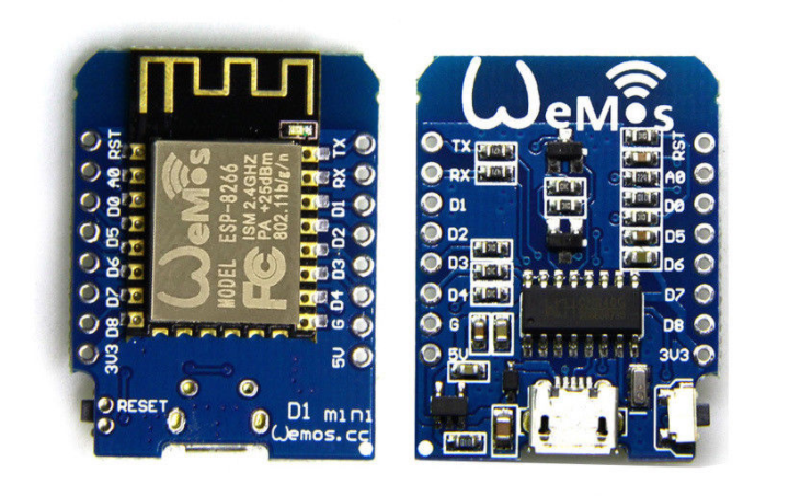

Pre-compiled binaries for the ESP web interface?
Hey Mr. Bauer. Greetings from Oregon. I've been supporting you on Patreon over the year from hell, and I bought the full assembled VCU kit last June 2020. Well it's been a LONG year, but I'm almost done with my project. One thing that I'm struggling with, is the WI-FI.
I'm not super happy with the strength of the wi-fi signal from the Olimex ESP8266 board once it's inside the CINCH enclosure and that is mounted where I want it down behind the vehicle firewall. I've installed this in a 1964 Mercedes-Benz Sedan. I know the bodies on these old tanks are much thicker steel than the newer BMW's. The way I have it mounted, the VCU wi-fi connection drops out frequently (I should say, always) on my Android tablet that I intend to use for the dash. If I'm outside the car, fine. When the thing is mounted in the cockpit of the car, no joy.
So, on the suggestion of the internets, I've got a Wemos D1 Mini that I would like to experiment with, to see if the signal is better. I've read other places online that these boards have a stronger wifi broadcast signal. This seems to be all I need.
Will you, or somebody, please provide me with updated binaries here, so I can flash the web-interface software onto my D1 Mini with esptool.py. Anyone? I've struggled so much with the damned Arduino IDE. It seems so simple, but I just can't get the damn thing to compile!
I'm so very close to having this thing rolling.
Thank you all so very much!

Did you program the wifi module? They don't just work out of the box.

Assume that was a reply intended for me?Jack Bauer wrote: ↑Mon Apr 12, 2021 7:31 pm As much as I'd like to help I don't know much of anything about the wemos.
I'm not asking for help with the Wemos. I'm requesting pre-compiled binaries of the l̶i̶t̶t̶l̶e̶F̶S̶ SPIFFS and web interface, so I can flash them onto a Wemos and hopefully solve the weak wi-fi problem.
Corrections:.
Trying to use a Wemos D1 Mini, bought several dozen of these few years ago. Looks like the photo. It has the larger ESP8266MOD wi-fi module. The units being sold now, have a cheaper design, less robust wi-fi module implementation. If anybody wan't one of the older design, PM me. I have tons. Spec:
https://www.wemos.cc/en/latest/d1/d1_mini.html
Schematic:
https://www.wemos.cc/en/latest/_static/ ... v1.0.0.pdf
Upon closer inspection, it appears that the VCU is sill using the now deprecated SPIFFS, and not littleFS, like the other wifi implementations in the community. Arduino IDE warns about this at compile time. Questions for the community; Should this be updated?
https://github.com/damienmaguire/Lexus- ... V1.ino#L25

Thank you, that answers my initial question! For those buying the partial board, the web interface will not work without programming the wifi module (also there is no part number anywhere that I could find listing the needed ESP8266 module). I will need to do additional research to figure out how to program the wifi module. I would have bought the kit had I known that. I thought the difference between the partial board and the kit was merely sourcing and soldering the additional components. That is not a complaint, mind you! Just a piece of info I wasn't aware of.Jack Bauer wrote: ↑Mon Apr 12, 2021 7:28 pm Did you program the wifi module? They don't just work out of the box.
Is it possible to buy a programmed wifi module from you?

@bassmobile ah yes I know the part now. Understand the frustration with getting the things to program. It took me forever to get it to just work. If there is a binary of some type I'll of course be happy to share. Regards upgrading the wifi firmware I'm not focused on that myself perhaps the community can step in? My focus now is getting the zombieverter vcu up and running and kicking that system back to the sam3 so we all use the openinverter wifi interface.

I think this is it: MOD-WIFI-ESP8266 by olimex.PatrcioEV-ATX wrote: ↑Mon Apr 12, 2021 9:58 pmThank you, that answers my initial question! For those buying the partial board, the web interface will not work without programming the wifi module (also there is no part number anywhere that I could find listing the needed ESP8266 module).Jack Bauer wrote: ↑Mon Apr 12, 2021 7:28 pm Did you program the wifi module? They don't just work out of the box.

viewtopic.php?p=20#p20Jack Bauer wrote: ↑Tue Apr 13, 2021 8:15 am @bassmobile ah yes I know the part now. Understand the frustration with getting the things to program. It took me forever to get it to just work. If there is a binary of some type I'll of course be happy to share.
This thread / post refers to two binaries. One is the file-system, in the GS450VCU's case it would be a SPIFFS .bin, and the other .bin is the actual firmware. I think these BIN can be exported from the Arduino IDE. Anyone care to contribute these?!
Fully understood. Appreciate the reply. I guess updating the gs450vcu webinterface isn't really high priority, and it will be abandoned maybe. Still, I've updated the original post, posing the question to the community about updating the web-interface to LittleFS.Jack Bauer wrote: ↑Tue Apr 13, 2021 8:15 am Regards upgrading the wifi firmware I'm not focused on that myself perhaps the community can step in? My focus now is getting the zombieverter vcu up and running and kicking that system back to the sam3 so we all use the openinverter wifi interface.
Maybe dima or someone else who is knowledgable will chime in and lend a hand with the .bins i'm requesting and other such. I still have not found them, nor figured out a solution for programming the interface onto the Wemos D1.
