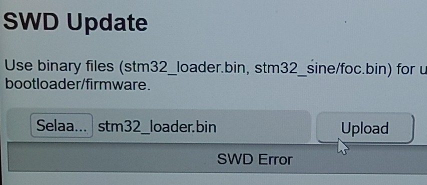

It says SWD error here:
No luck updating from wifi here
My stm32 is as cold as the pcb next to it. :mrgreen:

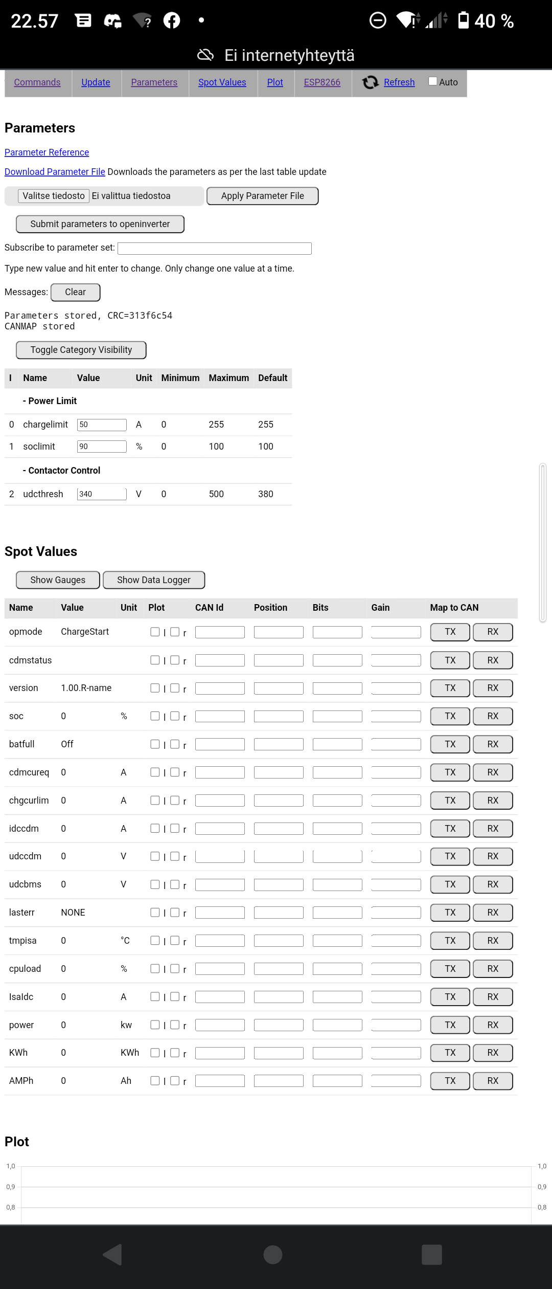

:idea: After last post, I did this: :idea:
Unplug the esp8266 from VCU
Connect st-link to swdprog on ISA FC VCU V2
Plug in st-link to PC
open st-link software
Select address 0x08000000
Open: https://github.com/jsphuebner/tumanako- ... loader.hex
Ctrl+P (target, program & verify)
Select address 0x08001000
Open: https://github.com/damienmaguire/Chadem ... hademo.hex
Ctrl+D (target, disconnect)
Unplug ONLY clock and data wire from VCU
Plug in the esp8266 to VCU
Plug back the st-link USB to PC. (Powering VCU from stlink 3.3v)
Connect phone/PC to esp8266 wifi
And now I have parameters!
Whee! it looks like it's working !

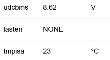

Whee, the IVT-S spits out 0x512 - 0x528 messages on CAN to MCP2515, to Arduino nano, to Laptop :D
In theory, I should get this working since all parts say "hello" now!
Had to put CAN receiver to 1000kbps like someone on the wiki had to do too.

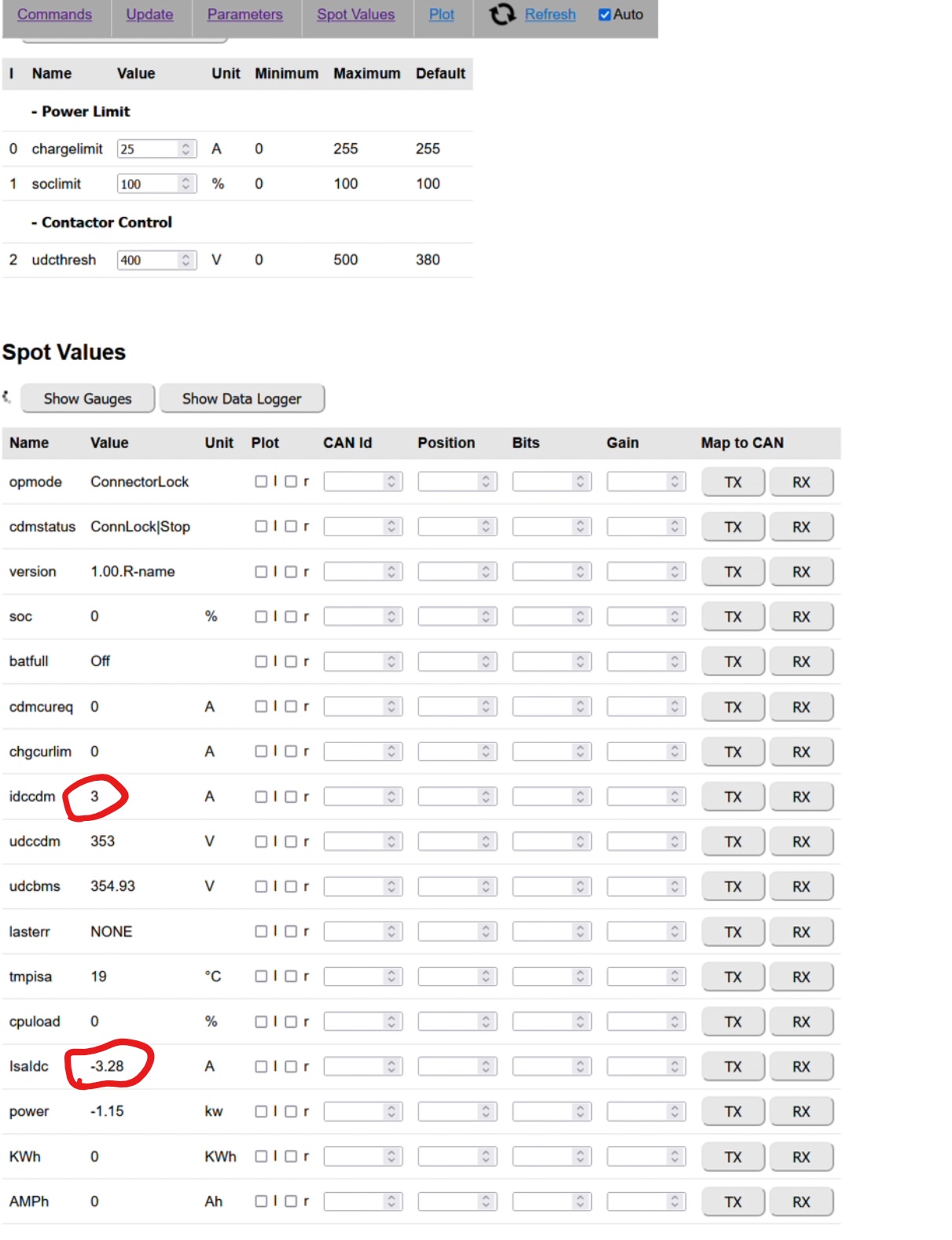

Looking at those, I think the issue has to be the 0A requested, because the station reports the shut down coming from the car side.
Does anyone know what direction the board wants to see current? i.e. right now it reports a negative current when charging using the onboard charger, and a positive when driving. Does the board want to see the reverse? I know the shunt can be changed to report the inverse.

ISA Shunt CAN communications working with the ISA FC VCU V2 (STM32)
Using RC car lipo balance plug and dupont cables to test :mrgreen:
(little offtopic, other board, LEAF VCU (DUE) doesn't show the voltage for some reason, but it also receives the 0x521 to 0x528 frames via CAN from ISA Shunt. But I mainly need the shunt for the chademo part, so I can sort that later.)
Next step here, is to wire the chademo plug and make a contactor box between chademo plug and battery.

I tested again this evening with a lower pack voltage and higher udcthresh, same issue.
Is this (below) discrepancy (positive vs negative) possibly what's causing the shutdown? I looked through the screen record and the frame before the malfunction idccdm (I assume current commanded?) is 3A, so the car claims it is asking for current, albeit only a small amount, just before the malfunction.
