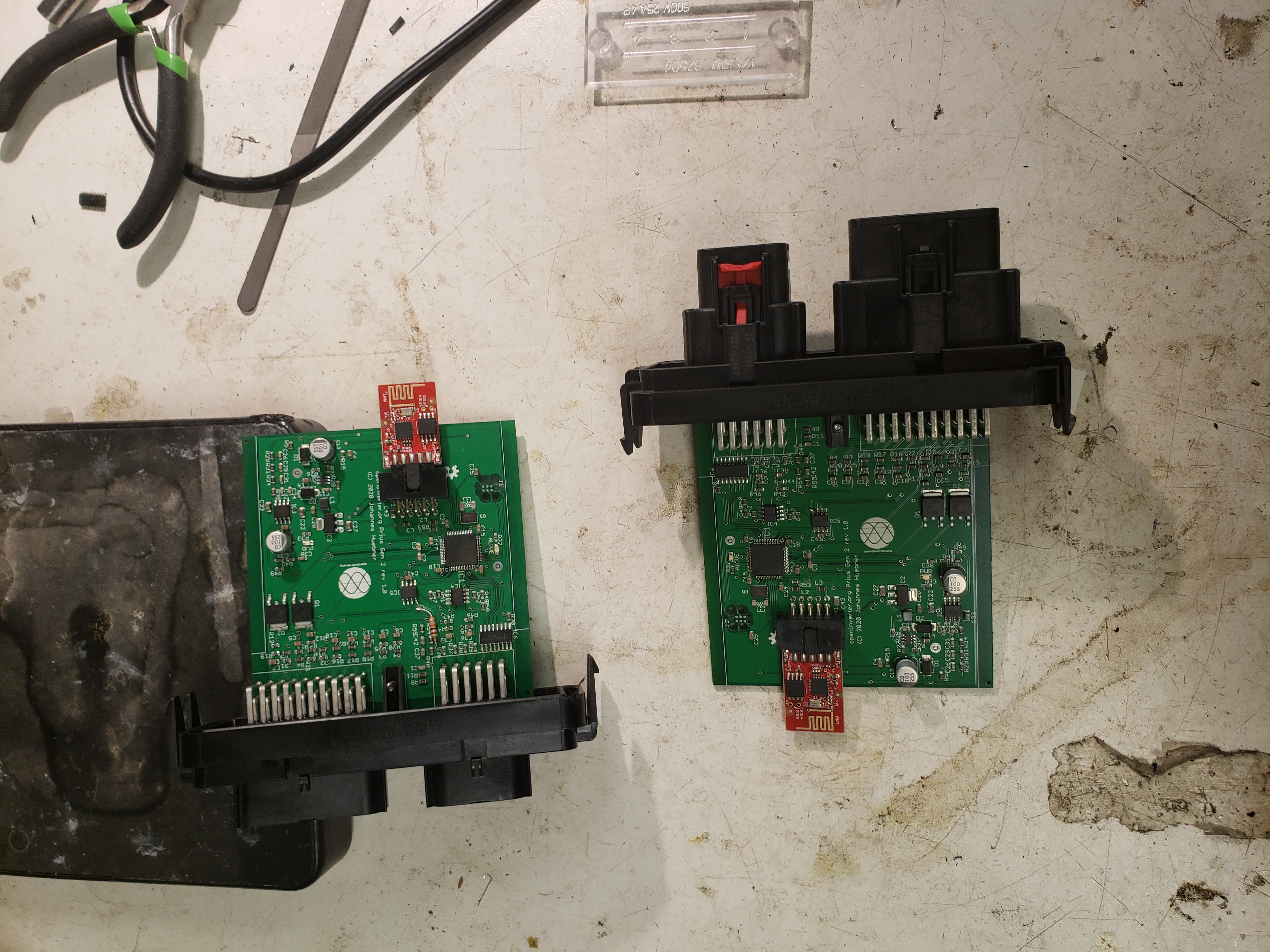

greetings members!, I am back after driving to Florida and back to pick up a spare inverter board that I own, and related prius work.
( including installing a leaf motor in a boat on another thread, and another tube vid)
in the meantime parts arrived for the original inverter board
uln2003 now replaced and board is turning a gen2 MG1 motor, and FYI the spare board is also giving the same results.
I dont see any PWM signal coming from the driver,so i assume my testing method is wrong and likely in the parameters

Well guys, I think I made a mistake in the documentation. I realized when testing one of my own boards. So in fact inverter PWM is on pins 28, 29 and 30 (per my documentation sheet) or 8, 9, 10 when looking at the 12-pin connector only. On the input of the ULN chip this would be pins 5, 6, 7.
Please try this and report back.
Likewise CPWM signal is found on Pin 31/11 and pin 4 of the ULN
Attached is a corrected documentation sheet.

I have 3 pwm signals now as well.
now tuning commences... will check current again.
