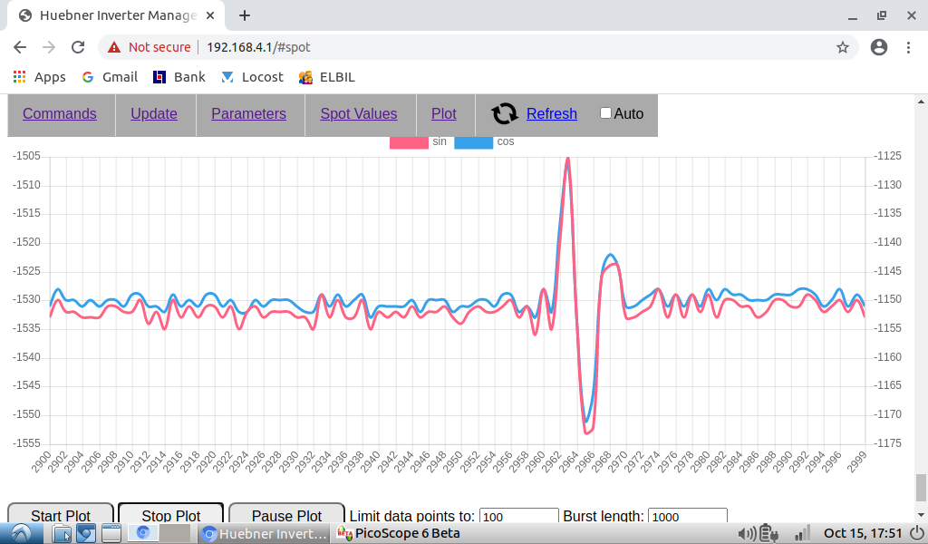

I'm afraid it had no effect on the spikes in angle plot on the Yaris board. :(
Blue is exciter voltage feed to resolver:
Blue is sin and red is cos from resolver, feed to logic board:
Now looking at sin (left) and cos (right) from SW, looks like this most of the time:
But sometimes this apperes:
A sign shift on cos?? How is that even possible?
All measurements done with 330ohm/30nF filters.

Both sin and cos jumps alot between negative and positive values but the angle signal seem fine. If the sampling always occur at the peak of the feedback sin and cos values the measurements presented should be a straight line on or close to the same value all the time when the motor is stationary.
Could it be that sampling point trigger sometimes triggers at rising flank and sometimes at falling flank? As far as angles goes the math results in the same angle so output should be fine anyway.
Regarding spikes in angle plot, to catch them I need to set 10000 data points and 1000 burst length. Then I catch them every time. With less data point I don't always find them.

johu wrote: Fri Oct 16, 2020 6:39 am Ok, so angle all good now, not jittering too much or jumping?
No, sorry to say but I still can find spikes of several degrees, as before.
It depends on what settings I have on the plot window. If I set 10000 data points and 1000 burst length I find them every time. But with setting as above 100 and 10 it usually looks great.
I will do more testing later today.

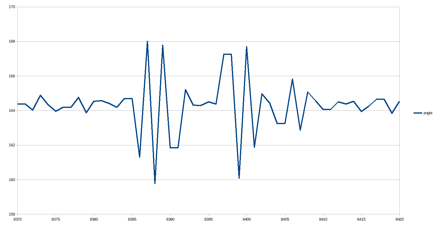

Several plots of angle at a couple of different motor positions.
An overview.
Same position, more detail.
Different position
Different position
The accuracy of the plot window is maybe not the best but to me the spikes all look very similar. To similar to be a coincidence.
I'm still thinking that it might be something more in the ADC.

Re: Large jitter on angle in resolver and sincos mode
Posted: Fri Oct 16, 2020 1:48 pm
by bexander
Excellent!!
Now the results.
First only logging angle to sample every data point possible.
Zoom at first spike.
Zoom at 8th spike.
Remember some points are logged twice, hence the flats.
Posted: Fri Oct 16, 2020 1:57 pm
by bexander
Now sin, cos and angle in the same log. As johu mentions, some data points are missing but all three graphs are in sync.
Angle
Absolute value of sin
Absolute value of cos
Spikes appere in both sin and cos.
