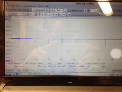

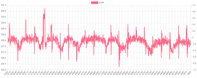

When doing an AC-measurement on C27 and C28 I see a disturbance at 8,8kHz and up to 20mV peak. Amplitude and sign varies with the adjustment of the input voltage at the resolver input. I'm feeding in dc-voltages and using SinCos as encoder setting. The disturbance is for a set input the same sign.
What is running at 8,8kHz on the board? I'm running inverter at 4,4kHz and resolver exciter is not active in SinCos encoder mode.
How can I calculate the time a certain number of data points corresponds to in the angle plot?
EDIT:
When I inhibit PWM by removing my 5V supply to R38 the disturbance is gone on the scope. However the angle output is also stopped. Any way I can inhibit PWM but still get angle output?
EDIT2:

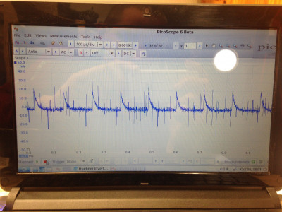

A picture from scope, probe at C27.
EDIT:
EDIT2:

As I'm running on bench in manual mode I don't have any PWM output. And also no change in disturbance frequency when changing PWM frequency.
I've been trying to probe around on the board but still can't find anything creating this signal.
Also, as mentioned before, no exciter output either, as expected, but what else is running at 8,8kHz on the board?

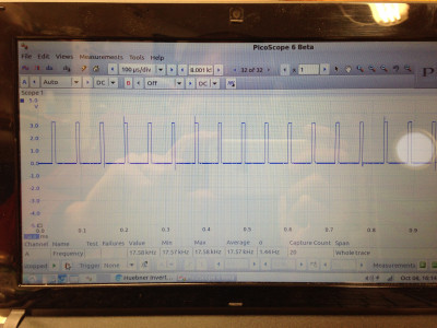

I probed all pin on the stm32.
On pin 61 which is NC but still outputs a signal at 17,7kHz, twice what I'm looking for. Also at pin 14 I found this. Why is there so much disturbance on a signal going to GND via a resistor with the exact frequency I'm searching for?
EDIT:

I get the same behavior at the ADC inputs when running the SW on my blue pill. I have tried different sources of 3,3V for this setup and the result are the same. I think there is a problem in the SW and how the clocks and ADC are setup? I know to little about this micro controller to have any usefull input but the disturbance I can see is at 8,8kHz and goes away if the MG2_PWM_INHIBIT is high.
Any comments on this? Is this possibly a SW issue?

So keep in mind the software runs on numerous devices with resolver and doesn't play up. Please check on github in param_prj.h which version still shows the raw "sin" and "cos" inputs. It was one of the early FOC versions.
Regarding your findings: you discovered the pin that normally generates the PWM for the comparator reference (over current protection). That comparator is not present on the Prius board but the PWM runs anyway.
Also the control loop frequency is always 8.8 kHz regardless the PWM frequency. So you're seeing the ADC sampling but little blips of 20mV will not cause a large angle swing.
When you shut down PWM, the sampling also stops, thats why it looks clean then. Currently I have no idea, I think a software with sin and cos display hopefully reveals the problem.

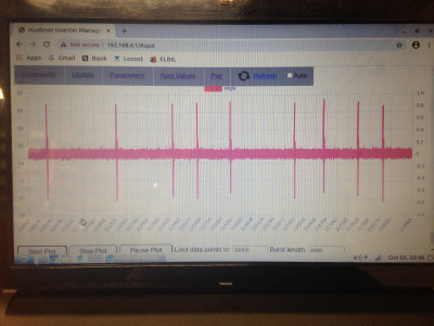

I'm just trying to find out why I have spikes in the angle plot signal. I'm under the impression that the angle signal should move max 1 degree or so and I see spikes in ranges of 10 degrees. Should I just ignore the spikes and move on? Have I created a problem that is not there due to me misunderstanding what should and should not be ok? Would you say that the spikes in angle is not a problem? The reason I started to dig into this is because I'm having trouble finding the syncofs value and it then came to my attention that the spikes in angle plot should not be there.johu wrote: ↑Fri Oct 09, 2020 10:32 pm So keep in mind the software runs on numerous devices with resolver and doesn't play up. Please check on github in param_prj.h which version still shows the raw "sin" and "cos" inputs. It was one of the early FOC versions.
Side note: It does not mean that everyone is experience a problem even though the problem might be there? I find it very odd that I see the same behavior on two very different HW. Almost the only thing the Yaris board and the Bluepill has in common is the SW.
I'm not able to find any SW with the sin and cos param lines not commented out in the param_prj.h? Or have I been looking for the wrong thing?
/* VALUE_ENTRY(sin, "°" ) \
VALUE_ENTRY(cos, "°" ) \*/
I'm agreeing that the 20mV dips on the ADC signal can not be the cause of a 10 degree fluctuation in the angle, when doing the math of how angle is calculated. But question remains, what then can be the cause of the spikes?

But why do I have the same issue with spikes in the angle plot when I run the SW on another board, my blue pill? In my opinion, that suggests it is not the board itself?
Do we all agree that the spikes in the angle plot should not be there and you have not seen them in any of your working boards?

Yes. Could it be your power supply? Are you running a sufficient amplitude into the sin/cos pins? The calculation at some point calculates the quotient sin/cos so if both are small amplitude the SNR decreases.
Absolutely, +/-1° is pretty much the most you should see. Like that little noise floor between the blips.

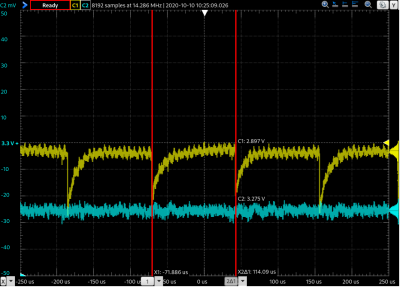

Did some plotting myself.
So with my test setup I'm also getting about 5° jitter. The supply voltage (blue) looks pretty clean (10mV/div) and I'm getting the same blips at 8.8 kHz. I'd say you can roll with that.
EDIT: I will check the angle jitter later in Touran. It has a newer V3 mainboard with the 1 nF filter caps very close to the processor pins. That is also important for you Blue Pill setup to have some capacity close by.

If I understand the math done in SW correctly it would require a pulse of 150mV to get a fault of 5 degree in angle.
Only the spikes I measured at Pin 14 are in this magnitude. This pin is pulled high to 3,3V on the PCB.- bexander

I'm afraid I can't let this problem go, it bothers me to much, so please bare with me.
When searching in the datasheet for the STM I can conclude that there might be a current draw of up to +-1uA when the ADC is used and has an internal resistance of 1kohm. This means, with an external resistance of 10kohm, a total of 11kohm and 1uA. That's 11mV in worst case. The pulses observed are in range of 25mV, which I find odd.
Is the ADC read only once every "control loop turn" i.e. at 8,8kHz?
Also to get the spikes magnitudes seen in angle plot it would require a magnitude of 100-150mV. This can be observed at pin 14, also possible to connect to ADC...? Pin 14 is pulled high to 3,3V via an external 1kohm resistor. To get a voltage drop of 100mV requires 100uA.
In the schematics this pin in annotated "MG2_UVLO_IN_14". If this pin truely is an input, why is there a 100uA current draw every "control loop turn" on this pin?? It makes no sens to me. I'm thinking that something is set as an low output for a short period of time.
I'm stuck on the idea that there is something going on internaly in the uC that causes the spikes seen in angle plot. Since I have tested it on three uC and Johannes also can see similar results it is not just a coincidence. Even if this may or may not have a large effect on the performance of the inverter it is still worth looking into unexplained behaviors. I'm not a programmer so I really struggle understanding where to look in the SW for clues so any pointers on where to start looking is much appreciated.

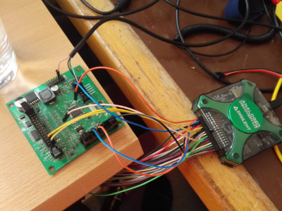

I have tested with the new SW an the "blue pill" and there are spikes in either sin or cos or both matching the spikes in angle, as one could expect.
Sidenote: The sine signal is the one inputed to PA7 and cos is inputed at PA6 without any pinswap selected. According to Damiens schematics (Prius and Yaris boards) it is the other way around.

Then in inc_encoder.cpp PA0 is used as a dummy pin to avoid noise during adc_injection.
Here PA6 and PA7 are set gpio_set_mode(GPIOA, GPIO_MODE_INPUT, GPIO_CNF_INPUT_ANALOG, GPIO6 | GPIO7) but not PA0. Is PA0 still in input_pulldown?? i.e. it pulls down for 1,5 Fadc clock cycles and causing the spikes on this pin and on the other two pins, PA6 and PA7?

Or maybe it is not a SW issue after all... I have found some interesting info on the ADC and that the input filter 10kohm/1nF might have to high impedance. I will make measurements on this and report back. Probably have time on thursday for this.
ADC clock frequency effects what impedance can be used.

Not a bad guess about that PA0 pin, didn't pay too much attention.
is_floating is only called once at startup.

Bexander, I am sending you a fully built and working board. Its the one I used in the FOC tuning video and in a recent video running an MGR. Let's see if this solves your problems.

This PA0 pin caused me much grief when using my hybrid rev2 to rev3 board! Finally i cut the trace which i had connected to OR circuit according to rev2 schematic. That stopped strange OC limit error on start signal.

So here is a firmware where PA0 is configured as analog input in resolver/sincos mode. Please check, I will do the same.
@Arber: yes on Rev2 board PA0 was connected to the AND tree that triggered the timer disable pin. On Rev3 it no longer is and I think Damien isn't using it either. It should just be floating.
