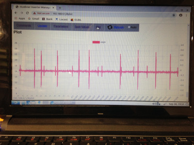

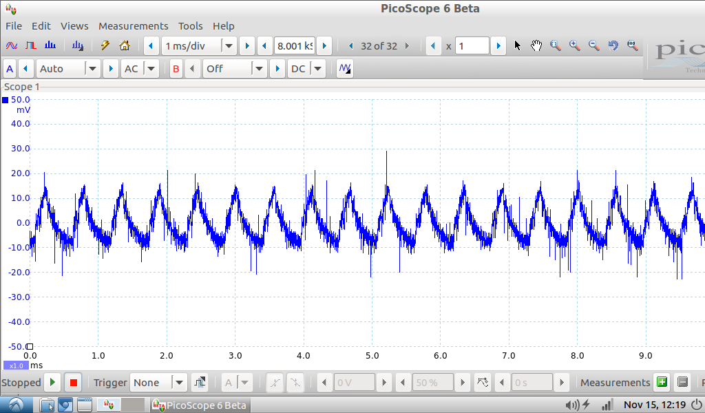

My angle data have spikes when motor at standstill, see picture.
I have a very long (4m) resolver cable as per original from the Lexus it came from. Shielded cable and shield connected to ground in one end.
I have tried moving the cable around without any changes.
Anyone else seen this or have any ideas where to start?

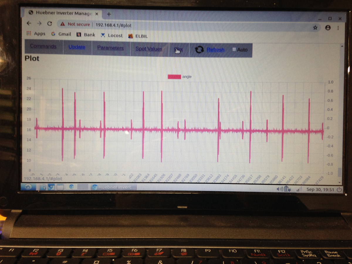

I'm running the inverter alone, with only the resolver connected to the motor. All HV wireing removed. No phase connection to the motor. Inverter powered from a bench supply.
I've tried and tied the motor chassie to the inverter chassie. No improvement.
No matter what I do, I still have the same angle signal with spikes.

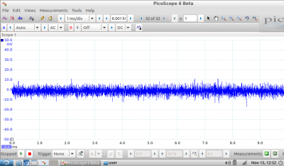

When looking at the resolver feedback signals with a oscilloscope (picoscope 2204A) I can't see any strange things? Probed at C27 and C28 on the logic board.
I would have guessed this was some sort of grounding issue but I can't find it.
Starting to lose my mind over this...

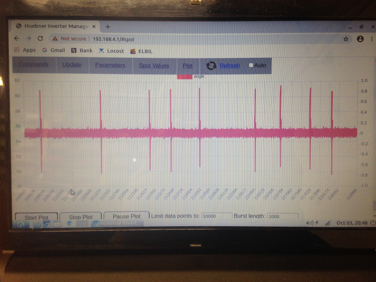

Removed R29 and R30. Sadly, it had no effect on the spikes in angle plot. Anyone have any more ideas?

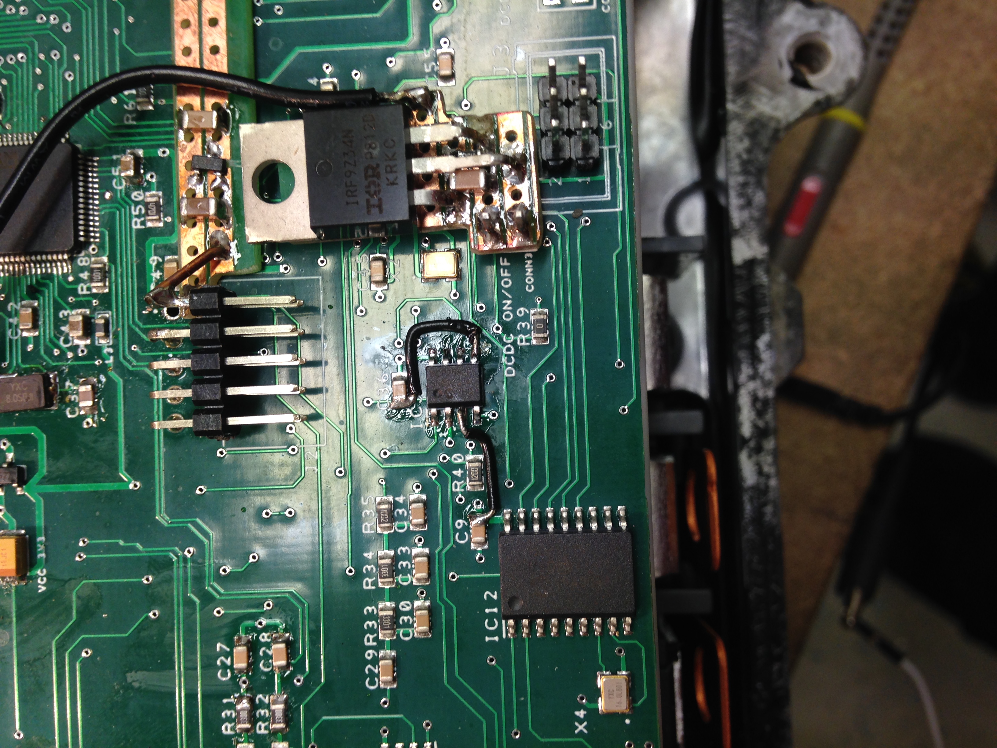

I have disconnected everything between the logic board and the inverter. With a 5V connection to R38 I can start the logic board but I still have the spikes in the angle plot.
I have measured the 3,3V to the STM32 on C44, C50, C51, C53 and most important C43 with a DMM and also checked with the oscilloscope without any findings. However my scope is slow with few samples so not the best for finding voltage spikes.
I'm suspecting that the ADC might have gotten damaged when the 5V pullups (R29 and R30) where in place. The pins should handle 4V as per datasheet and I meausred 3,85V with nothing connected to the input so not alot of margin.
I don't know what I should do next...?

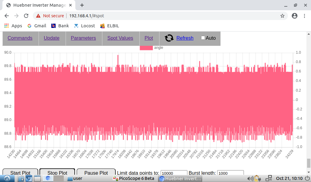

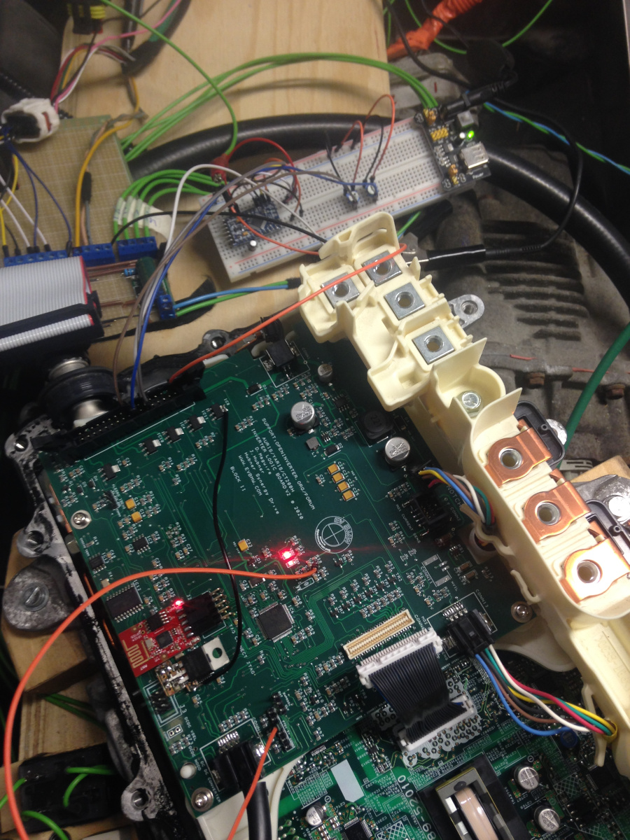

I've switched to SinCos mode and feed some constant voltage of 1V and 3V to the inputs. The resulting angle plot in the picture.
And a picture of the setup.
I noticed that when both inputs are low I get a good angle plot!! so started to do some more measurements and can conclude that when both input voltages are below 0,5V the angle plot is good. Angle jitter is about 0,3 degrees.
When increasing one of the two input voltages to 1V and the other still below 0,5V I get spikes with pk-pk at 3 degrees in angle plot.
When increasing one of the two input voltages to 3V and the other still below 0,5V I get spikes with pk-pk at 9-10 degrees in angle plot.
So there is a voltage dependence on the angle spikes.
Can the flter capacitors C27 and C28 cause this? If they somehow are defect? Seems unlikely.
Otherwise this is most likely caused by the STM32. Or possibly the SW but then more people should experience this.

Re: Toyota Auris and Yaris Inverter Logic board
Sounds resonable and easy to check.
First visual inspection on more time.
I will then desolder the filter caps and measure them as I couldn't measure them inplace.
This also allows me to test again with constant voltages with the caps removed.
If this doesn't work I will replace the 10k filter resistors and check.
If problem persists I can try to feed the signal directly to the STM32 input pins, to exclude any defects in the PCB.
Still a problem, the STM32 needs replacing.
I have tested removed the filter caps and they are both 1,2nF when measured with my DMM.
I have also tried feeding the signal closer to the STM32 (at the capacitor pads) using an external resistor. I don't dare to probe directly at the STM32 pins.
No luck, the fault still remains so I'm down to replacing the STM32. Will look into whats needed to see if I or someone around can do it.
The easiest way I've found to replace leaded components like the STM32 is to use a razor blade or exacto knife to cut all of the leads next to the body, then use a soldering iron with a generous blob of solder to pick the legs off the board. Use solder wick to remove solder from the pads, and then tack down your new part by a couple corner leads after lining it up. This gives you lots of time to adjust. Once you're happy, get lots of flux on the leads and then wipe the leads with lots of solder on the tip of the iron. Once you have a nice shiny joint on all the leads, use your solder wick to take off all the extra solder and voila, you have a nicely soldered QFP micro.
