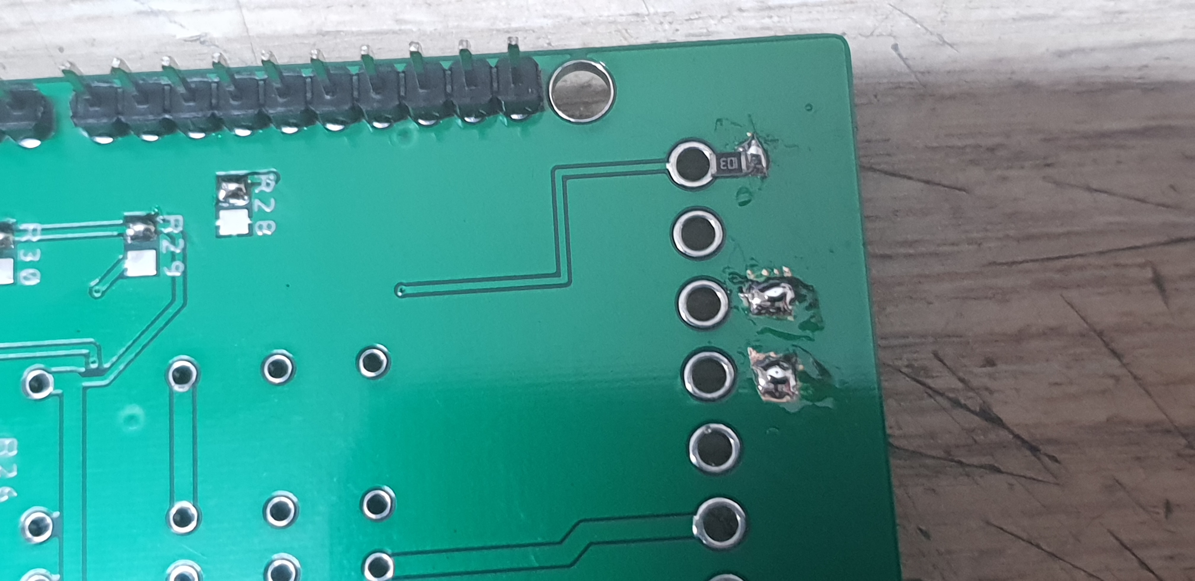

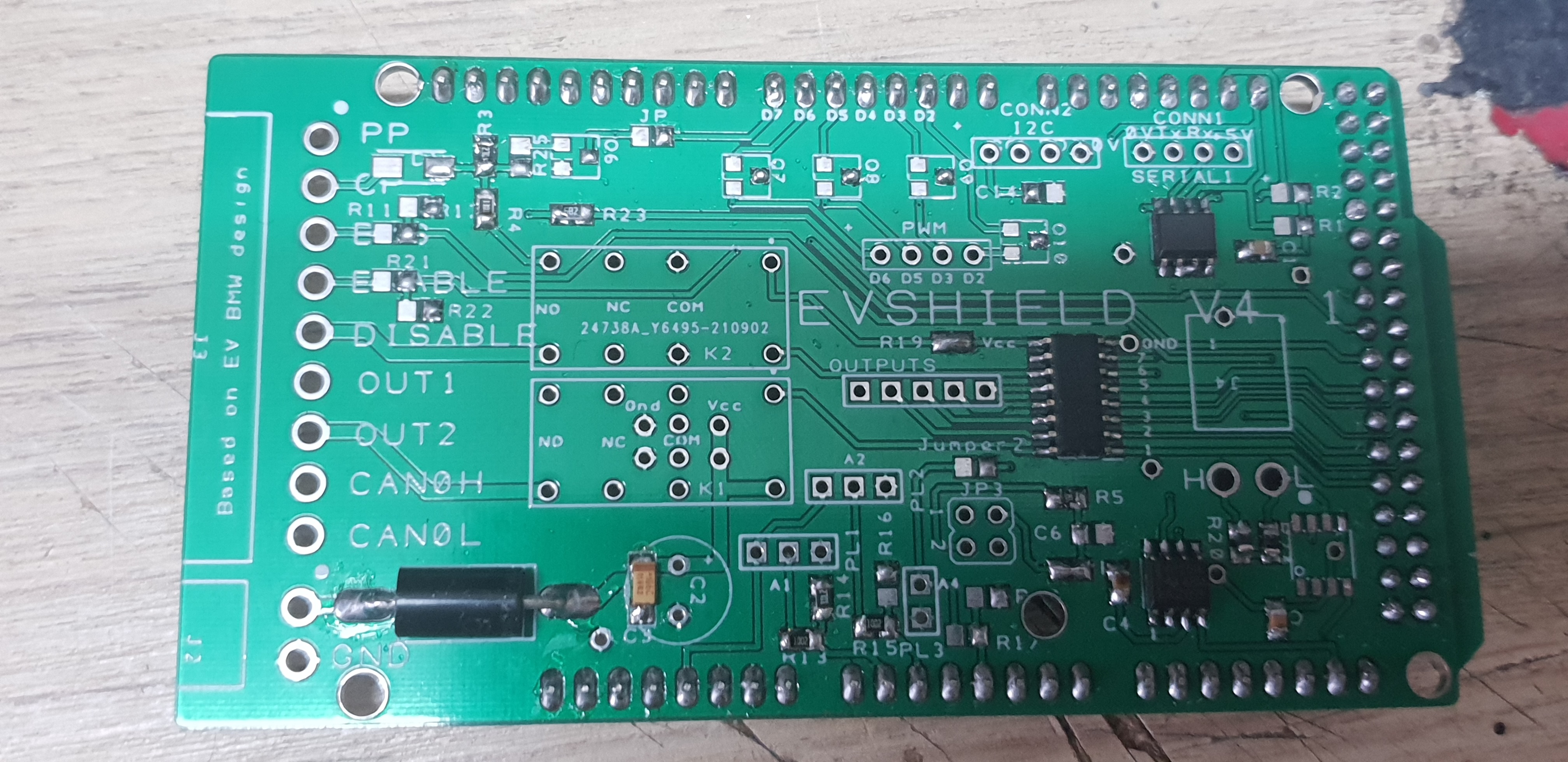

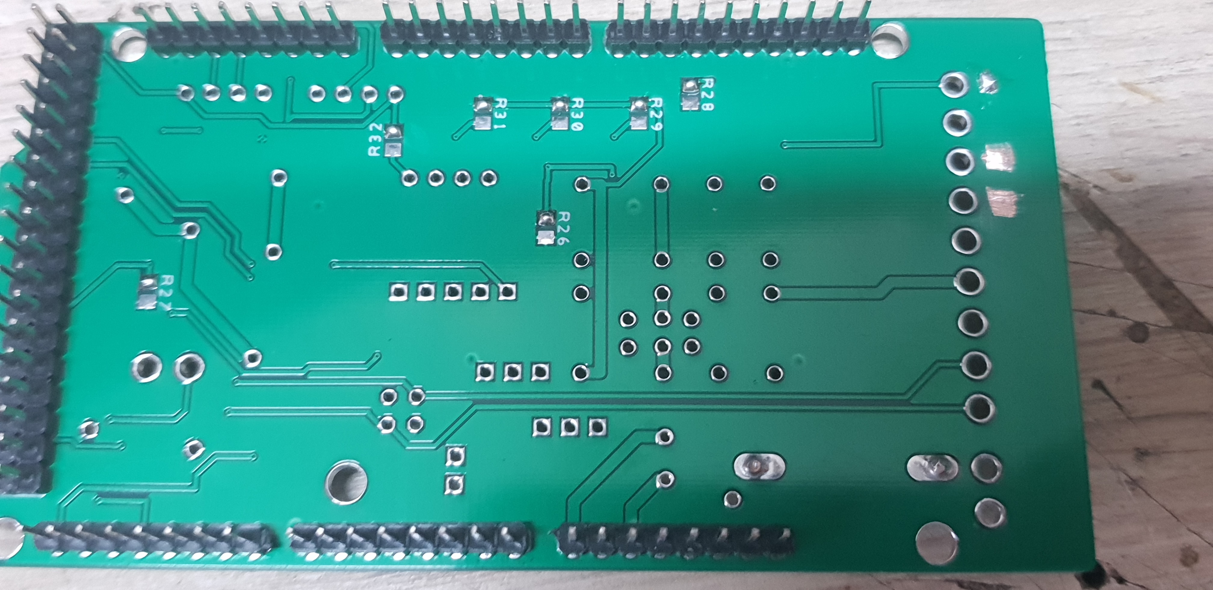

One glitch i discovered with DUE...
Its internal pullup resistors are a joke. I have noticed that during driving sometimes a PP sense pin i use with internal resistor drops from 3V3 and it signals as if EVSE would be plugged in. This causes another pin to command relay to pull in the coolant pump and Notaus switch to disable the car!
Of course when this happens at 130km/h it is exciting :twisted: . Luckily Lebowski has option to fully recover into RPM after chip reset.
Immediate solution for me was to add external 10K resistor to +3V3 plain. This resolved the glitch and i havent had any incident since.
But i urge you to inspect your boards for a solution as it is quite simple. Just scrape some of insulation near the PP pin on the 3V3 plain and solder 0805 resistor there as a pullup. See photos.
Location of pins on the front side
I schratched the layer to expose the copper on the underside where i have 3V3 plane
I soldered 10K resistor from the pin towards 3V3 plane
In future i will correct the design with V4.2 and add additional pullup resistors to all input pins.
https://github.com/arber333/Arduino-Due-CAN-shield
EDIT: I have fixed V4.2 with additional resistors 10K tied to 3V3 and specific pin. To have more freedom i put resistors even to those pins which are set with resistor divider to receive 12V input, just to leave some option of signal polarity. You dont need to populate all of them, just the ones you actually want to use.

Darn! I simply forgot sorry. Now i uploaded photos where you can see how i resolved this.

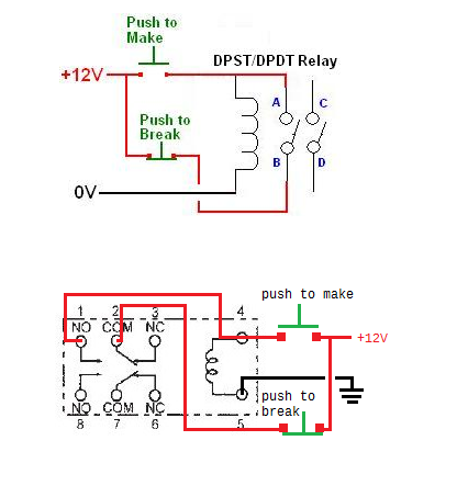

I would recommend this action sequence:
1. Turn ON the key which brings 12V to precharge circuit and latching relay
2. After certain time precharge allows 12V pulse to DC contactor relay circuit.
Now this is DPDT relay that is wired to carry 12V from the key via one set of contacts to the coil, acting as latching relay.
This will keep your DC contactor active even if starting pulse is gone. You can use this with car starter circuit too.
3. To disconnect DC bus you simply return the key to the off position which will remove 12V altogether from the relay. In that case push to break button is not neccessary.

Latching relay is nothing but 2x DPDT relays wired so first one can trigger itself and second one. Then it will keep connection untill 12V power is removed which will happen via car key. The simplest of methods i used in my Mazda back in 2013. Now with more sophisticated control however you can delegate DC contactor "turn on" to your inverter, however "turning off" will again be out of its hands since latching relay will turn off only when you remove 12V power.
Idea is for inverter to pull precharge signal in and after some time trigger DC relay. Then it can turn precharge relay off since its resistor is now bypassed. So you need two signals from inverter. I think your DUE is unnecessary for precharge. You need it for other tasks though. What kind of inverter do you use?

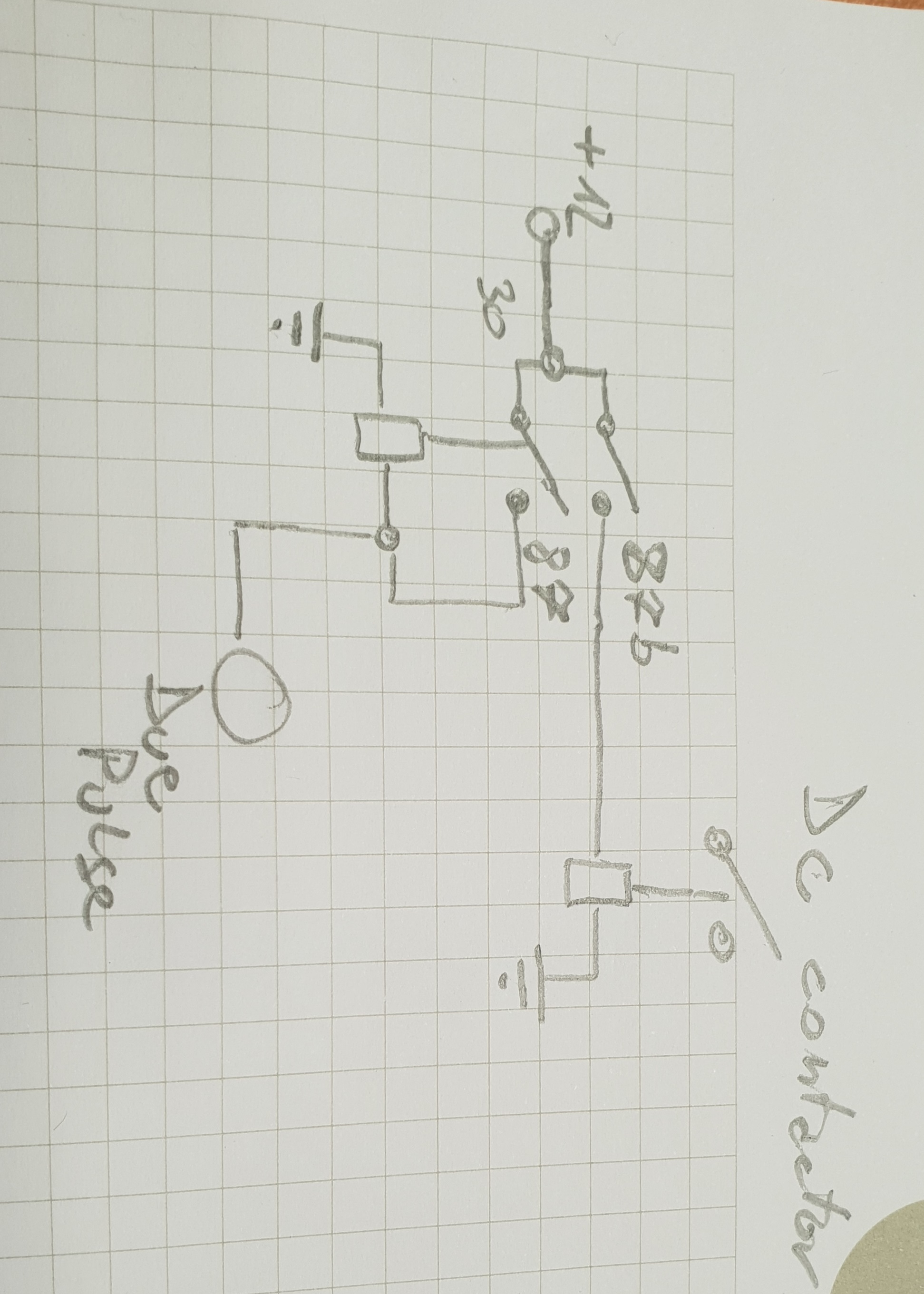

I will draw you a sketch tomorrow...

Well, i dont know about automatic, but close...
See the file sketch.
You will notice i drew one DC contactor with precharge relay and resistor in parallel.
Precharge is run by one Nmos or NPN (ULN2008 ladder), so it can amplify relay up to 500mA.
DCDC contactor could very well be run in the same way, but i recommend you use at least 2 pins of ULN2008 chip in parallel for 1A draw power
Both pins are power neutral. This means they only sink power towards GND and dont care how much votlage is on the other side - up to some sane value...
Latching circuit is simply DPDT relay which uses one complement of its contacts to connect GND to its coil. With that the other side can be connected to 12V. When NPN pulls its collector to GND it will create a circuit through which its contact pair will keep relay latched. First contact pair will then show 12V to DC contactor and keep connection for the remainder of the drive.
If you want to break this you just need to remove 12V from innitial contact. This is why this pin needs to be fused and mechanically actuated. if you would just connect live 12V power you wouldnt be able to break contact at all!
EDIT: You can use "Enable" signal from key to signal DUE (enable input pin) to start precharge process. After 3s DC pin active condition will remove precharge pin and signal DCDC to start.
It can all happen on this condition.
CamScanner 06-06-2022 13.19.pdf
(167.96 KiB) Downloaded 411 times

No! I strongly advise not to use DUE relay as a latching relay. It was not intended as such. Just make a contact fuse box and pull your wires from due there. Use the car key lock contacts to signal "enable" to due. You can use DUE relay to signal 12V to latching relay and you can use other DUE pins to start precharge like i made in the drawing. That is the natural way...
Yes, DUE is powered all the time and in the newer code i implemented watchdog. I have no way of telling if it works, all i can say it doesnt freeze :).
If you want to use more ULN pins in paralell you can just command those pins in code OR you can use only one pin, put a glob of solder on parallel pins and cut the rest of traces...
Hm... good question. I dont use HV- contactor. I have fuse for that...
You could simply use another latching relay (remember, connection needs to be firmly established) which would use a +12V signal from OTHER DUE relay or even directly from KEY ignition. Remember! First you need HV- engaged, then you bring in HV+ across contactor through resistor for precharge to function. What you want is more complicated, but can be done with a good thought to ignition sequence. Put it to paper, it may help you.

Let me explain... i wouldnt trust DUE with anything more than providing starting pulse to a relay. That can be provided by the second relay on DUE board. If you want to latch something you need 1. a +12V pulse to start and 2. a removal of +12V or drain to release. If you want to use DUE to start latching relay that would be OK. So use 12V signal from DUE relay to latch your contactors. But i wouldnt explicitly trust it with release pulse. Its logic might succumb to EMI or simply coding problems. Also 12V is routed to relay on the DUE directly. The only way to release then would be to remove 12V power to DUE itself, not desirable option.
Story short, inverter life depends on it. Release needs to come from the outside at least that is my philosophy. You may try differently, i am just noting the possible shortcomings.
Enable line is sense input from the key 12V. DUE will sense active input via resistor divider and a host of functions need this signal for the "engine running" equivalent signal. If that signal would be missing for example AC compressor control wouldnt function, heater wont work and coolant pump wont start...

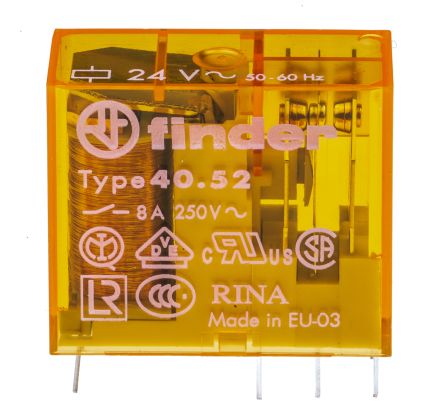

Posts: 3795
Been thanked: 411 times
Re: Arduino DUE VCU with analog and CAN control
Ok last time you asked about a specific relay. I think it was DPST since action happens with dual output pins from a single point.
My circuit for latching...
Dont forget you need to signal pulse 12V to this relay into a contact which will then be latched to 12V.
900
Posts: 55
Joined: Fri Jun 25, 2021 11:10 am
Post by 900 »
arber333 wrote: ↑Thu Jun 09, 2022 5:00 am Ok last time you asked about a specific relay. I think it was DPST since action happens with dual output pins from a single point.
Hi, so you're suggesting to have ground permanently connected to contactor and be switching 12V to contactor with a relay? My thought is to connect a relay to 12v after ignition permanently then be turning ground to relay via ULN2003 chip. Then kill 12V with ignition switch which would remove power to latched relay.
I already tested this relay and it latches. My main concern after seeing your post was the reliability of this little automotive relay during longer drives since it would be holding main contactor. So you're saying it might heat up and stop working reliably? I think I will just use it for latching and holding dcdc contactors.
I was searching for those 24VAC coil relays and found them from finder, so I think for the peace of mind I will go with them. Like this one:
So I tested this 12vdc automotive relay and it indeed gets hot when left connected to 12v dc power. Just as you said. Although it holds contacts when hot I wouldn't feel comfortable using it for such an important task. Going to try 24vac relay now when I get one.
900
Posts: 55
Post by 900 »
arber333 wrote: ↑Thu Jun 09, 2022 5:00 am My circuit for latching...
Meanwhile why I still don't have a 24vac relay I wanted to try this 12vdc automotive one. I wired everything according to your drawing just that I swapped polarity because I'm using Due with your shield to latch it by ULN2003. I connected HV+ contactor to permanent 12v and I'm supplying ground via relay by pin 87b. 87 is looped to ground of the coil. Now when due supplies ground to the coil the relay latches and turns on the contactor. The problem is I cannot unlatch it by removing +12v from the relay coil. The HV+ contactor stays on! What am I not seeing here? Where does the HV+ contactor get the ground from after I remove 12v from the relay coil?
900
Posts: 55
Post by 900 »

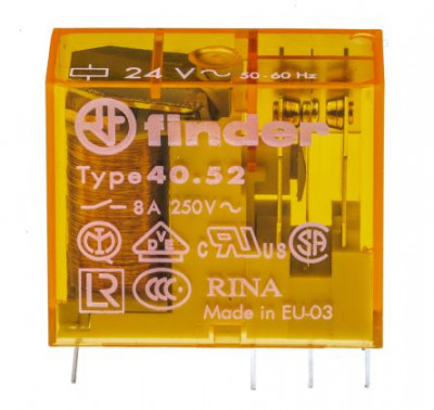

Also what about these relays? Would they be suitable?
