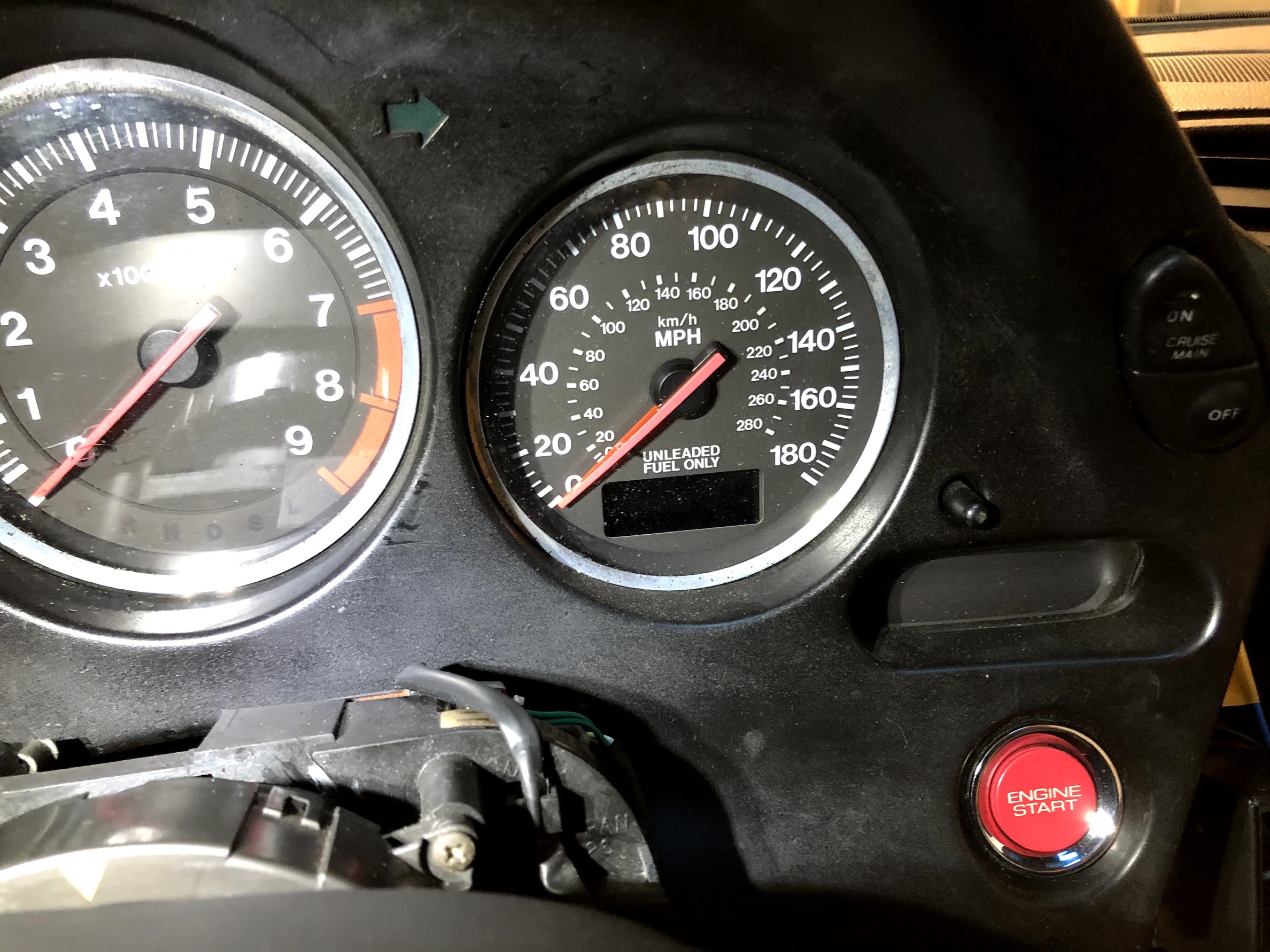

I mounted and wired in an engine start button from a Honda s2000 to send the start signal. I'm sure I overpayed by using one from an s2000 but I have nostalgia because it was my first real sports car.
This mounted in the cigarette lighter hole really easily. I just had to dremel out a few grooves so it would slide in. Wiring was easy as well, I used the existing pos/neg from the cigarette lighter since it is already switched power. Then when pressed it sends 12v out.

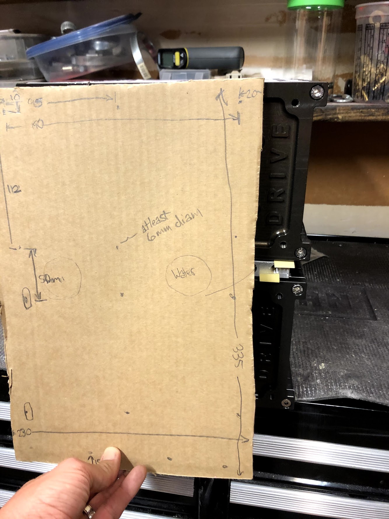

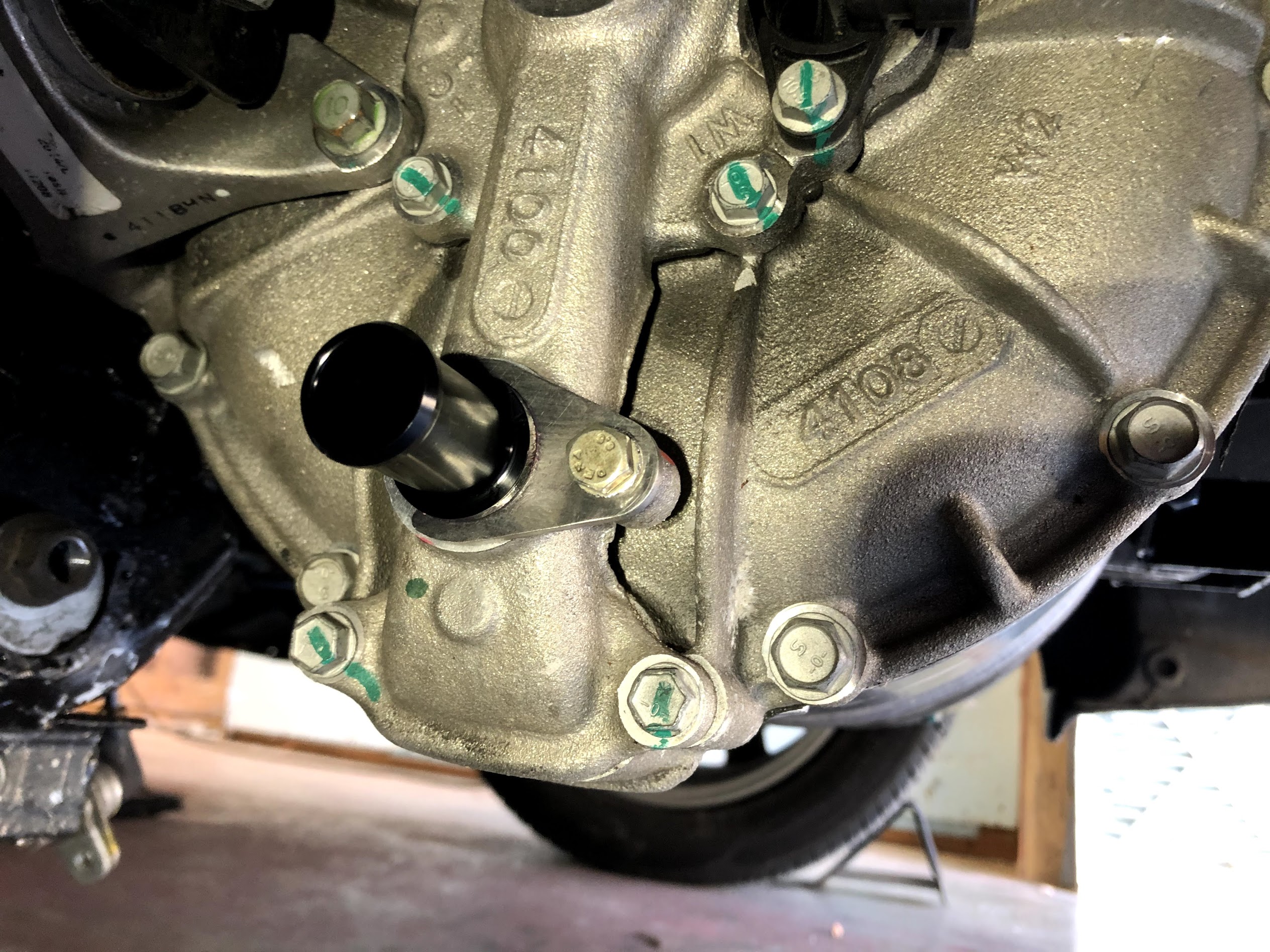

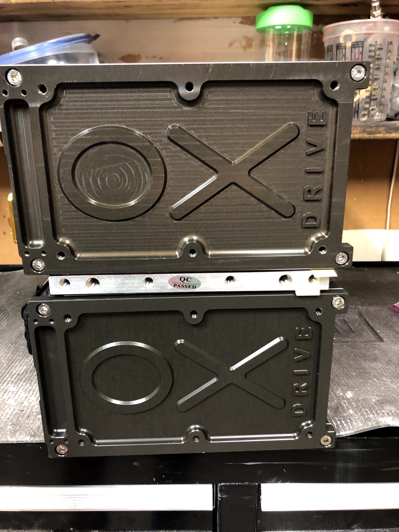

19mm coolant adapter from zeroev mounted on the drive unit. Nicely machined part.

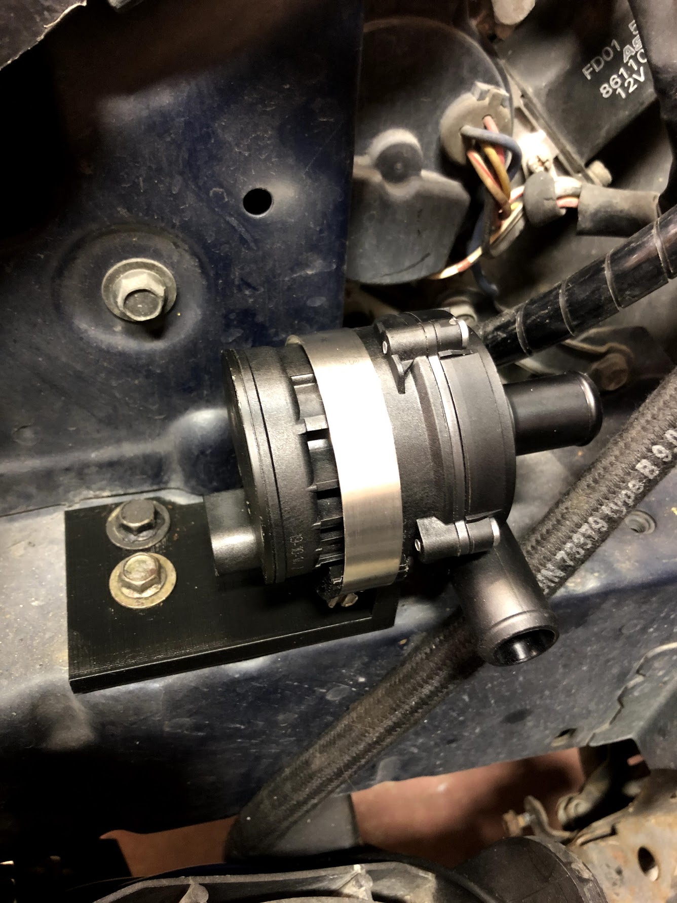

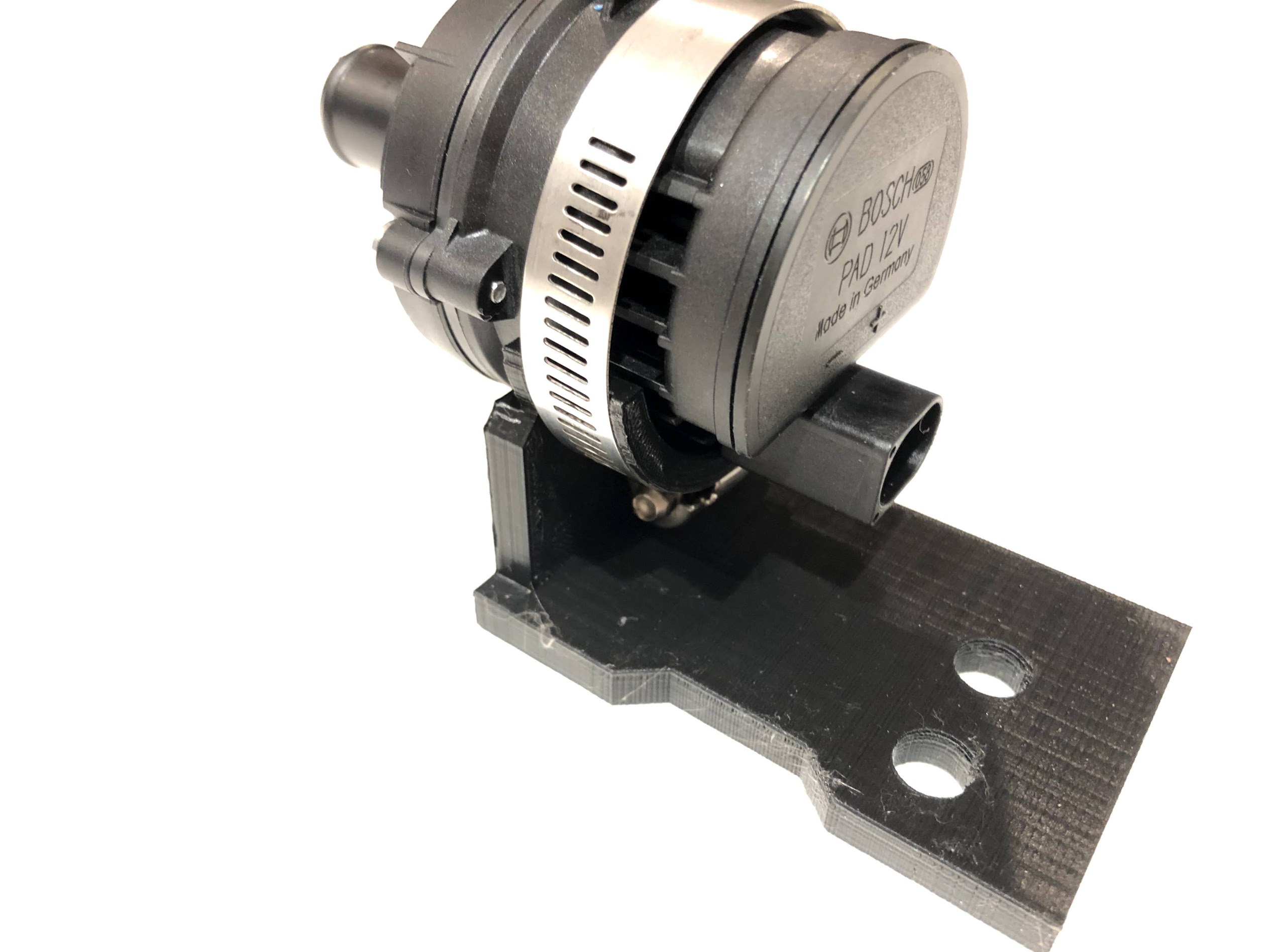

Waterpump mount done and wired in.

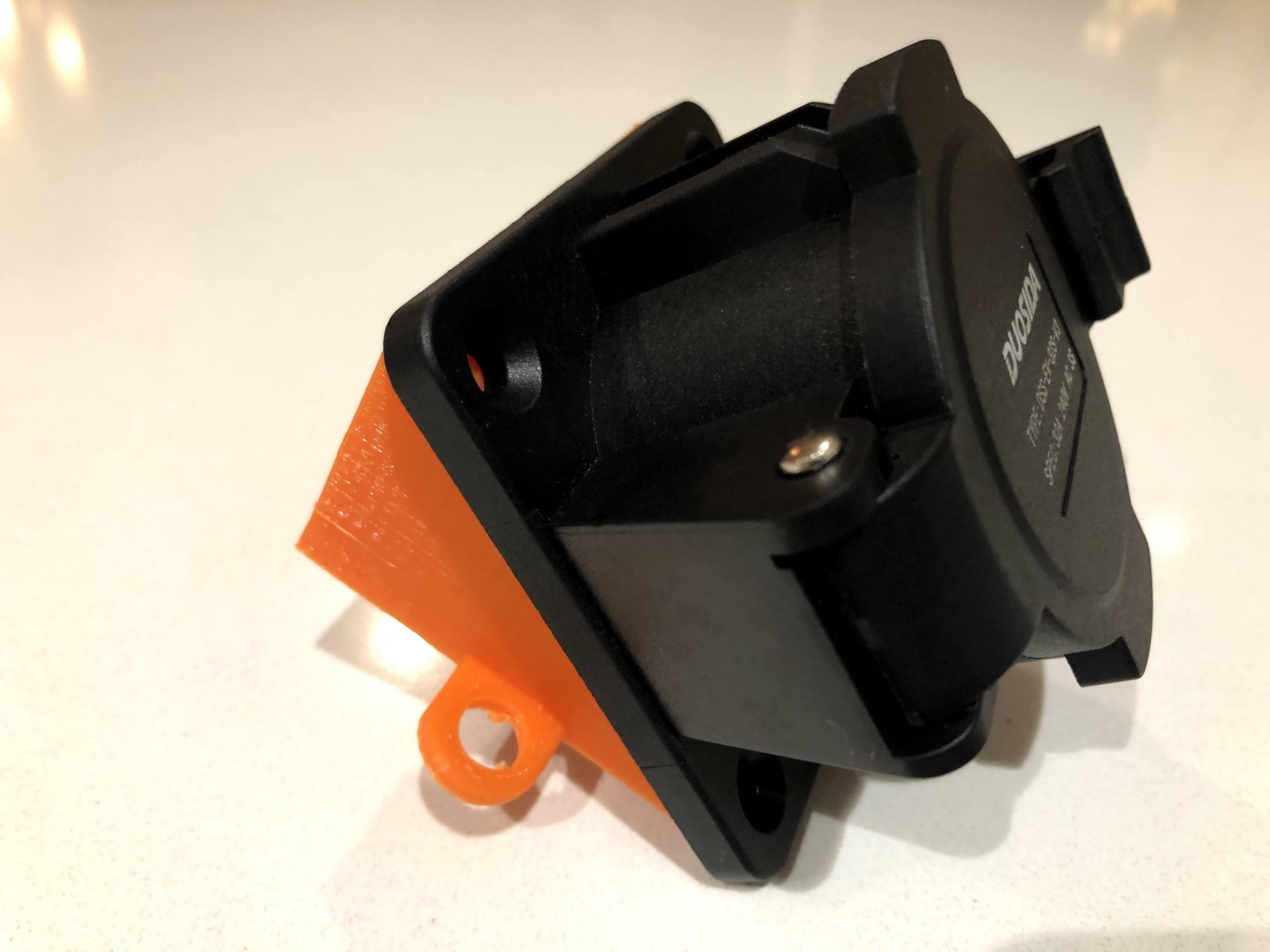

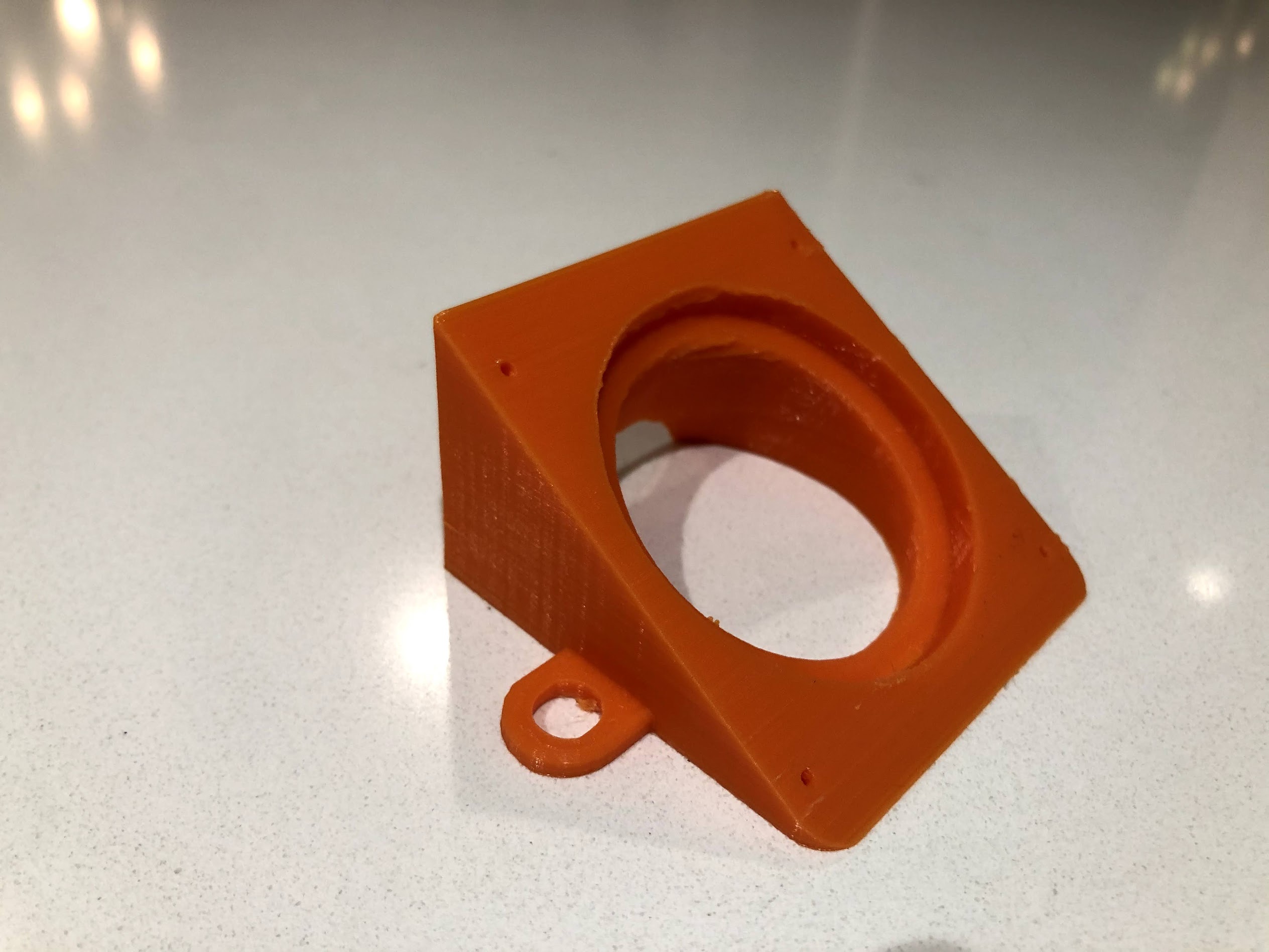

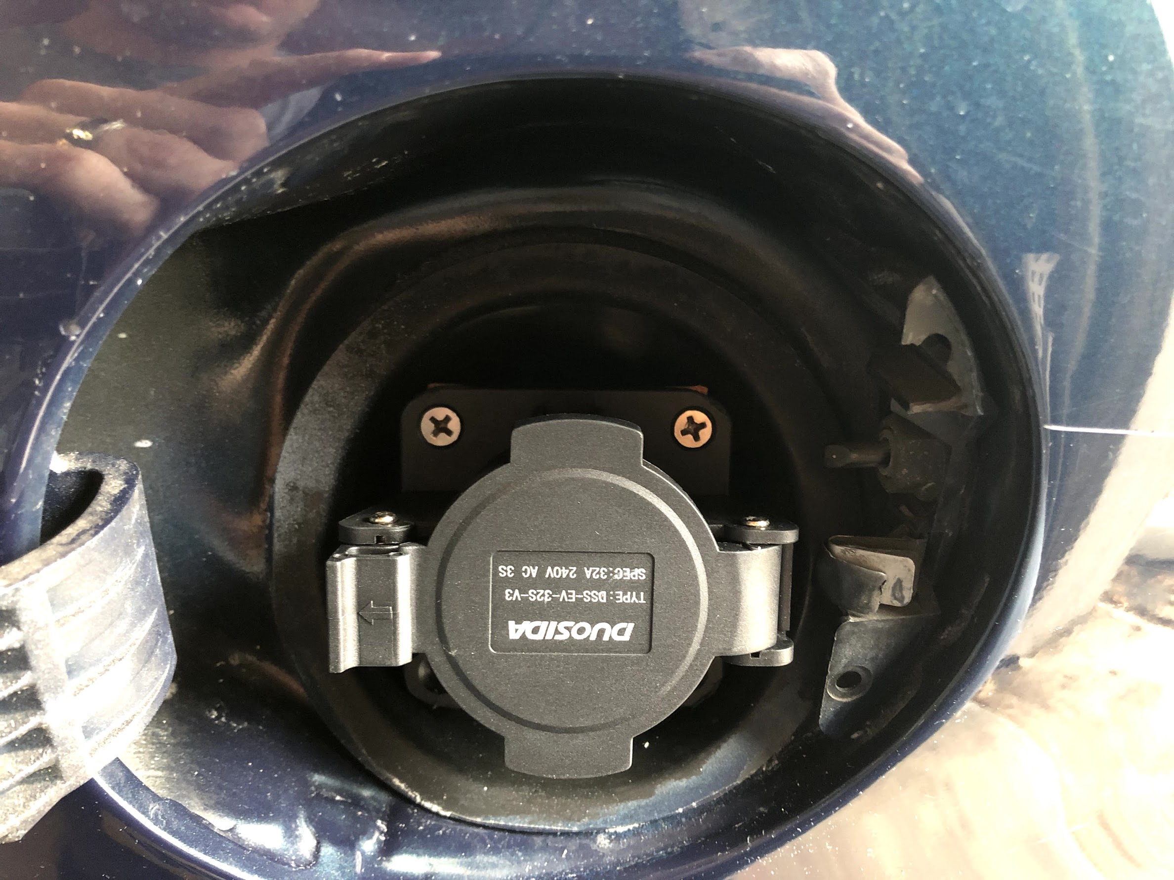

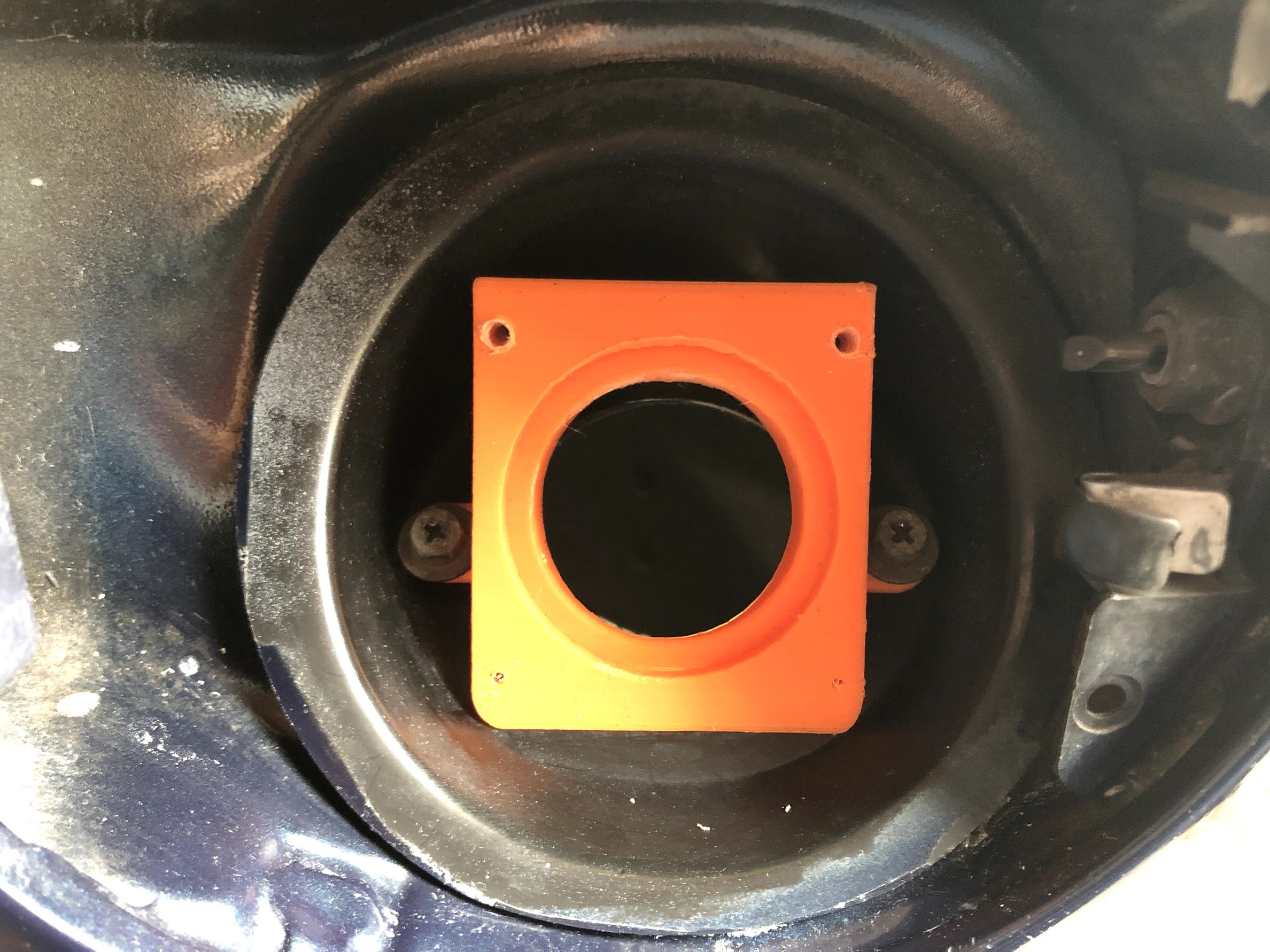

J1772 connector is mounted (the label is upside down because I had to swap the door to the other side...I'll cover this up later). It was much easier than I expected. I just needed to alter the angle so the charging connector wouldn't hit the body.
One more thing down...

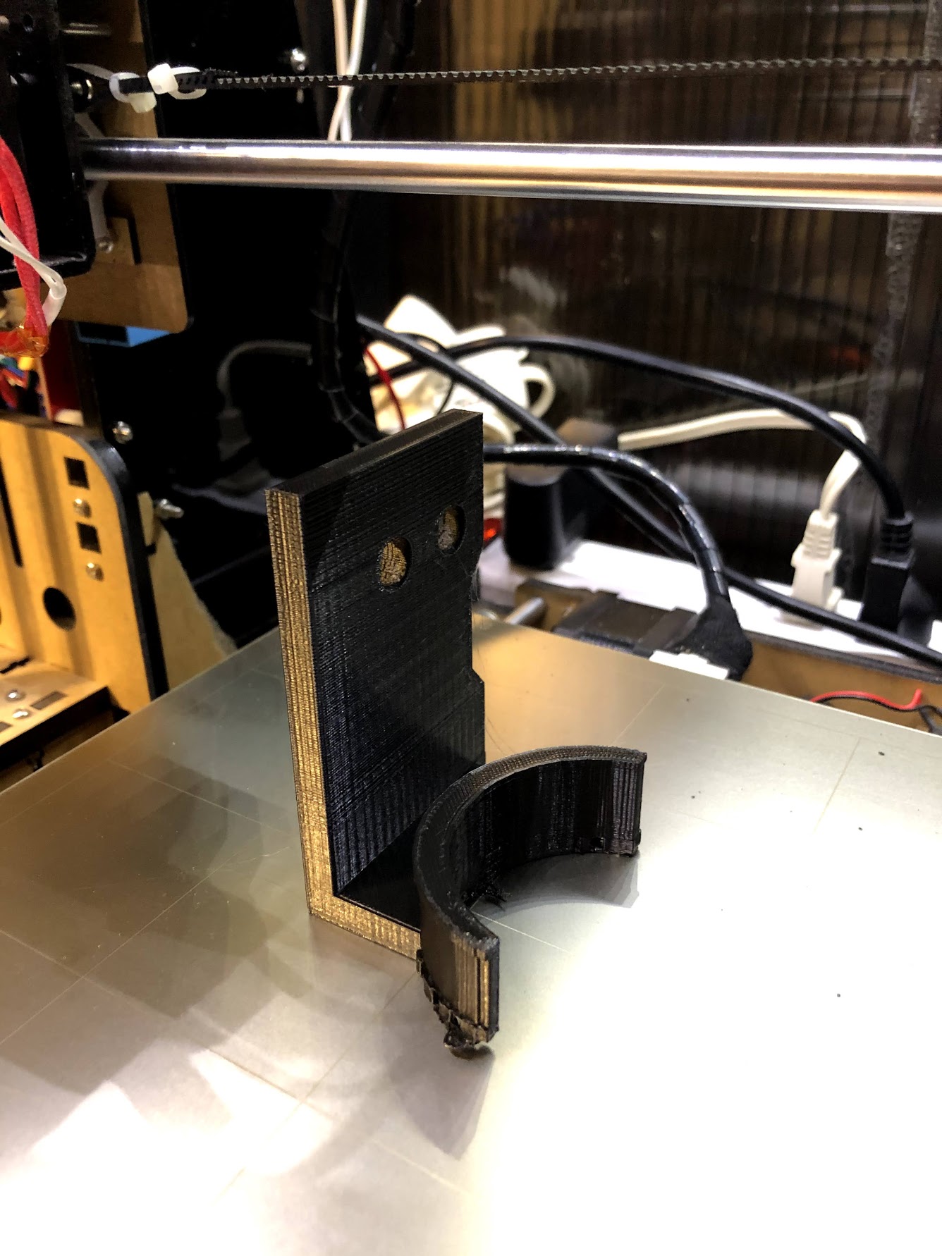

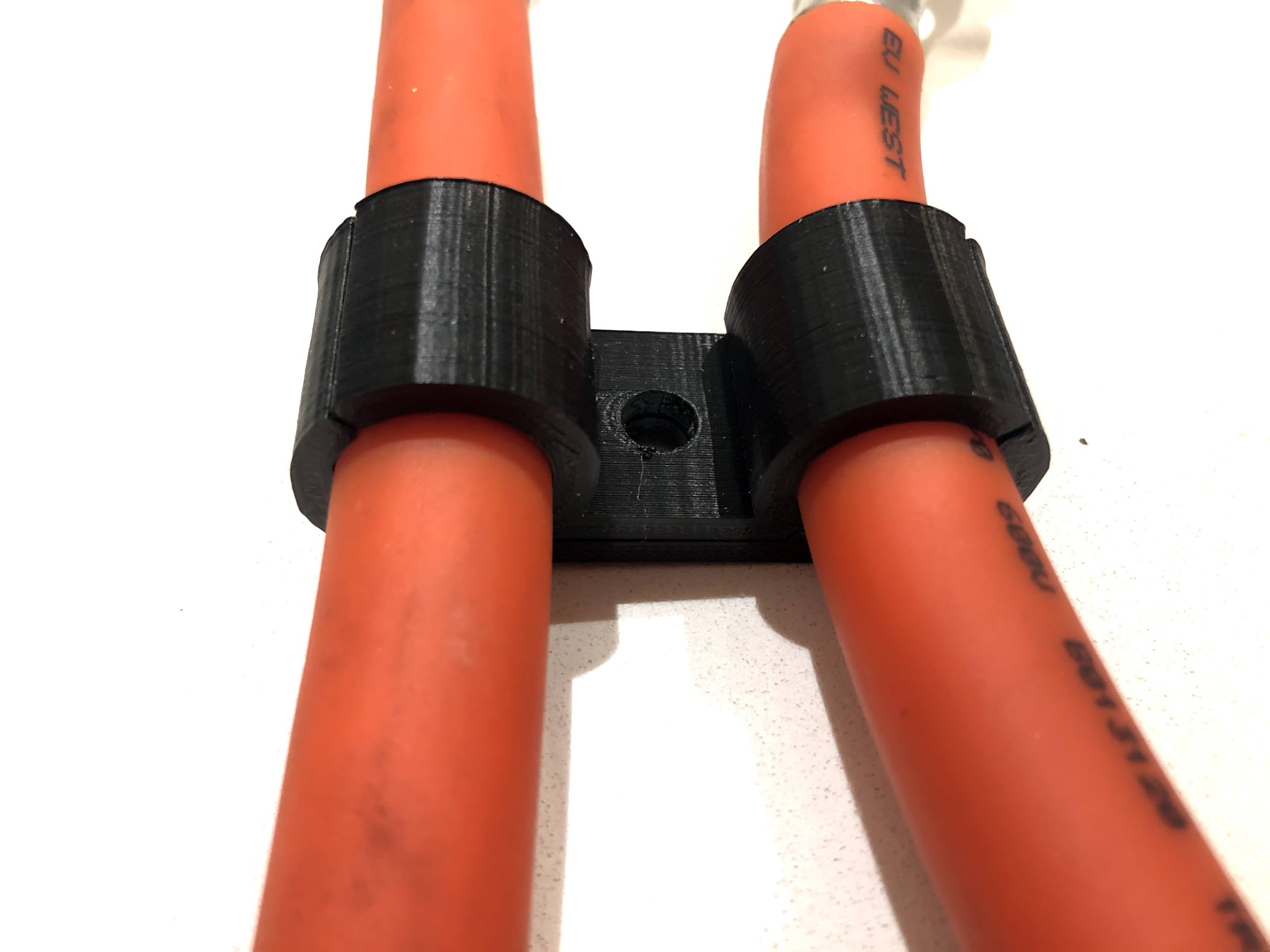

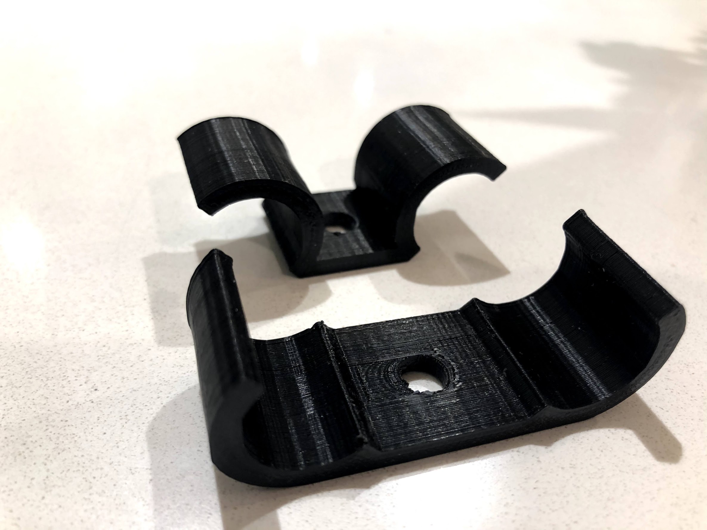

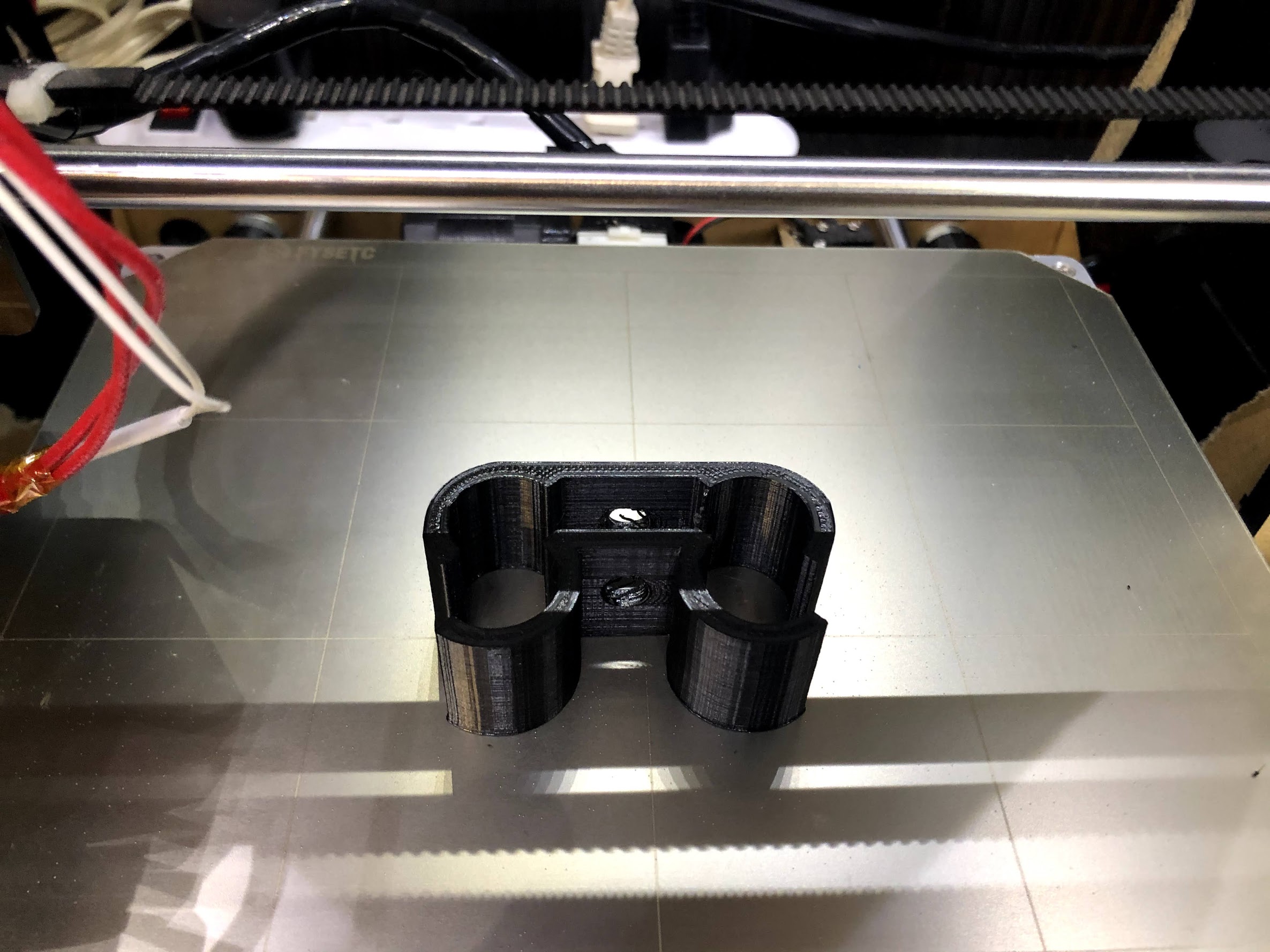

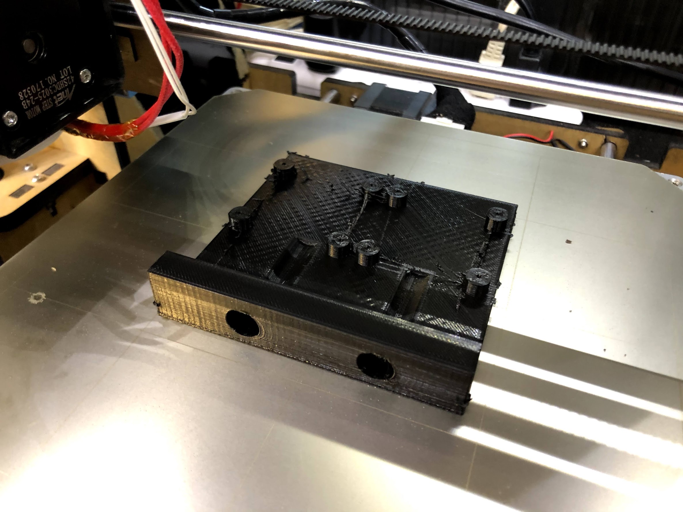

Another small update, working on the details. I created a design to hold the 2/00 high voltage wires. I'll adapt the design based on placement after I get the batteries.
FJ3422
Posts: 122
Location: Netherlands
Has thanked: 13 times
Re: 1993 FD Rx7
Post by FJ3422 »
Good work ! Nice 3D printing work !
rjmcdermott81 wrote: Wed Feb 03, 2021 3:30 am waterpump pic 1.jpg
Do you use this Bosch PAD-12V pump for just a partial coolant circuit, or for the complete (inverter-motor-charger-batteries) coolant loop ?
Where the Bosch PAD's can create a differential pressure of around 0,1-0,15bar (at around 1 Amp), the usual 'Tesla'-pumps are spec'd around 0,5-0,7bar (at around 7 Amps). When you have a large / complex loop with a high flow resistance, you might have to consider a more powerful pump.
You are 100% right. I looked over at Boxster EV's build thread and he is using a Davies Craig pump so I just ordered one. Much much higher flow rate.

rjmcdermott81 wrote: Mon Feb 22, 2021 3:37 am
FJ3422 wrote: Tue Feb 16, 2021 4:25 pm Good work ! Nice 3D printing work !
I use Bosch PCE pumps. They have more power and can be controlled via PWM. Without PWM they run at 100%. A dry run protection is also integrated.
They are easy to get because they are used in many VW models, but the VW version has a different plug and pin assignment.
I paid € 30.- each

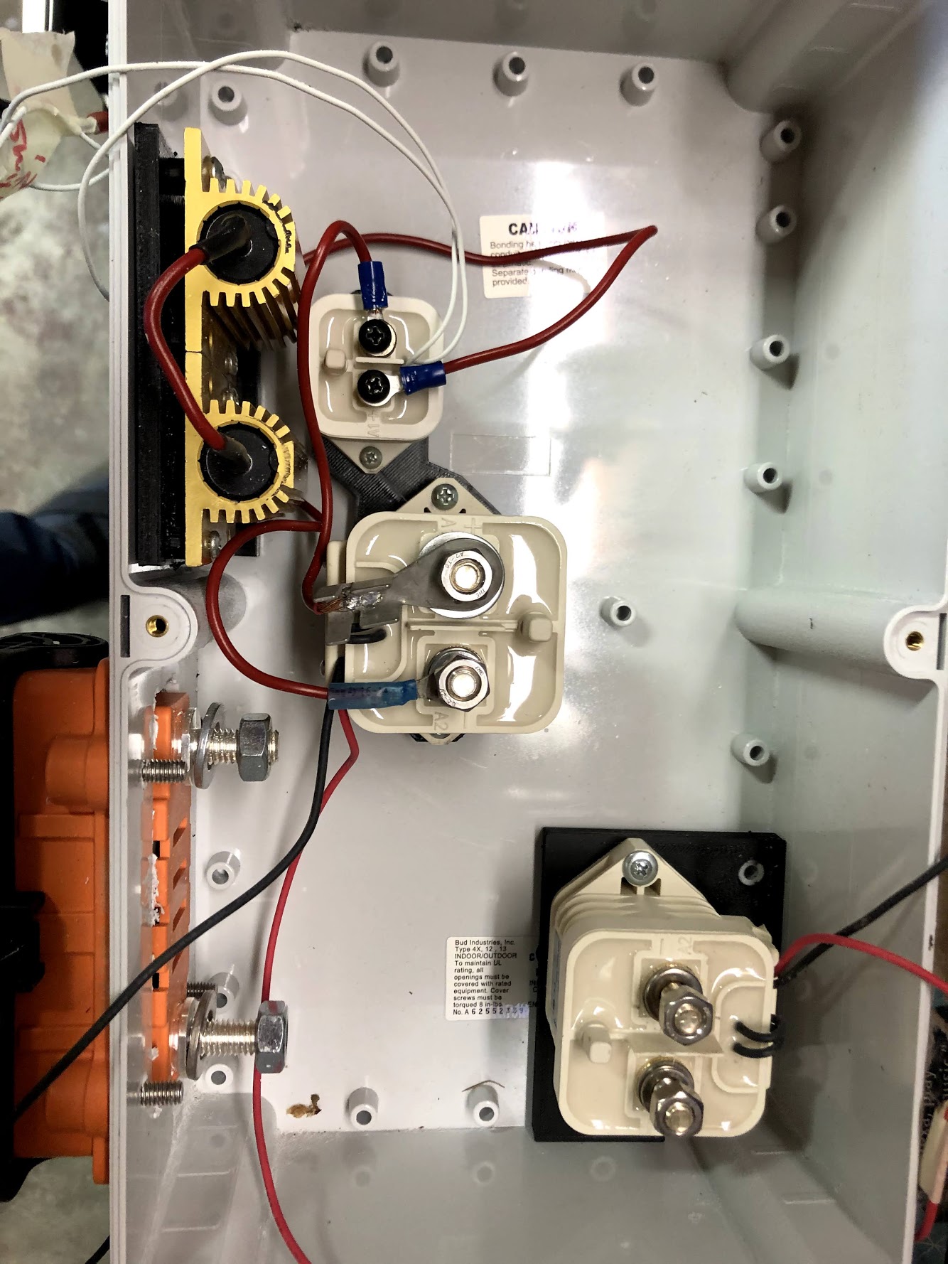

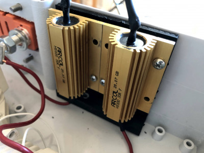

Starting to work on the high-voltage box and mounts for each part - resistors, contactors, etc. These are not the final wires...just for testing.

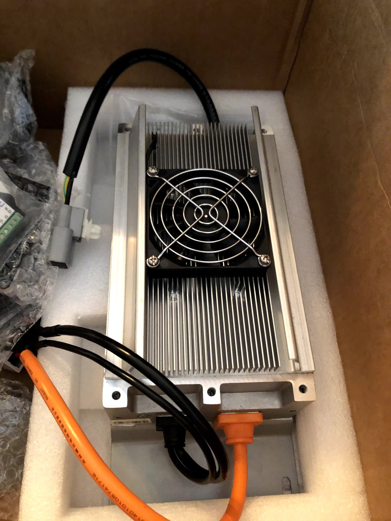

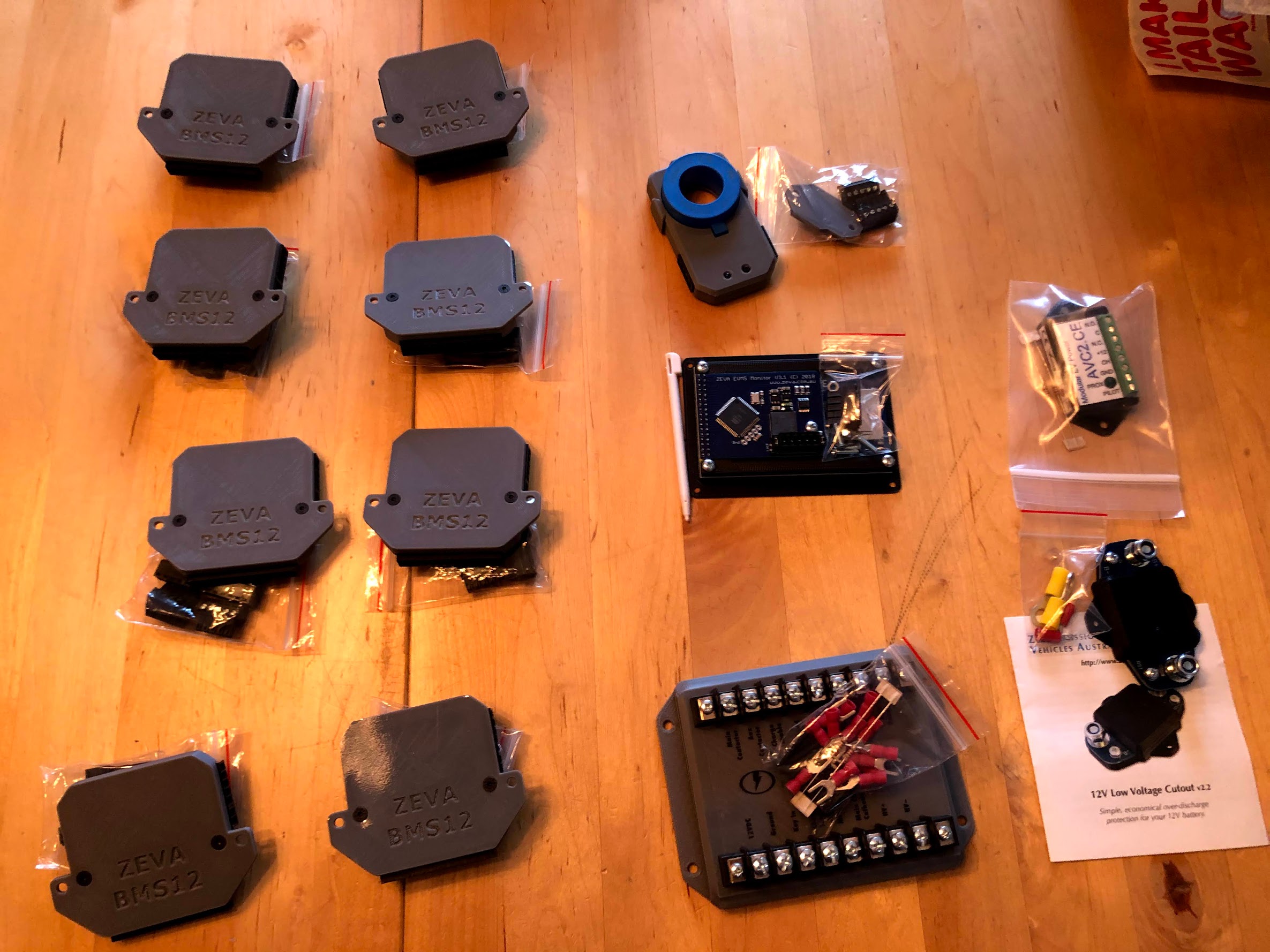

BMS and charger are here

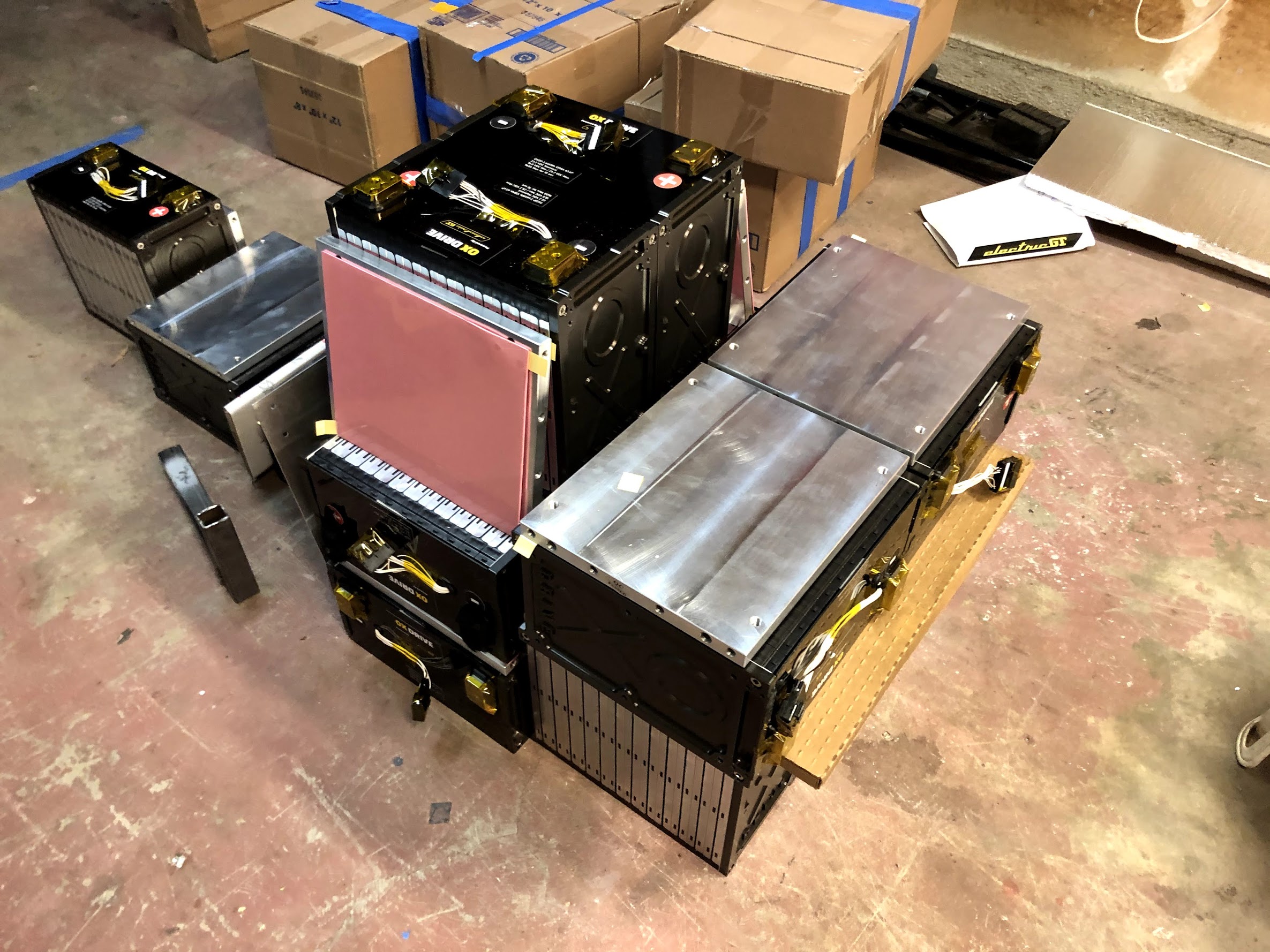

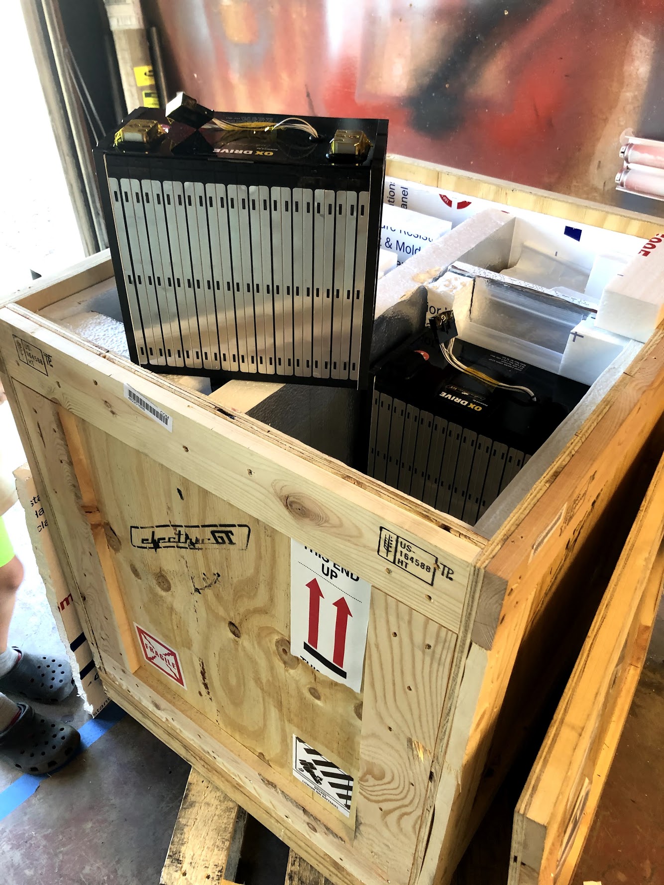

Batteries are here!! (2 more on the way but this is what I need to start building the box)
rjmcdermott81
Posts: 112
Joined: Thu Dec 03, 2020 5:03 pm
Re: 1993 FD Rx7 with Tesla LDU and ElectricGT Batteries
Post by rjmcdermott81 »

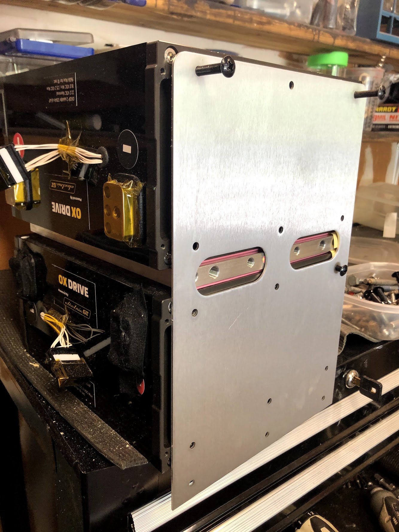

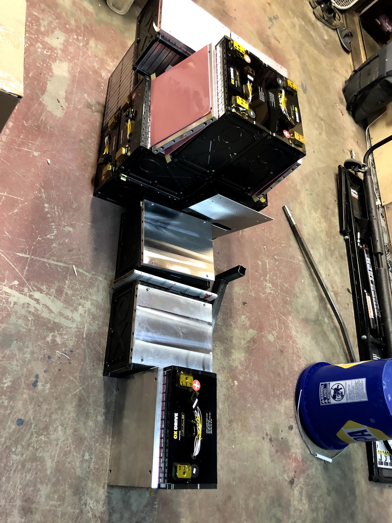

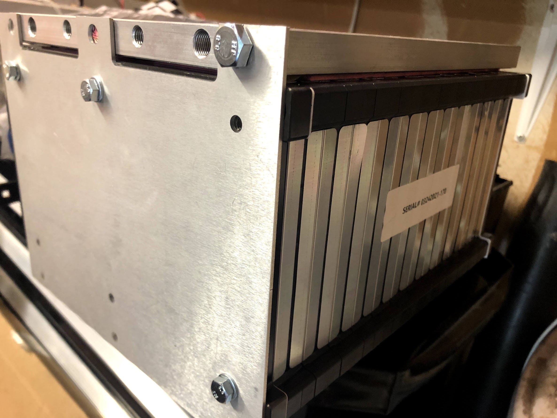

Arranging the batteries in the way they will fit in the car.
rjmcdermott81
Posts: 112

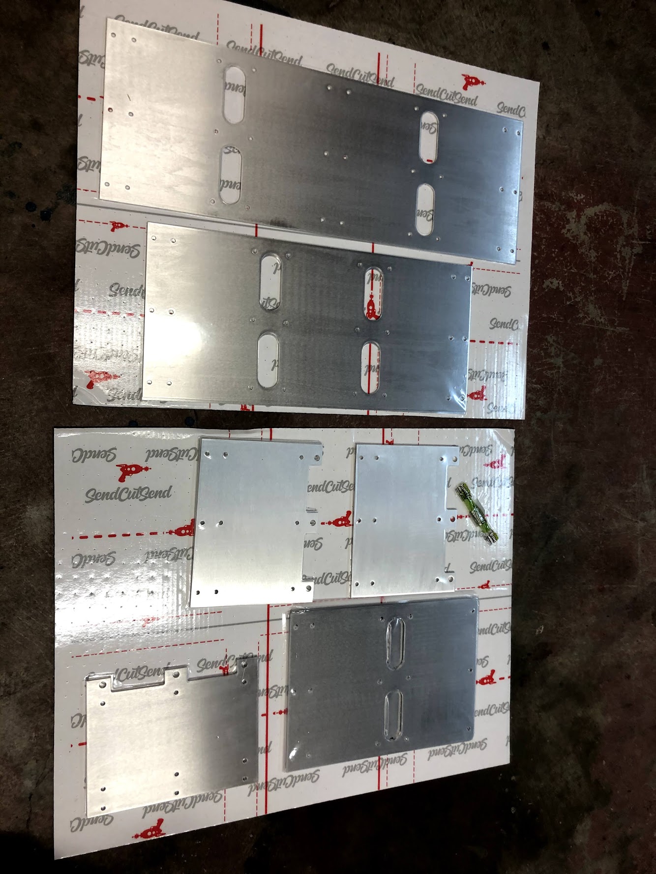

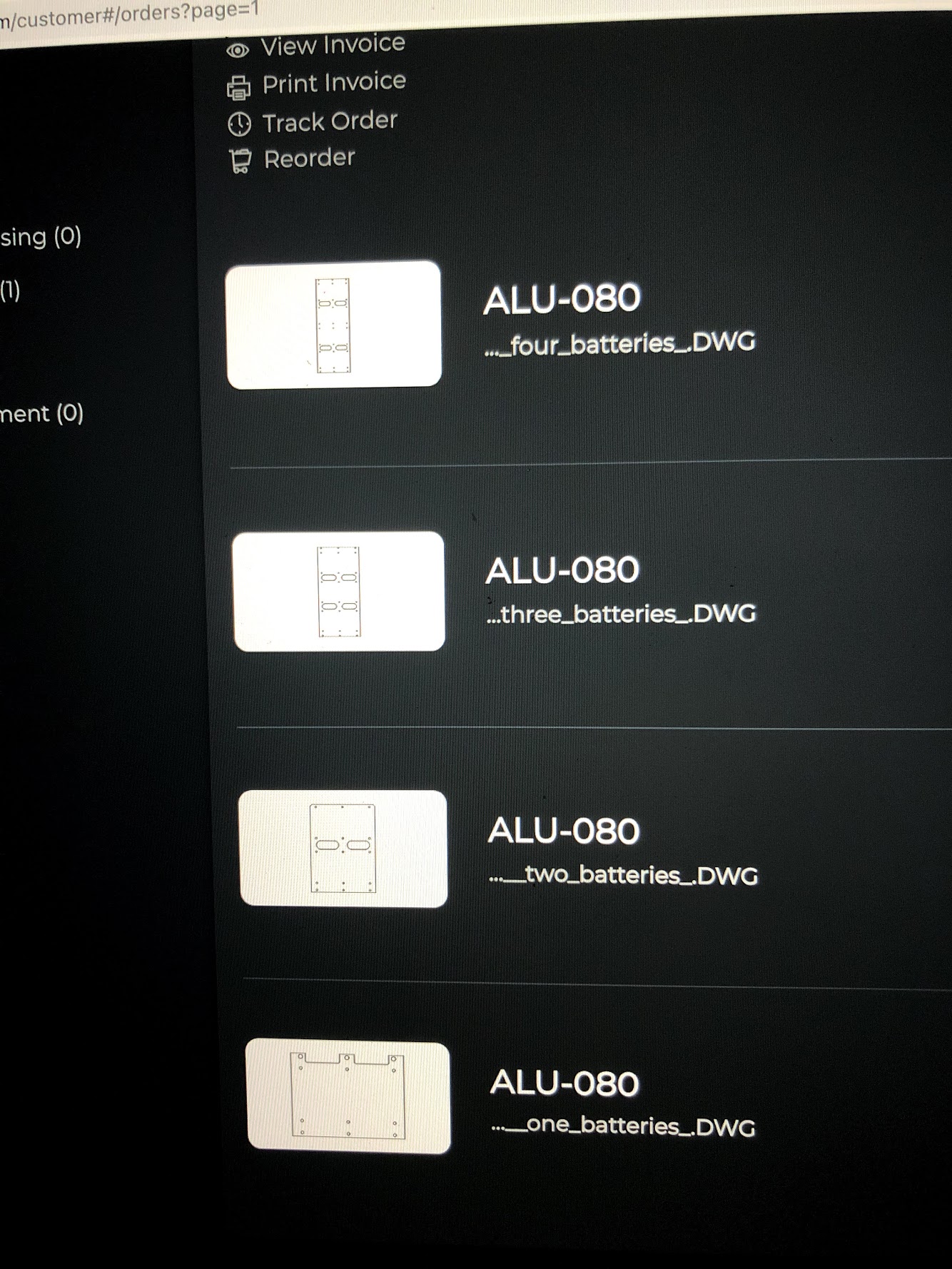

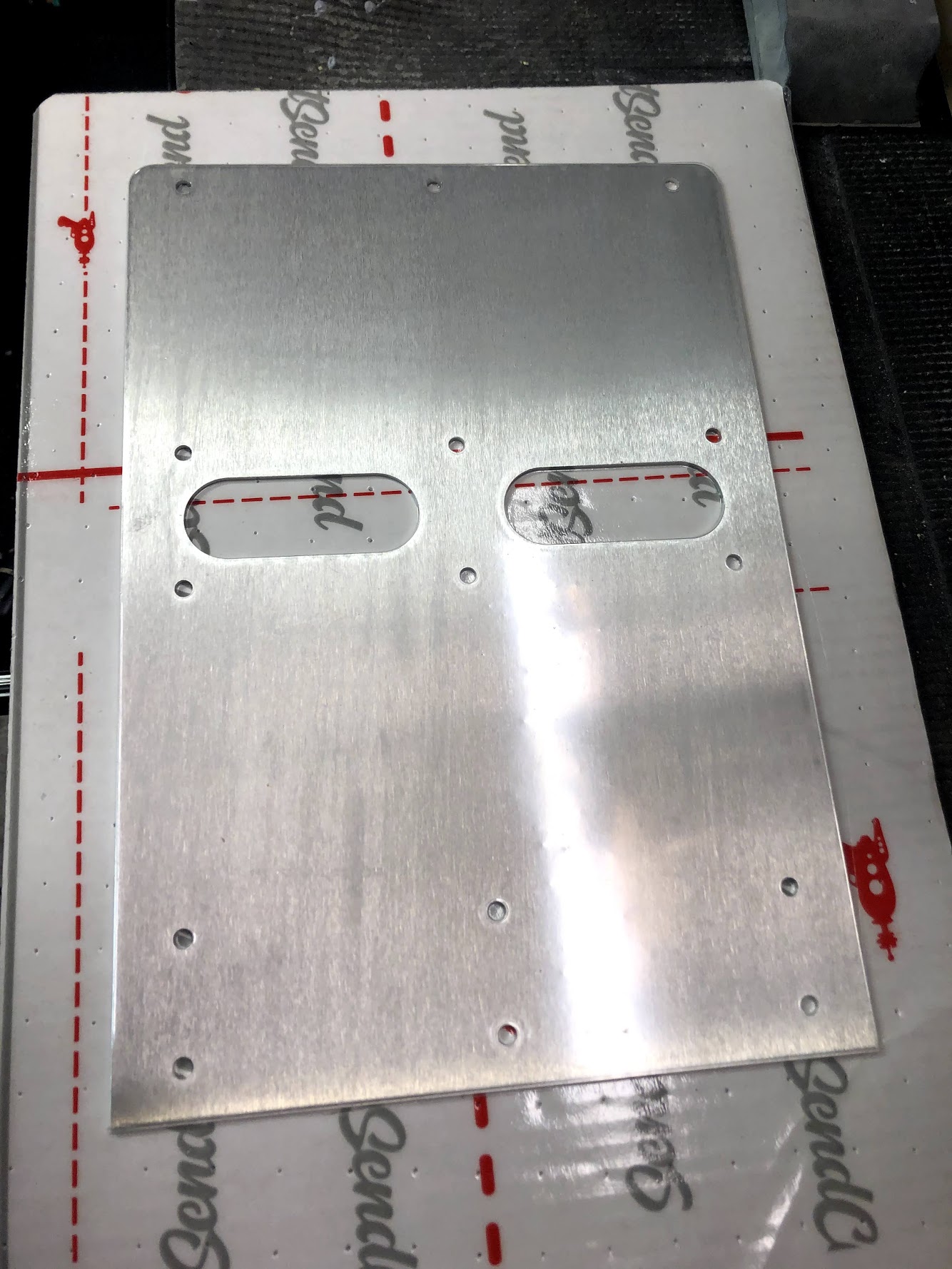

Working on a battery holder template and then getting it back from Sendcutsend.com. So easy and such nice delivery.
rjmcdermott81
Posts: 112
Now that I have the first one dialed in, ordering the holder plates for all the batteries
Boxster EV
Posts: 489
Location: UK
Has thanked: 57 times
Been thanked: 50 times
Post by Boxster EV »
Loving this build. Thanks for sharing such a comprehensive write-up.

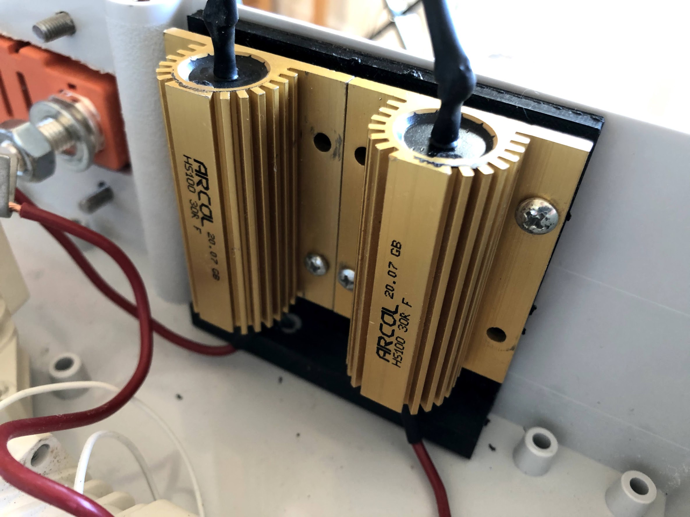

You might want to mount the pre-charge resistors on a metal plate. They will get warm and could melt the plastic.
rjmcdermott81
Posts: 112
Boxster EV wrote: Fri Apr 23, 2021 1:12 pm Loving this build. Thanks for sharing such a comprehensive write-up.
Thanks - I appreciate feedback like this. I think now that I have the file and design dialed in I will send it out to have it 3d printed in metal. Good excuse to try that for the first time.

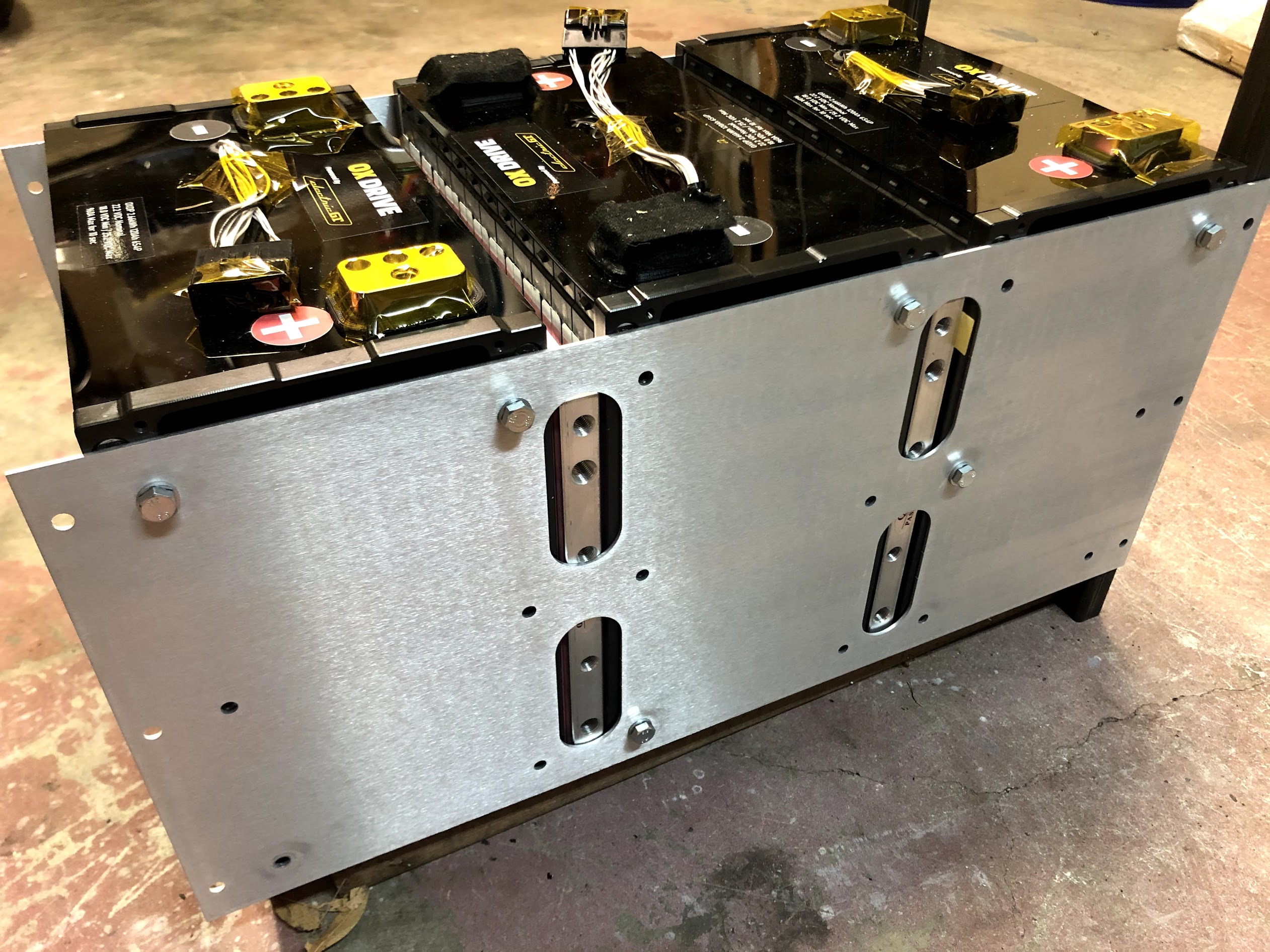

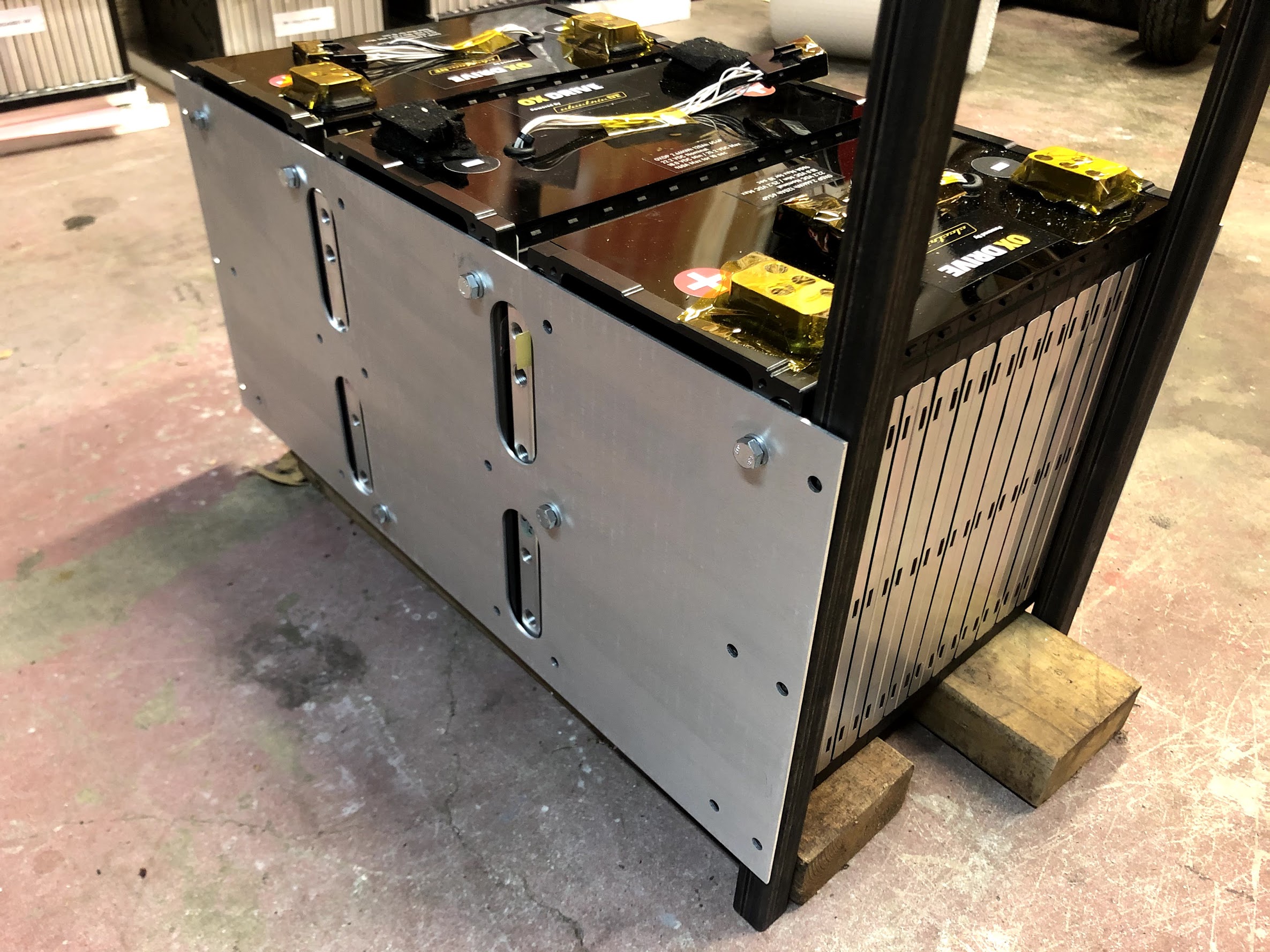

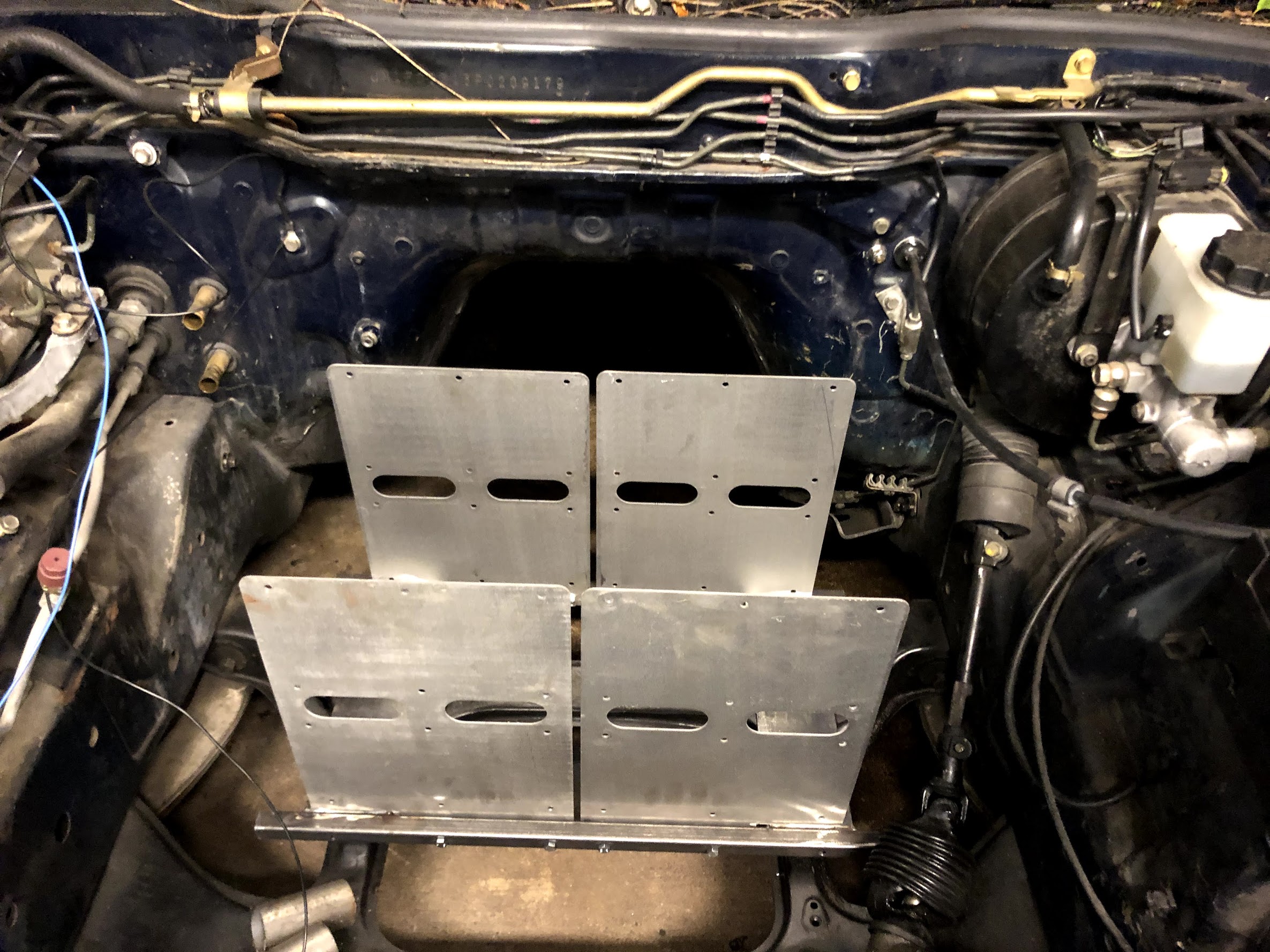

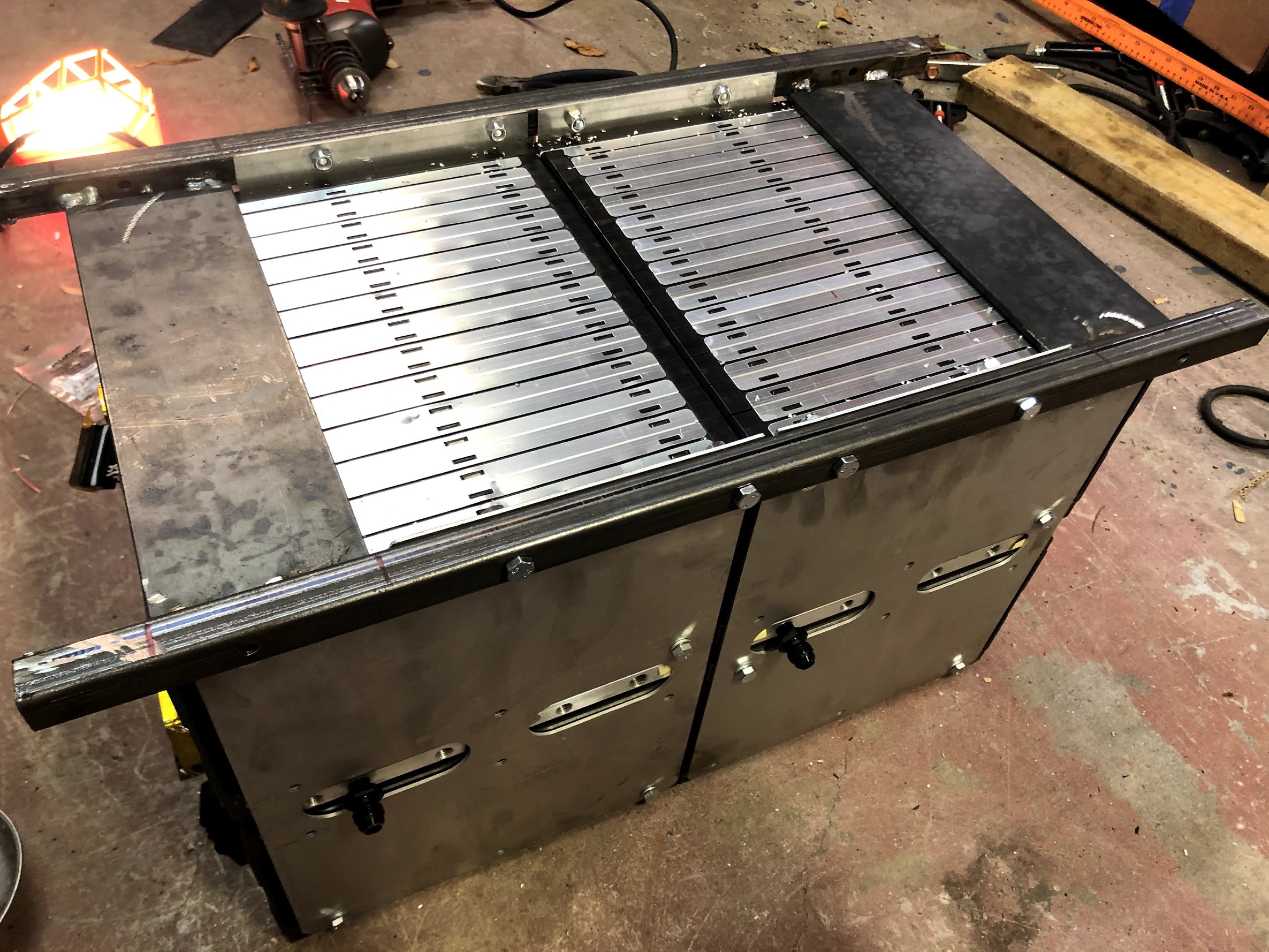

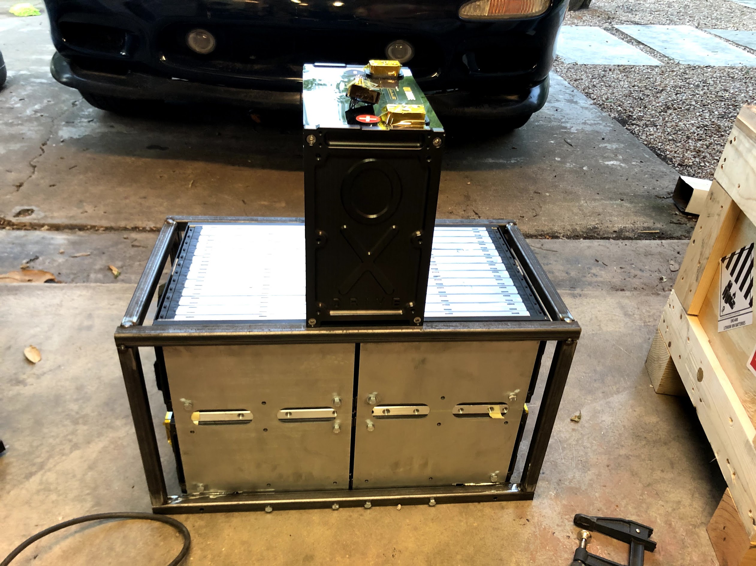

Battery mounts and steel square tube are in to make the battery box. I plan to build it one battery section at a time test fitting in the vehicle to squeeze it all in.
These brackets will hold the chill plates on the single batteries
Here is a section of three batteries with chill plates sandwiched in between
Here it is with the square tube on the side. I will cut, drill and then mount to this.
Also, at Walmart I saw the new Mustang E parked at the charger. I've been totally excited after reading about it in magazines but seeing this one...man I hope they don't all look like this. It's probably the ugly wheels or something but it did not look good.

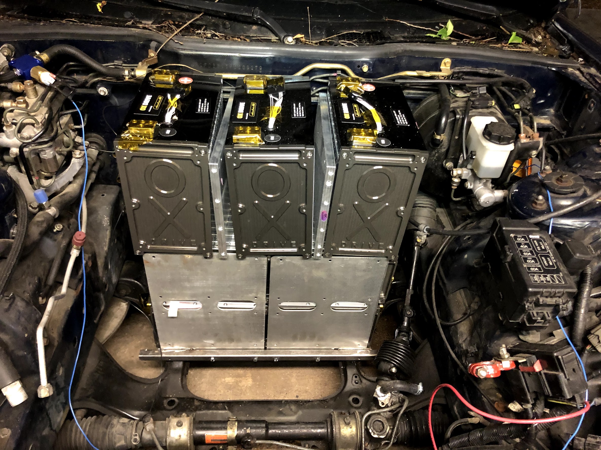

My neighbor caught me working on the battery base the other day...
rjmcdermott81
Posts: 112

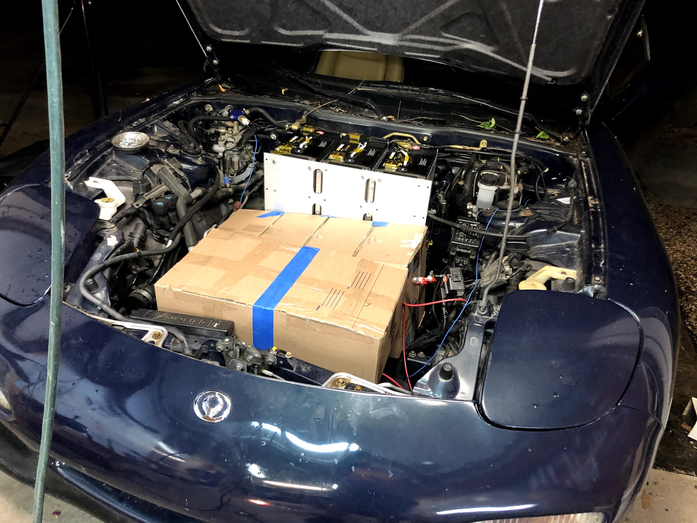

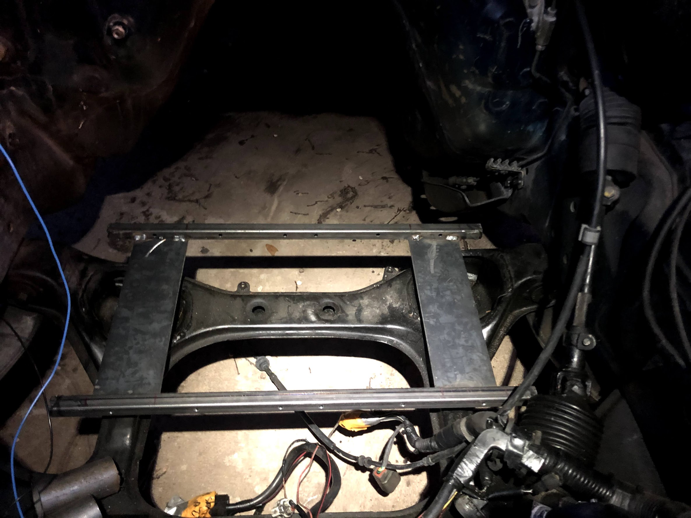

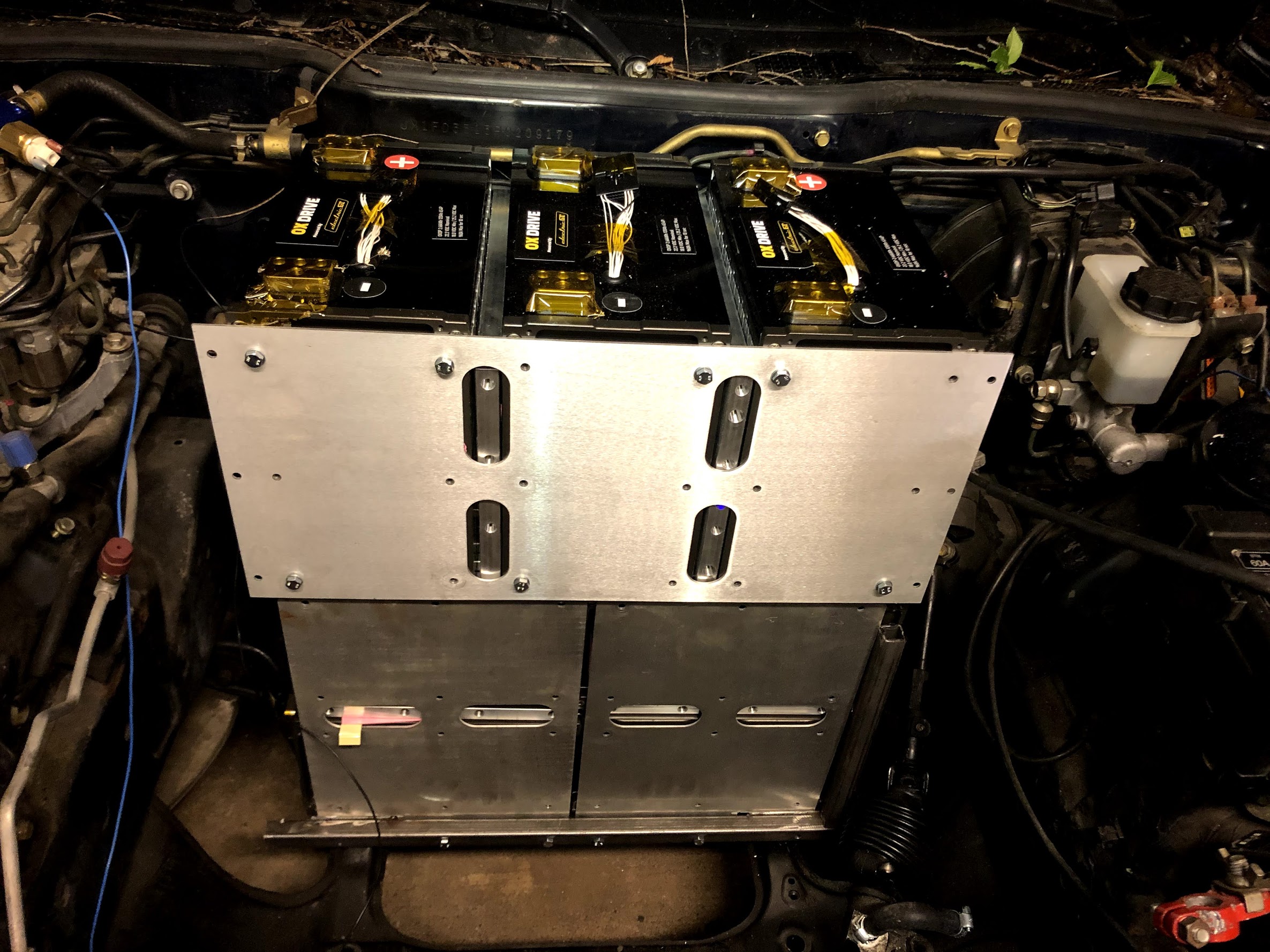

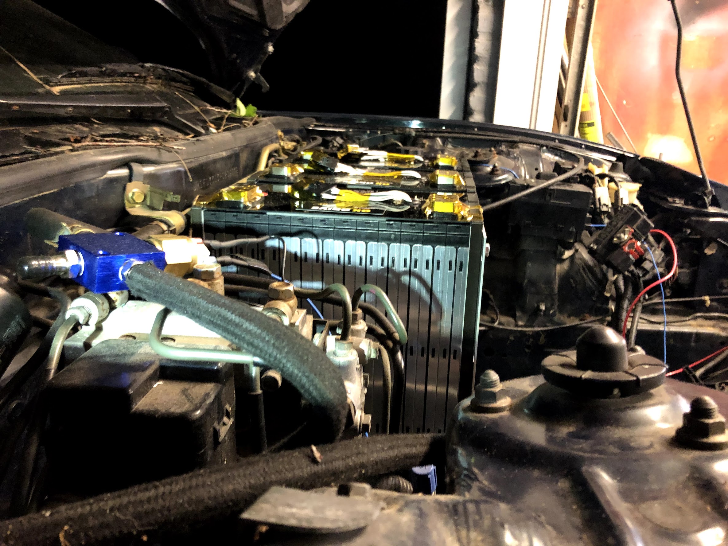

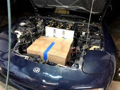

k, progress on the battery mount has been slow. The first design had the batteries sitting too high so now I have a steel base that will mount directly to the subframe.
Base on subframe
Batteries mounted to base (this is upside down)
Base in car
Testing with batteries
Now with bracket on top batteries
Test fitting other 6 batteries
Clearance under the hood

Boxed out the lower section of the battery box.
