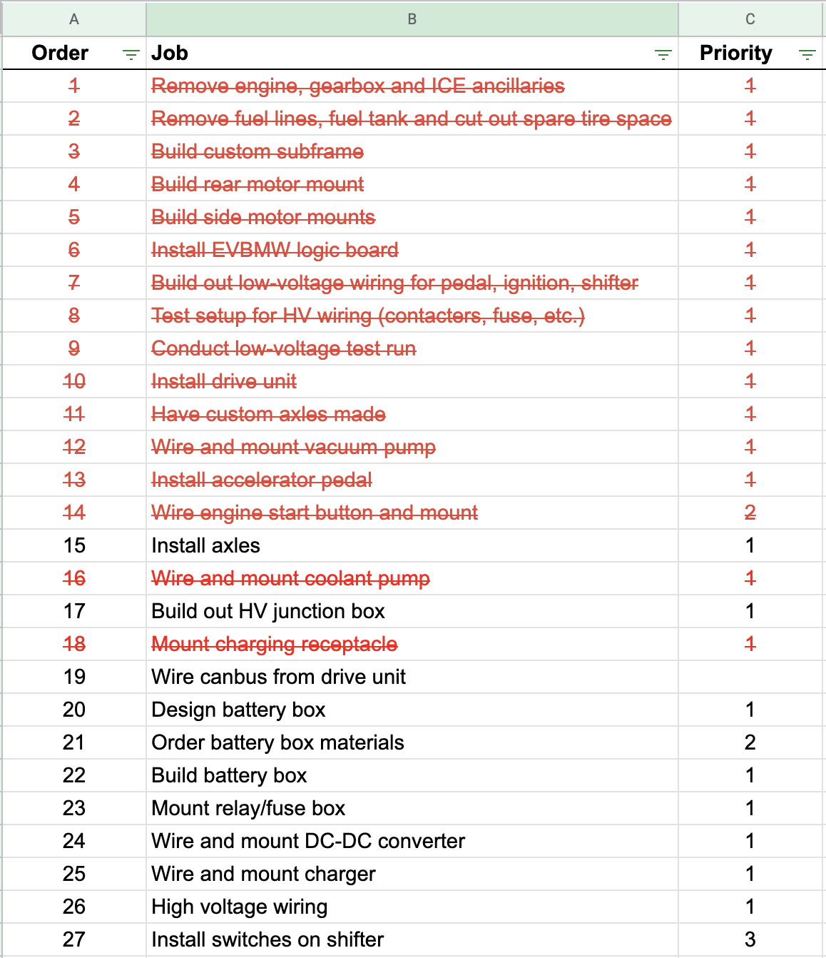

Plugging in my current project plan for tracking:
