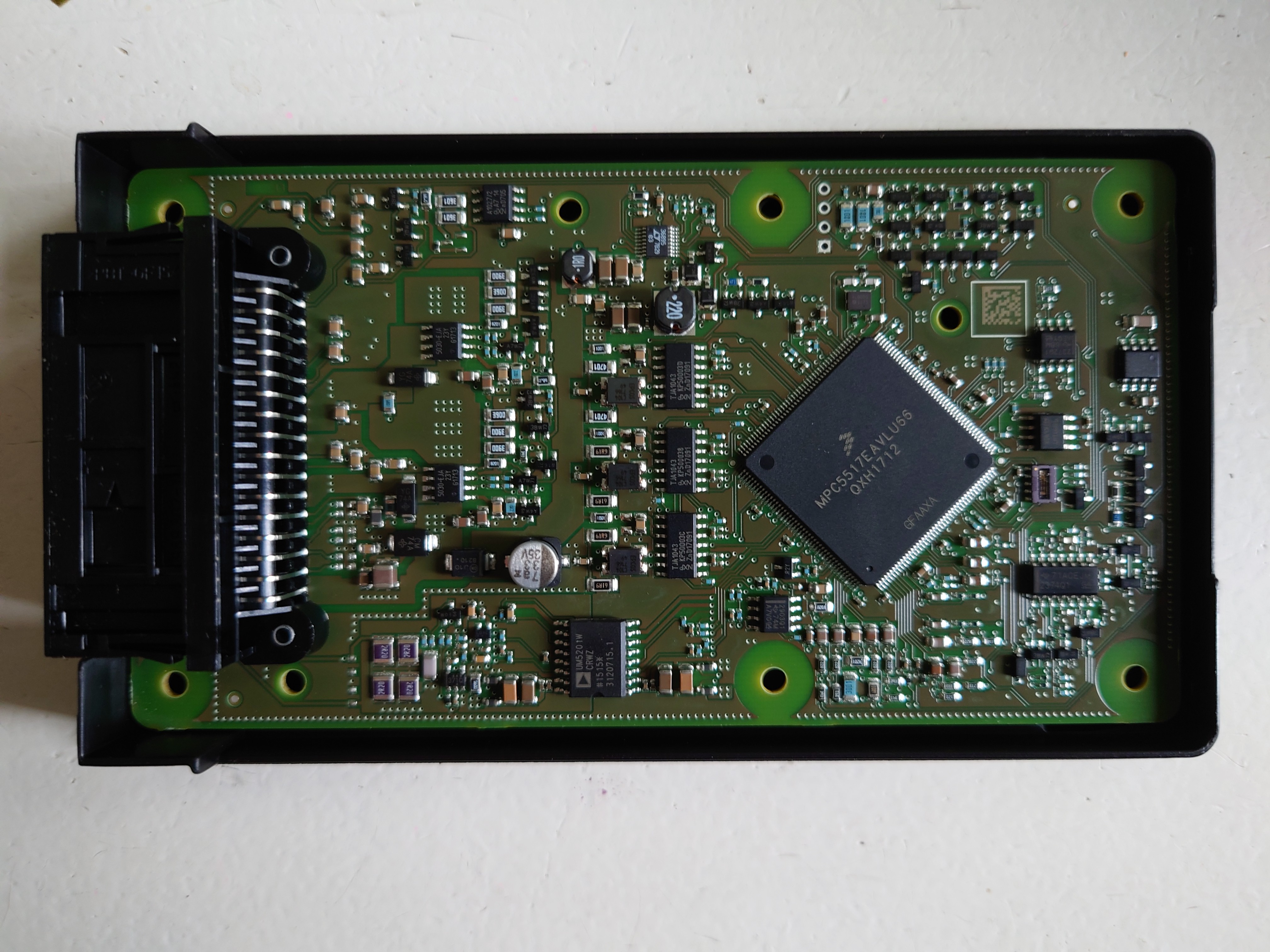

Allright, a E-Golf gen2 BMC (battery master controller?)
Let's see if he talks to me.

JaniK wrote: Thu May 27, 2021 5:24 pm Allright, a E-Golf gen2 BMC (battery master controller?)
All he said to me was "Close the lid and GO AWAY" :o
