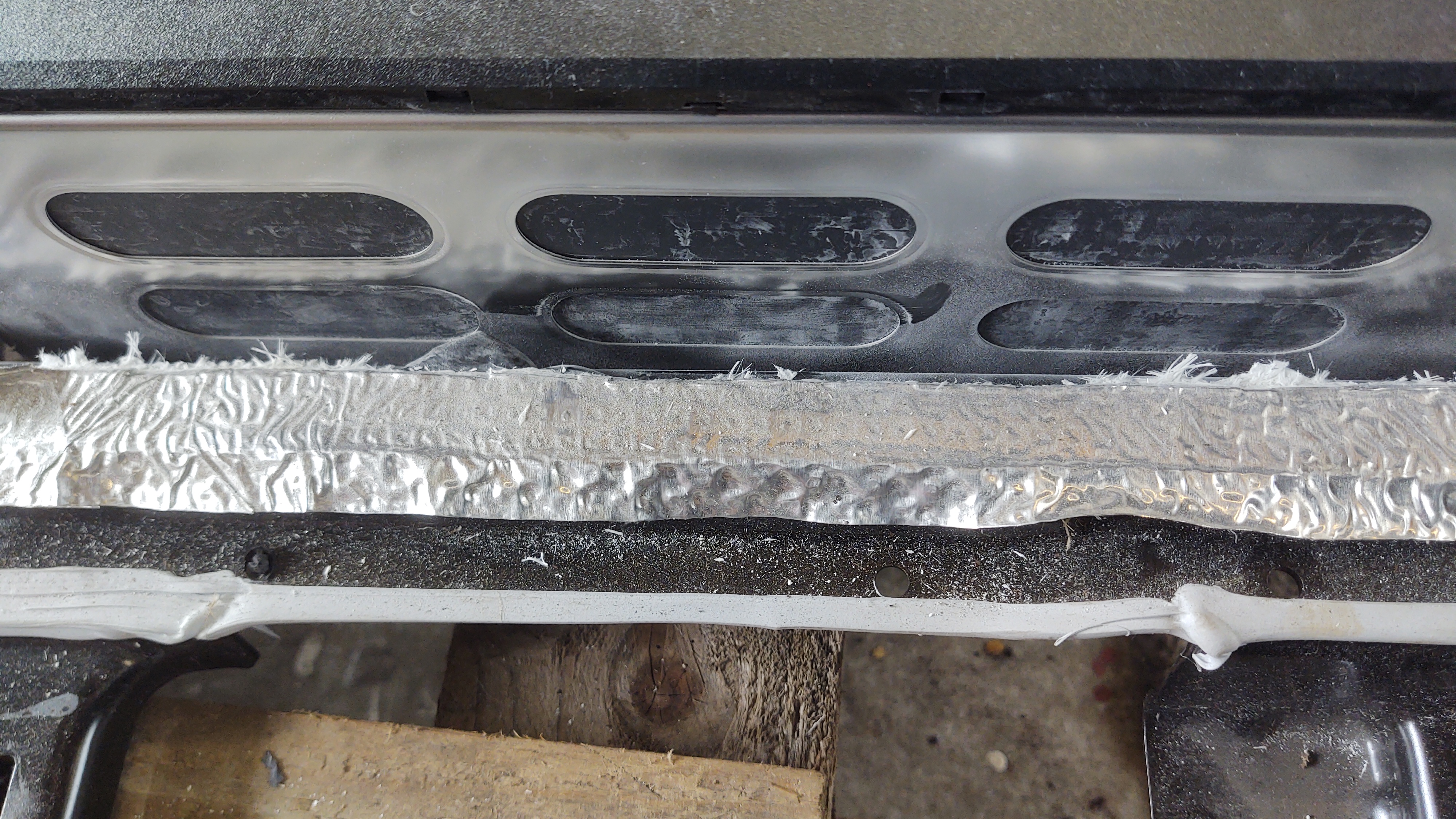

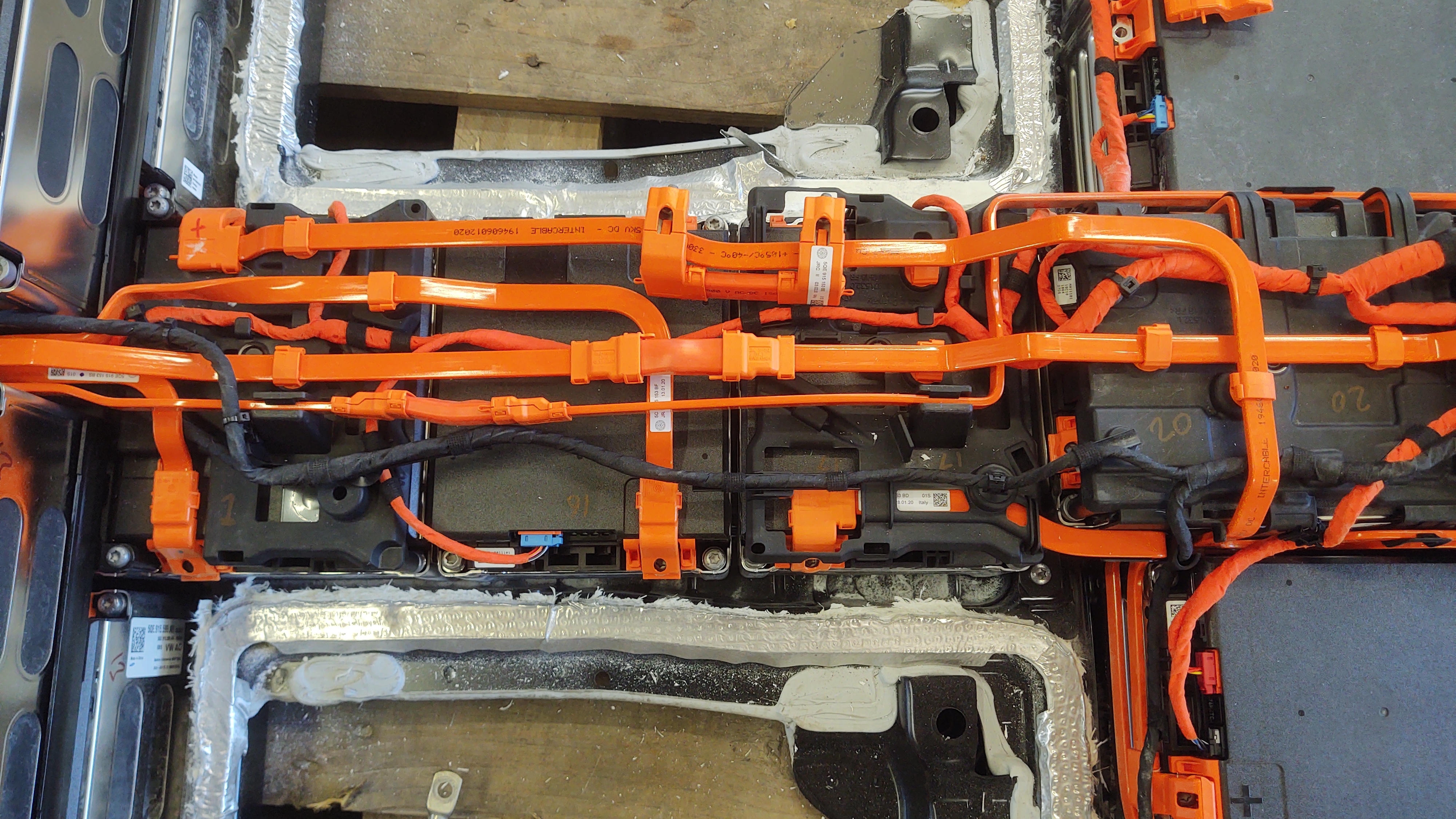

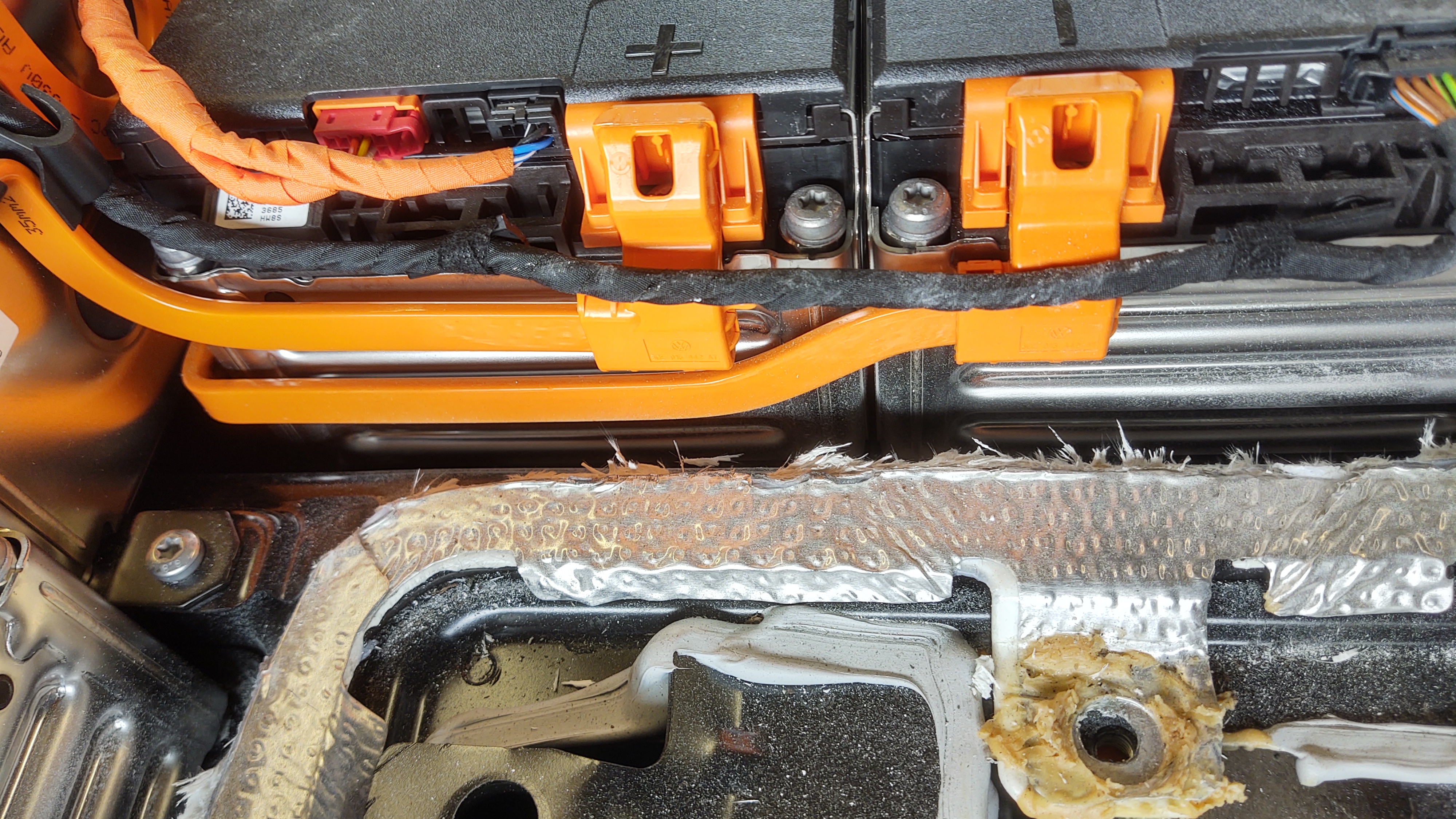

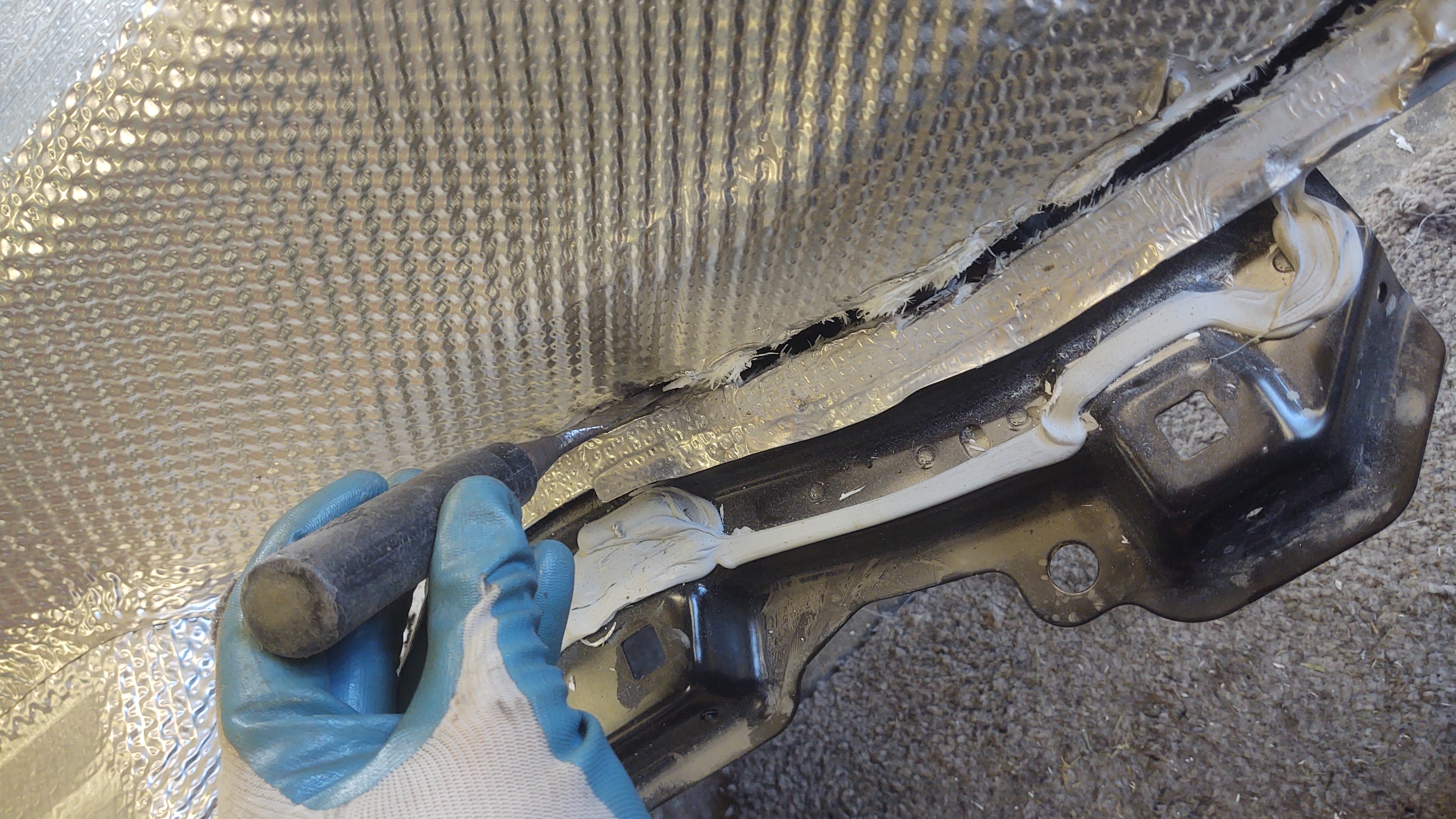

**********SAFETY WARNING**********
Edit:
I'm adding this here so hopefully you will see it before attempting to open one of these packs.
I don't know if all eCar packs are the same but this pack has no physical safety disconnect to cut the pack in half, it will be at full voltage until you break it down.
It also means it is at full voltage while you are cutting the top off which is not easy and if you do it wrong you WILL cut into the battery modules!! I was lucky as before I figured out the best method I slightly cut into a module with my chisel but caused no harm. :o
The top of the pack is some kind of fibre glass covered in metal foil. It is so well glued down you will not be able to prize it off so will have to cut the top off.
To do this you MUST cut straight down at the corner of the bottom flange. Cutting flat in towards the pack will probably result in damaged modules and possible fire as unlike Leaf packs the modules have no protection.
I used a 1" wood chisel to cut the top off but I think one of those vibrating multitools would do it much cleaner and easier.
Even cutting straight down there are a couple of places where you could cut through BMS wiring so DO NOT use a Dremel or grinder to cut the top off.
I'll take some photos later and add them to this post.

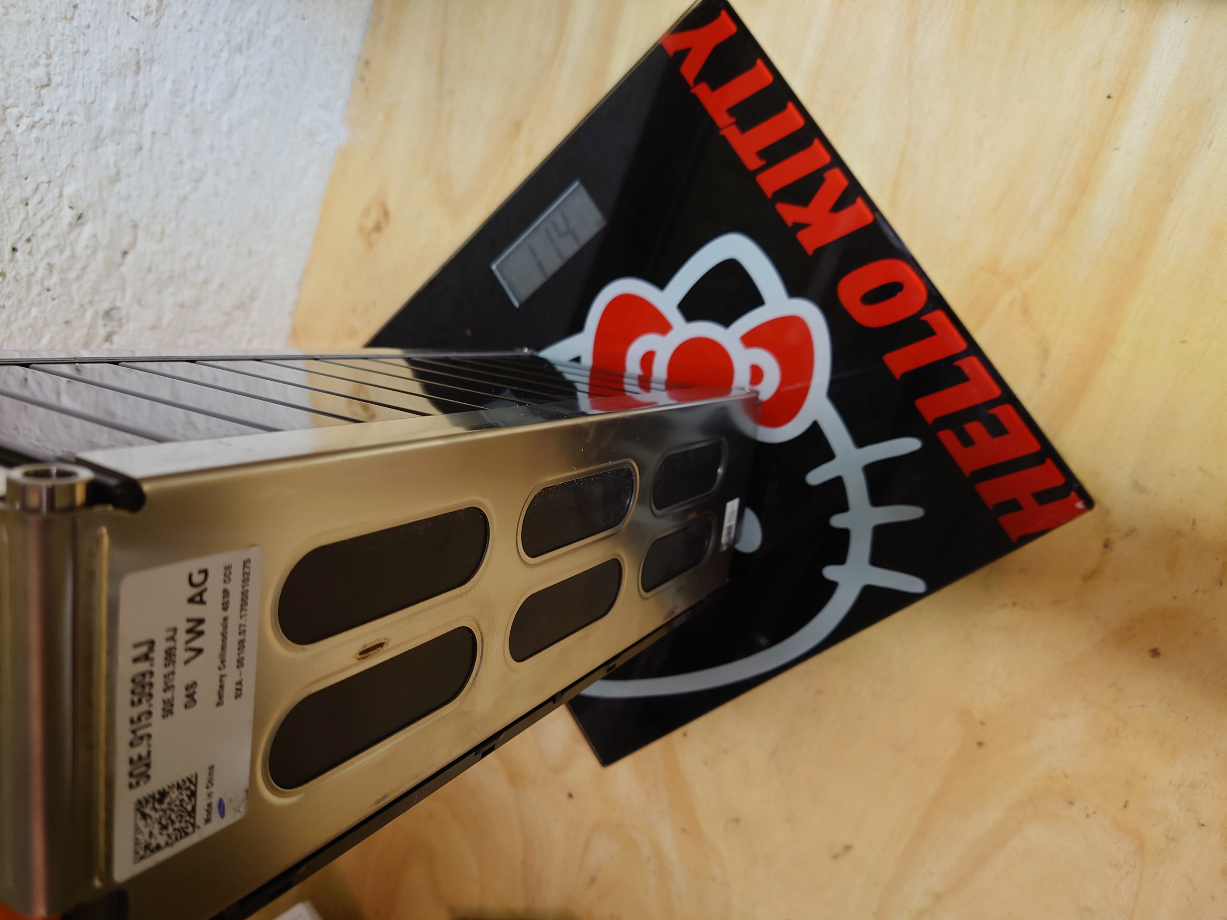

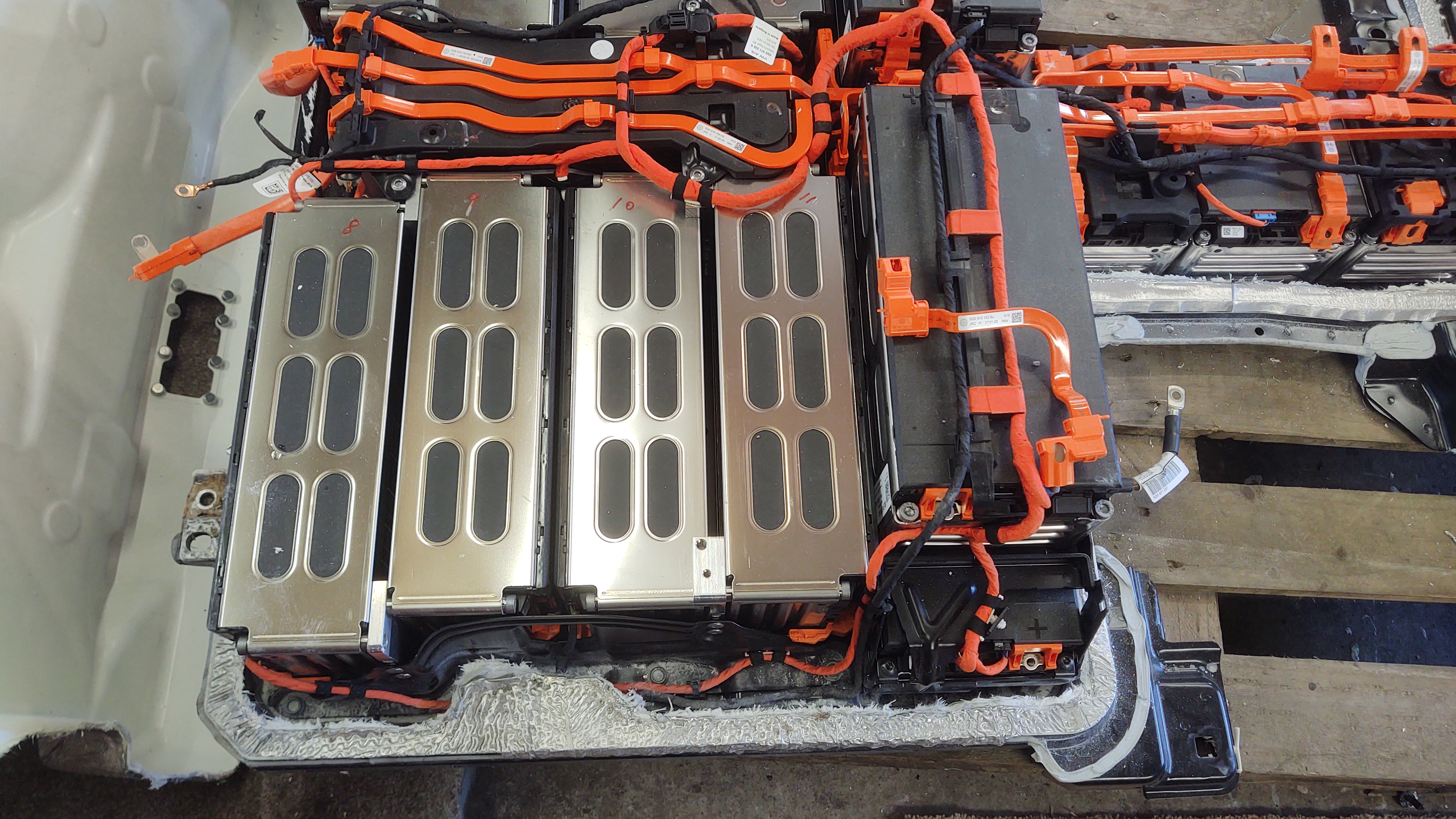

Hi guys
I'm considering purchasing a battery pack from a 2020 e-Golf so asked some questions in the ebay thread and Bigpie kindly answered me so I thought it better to continue the conversation here.
This is the pack I'm talking about. https://www.evbreakers.com/product-page ... hv-battery
It's a 35.8kWh pack from a car with only 165 miles so basically brand new.
The cells are a mix of 15.2V https://www.ebay.co.uk/itm/VW-e-Golf-15 ... SwDgtfqRK5
and 7.6V https://www.ebay.co.uk/itm/VW-e-Golf-Mo ... Swn9Jf7dRx
If I have this right Bigpie says I can currently use the CAN connections in each module to monitor voltage and temperature but for the moment not balancing. This means I have to either fix the balancing issue or use a third party BMS.
If anyone else knows more about these battery packs then please share.

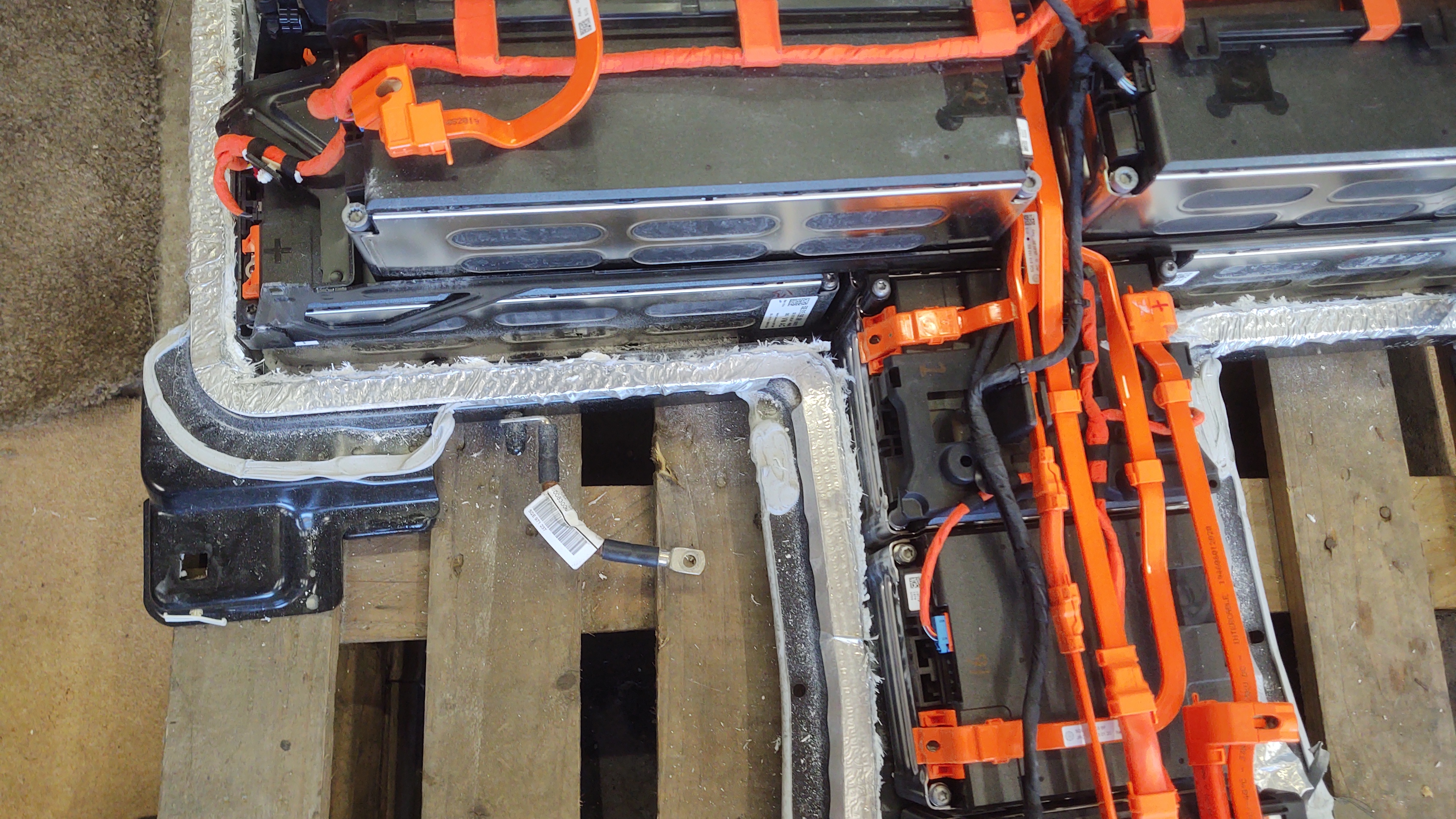

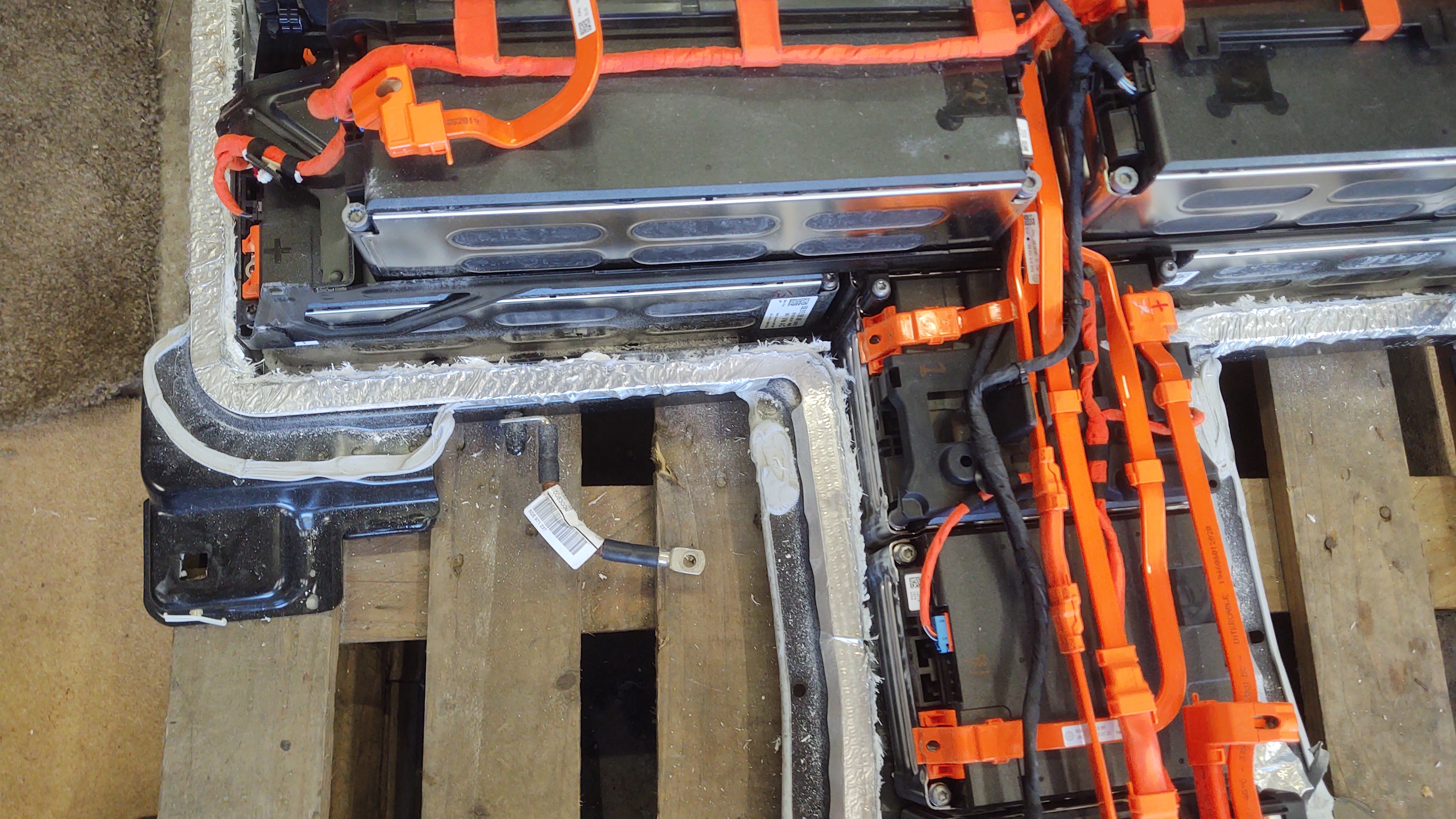

OK so the deal wasn't quite as good as hoped as VAT was involved but I made the purchase and will be collecting the E-Golf pack on Saturday. It is still around £2.5k less than slevb.com are asking for the same pack and I got a charging lead thrown in.
The guys in EV Breakers had already had a go at opening it but it's really well glued together and they hadn't quite got it open yet so it will be fun for me but I'll update further when I get it home.

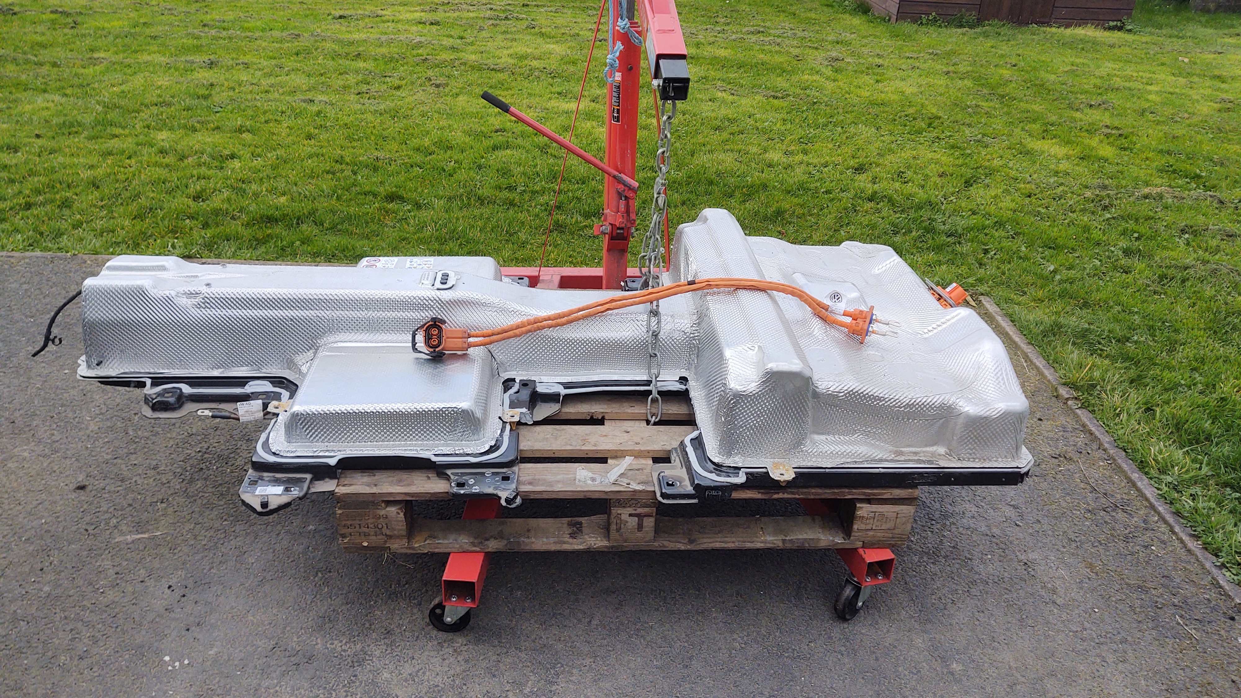

Re: E Golf Battery pack
Post by Alibro »
I picked up the pack today in my van and got it home safely. :D
I'm not sure how heavy it is but my engine hoist struggled to lift it even with the boom at 1.5 tonnes but I was able to lift it just high enough to let my wife drive the van forward leaving the pack hanging. The hoist was really cheap so it was probably the problem but I suspect the pack is well over 500kg.
Here is a pic of where I have it now until I get the motor mount fabricated and the car moved. Don't worry I have it well covered with plastic sheets.

According to vw the 24,2kWh pack is 318kg.
And it is the same size but different cells,
So i guess 3xxkg for the OG pack.
The modules in 35,8kWh pack themselves:
Larger module ~11,4kg / 35,5x15x11cm
Smaller module ~6,2kg / 19,5x15x11cm
-tape measurement
I just weighted them on trusty HelloKitty bathroom scale.
So +/- some hundred grams might be in order :D
Yes it's a bathroom scale reading of a 2019 e-golf 4S3P module.
You will find inside a mix of:
17x larger modules and 10x smaller.
There are 2 types of the larger module,
8 has a BMS slave inside and 9 are controlled by the slave module with interconnect cable, the interconnect does not include the connection between modules, so a HV connection is needed to make the slave see all the modules connected to the slave.
I tried to get it working with only BMS cables many many times with errors, then added HV between modules and pling it just works. The VW bms slave also need to see the "end of the loop" or it doesn't like work properly. So only the slave and it doesn't like to work.

JaniK wrote: Sun Mar 21, 2021 7:53 am According to vw the 24,2kWh pack is 318kg.
-tape measurement
When you say "It just works" do you mean the BMS is balancing the pack all the time as soon as the cells are connected. If so I won't need to use the Leaf BMS at all. :D
