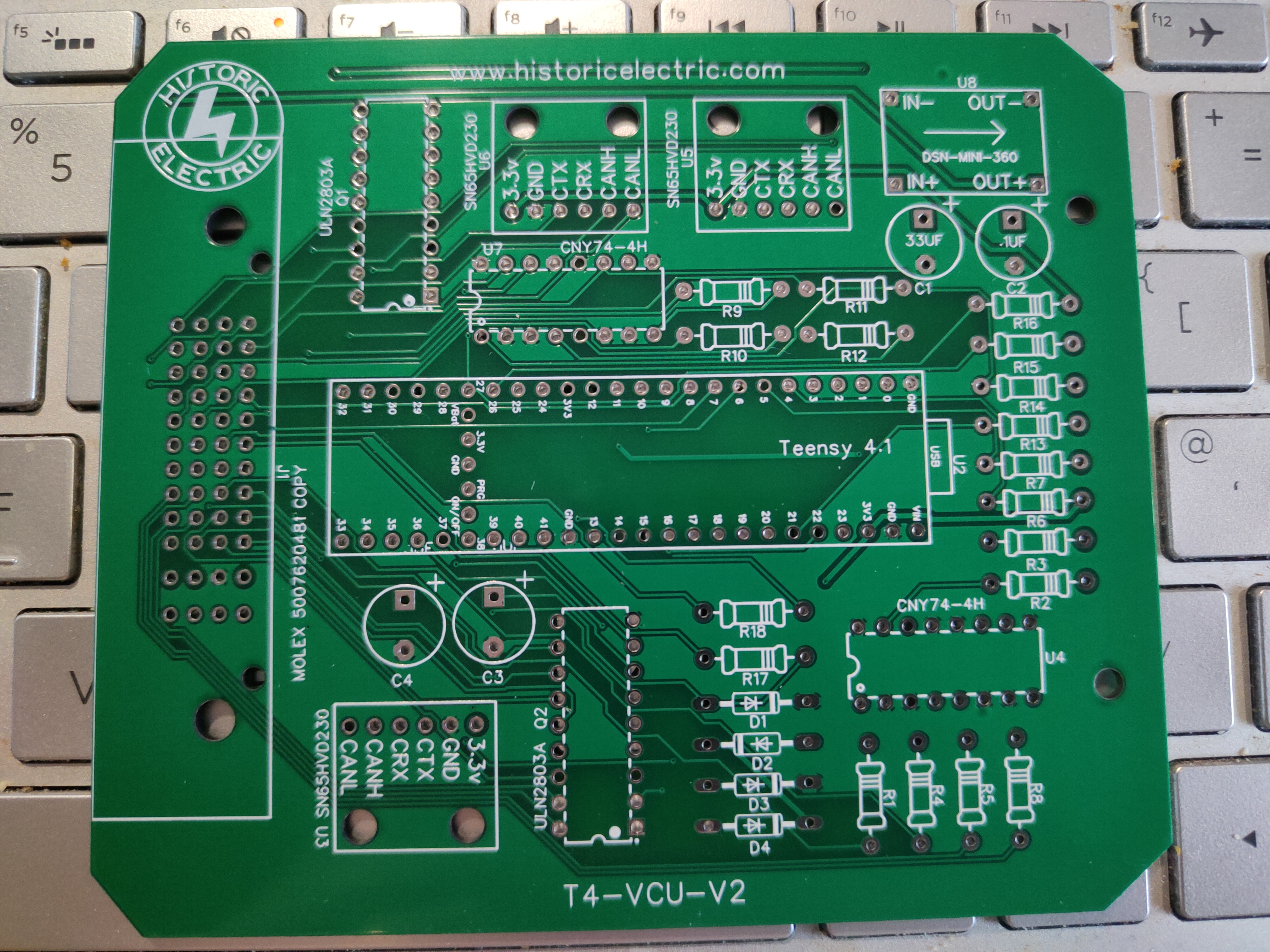

I built the VCU board now. In a day (or several) i will be able to install the program.
In the meantime i would like to setup my car simulator with motor and inverter. Can you tell me how did you connect inverter Hirose connector?
Obviously inverter CAN lines are connected to VCU CAN2 but do you use any other inputs of inverter. I recall i could be using RSDN pin with notaus button directly. This could be pulling 12V down in case of any errors.
Also do you connect ignition pin of inverter to VCU, which pin?
Anything else interconnected?
tnx

Post by aot93 »
Good to hear the progress!
I connected RSDN to Drive contactor of BMS, that way if the BMS faults it should be a graceful shutdown of the inverter.
IGN goes to a relay pulled high by the key switch.
GND goes straight to GND.
You will need the link to motor to have the temperature, revolver and other data, the inverter needs to see this or it does nothing from my experience.
As a side note and mentioned in other threads, these connectors are very hard to find, so try to get them from where you pick up your inverter or motor from.

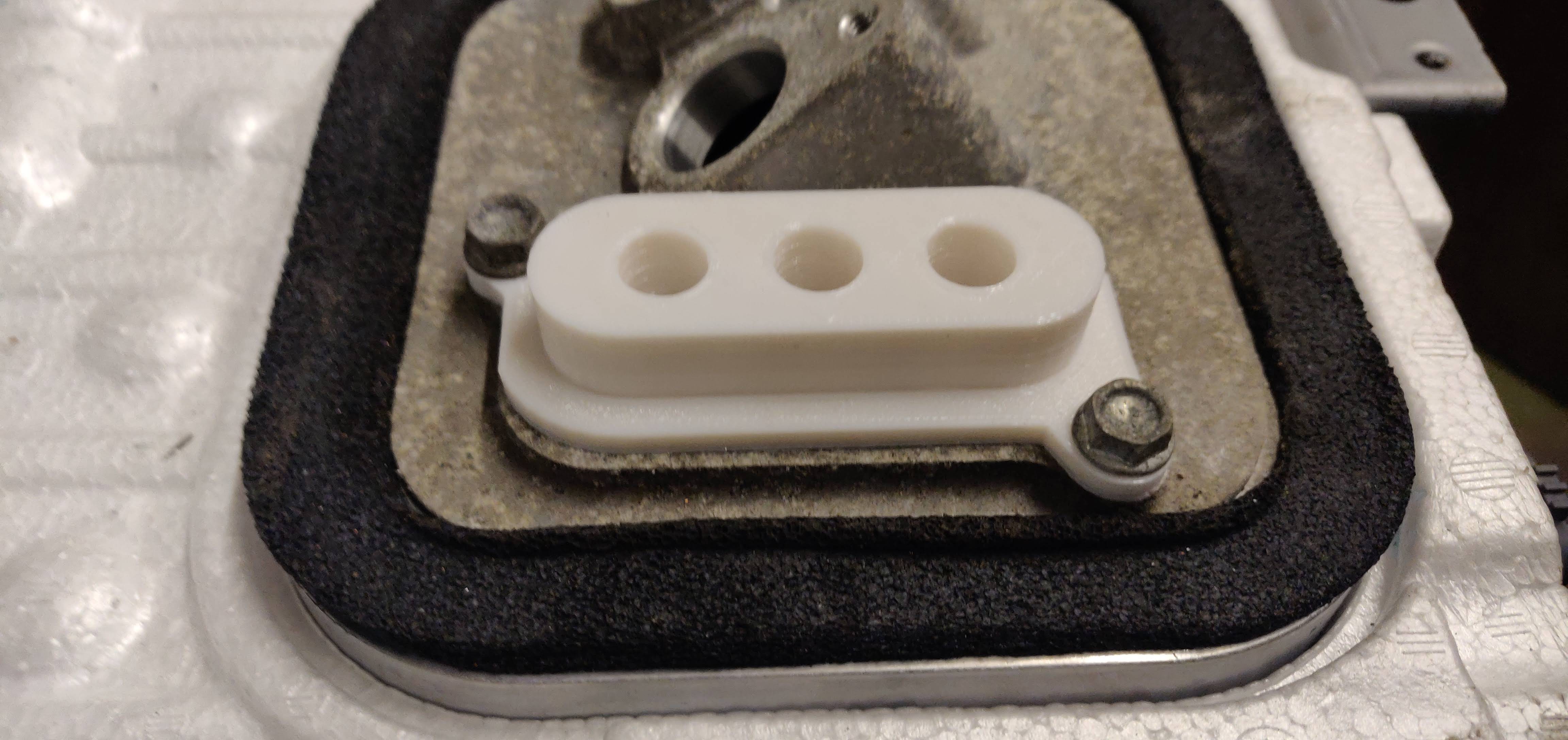

Talking of 3d printed parts I made a HV cable entry block for the motor or inverter. If you can't get the original this could be helpful.
motorPower.stl
(74.69 KiB) Downloaded 521 times

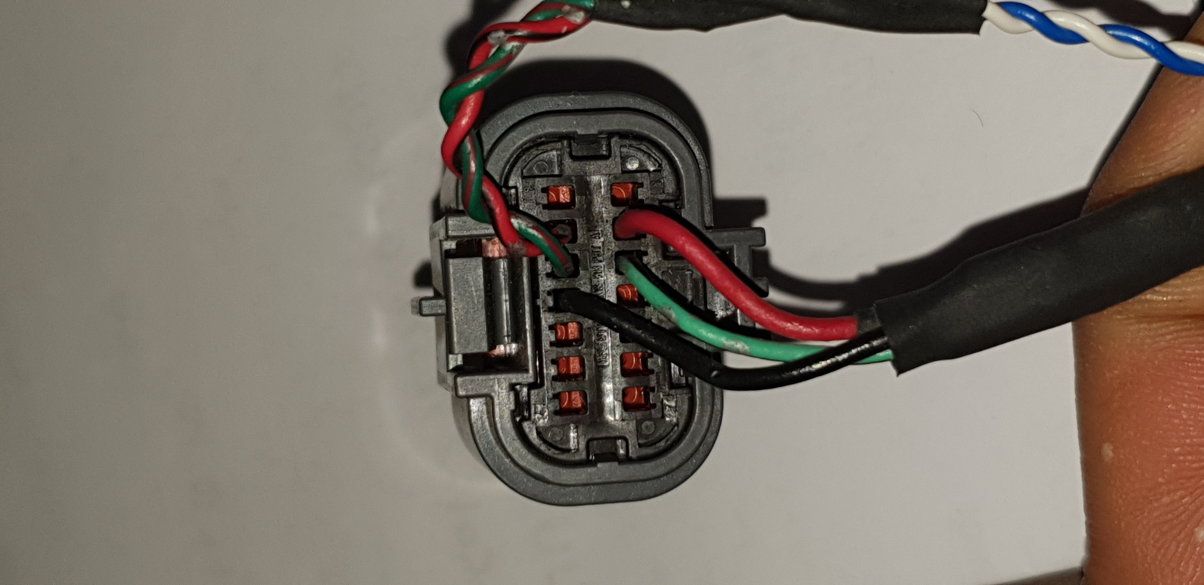

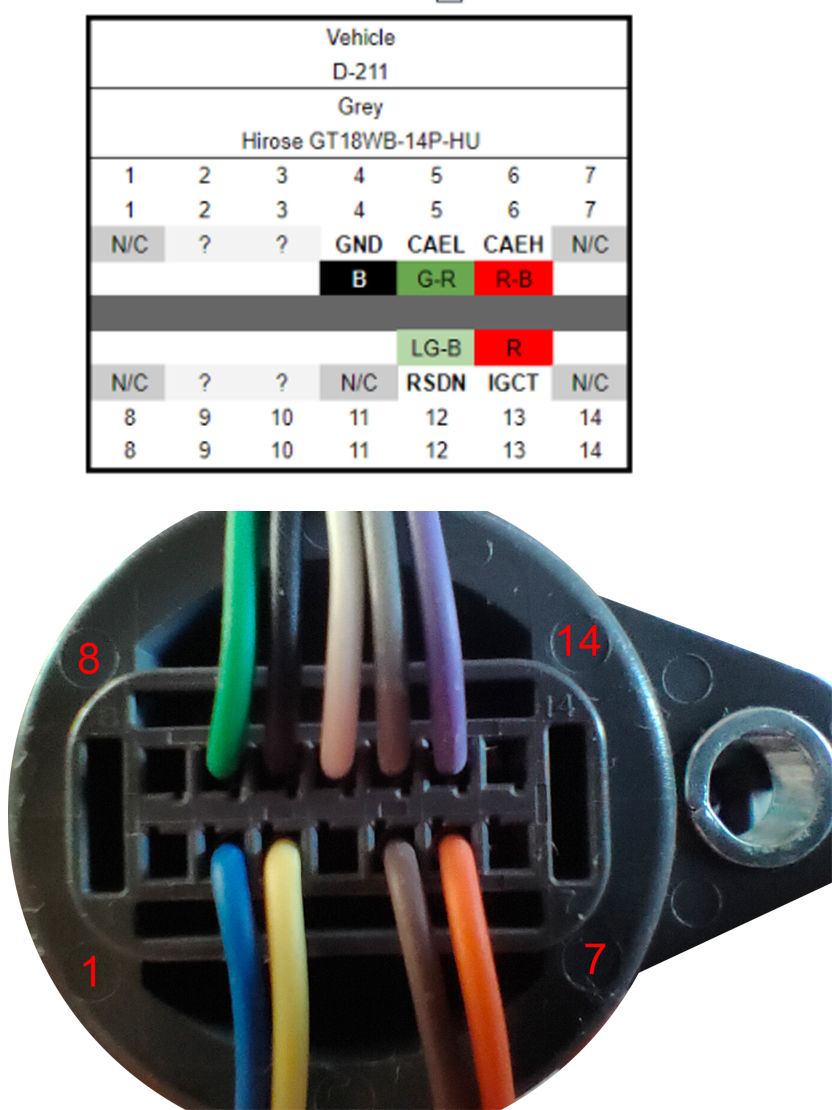

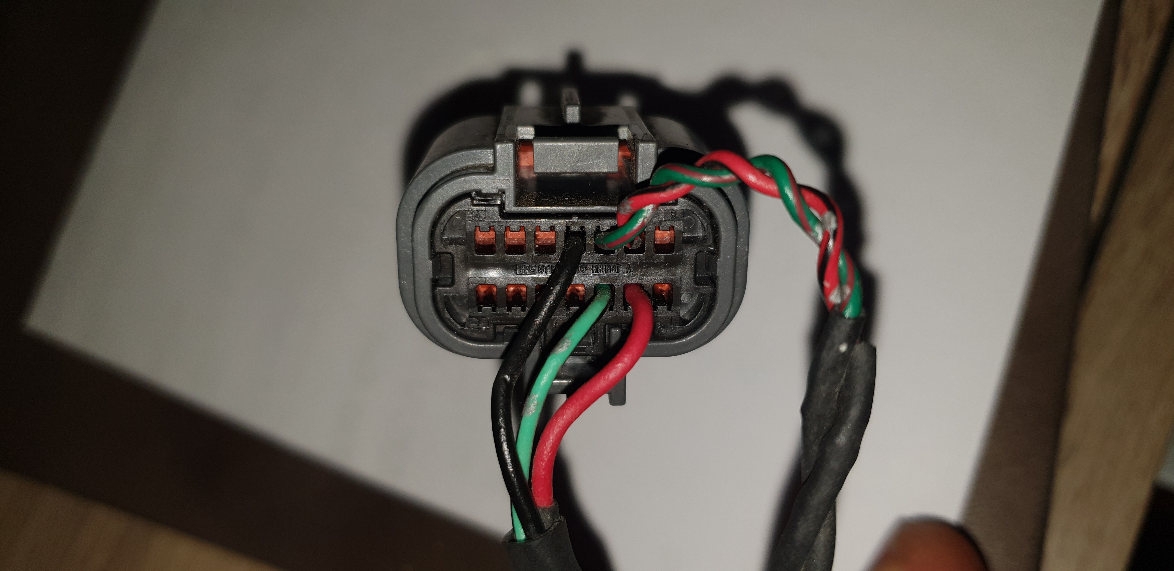

Hi all, just tearing down the inverter to get at the vehicle wiring (fortunately I have a loom for the resolver) and I am presented with a question!
This is the back of the grey connector (view from inside the inverter) and the pinouts from the manual.......As you can see they are different as pins 1-7 and 8-14 are upside down and back to front. The pin numbers dont worry me as all I am interested in doing is identifying the wire colours for CAN L, CAN H, IGCT, and RSDN. I can say with some certainty that white appears to be GND.
So, is CAN H Green or purple?
Is IGCT Orange or Blue?
Posts: 3795
Been thanked: 411 times
I see this on the other side. This is OEM connector.
It seems the sketch was made from the front side of connector. Black is GND and IGCT is ignition (red), RSDN is shutoff (light green). CANL is green red and CANH is red black.
It seems like internal connector CAN wires are black and green yes. White is GND. Yellow is RSDN and blue is ignition.

arber333 wrote: Mon Mar 07, 2022 7:28 pm It seems like internal connector CAN wires are black and green yes. White is GND. Yellow is RSDN and blue is ignition.
That is perfect, thanks!

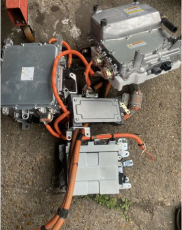

Also just bagged this lot for £225......I now have 3 inverters... :evil:
I am sure I will be tapping you up with stupid questions!

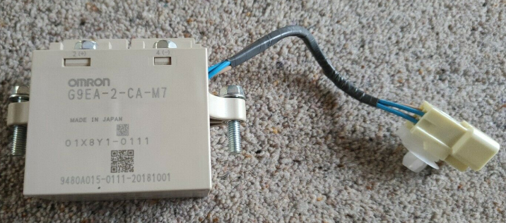

More ebay trawling and I picked up a battery box for £70
All I really wanted was the contactors as I didn't want to pay £70 each for them. I found that the +ve and -ve contactors are housed in a nice single package
As a bonus the seller included the 10 BMS units that sit on each of the cells......that is money well spent I think!

looking at the schematics, this looks like the quick charging contactor - need to dig in the other end of the battery box :D
aot93
Posts: 213
Location: UK, West Sussex
Has thanked: 8 times
Been thanked: 49 times
Post by aot93 »
Yep that is the chadamo one. (I used it to run my heater)
The other end under the fan should have a three pole one which is the main drive package.
There are a lot of handy parts in the case, I reused most of the wiring.

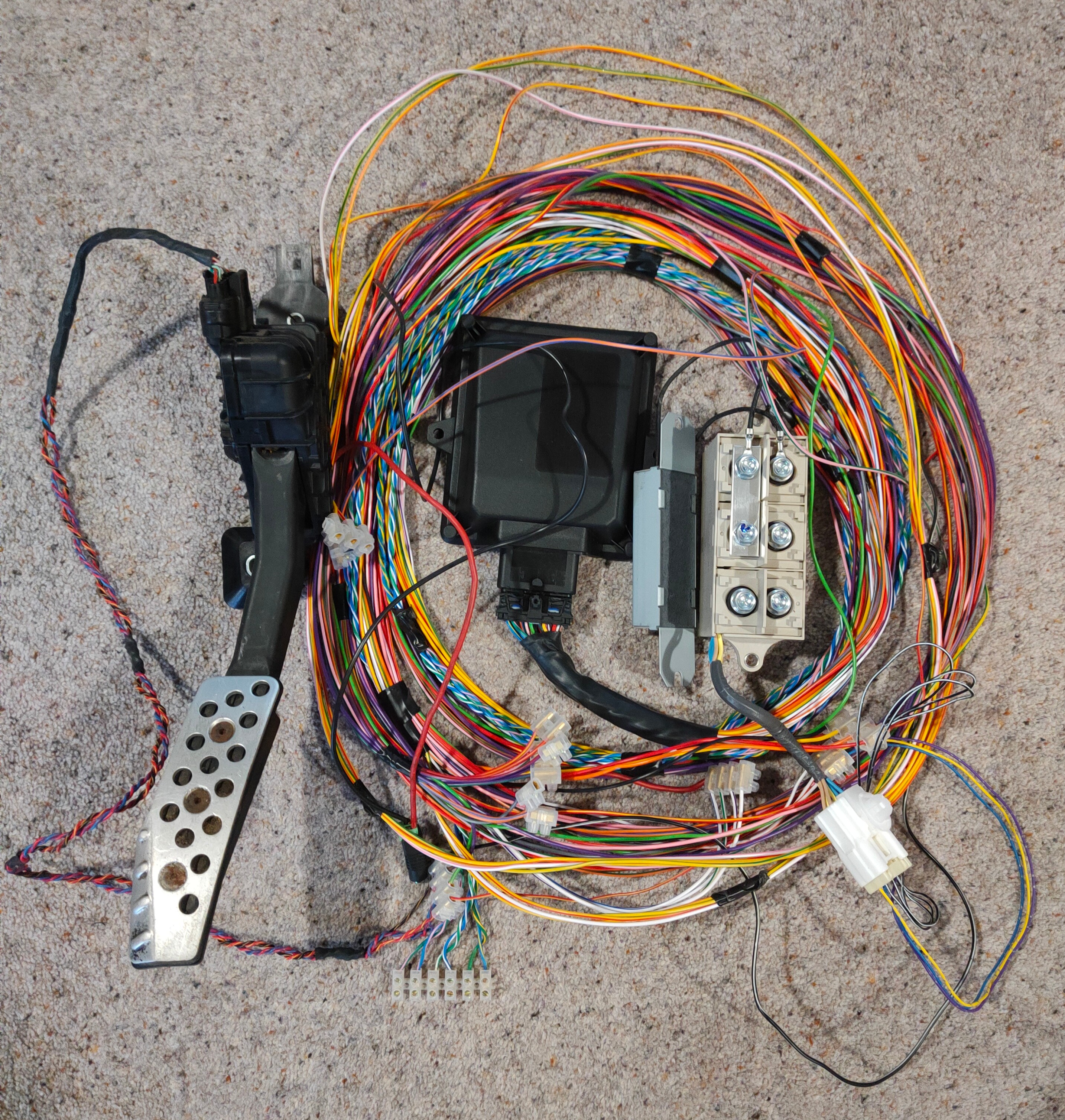

So, I have made a harness, powered up the VCU and managed to run some of the menu items.
Throttle position set points done
Control of contactors (neg, pre charge, pos)
I am still waiting for the opto isoloator chips so cant do anything with the inputs and all of connectors are on chocolate blocks until I actually need to put the loom in a vehicle.

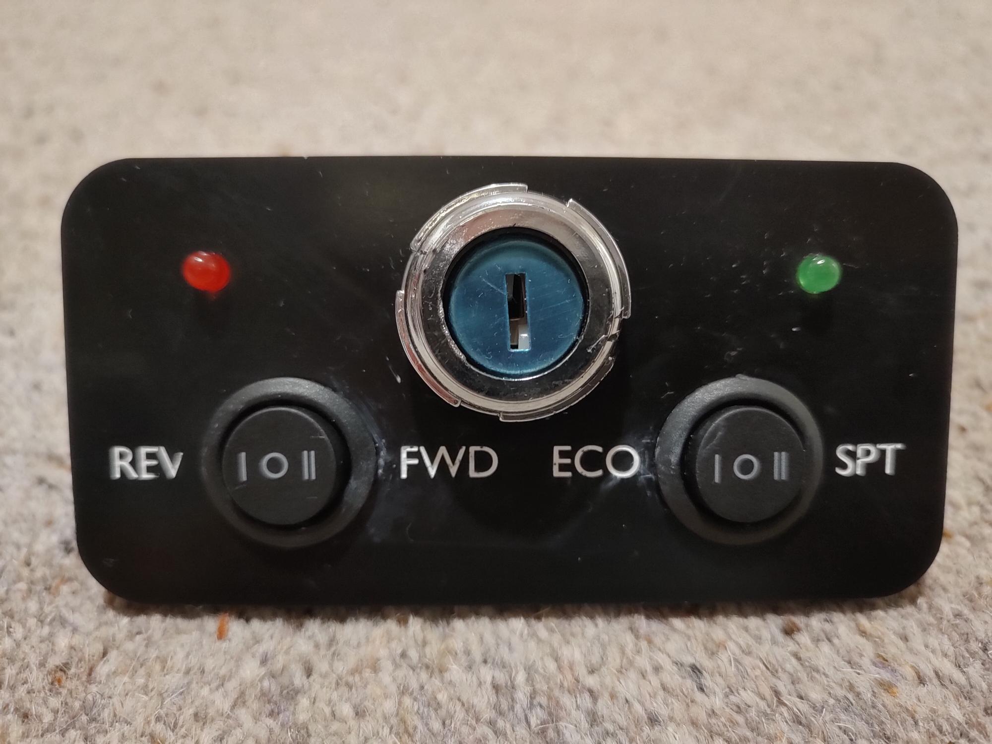

While I wait for the optos I thought I should make a miniature dash for the bench that works with the code in the first thread 8-)
