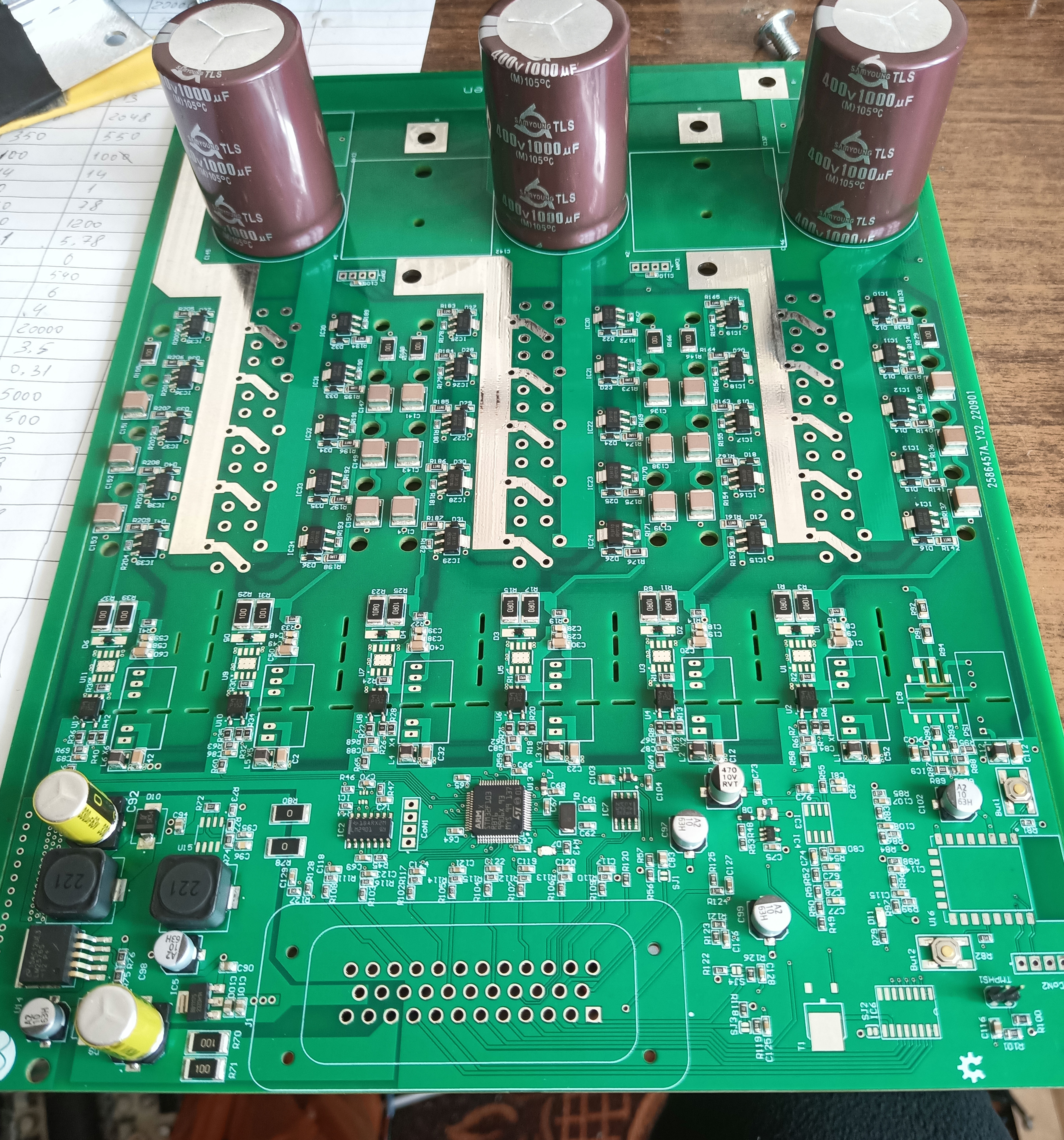

hello everyone.
the story with these boards continues slowly.
I'm almost ready to start testing them. several manufacturing errors were found, they decently took out our brains)), but we found them and eliminated them.

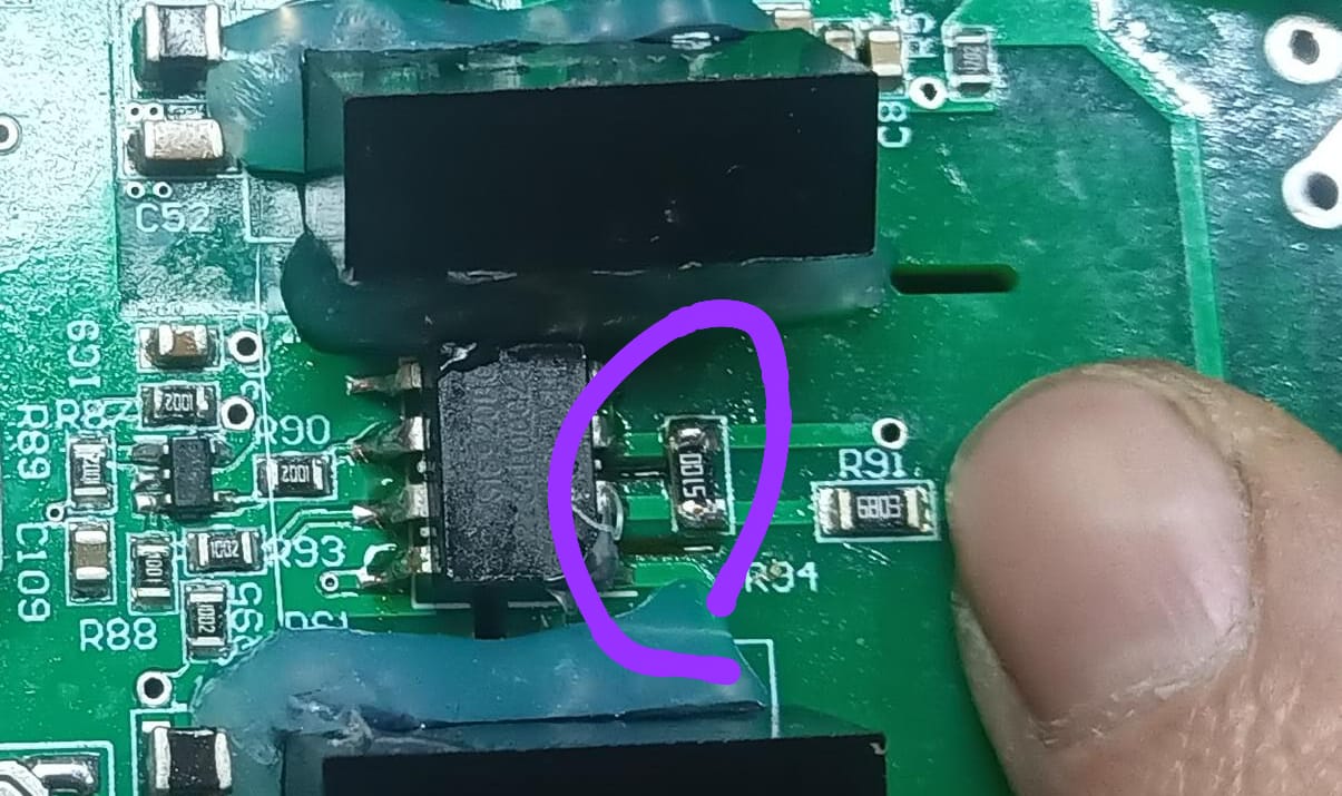

Now I'm stuck with the inability to calibrate the high voltage reading. after two resistors of 680 kohm, a 510 ohm resistor is parallel to the signal. it seems to me that this is a mistake and the nominal value should be higher. otherwise, even 100 volts of board power supply give 0 volts at the input to the meter chip.
evil neodymium
kiwifiat
- Posts: 101
- Location: Vancouver, Canada
- Been thanked: 12 times
Re: all in one board for open inverter project
You need to arrange the divider network on the high voltage side so that you see a maximum of 200mV across the 510 Ohm resistor at full battery voltage. Take a look at the datasheet for the si8920.

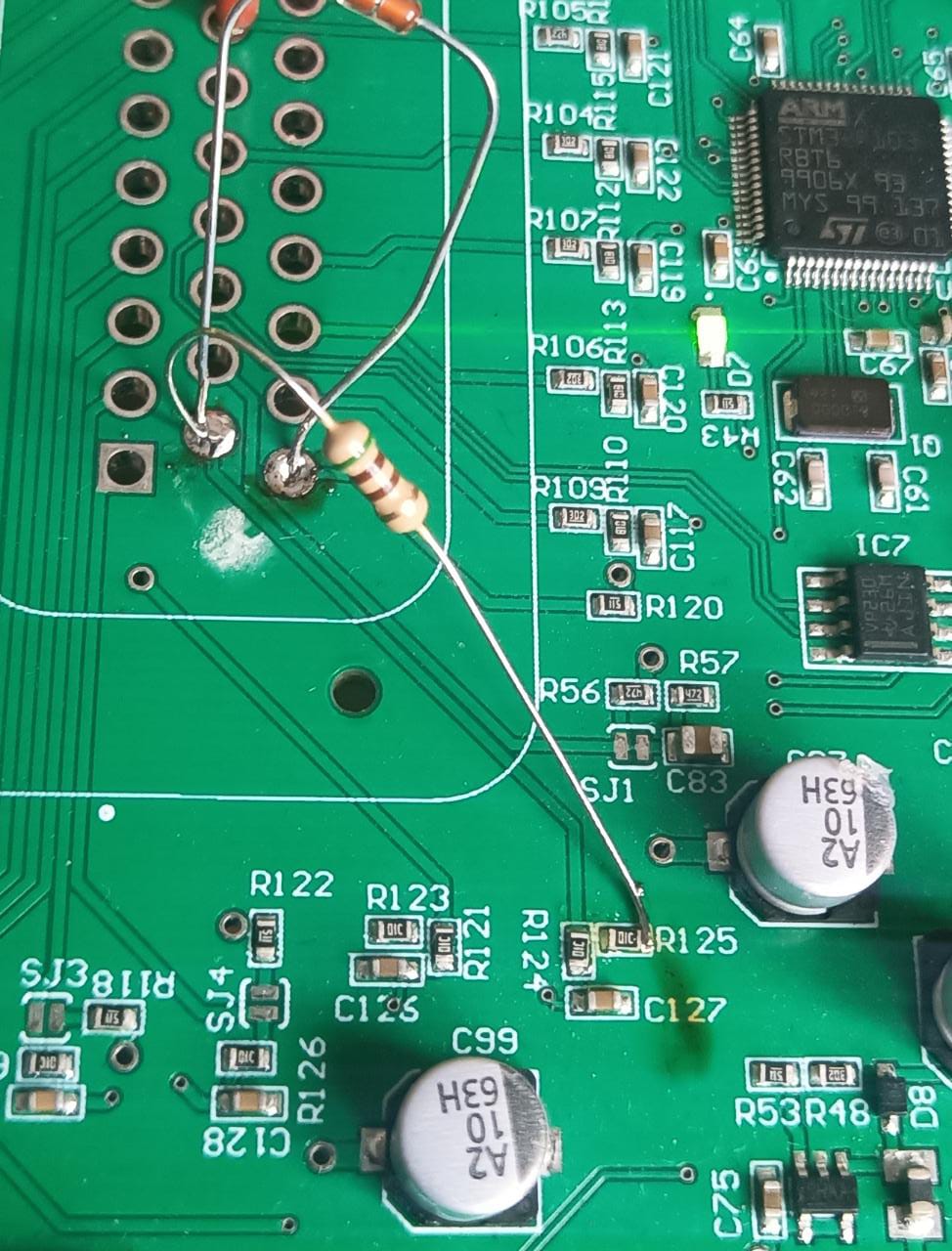

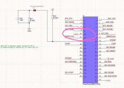

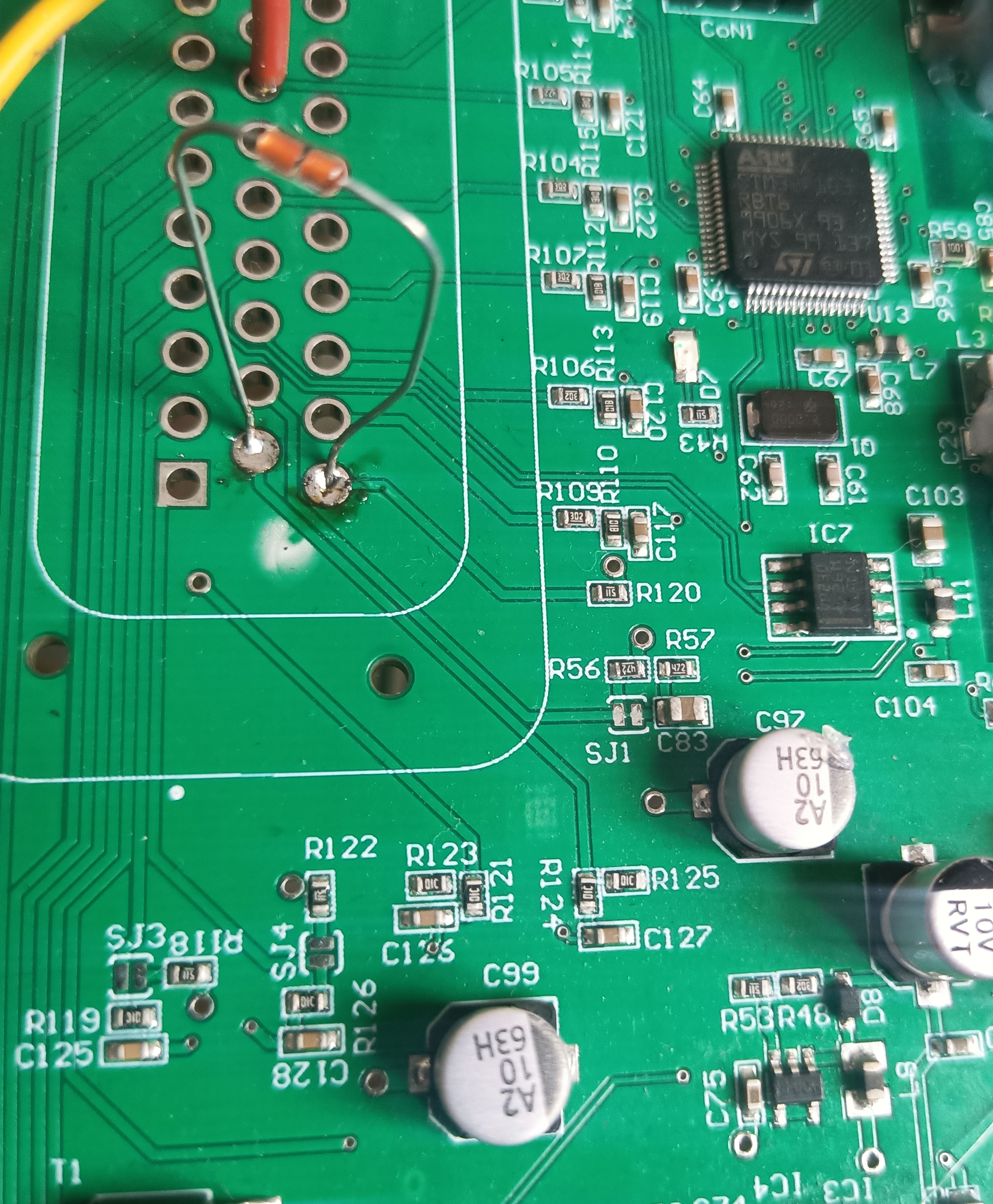

I found another mistake. or rather, only the consequence, I have not yet found out the reason itself. soldering the temperature sensor into the slots responsible for the motor temperature sensor and specifying this type of sensor in the settings gives -40 ° at room temperature and no changes when the sensor is heated.
the kty84-130 sensor itself.
probably need to add some filters or dividers?
evil neodymium
- Been thanked: 1913 times
Software expects the sensor to be between two 500 Ohm resistors, one to GND, one to 5V. Voltage is measured at the upper resistor.
thanks. I'll check if I really am.
Halil said that this part fully corresponds to the V3 board
evil neodymium
- Romale
- Posts: 550
- Location: Romania
- Has thanked: 346 times
- Been thanked: 101 times
This helped (I hope I haven't replaced the resistor yet) on the r125 board, who is responsible for the gnd = 2.47 kohm instead of 500 ohms.
