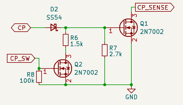

Assuming it makes sense for this device to handle AC charge negotiation too.
For CP, here's a starting point.

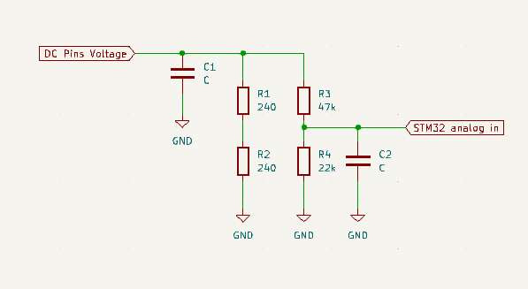

Can you add an analog port like this? In the LIM it is used to measure the DC voltage at the connector. So my board or that of larsrengersen could be used as an alternative to your Dieter.
- Sensing Board In.png (8.04 KiB) Viewed 726744 times

muehlpower wrote: ↑Wed Jul 12, 2023 2:38 pm Can you add an analog port like this? In the LIM it is used to measure the DC voltage at the connector.
This would certainly simplify my install.

Vgs max for the device is only 14V so danger of over volting it
Wondering whether the HCT gate is the way to go after all, just use something like a HCT08 (AND gate so no inversion) instead so that a low on the input defaults to the contactor being off?

Meh - I think uhi's original design is absolutely fine. No need to overthink this. A buffer IC powered from 5v with a pulldown on both sides will drive the thing just fine

Not really fussed but to me a 3V3_uC rail fail = contactors on is not ideal. Uhi's design but with a non inverting buffer instead of the 04 sorts it so seems worth doing to me?
Edit - ignore me there I'm taking rubbish, that graph is just the VI curve, doesn't allow for power dissipation which is the limiting factor here.
Not sure what you mean, are you looking at Fig6 in the data sheet, if so that's Vds not Vgs??
