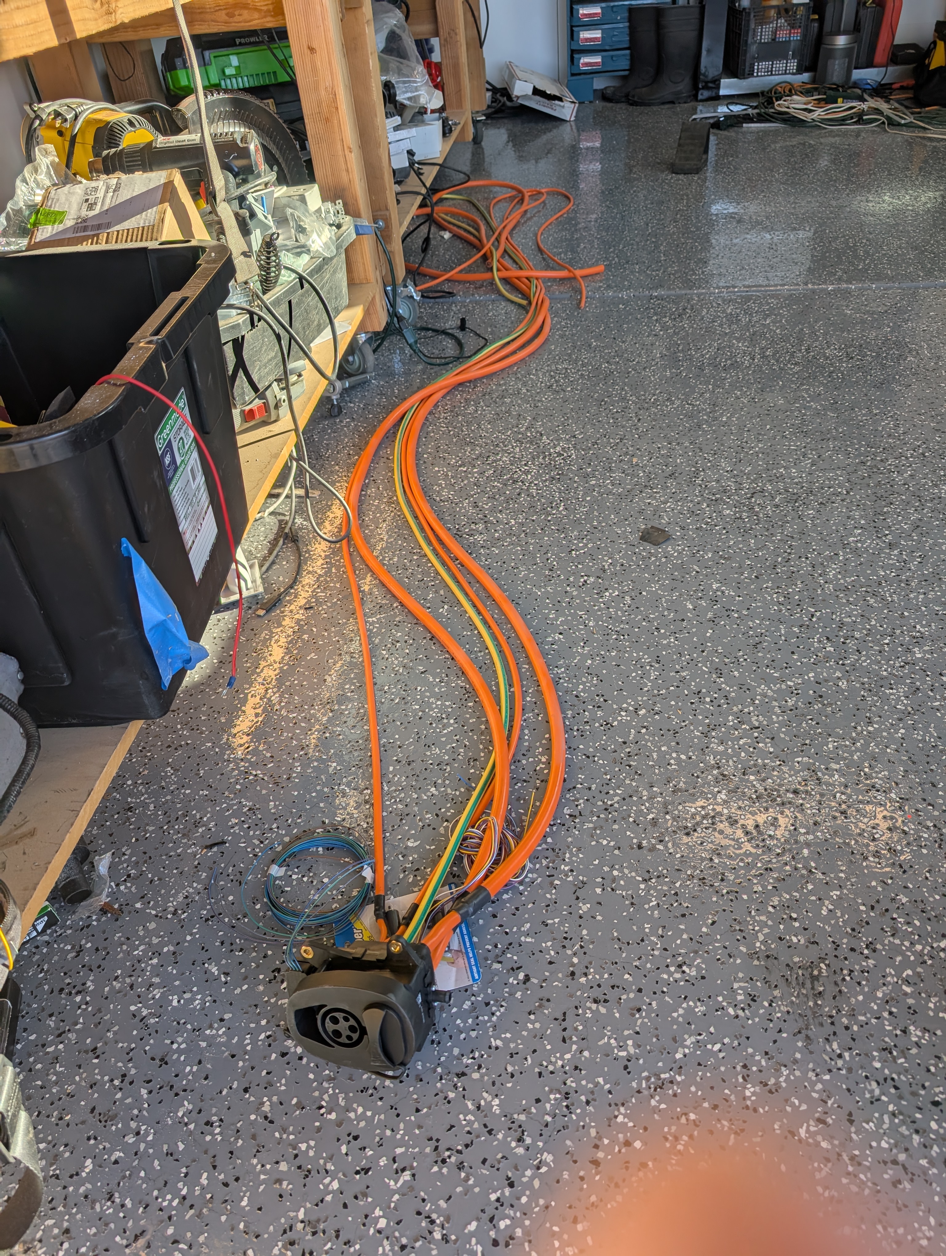

First, I would really like to thank you for your help. Next, I will tell you that to charge the vehicle I have been turning the ignition to Accessory to charge so that all the 12v systems power up, but the truck is still in off OPMODE. Here are the charging sequences I have tried:
Accessory mode->plug in charger->The AC charging works->I unplug the charger= the truck is still in charge OPMODE
Plug in charger->Accessory Mode->The AC charging works->I unplug the charger= the truck is still in charge OPMODE
Ignition Off->Plug in charger->The AC charging works->I unplug the charger=the truck is still in charge OPMODE
When the truck charges, it doesn't seem to leave the charge OPMODE when I unplug the charger. No combination of accessory or start signal from the ignition makes it leave this mode. I have to hard reset or power cycle the VCU.
Also, the zombieverter seem to automatically set the UDCSW parameter to 330 when I set it to 300. Is this because the pack is so degraded that its automatically being set to the lowest safe voltage based on the weakest cell in the pack?

Do you have anyway to log the CAN bus it seems your PDM does not report the correct charge connector status. The info that is used to go out of charging.

I can see byte 5 of 00x390 going to 0x8C at end of log which is an error state. It does show 0x88 when plugged in which is good.
What is the resistance of your charge port, proximity to ground?

tom91 wrote: Sat Jan 18, 2025 9:02 pm I can see byte 5 of 00x390 going to 0x8C at end of log which is an error state. It does show 0x88 when plugged in which is good.
Also what else is connect to cause the 0x7xx messages?

What does that say? Kohm? You disconnect it from the pdm?

tom91 wrote: Sat Jan 18, 2025 10:44 pm What does that say? Kohm? You disconnect it from the pdm?
I did extend the charging connection from the PDM to that gas port but didn't permanently mount it yet since I was going to replace it. I just received a new CCS1 port that I'm going to use to add the Foccci in the future.
Here is a better picture of the multimeter which is reading 7.97 mohm now:

The OE Nissan has 2.7Kohm between Proximity and group

I replaced the old extended j1772 port with a Phoenix Contact CCS1 port at the gas fuel door. This fixed the charging issue, which seemed to be a bad pp line.

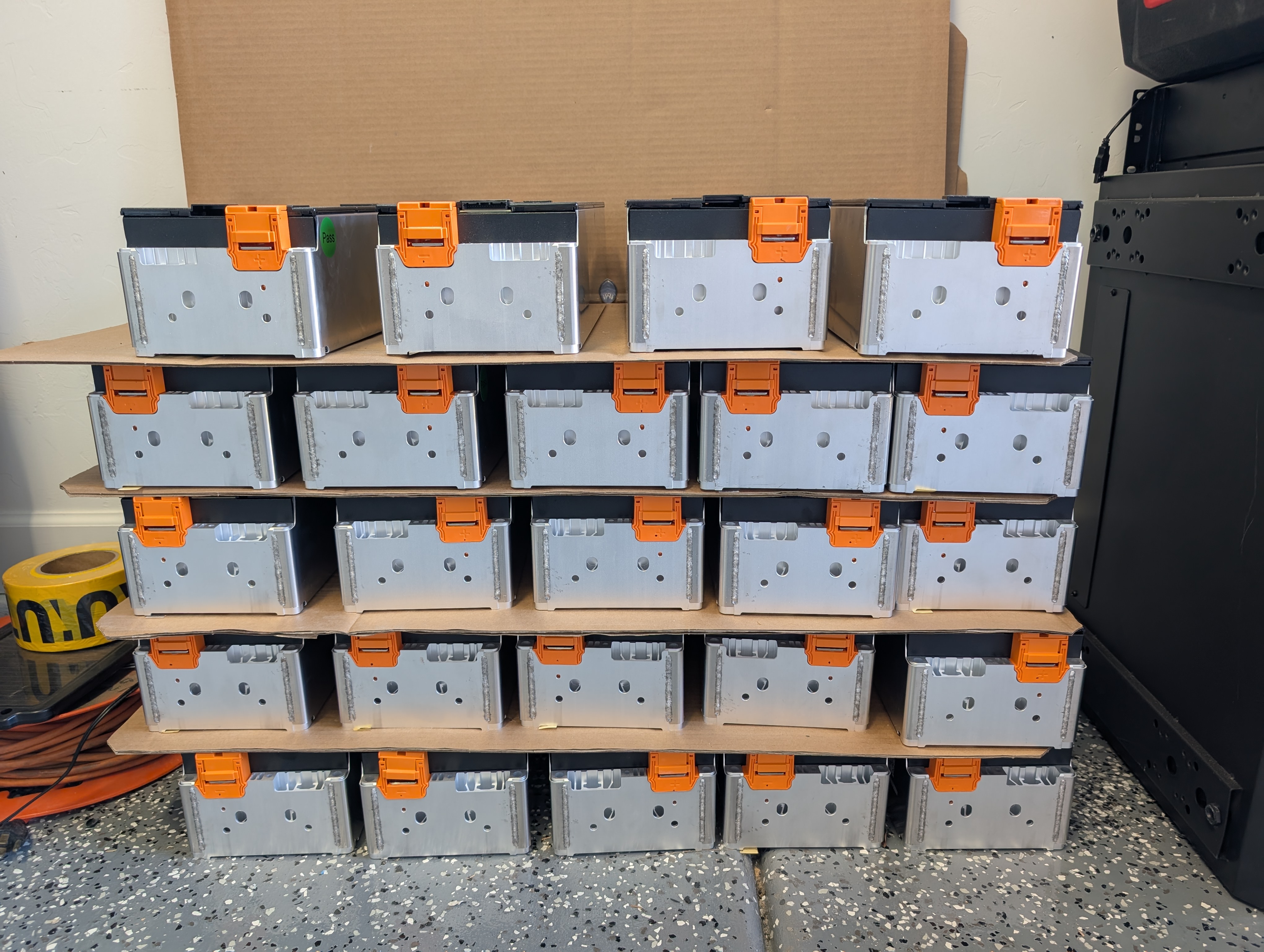

I got 24 4s1p Sunwoda 2.2kwh vda355 modules for a new battery pack. I'll use the OpenInverter BMS in the new pack.
Are these from battery hookup?
From my memory they don’t have a very high c rate

Yes, they are from Battery Hookup. The site claims 150 amps continuous and 450 amps 10 second pulses. That is about 1C continuous and 3.4C pulse. Will that be ok for general use?

Sector7e wrote: Sun Feb 16, 2025 5:32 am Yes, they are from Battery Hookup. The site claims 150 amps continuous and 450 amps 10 second pulses. That is about 1C continuous and 3.4C pulse. Will that be ok for general use?
Oh that should be fine, I just remember seeing much lower specs, perhaps my memory is not serving me right.
Are you going to make two packs under the bed?

I was thinking about making two packs under the bed or a single battery box similar to your 720. I haven't fully committed to a design yet. I wonder how different our frames are? 🤔
Posts: 965
Has thanked: 154 times
Been thanked: 334 times
Re: [Driving] 1996 Nissan D21 Hardbody 4x4 Leaf Swap
It’ll be tight, I was doing one saddle pack, with a drive shaft tunnel. Which would require the drive shaft removed to drop the pack. the king cab takes up more space unfortunately.
Being 4x4 the frame is quite different and the hardbody is wider. So you might have more depth!
as long as you can have dead space from the bottom of the cells to the bottom of the pack. If not a 3rd box bellow the tail gate!
I was going todo laser cut aluminum plates that 4 modules bolted to making an assembly.
