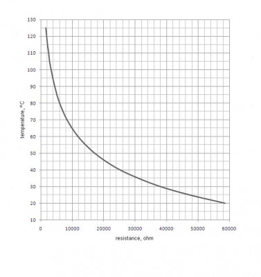

Looking at the mg1 and mg2 thermistors today. This NTC thermistor appears to be similar to the Prius mg1/2 temp sensor. Beta is 3900-3950K and resistance at 25C is 47kohm

We may want to look at changing R35 and R42 pull ups from 1k8 to something much bigger. With the existing pull up the temp has to be above 90c before the adc comes into range. Maybe recommend 45k pull-up, but could use something much smaller to keep the adc happy.

My calculations were 249k for some of them. Working on this now. 1k8 were placeholders. If you have any input, that would be great.
I need to get the SH-H values for these sensors as well. Would be nice if we could get a collection of thermistor values at verified temperatures. for all 4 thermistors. I'm not sure how Ill do it.
Dilbert
Posts: 410
Location: Dublin, Ireland
Post by Dilbert »
I guess we just need to be in the ballpark with the values, a few degrees out shouldn’t matter too much. A beta value of around 3500 is probably a good starting point, so if we know the 25c value for the thermistor that should get us something to work with.

xp677 wrote: Sun Mar 01, 2020 10:56 pm My calculations were 249k for some of them. Working on this now. 1k8 were placeholders. If you have any input, that would be great.
I have used this site to calculate SH-H coefficients:
https://www.thinksrs.com/downloads/prog ... lator.html
It would be nice to see SH-H support as an option in the firmware.

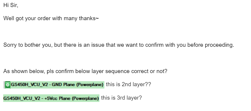

Hi
I just ordered PCB from JLC and they asked me a difficult question. I'm not familiar with 4 layer PCB's, I don't know how to get this info from design spark.
PS, there are 11 extended parts, so they cut two resistors from assembly parts list
