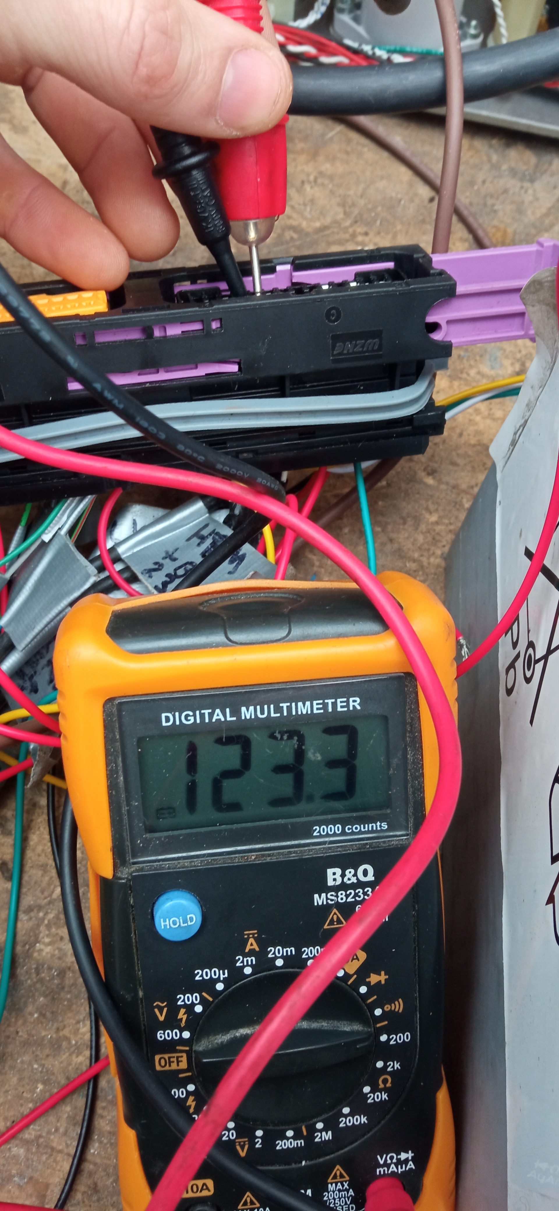

Jacobsmess wrote: Fri Dec 08, 2023 10:58 pm I've gone through and checked wiring and continuity this evening but nothing but I also checked the torque Vs pot and there is no torque request with pot change.
Did you check inter-pair resistance? Should be 60ohm across each pair?
I had problems getting the motor to spin without solid ground connections between inverter, motor, and zombie.

I did and got 128ohms across each pair measuring the same end of each (unplugged zombie). I thought it should be 120ohms....
I'll try the ground but have tried with an alumiun bar connecting inverter and transmission and signal wire shielding to inverter and then a wire connecting inverter to the negative of the battery.

120 on each end, so 60 if both zombie and inverter connected

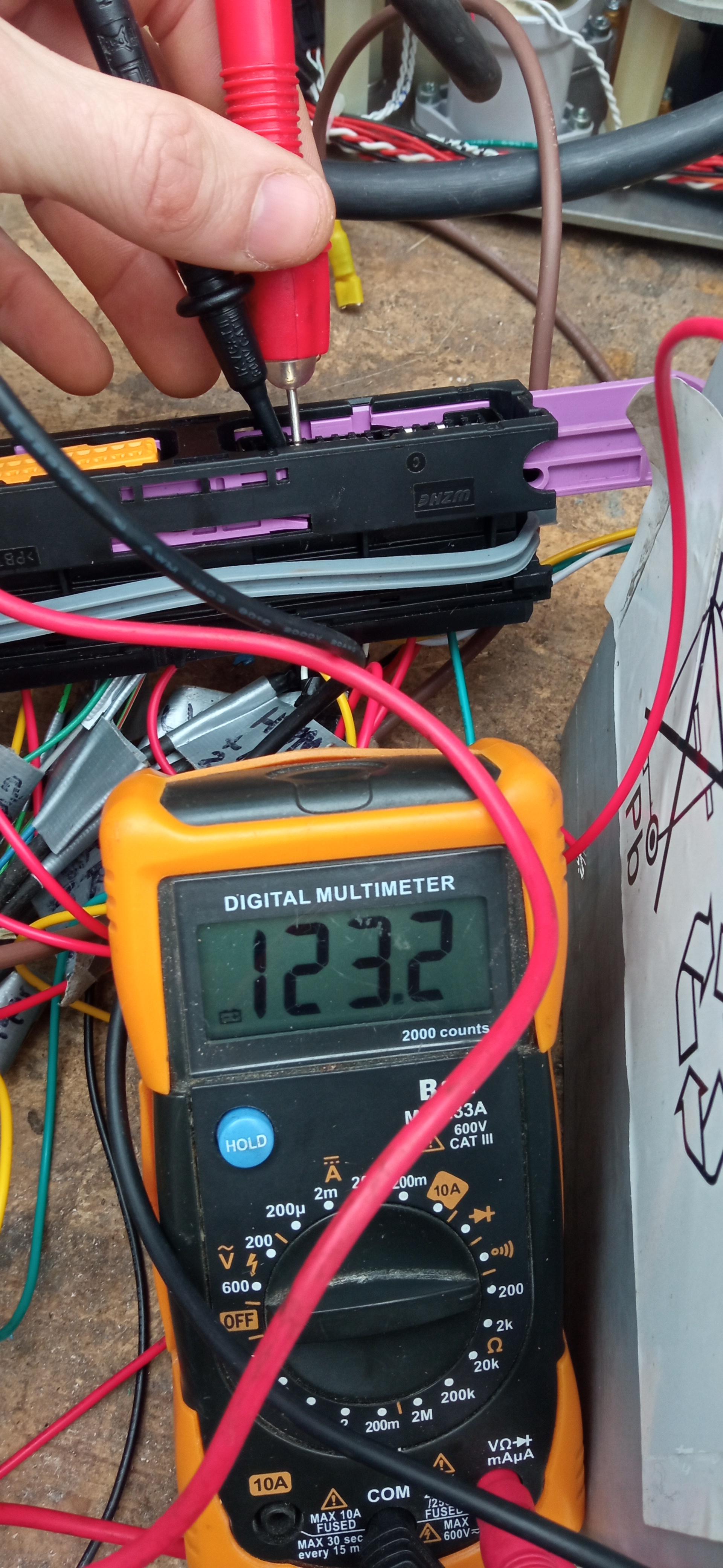

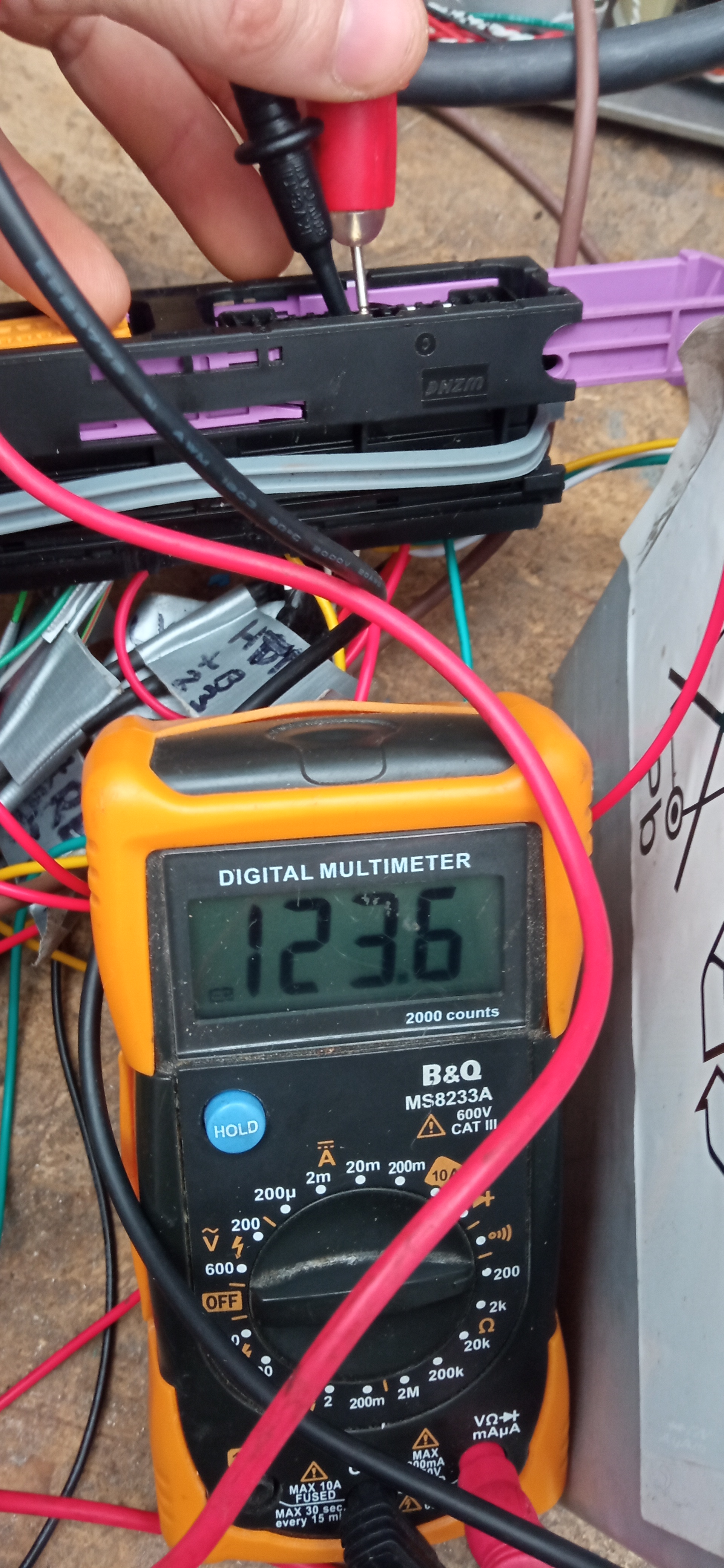

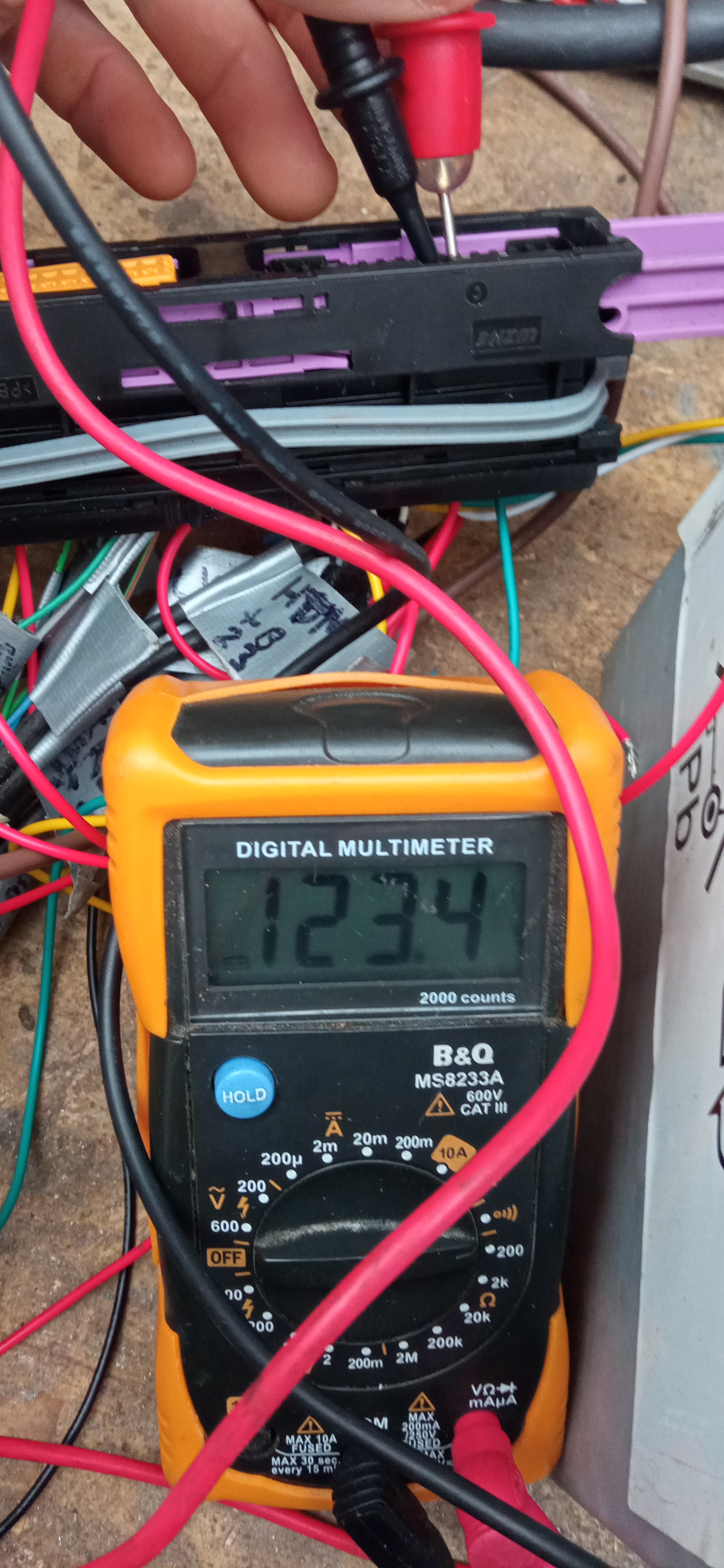

Resistances on zombie plug across signal pairs. All around 120ohms

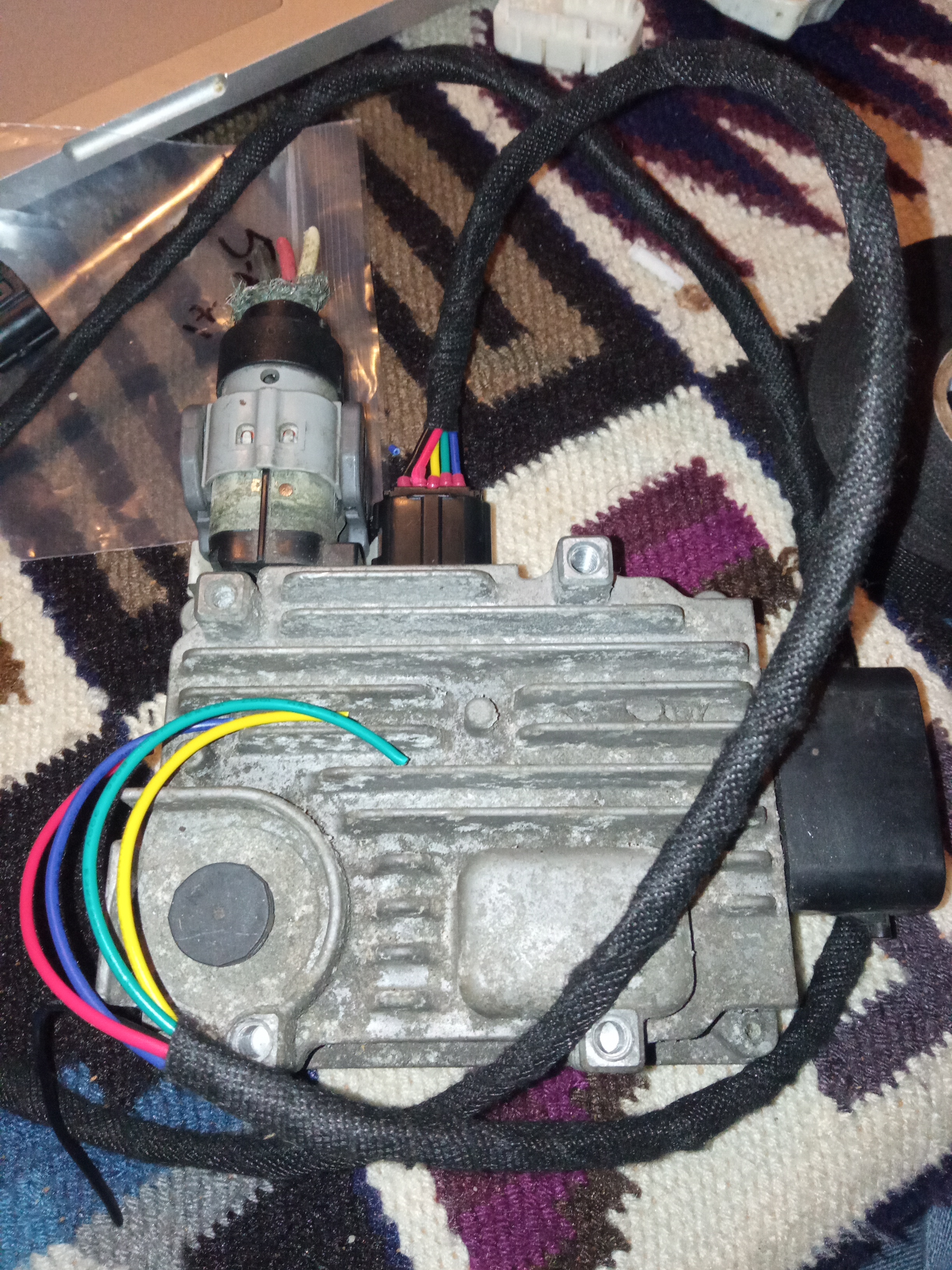

First wiring harness (half) made up for the oil pump controller....

The cloth tape isn't always suitable for outside applications, it might go moldy.

crasbe wrote: Sat Dec 09, 2023 10:42 pm The cloth tape isn't always suitable for outside applications, it might go moldy.
Ah that's a bit annoying but thanks for the heads up. What would be a suitable alternative tape-wise? It's be nice just to rewrap the existing cloth in something rather than remove it completely if possible. I may add conduit also at a later date when installing.

Get some good quality PVC tape from a reputable brand. Coroplast or Tesa for example. The cheap tape becomes "slimy" rather quickly.
You can get cloth-like tape which is suitable for exterior applications like TESA 51036 (recommendation from Tom91 :D ).
Tesa has catalogues which you can go through and find good tape for your desired applications.

There is 3m self amalgamating silicon tape, that when stretched so the dimples dissappear and bound, is extremely durable.. this maybe suitable to overwrap your loom.
