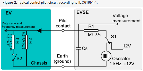

Re: Foccci wakeup/sleep discussions
If your charging station tells you a CP error, it want's to say that it did not detect the circuit in blue box.
I see three potential root causes:
1. The charging station is defect and tells bullshit.
2. The wiring between the charging station and Foccci is wrong.
3. The Foccci does not behave like the blue box.
To find out, which of these is the case, I propose that you grab a diode, two resistors and a switch, build the blue box, and connect it to the charger. With this you can find out whether (1) is the true. And then connect the same circuit instead of Foccci, so you can check whether (2) is true.
The resistance measurement at the vehicle inlet is tricky, because there is the series of diode and 2k7, so depending on the multimeter it shows "something" above 2k7 in the one direction and "infinite" in the other direction.

Two ideas:
- check the voltage levels of the PWM with the oscilloscope. It should be -12V and +9V after plugged-in, and later, when the charging is active, it shall be -12V and +6V.
- Foccci does not contain more than the blue box. But if Foccci would have closed the state C switch, some chargers may complain because the switch should be open at the beginning and close later. Some chargers may not be interested in this, and may working even if plugging-in which state C is already closed.
[Edit] and another test: use a 12V power supply and a 1k resistor, to simulate the charging station. Connect this to your vehicle CP and PE. Expected is 9V in this case.

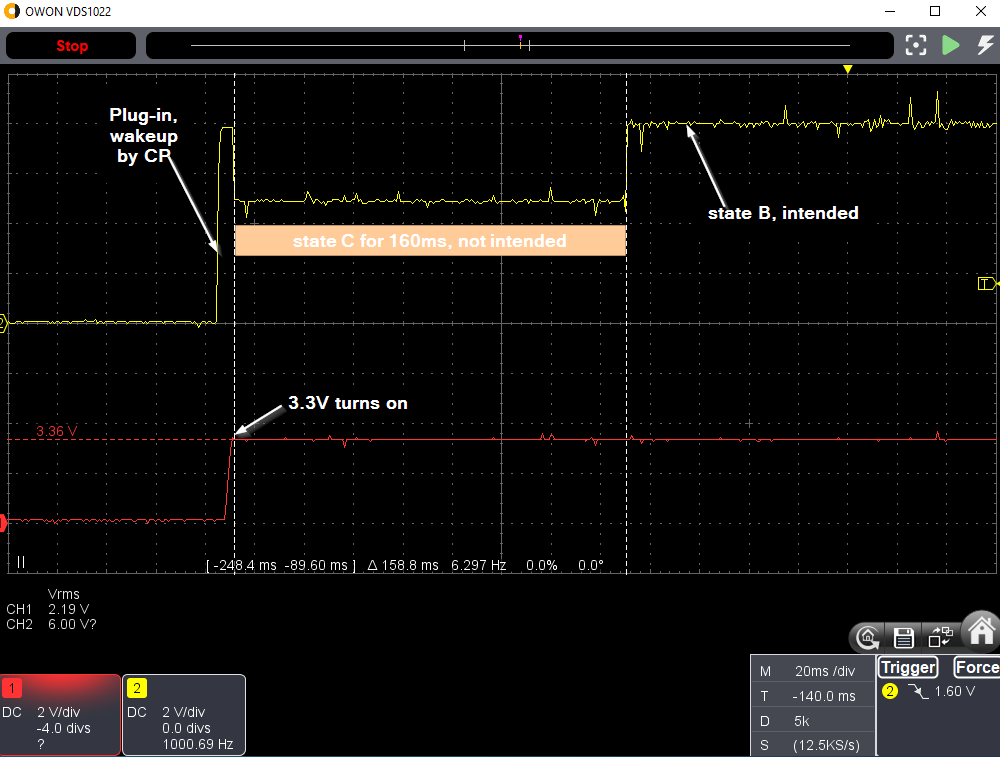

5.6v is not state B. B is 9V.
- uhi22
- Posts: 1244
- Has thanked: 245 times
- Been thanked: 684 times
This is the error. In state B the Foccci should have only 2k7 resistor, which leads to 9V nominally.
[Edit] On Foccci there is a LED for state C. You could try to switch this via the parameter ActuatorTest. This should lead to
- LED off, is state B, is 9V
- LED on, is state C, is 6V
[Edit 2] And check what the spotvalue AcObcState says. If it is "charging", the Foccci is expected to turn the State C on, and in the other cases it shall stay in State B.
I went to charging station. When i connected focci board to ac station. Ac station cp voltage is ~8.65v. Focci is waking 3-5 seconds. Then it is not working continuesly.
I cant find any issue about where is it

Every time I plugged home AC charger to the car with Focci 4.5, I heard short contactor sound from the charging station. If Focci is already waken by button or before it goes back to sleep, charging station did not react.
Something to do with sleep, so I added pull-down resistor from STATE_C_CONTROL mosfet gate to ground and now Focci does not shortly activate CP.
Please, use resistors with mosfets, those are important while uC is waking. Second option is to use mosfets with internal gate resistor.

Does it run the latest or recent firmware? It instructs pull-down in boot loader.
Probably still a good idea to fit pull down resistors
Latest firmware yes and for bootloader could I have used the same v5.2 stm32_loader.bin as for zombie, I think so?
Confirmed the state C issue during wakeup. Which bootloader would fix this?
