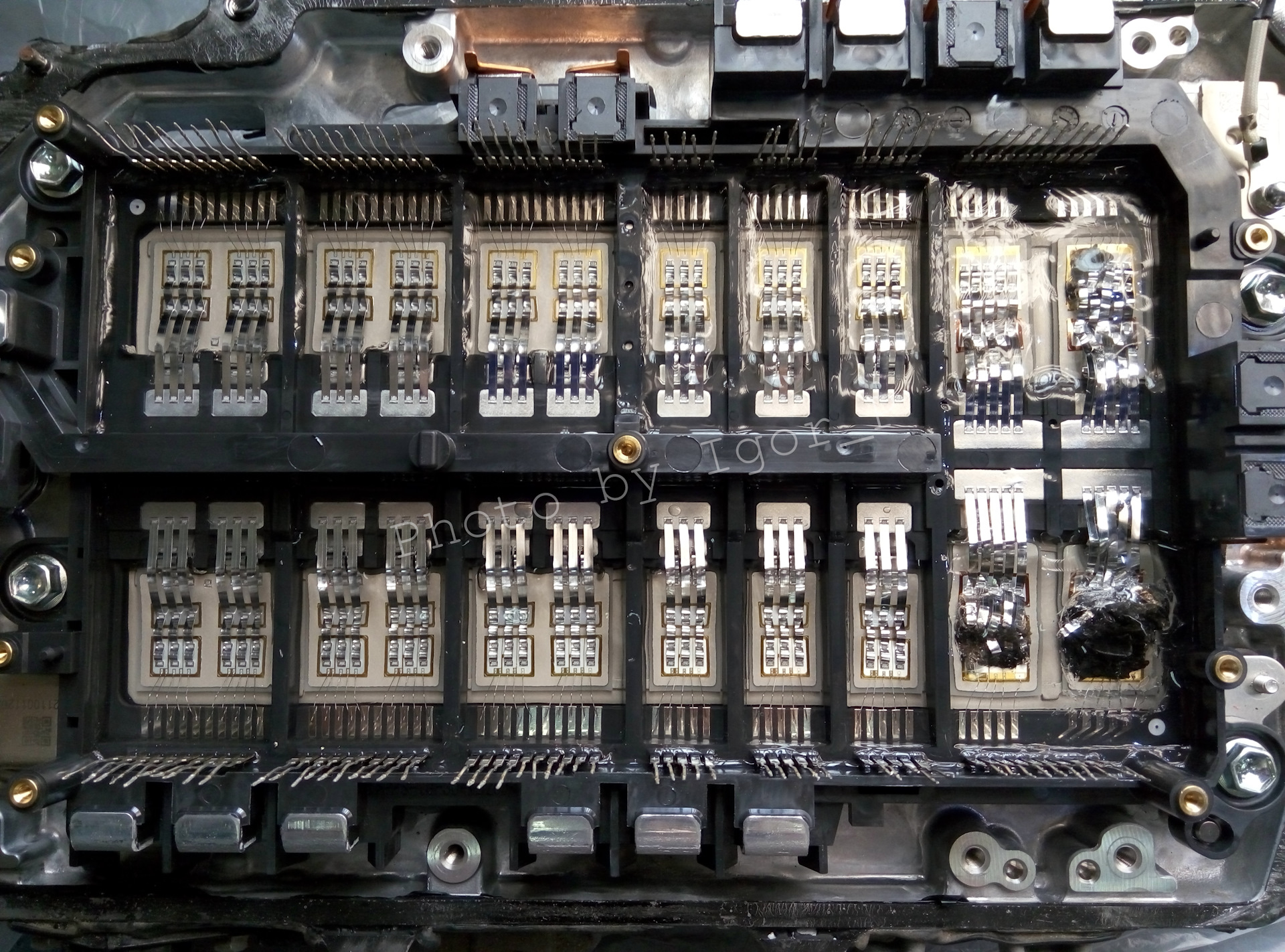

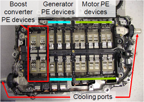

I've got a little question here. There is a deal I've got on my hands - gen 3 invereter for 20 euros, that is "just stopped working"...
I've googled some info about them and have found out that gen 3's IGBTs tend to burn the most of any generation.
But, there are always photos like this:
And those are boost converter IGBTs.
So correct me if I'm wrong, but there is no issues for usage of MG1 and MG2 power stages? Right?

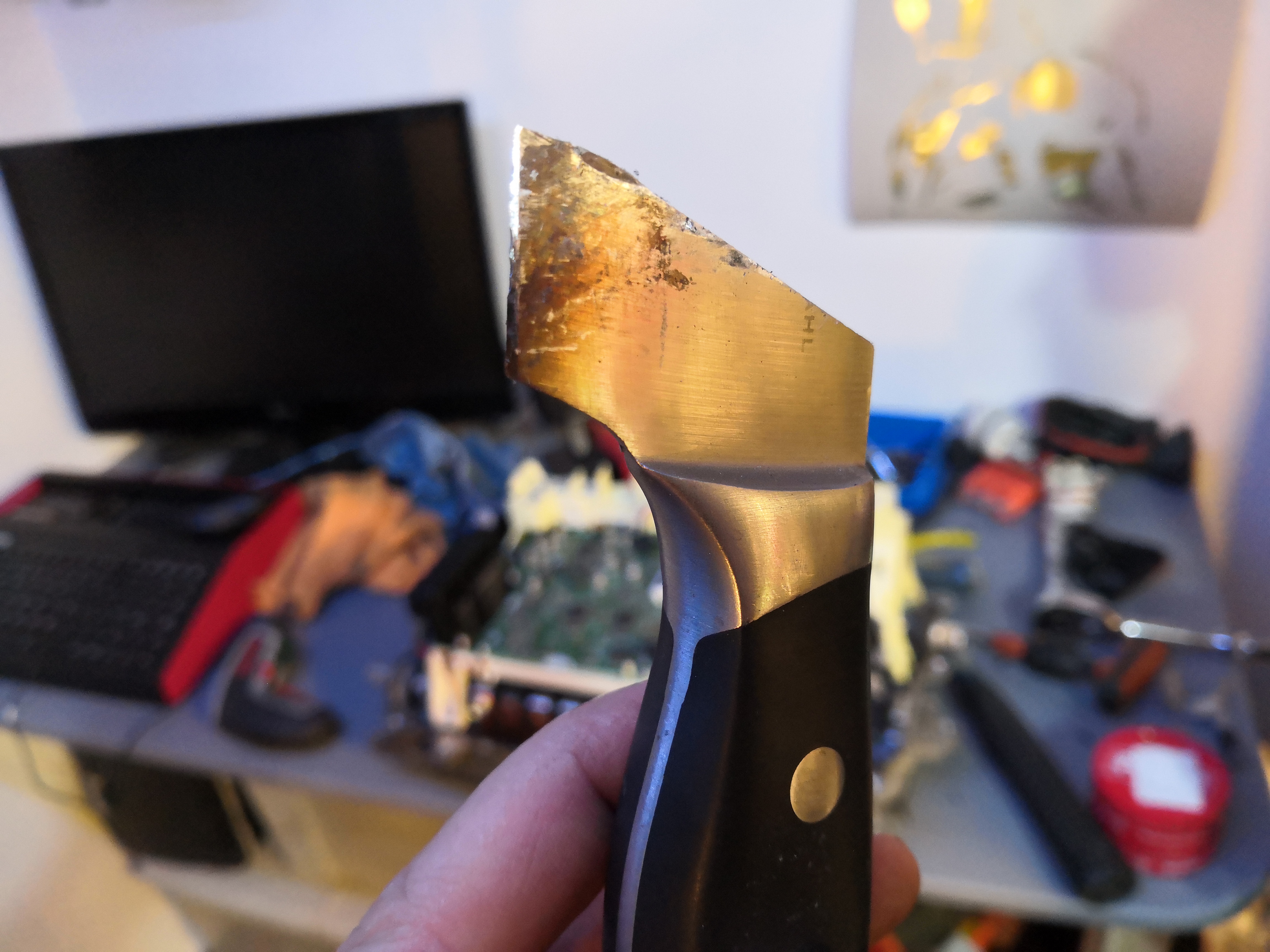

After trying and failing with a few different screwdrivers, I used a broken kitchen knife and that worked perfectly. Obviously not everyone hoards broken stuff, but just sometimes it pays off.arber333 wrote: ↑Sat May 16, 2020 10:59 am Whenever you are working to open any glued lids on automotive devices you need to go in between with a wide and thin screwdriver (I grinded one for this task) and twist handle a bit to lift one side and hold for the glue to release on that side. Repeat on each side and only then you can lever the lid. Otherwise you can damage the lid or screwdriver...

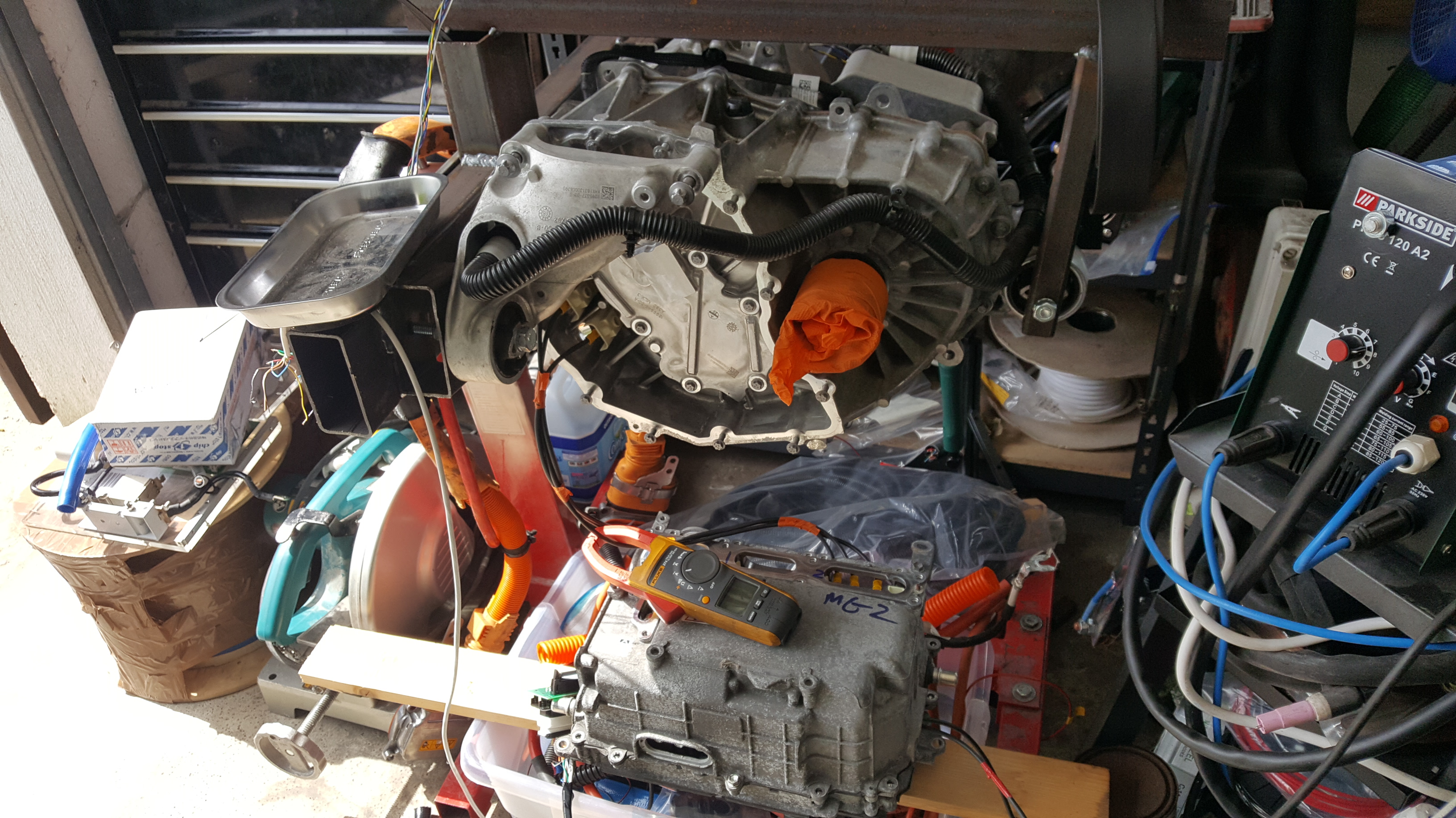

So went to work on the M3 rear drive unit today with the prius inverter and foc firmware. Of course it didnt work as the Prius inverter has current sensors on Phases 1 and 3 not Phases 1 and 2 as required by the foc firmware. Sooo went poking around the firmware and made some changes :
Unless I'm missing something somewhere else this should make the pinswap swap phases 2 and 3 not phases 1 and 3. Here goes ....
if ((Param::GetInt(Param::pinswap) & SWAP_PWM) > 0)
timer_set_oc_value(PWM_TIMER, TIM_OC1, dc[0]);
timer_set_oc_value(PWM_TIMER, TIM_OC2, dc[2]);
timer_set_oc_value(PWM_TIMER, TIM_OC3, dc[1]);

Yep that works. I can't seem to upload the bin so will wait for Johannes to do it properly:)

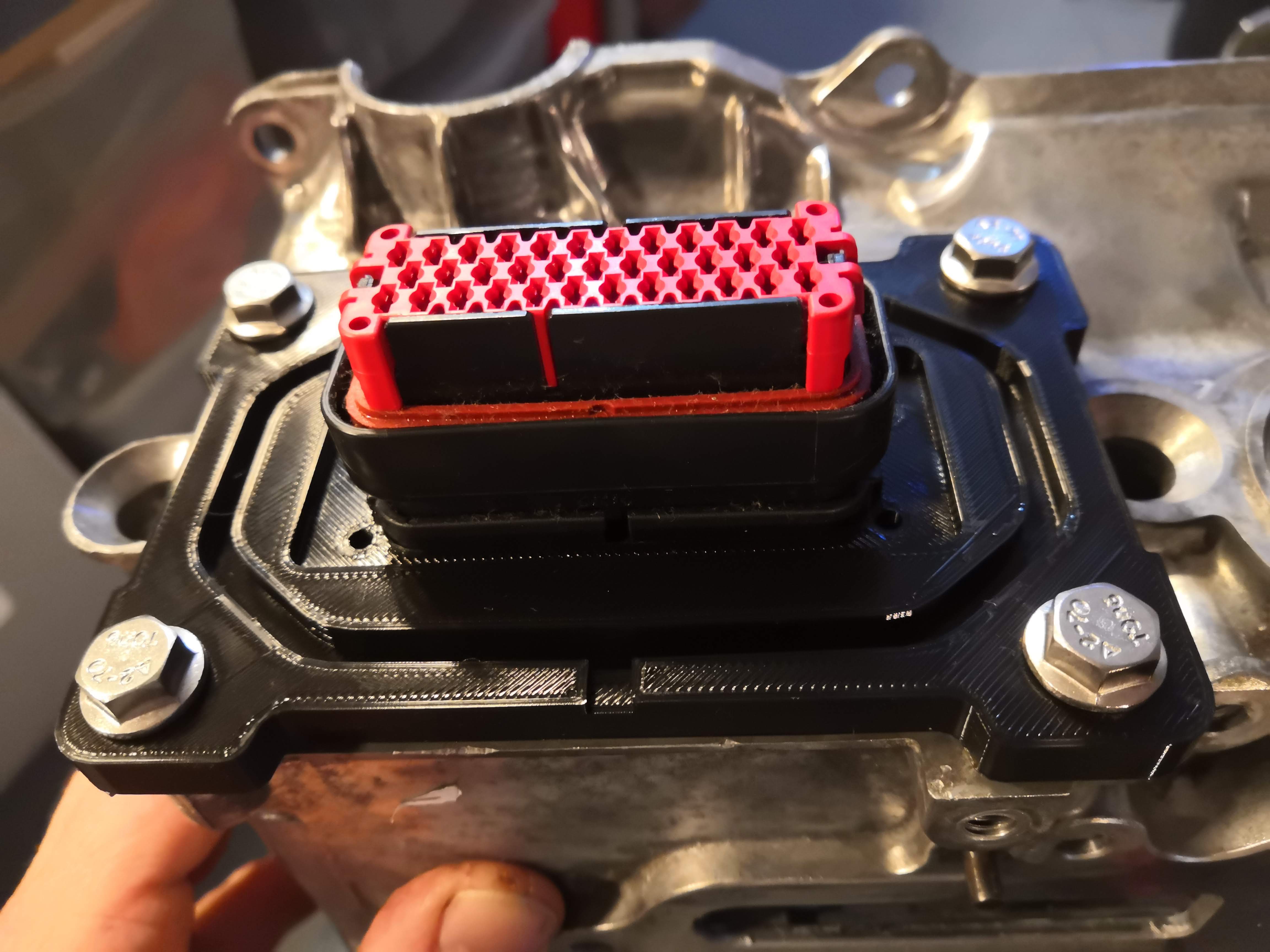

Hi Damien I can model up the PCB holder /sealing unit and get it 3d printed this weekend if you send me dimension for the opening in the inverter and PCB. Ironically I bought the printer to make up the high voltage connector to seal around the brass HV lugs on my is300h inverter( I have HV orange filament).

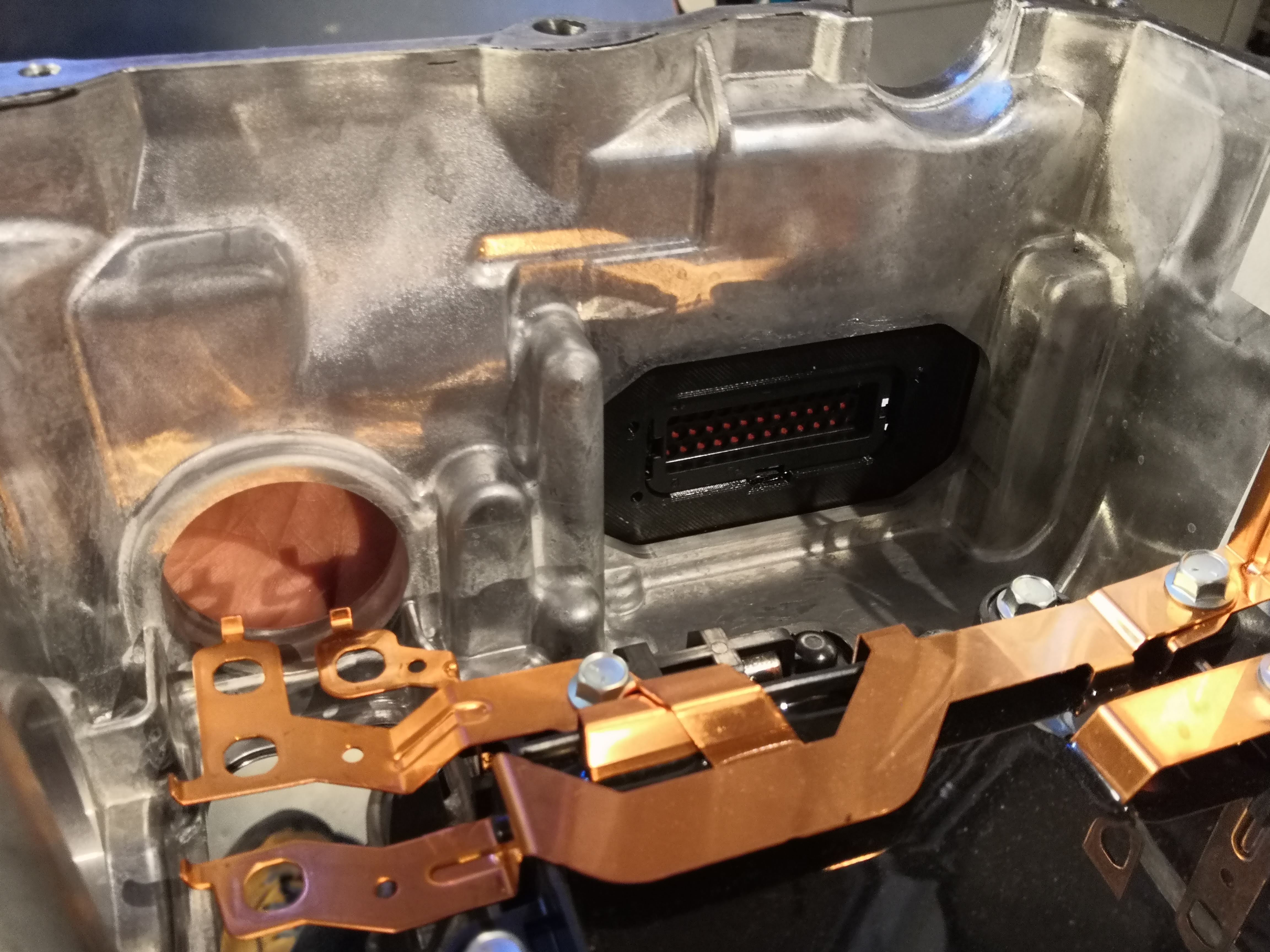

Is there any need to connect the negative battery cable through the weird hole? I think you only need one brass post there to connect the positive and use Toyota's intended terminal for the negative.

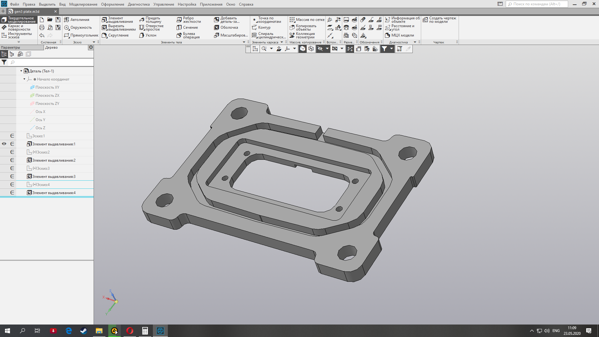

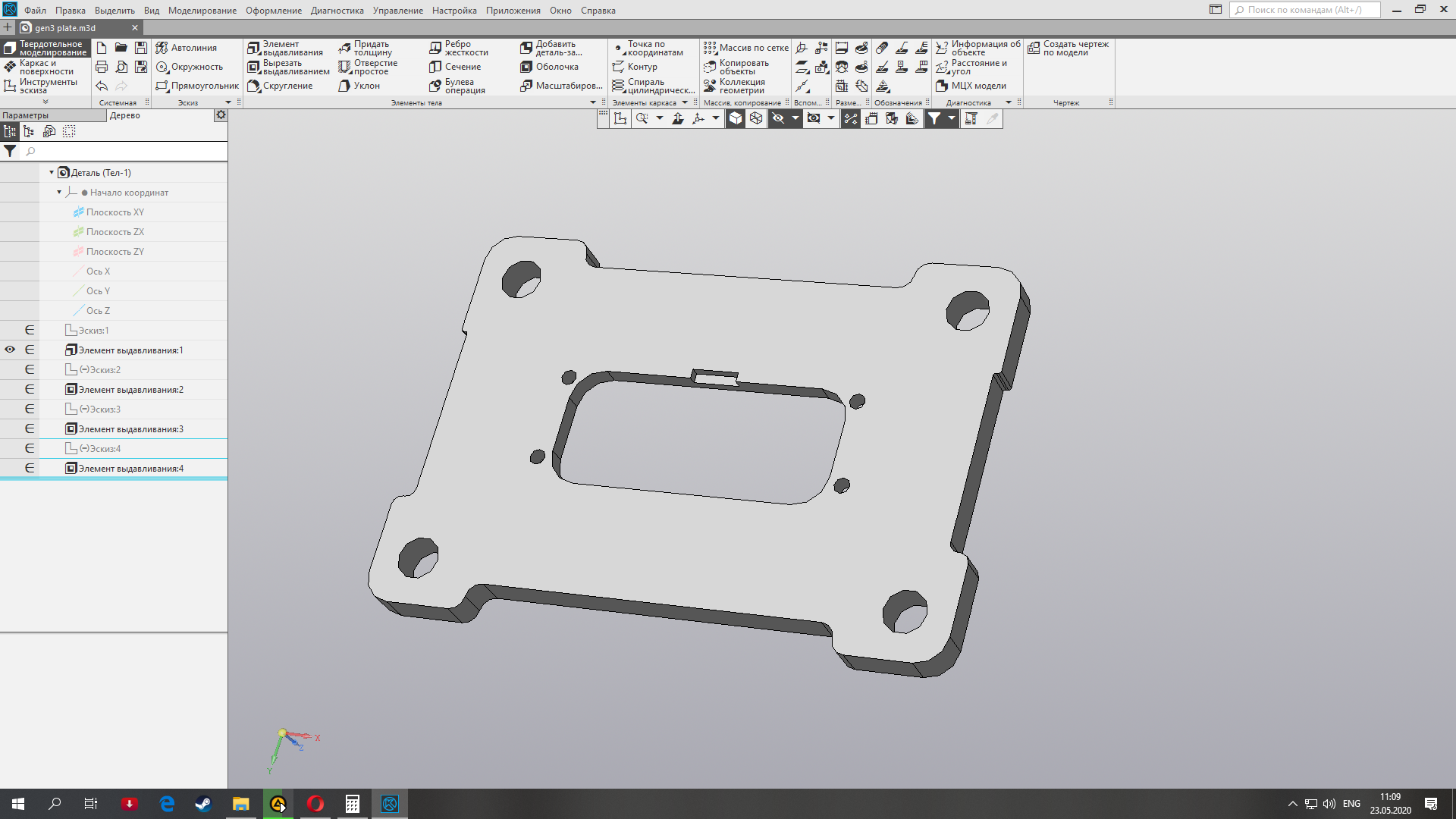

In wich format do you guys need a 3D model for a printing?
I believe for this design we gonna need 90 degrees angle ampseal connector and plate placed horizontally.
Attached archive with *.stl file. There is a little mistake on picture, it is corrected in 3D model in archive.

Also I want to point out that I might missed the sealant groove dimensions. If anybody who will print it and place a sealant inside, let me know if it is an misalignment. I'll correct it.

This plate, I've designed is literally a plate of plastic. It can be fabficated with simple drill and dremel. Too bad, I've got no ampseal socket on hand, and If I order one abroad, it will arrive too late for design testing.

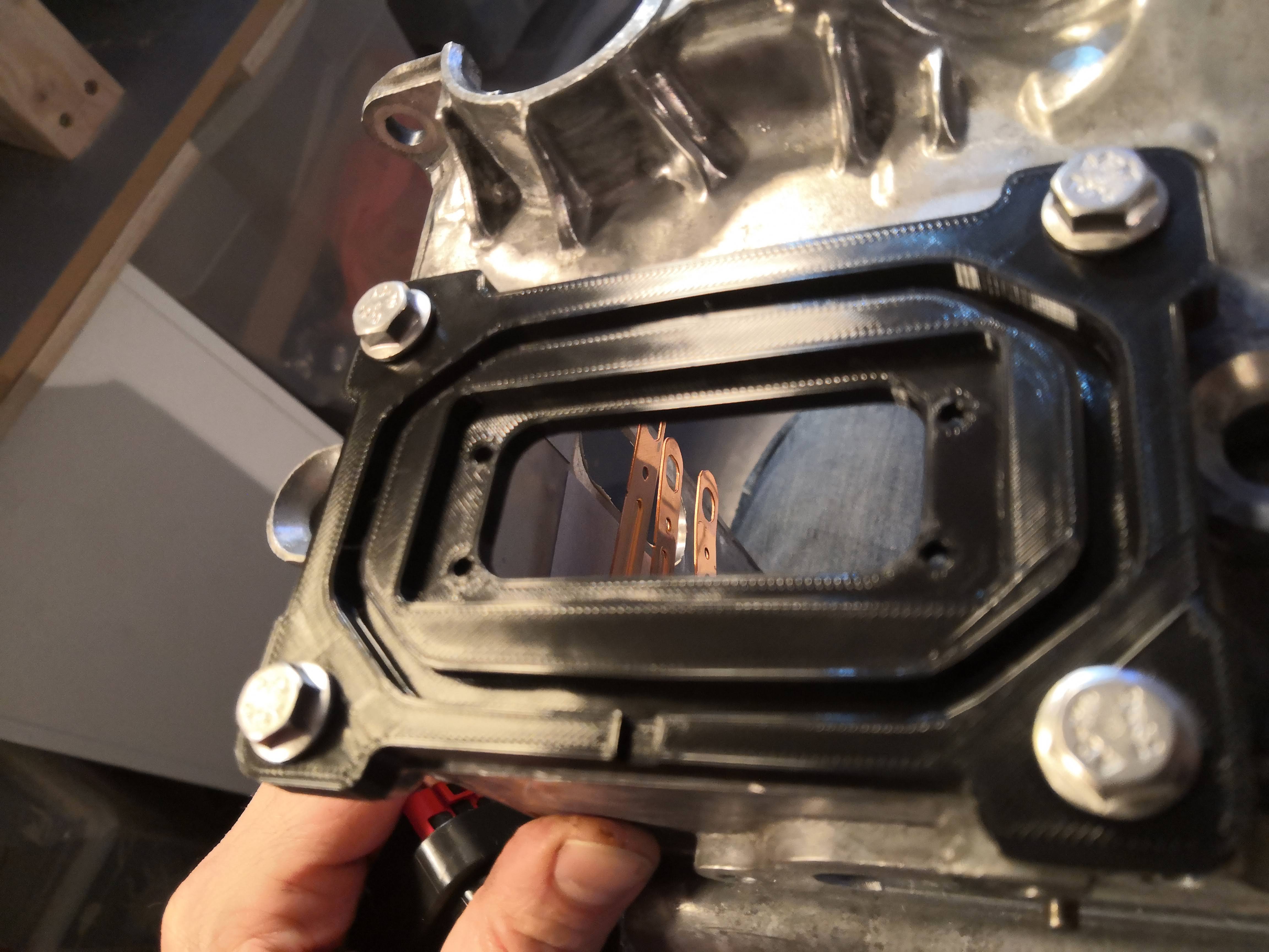

Doh! I am, as we say here, a numpty. Printed it out and realised I only have the Ampseal plug - the socket hasn't arrived yet.
Anyway, it looks good in situ (assuming I have it the right way around?) and the plug matches up very well to the hole. As soon as the socket arrives I'll test that.
