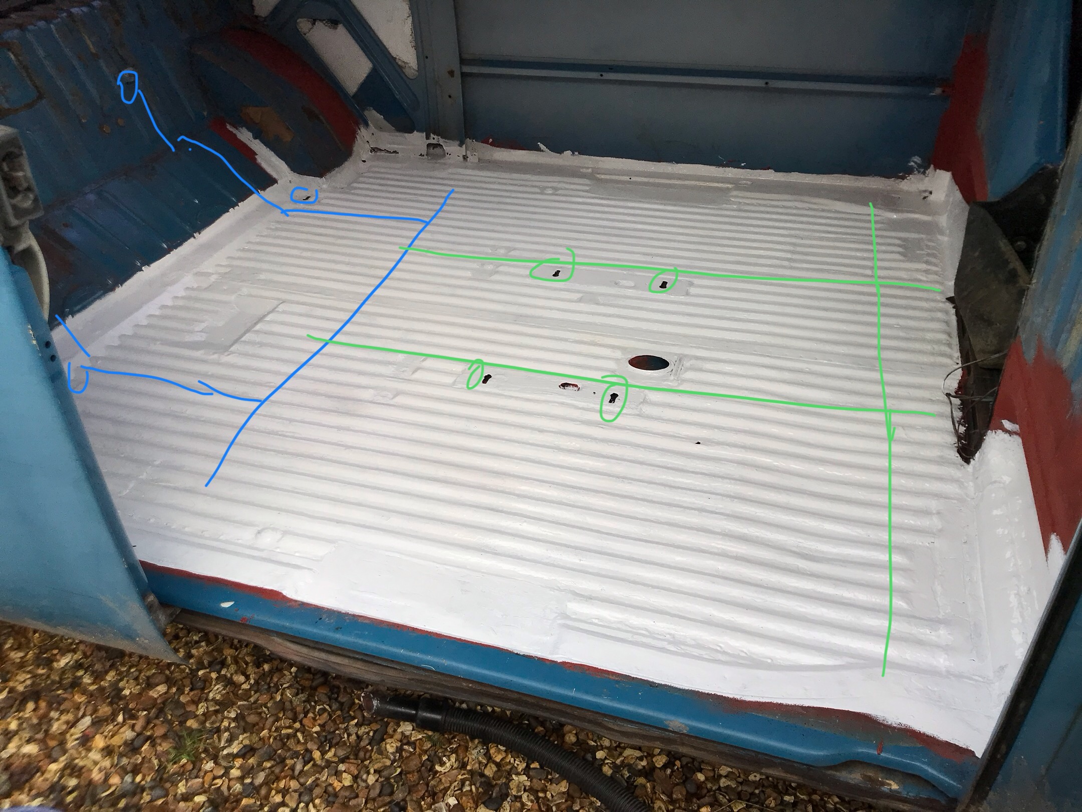

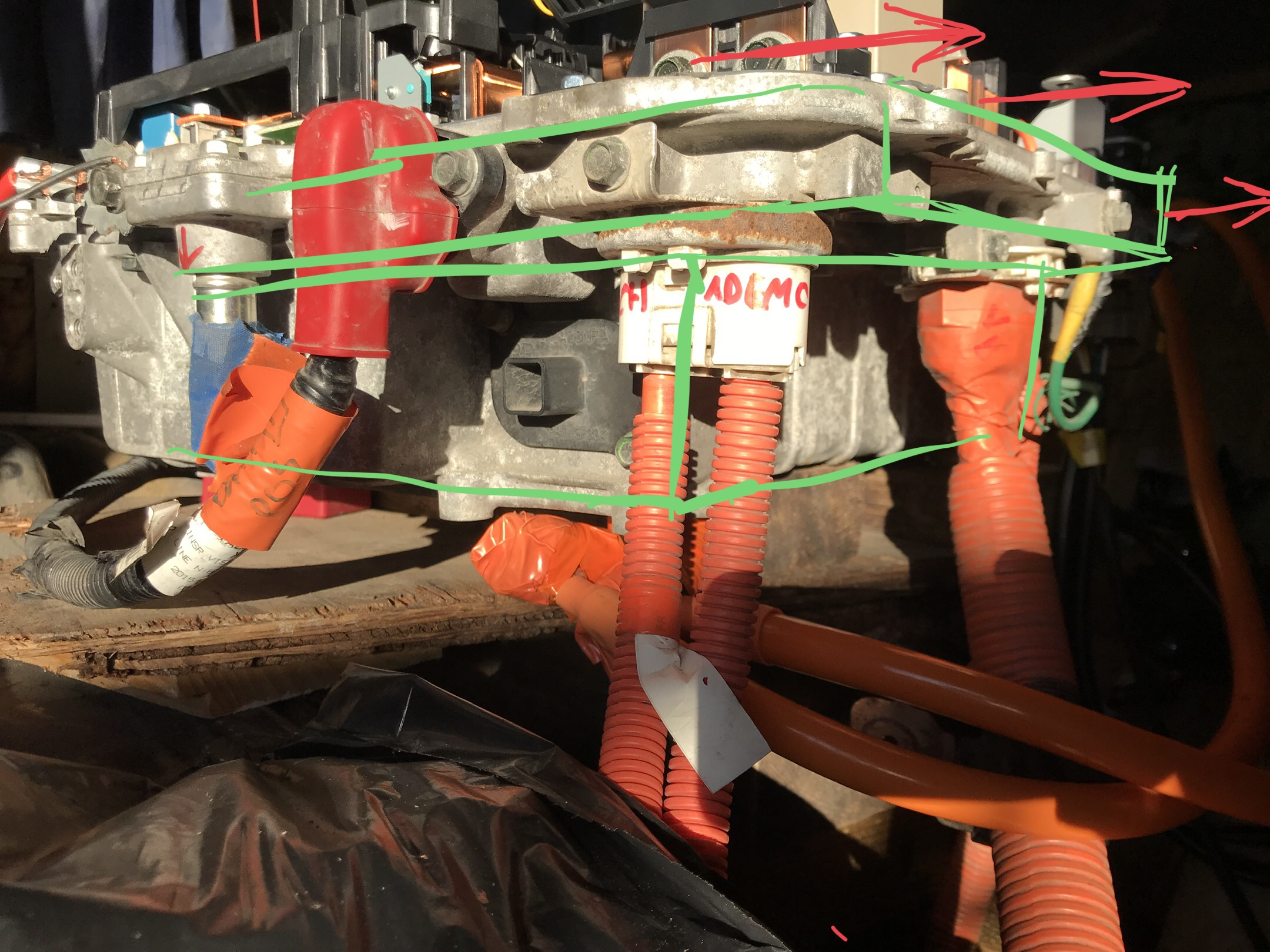

I’ve been thinking…
I think I need to revisit my Plan A for placing the PDM on the petrol tank shelf. I reckon it will work. The problem is not the PDM shape or available space, it’s that the HV cables are all routed downwards from the overhanging section. It is not the PDM itself that stops it fitting, it’s the cables.
If the cables came out horizontally from the upper half of the PDM, where the cables connect to the internal copper bus bars, there would be no problem (I think). The upside L shape of the PDM should slot over the shape of the inverter if the cables weren’t there. I kind of knew all this, but my brain has been slow to process what is obvious.
If I was to create my own lid (which would also probably save me a bit of vertical height which would be useful), I could add in my own connection points or exit points (to be defined in detail). Or even if I cut holes in the original lid, I could achieve the same.
The benefits
- I’m back to a central position, which pleases me aesthetically.
- I can use existing bolt holes around the petrol tank space for a mounting frame, which will please the DVLA.
- I avoid the various other thoughts I’ve had for mounting in many other sub-optimal places.
I’d have to route cables for Chademo, main HV battery, AC charge, and HV battery comms with my new approach.
A little thought needed on the water cooling routing, but think it will be ok.
If anyone think this is a horrendous idea let me know. But I like it and have a good feeling about it.
I don’t intend to pull the Leaf motor out just to test this right now. I’ll probably wait until I’m ready to do my blue van. That way I can continue to impress visitors with wheel spins on my driveway in the disaster-bus. This is very important.

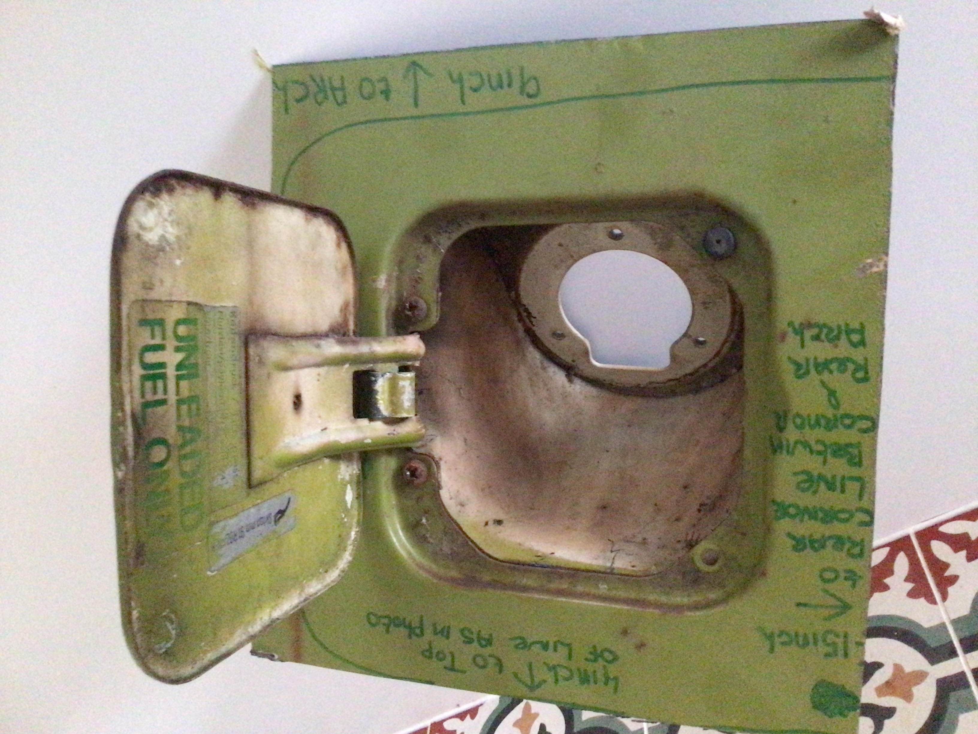

Like my unleaded electricity charge port?
My ‘late bay’ doesn’t have a flap, only a turny cap that is flush with the body. So this cut out from an ‘early bay’ a couple of years earlier is a much nicer way to hide and present a charge port IMO.
Upside down picture I’m afraid.

Can you not install it upside down? With the charger plug we want liquids (rain) flow away from the car :)

marcexec wrote: Thu Dec 05, 2024 2:55 pm Can you not install it upside down? With the charger plug we want liquids (rain) flow away from the car :)
Yes you’re right if course.
Might not be obvious from the photos, but the mount / hole for the petrol cap / EV charge port is angle 45deg from vertical. Plus the Leaf’s cables already come with plastic click shut lids, which would be behind the VW’s metal flap, so I think right way up would be ok. But will give it more thought when I get to that stage.

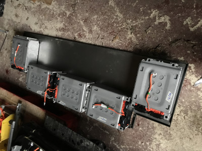

I’ve started a thread in the Nissan section to cover the 60kWh battery I’m dissecting for this project.
Will show photos, dimensions, weights plus a handful of other useful links I’ve found around the internet.

I now know the modules, not including bus bars and other odds and ends will weigh (edit, cocked up number I showed here before) 335kg. I will need to add the box to that, so rounding up to 400 kg for now.
VW T2 has payload of 800kg, so not a problem.

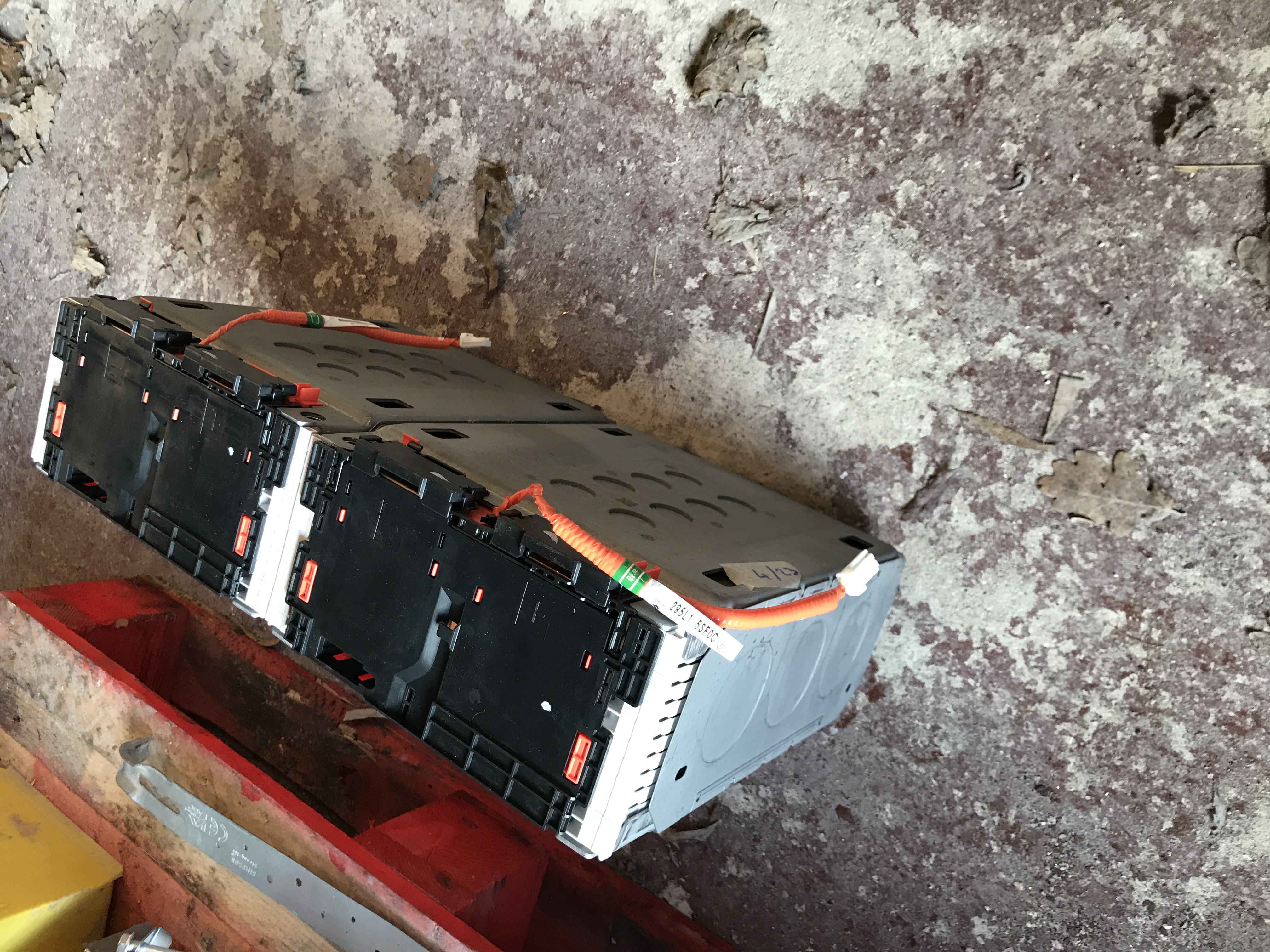

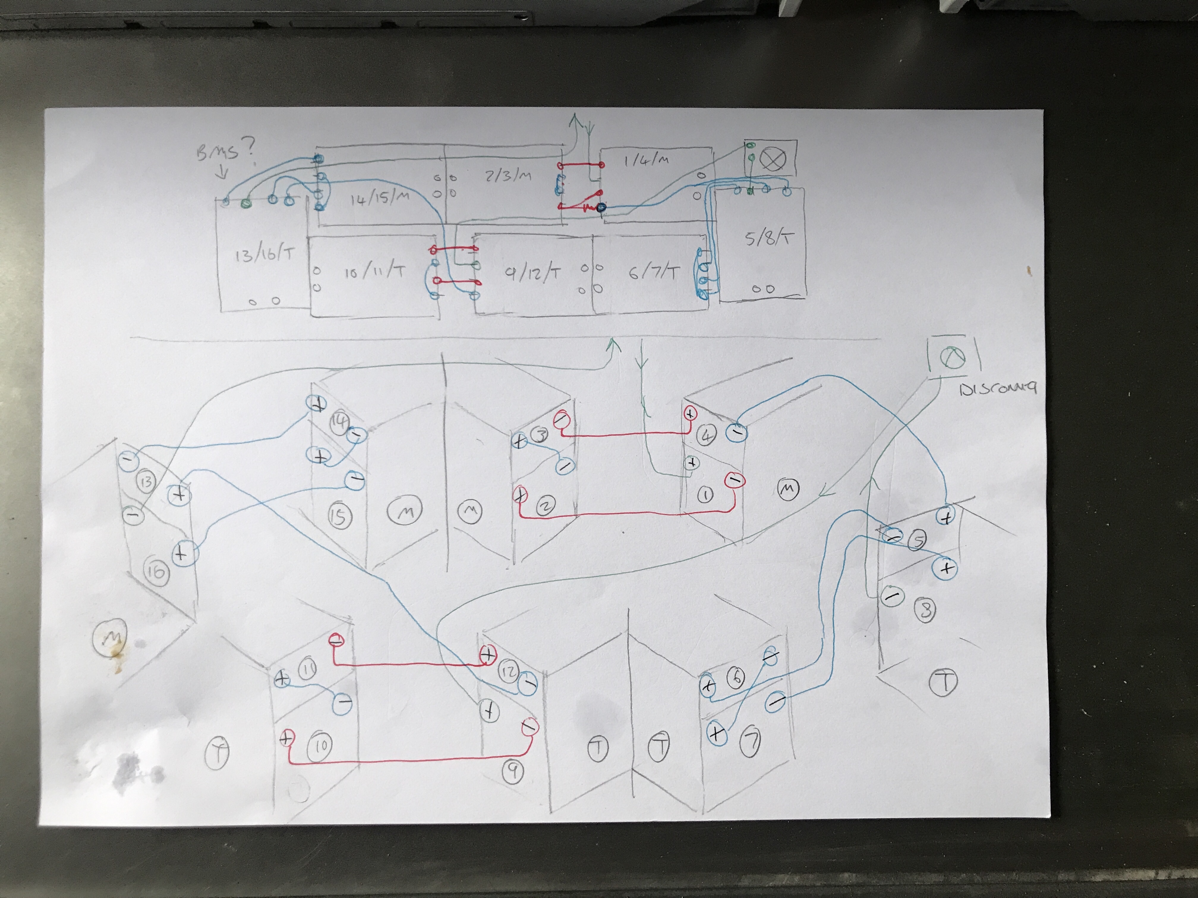

Question - anyone care to sanity check a basic question please?
I’m taking apart a Leaf 60kWh battery (link to the dissection is a few posts earlier up the page) and planning my new battery box.
Nissan’s bus bars are 1.6mm x 20mm. So does this mean an equivalent diameter cable of 32mm2 would be a suitable replacement where I cannot reuse busbars? I see Fellten do 35mm2, so I assume this would work?
Just want to check there’s no other considerations I should taking into account.
Posts: 1000
Has thanked: 176 times
Been thanked: 369 times
Re: [WIP] Leaf to VW Type 2 Campervan
ianlighting wrote: Sat Dec 28, 2024 1:17 pm
generally yes thats fine, but
Two things to consider when selecting wire gauge and observing what oem’s use:
1. Cable length, resistance increases the longer the run
2.heat dissipation. Is the cable in open air, any active air flow? What insulating properties are around it? Etc
calculate the required ampacity of the cable based off of the load running through it.

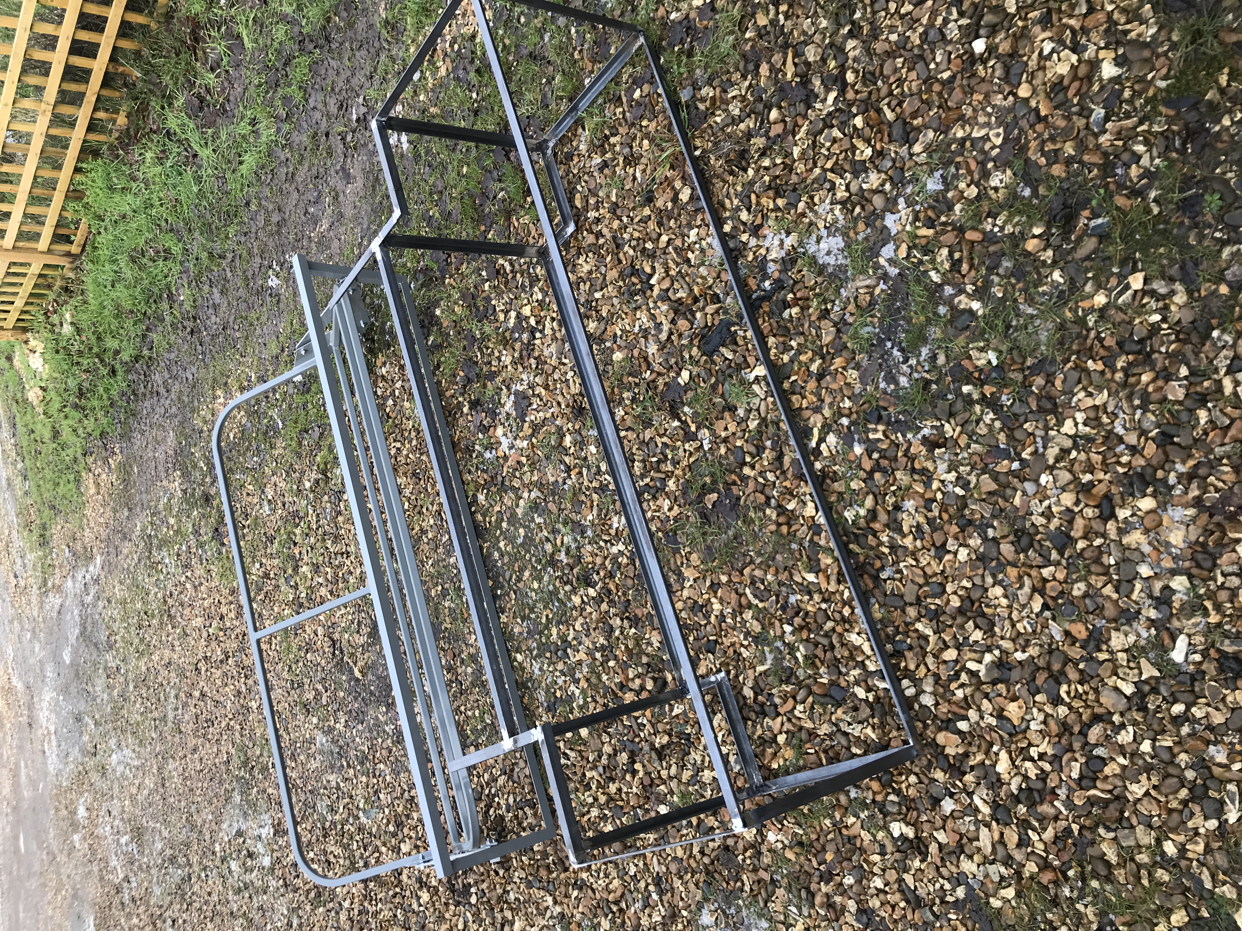

ianlighting
Posts: 179
Location: Uk
Has thanked: 158 times
Been thanked: 86 times
Post by ianlighting »

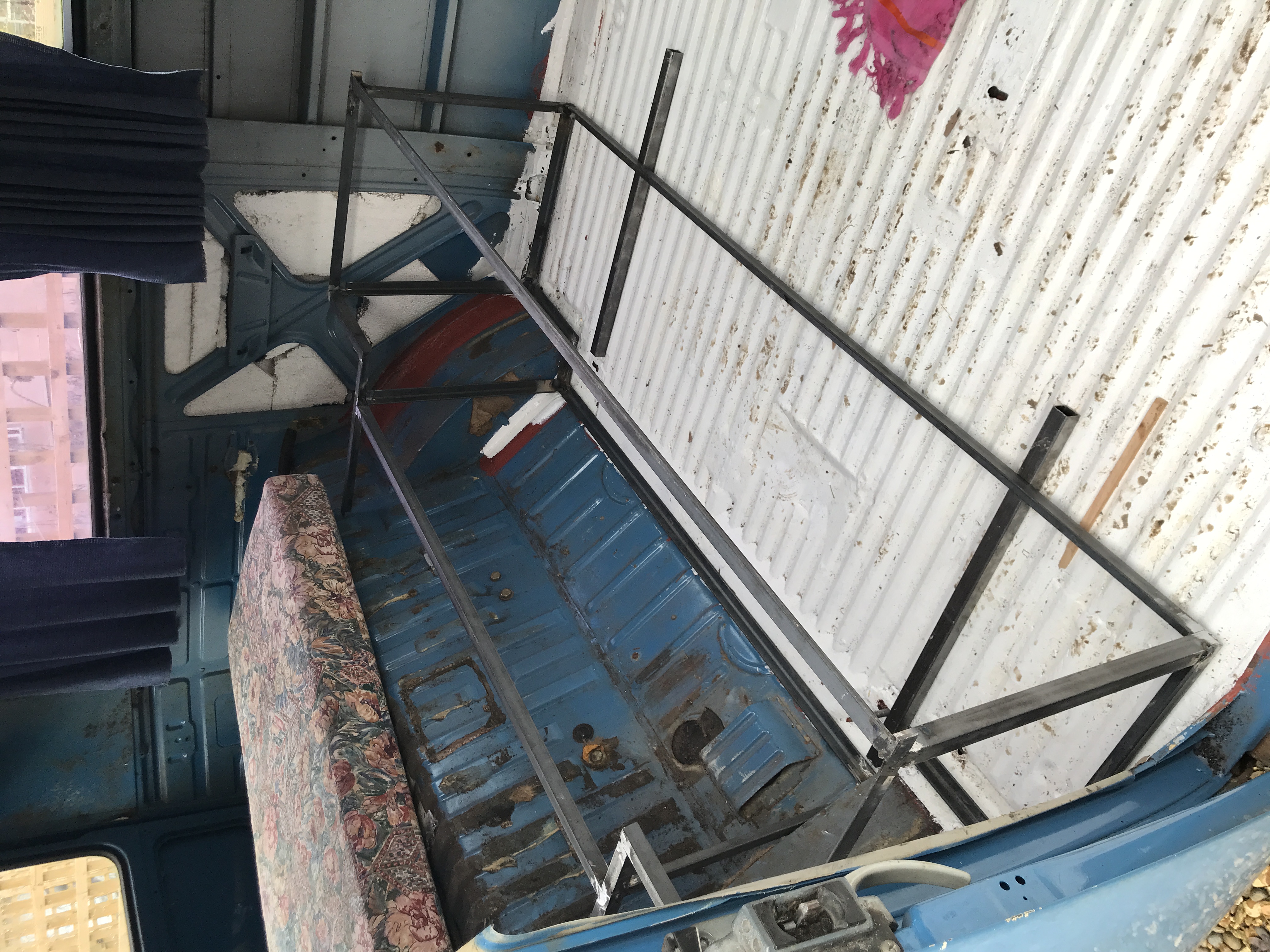

Hmmm…
I had a plan for battery box and location. But having moved forward with that I’m no longer convinced I’m doing the right thing.
Plan A
- single battery box
- under bench seat in passenger compartment
- meant no extra cabling or safety measures for a 2nd battery box
- but I knew it would be pushing at what’s reasonable in dimensions.
- width. Constrained by the rock and roll bed’s brackets and the width of the bus.
- depth. Not a show stopper, but eating into the passenger space isn’t ideal
- height. Impacts on whether the bed is level with the rear parcel shelf, although I’m ok to accommodate this with a thicker rear cushion.
But having made up a frame, I just think it is too tall for the space. It’s fine as a bench in its own right, but within the bus it’s too tall.
Why so tall? Because I’m using all the Leaf’s modules, their heights are (approx) 120mm (x8), 200mm (x4), 250mm (x4). I worked out a plan that placed a short module on all of the medium and tall modules, and the wiring path to do this. It all ‘fitted’, but having got this far I don’t like the results.
Diagram, might look confusing, but helps me picture the plan. Helps to understand the 2nd diagram has the modules rotated 45deg so I can more easily illustrate the connections. Makes sense to me.
Red = short reused Leaf busbars.
Blue = new cable
Green = same new cable, but going somewhere other than another module.
So Plan B?
Rough thoughts…
Ditch the double decker battery module arrangement.
split the battery pack, I guess at the mid point where the service disconnect is.
Means, some HV and BMS cabling crossing from back of compartment to the front.
Means more safety concerns, cos I really don’t like the idea of HV cabling crossing that space, but may have to accept it.
Means another box behind the front bulkheads (but within the passenger compartment as the first one.
Not fixed on this Plan B, still pondering….
Edit - There’s a gotcha with Plan B. If I am to stick with the DVLA’s ‘no drill, no weld’ rule, I dont know how I will secure the 2nd battery box… I’ll have another look, maybe I overlooked an OEM bolt hole….
*Diabolical welding - first time - will improve!
EDIT 2 - the plan in the diagram would not work as shown. Found out the other day that Nissan reversed the polarity of the short modules compared to the tall and medium modules! Doubt anyone was planning to follow me, but just in case - don’t!

Securing. See highly detailed technical drawing below.
- Blue lines is roughly what was planned for Plan A / battery box #1.
- Green lines is an extension for battery box #2.
- small circles indicate VW OEM bolt holes for the original bench seats when in mini bus mode.
Consider those lines a kind of chassis below the battery box itself. I had planned this arrangement for the first box because the floor’s bolt holes would be below the box itself. I was / am intending to cut a small square hole to bolt the box down to the bolt holes. Then seamseal a steel plate over the hole once done.
Now, with box #2 in the plan, I can extend the idea. There are no specific holes against the forward bulkheads, but there are holes mid way along (green circles). A single chassis that has multiple bolt holes is good. I just need to consider whether I can add to that with further securing against the bulkheads themselves. I expect something will occur to me.
A benefit of this chassis base is that I’m creating a nice 20mm (ish) cavity for my cabling, esp the HV that I was concerned about.
This 2nd box is probably the right approach.
I think I had avoided the 2nd batt box for a few reasons. Chief amongst them being I had no welding experience so was doubly concerned about doing a second box before I’d even started the first. But having done my first (diabolically bad, but solid enough) attempt, it seems a bit more achievable now.
Batt module arrangement / orientation still TBD though.

So exploring my batt box Plan B further, I would be keen to place 3 of the short modules vertically, sat on their rear end, as shown.
Does anyone know of any reason why this should not be done?
Posts: 1000
why not just start with a simple box.. just 2 rows of modules. reuse the stock busbars and what not. simple steel frame. make it a bench seat for now and then tackle everything else. getting to lost in trying to stuff modules in weird places , multiple boxes with a master bms is a recipe for disaster.
KISS for now. you shouldnt have to modify the bms leads, or anything.
