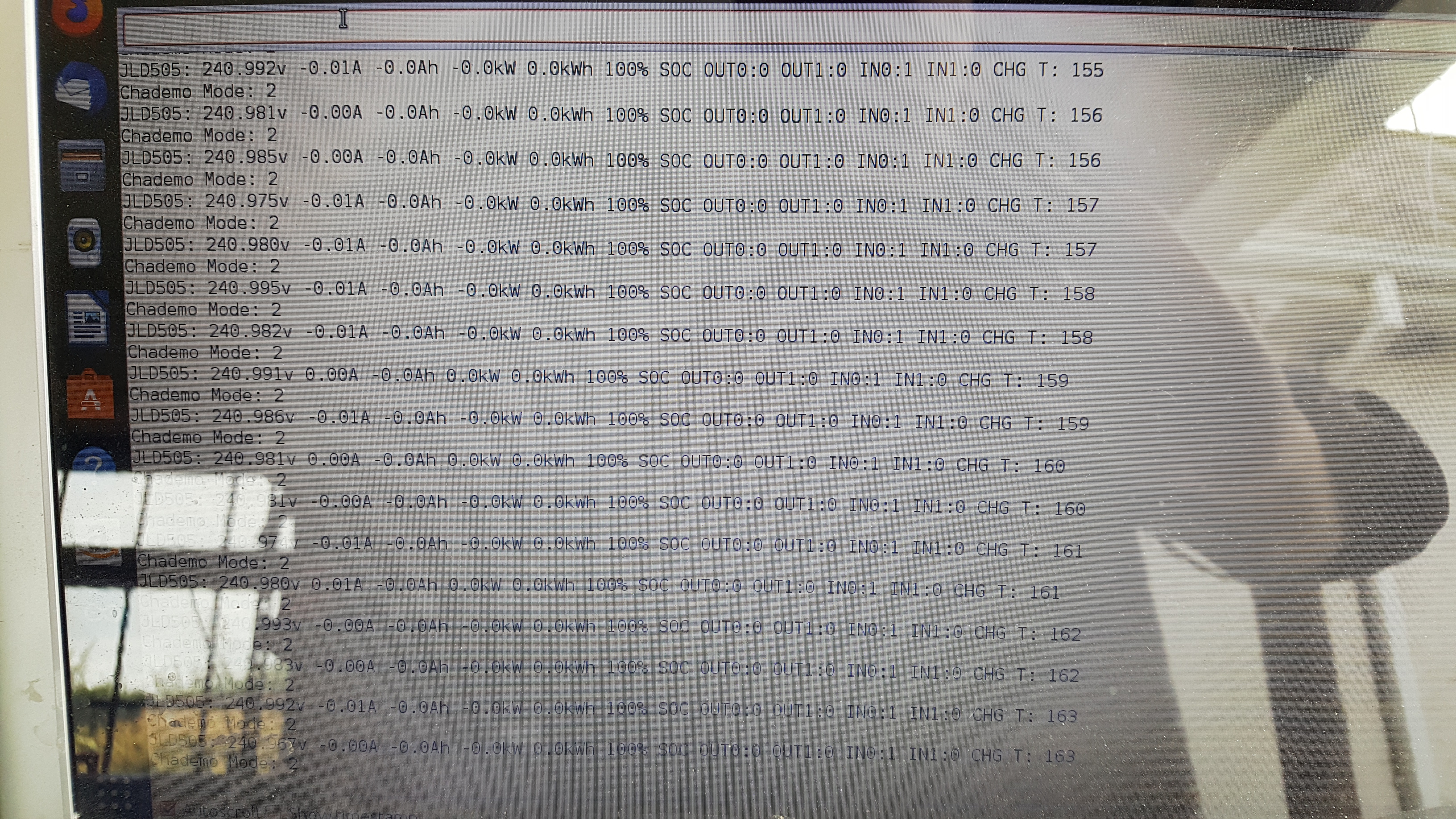

Good news is we are reading from the ISA shunt. Seems we have a problem with the menu saving. It wont update no matter what it try e.g. V395 etc. Not just that it wont save to eeprom but it wont update on screen when p brings up the values. But yeah. Great progress and many thanks:)

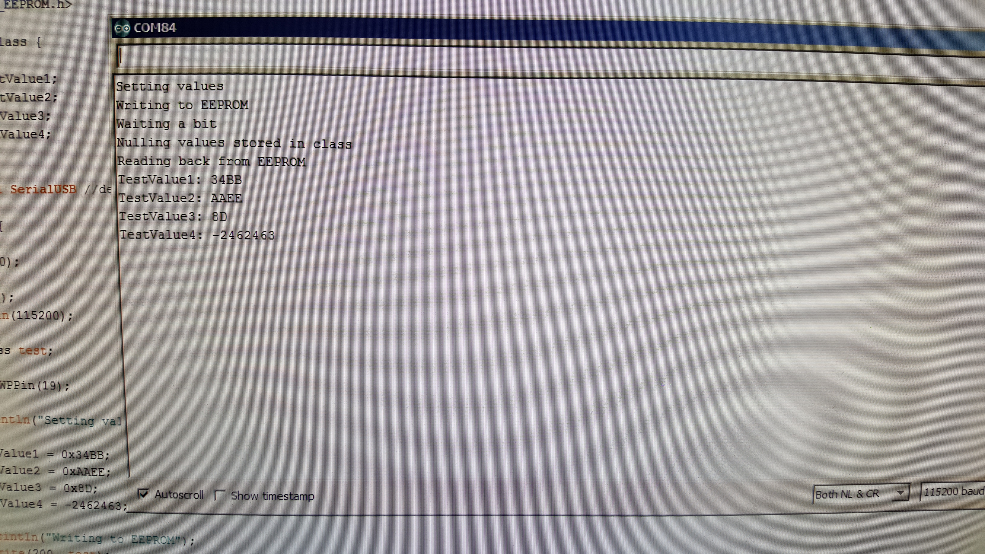

Hmm.. I'll look some more at the EEPROM coding. Not sure if the chip is compatible.
I assume you've verified that the EEPROM on the VCU works in general? If not, try one of the Wire_EEPROM examples (https://github.com/collin80/Wire_EEPROM)
Good to see the ISA reading correctly
-Isaac
EDIT I've done some looking through datasheets and schematics... Leaf VCU uses TWI0 for the EEPROM so that should all be correct. Please test functionality of example code.
I am using a struct rather than a class for the settings holder, if the EEPROM works with the example just let me know and I'll switch the Chademo code over.

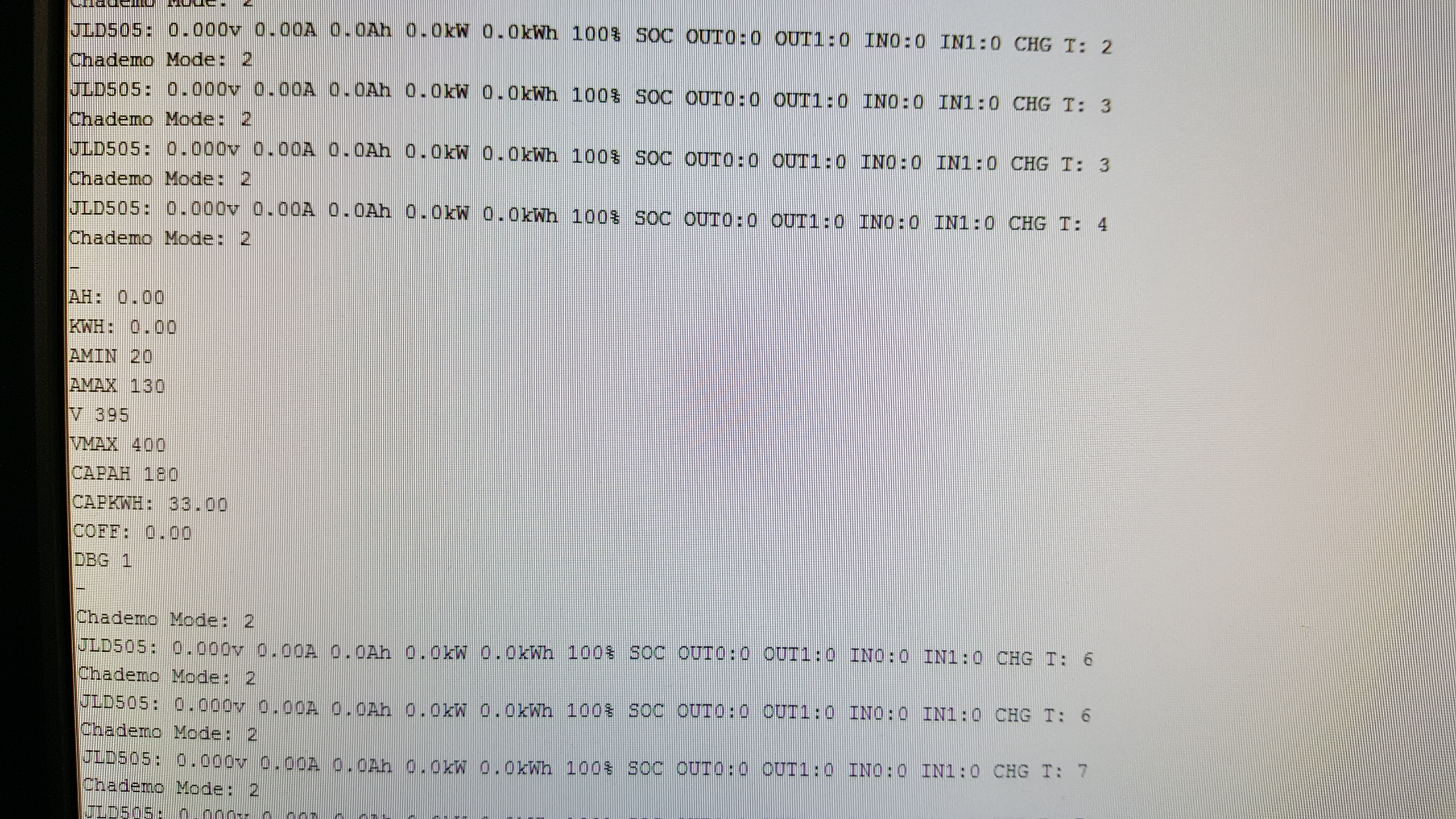

Just took another look -- with the EEPROM code removed the settings update correctly.
Are you typing "V395" or "V=395"?
The latter works for me - the "=" is the marker for end of command/start of value.
-Isaac
-Isaac

Ok, so I wasn't using the "=" sign which was the problem with the serial monitor ignoring the commands. What happens now is if I type say "V=395" and hit enter the serial monitor freezes and the SAM3 locks up. However, if I then reboot and hit "p" it has actually updated and saved the parameter so it must be hanging on return from the eeprom routine. I also ran the eeprom test and it works fine so I don't think its hardware.

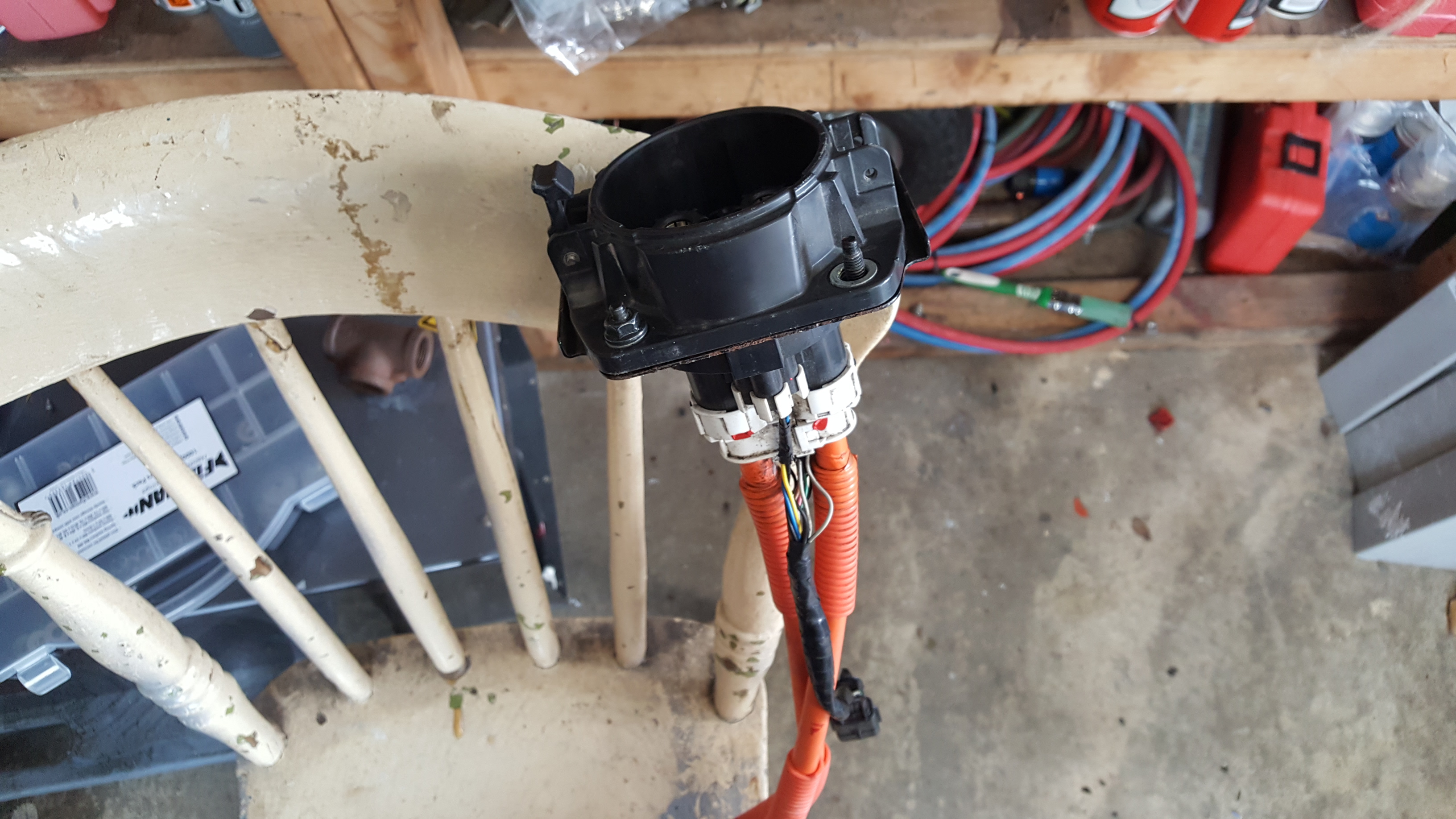

In other news my Chademo port turned up so will have a car ready to do some actual testing soon.

That looks awfully like the port I have from a Leaf...
Glad to see my 'hey can't we simplify this' theory wasn't crazy in the end.

There's a "noInterrupts()" call at the beginning of the save() function. Then "interrupts()" gets called again at the end.
Are you getting a "SAVED" message after setting a parameter? (probably not since the monitor is locking up).
Also I'm a blithering idiot - my GEVCU hardware actually has a M24M02 EEPROM on it already. I'll start testing with that in about 5 minutes. Should be able to solve these issues quite easily.

Here's version 0.3, with more improvements and still less clutter.
-Added help menu - shows when a wrong command is entered and on startup

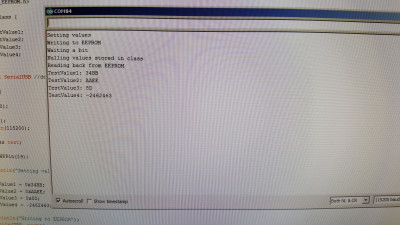

-Fixed EEPROM - turned out to be something weird about the delays and the interrupt() function.
-Improved AH/KWH counters (just uses ISA numbers now, resets them to zero at certain times)
-Took out some extra functions that did nothing
I'm trying to strip this down to the bare minimum while retaining the configuration capabilities. Not messing with the Chademo (though that might be necessary) but allowing lots of room for expansion in whatever direction anyone wants.
Let me know how this works!

Working perfectly (at least on the bench). Added this line to Setup() to give a heartbeat led : pinMode(13, OUTPUT); //led
Will be a few weeks before I have the E39 kitted out with a Chademo "exhaust" for testing. If anyone else is going to get there quicker and willing to help with testing,I'll donate a leaf vcu. In the meantime I'll get my wifi guy to do some wifi firmware so we can have a display ready to go.
