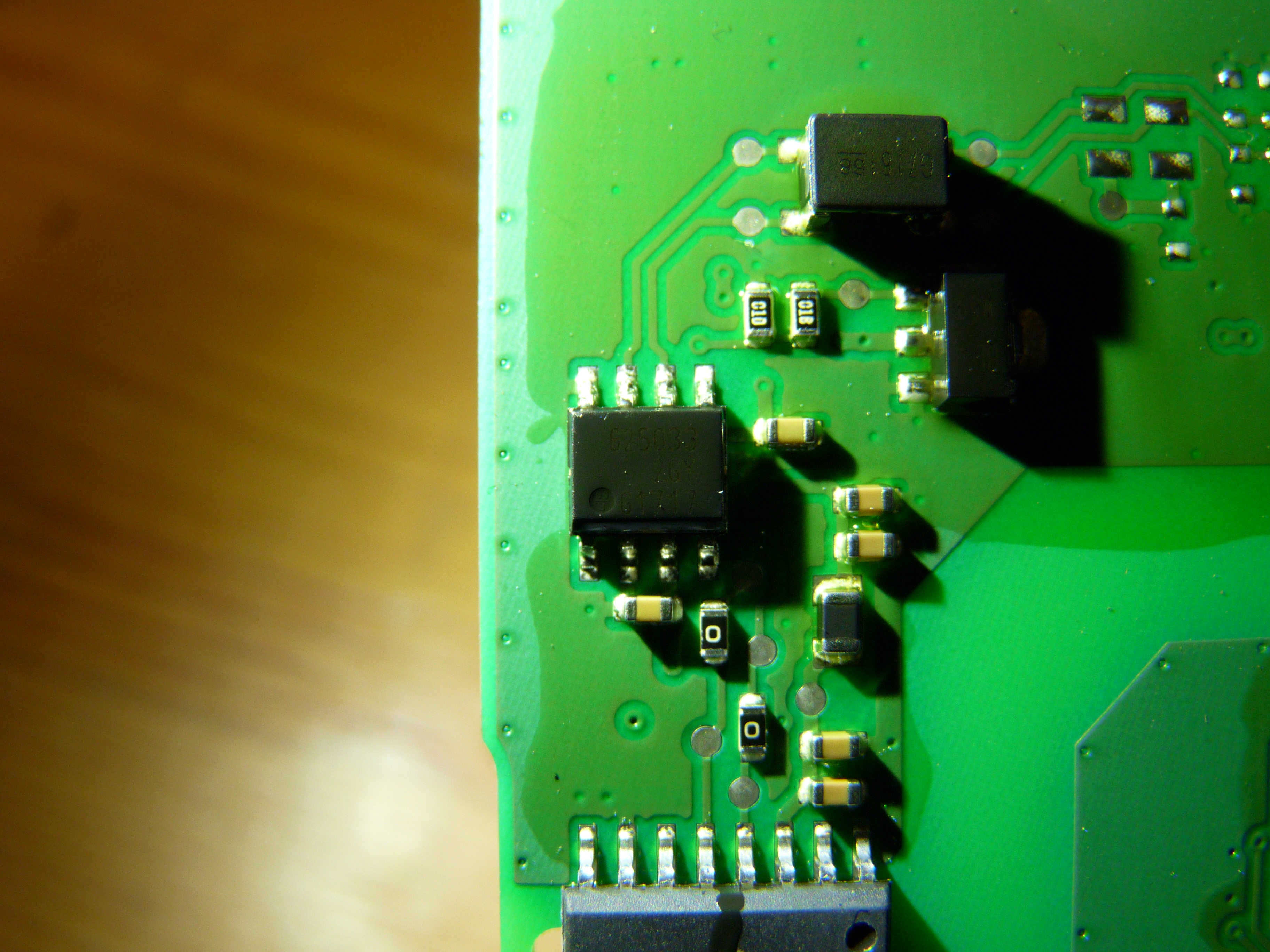

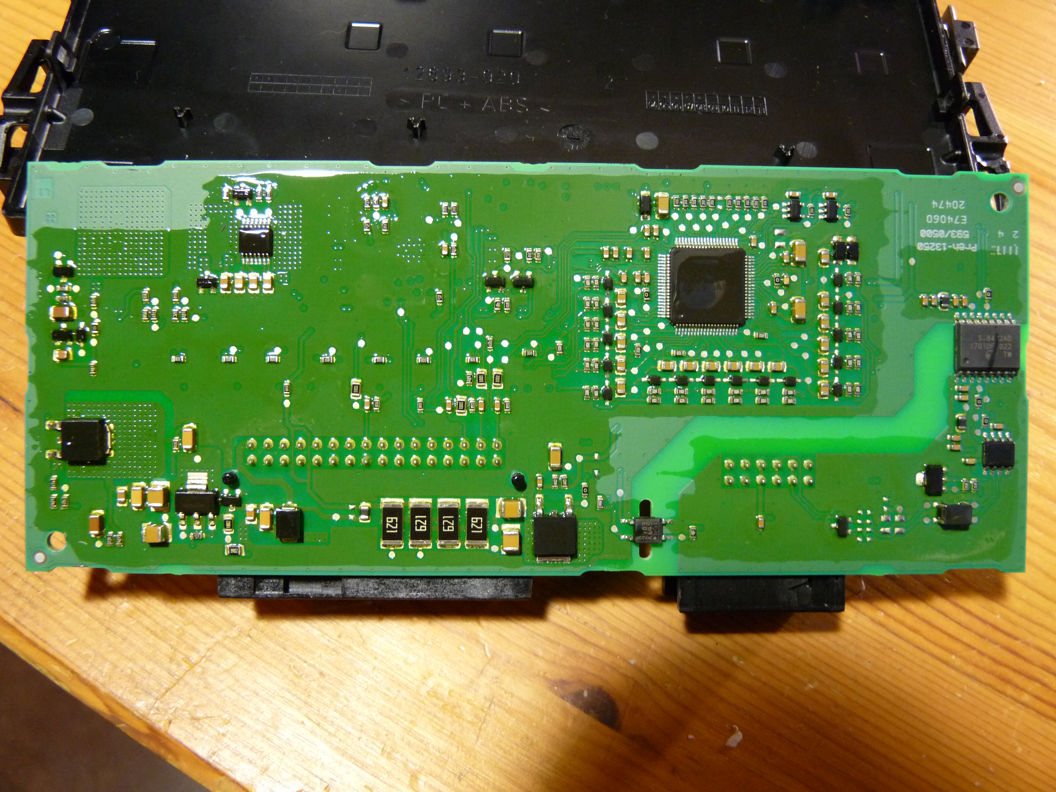

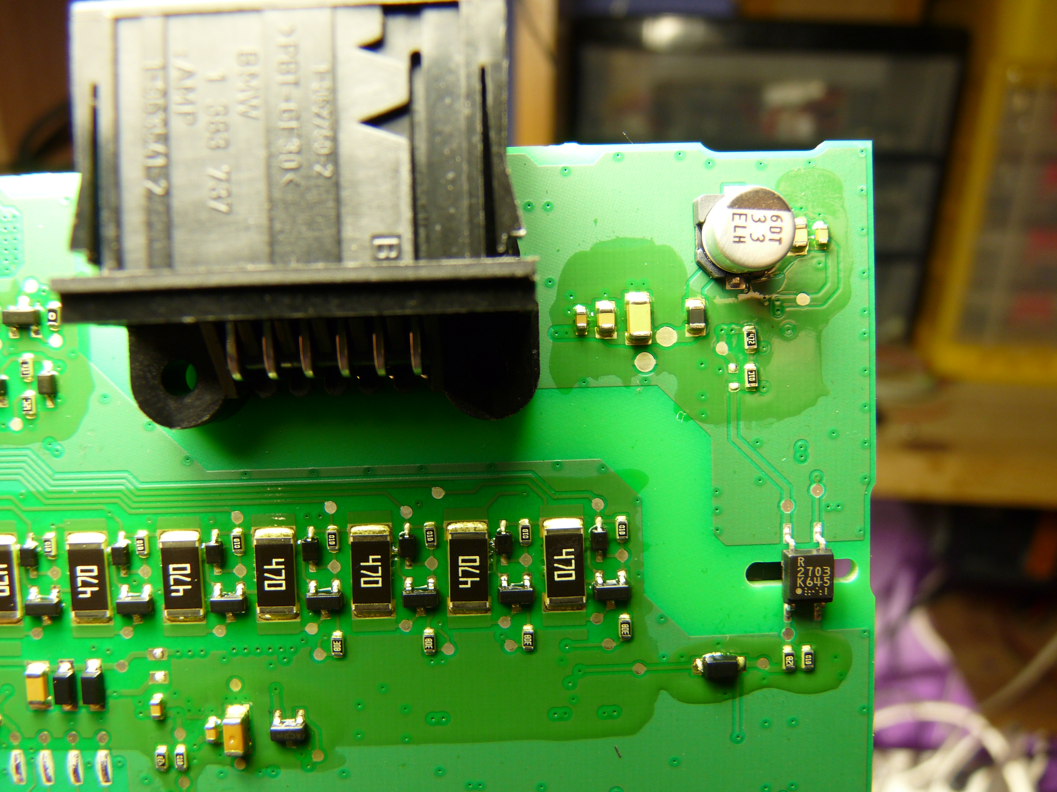

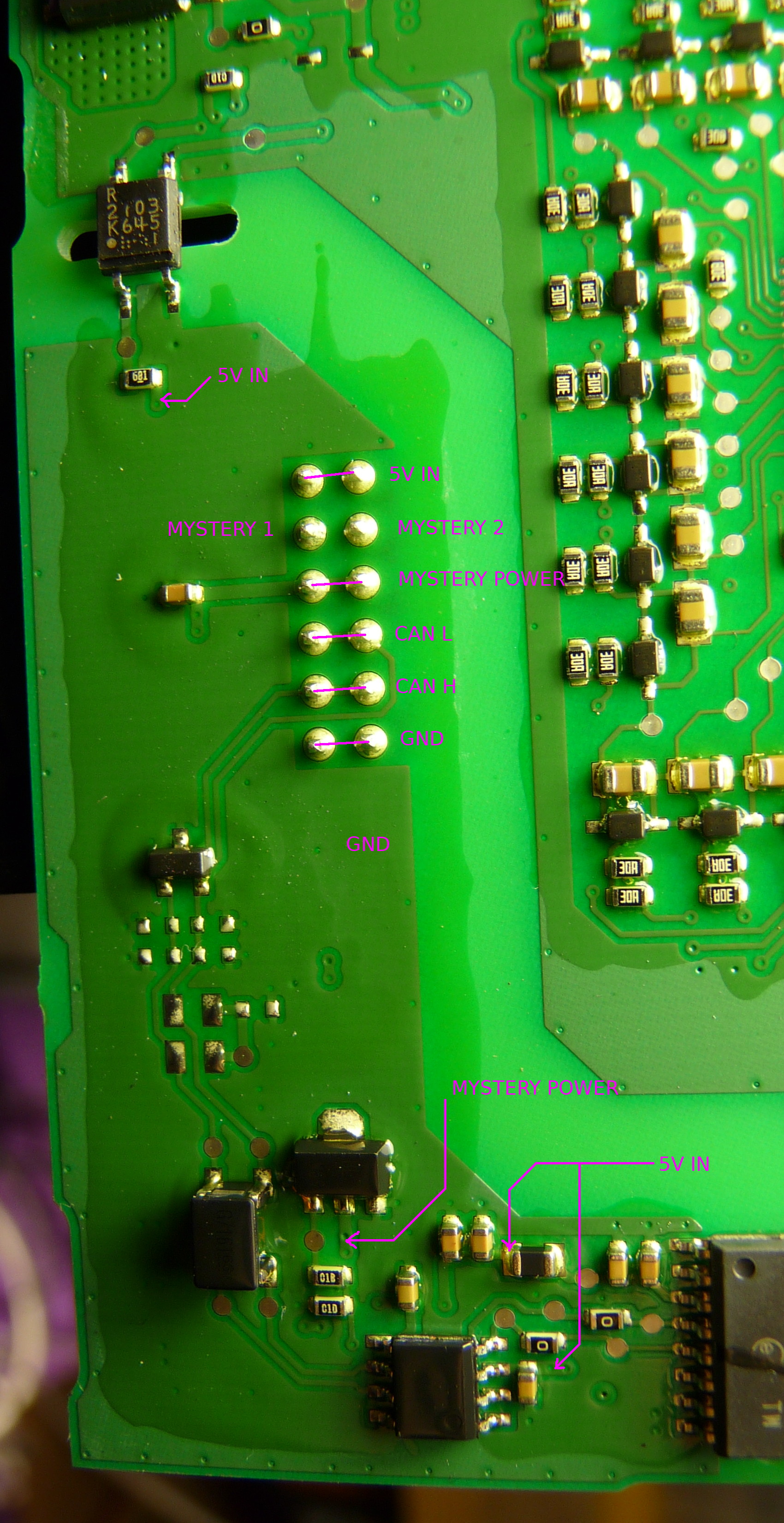

This is what I can make of it. Not sure about the two pins, were they even wired at all?
This is probably not correct yet, I'm still probing around.
EDIT: Updated a bit

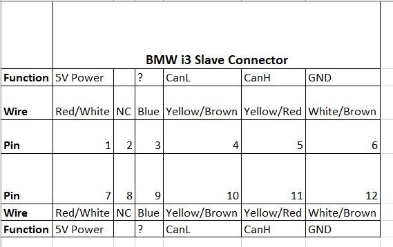

Slave looks alot like the I3 one, even canbus messaging is really close.
Pin out
Does anyone else have any more internal pack can captures? You have to just provide the external connector with 12V and ground and the master should start to request data.
Pin out

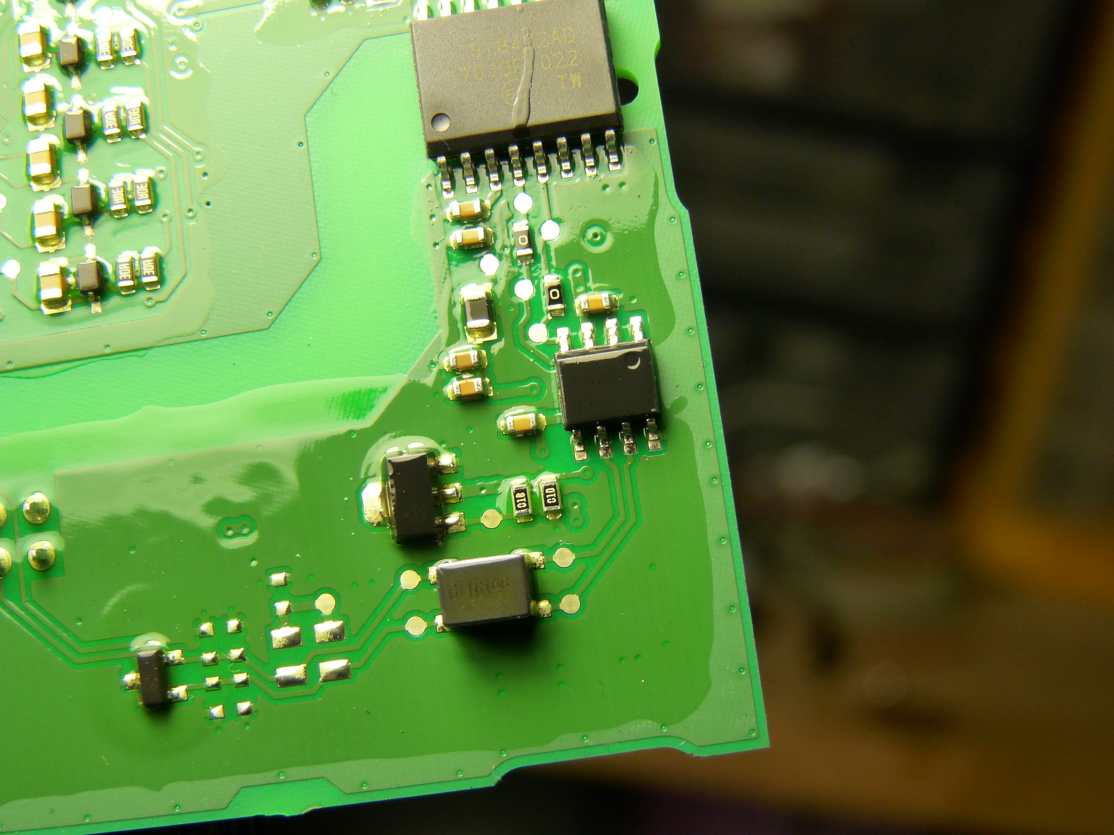

I was hoping to power up this BMS slave without the battery module itself, but I guess it's not practical as the isolated module side is designed for 40-70V input and might not power up with anything lower. Not so easy to figure out where to inject 5V or something, and whether it will tolerate that. I'll get back to this once I move this laptop stuff over to the garage.
- celeron55
- Posts: 805
- Has thanked: 39 times
- Been thanked: 136 times
Well I decided to go for it anyway, and destroyed some VDD filtering choke in the process of soldering through the coating. A jumper wire will be a fine replacement I suppose.
On the module side, I'm only feeding 5V to the power rail that connects to the Si8422 dual channel isolator and that seems to power the MCU, as it transmits things. Nothing is connected to the module connector.
