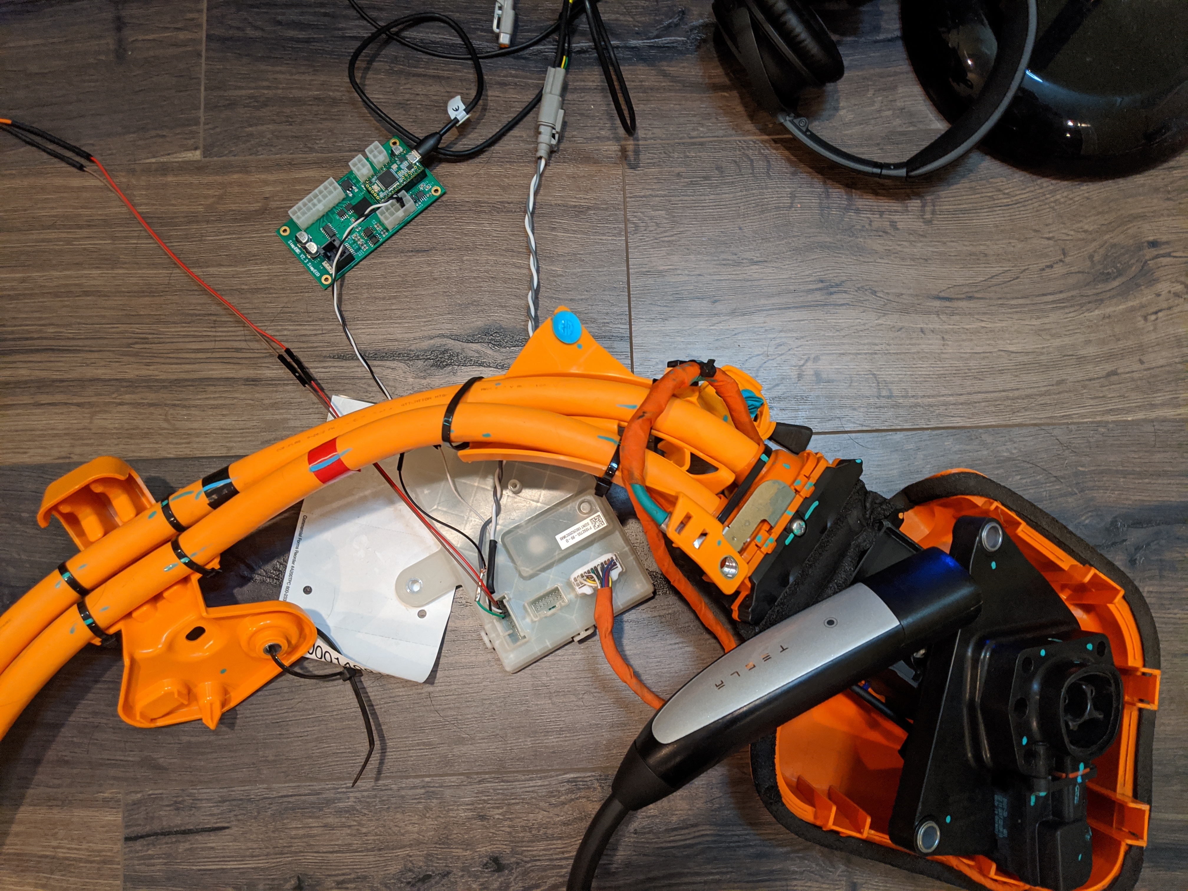

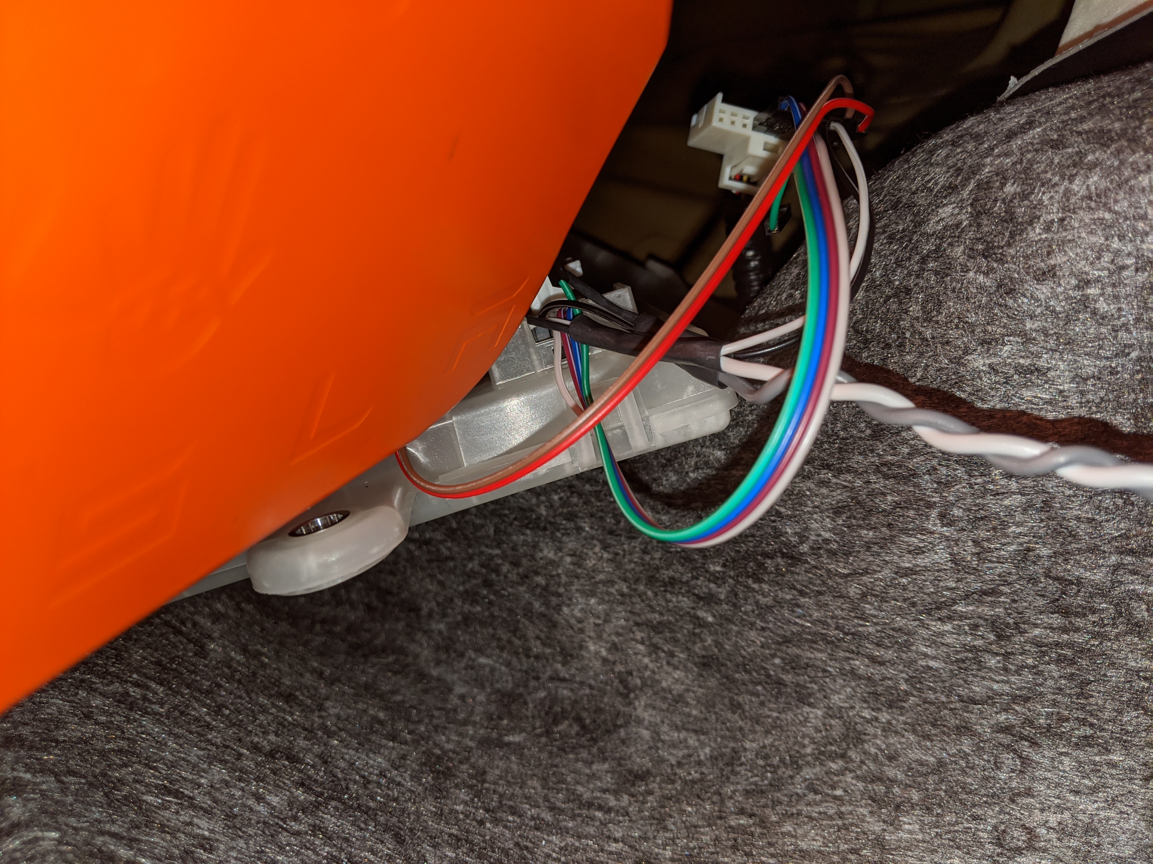

Well, I didn't get to do what I wanted, but I did learn something.
Logging on the "party" bus with the EVTV thing doesn't upset the car because it's the backup.
Messing with the charge port controller..Well...yeah. Uh. Don't.
1. It's a tight fit. :)
2. I understand this part now:
INSTALL
Installation procedure is the reverse of removal, except for the following:
Update the firmware.
I plugged in the power, and after a second or two, the battery contactors OPENED. I thought that was odd. So I opened the driver door to update the charge limit from 70 to 80% (I wanted some headroom to test with this ECU), and that's when I saw it was really, really pissed off. It said car was not driveable and to contact Tesla service. Yeah, oops. Hmm. Let's open the charge port door. Oh, that works. Look at the door. Tesla logo in RED. RED = Error. Hmm. Plug in the cable, still red. Ok then.
Swapped the connector back to the one that came with the car, contactor closes, coolant pump starts. Plug in cable, and it is charging currently.

I've been reading up on Tesla things and swapping parts. I think the charge port ECU is one of the things that has hundreds of firmware revisions (or at least number changes) and you need to redeploy firmware to the whole car if you swap it. Maybe after redeploying you could swap them back and forth (they should have the same firmware then).
Model 3... No idea how to handle redeploying. On the S you can telnet into the CID (one of the computers) using a special Ethernet cable and run commands.
https://teslamotorsclub.com/tmc/threads ... rt.142122/
INSTALL
Right - updating firmware does the same thing as a redeploy. But if you update with the extra ECU in the car, the original won't work (unless you redeploy).
-Isaac

Yeah I don't think that option is available to Model 3 owners. AFAIK the newer MCUs are much less hackable.
On the upside, I did get a list of the ARBIDs with the ECU disconnected, so I know what is available to it.
-Matt

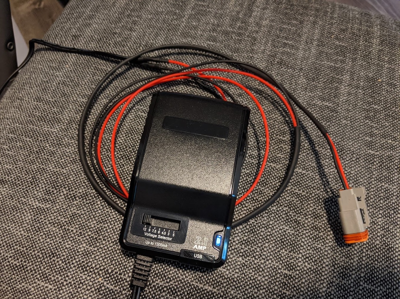

For $10 from Best Buy, I bought a supply which came with multiple plugs. A Deutsch connector is more fitting, so there you go. Lots of capacitance in there, as that was a good 30+ seconds after unplugging and there was still enough voltage to keep that LED going. :)
-Matt

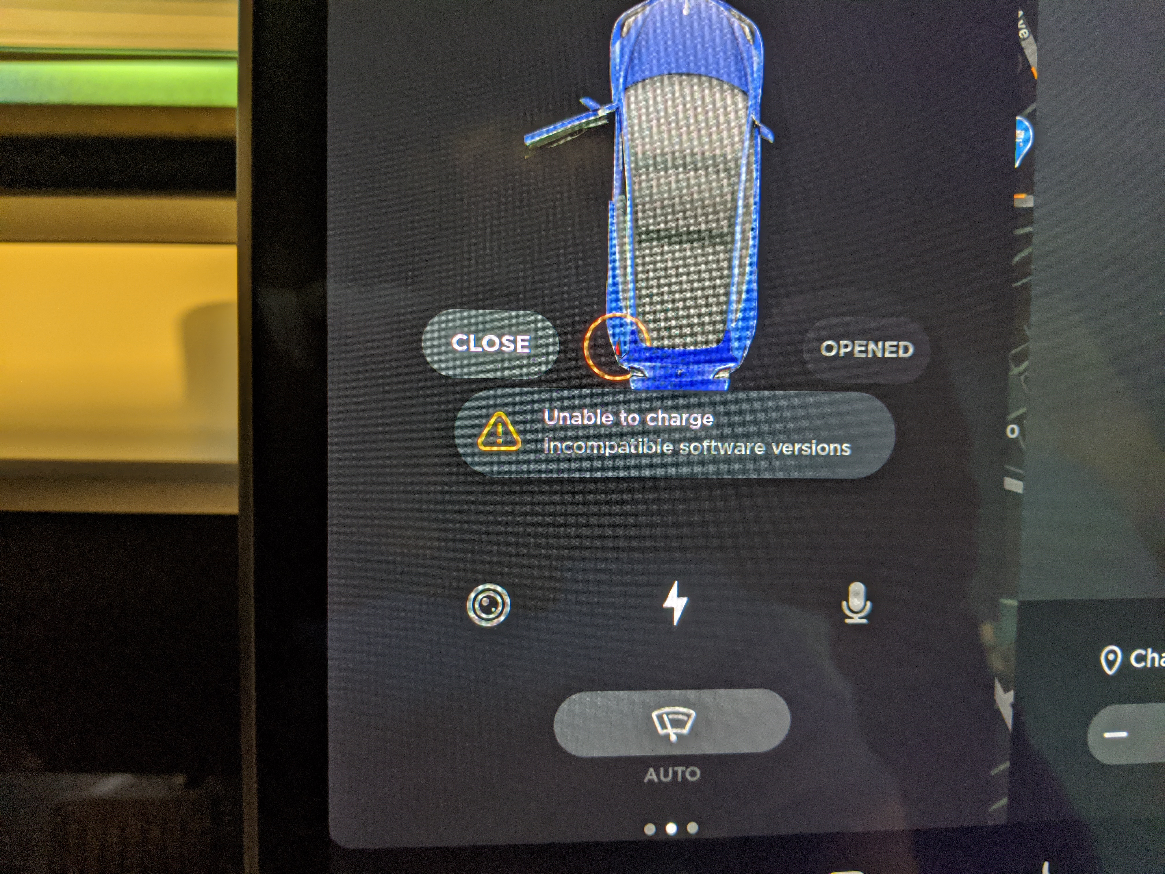

Ah... Ahhhhh, a-ha!
They are NOT replay-attack resistant; rather - they support multiple units!
I replayed the traffic capture from my car on the purchased ECU. Nothing.
I pulled the connection off the HV ECU connector and replayed from my laptop (filtered out for the original messages from the CP ECU, of course)...and the door opened.
Now to just figure out how to do address the thing.
-Matt

Right. What you're seeing is the firmware difference -- this is why they want you to have a software upgrade ready when you replace parts.
It's possible to telnet into a Model S to force a firmware redeploy, but the 3 may or may not be more locked down. The Toolbox software can certainly do what you need, if you can either get it or find a helpful service center.
Or just walk around looking for 3's and steal all their CAN logs :evil:
-Isaac
