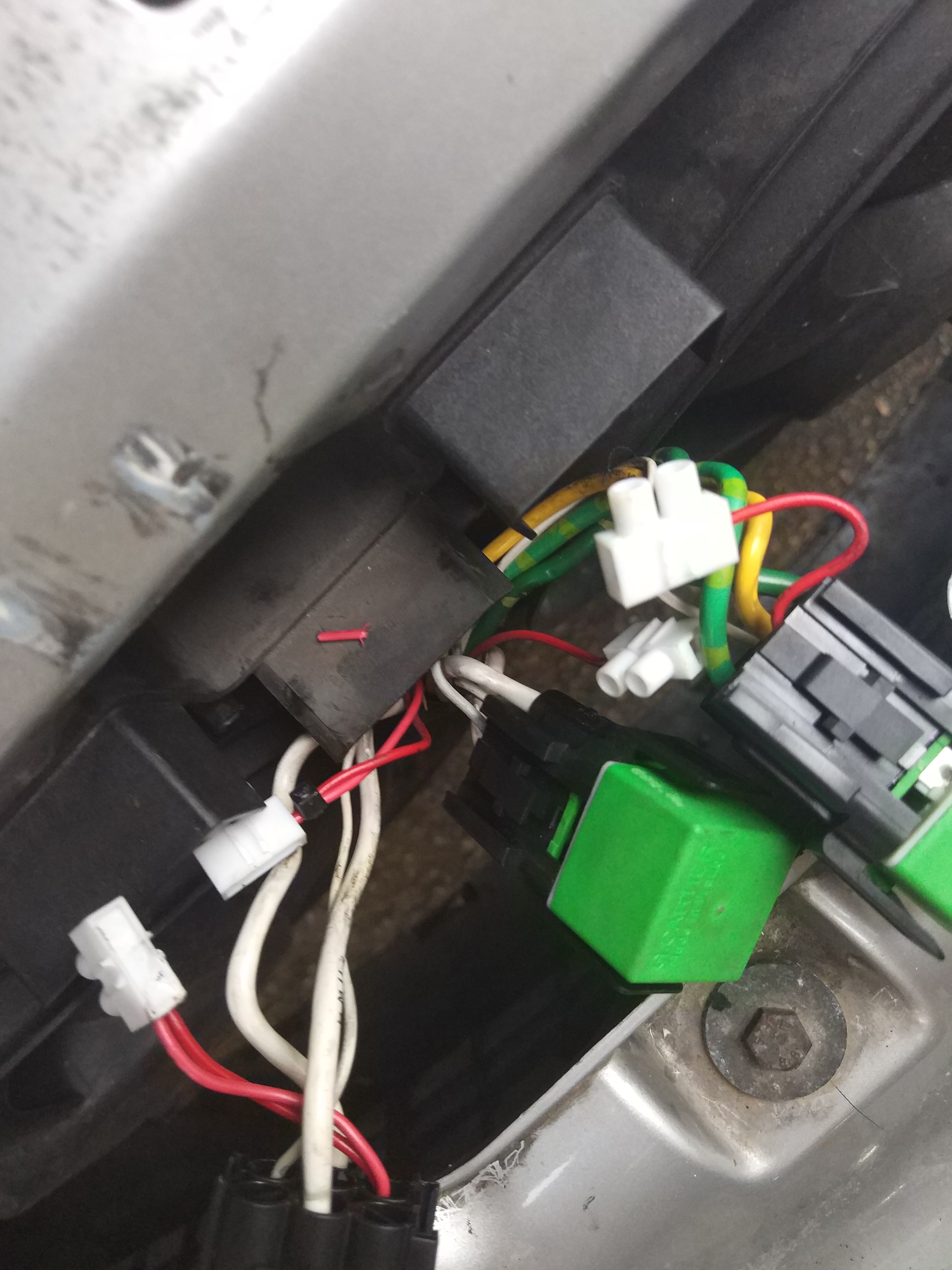

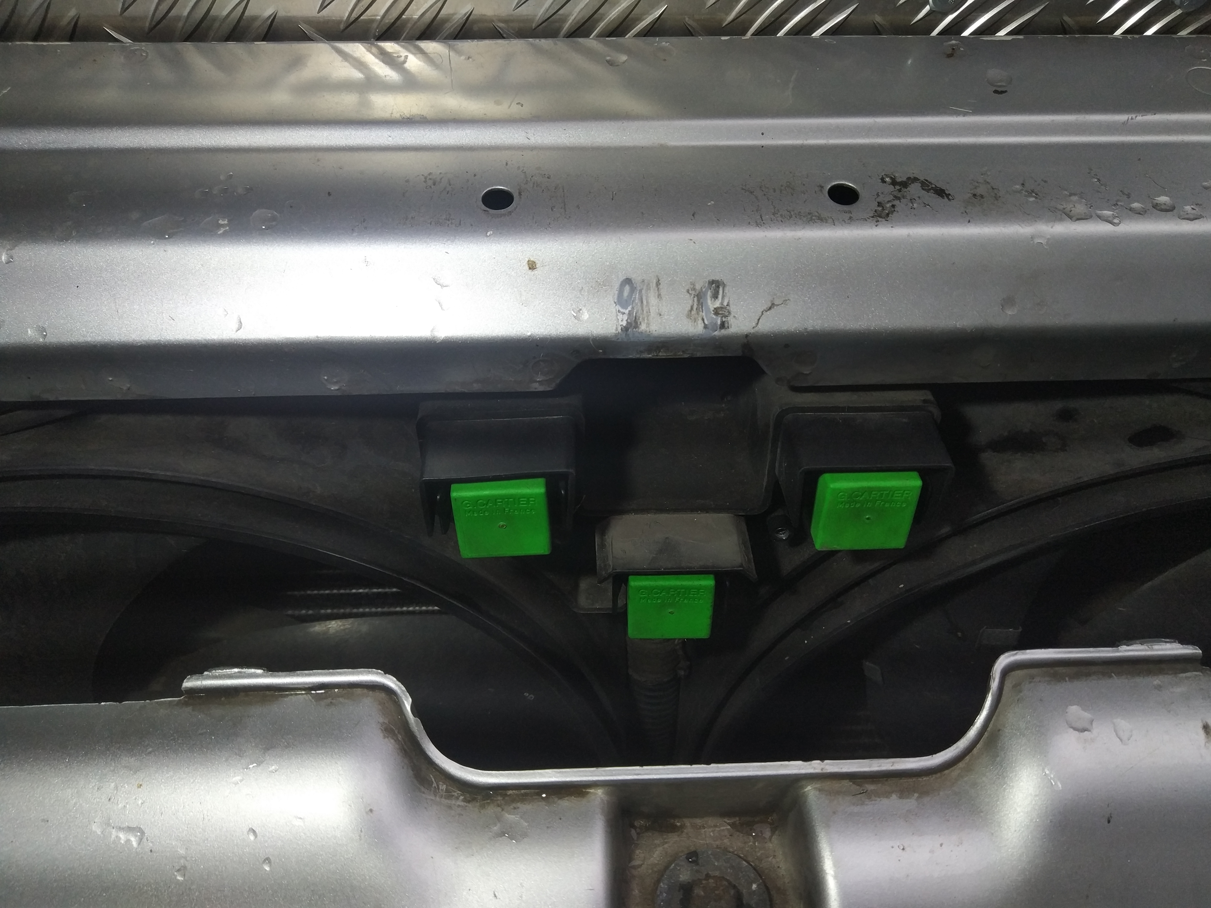

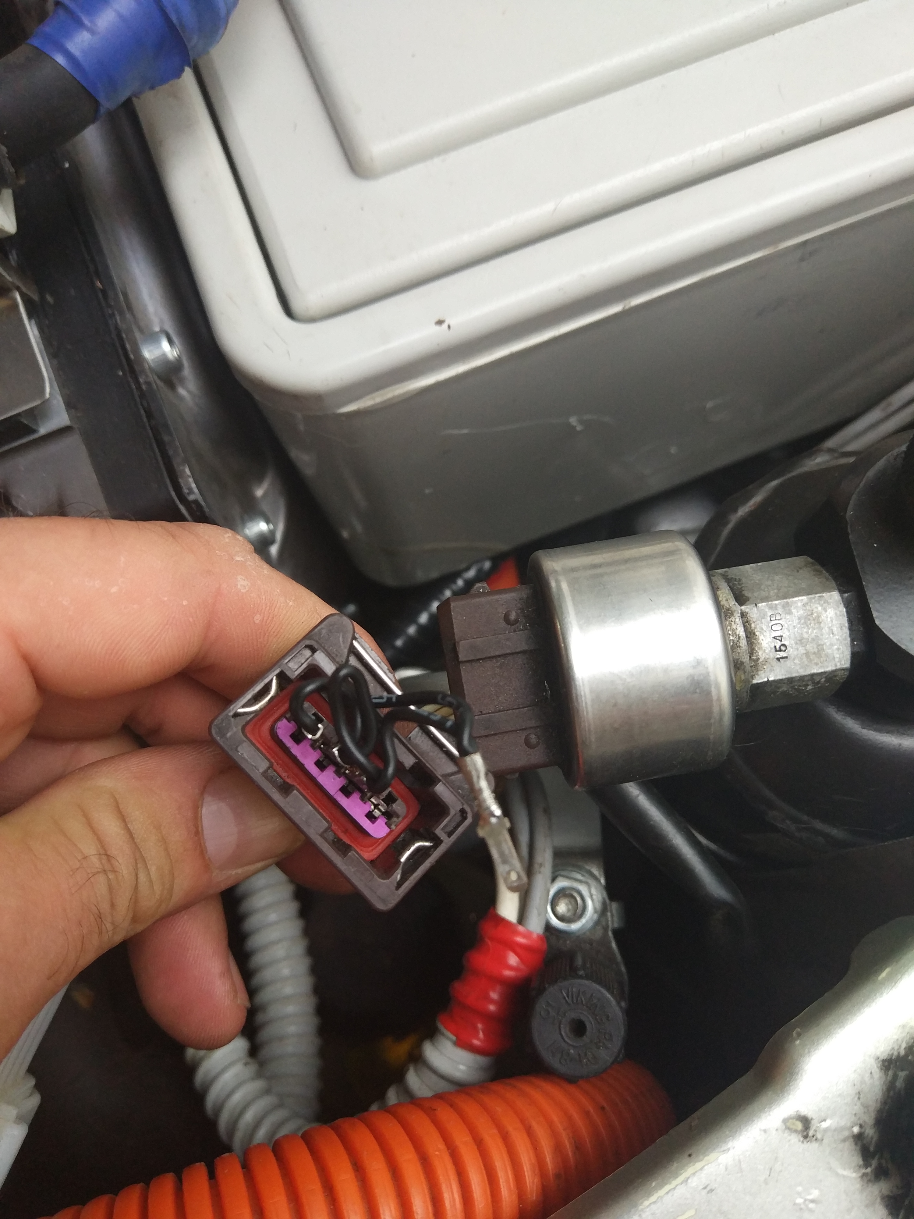

I guess throttle sensor was not the main culprit for "engine overheat" error displayed on dash.
How do i know that? Well i managed to connect throttle sensor and oil temp probe. Now after a longer time of "motor running" i still get "engine overheat" warning and STOP sign on the dash. At first glance it looks like a missing temp sensor. But when i try and follow what happens with sensors i see engine coolant temperature dial slowly rise from its corner up to 70deg! When it comes to about 1/3 warning happens and cooling fans start to blow at full speed.
I dont understand the logic behind this. I have a legitimate temp sensor connected to BSM on previous lines. I connected that directly to calm down BSM and also to have indicator for coolant temperature. I really didnt expect for the needle to move by itself.
But this happens only if i simulate engine RPM with my arduino. Any ideas? Are there more temp sensors?
I found in transmission training manual that one can use like 400ohm testing connection to test fan deploying function of transmission. Maybe that is happening because i dont have any ohm value connected. I will try to show it 1Kohm and see what happens.
Maybe i will be able to use this logic to manualy deploy fans at the time of my choosing.

Re: Peugeot 406 coupe Pininfarina with Leaf motor and Ampera inverter
Look if You have more than one temp sensor - in my car are 2 - one in engine and second on cold tube from cooler.
There isn't also any cooling fluid flow sensor, fluid pressure sensor etc.?

I am not so sure now that i read about some transmission test protocol. I think it is something in ECU software to allow it to test overheat condition.
Today i will wire one 1K resistor onto connector wires. Also i see i will need to wire 6R to solenoid wires so the system will think it AT works

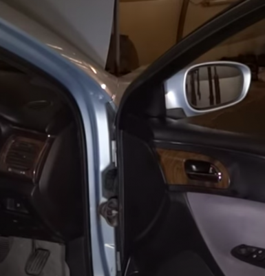

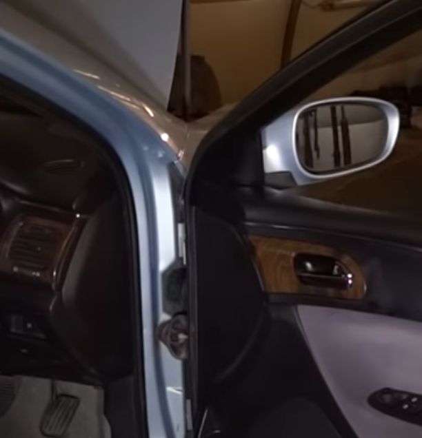

The one finding i recognised the most serious is the "open door beeper". Regulation says it needs to beep if key is ON and doors are open. This is to notify the driver of the working vehicle since EV does not produce any sound when standing still.
Originaly Pug has a beeper which does beep ONCE if you open the door, but that is not enough. Sound needs to be continuous. I guess i missed that.
My plan is to fit a piezo speeker under the drivers seat and it will be wired to ignition and to the door.
My only problem is how the door knows it is open? I cant see any switches on the door or on the frame. Does anyone know of where that would be located on a 406 coupe?
I need to connect to incoming side of the switch and my beeper will chime..
Or maybe i need to connect the the door light under/inside the door? It is only lit when door is open is it not? Hm...

Looks like a push switch on the frame below the front door hinge (this video says it's a 406 coupe but that could be wrong)

Now i am playing with cooling fans controls. I see the logic behind a two fan start. First they start slow and then relays click! Now fans start to run at full speed which is quite loud.
I also found out that i can trigger start behaviour with the 4th contact on pressostat. If i give it 12V it will start fans and if i pull it they will stop.
Now in practical terms i have 3x relays between fans. I experimented with taking them offline and figured which relay was for which function. In the end i cut positive control wires to two relays and now with a single pressostat wire i can start both fans at 1/2 speed. Though full speed is not available anymore i think i will be good with half rpm. It is much quieter and lower 12V consumption.
Last time i went on the highway and drove some 40km to a friend and charged there. Remember i have my temp gauge wired with some parallel resistance to create higher temp. That way dry temp sensor alarm wouldnt get me at start. When i leaned over and touched the coolant hose leading to radiator i was shocked! It was hot. Luckily it was not hot enough to fault the inverter.
