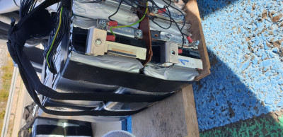

For that purpose i also bought a broken Ampera car. It showed the wreckage was only on outside. Every internal component aside of airbags was still working. I got another inverter, DCDC converter, 3kW charger, electric cabin heater, AC compressor and of course one good 16kWh battery.
Almost everything i got off there works on CAN bus. Even BMS is already there it just needs to receive commands for it to work. I also have a EVTVdue board with single CAN chip and eeprom. I would like to use that to signal my devices on the line.

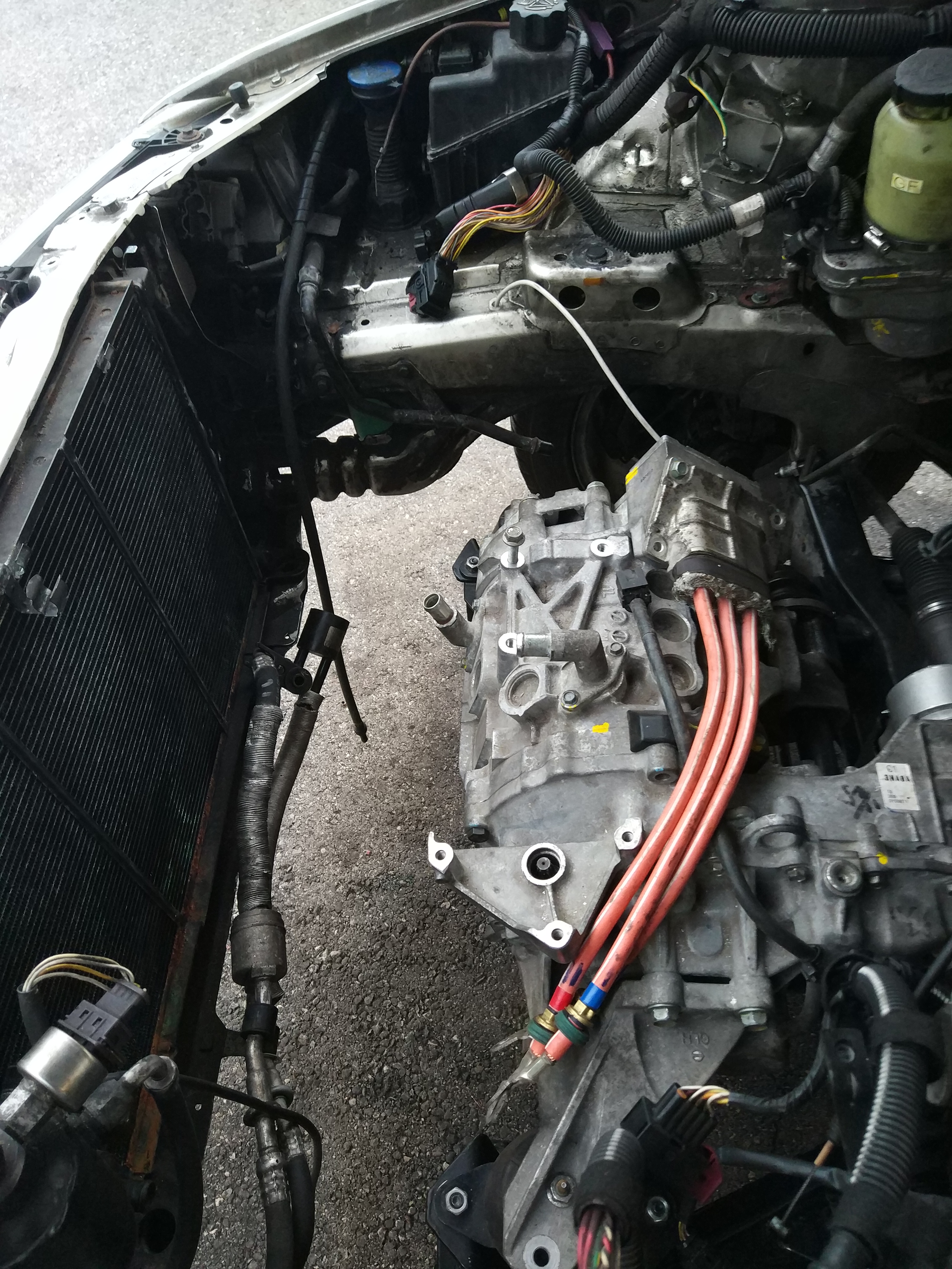

Since i have motor and gearbox from Leaf i will just use that. No shifting required. 1:8 gear that ends at cca 10000rpm and 150km/h. It would go further using field weakening, maybe 20%...

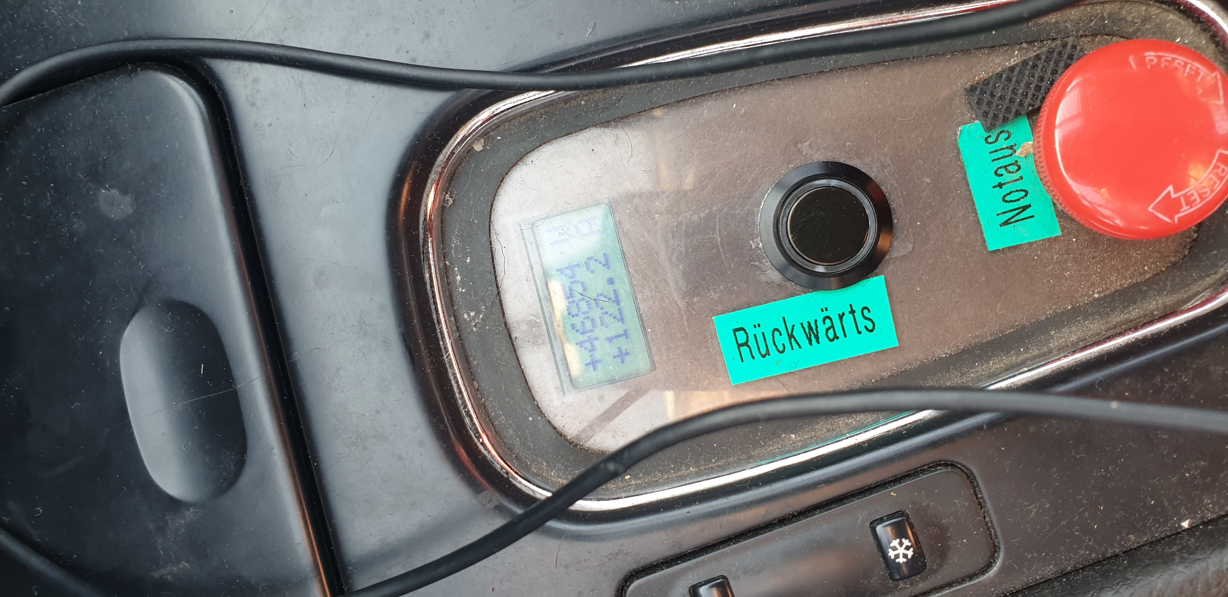

I will use electronic reverse function. Motor inverter switches between phase wires and motor spins backwards. There will be some logic involved to inhibit switching if motor is turning over 100rpm for safety etc....
I will just use switch with safety cover so changing direction will require two intentional gestures.

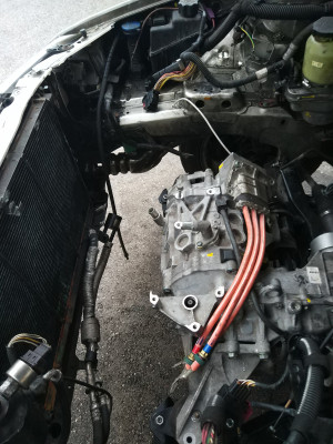

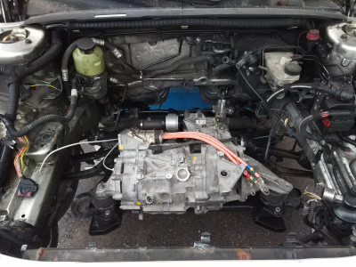

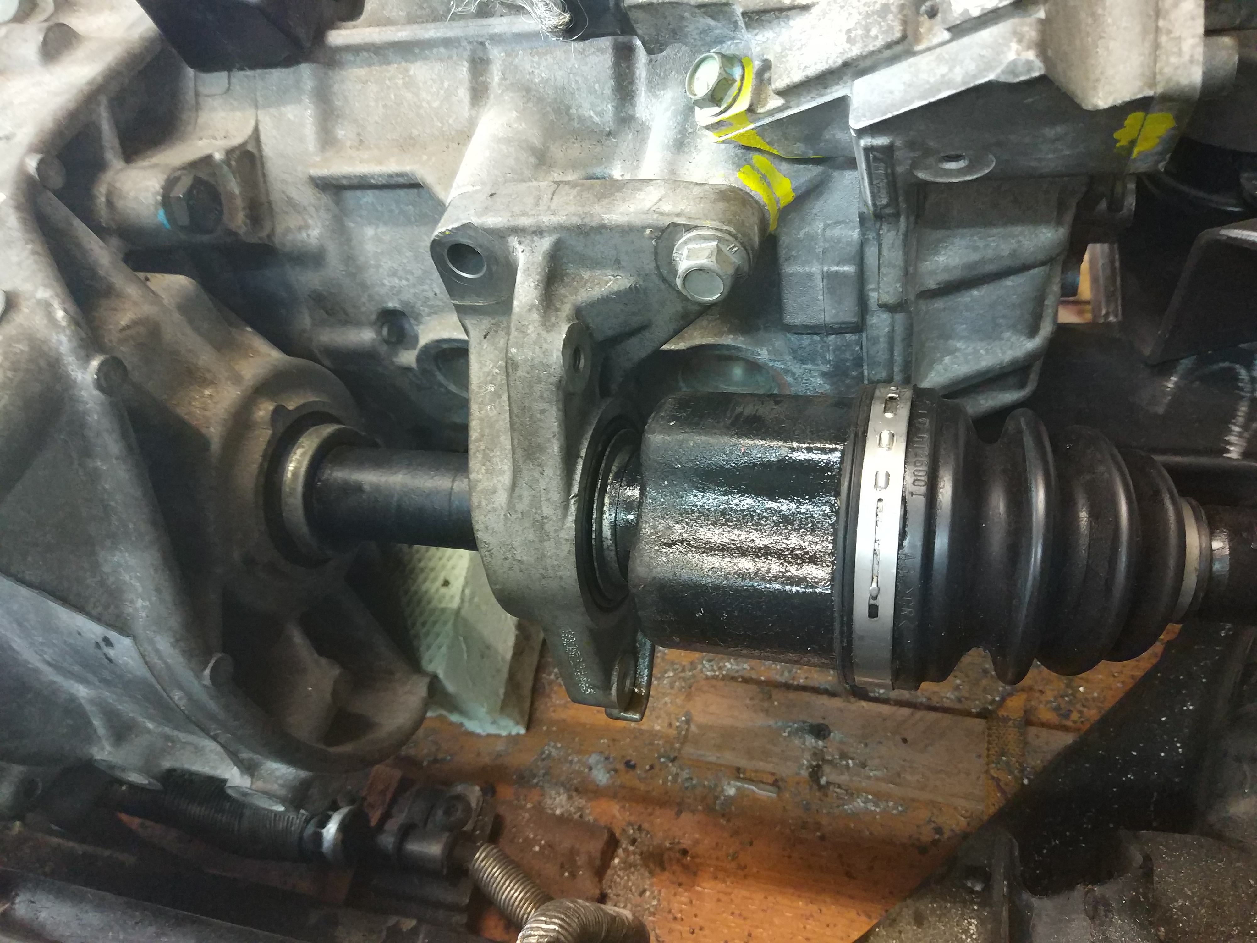

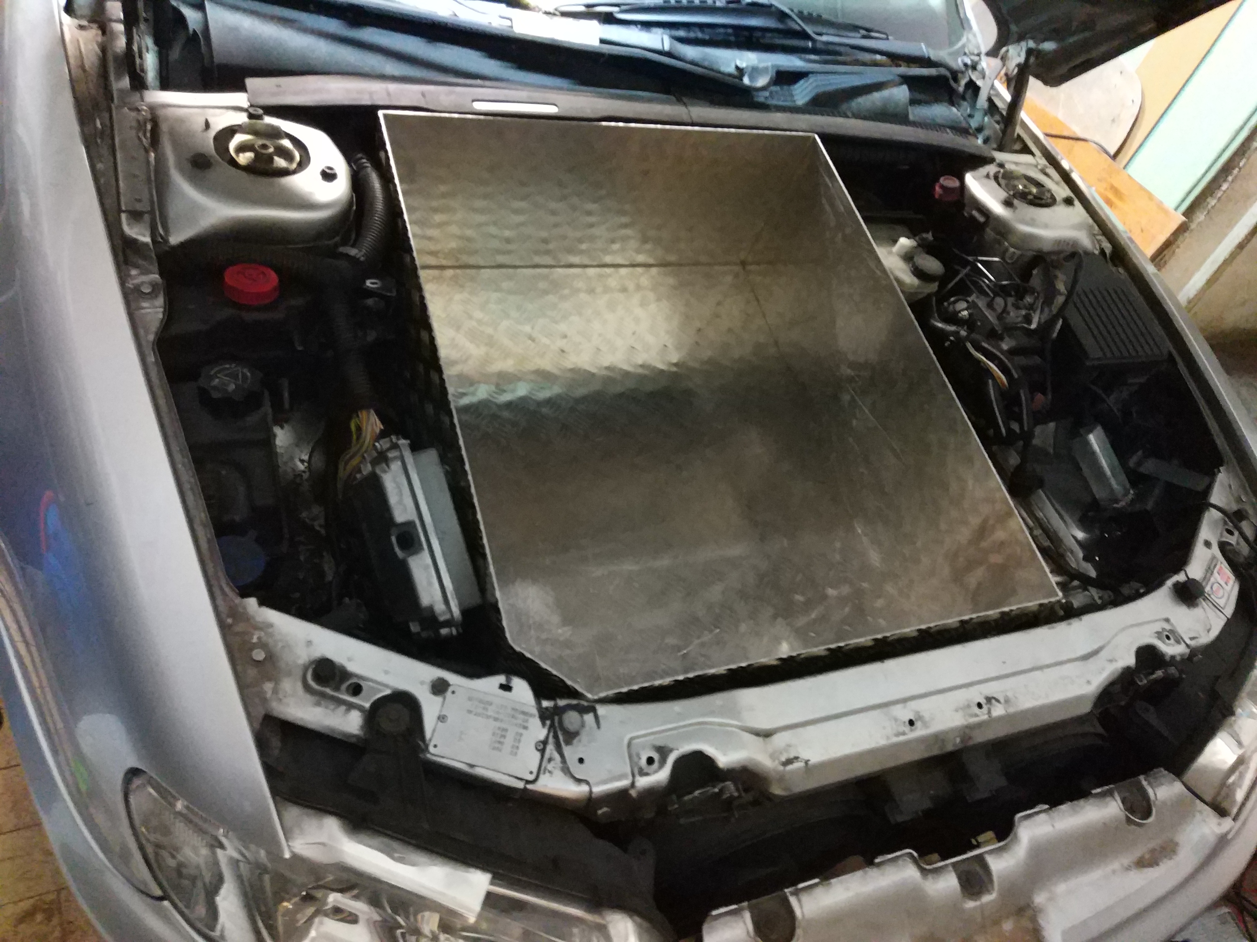

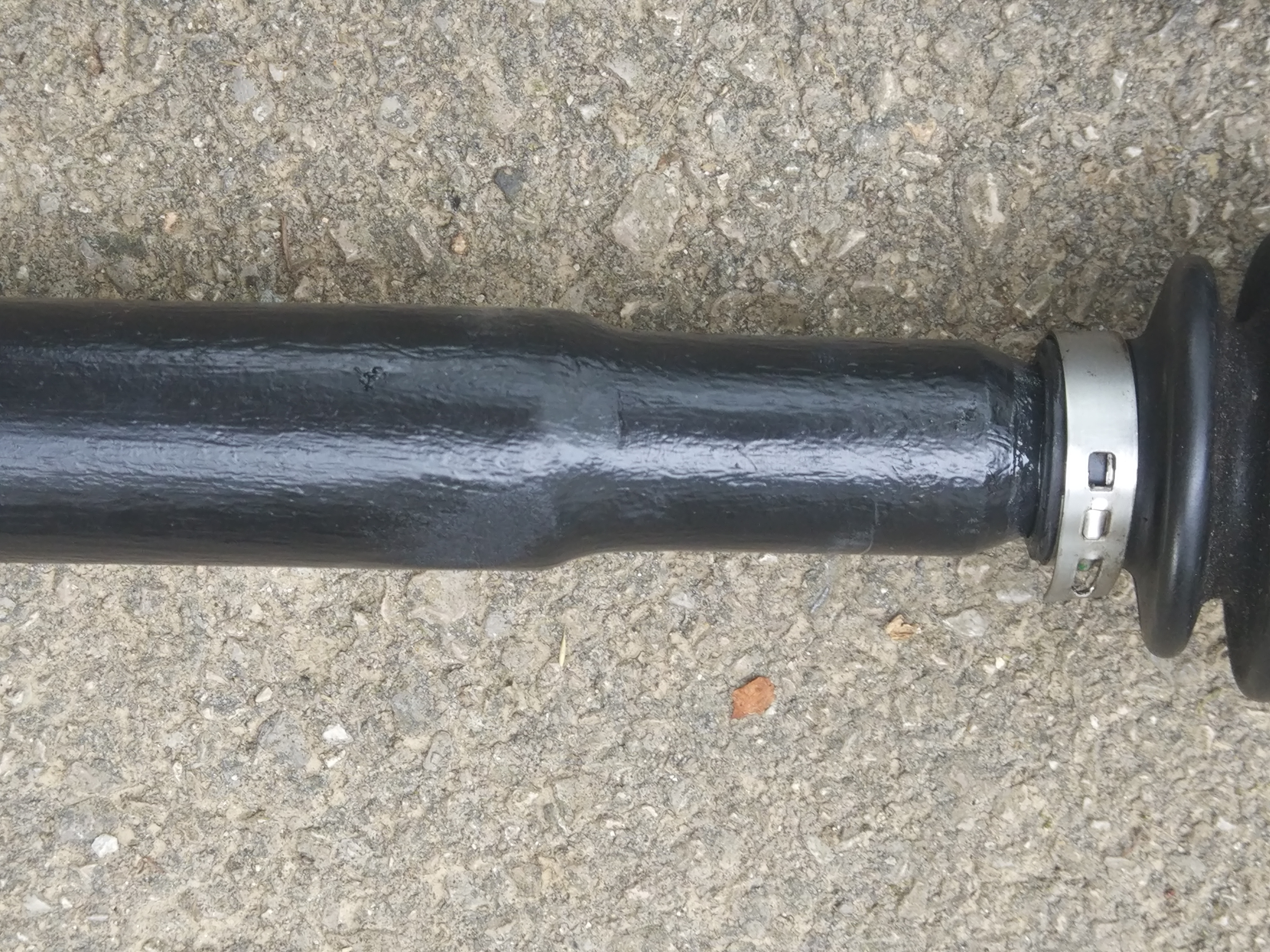

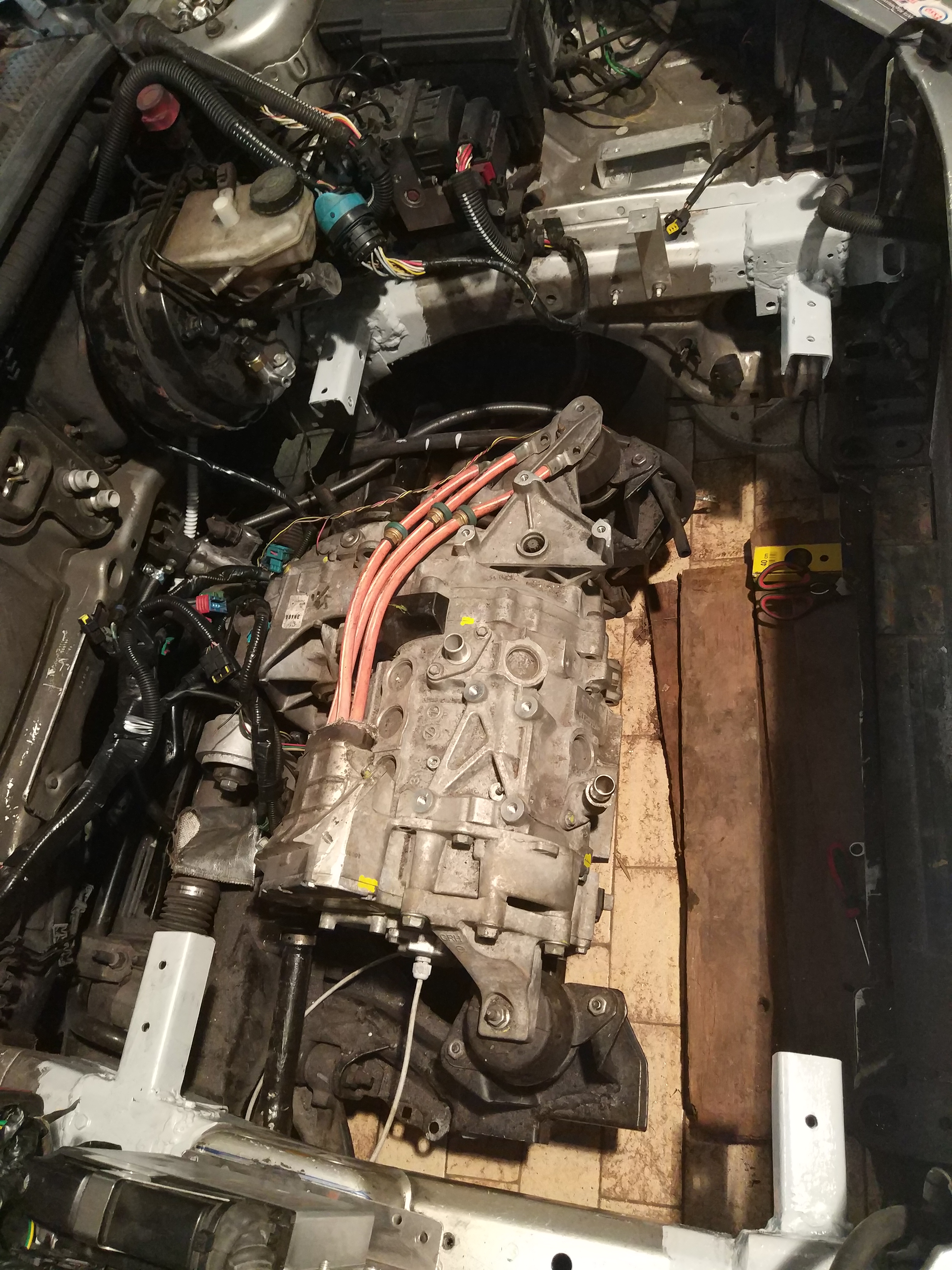

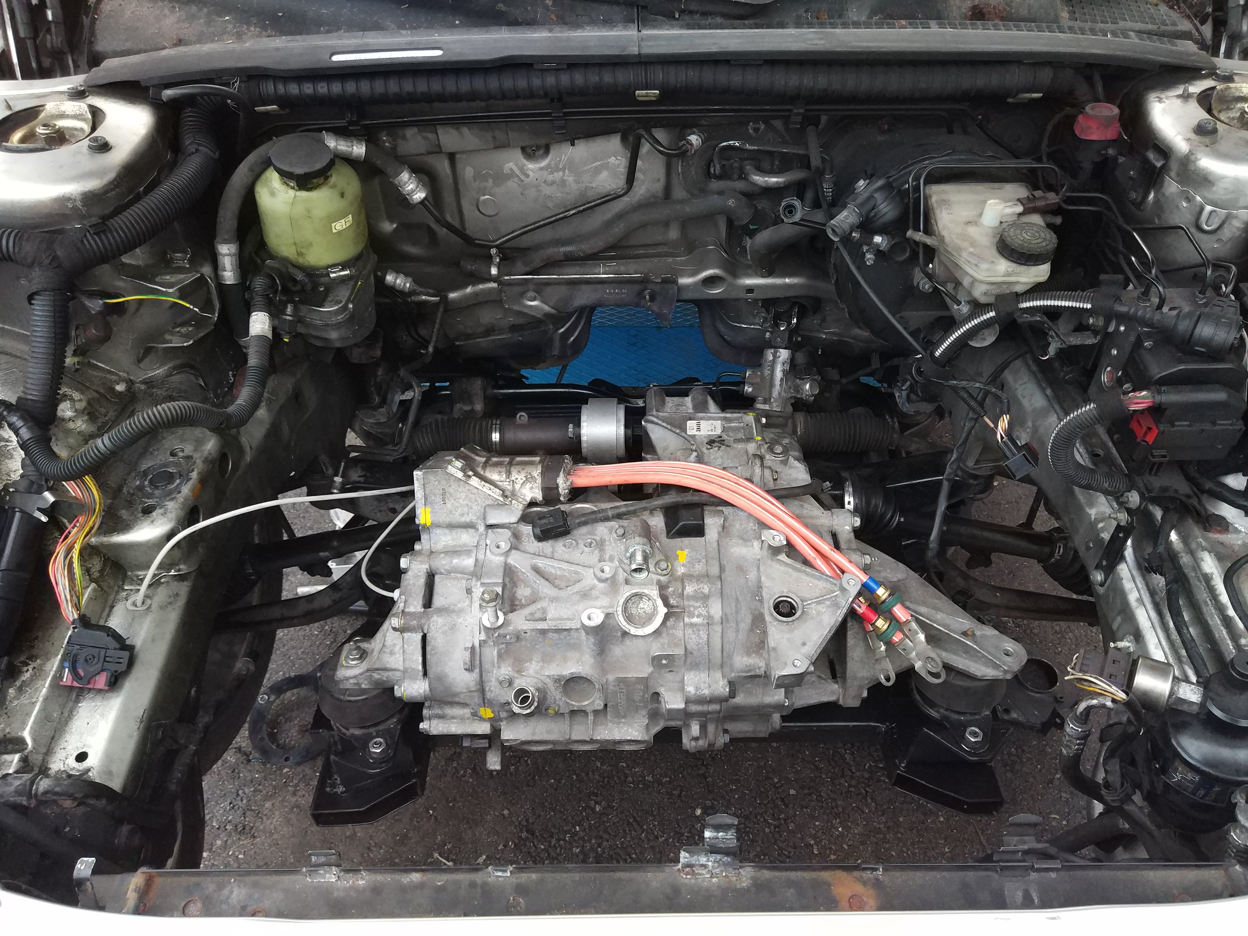

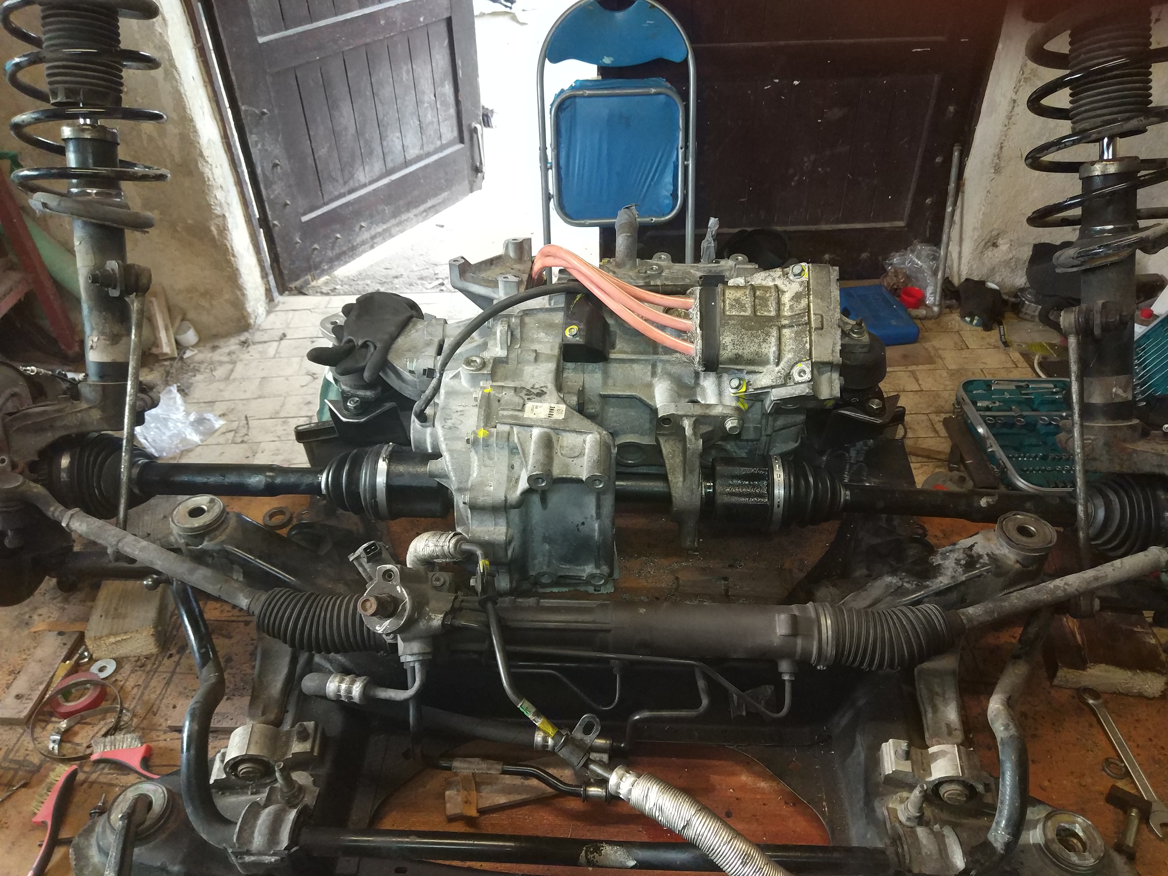

I pulled the engine out with everything engine bed, disks, shocks and transmission. I am now keeping subframe in my garage and are trying to design motor mounts for Leaf motor.
Leaf right one has additional bearing that keeps the shaft aligned and keeps the same length of both driveshafts as well as both angles of movement.
406C and Leaf are almost the same width and the shafts are a good fit. Pugs shaft is wider tube which will help me with mating one onto the other. That is exactly what i did. I cut both shafts where they intersected and I got them to Stane and he turned Leaf shafts and took off 0.5mm of material so that leaf shaft went into the 406c shaft for about 60mm, Then we drilled into 406c shaft from the side to get access to the underlying Leaf shaft. We then welded along the joint circumference AND into the hole. That meant that bothj shafts are melted into one and no ammount of torque will turn the inner shaft inside the outer.

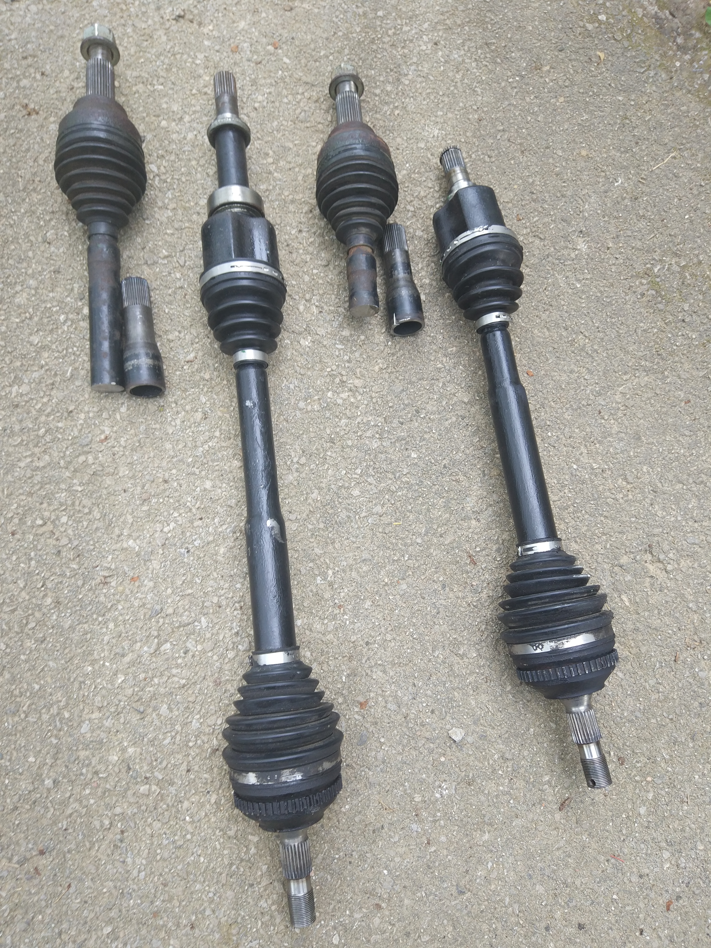

I managed to dissassemble both Peugeot and Leaf driveshafts.Leaf right one has additional bearing that keeps the shaft aligned and keeps the same length of both driveshafts as well as both angles of movement.

Amazing job. Where did you get the Leaf shafts?
- Posts: 3571
- Has thanked: 134 times
- Been thanked: 339 times
Re: Peugeot 406 coupe Pininfarina with Leaf motor and Ampera inverter
Hi J
Yes i also find it quite nice. What is amazing is that Stane, the guy who last time supplied the wine btw, used only a day to make them. Truly good machine work, hats off.
I bought leaf drive shafts like a year ago when i got Leaf motor. I could get Leaf motor with gearbox, but shafts are harder to find. They are quite expensive as new part.
WARNING! Different first generation Leaf cars (EM61 and EM57 motor) shafts are very similar down to a few millimeters, BUT really do not fit! I got some shafts here in Slovenia that were from EM57 car and i couldnt fit the bearing mount and splines were no fit. Be carefull with P/Ns when ordering.
Leaf 2011 with EM61 motor PNs
39100-3NA0A RH driveshaft with bearing
39101-3NA0A LH driveshaft short
Leaf 2012 onward with EM57 motor PNs
39100-3NF2A RH driveshaft with bearing
39101-3NF2A LH driveshaft short
I got them from Norway from their "car parts forum". You have to be carefull to make sure to also get the intermediate shaft bearing mount on the right side. This is a pain to make and original is the best.

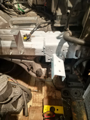

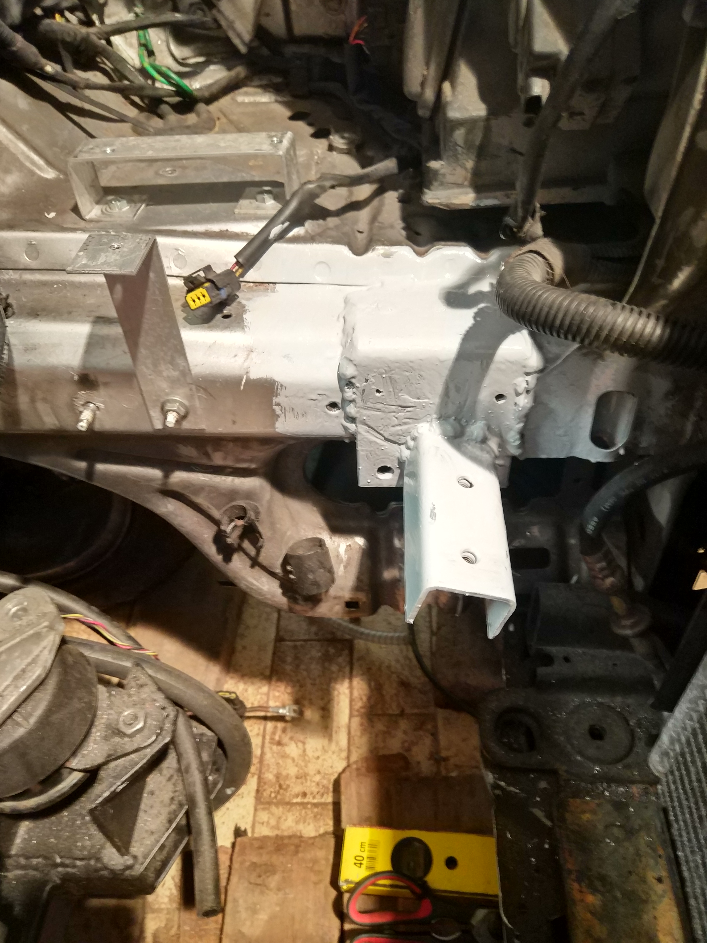

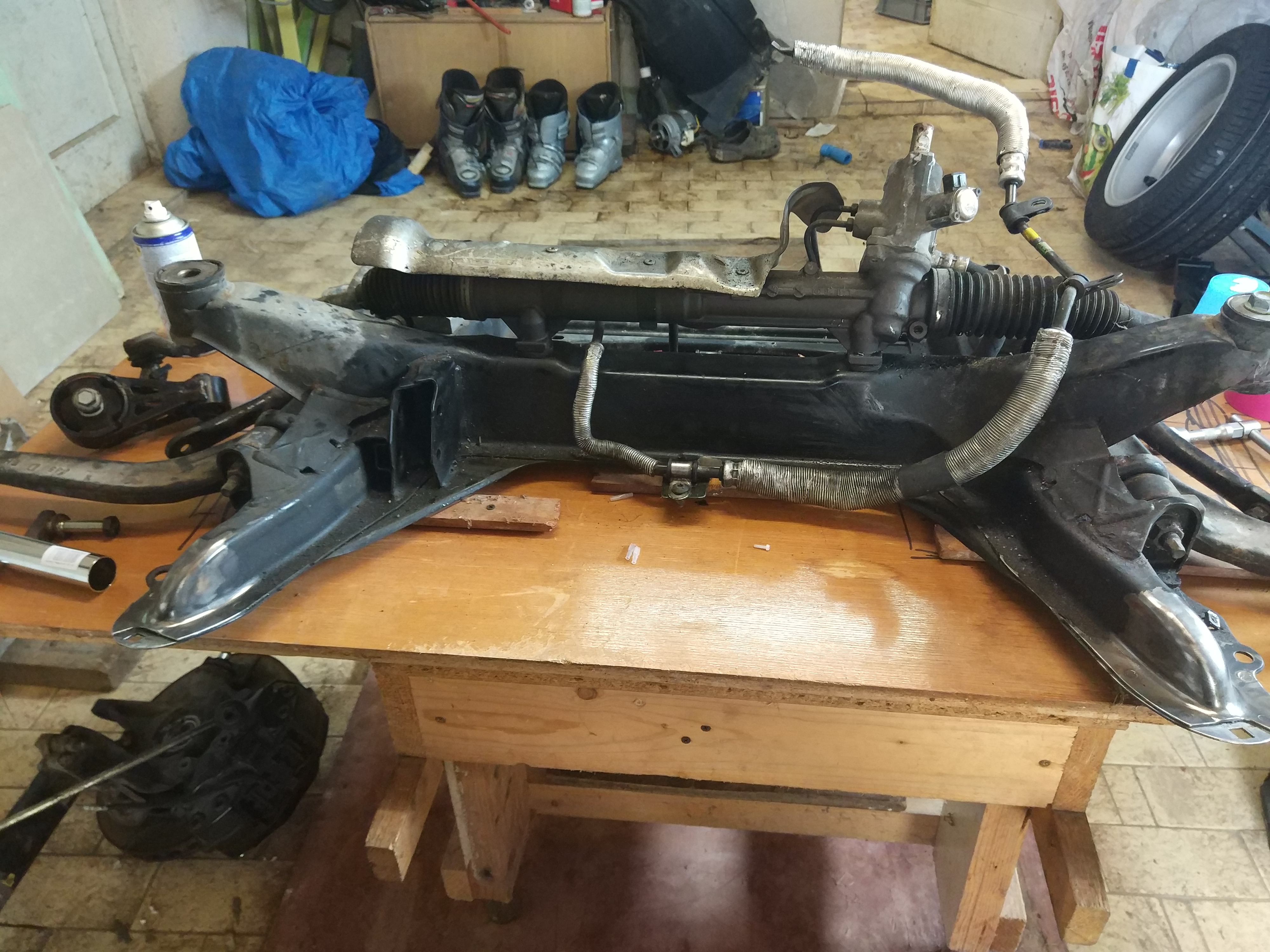

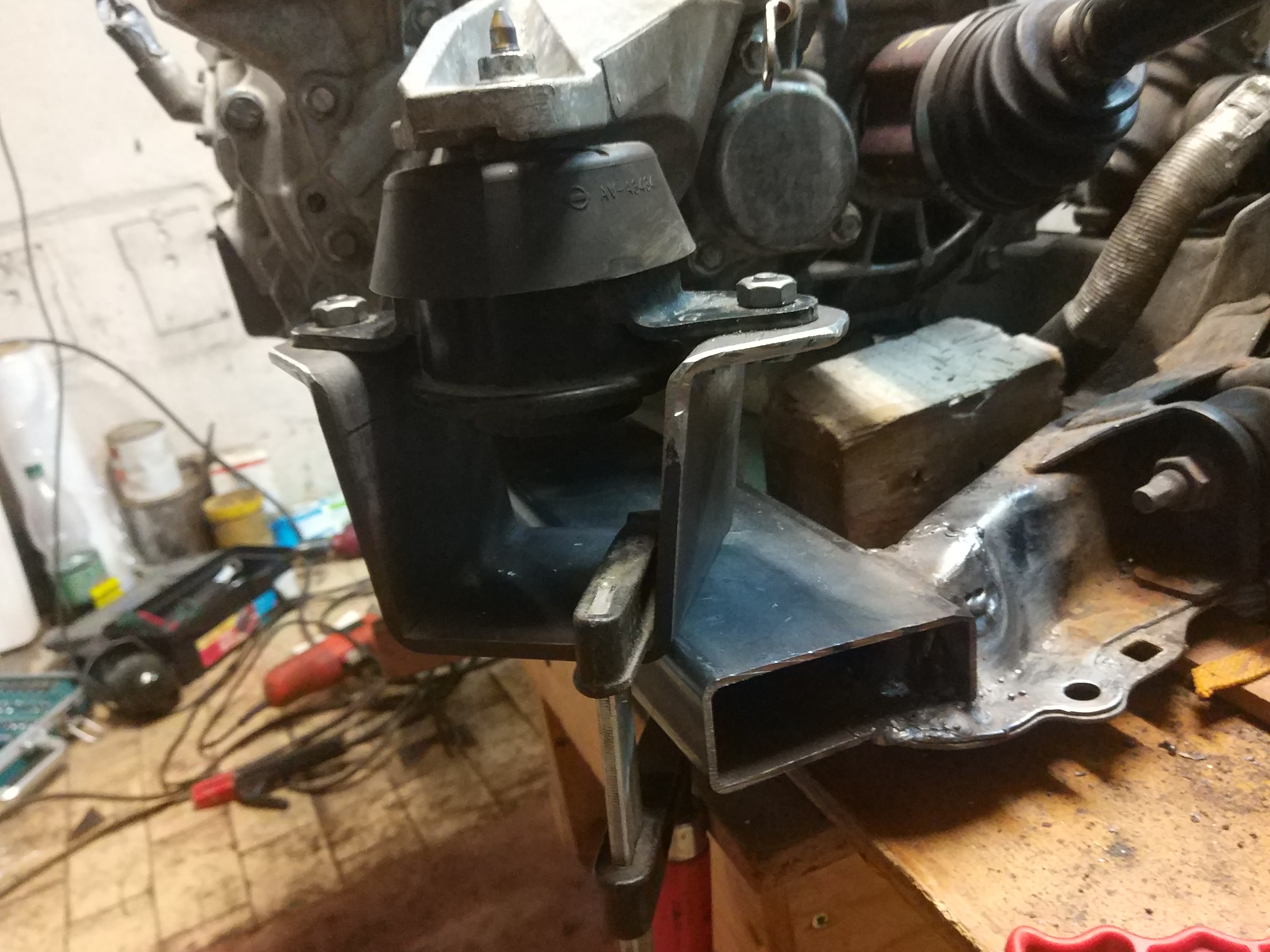

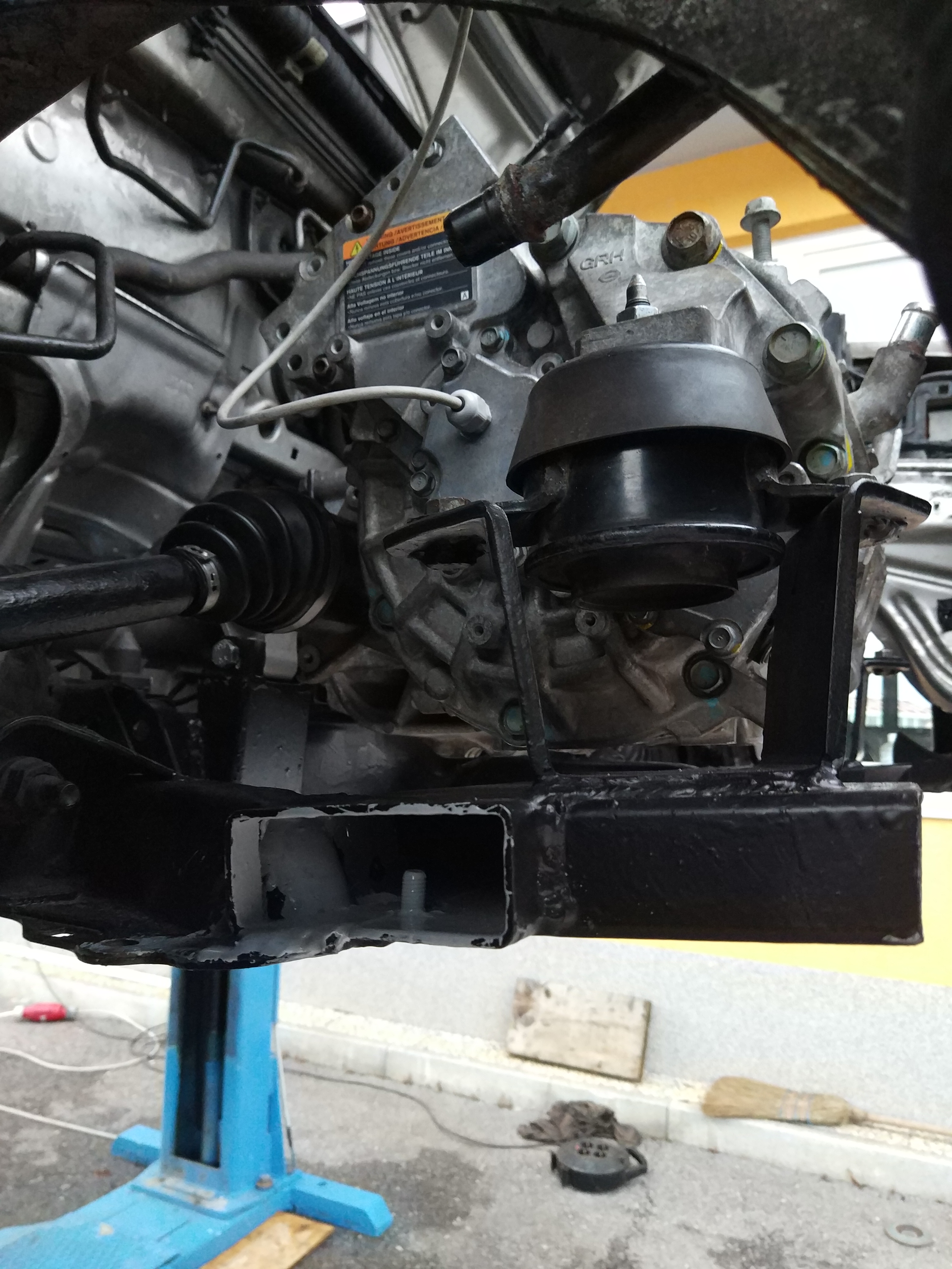

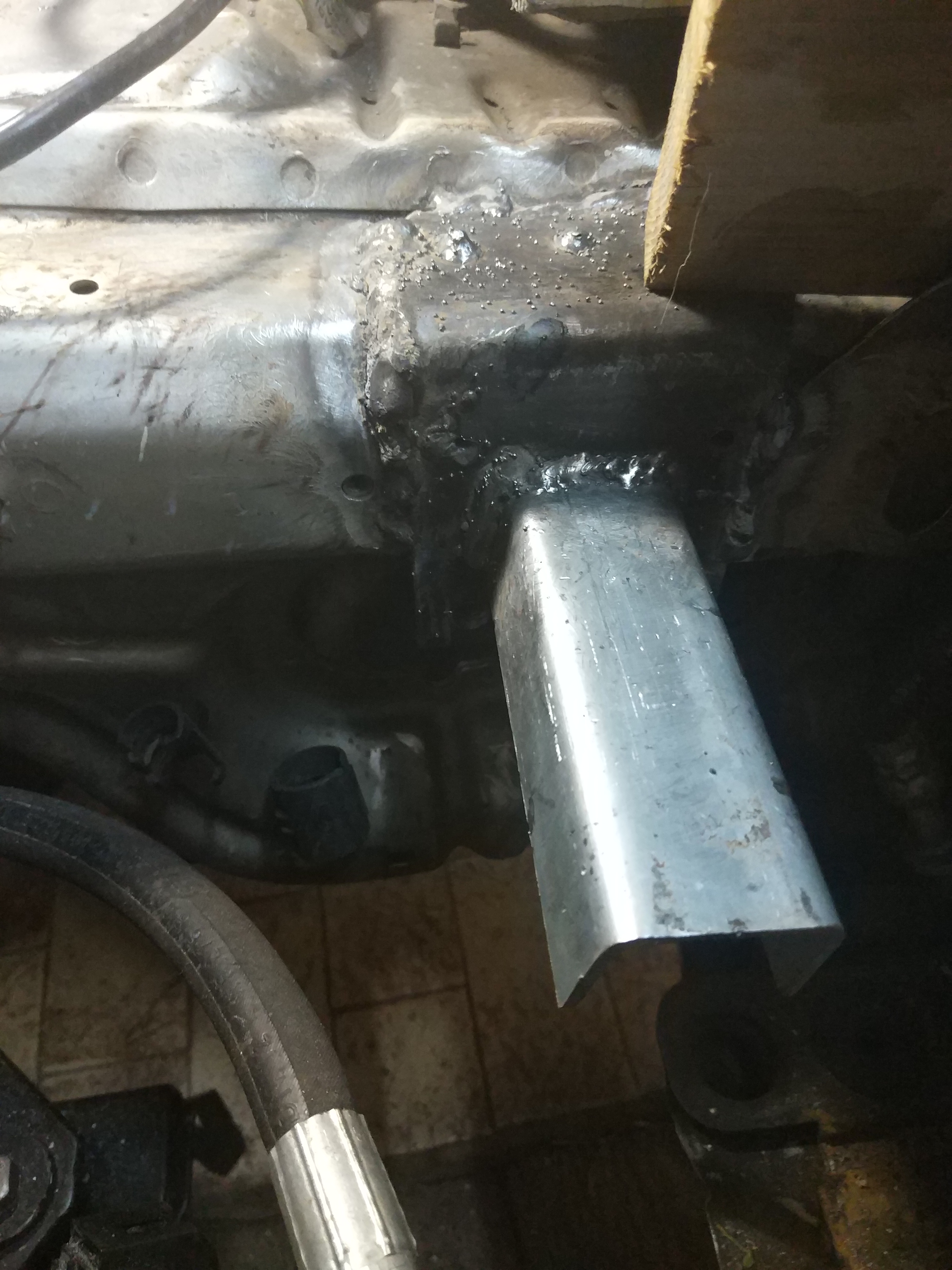

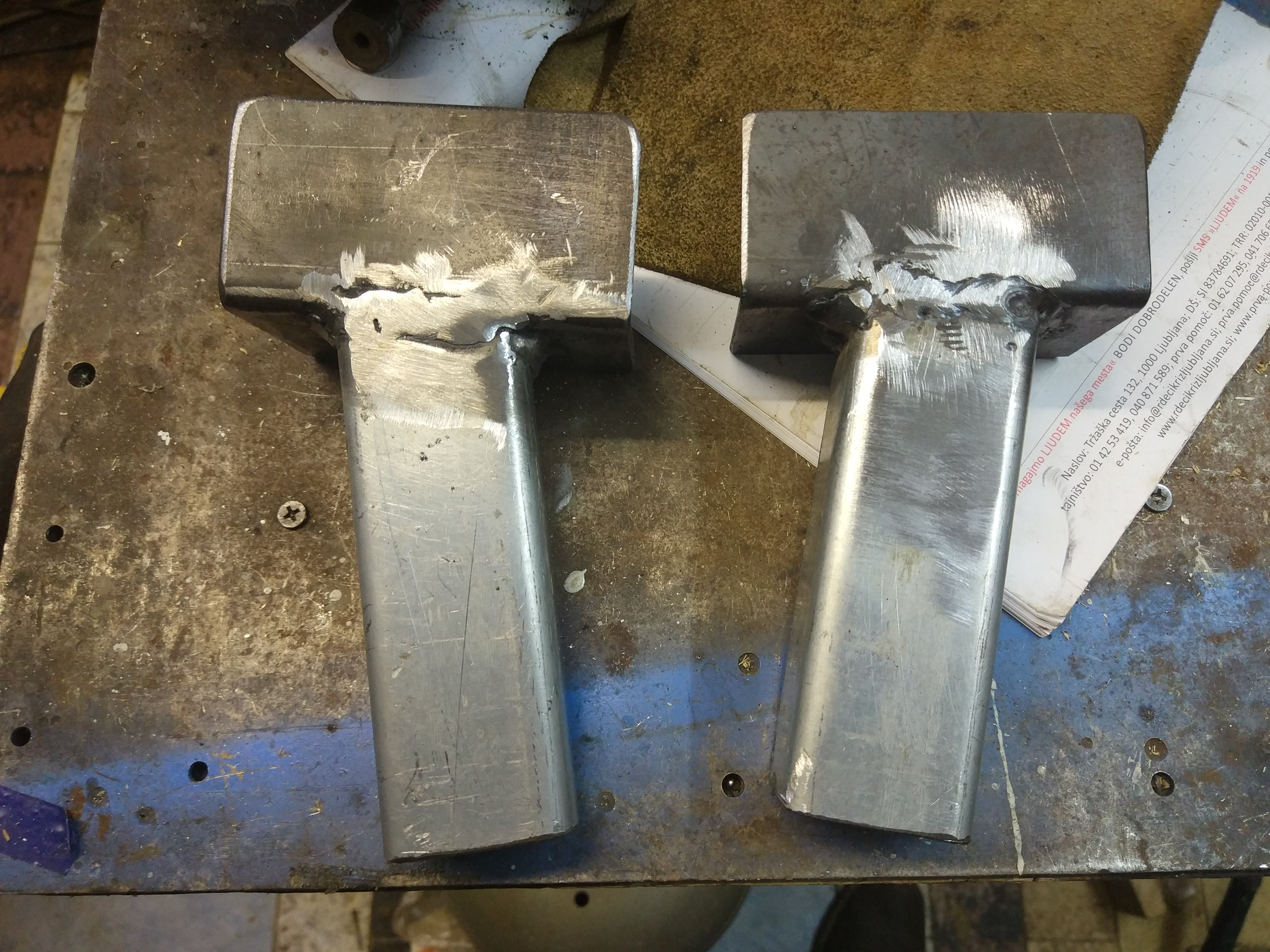

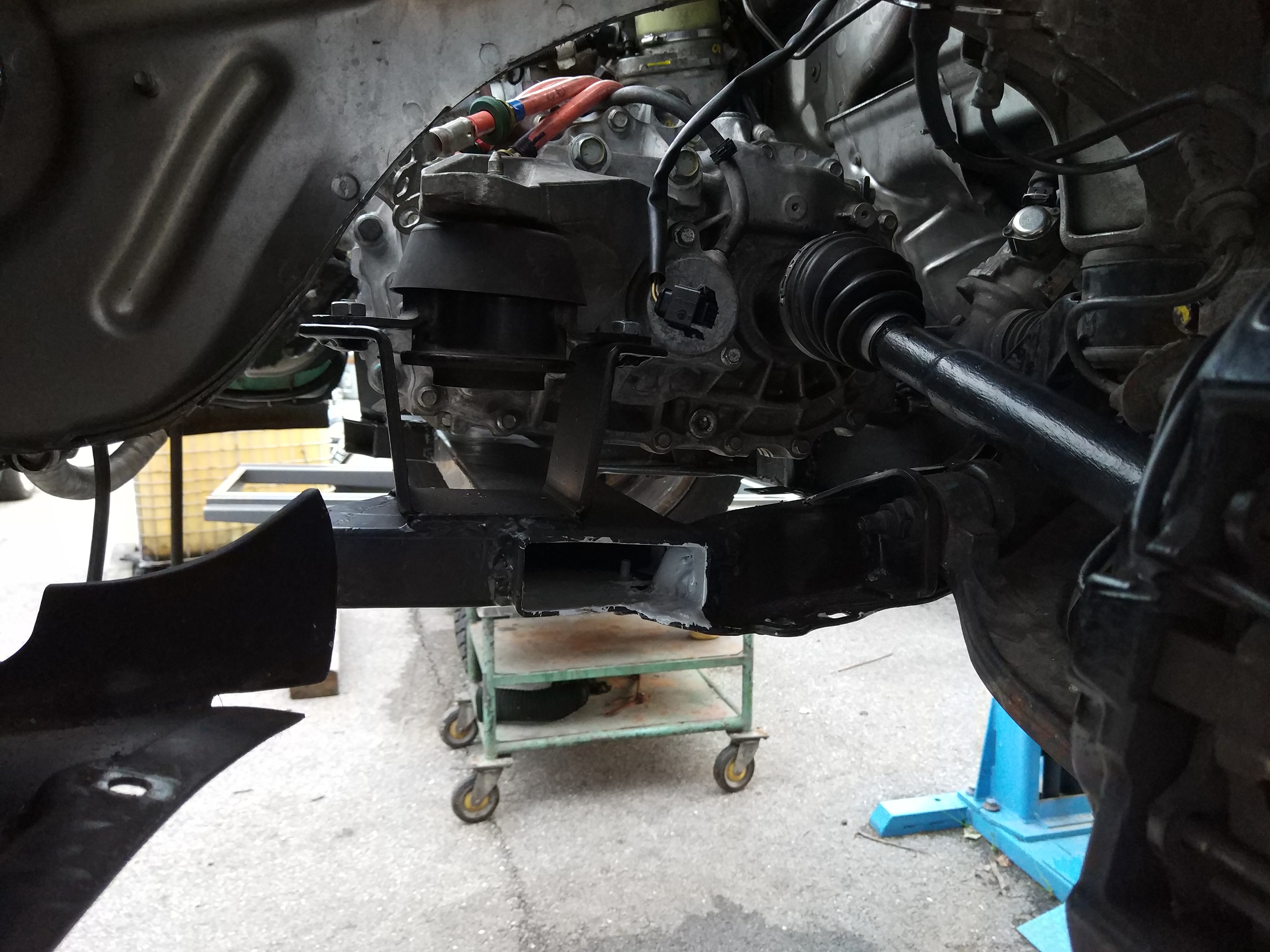

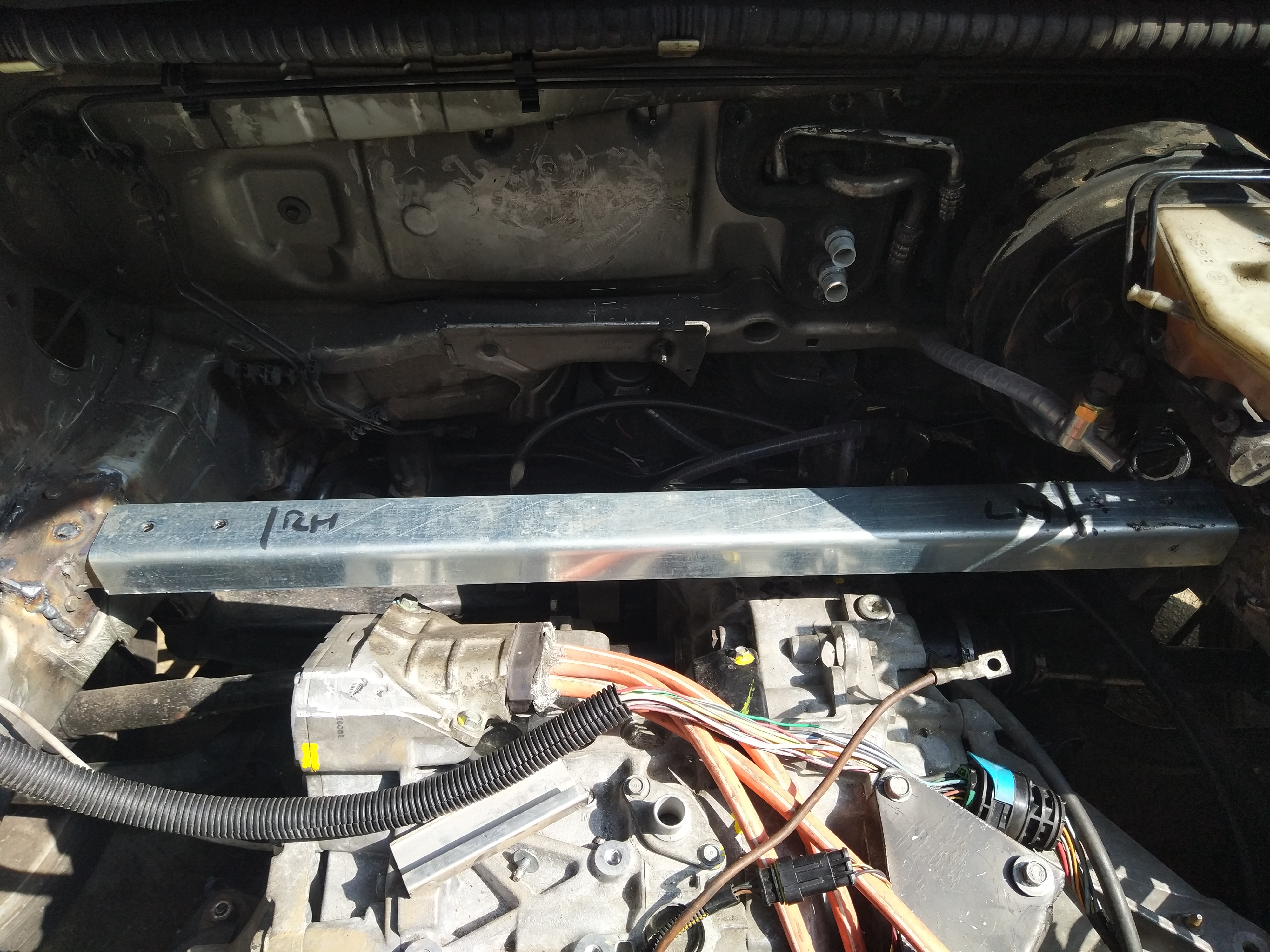

I finished the subframe mounts today. I painted it with epoxy paint and finished matte black.
The 3rd mount gave me some problems, but i solved it quickly.
https://leafdriveblog.wordpress.com/201 ... extension/

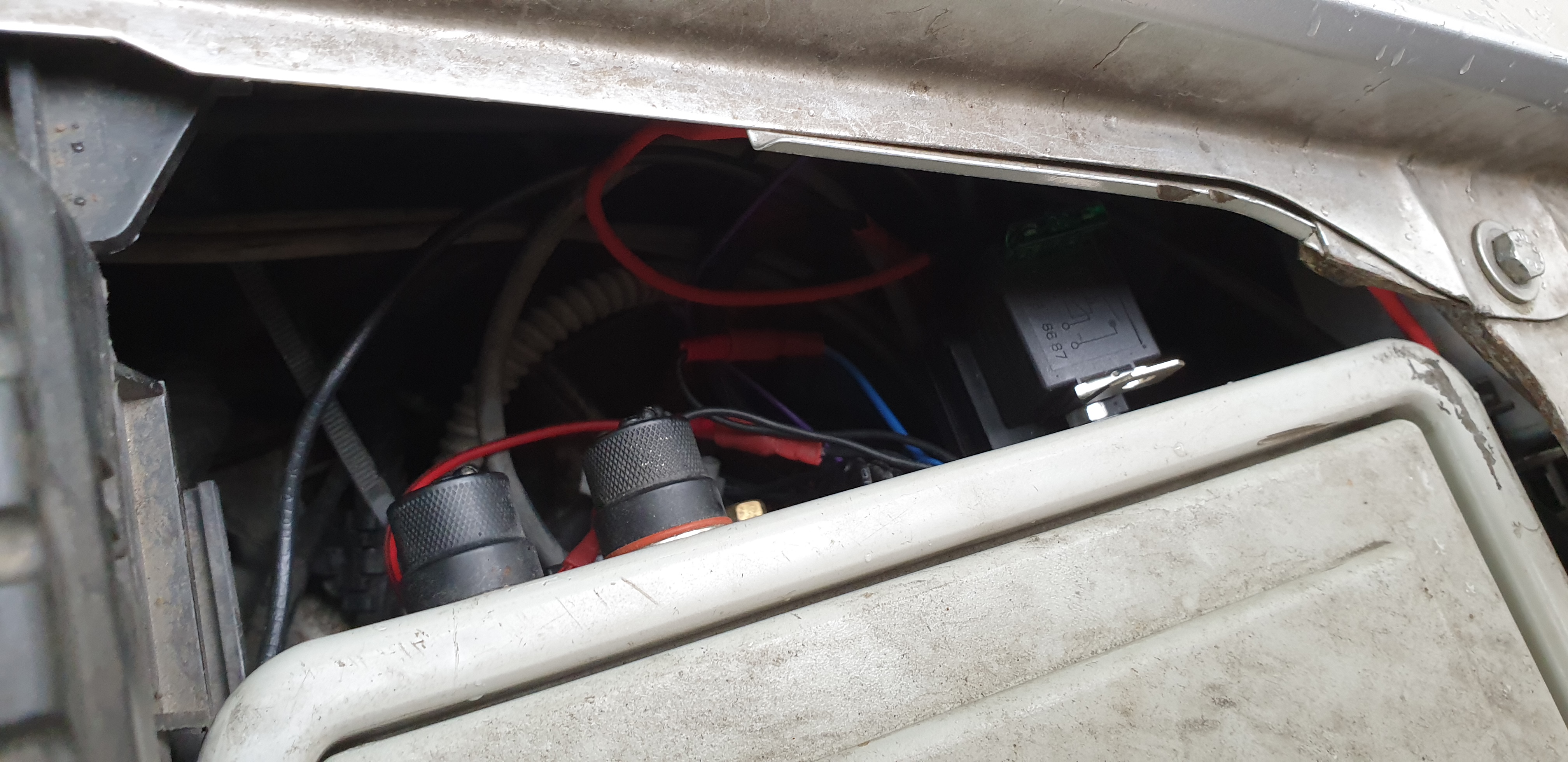

Also i did some research on Pug electric system. I quickly found the speedo sensor and RPM. I tried to get speed with my cordless drill and behold!

I did try to fit Astra G HPAS pump to the rear of engine compartment. I think it will work there. I need some flexible hydraulic hoses/pipes.

Subframe is in!
Only the trunk i will cut and weld a new box in. In front i will have to make some boxes to suspend cells.
What i am troubled with are the driveshafts, Now there is no more 200kg motor upfront car is sitting with its nose up and both shafts stick out of gearbox at quite an angle. Also you can feel the resistance if you want to turn the wheels. Maybe it will be better when i load a bunch of batteries in the hood. What do you think does it look to you odd that downward shaft angle?
I have to say it looks great. There is so much space in front now that i am thinking if i am carefull, i wont need to cut the rear seats at all. Only the trunk i will cut and weld a new box in. In front i will have to make some boxes to suspend cells.
The front suspension is unloaded? I would put the car down and load it similar weight as would be expected with batteries etc before going further with installation of the subframe.
In fact, would be best to make these ride height measurements before pulling the engine and transmission out.
The ride height can be adjusted with shorter/longer springs. Ideally you'd want the driveshaft angles to be close to original as possible. The driveshafts can tolerate some angle of course but straighter is better!
Hah! Shafts or gearbox was not a problem.
When i was trying to move a car back and forth i felt some strange resistance from gearbox through shafts.
After much fussing about i realized all three phase cables were lying on gearbox alu housing! They were in contact. And of course when i tried to move the car forward that would short the windings and create resistance. When i took cables apart everything moved smooth.
I agree i will have to load the front with batteries. Now it looks like a speedboat...

Ha, damn sync motors
Polo is also a bit light on the nose and starts misbehaving at higher speeds or when it's wet. I have artificially jacked up the back with harder springs and spacers but that just hides the symptom.
Yes you should load it down and I'll have to load down Touran as well.

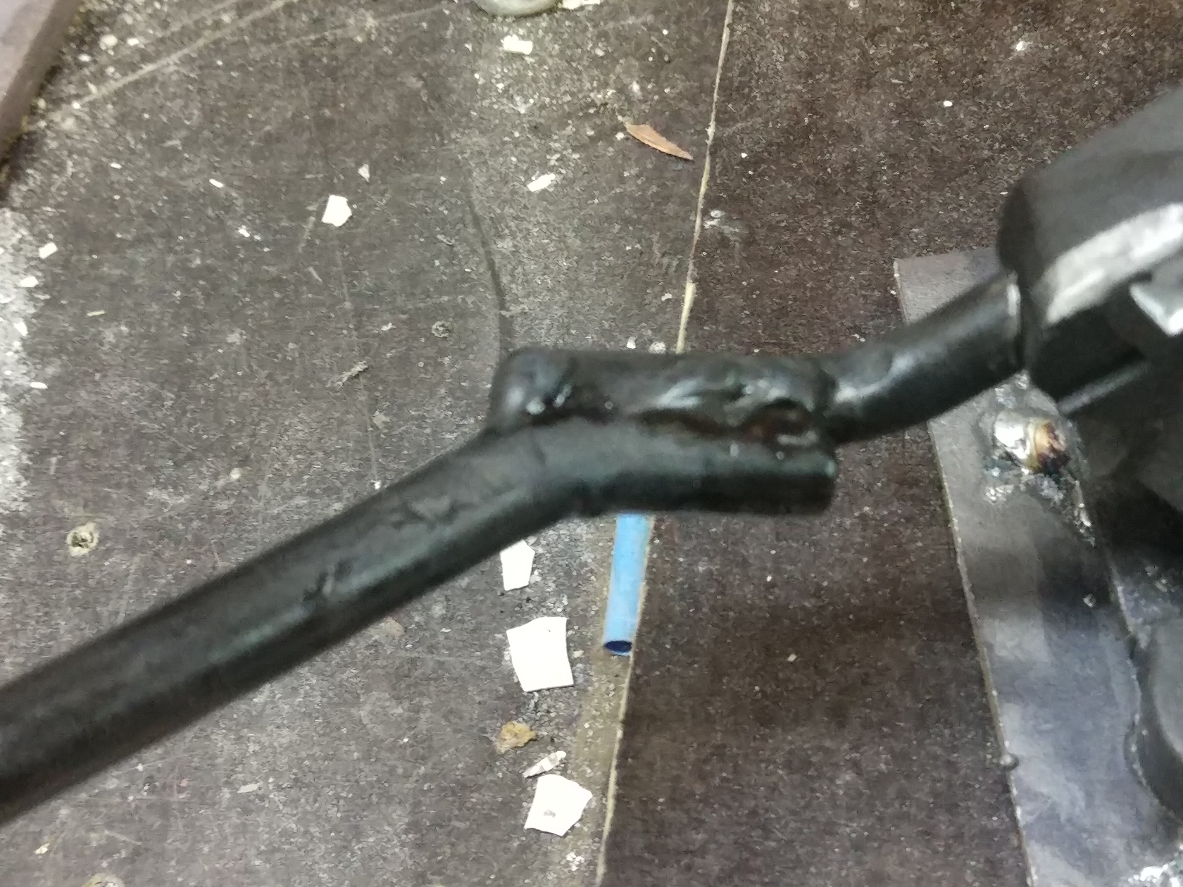

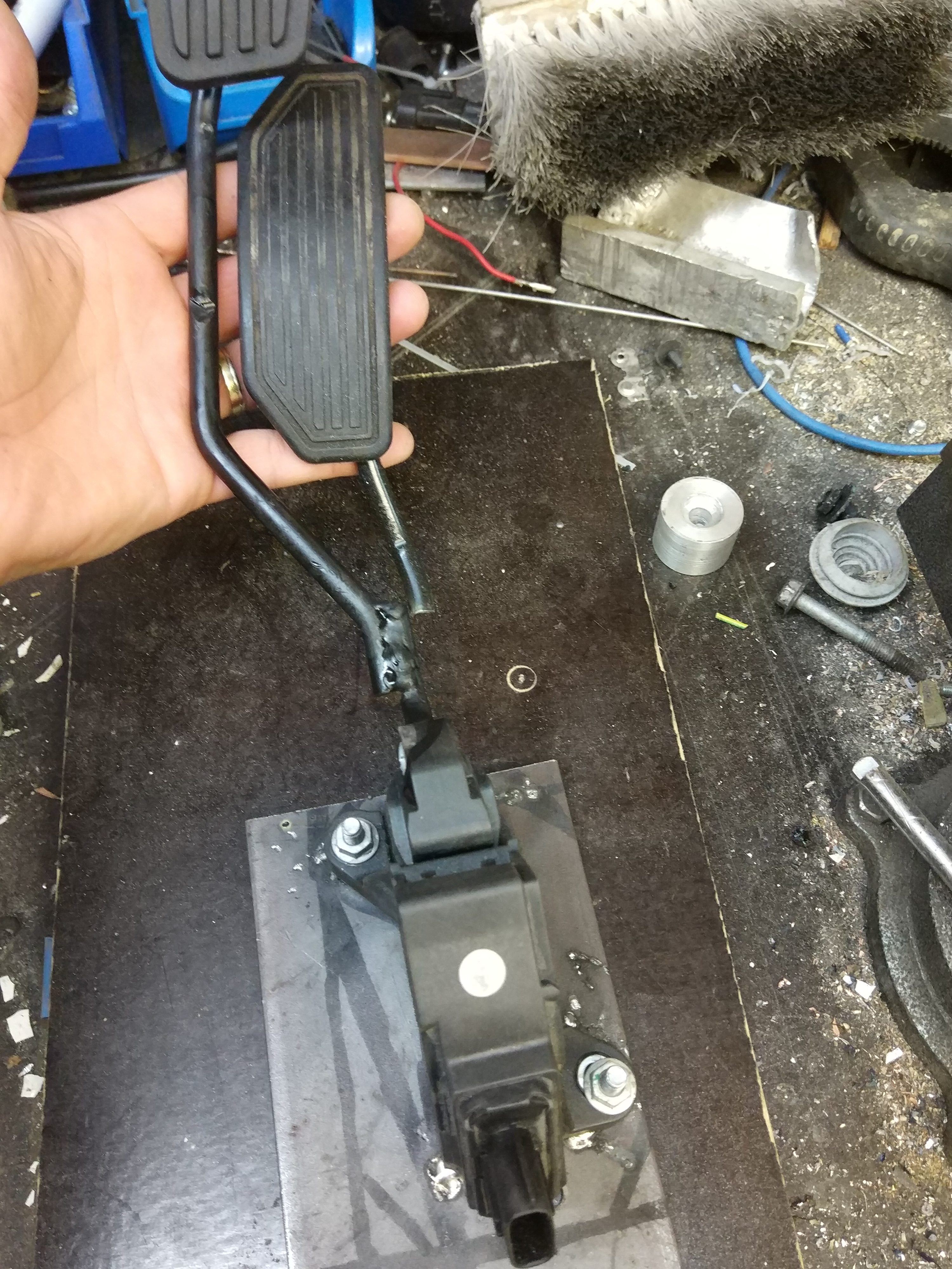

OK first obstacle detected!
I removed Pugs throttle pedal and tried how Prius pedal would fit in its place.
I like Prius throttle pedal very much. It is 2x hall sensors very easy to connect. Both sensors can output from 0.8V to 3.6V or 3.3V.
However now i see there are some pipes in the way in Pug. I see now why Peugeot would want to bend its pedal in some unnatural angle.
I will buy Auris pedal since it is made out of metal rod like Pugs and that will allow me to weld the Pug pedal rod to the Auris pedal.
Also i will have to make a flat holder interface for the pedal to be bolted onto.
EDIT: I got one Auris pedal and it uses totally the same connector than Prius. A perfect match for me.
I performed some operation and now i have a throttle that goes around the steering column.

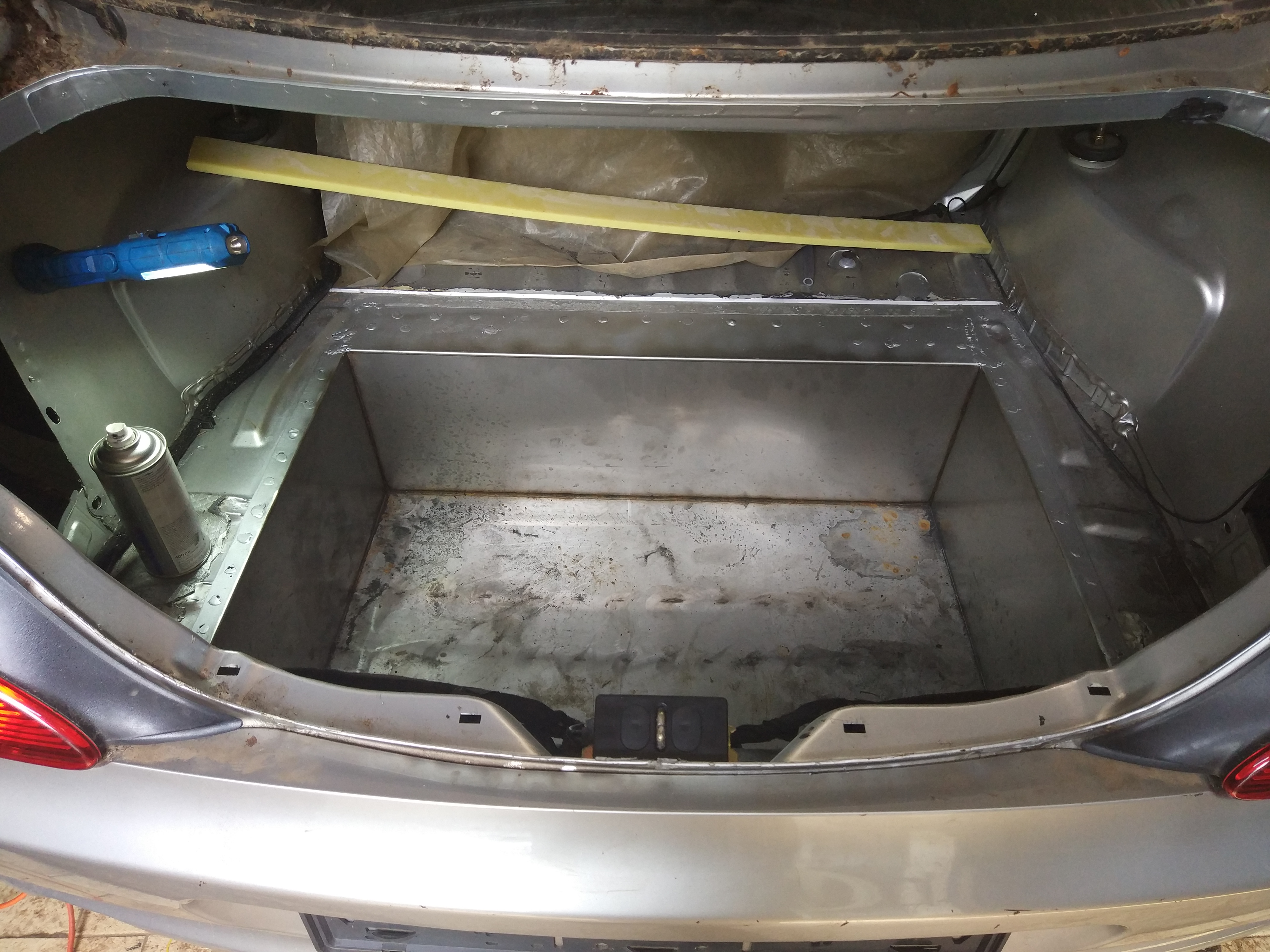

Some progress update.
Rear and front boxes are in. HPAS Pump is installed and hoses are connected.
Vacuum pump is fitted and hose is connected.
DCDC is now in and i choose 12V AGM 30Ah high drain battery to fit over the rear right wheel well.
Charger is installed under the central shaft.
I have to install inverter mount. I think i can fit it on the side. There is enough space to connect the phase cables and everything.
I need to install the control and CAN wires.
I have to decide how to connect the HV wiring.
I need to put a separate fuse/contactor box in front of the engine fuse box.
RPM indicator is till not responding. Also A/C clutch pin remains dead.
I managed to reduce DTIs down to a throttle position error and transmission computer error. BSM cand throw crankshaft error from time to time, but that is it. It seems ABS and airbags are working.

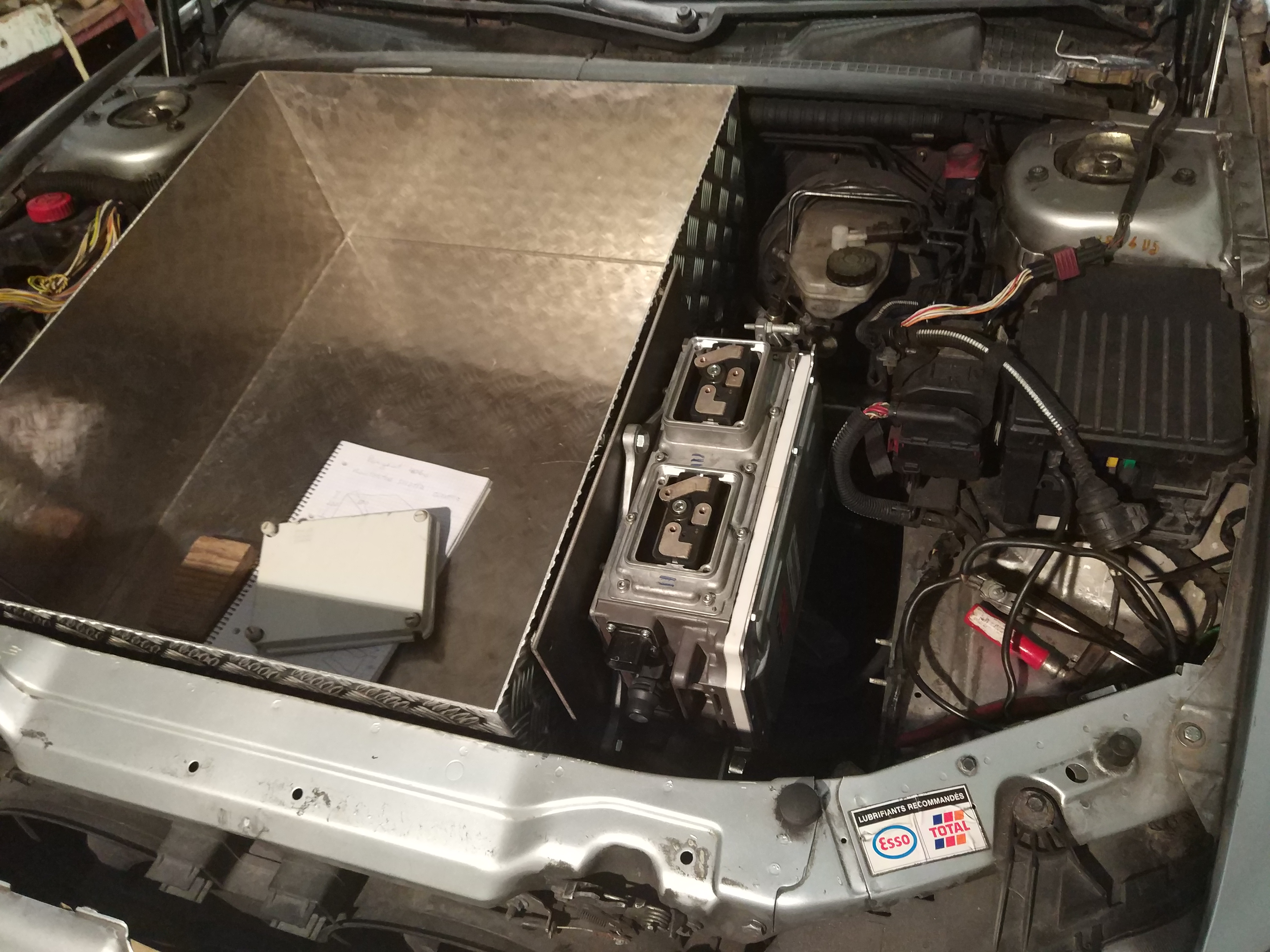

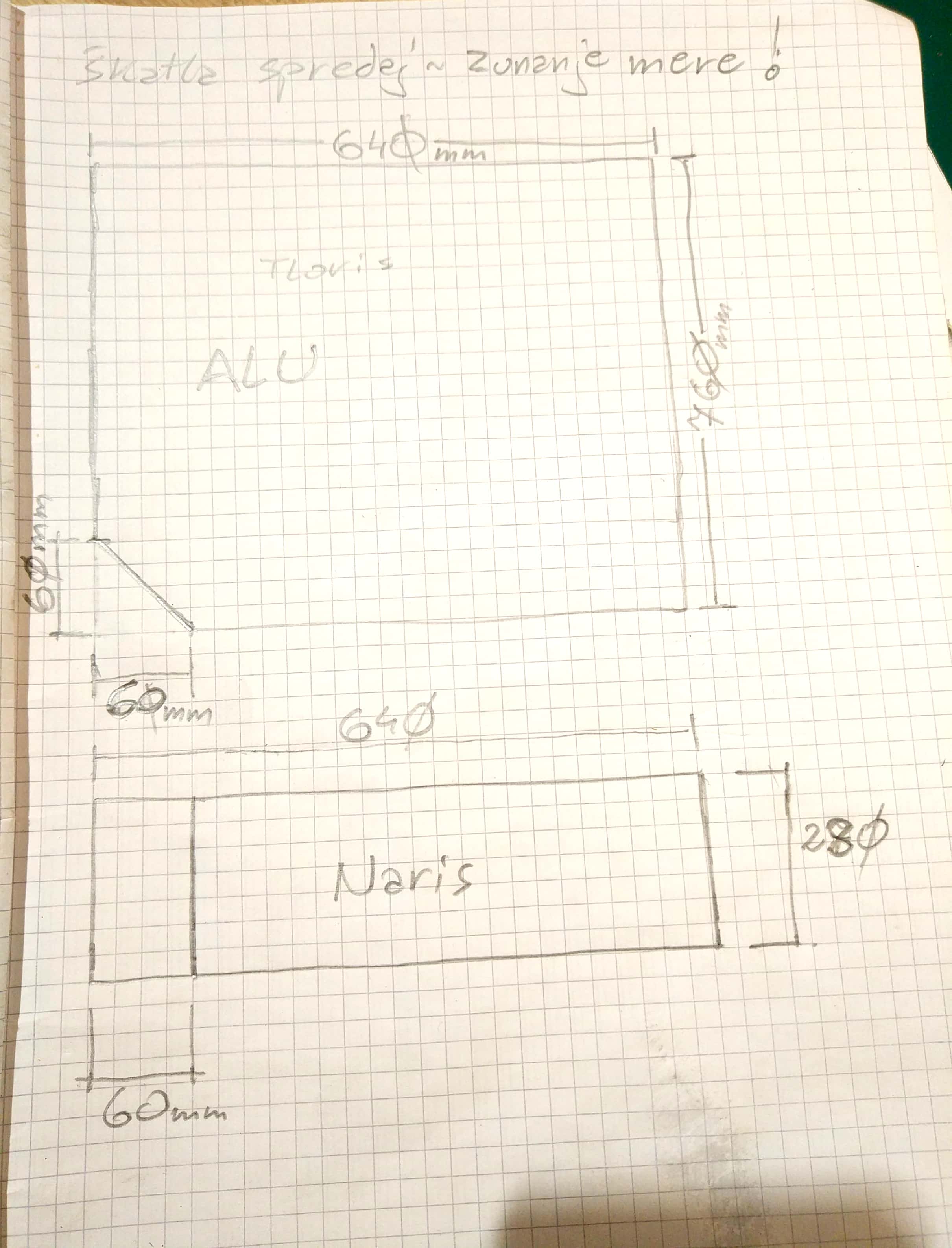

I measured space under the hood and made a model of front box cross section to give me a feel how high the box will sit under the hood.
But in the end i had to account for the front curves. I must be able to replace the light bulb and service the connectors there. So i decided to take an edge off from the right side of the box. Material will be 3mm aluminum. While i got the box made i designed the fittings and frame to install the box.
The simplest method was to simply weld an inverted U channel into motor space. I decided against that since it would restrict access to component dissassembly in case i should need to take something out. What i decided on is the angle fittings welded on to car frame with a bit of console on both sides.
Console will accept U channel frame fastened by M8 bolts and that will carry the weight of the front battery.
On to the U channel and under the box i will adapt a straight brace to carry the weight and keep the box in correct (slightly canted forward) position.
The box will be fastened to the brace by M6 bolts with countersunk heads so the box will have a smooth surface inside.
Also i decided to bolt inverter to the battery box side. This will give me more space for cable routing. The front fittings will carry another U channel, but box will lie on it directly. I welded that with my new MIG inverter welder with flux wire. I consider the process rather easy. The device is easy to setup. 0.8mm wire is elegant and good for most sheet metal. The only real problem is flux emits a lot of smoke that shields the arc. This remains on the weld as ash that has to be cleaned off after. Otherwise the welds are strong and good looking.
To fit the box onto carrying members i used countersunk 6mm bolts. They are now hidden and surface of the box is almost smooth. Good enough to place the batteries inside on a 3mm rubber matt.
In the end i painted the parts.
I found out i have like 4cm of space above the engine space, since the hood is curved upwards a bit. So i decided to designed a box in full height 28cm. That will allow me to install the Volt batteries standing. This will take less space up front.But in the end i had to account for the front curves. I must be able to replace the light bulb and service the connectors there. So i decided to take an edge off from the right side of the box. Material will be 3mm aluminum. While i got the box made i designed the fittings and frame to install the box.

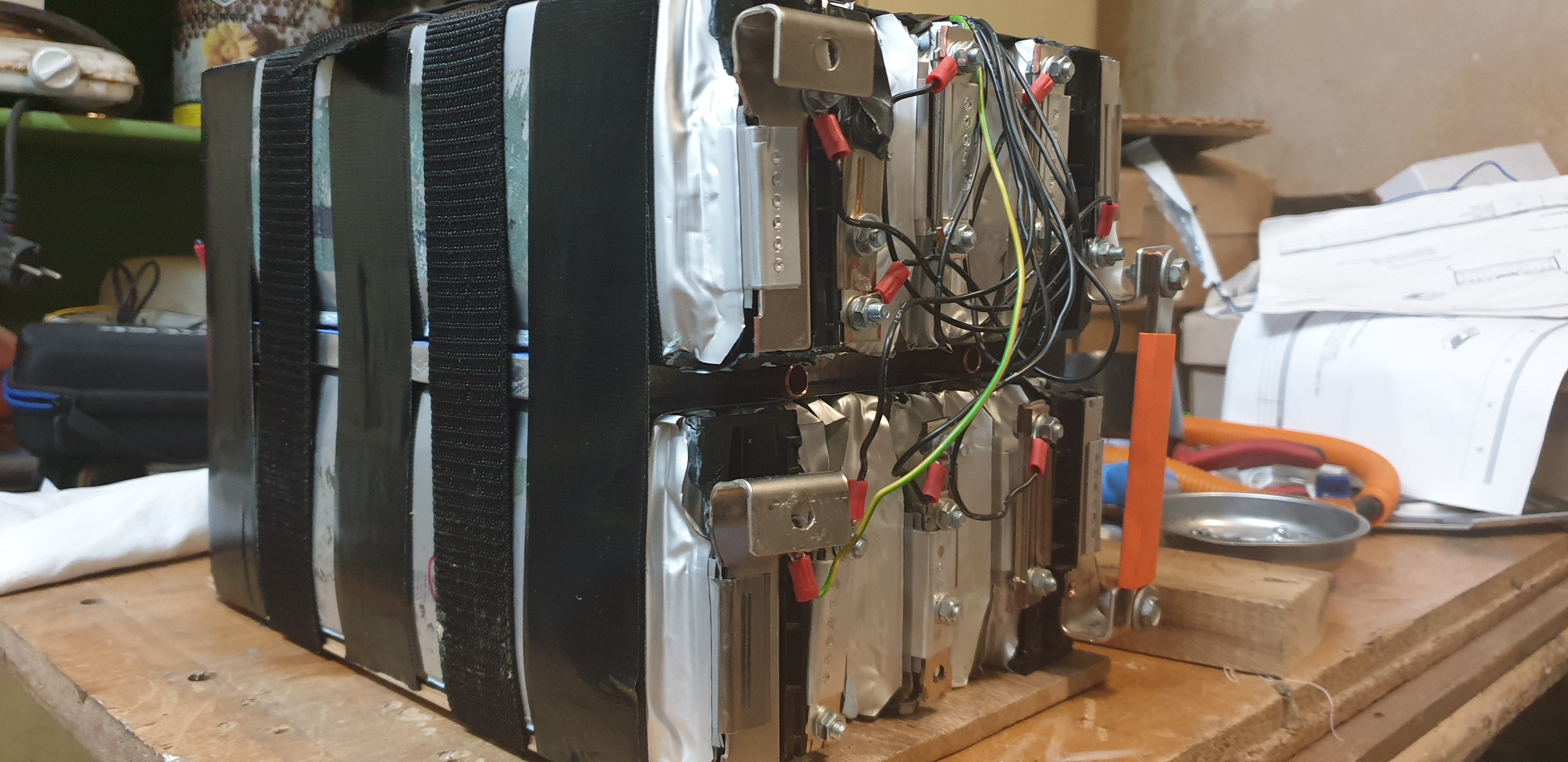

I am quite surprised how larger this car is from Mazda. I can actually fit 80 of 102 Kokam batteries in my Mazda just in Peugeot front box!
Volt cells however are a bit more clumsy. Maybe i could just split them into 48V packs and connect them in 2P while lying on the side.
And the rear box is also huge. I just hope DMV will not give me problems because it is so low under the car. I mean i installed it so the bottom is higher than suspension torque axis. So in theory i should be good.... well see.
I now think i will use my own design BMS. It is just analog comparator with some transistors and low voltage triger. You can have an opto and NO connection to signal turtle mode to inverter... minimalist, very Russian we say, which doesnt mean a bad thing, as it works in adverse conditions.
It works without my interference in my Mazda for some 4 years now. I bet there are spiders nesting there now and that is a good thing.

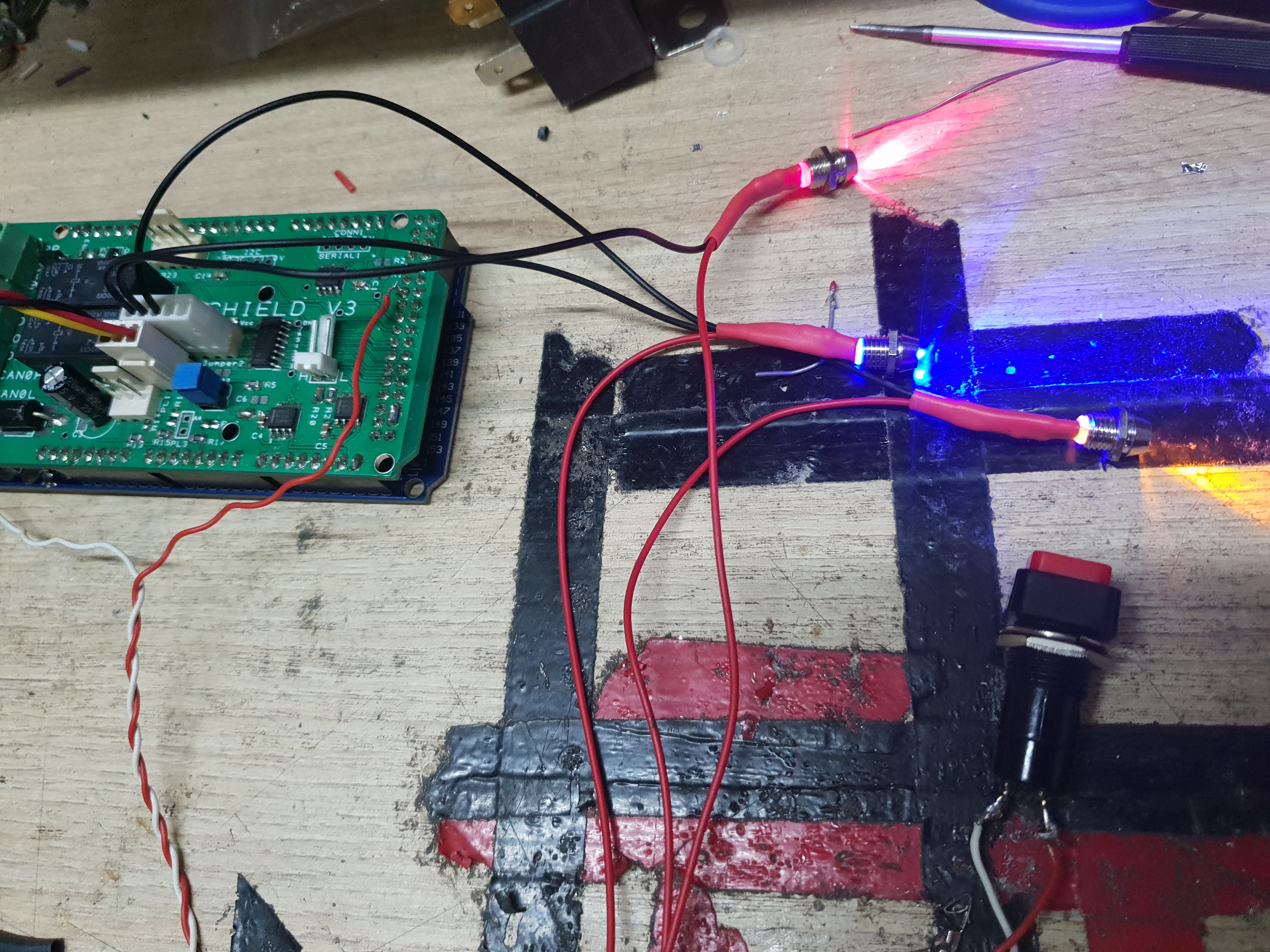

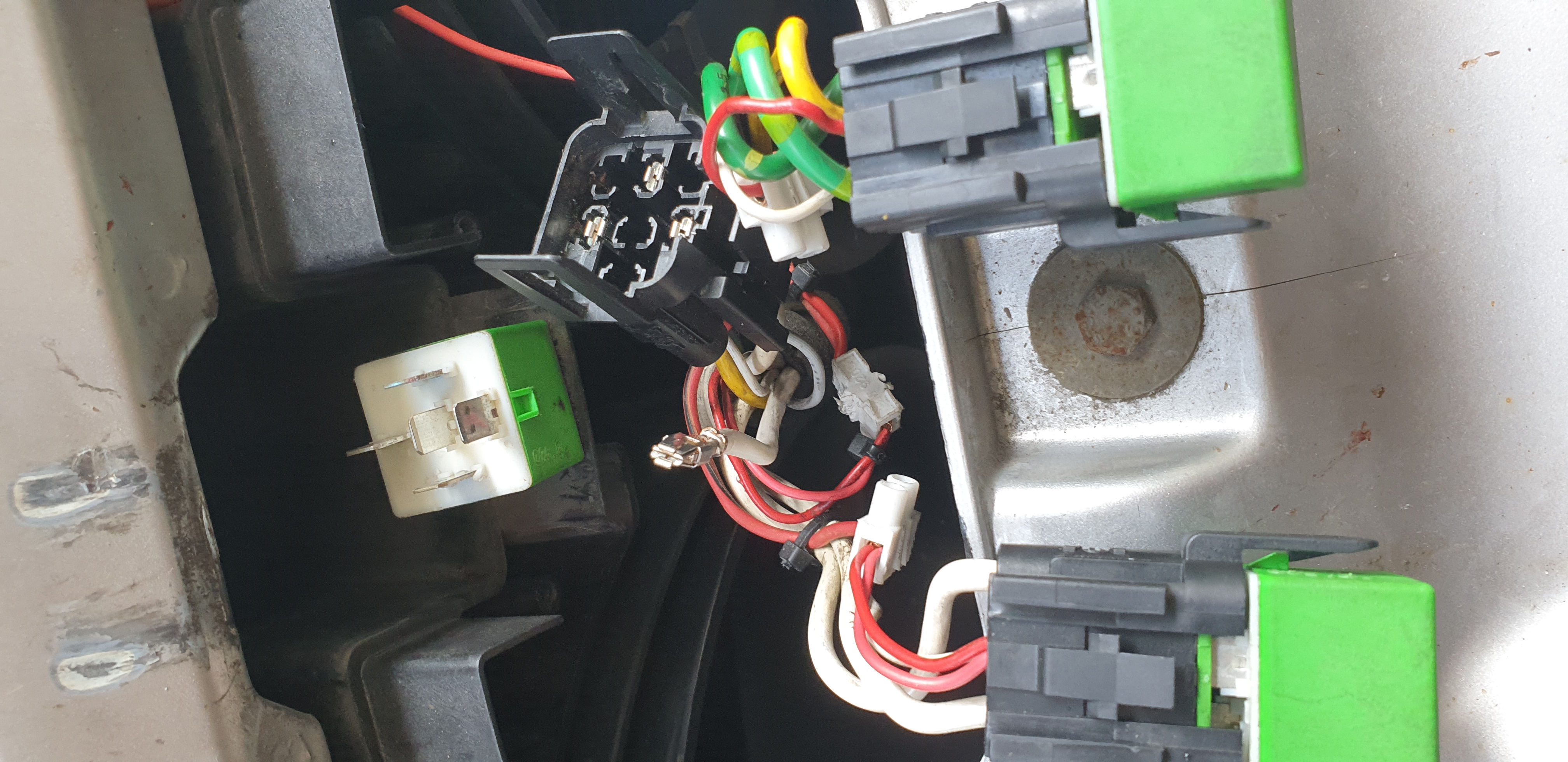

Last month i had an issue with ECU throwing an error "Engine coolant temperature too high", which is just one of many errors because engine is no longer there
. Oh well i thought and went through many temp sensors this car has. Surprisingly nothing worked! It was not a light error because red stop sign was shown on dash and start circuit wouldnt work. In the end i left it there and worked on vacuum and steering systems.
Recently i revisited it and verified every GND wire is still there. Then i used Arduino to simulate RPM to sensor wires...yes i cut those wires to lengthen them towards my contact box just about the same time error appeared DOH!
Well immediately after i connected one of the sensor wires to Arduino output a relay clicked and i guess interlockeed GND to ECU and error went away.
GRR.....
well now i know even RPM sensor is important.
And of course everything works, but i cant get the dial to move! I suspect i have to engage everyting in correct order as it was with original engine. And of course i only supply signal to one side of the wire. The other side is in the air. I will have to provide opposite signal to that one similar to original RPM inductive sensor. How to do that effectively?
1. I will try one transistor amplifier with transformer and two wires on the other end.
2. If former doesnt work i will try halfh bridge amplifier.

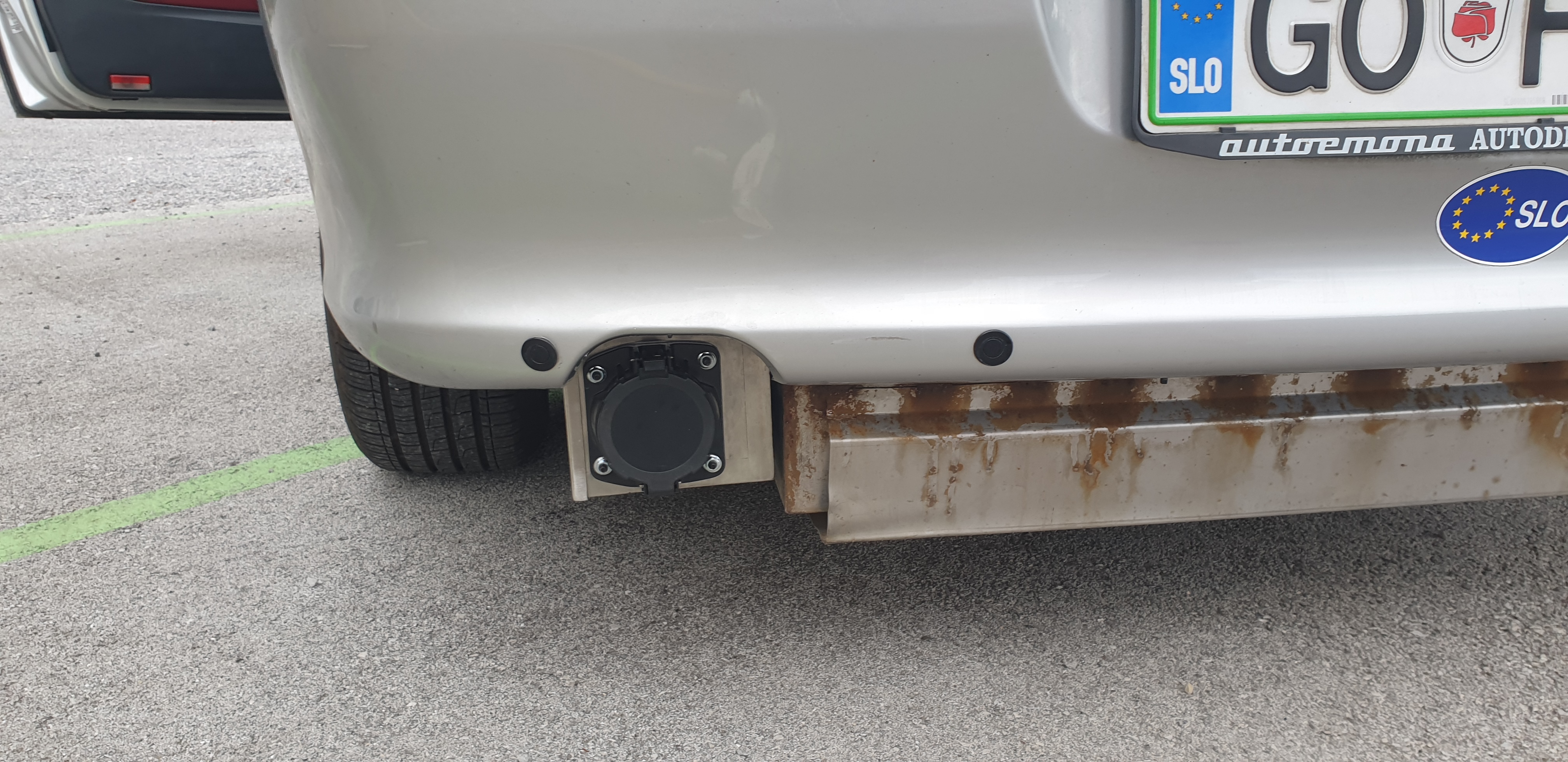

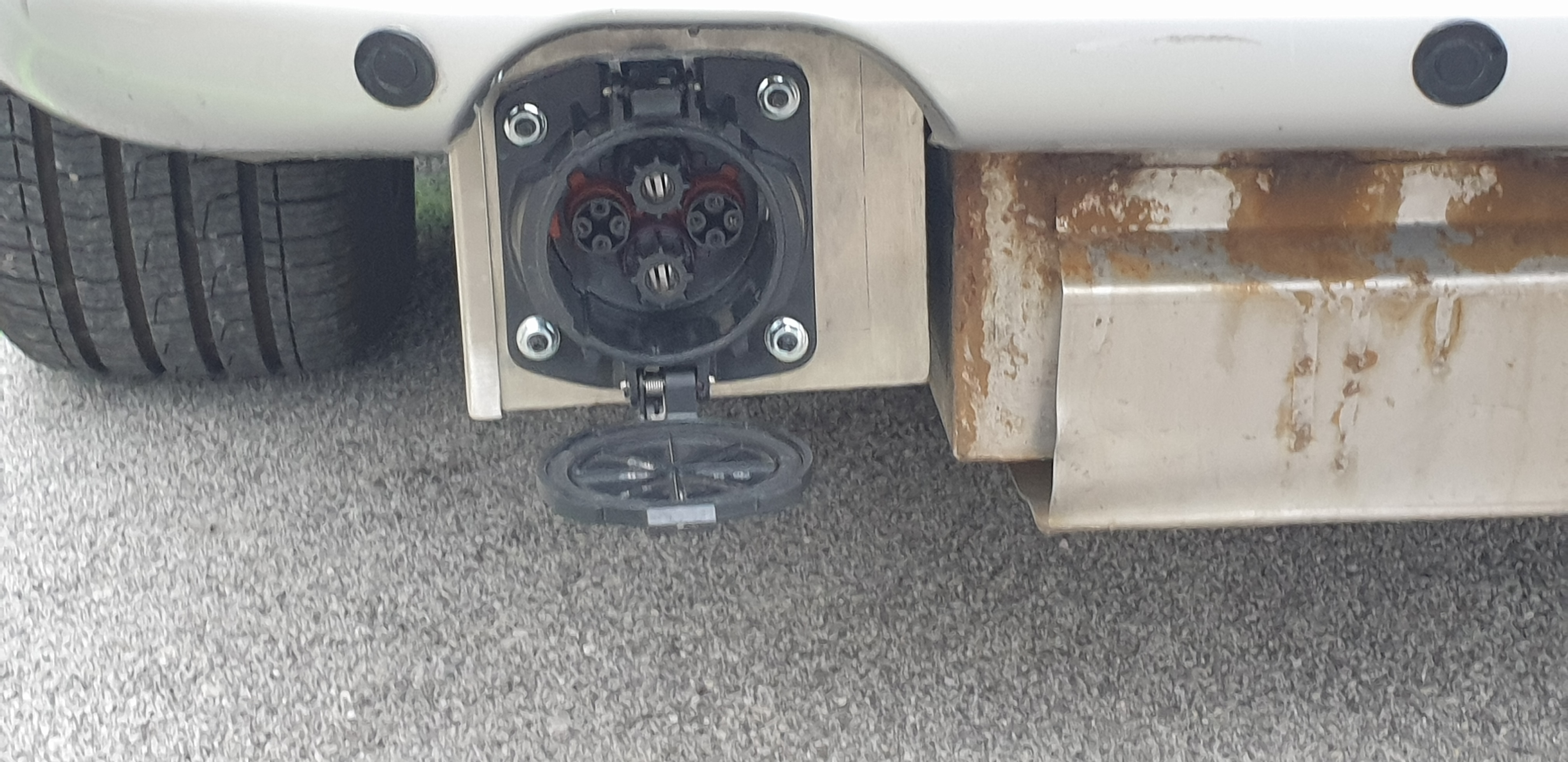

I made charger port and AC wiring to charger.
