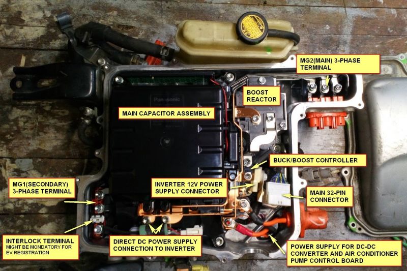

From what Konstantine posted of MIKMUR's drawings, MG2 current sensors are on V & W w/ IC250 = v, IC350 = W, if that helps.

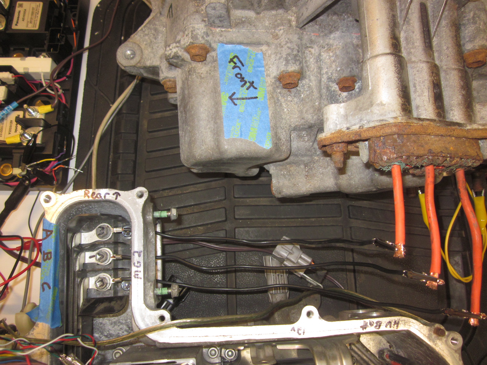

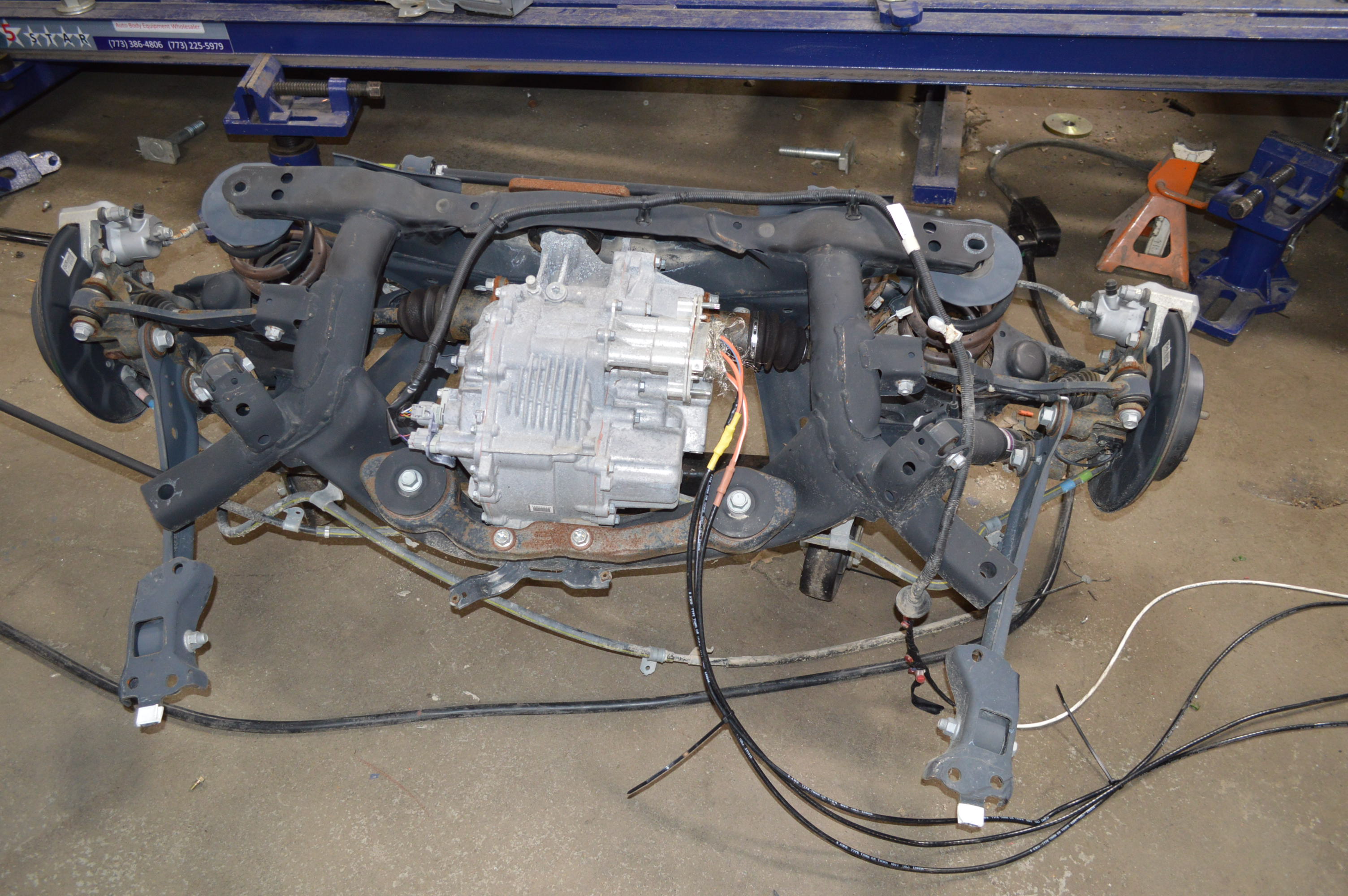

See attached photo for a Gen2 Prius inverter wiring to an MGR. Basically, the rear inverter phase goes to the forward motor phase and vice-versa.

Thanks Zookeeper, got my new adapter board and trying to test what you and imwoody have done thus far..with help from the forum top dogs, it's moving along 'nicely'... R&D
Trying to understand pinswap.
Basically, A, B,, C marked on your MG2 outputs = W, V, U phases in original Prius Inverter documents?
Current sensor Il1 is connected to V phase
Current sensor Il2 is connected to W phase
Adapter board setup requires U, V, W phase setup. And current monitoring on U and V.
So pinswap 5 makes the adapter board logic operate the W, V, U setup with current sensors on the first 2 phases?
I think that's what Johu was saying previously, but I am translating to my 'non electronics brain'..

I'm a patreon supporter too, and was hoping to get this up and running without needing J and D (too much), as they are very busy.
I'm back to basics, uploaded sine.bin file and will attempt manual mode in delta light bulb config.
How do you undo a pinswap command?
I entered the pinswap 5 after configuring the current sensors.
Removed pwm MVU and MWU from adapter board connector, but can't get pwm signal in manual mode.
Hence, connected back up (after changing pins according to new schema at the beginning) and would like to undo pinswap and confirm pwm in manual mode..
Im almost positive just selecting none or whatever pinswap you want in the drop down menu overwrites the pinswap 5 command
do you have a scope? are you missing PWM signal from the board? mine needed to be reflowed.
the priustoric boatcar guy
RetroZero
- Posts: 947
- Location: France
- Has thanked: 645 times
- Been thanked: 64 times
I don't have a scope.
About that drop down menu. What am I looking for? There's no pinswap menu for me.
Edit : that would be encode?
Edit : encmode?
I have SINGLE, AB, ABZ, SPI, Resolver, SinCos in drop down menu.
Edit : encmode?
oh, your using sine, not FOC. not relevant . what is your motor and are you using a resolver or an encoder for shaft position?
RetroZero
- Posts: 947
- Location: France
I'm using MG2 as motor. With standard encoder. I had it running in manual mode with 'old board', but cannot duplicate that since modifying the phase pins and uploading sine. bin file.
I am connecting 12volt supply to original Hv inverter inputs (not bypassing boost converter)
Have delta light bulb setup in place.
Have WARN pwmstuck fault permanently...
Have Derate Current limit fault when I press start, and main contacter opens and precharge closes
