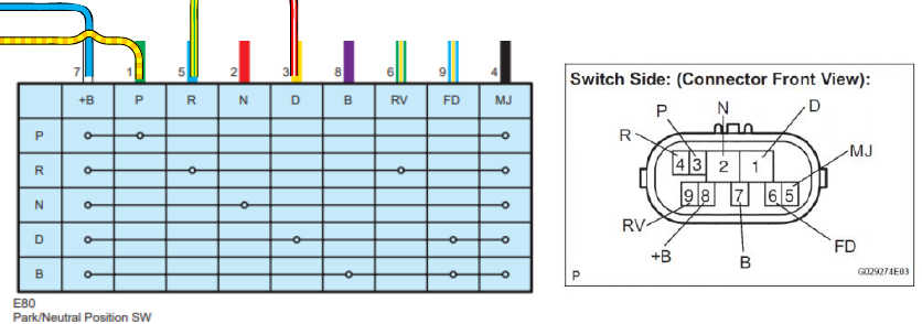

I was just banging my head to the wall few days ago "something wrong with my wiring or what", so good finding, perhaps all 5 pcs are wrong as I just quickly checked those four on the corner. No worries as these things happens sometimes. I highly appreciate for mailing correct ones, because local shop source shows empty stock for now.
One another thing, wiring overview v2.4 and another sources where same connector pinout pictures is, seems to have flaw. Gear mapping on the left is correct but connector pinout naming on the right seems to be incorrect.

Yep I can confirm that at least B and B+ are swapped in that graphic to the right of the connector. The chart to the left mapped correctly for my car and colors matched.
All 4 of the switches on mine are incorrect. I tried rewiring them to the correct pin out, but the incorrect PN has an internal current limit that is too low to actuate the solenoids in the transmission, so the correct replacement parts will be needed. You’ll be able to tell by listening to the solenoids oscillating.
My hacked up wiring diagram attached, for what it’s worth.

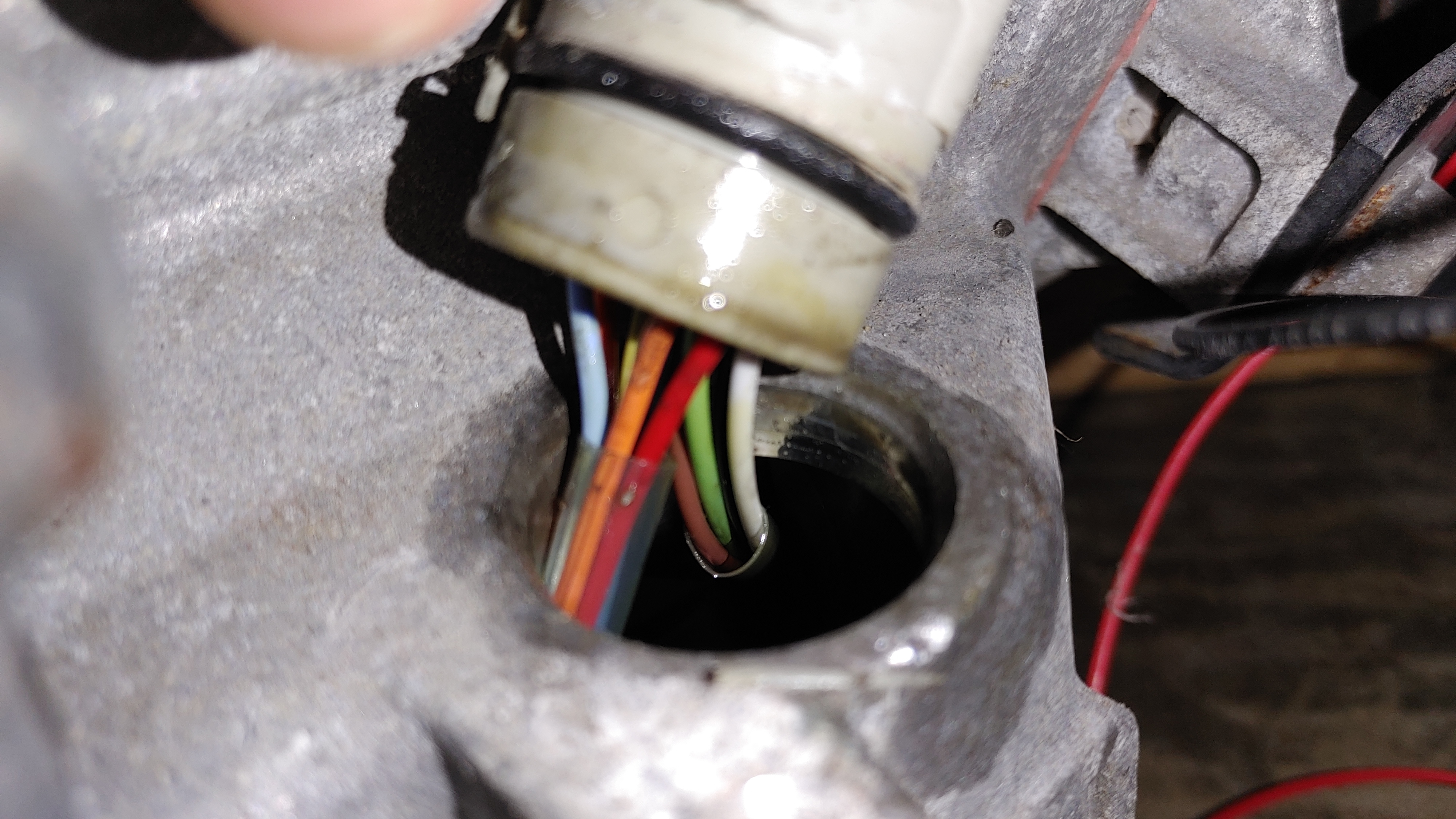

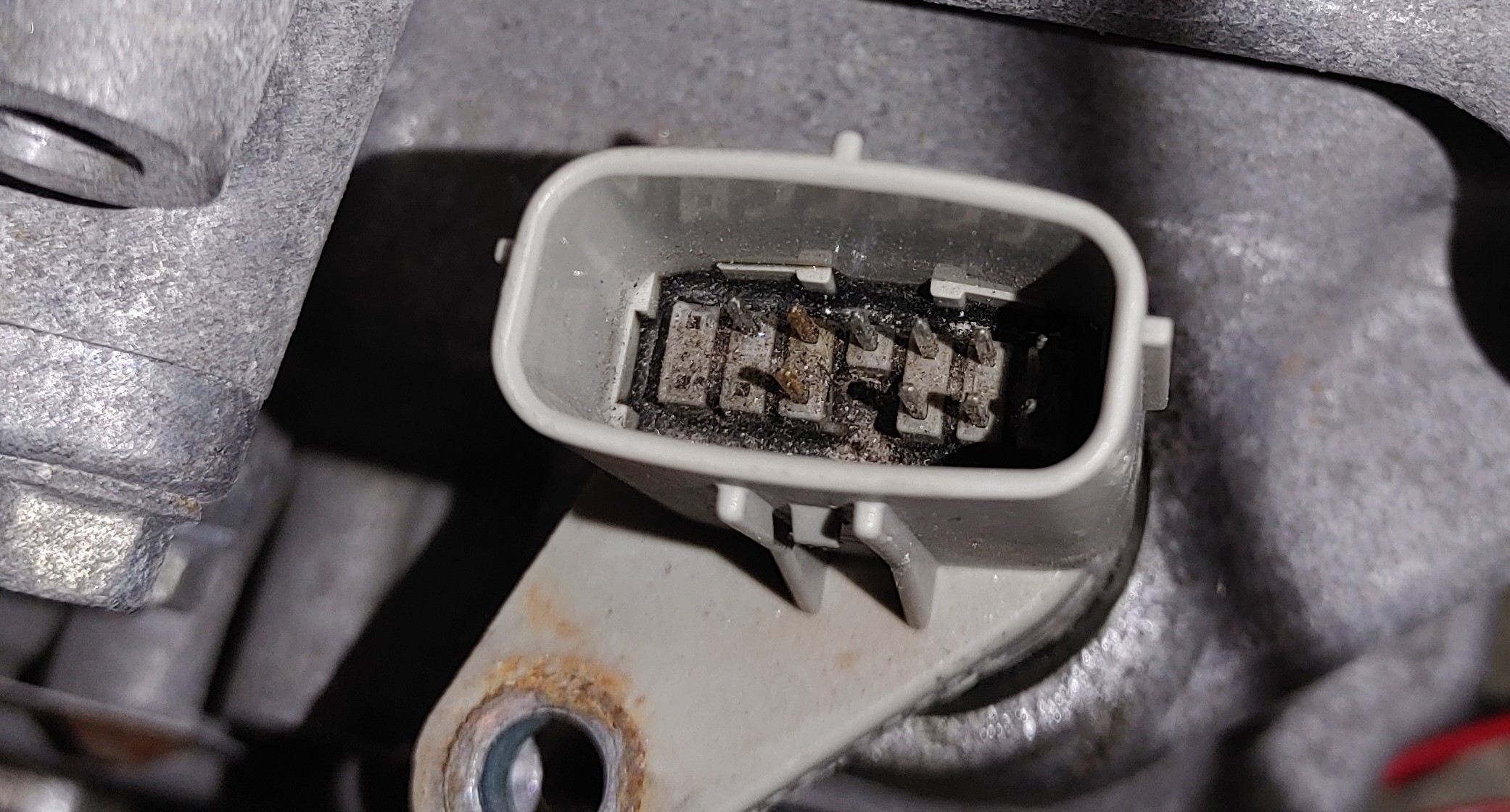

Sooo, came across this tonight and was ready to throw in the towel. Anyone know the best solution to this. I was going to clean things up and get ready to wire this out and looks like im missing SL2 + , SL1+ and SL1-. I gentle pried the connector up and there is almost zero play to get to the wires and I would need to figure which is which as it not in line with the pins. Anyone have suggestions?
What was I doing?
- Bassmobile
- Posts: 94
- Joined: Sat Apr 25, 2020 5:51 am
- Location: USA
- Has thanked: 7 times
Looks like there isn't much option here, other than to crack open the casting and rewire it up from the terminal block.
This is why I won't buy units from breakers online. Without seeing in person, there is no way to know what you are getting. Maybe you can return it? Some sellers offer limited time warranty.
It was 400 and a no return policy. Either im going to get really good at this and fix it or my project is now dead

Not sure where those wires go, but im might try splicing the wires first, then go then stupid route laterBassmobile wrote: ↑Sat Jun 19, 2021 4:03 amAnd there you go.

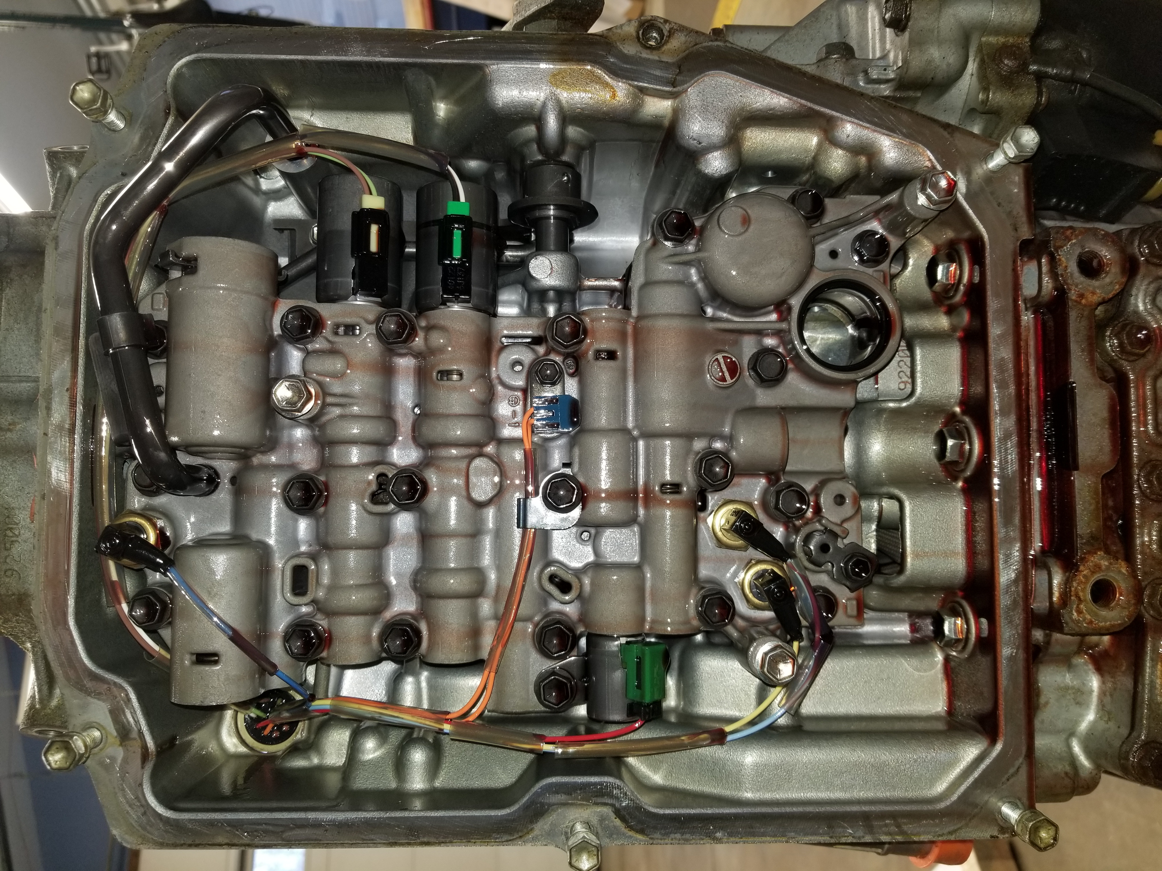

This picture might help, I’m assuming the solenoids are the two twins on the top. A needle into each of the four wires probing for continuity will tell you which solenoid pairs to which. Please report back what you learn (ie: which solenoid is which)!
I was building a truck so I was hopeing for more more torque and less rpm so I think I want low gear. Is that just the oil pan removed? If it is , this might be a time consuming but easy fix.Bryson wrote: ↑Sat Jun 19, 2021 4:25 am If you only need high gear, you don’t need those pins. High gear is fine for everything except burnouts in my experience.
What was I doing?
Bryson
- Posts: 179
- Location: California
- Been thanked: 4 times
It is the oil pan removed. You might be surprised by the amount of torque in high gear, honestly. It might be worth trying first

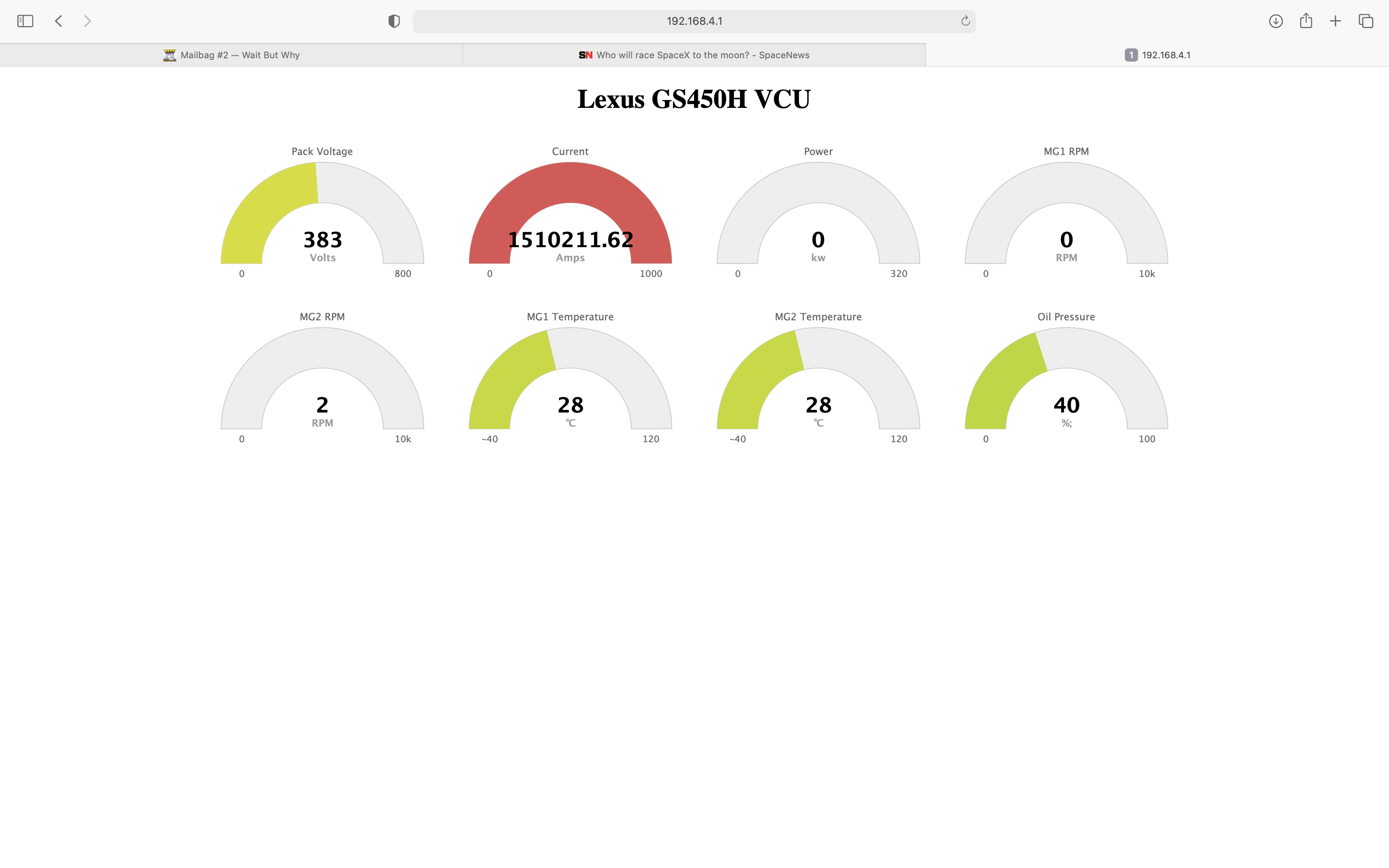

Well I guess there's one more thing. Anyone here with ISA shunt experience understand why I'm getting erroneous current values? I'm using the same code from Damien's v7 file but on can1 instead of can0. It oscillates between ~1.5-1.8 million amps positive and negative. Voltage shown in the WiFi menu is coming in correctly from the ISA shunt, and kW always comes in as 0:
