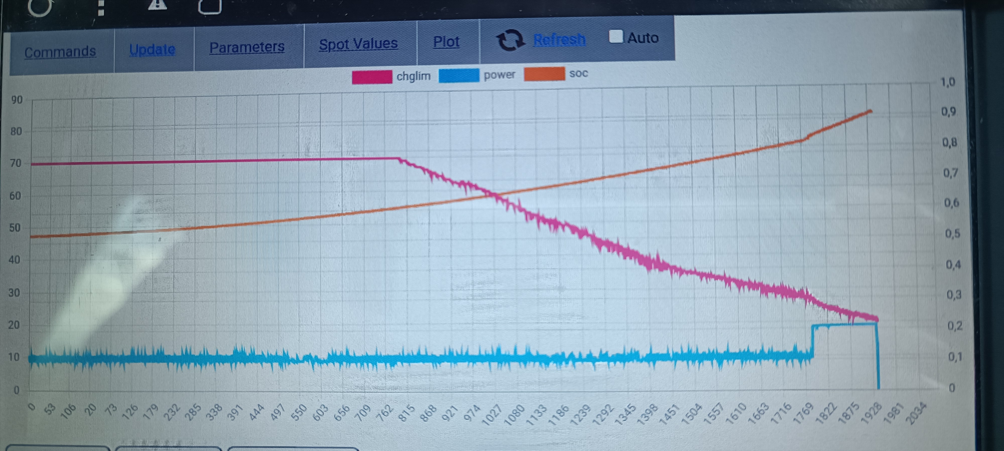

What is limiting the charge rate on the longer sessions over 70% SOC? Is the pack overheating?

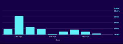

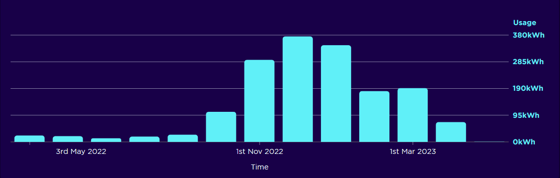

TBH thats impressively low even with the spike! With solar and a battery i rarely dip below 10kwh a day! When i'm charging its usually over 30.SciroccoEV wrote: ↑Mon May 01, 2023 9:09 pm You caused quite a spike in my consumption!

The 30 kWh Leaf for some reason has a nicer charging curve than the 40 kWh. It allows 70 kW till 45%, then 50 kW till about 60%, 30 kW at 70% and then it drops until it reaches like 12 kW at 90%. If you plug in at higher state of charge it is different and allows more power even at 90%. It seems they don't want to stress the battery with prolonged high charge current.Aragorn wrote: ↑Wed May 03, 2023 9:29 am What is limiting the charge rate on the longer sessions over 70% SOC? Is the pack overheating?

Was thinking just that! We charged for 3 hours or so - thanks for 7 kWh
Ah interesting, the so-called "rapid-gate" 40kw leaf. I guess your using the original LEAF 40 BMS so its following the same curves.

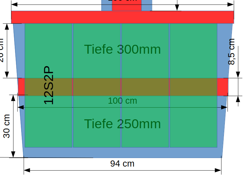

Just checked the dimensions of ID3 modules and it seems the 55 kWh pack would easily fit in the fuel tank space in 2 layers:

Very good! You have to be carefull though as the fuses inside those modules are rated to 750mA. I need to cut off the corners of one module now as i managed to burn some fuses there...johu wrote: ↑Tue May 16, 2023 7:53 am Just checked the dimensions of ID3 modules and it seems the 55 kWh pack would easily fit in the fuel tank space in 2 layers:
Will wait and see which offers come up in the coming 2 years.
I now have 8x ID3 12S modules and i intend to put them in Peugeot. My design showed i could easily install 6 modules in front battery box which would only leave 2 modules to put in the back.
The idea is to fit those modules onto a flat alu plate carrying structure. This way modules would be firmly mounted onto both sides of the plate which would leave me to install the plate into the front box onto its mounting points. Of course an engine hoist would be needed for that as the whole pack would weigh close to 200kg!
But the benifit of that configuration would be to easily cool the modules through the alu plate of the sandwich.
On the other hand 12S modules are becomming scarcer as Poles are selling them to Ukrainians en masse to use them for solar.

I'll stick to the Nissan battery until prices drop. How much did yours cost and what is a good place to get them?
You're saying the cell taps are fused with 750 mA? That's pretty good actually, just means extra care when playing around

I got them through a guy i know in Poland. I paid 550€ per module with the BMS cables. It seemed a really good deal at the time. Now the price has gone up and they are harder to get.
I am afraid they are now linked to the conflict just by way that they are reconfiguration free as they come. 6KW8 12S module can be used for solar directly and wire additional modules in parallel.

Today I tested some charging, I have different soc limits for AC and DC charging now. DC charging I usually don't want to limit in case I'm doing something while charging but AC charging should be limited to 80% or so. Before I always needed to remember to raise that limit.
I used rich mans charger for the heck of it and it charged nicely at 10 kW (well, the power is not really steady...)
Decided to record the charge power limit (cell temp was 20°C and rose to 25°C). 70 kW till 50% then hitting 50 kW at 60%

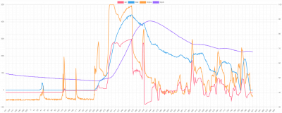

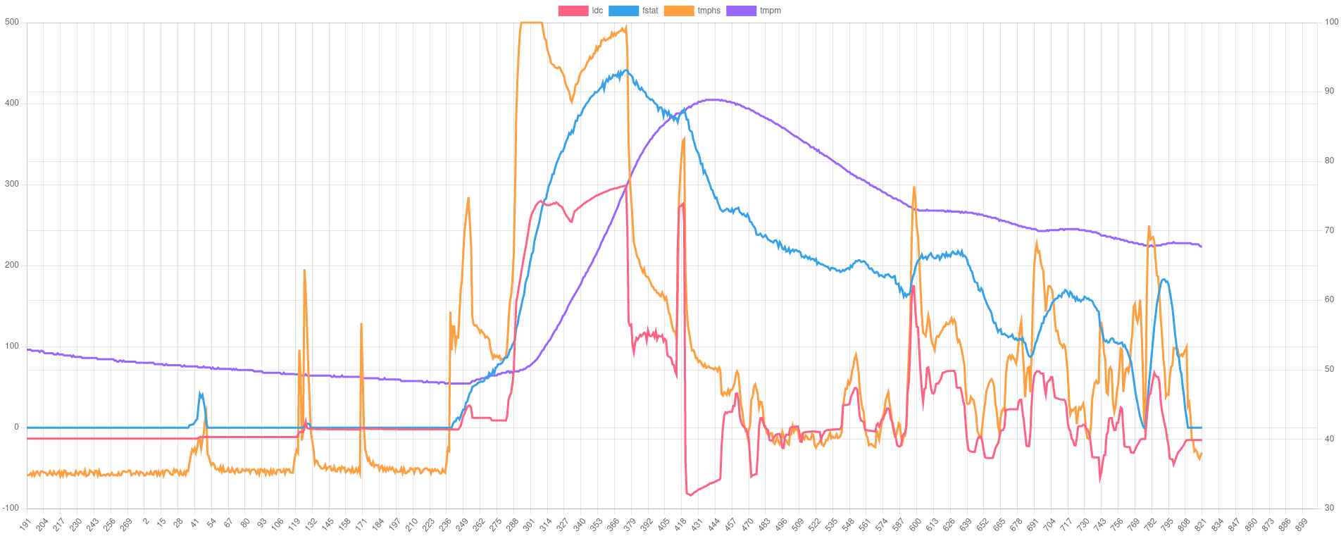

Did a top speed test yesterday, here's the result
If you know which gear I was in and what ratio that is you can spoiler yourself, otherwise wait for the video
What I concluded is that top speed is quite high in comparison to other production cars but it can't be sustained very long, as motor temperature suggests. That's probably down to my tightass cooling system.

What do you think is a reasonable maximum temperature for the motor?
In the Previa, I have have the battery and motor/inverter coolant loops running in parallel through the big original radiator. The problem then becomes in high speed summer driving (e.g. 120km/h uphill at >25°C) that the motor starts heating up the battery. The motor stays quite happy, but fast charging becomes impossible. Of course in Finland this never happens for long enough periods to matter, I only know because I drove that fast towards the alps from Germany 10 days ago or so.
- Posts: 6769
- Has thanked: 383 times
- Been thanked: 1589 times
I'm not even sure the reading is correct, after the experiment the metal was maybe 40°C while the gauge still said 65°C or something. Of course the sensor is in the windings but by then the temperature should have travelled to the outside.
Anyway, high temperature industrial motors are specified for 170°C. So still some headroom. Regardless the absolute value I was more worried about the rate of change.

HAH! Road rage indeed. Really informed test.
Myself i managed to test Mazda to 180km/h using measly 28kW motor and transmission. But only for 30s or so then motor temperature rose to 150deg!!! Motor was ACIM air cooled
The Pug was also tested to 180km/h. Be warned i have OEM gearbox and at that speed motor RPM was over 12000RPM!
However i had the car opened at 140kW and Leaf motor was game for more speed no overtemperature detected. I stopped out of sanity.
- celeron55
- Posts: 804
- Has thanked: 38 times
- Been thanked: 136 times
The Leaf motor is a permanent magnet motor though. I don't think the magnets can handle 170°C.
