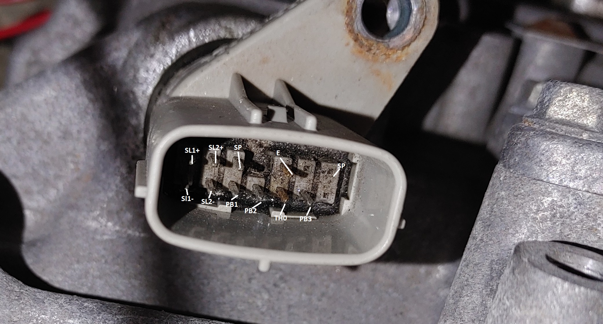

Gigas wrote: Sat Jun 19, 2021 3:44 am Sooo, came across this tonight and was ready to throw in the towel. Anyone know the best solution to this. I was going to clean things up and get ready to wire this out and looks like im missing SL2 + , SL1+ and SL1-. I gentle pried the connector up and there is almost zero play to get to the wires and I would need to figure which is which as it not in line with the pins. Anyone have suggestions?
I had the exact same problem. It's an easy fix, just pull the pan, then the filter, and it's all right there. Supposedly I just bought the only one of those connectors in the states, about $45. The Ebay yard I bought the trans from even reimbursed me.

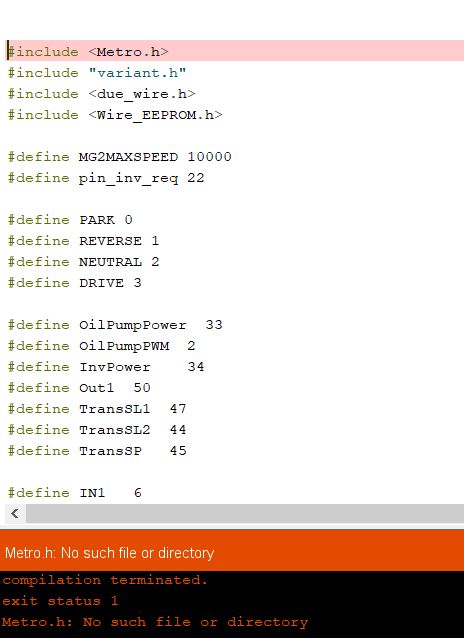

I'm sure i'm doing something wrong here but why do I get this everytime I try and upload the firmware?

Looks like you need to install the Metro library.

Well, it's been so long since i've done programming I forgot about all the libraries. :P brain fart day. I added all the libraries and it fixed it

I started hooking individual wires from the vcu to this connector today, and realized that the new part I just installed has the same pins missing :roll: Someone may correct me if I'm wrong, but I think you are looking at the connector wrong(the diagram shows the wiring side), and the missing pins don't actually have anything that's supposed to go to them.
I did get the part number for the connector going into the trans case: 82125-50100

You may be right - I think the blank SP pin is what threw me. If your right(Which I think you are) it should be this at the transmission
If someone can confirm this then we are both good! I may order the new connector anyway as mine is in pretty rough shape.

Correct, there is nothing on those three pins. I have an original harness and those are plugs on the wire side of the harness (and missing in the plug itself).

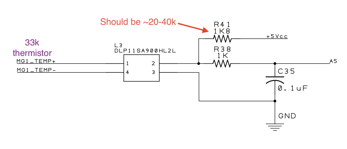

So I've been digging into the stator temp situation - it looks like the voltage divider resistance is an order of magnitude too weak to deal with the thermistors in the transmission. They appear to be 33k ohm NTC thermistors, which means we'd want 20-40k resistors on the board to divide 5V down into a readable range for the input signal. The board has 1k8 resistors which are railing the input high. Next up is to order some suitable replacements and test from there.
It is so helpful to have schematics available! Open source rocks.
edit: it could also be a 47k thermistor. I've got to let the car settle for a few hours to see what it converges on - it was 20C outside when I measured 33kohm about an hour after driving the car
edit2: looks like I'm late to the party and this was discussed earlier in the thread, they're 47k thermistors. With a 1k8 resistor divider you get more fidelity in higher temp ranges, but the ADC can't measure anything under ~100 degrees C

That's my fault, I originally specced those for another purpose and just copy/pasted them into place, I didn't know the value of the thermistors in the transmission at the time. This was two years ago, and I still haven't looked into the thermistors, thanks for the update!
