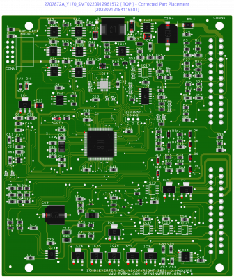

Is there an exact reference for R14? There’s a bewildering array of 1K R0805 resistors listed on Mouser.

any 1k 0.1% 0805 will do.

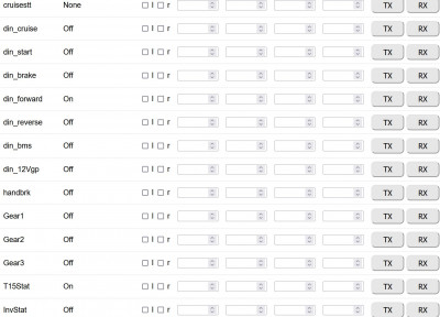

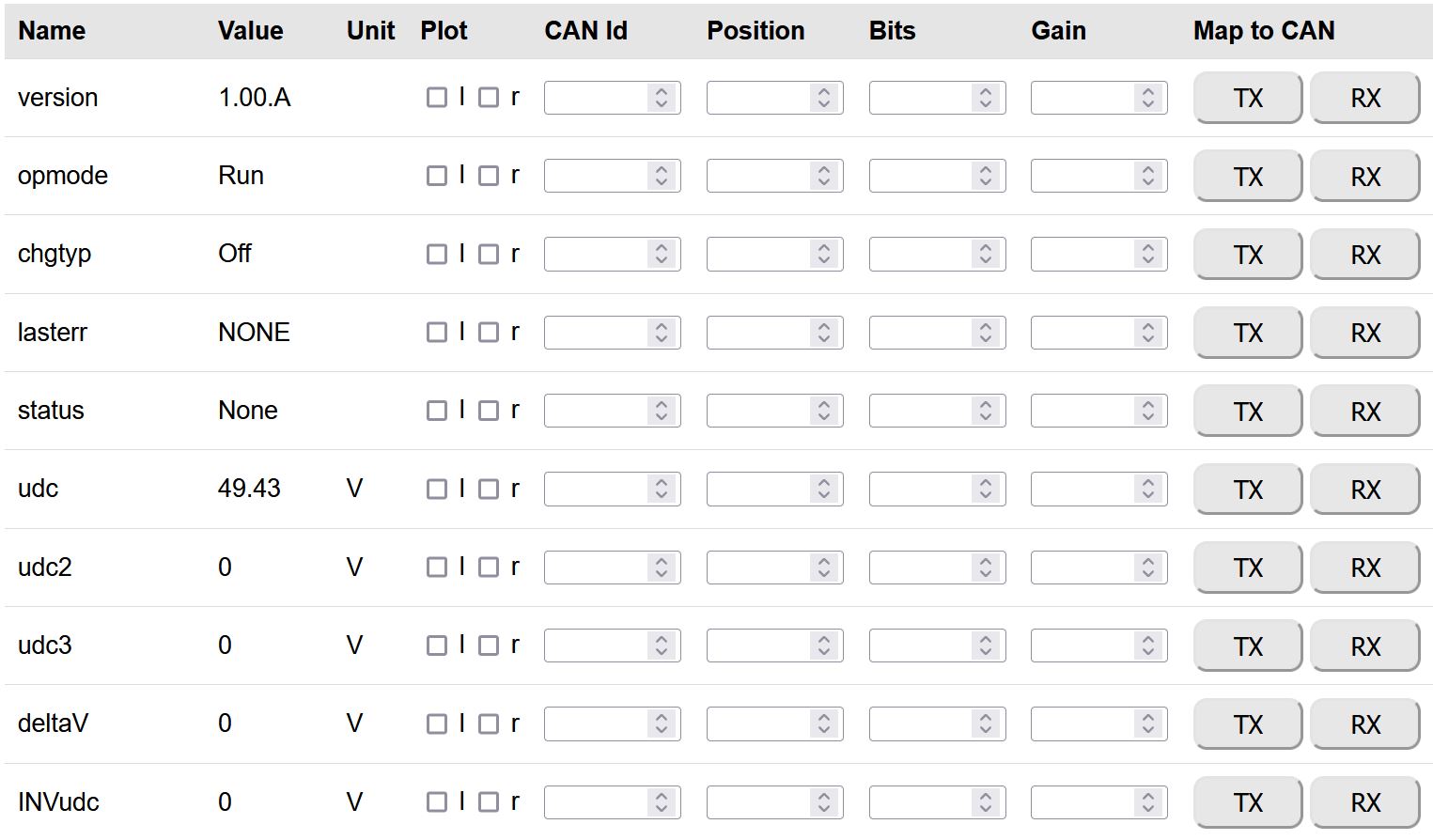

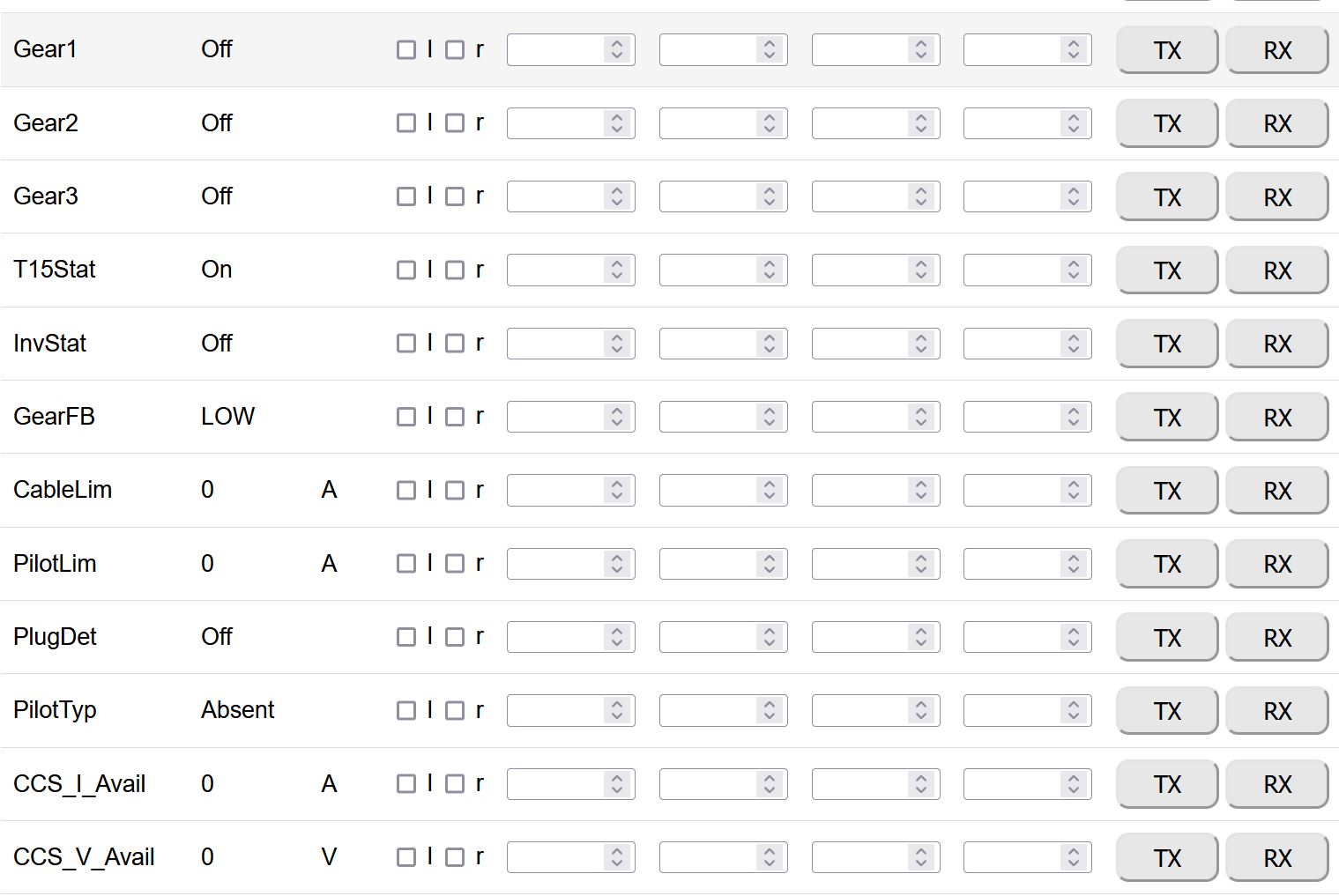

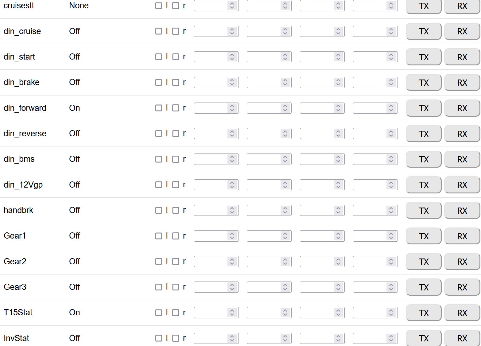

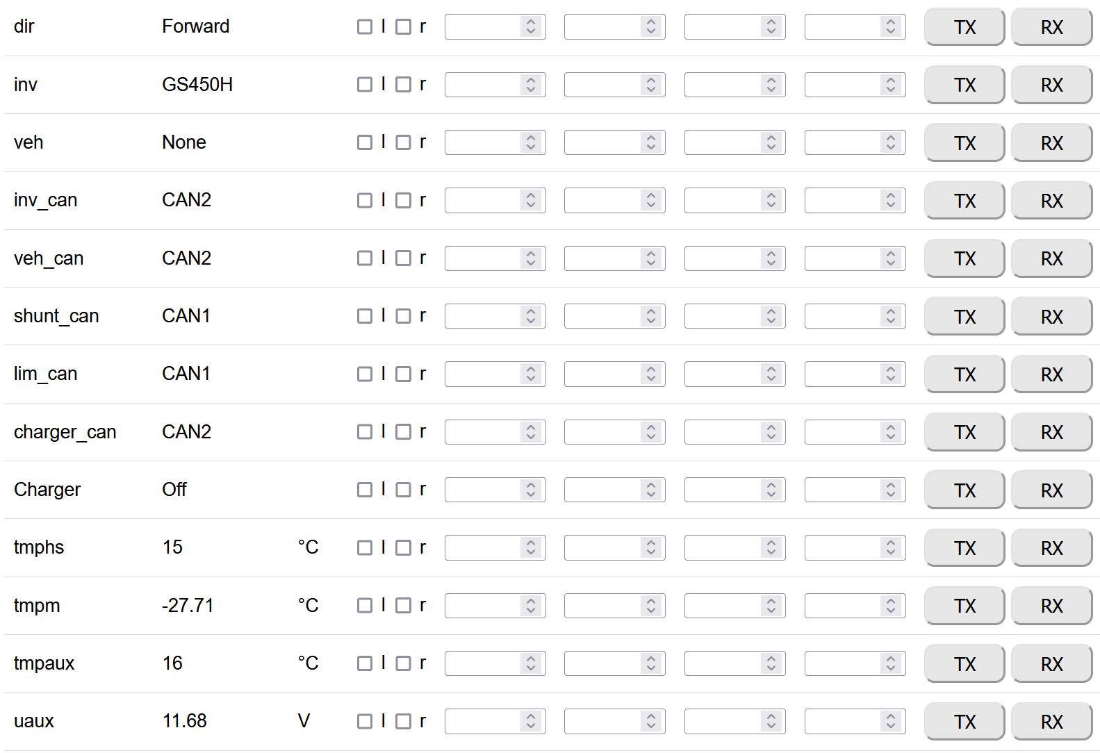

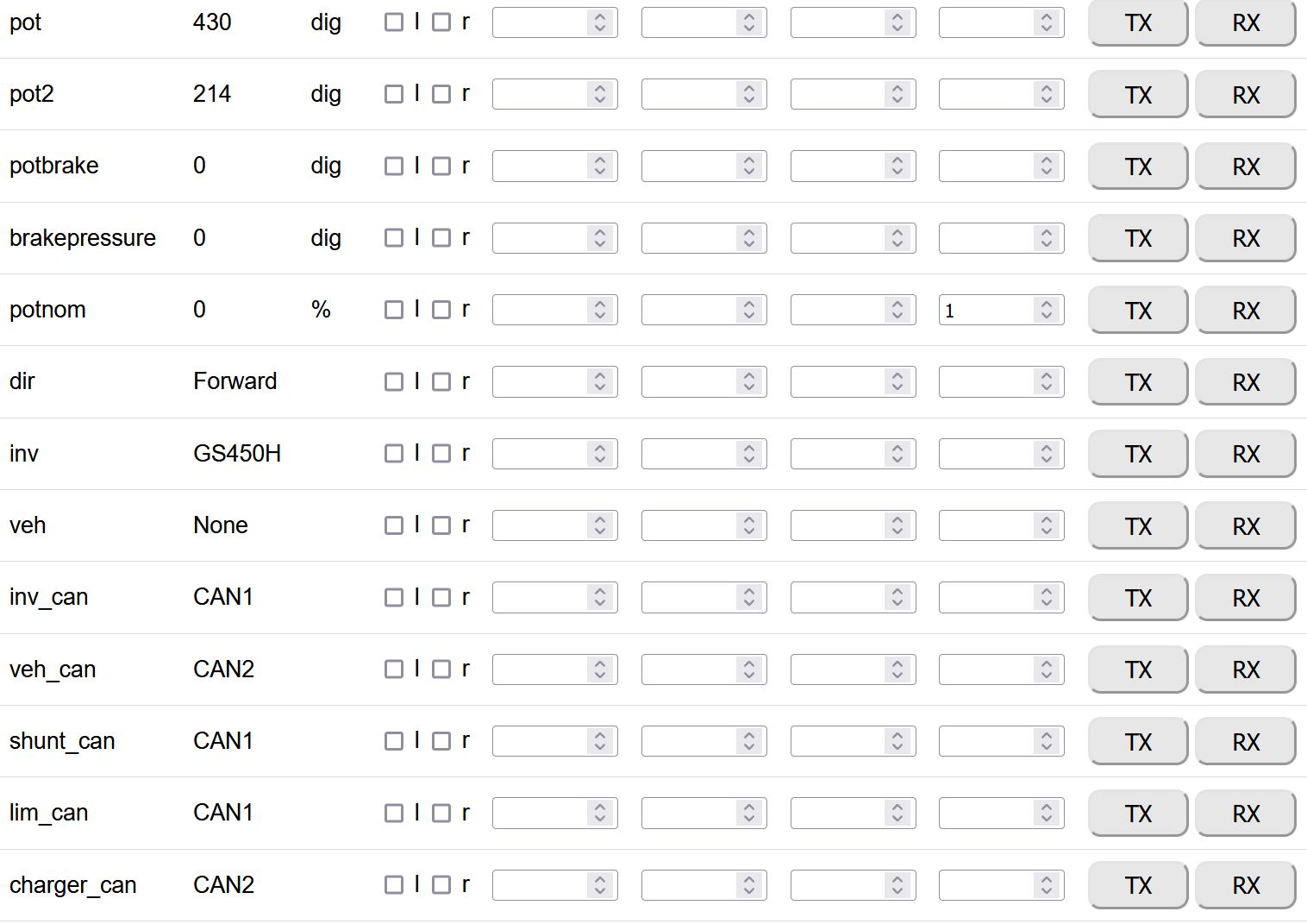

Re: ZombieVerter VCU Support

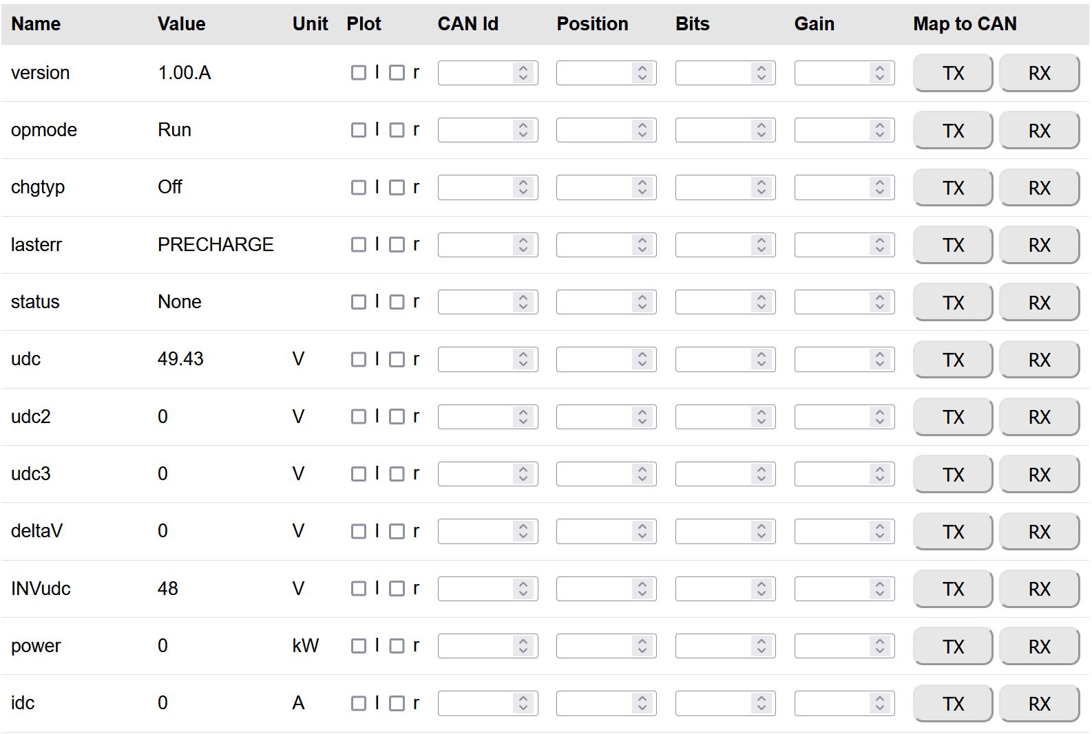

Thank you Damien, was looking forward to this update

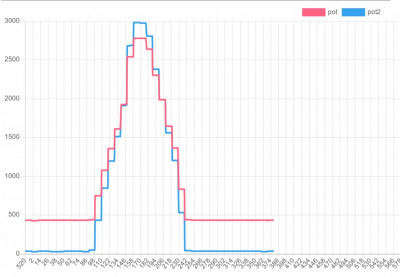

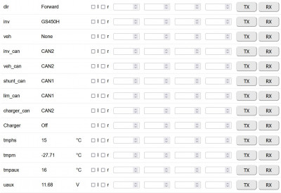

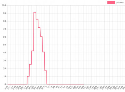

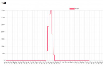

Gave it a quick run this morning. Testing with four 12V batteries for HV (approx. 49V). Initially have vehicle type set to 'none' and inv_can set to 'CAN1', the default. Is there supposed to be three CAN channels to select from the drop down? Only two showing currently.

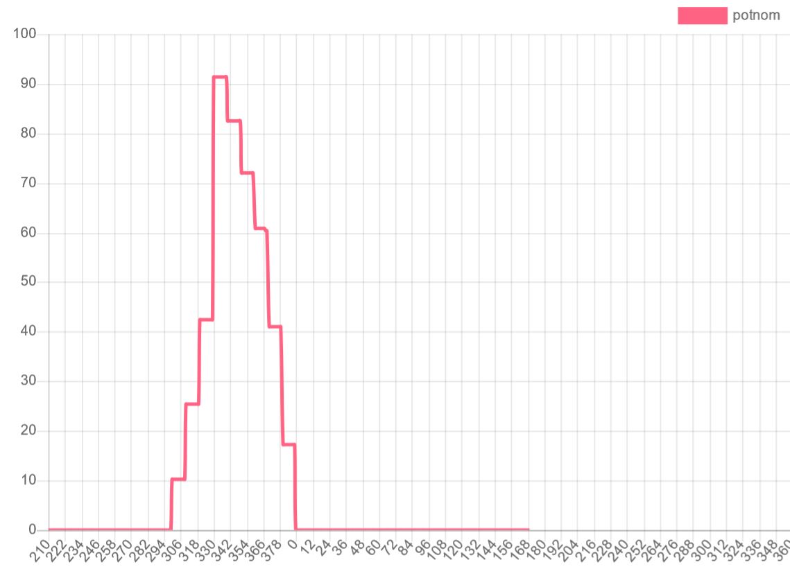

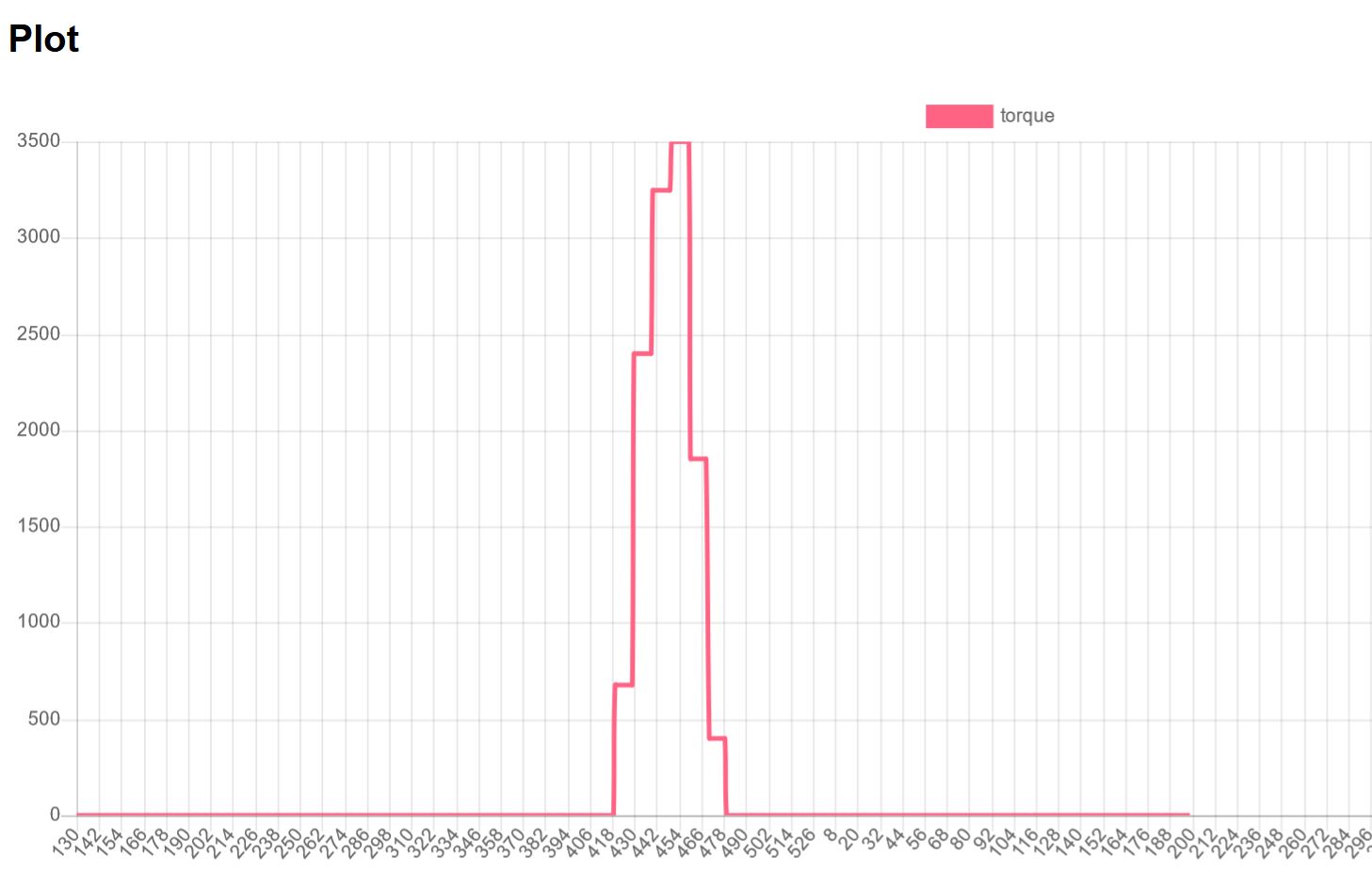

Torque, potnom and pot1/pot2 plots below. Is torque scaling correct?
Pre-charge and contactor sequence works as expected and as before and opmode changes to 'Run' ok. But also as before, InvStat stays 'off' and no drive rotation in fwd or rev. InvUDC also reading 0V as before but I can measure 12V at the inverter power input (so Zombie has inverter power relay switched on) and 49V at the inverter HV input so inverter should be happy with HV and power (which is all it needed to run with the GS450H vcu). Attaching a few screenshots as I'm probably setting something incorrectly and someone might see it.
So changed inv_can to 'CAN2' and this time INVudc now shows the correct inverter HV (this comes from the Inverter to Zombie communication yes?) But still InvStat remains off and no rotation. Precharge error here was just first start attempt where didn't hold key to start long enough
My thoughts are that it must be something I have incorrect in my wiring (or settings) so will be taking another look at both again although the GS450H vcu still runs the setup (can still connect in either for testing). Tried changing vehicle type to classic and E65. E65 just shuts off contractors as expected as its CAN based. If InvUDC is reading ok, would that mean there is now communication between Zombie and inverter. So I still have some troubleshooting to do

ill check inv stat but I think inv stat and udc inv don't show anything but system is working otherwise. How are you loading new firmware ? through web page or st link ?
Loading through web page using phone. Laptop connection is less stable, then back to laptop for the testing. Looks to load OK with new temp parameters at the bottom of the list. Not set up for stlink
So invstat and invudc as well as other inverter params for 450h and 300h do work. The fact they dont in your setup indicates a comms problem. All I can say is that this firmware works so at least you can narrow down the problems. My first suspect would be a missing clk signal. Remember that the Toyota serial comms do not use any of the CAN channels. CAN3 is not in the menu items as of now as it is dedicated to Chademo.

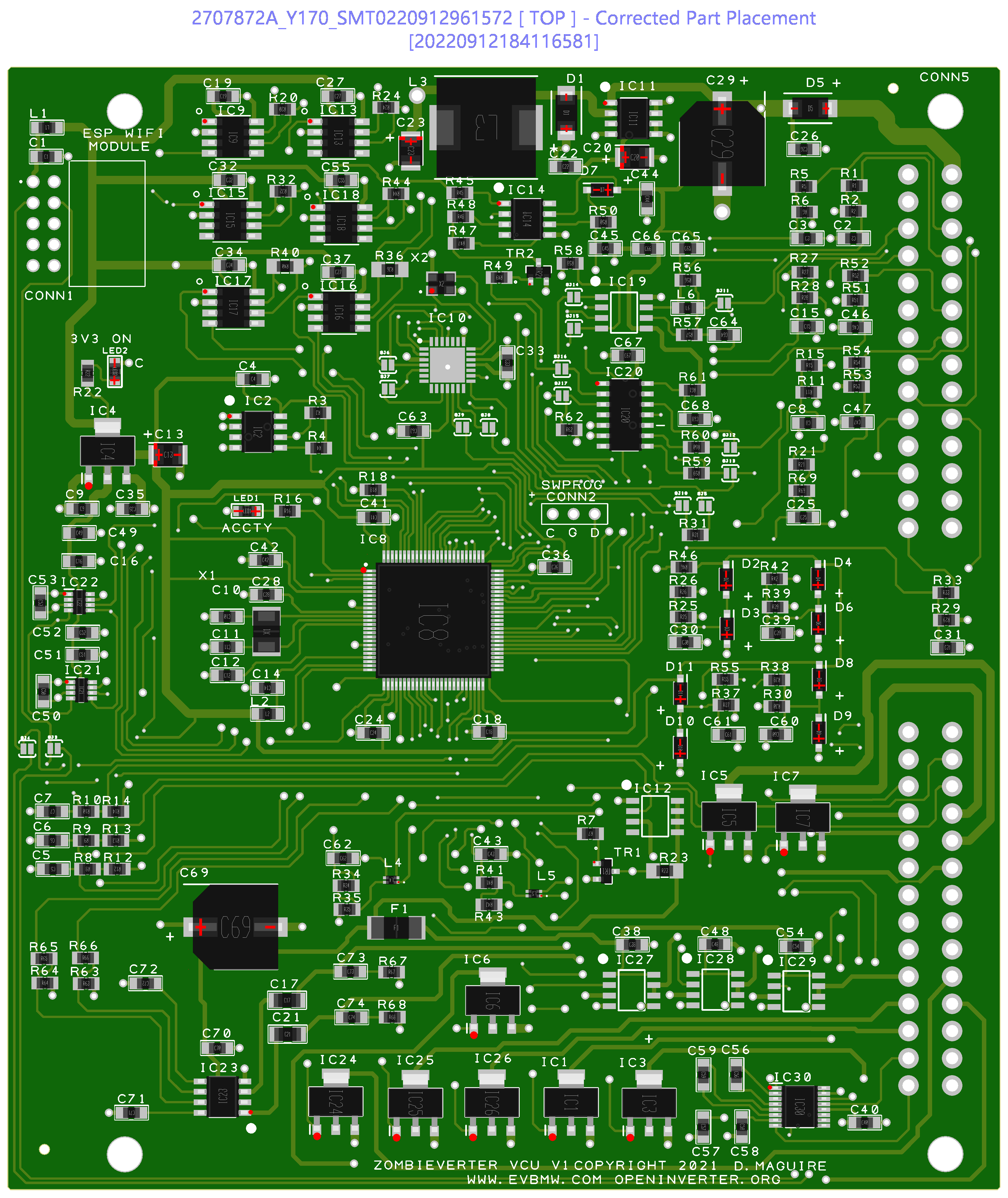

I’ve looked at the schematic and don’t think they are but are IC17 and IC12 needed in operation of is300h inverter & gearbox?
- Posts: 4000
- Been thanked: 1116 times
IC12 is used gear shifting in the 450h and IC17 is one of the CAN busses so neither would be required for test but IC17 would be needed if you intend to use more than one CAN bus.

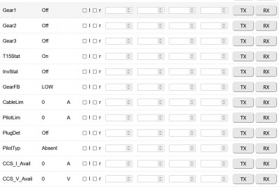

Ok thanks, just testing for now. Getting as far as run mode and torque commands but invstat stays off and no high pitched noise or spinning. Have checked all the comms and power wires placement and continuity

Sounds similar to what I was seeing today, run mode ok but no whine or spinning. Meant to do one more check but forgot, will try tomorrow, but previously I believe when I refreshed the web interface after applying ign on but before applying start, INVstat changed to On and INVudc read correct voltage. Then apply start and both changed to off/0V. Maybe I was dreaming, but will check again.
Thank you for the reply. Yes, comms appears to be the issue (my bad on the CAN bus relationship, although thought it was interesting it shows correct voltage even if coincidental). So the GS450H VCU appears to work correctly which rules out the inverter/transmission side comms. If the firmware is now working, that means its the 8 comms wires (which I checked again but going to remove the GS450H Tee in case that might have some affect), or its Zombie hardware.Jack Bauer wrote: ↑Sat Sep 10, 2022 2:50 pm So invstat and invudc as well as other inverter params for 450h and 300h do work. The fact they dont in your setup indicates a comms problem. All I can say is that this firmware works so at least you can narrow down the problems. My first suspect would be a missing clk signal. Remember that the Toyota serial comms do not use any of the CAN channels. CAN3 is not in the menu items as of now as it is dedicated to Chademo.
Is there a relatively straightforward troubleshooting option for the Zombie hardware to check the four comms lines ('For Dummies' type thing!
Could there be a debug/error log option in the web page at some stage similar to the new Tesla Model 3 PCS firmware to help confirm comms for the Toyota stuff is ok?

InvStat is designed to show active comms from any inverter toyota or otherwise. Built In Test (BIT) or loopback test of the hardware would indeed be possible if this were a better resourced project. Sadly it would seem to be just me and between limited time and software skill I wouldn't hold my breath. That said I would very much like to get to the bottom of this in case there is some deep bug still lurking thats not triggered by my bench setup or the setup in the E65. I'll mess about this morning and try to create the problem.

Some folks had asked about the component situation regards the kits and fully built boards. As of an order today I'm pleased to say most parts are now fitted by JLC once again. See attached picture.
Components not placed but included in kit :IC27,29,29. IC19. Wifi module and socket.
Components not included in kits but fitted to fully built boards : IC10,IC12.
Missing 1k R14 is now placed and R35,R43 changed to 150k to reflect recent calibration of GS450h and GS300h temp sensors.
