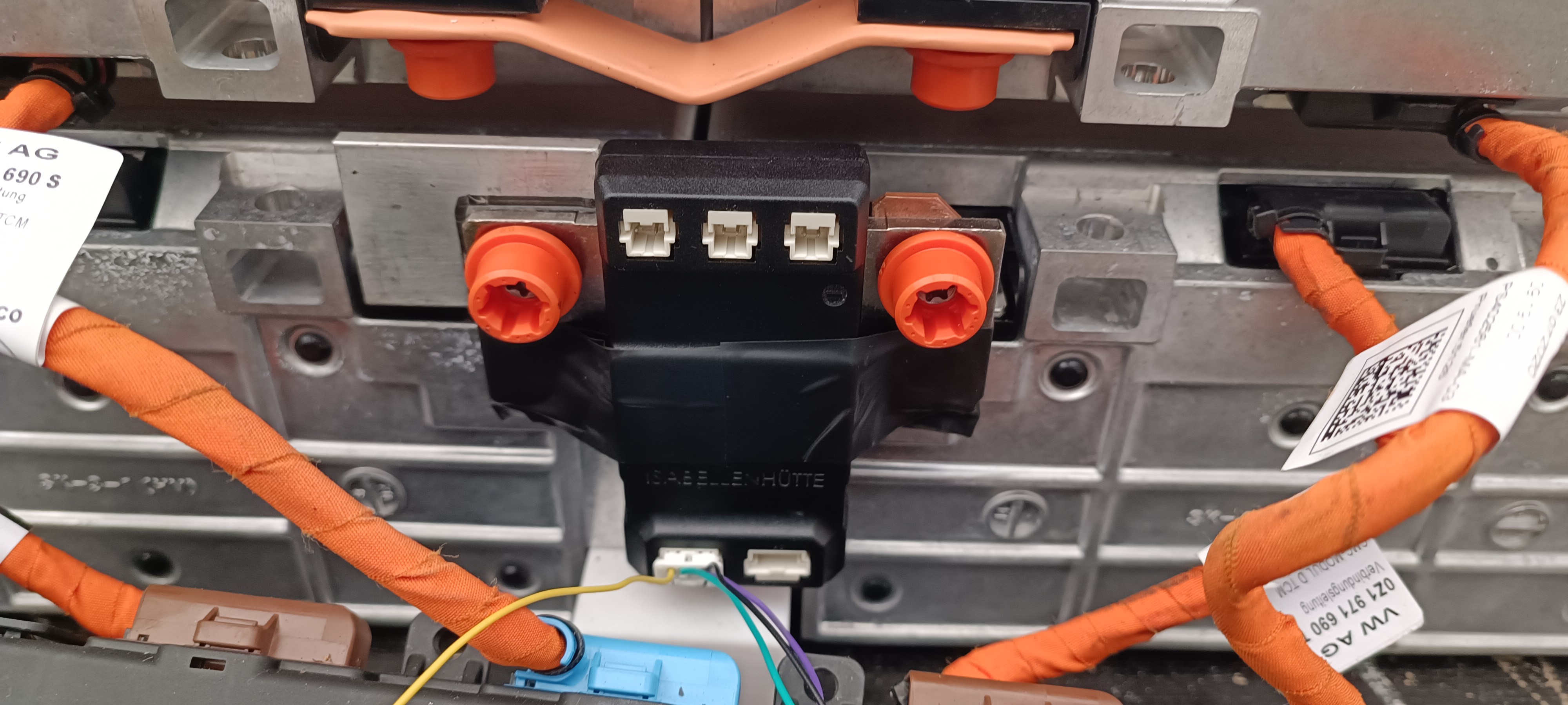

Subsequent repair today. Freed the cable from the one point it got caught. While doing so I found that I hadn't fastened the middle bolt that holds the battery pack up. Maybe that's the cars way of telling me to take off the battery cover ;)
Once it was freed I found the enable signal was still shorted to ground. Then I found the cable had gotten caught at another spot as well. CDYCS - Clamp down your cables, stupid.
With that sorted and all bolts now securely fastened all is as it should be now.

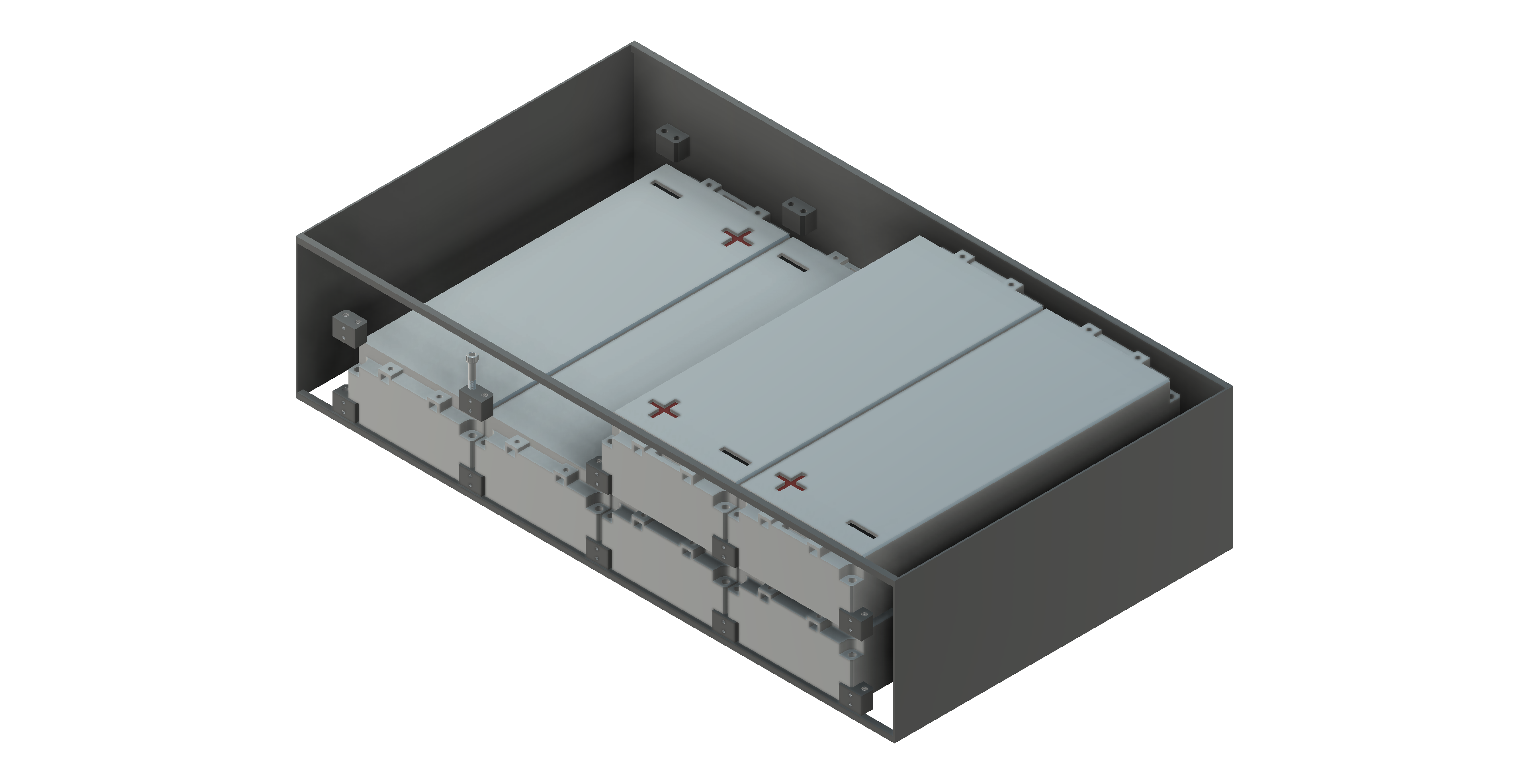

Now comes the best part - all that good work will be undone when I install the ID.3 battery pack :) I asked the pros to sketch up a battery box for me that doesn't leak.
I could theoretically install the 9th battery module behind the axle but am not sure about it. It adds extra complexity and I'd have to throw out the Outlander charger. The Leaf inverter would probably cope, I suppose.

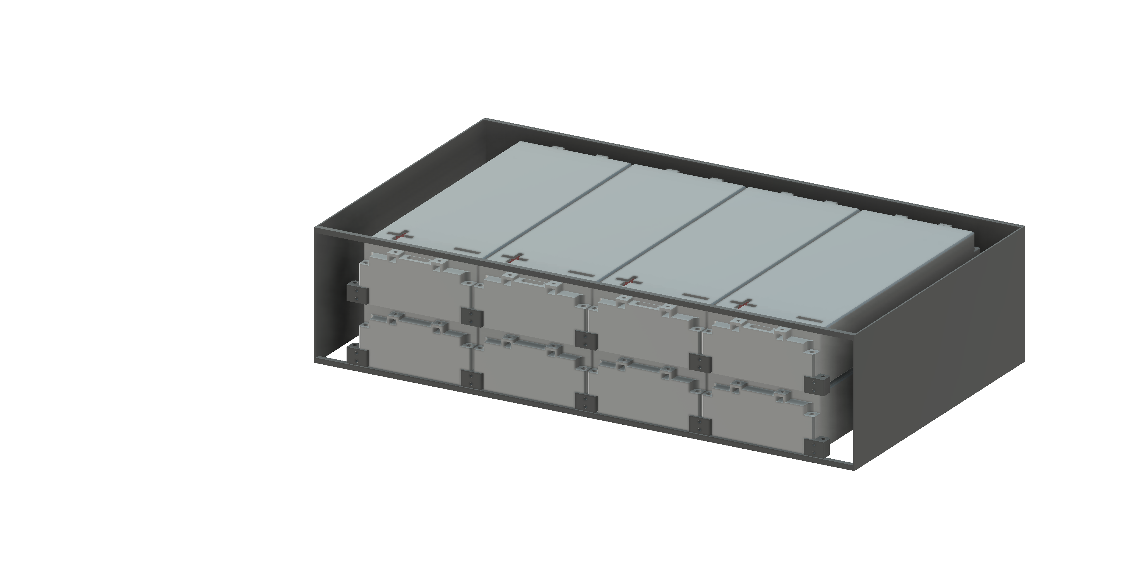

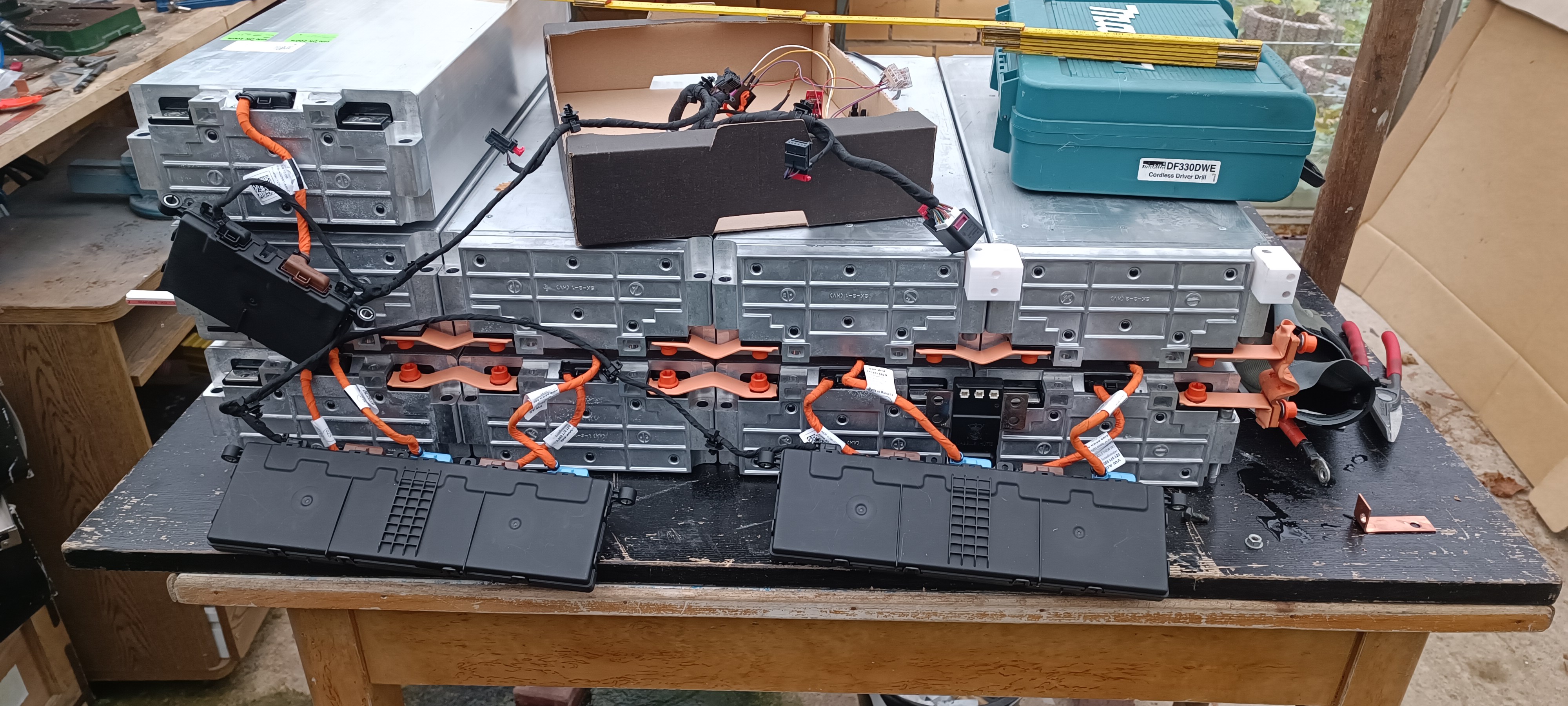

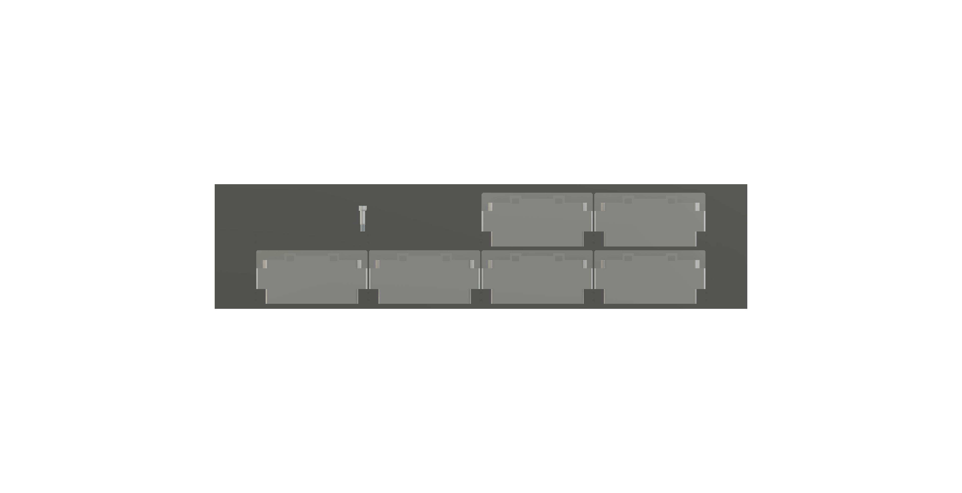

Re: [DRIVING] VW Touran powered by Nissan Leaf
How will the box be made? I do not see how you will transfer the weight of the batteries into the chassis.
Also small hint, you are missing the CMCs which need to be in front of the modules (front being the terminal side)
Luckily the OEM cables can work with 4 modules stacked 2x2. The CMC should be insulated between module sections so wiring order does not matter.
I have done this in the mini battery box and it works fine.
Front box shows better the cables not being in HV module order.
Thanks for that.
It's supposed to be 3mm aluminium.
It's bolted to 3 rails:
The one in the front (red) with 3 angle pieces, the middle one (also red) directly with 3x M10 bolts and in the back again with 2 angles (not colored). There are 40mm of extra space, I'm hoping that is enough for the CMCs. Otherwise I could relocate them to the side perhaps?
I think I'll add reinforcement bars where the box is bolted to the chassis.

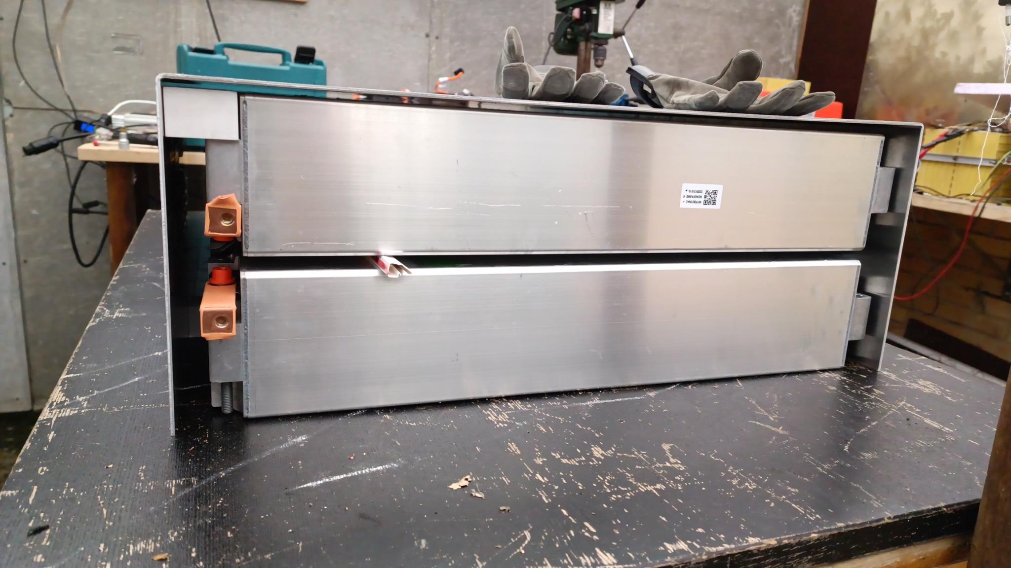

Let me discuss how i intend to solve this for my ID3 modules.
I will assemble modules in 4 packs 2modules on top and 2modules on bottom inverted. In between i will have a cooling plate which will double as a mounting jig, so assembly will be turnover proof.
Cooling plate i first intended to assemble from 2 plates one 8mm and the other 12mm and bolted together. 12mm plate would have cooling channels cut on milling machine as well as O ring seal channel.
But as i couldnt find a milling machine operator who would machine just one or two pieces for me i decided to make the plate in 3 pieces.
3 piece construction will include two 8mm side plates and middle 5mm plate. This plate i will be able to just cut by my hand jigsaw. There will be no Oring seal instead i will use sika silicon glue on both sides together with countersunk head screws.
I will still have to position 10mm tubes somewhere on the top plate and weld them to have inlet and outlet.
Also dont forget each module is 30kg and 4module pack is 120kg which is quickly too much for a single person and it might cause problems with two not so strong persons. Having more than 4 modules on a single plate will require additional supports to bolt to the chassis to enhance material stiffness.
Modules have 10mm bolt holse and those are quite sufficient to support 30kg individual weight of the module.
Grade 8.8 bolt should hold upwards of 640MPa force converted to G loading should be 1.9T for each bolt = 60G+.
Shear strength is a different animal. You have material capacity of 60% at shear forcess only. And if one bolt goes everything goes! Usually Aluminum box will fail before that bolt. You will now see the weak point really is mounting assembly to a car.

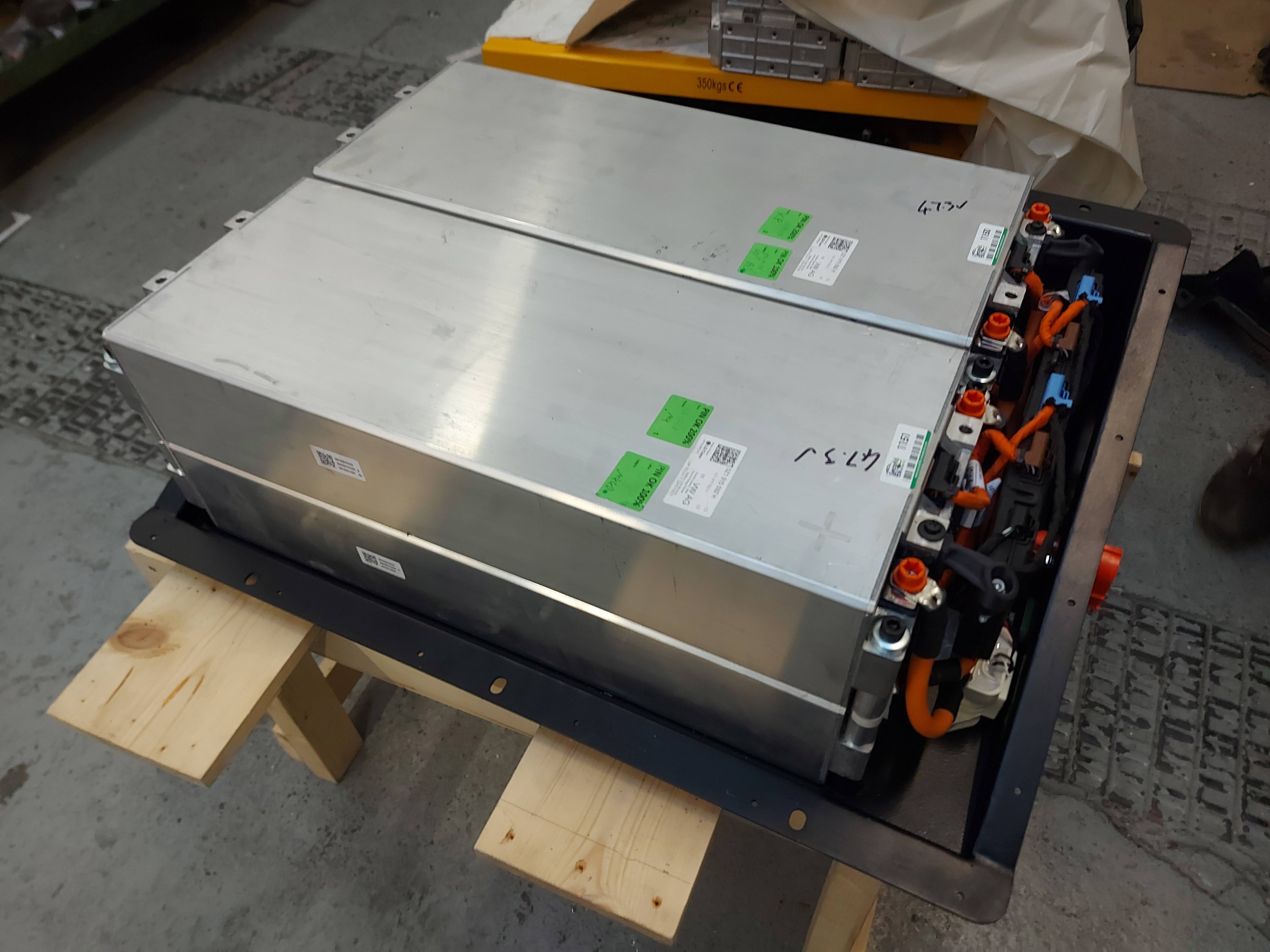

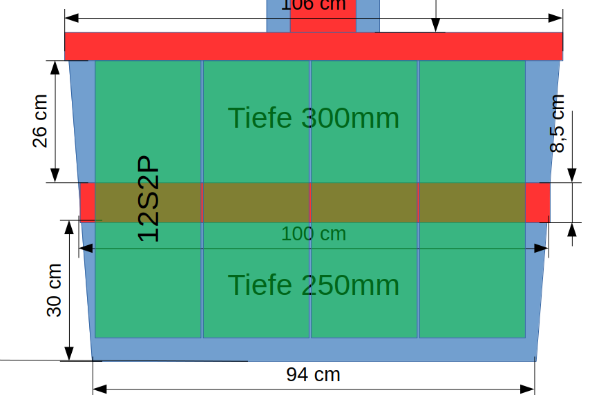

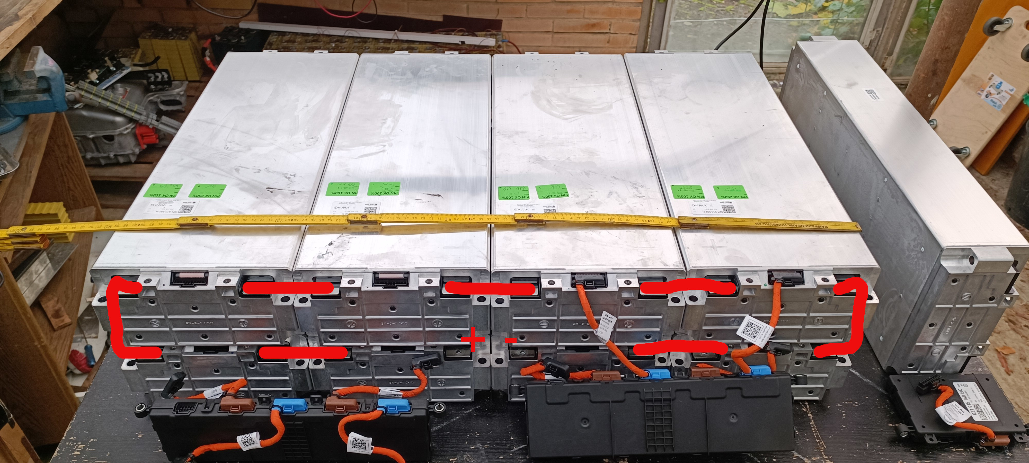

Here it is in all its glory. 895x590x220mm (without spacing - will add 10mm of spacing between the modules and below the lower modules)
And here is the box
I will probably build it from 2 custom U-profiles. One from stronger material that is actually structural and one from thinner material that is just the cover. In the front and back and will be mounted with 2 L-profiles to the existing mounting holes and in the middle to the extra Arber-holes into the beam that holds the seats.
I will assemble the entire pack on the transmission jack and on the lower "cover" U-profile and then put the upper mounting profile over it with 3 studs sticking out to go into the Arber-holes.
I will try to only air-cool the pack. I will add inlets to the front panel that direct the air towards the gaps between the cells and then pull it out the other end with a fan. I learned from e-grandpas latest video that there's vents that block water but not air.
Software will make sure no module ever rises above 45°C or so.
Nice photo. That is actually my favourite rtool right now :).
Do you need me to come visit 8-).
Let us explore another venue. What about strong central plane where all modules will be bolted to? M10 bolts fix modules in place and you just use sheet metal as cover - not structural. That way if you at one time decide to implement cooling you can do it with a single plate and bolt channel plate in between.
Hm... could you cut the bottom of your OEM box on one side. Use one row only as a central carrying member? Alu is already there...
EDIT: I would not use that last module in vertical position. Such connection could only allow for 75% of SOC use and shorten the life of that module. Unless of course those modules are omnidirectional, but i would get confirmation from OEM for that. Probably not worth the chance...

arber333 wrote: Thu Nov 09, 2023 7:26 pm Let us explore another venue. What about strong central plane where all modules will be bolted to? M10 bolts fix modules in place and you just use sheet metal as cover - not structural. That way if you at one time decide to implement cooling you can do it with a single plate and bolt channel plate in between.
Issue is how would you connect the central plane to the Arber holes? Also I'm not sure if the modules should be mounted upside down.
arber333 wrote: Thu Nov 09, 2023 7:26 pm EDIT: I would not use that last module in vertical position. Such connection could only allow for 75% of SOC use and shorten the life of that module. Unless of course those modules are omnidirectional, but i would get confirmation from OEM for that. Probably not worth the chance...
I won't. If at all I would mount it behind the axle below the spare wheel. But I don't think I will, it adds too much complexity and also too much voltage at 108S

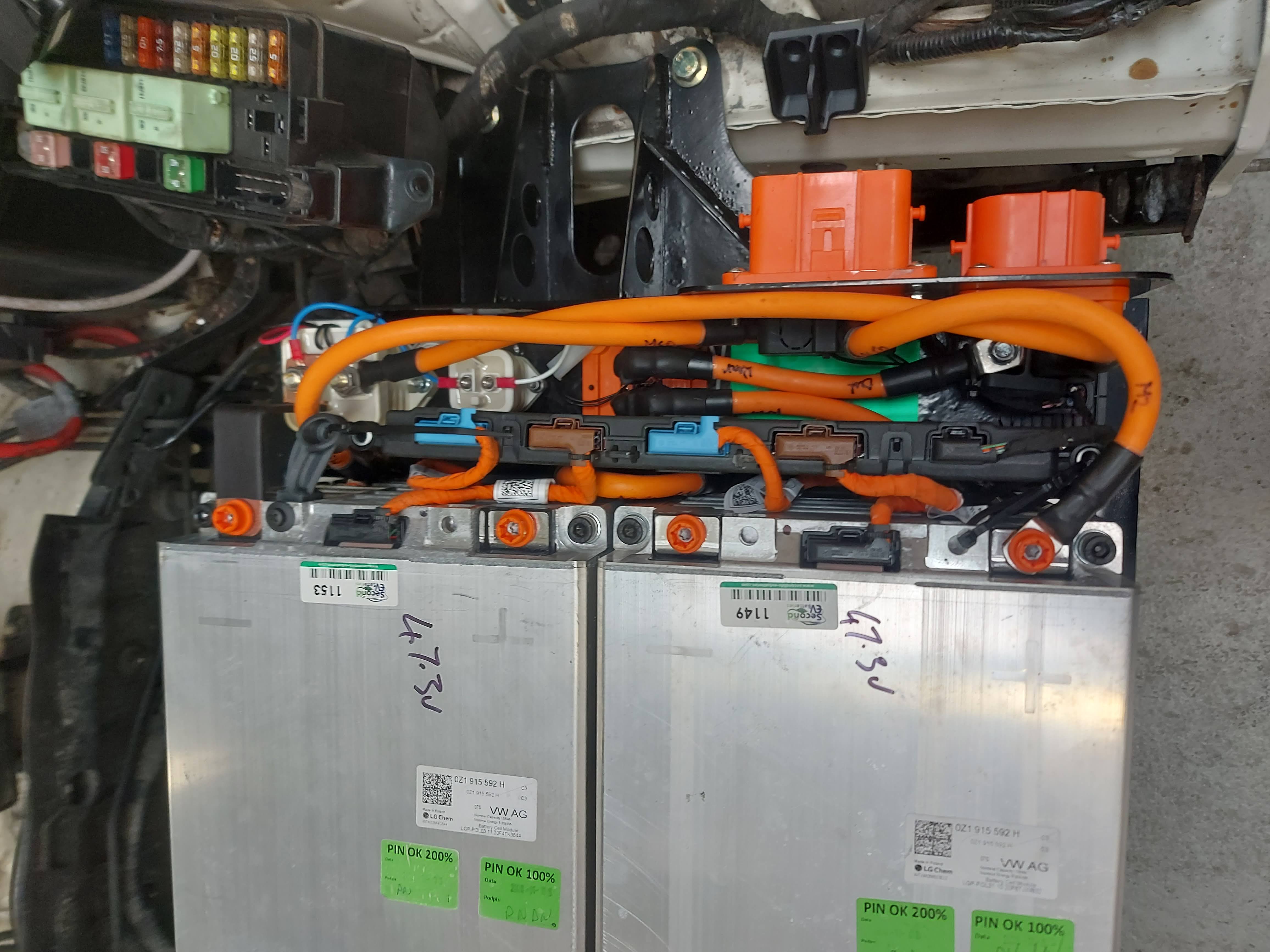

Been thanked: 1918 times

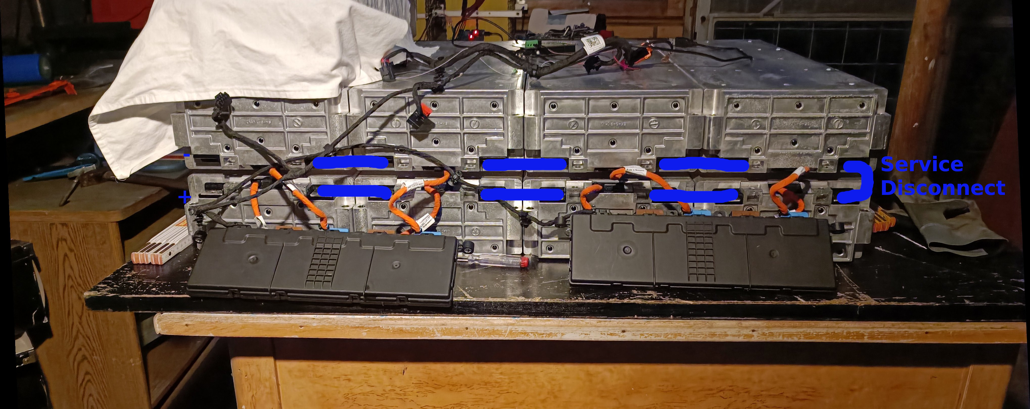

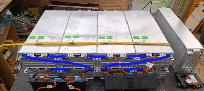

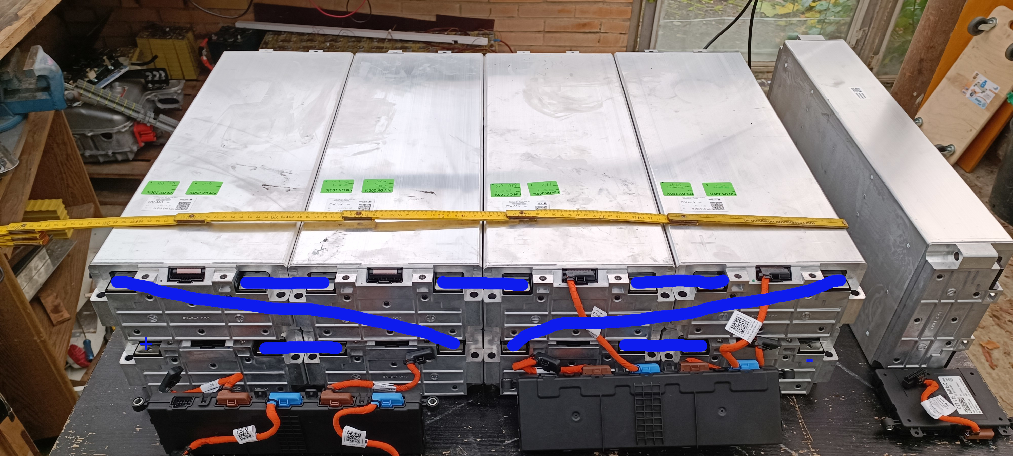

Now I went over the pack design with my neighbour and we found a rather fatal flaw - the output would be 0V!
We are looping - to - and + to + when jumping from the upper to the lower row.
This would work but is clumsy
So now I consider turning the upper row upside down. I could then use the grey heat compound to connect them to the outer shell of the box and thereby get rid of the heat of the upper row. Likewise on the lower side. Maybe with an additional blower or so. That way nothing but electricity leaves and enters the battery box. No danger of leaks.
EDIT: I could even snake some coolant lines along the top of the box.
EDIT: maybe this lets us decide about turning them upside down

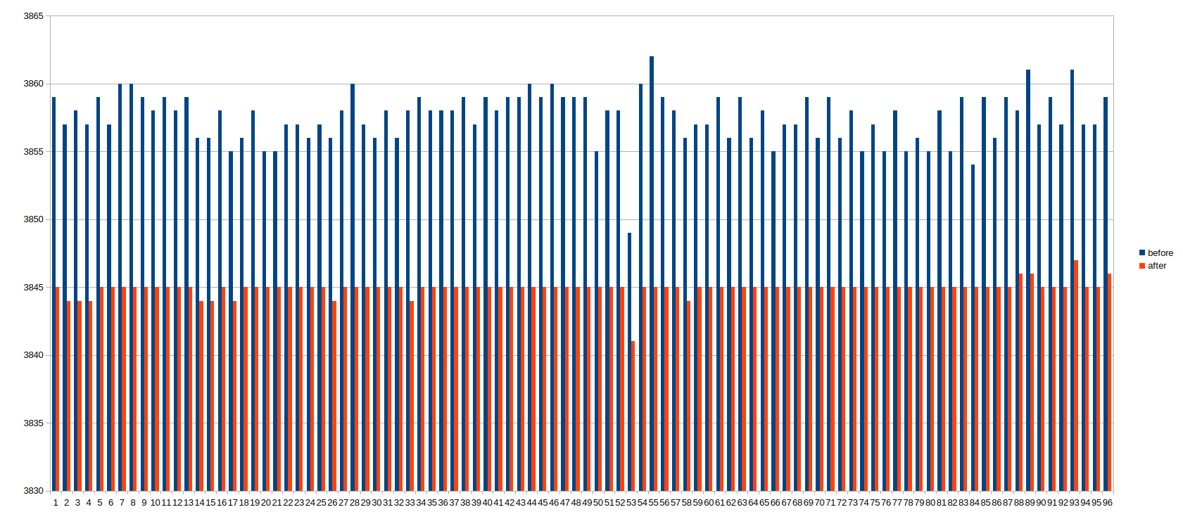

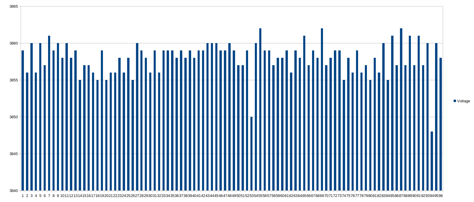

Cobbled together a DBC file for the MEB BMS with Toms help (https://github.com/Tom-evnut/VW-bms) and decoded the cell voltages of 8 modules
Two voltages stick out a bit. Highest is 3862 mV and lowest 3848 mV . so 14 mV Delta. will take a few more samples and watch these two carefully
johu wrote: Fri Nov 10, 2023 4:45 pm Now I went over the pack design with my neighbour and we found a rather fatal flaw - the output would be 0V!
Well i am seeing this as well. I am using big M10 through bolts and in my pack two bolts in the middle are going to interfere with simple flat bus bars.
I will have to make insulated 35mm2 cable shoes to bridge those bolts... but i will probably assemble cells in upside position. It is easier to connect everything together when accessible than in upside down scenario.

And latest iteration of my electrical layout. Upper row is now upside down. +/- will exit on the left (could be the other side just as well) and I will try to fit the service disconnect on the other side.

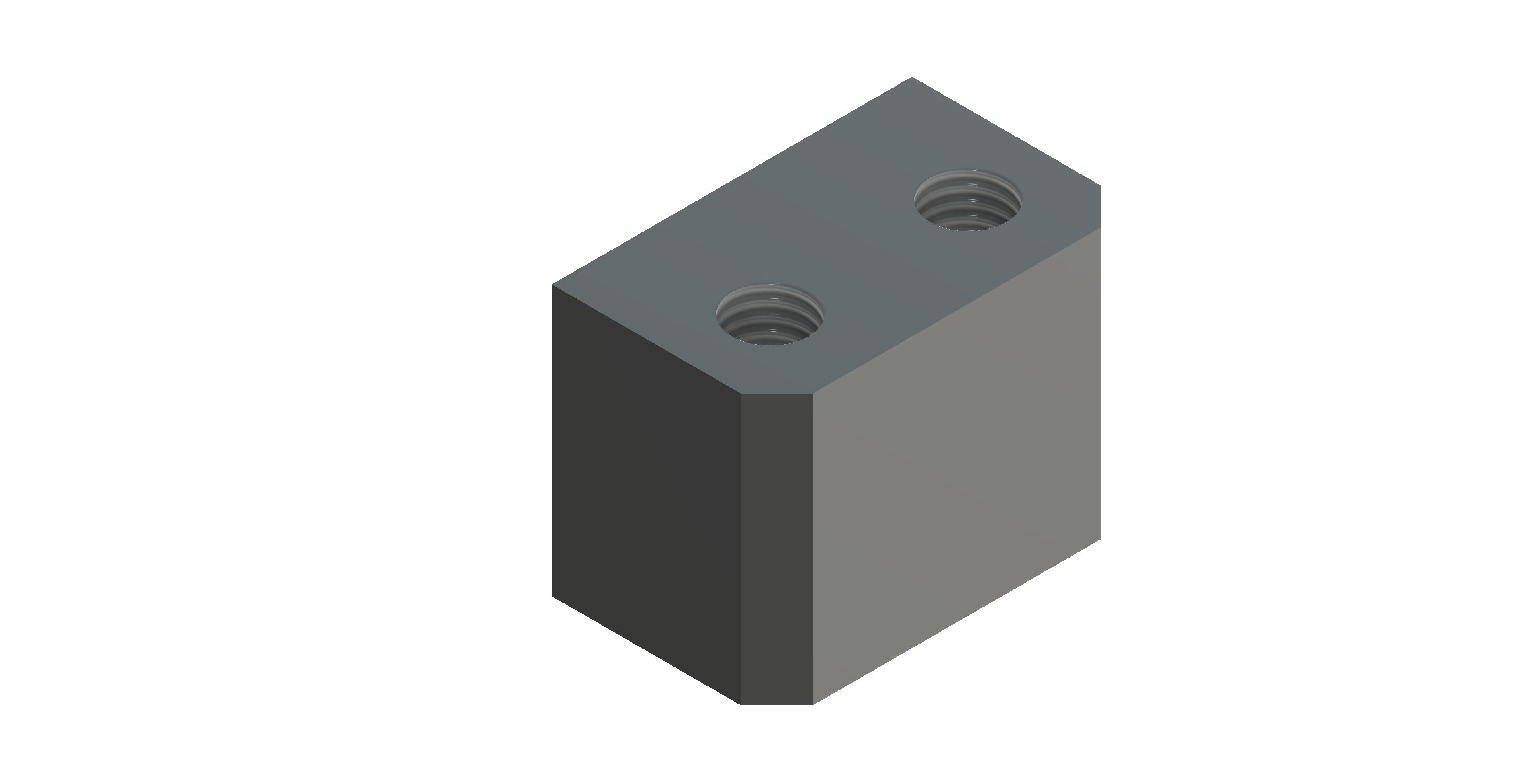

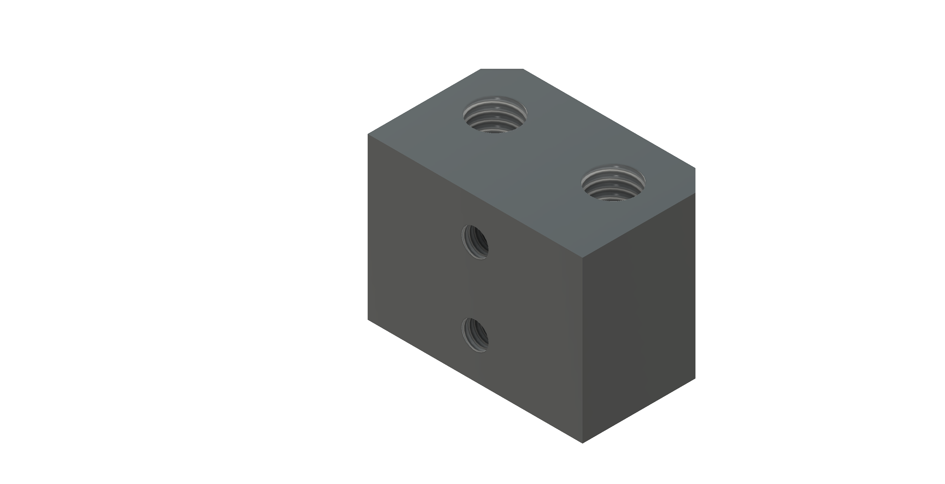

And the first 3d-printed models of the mounting blocks have arrived.

johu wrote: Sat Nov 11, 2023 5:16 pm Two voltages stick out a bit. Highest is 3862 mV and lowest 3848 mV . so 14 mV Delta. will take a few more samples and watch these two carefully
Given you have a 9th/spare module, might be prudent to swap the entire module containing the lowest cell at this stage? Then theres only one to keep an eye on.
Aragorn wrote: Thu Nov 16, 2023 9:11 am Given you have a 9th/spare module, might be prudent to swap the entire module containing the lowest cell at this stage? Then theres only one to keep an eye on.

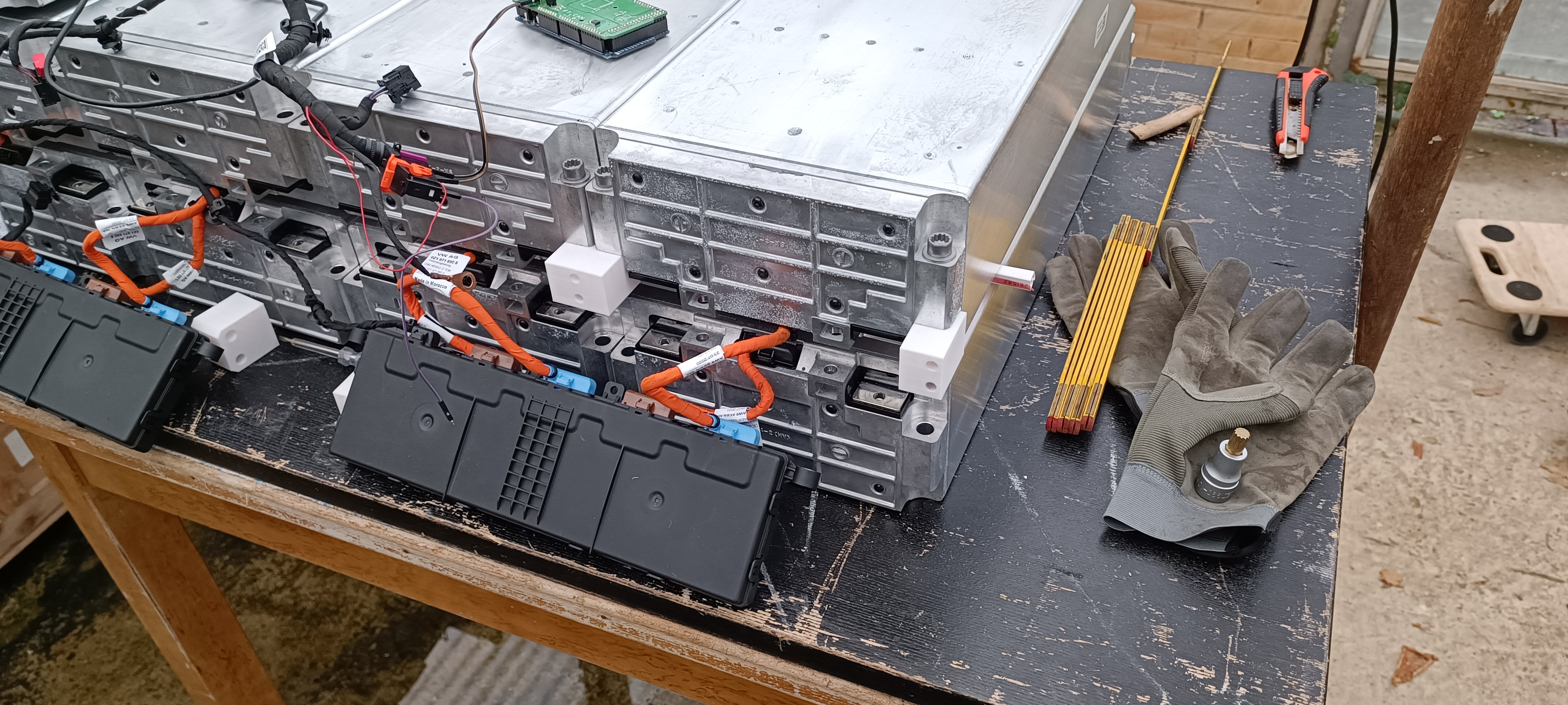

Aye sir, did just that. Here is what it looks like before and after balancing. Not sure if I got the balancing right as the low cell sits even lower now :?
And here is some connector progress. Made 5 isolated bus bars from copper, 6th connection will be the ISA shunt that Damien donated a while back and the 7th connection will be a kindof, sortof service disconnect aka the VW pack halves bus bar

johu wrote: Sat Nov 18, 2023 1:20 pm Aye sir, did just that. Here is what it looks like before and after balancing. Not sure if I got the balancing right as the low cell sits even lower now :?
Hm... maybe you should get a 12S connector and extend wiring to connect that JK BMS balancing module to streighten up your cells. Warning you need to limit balancing to 300mA in JK app!

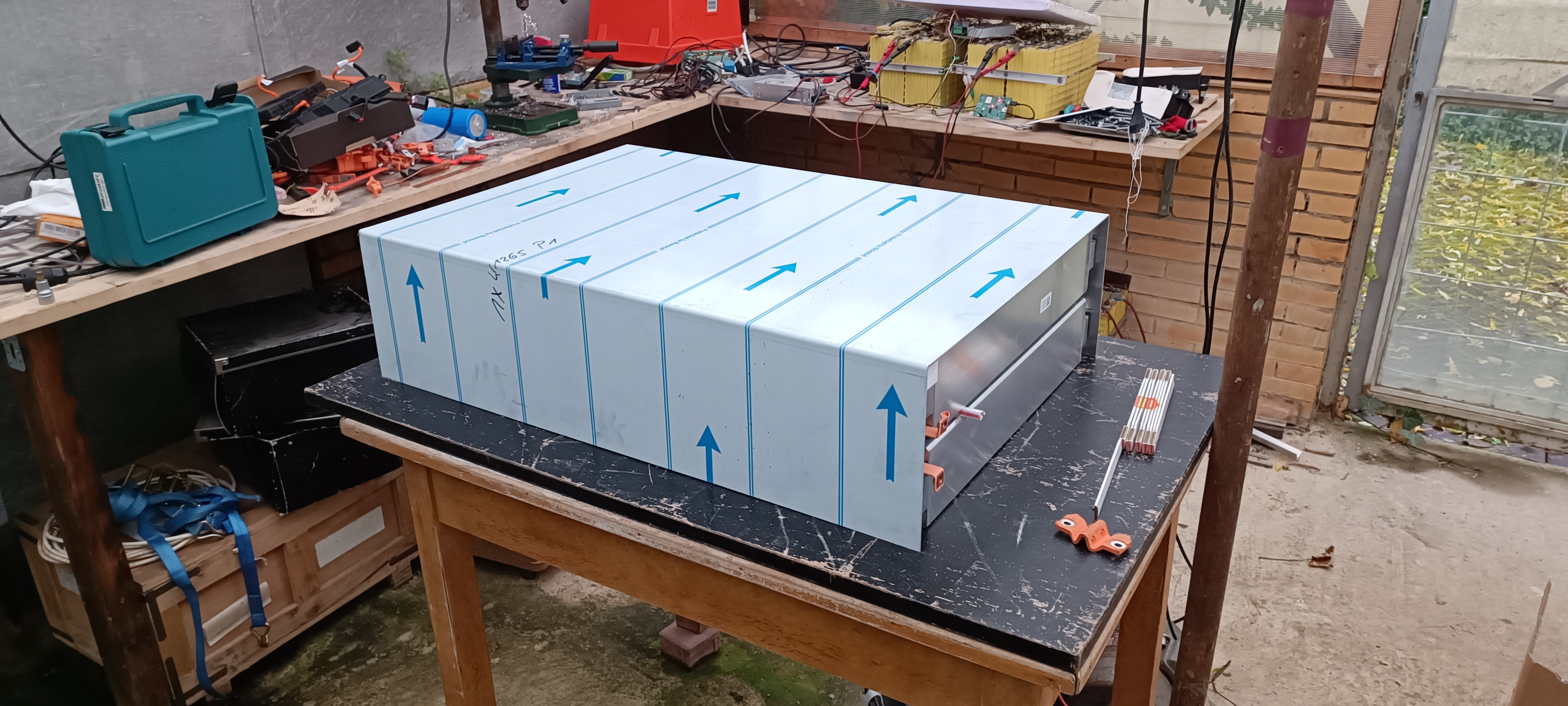

It is growing. This U-profile set me back 180€ but I think it's worth it.
Still wondering how to best route the HV out of the enclosure, out the side or out the front.

johu wrote: Fri Nov 24, 2023 2:29 pm It is growing. This U-profile set me back 180€ but I think it's worth it.
That is expensive :shock: i paid 180€ for welded box but it is only 1.2mm inox.
Well, from experience your pain is just beginning. I had real problems how to cut holes for cable glands into this material. I tried "step drill piramid" and failed... In the end i decide on a suitable "crown drill". Some 24mm diameter and to my surprize i just needed some WD40 and set my drill to slow speed and i had a hole in couple of minutes. While i was at it i could use what remained for a washer 8-).
