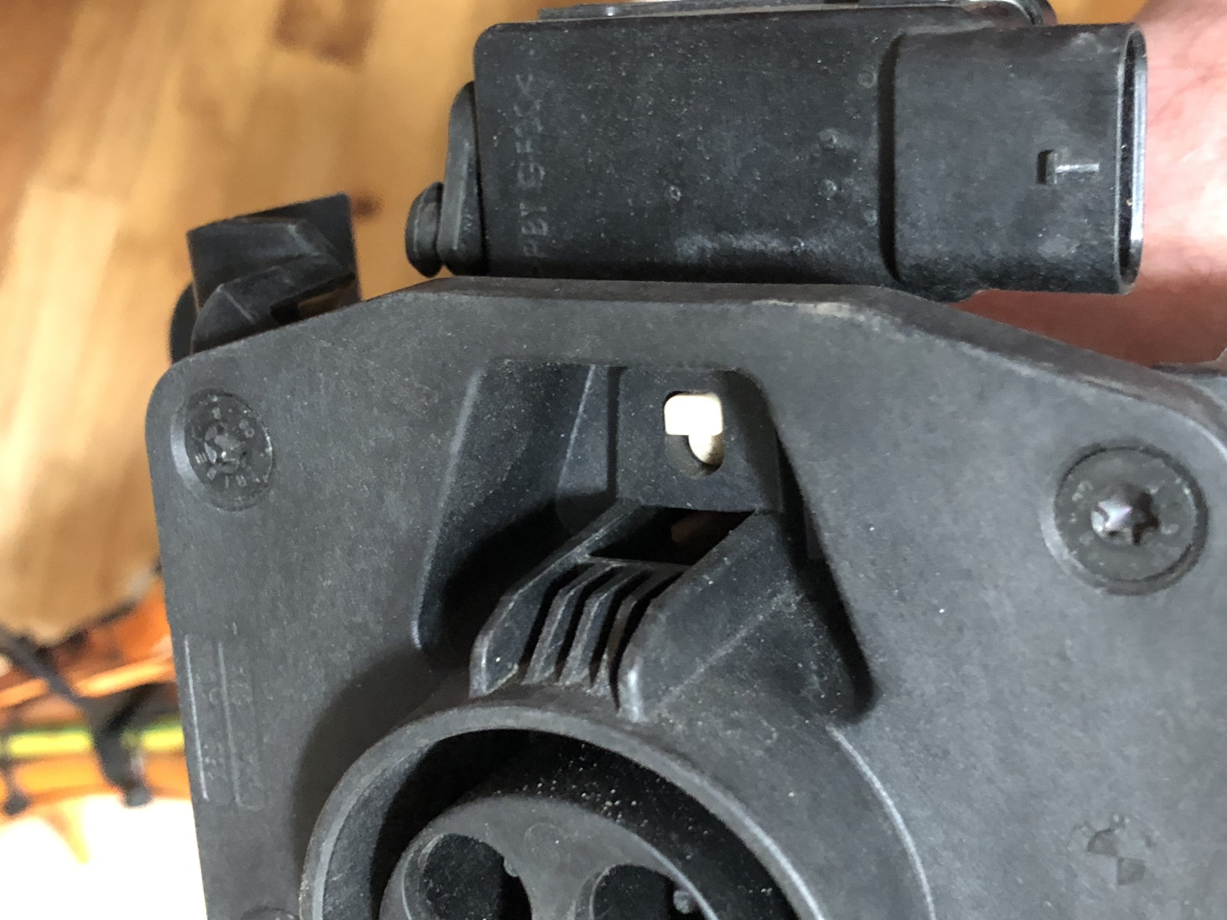

I have a question about charge port locking of CCS1 vs CCS2. The Wiki states: "Only important for Type 2 (3-phase) charge ports.", which to me implies that the charge port locking feature is not applicable to Type 1 (J1772) and/or CCS (1-phase) ports.

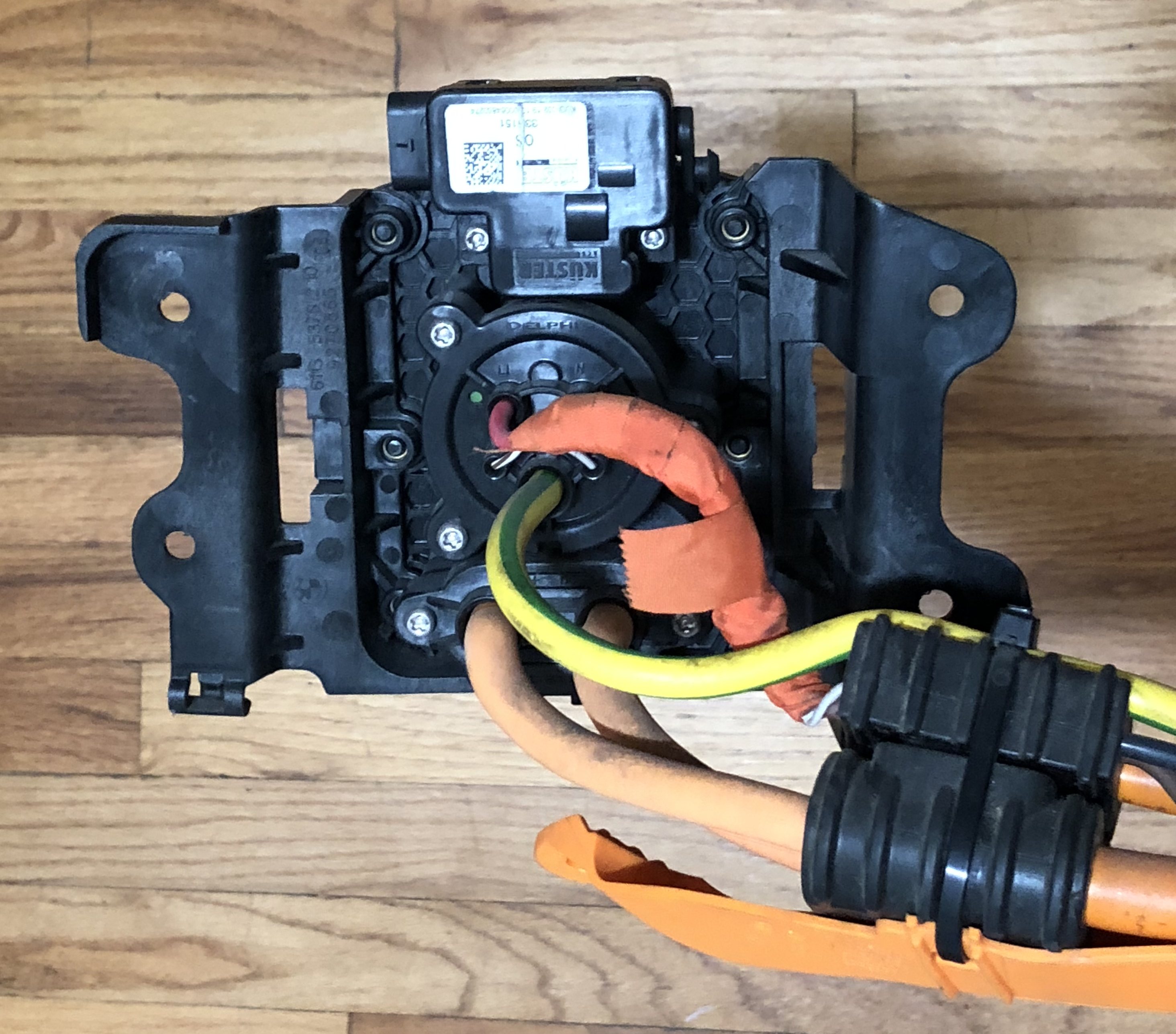

Via eBay, I recently purchased a BMW 6828092 charge port/cable assembly -- shipped from Lithuania, and supposedly from a 2016 model i3 -- which to my eyes looks like it's CCS1 with a Kuster cable lock actuator mechanism.

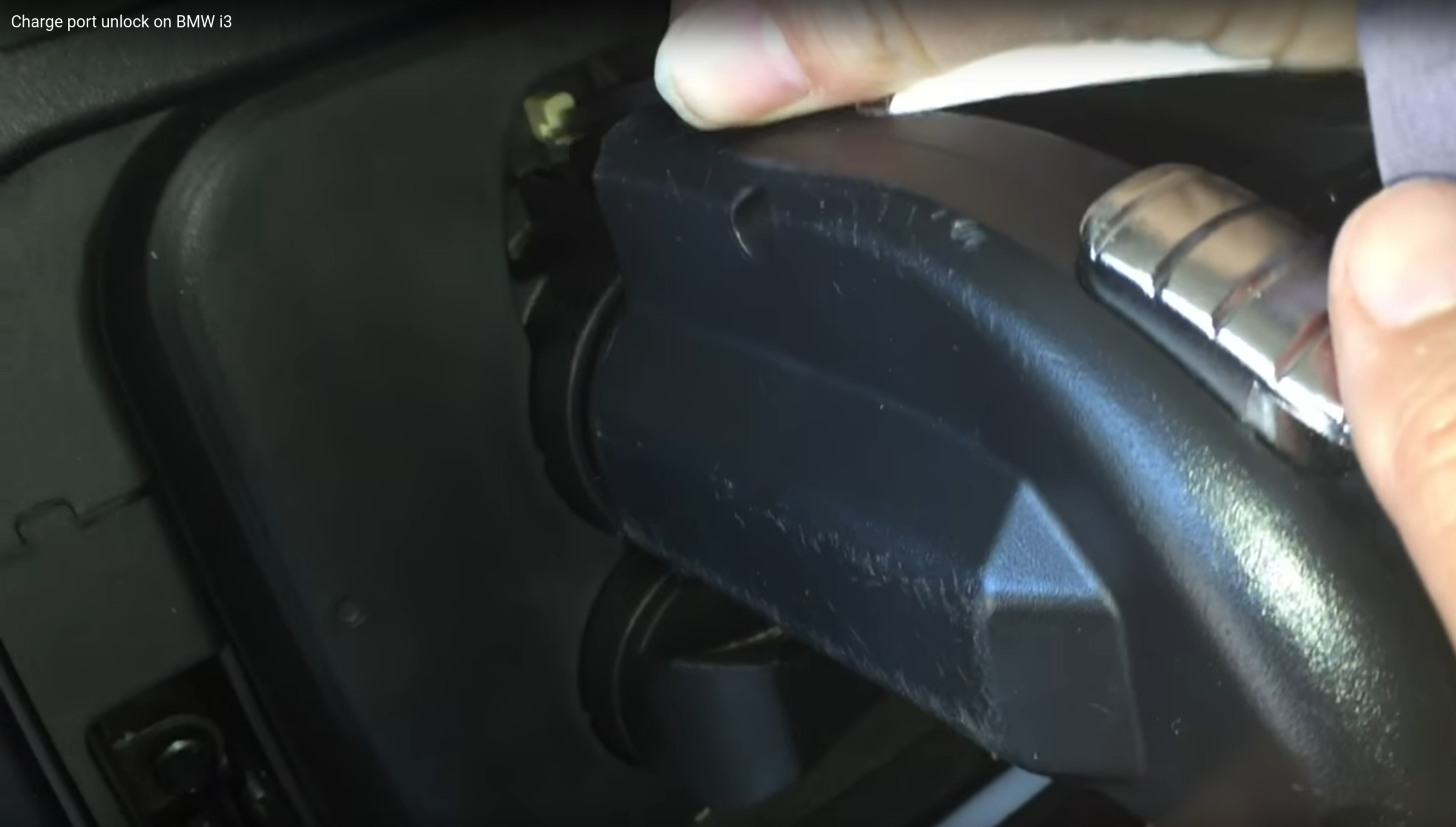

Here's a YT video of it in action:
Screenshot from that vid, where she's pushing on the end of the extended lock actuator to manually unlock the nozzle:
Another vid, showing a different angle on the same locking and how it prevents depressing the latch release button:

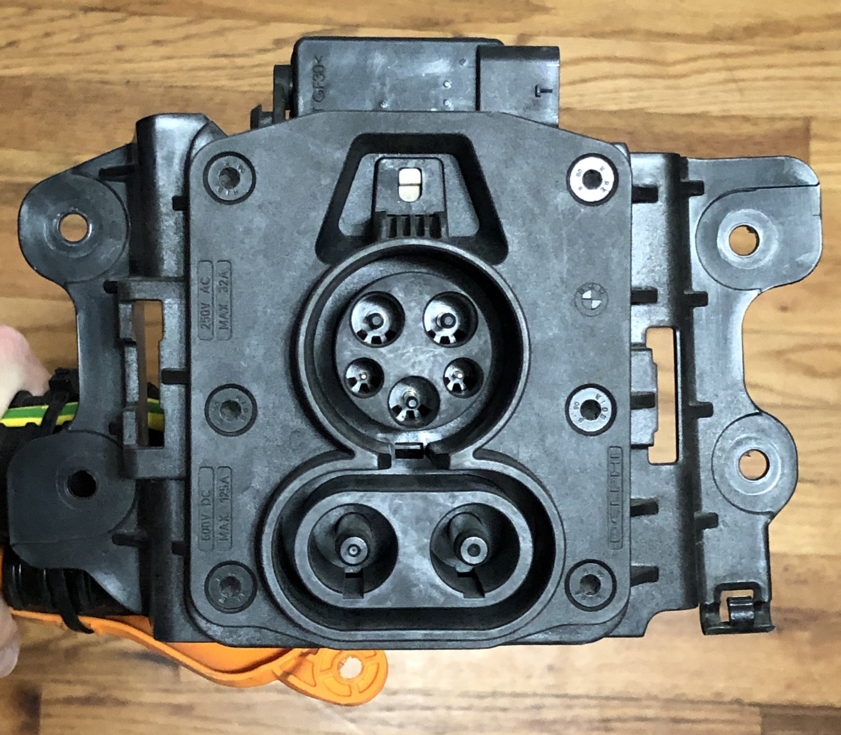

Apparently, sometime in late 2015 BMW redesigned the inlet to make it more difficult to just insert a tool to press back the actuator, but the actuator itself remains.
My questions:
1) Do I understand this accurately (CCS1 in North America does lock the charge cable/nozzle)? If so, should I update (remove) that line in the Wiki?
2) Does the North American CCS nozzle sense that the charge port's actuator has extended (locked) the nozzle to the port? Thereby refusing to DCFC if the actuator has not been extended? Some discussion I've read implies this. Put another way: does CCS1 in the US require a functioning cable lock for DCFC to operate?

Probably stating the obvious but all DC charging requires locking of the connector to the vehicle.
In CCS 1, a pin or lever in the receptacle holds down the latch of the CCS1 connector/plug/“gun” to prevent actuation of the button/latch and thus removal of the connector from the vehicle. Users typically can press hard enough to trigger the switch to stop charging but not to actually remove the connector. While not the way the standard was intended, a lot of locks on vehicles have some slack (along with latch flexy-ness) to make this possible. Notably, the i3 mechanism is a bit stiffer and therefore doesn’t quite allow this.
In CCS2, there are notches on the CCS2 connector that the receptacle lock grabs on to. Commanding this lock to unlock is done externally, typically with a button adjacent to the charge port.

It doesn’t. The vehicle tells the station that the vehicle is unable to lock. In all honesty a lot of vehicles handle the conveyance of failure to lock very badly, which results in weird charger error codes… but all should essentially stop the charge during the setup process, ideally at or before cable check, where the vehicle must lock the cable on or before that point.How did the EVSE know that the nozzle was not mechanically locked?
The LIM is capable of monitoring the lock state and checks during initialization and continuously during the charge. I don’t know how the LIM handles telling the station of said lock failure but it clearly does stop the charge from happening. Could get me a pcap and I can tell you how well it does so.
As I sad about 10ish pages before, when incorporating CCS into your EV, having functional locking is absolutely 100% necessary. The station is trusting the vehicle to handle locking. There’s likely ways to trick the LIM into thinking the lock is ok, but actually isn’t. Do not do this.

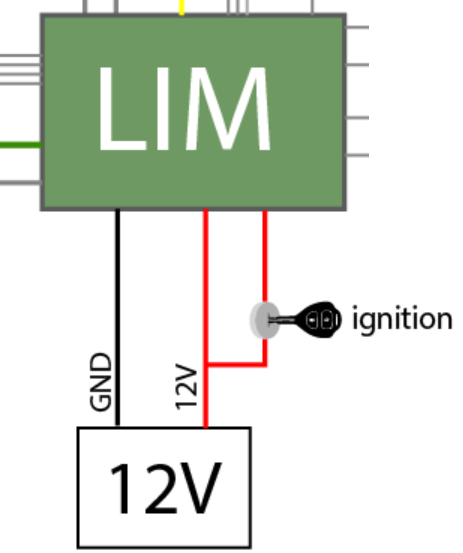

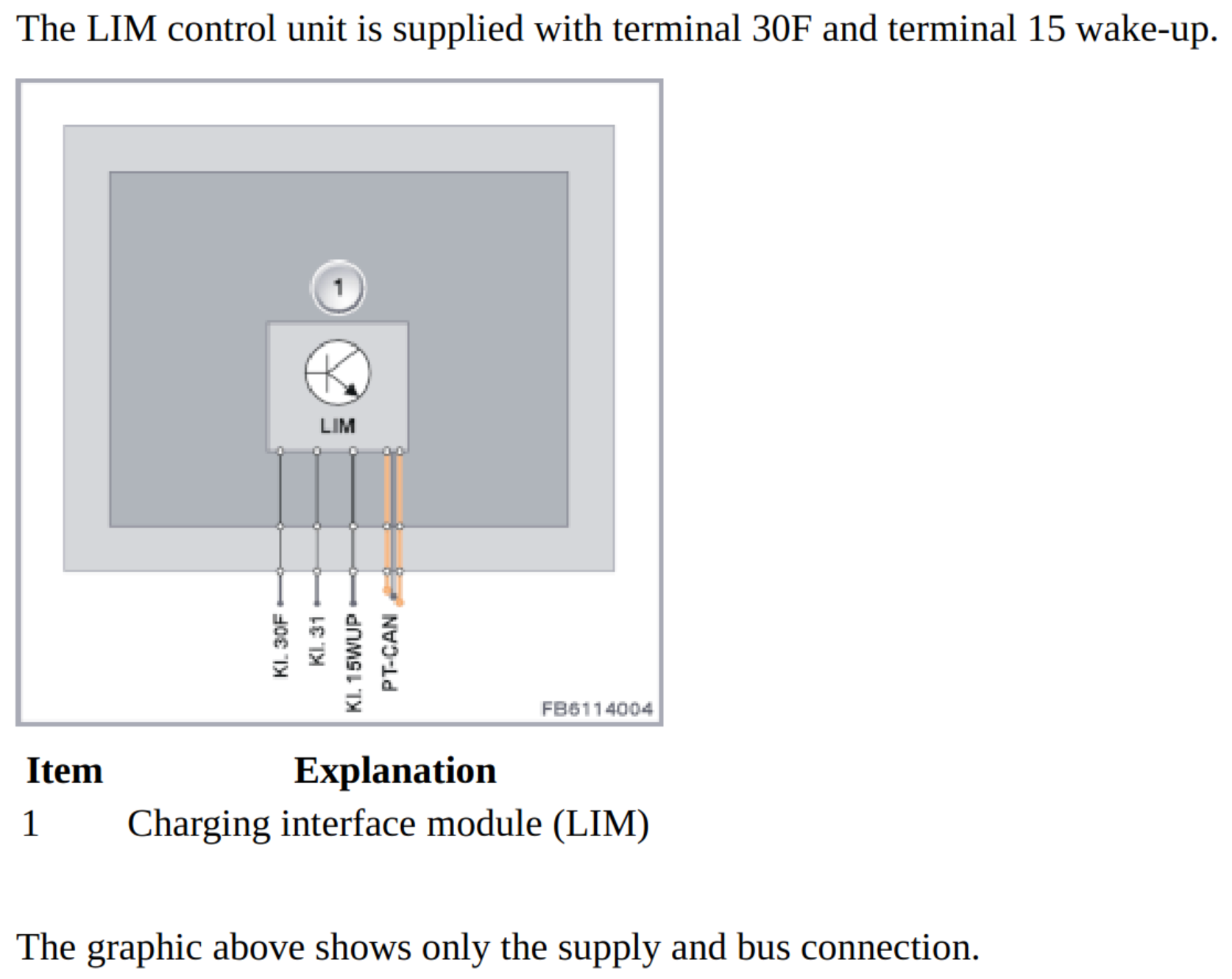

I am due to receive my own I3 LIM soon and have been doing work with others to try and first of all reproduce the findings in this thread. So far so good and gotten the AC charging functioning.
One "basic" function I would want to look at sorting is the ability of the I3 LIM to wake up the rest of the vehicle. Reading the documentation on the wiki there is reference to a wake up line that the LIM controls, however in the wiring info on the wiki I cannot find it.
Has anyone looked into this wake up functionality if it is a canbus based wake up of vehicle or a true hardwired line?

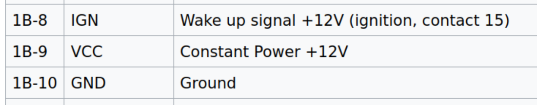

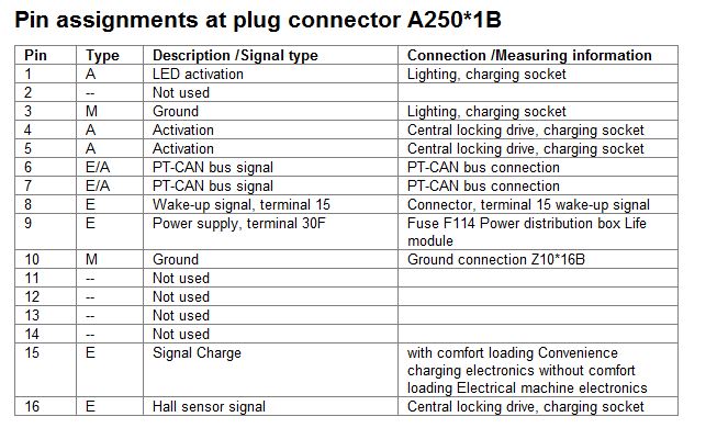

IDK, to me it looks as if terminal 30F is connector 1B-8.
" LIM . . . is supplied . . . " = "module wake-up"? Could be me mis-interpreting translated German).

Wake up in the i3 works the same as in most modern bmws (and I'm sure others). How I implemented it is not really correct. Its more of a holdover from bench testing when I was working out the can. Any module can wake all the other modules either by can on 0x12f or via the hardware wake up line. If the LIM is asleep it will wake itself on the insertion of a charge plug or the opening of the charge port door. It will then pump out wake up via can and put 12v on the hardware wakeup line. Also, if the LIM is asleep and sees a can or hardware wakeup it will wake and start doing LIM things until it is allowed to sleep. This behaviour can be observed in the i3 logs on the ccs github page. How I implement it in the vcu is kinda crude as the LIM is kept awake all the time when it really doesnt need to be. Another piece of cleanup when I get back to ccs.

Thanks Damien, so the "IGN" "KL15" wake up is bi directional, very good to know.
I was quite aware of the canbus wake up probably working in that way. However creating modules with wake up on canbus is quite tricky for us DIYers while maintaining low current draw while a sleep.

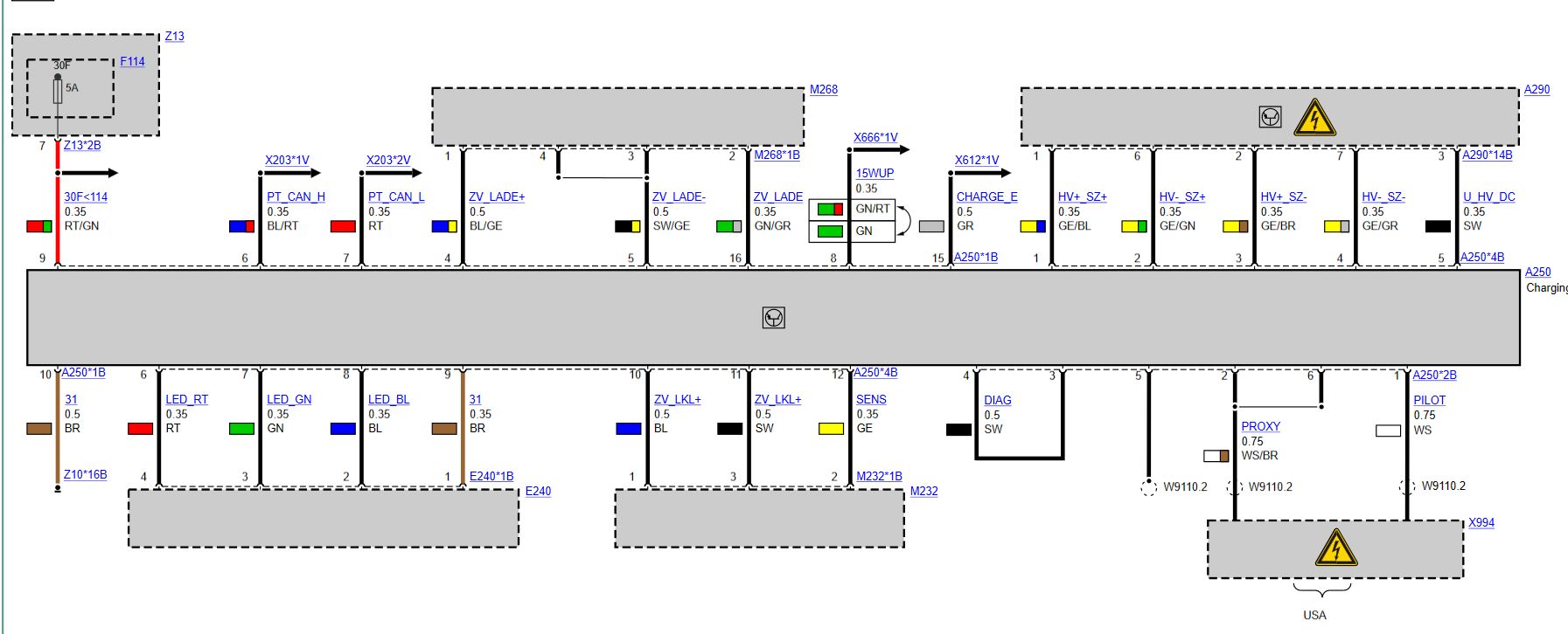

If we're discussing the charge port's lock (the BMW has a separate switch on the actual door) . . . the LIM monitors pin 1B-16 (referenced to ground) and is expecting 11k when locked, 1k when unlocked. Because the LIM thinks it's driving a motor that drives the lock actuator pin, it outputs 12vdc in one polarity for ~1 second pulse to lock, and another ~1 sec. pulse of the opposite polarity to unlock.Jack Bauer wrote: ↑Fri Jun 17, 2022 11:30 am I forget the charge port door logic but it is either tied to ground or floating if memory serves. Actually yeah on the i3 its just a on/off switch on the cp door.
Member raine recently updated the charge port lock wiring diagram and made a really good contribution in the process, added to the Wiki:
In May2021, Damien spoofed the LIM's expected charge port lock behaviour via a pair of resistors and a bistable relay:

We are not discussing the plug lock.
We are talking about the Fuel door/charge door position switch. This door can be locked by the central locking system.
- asavage
- Posts: 385
- Has thanked: 369 times
- Been thanked: 119 times
Ugh, the Wiki didn't mention the charge port door lock (and sensor) at all . . . I've now updated its LIM "Connectors and Pinout" function chart to define the function of the connector @ 1B-13, based on member chrskly's chart.
I've made the Wiki's chart now state that 1B-13 must be tied to ground for the LIM's contactors weld test to occur . . . can someone confirm that: grounded = door closed?

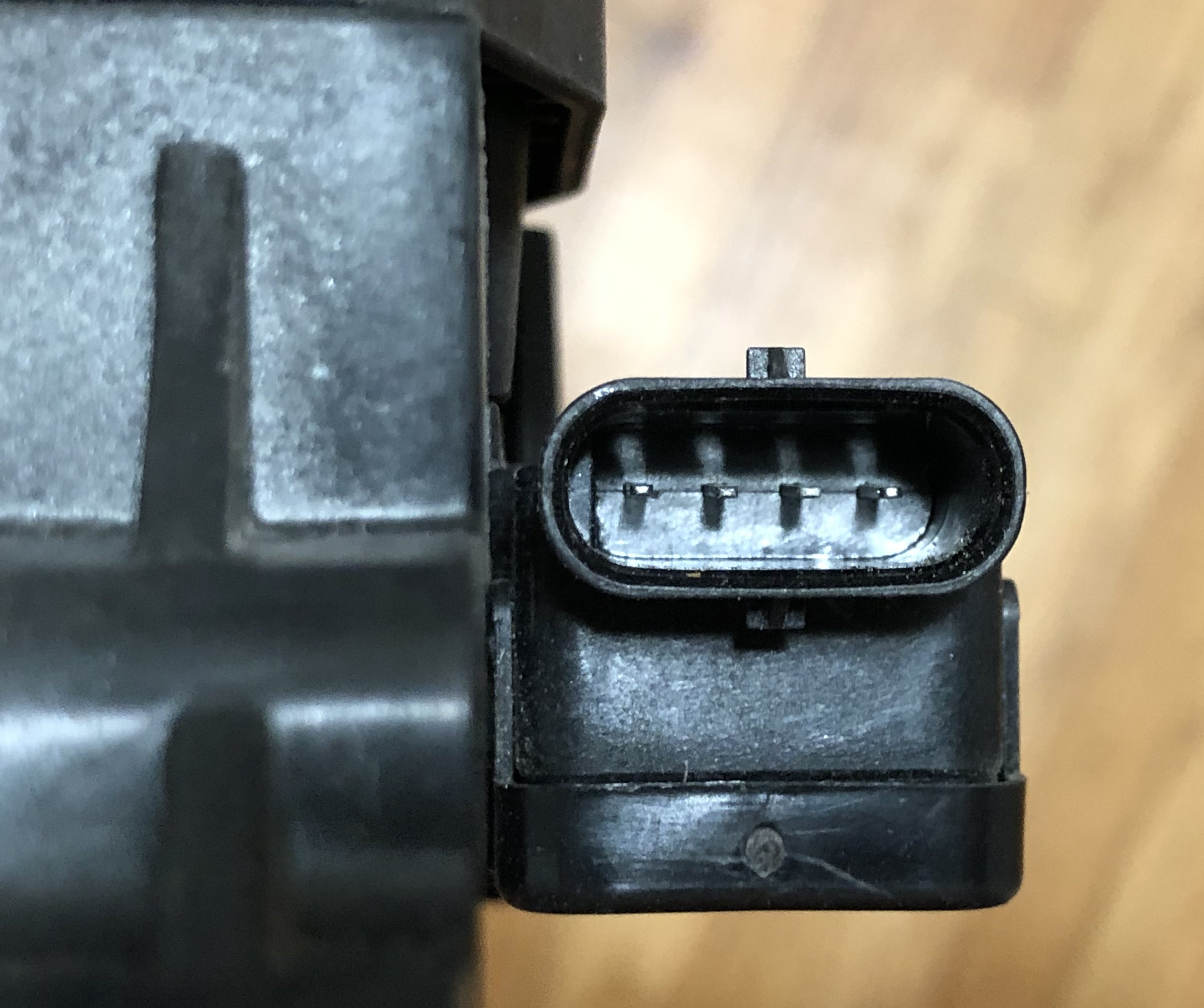

I recieved my LIM and built a bench setup
4B-12 COV FBK when not grounded it indicates being open over canbus based on the DBC file on github.
I do not see any change when grounding 1B-13 or having it high.
One thing to note when powering on the LIM and having both 1B-13 and 4B-12 floating on startup the flap status report error.
At this moment I am simulating the charge socket and actuator with resistors, I do not know is this will cause issues. I have not been able to get the LIM to be happy with a simple portable EVSE, probally due to not having an locking actuator.
1B-13 is not on on the wiring info on ISTA, this only is referenced when you look at the Chademo version.
Made changes on wiki to match this info.
