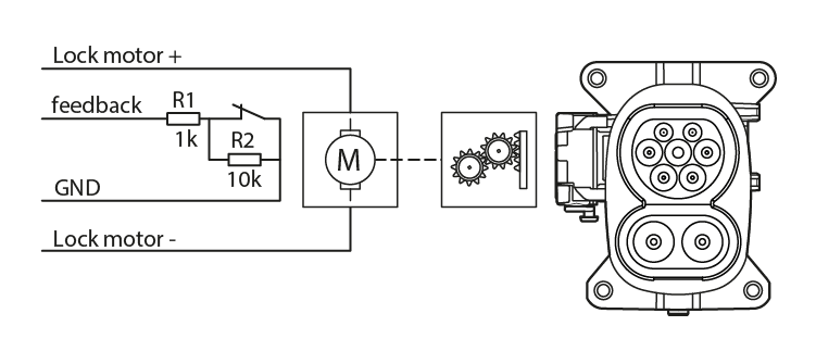

tom91 wrote: Sat Jun 18, 2022 6:23 pm Got a cheap chinese lock actuator wired back ward to put a 1K over the 10K for cable lock position feedback.
Doesn't the LIM require 11k for "locked". Paralleling 1k over 10k = 9k1 ?
Al Savage
2014 RAV4 EV
NissanDiesel
Posts: 2962
Has thanked: 328 times
Been thanked: 847 times
asavage wrote: Sat Jun 18, 2022 8:20 pm Doesn't the LIM require 11k for "locked". Paralleling 1k over 10k = 9k1 ?
Wired like shown. The resistors are outside the actuator, but to make it properly work I will make a PCB to reverse the switch behaviour to allow the Chinese actuator to work with the I3 LIM.

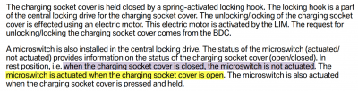

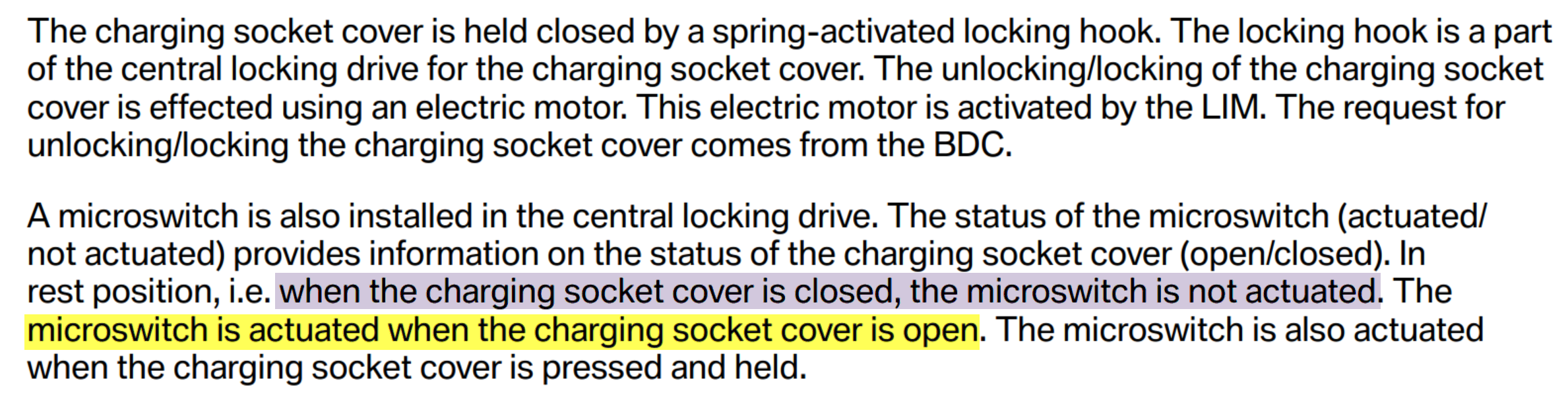

tom91 wrote: Sat Jun 18, 2022 5:08 pm 4B-12 COV FBK when not grounded it indicates being open over canbus based on the DBC file on github.
To confirm: are we agreed that 4B-12 floating == (0x272.16 == 1) == "Charge Port Cover is Open" ? The Wiki is currently in a indeterminate state on this point.
[later]
Confusingly, there's this from pg. 112 (indicated) from BMW ST1403a:
BMW ST1403a, pg. 112
Switches can be NO or NC, so the functional description doesn't/shouldn't imply the electrical circuit to provide that function, but still . . .

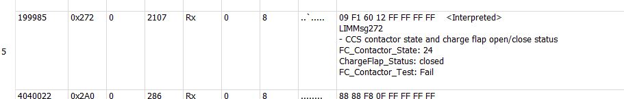

I have measured the pin 5 return from the HV measurement board it is at 1.439V and the canbus reports 0V on FC voltage. Contactors connected and measure at 15.8 ohm.
I took logs of my setup if anyone would mind having a look that would be great. https://github.com/Tom-evnut/BMWI3_LIM_ ... ch%20Test
The charge flap reports to be closed and I double checked the values of my messages with known working logs so all should be inline with what the LIM expects, however no weld check test is triggered.
One thing I am seeing is in Damiens logs the FC Contactor Test reports fail on the canbus even though the contactors cycle when requested during charging.

Your value of byte 2 on CAN 272h is 00. That means DC contactors are OK, so no weld test necessary. You can fake a voltage on the charge port (e.g. 2V on pin 5) and then set it back to 0V.
You should be able to observe on CAN 272h a change to 18h while the DC voltage is present , then 8h during the test and then 0 again

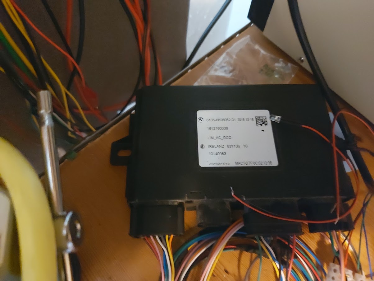

Thanks guys. They have cycled :D
I applied 100V to the sense lines and removed them and then the contactors cycled after toggling the ignition in 0x12F byte 2 from 0x88 to 0x8a.
My Lim is a 2016-12 date

Here is some pictures of my current setup. Now I got the contactors to cycle I will start to build my HV junction box and try to clear the contactor test fault, using my HV power supply on the battery side of the HV contactors once I have forced it into a fault condition.
Is there a way to get the 2016-2017 LIMs to preform this test without having to force it into a fault condition with Voltage first?
