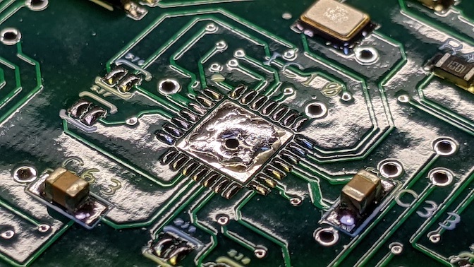

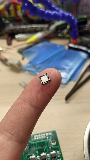

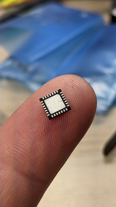

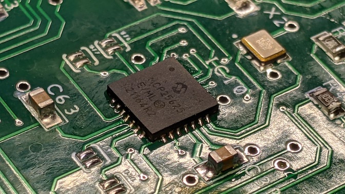

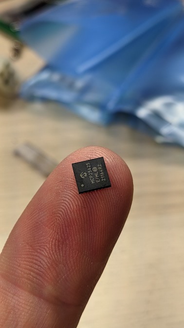

Got my boards today! Thanks Jack ;-)
I need to fit the MCP25625's, Jack included the parts with my boards. Anybody done a video on fitting this part? Should I make a video?

That MPC25625 was a nasty little bugger to fit onto the Zombie Brain! I hope I got all those pads nice and seated.

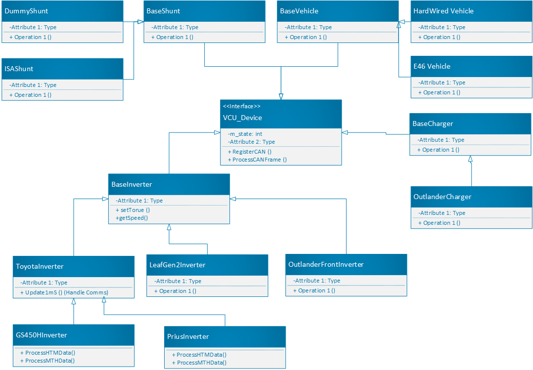

I've drawn up a class diagram for what has been done so far, this doesn't include any vehicle logic to the classes which will be used to represent Inverters, chargers, vehicles and shuts. Many of the attributes / methods aren't on the diagram, but it should give people the idea.
EV_Builder
Posts: 1205
Location: The Netherlands
Has thanked: 18 times
Been thanked: 37 times
Post by EV_Builder »
The base class should be the first tobe drawn in the schematic.
Then from that you can draw the instances. In that way they inherit the interface (in our design).
Nice that you do this all :)
