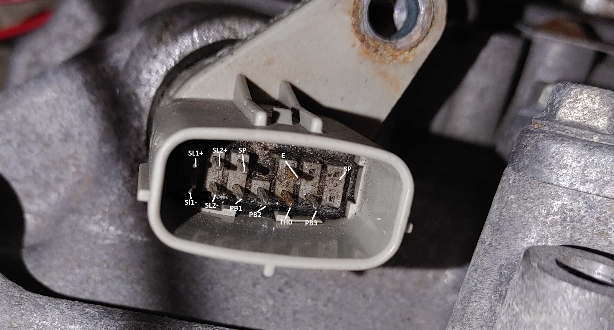

Looking for a spare 90980-12483 (connector for the oil pump controller) if anyone has one with wires attached? 2nd hand ones only seem to have wires on pins 4 & 5 and new ones don't come with terminals.

The controller only uses two signal wires (brown and black) and the blue power wire. Pins 4 and 5 sound correct.

Unfortunately the brown and black wires are pins 6 & 7 (according to this) but the only ones I can find to buy have pins 4 & 5, the HV pins, like this. I'm trying to avoid buying a whole new control unit just for the connector.

You can always just use generic pins and then fill the cavity with epoxy, then add your own connector.

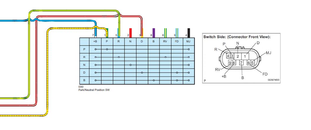

For what it's worth, I think it makes more sense to use pins 6 and 9 (FWD and REV) instead or R and D. This way, you can use the momentary "B" position without it dropping into neutral.

Gigas wrote: Fri Oct 29, 2021 8:01 pm do you mean you can just use a momentary push button and hit pin 6 or 9 with 12v for a second and it goes in drive or reverse till you select something else?
No, the gear selector has 5 positions: Park, Reverse, Neutral, Drive, B. "B" is special, unlike the others, it's momentary, when you let go of the lever it goes back to D. It's therefore useful as a switch to do something special, but you *probably* want the inverter to stay in forward more while it's engaged (not neutral).
Each of these 5 positions has wire that goes to 12v when it's selected, but there are 2 extra wires, "FWD" and "REV". FWD goes to 12v when either D or B are selected. REV is just the same as R.
In my project I'll be using FWD to put the inverter into forward, and REV to put the inverter into reverse. I'll be using B either to trigger a gear ratio change, or engage cruise control.
To clarify, this means that while using the momentary "B" position, the "B" and "FWD" wires will still be live, but D will not.

I used FWD in my car as well, and I use B in my firmware to shift into low gear (it doesn’t have to be momentary if your setup doesn’t have a spring return). Works great

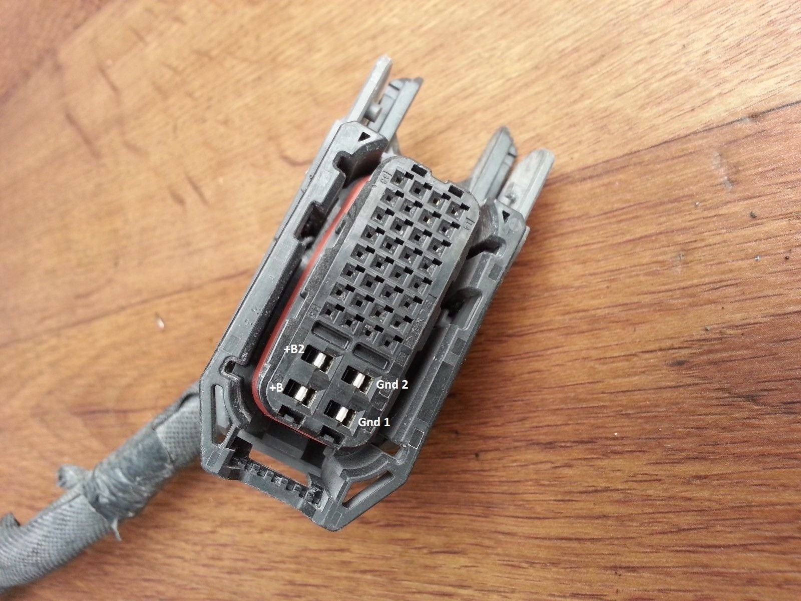

Ok I just need to confirm a few things as I finished pinning and wiring up everything - check my wires and put 60v to the invertor and got NOTHING! Very frustrating. I checked and double checked - I even ordered a new pedal and a 5k pot just to test things. When 12v is turned on I here a relay click in the transmission and can switch gear fine but I don't seem to be getting anything from the invertor. Is there a way to make sure my invertor is good? I'm at a loss right now as what to do - Just to make sure can you guys verify I have these labels on the plugs correct?

Gigas wrote: Mon Nov 01, 2021 12:51 pm Ok I just need to confirm a few things as I finished pinning and wiring up everything - check my wires and put 60v to the invertor and got NOTHING! Very frustrating. I checked and double checked - I even ordered a new pedal and a 5k pot just to test things. When 12v is turned on I here a relay click in the transmission and can switch gear fine but I don't seem to be getting anything from the invertor. Is there a way to make sure my invertor is good? I'm at a loss right now as what to do - Just to make sure can you guys verify I have these labels on the plugs correct?
Those look correct. How are you getting power to those 12v lines? The Inverter Power (B, Pin 6) is for providing a ground to a relay. Also, in Park, the inverter will make no whine. Couple of thoughts:
* You should be able to connect your throttle to the VCU and get readings without being connected to the inverter at all. You can set min/max throttle and verify it's reading correctly.
* Make sure your CLK, REQ, HTM, and MTH connections between VCU and Inverter are correct.
* Make sure your resolver connections to the Inverter are correct.
* Do you have a common ground for Inverter and VCU? I'm not certain this is required, but it seems to resolve a lot of my accessory issues when I'm having problems.

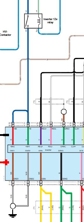

That may be my issue as I didn't hook a relay to the B and B2 , as it looks like they where connected together and just connected to positive via the 10amp fuse
- so if I'm reading this right now B and B2 connect together and go to 5(87) on a relay - 2(85) and the relay goes positive via ignition switch - 3(30) goes to positive via 10amp fuze and 1(86) goes to pin 6 on the vcu.
-I'll recheck the throttle via the vcu when the new one comes in a day or so
-i'll double check all the connections
-does it matter where the resolvers are connected as there a gsn and msn and I'm not sure which goes to which on the transmission - also I don't have the temps wired up on the resovlers - not sure if that matters
- I have the ground of the vcu and the two grounds of the invertor connected to the same busbar then the negative of the 12v supply goes to that bussbar

Gigas wrote: Mon Nov 01, 2021 3:29 pm ground.JPGThat may be my issue as I didn't hook a relay to the B and B2 , as it looks like they where connected together and just connected to positive via the 10amp fuse
I don't know that the relay is required, I was just making sure you weren't using Inverter Power as a positive 12volt. The temp wires go to the VCU and aren't really meaningful anyway (see previous discussion in this thread). They are just informational. Yes, the resolvers need to be right, but I honestly can't recall now how I determined which was which. I confirmed with my setup that switching the resolver connectors on the tranny will still allow the inverter to fire up and drive the motors (it'll just send the wrong values to each).
EDIT: E81 is Generator Resolver (MG1) and E82 is Motor Resolver (MG2)

Is your trans switch Drive/Reverse lines wired to Input1/Input2 on VCU and Park to Pin6 on inverter? First time I hit the throttle, nothing happened until I got those plugged in.
