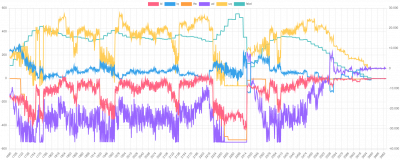

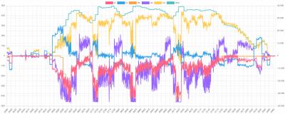

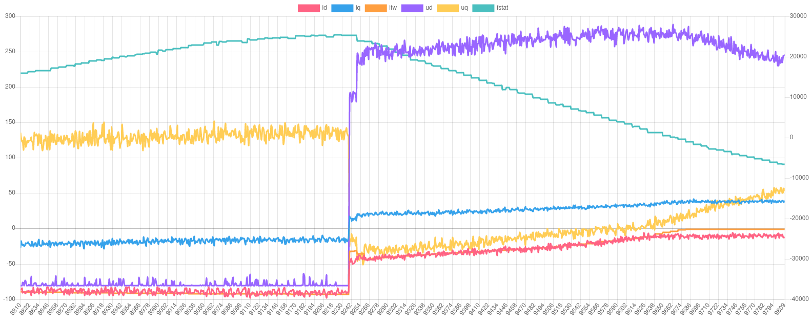

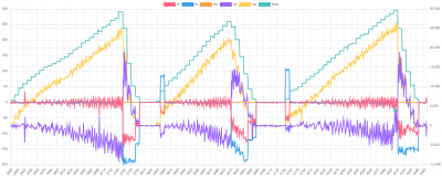

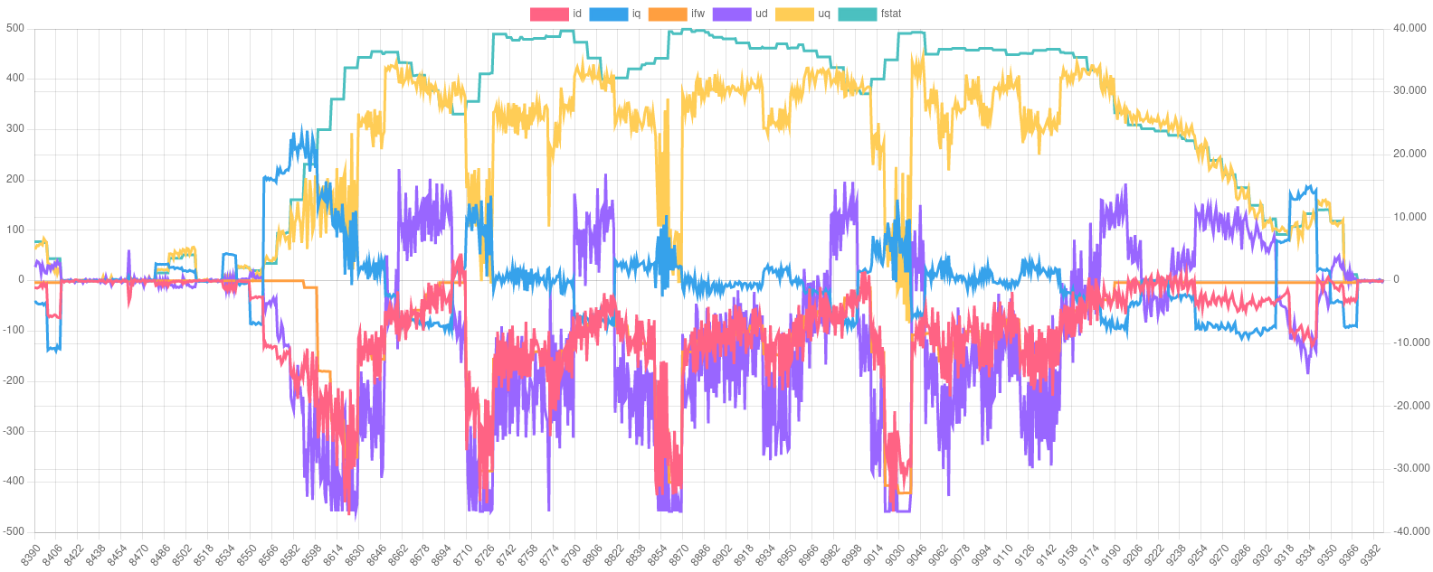

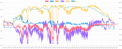

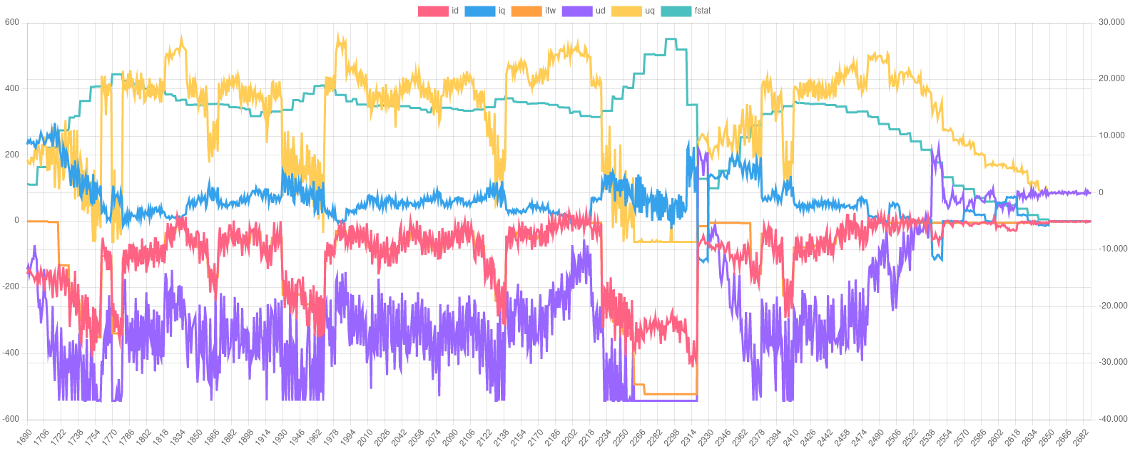

Finally, a Touran test run with latest commit. Performance is now also very good with the Leaf motor, allowing idMtpa to be up to 2xiqMtpa in vlim case has cured the torque dropoff.
At the first try I had some unwanted acceleration: So now I did some coasting tests, first with syncadv=0: Aha! ud is frequency dependent.
Ok, lets give it syncadv=5 Better, but lets go higher, syncadv=10 Alright, close enough. Lets hit it again: And again: Well that's better! Fully controlled at any speed, nice torque at any speed, regen at any speed.
Lets go home. 3rd gear. Bonk! Oh, whats that? Over current shutdown when planting your foot at standstill. I had been driving with curkp=150 as suggested by the simulator. Ok, lets dial that back to 60. Launches ok. Too much oscillation with high curkp and low speed. Now I should do another high speed test run but then the last one with the "accidental" syncadv worked fine with curkp=50. So won't test that today.
Bottom line having syncadv is super important, it alone cured the unwanted acceleration. The coasting graph suggests that 10 is quite ok.
EDIT: flux linkage calculation:
uq=25000, udc=360, fstat=300
uac = uq/37813*udc/sqrt(2)=169V
V/Hz = 169/300=0.56 V/Hz = 90 mWeber

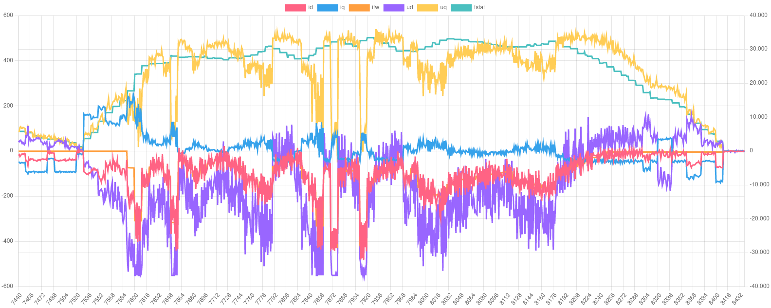

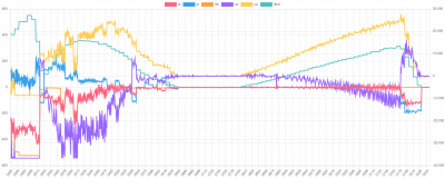

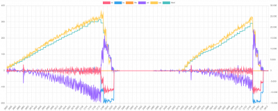

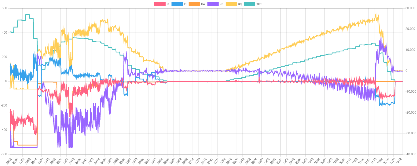

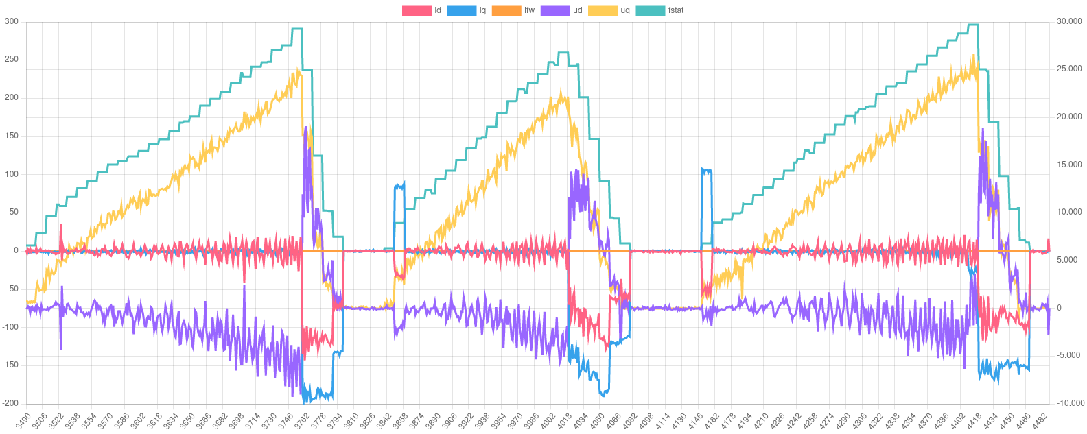

With the latest knowledge (syncadv=10) I did another test drive in the Audi. I think this is production ready now. I didn't get a single trip for the entire run even though I was pushing it and I do get a very stable 80A (x370V) battery current in the constant power region.
Here is a plot of accelerating from standstill to 120 kph and regenning back down (didn't fit entirely from and to standstill...) The d-controller is very close to saturation but is never saturated.
You can even see the DC current limit working as speed decreases iq increases. I have posted the parameters here https://openinverter.org/parameters/view.html?id=29
I will draft a new release of the firmware now. I was going to include the logging code but having some minor trouble with it, so will include it in the next release.
At this point I'd actually consider this topic solved. As you know I have been struggling with this for years and I think it would not have been possible to solve this without Petes input and his simulator. So huge thanks for that
